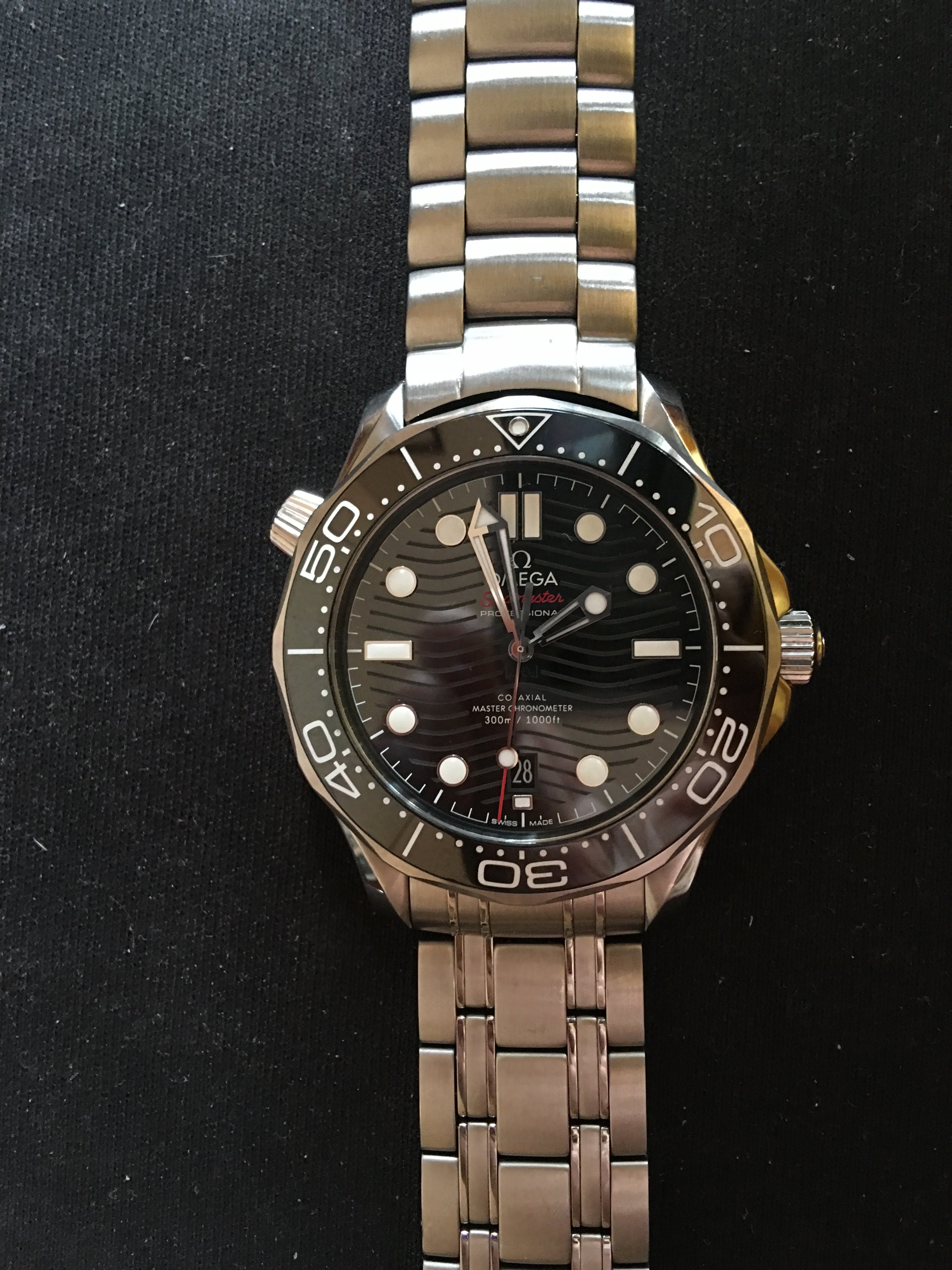

Quick question, would the Seamaster Planet Ocean 600M bracelet (watch number 222.30.42.20.01.001 with a 42-mm case and 20-mm lug width) fit in my Seamaster Diver 300M (watch number 210.30.42.20.01.001 with a 42-mm case and 20-mm lug width)? Widthwise they seem to fit but the distance from spring pinholes to watch case is my concern.

That is what I thought, them lugs are be a problem. I just purchase a 100% replica bracelet and I'll see what modifications I need to do. If I only need to trim off the tabs or a very small filing I can do, but if the hole distance to the case does not align then it's a no-go. I should get the sample Monday 30th, I'll get back and report my findings.

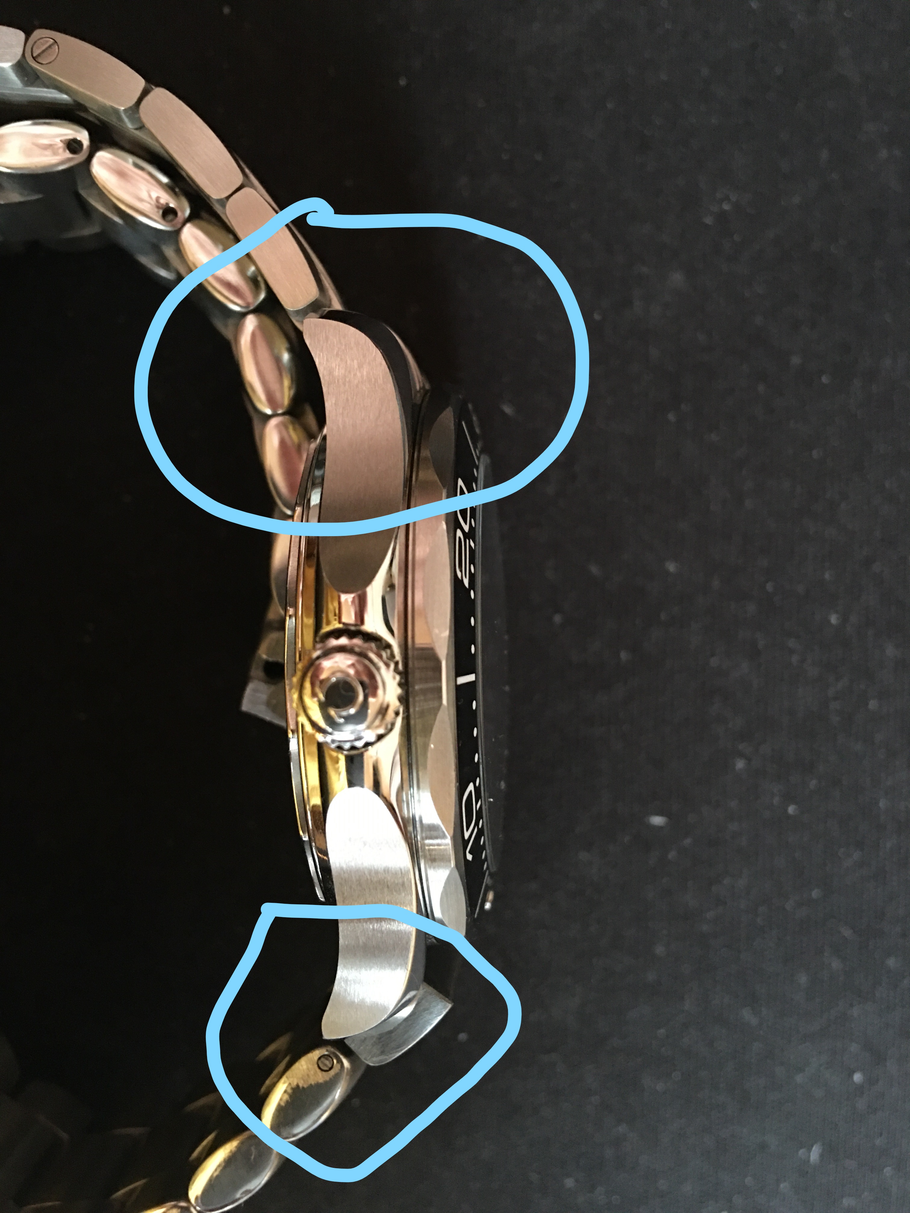

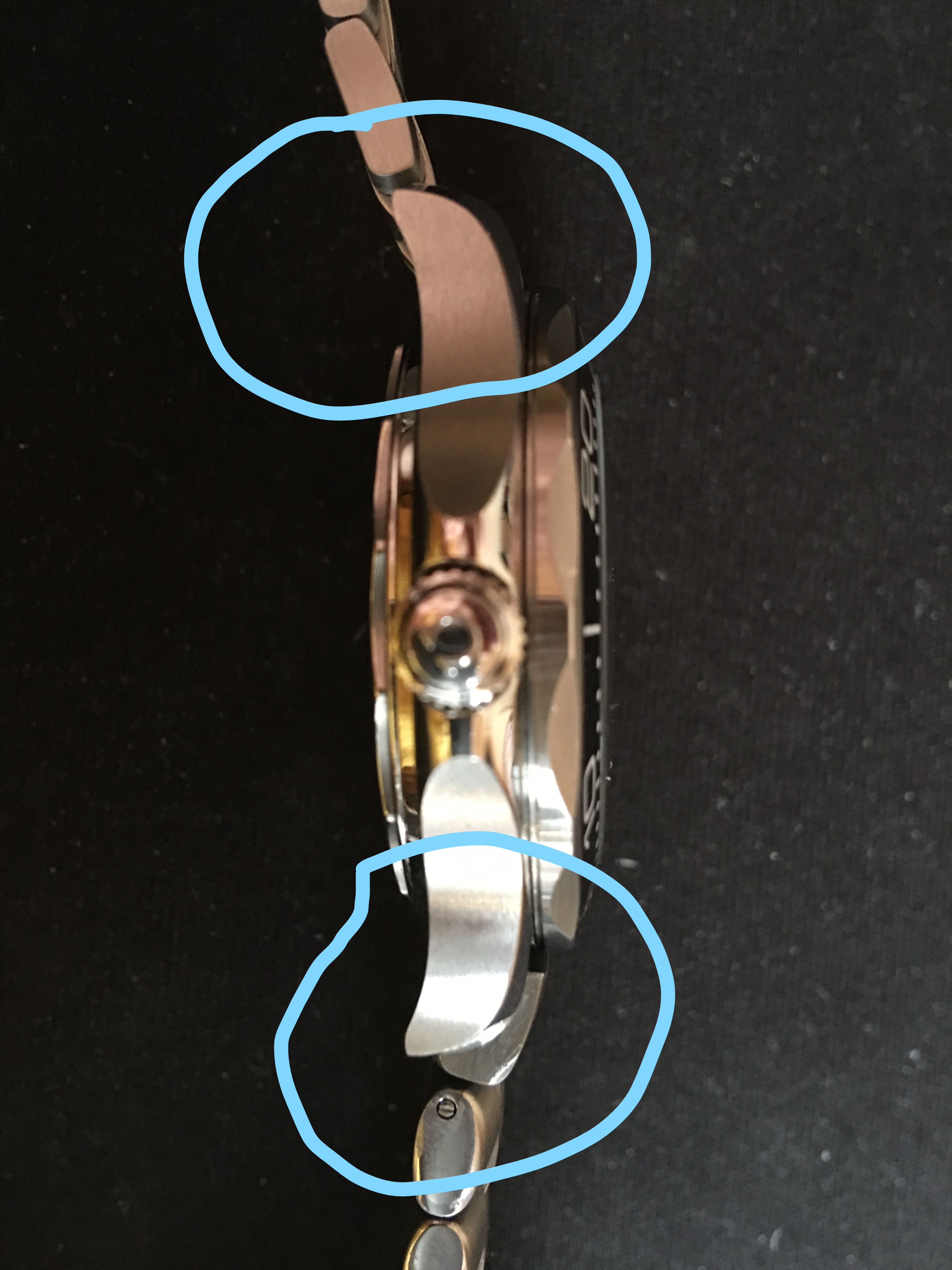

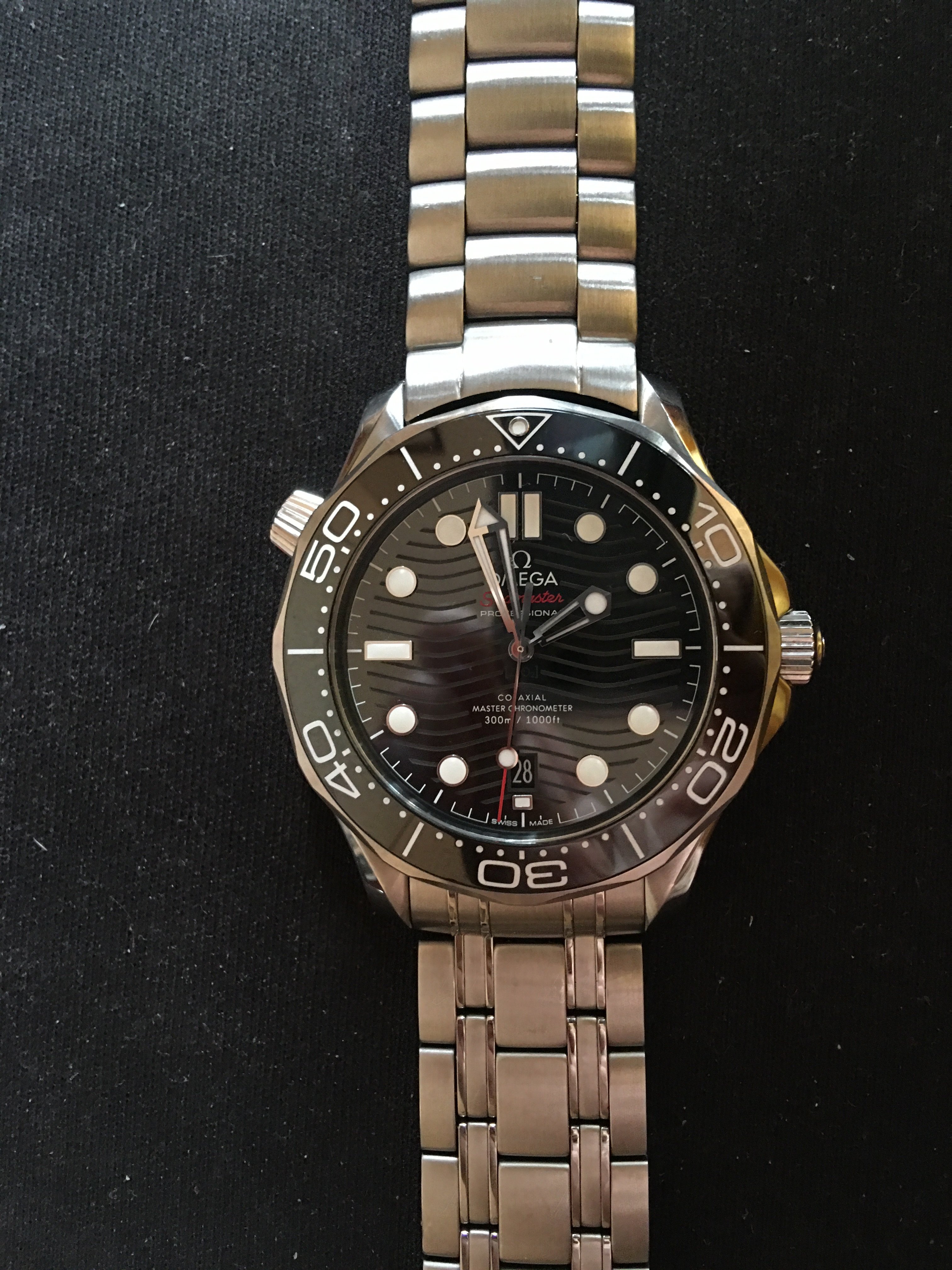

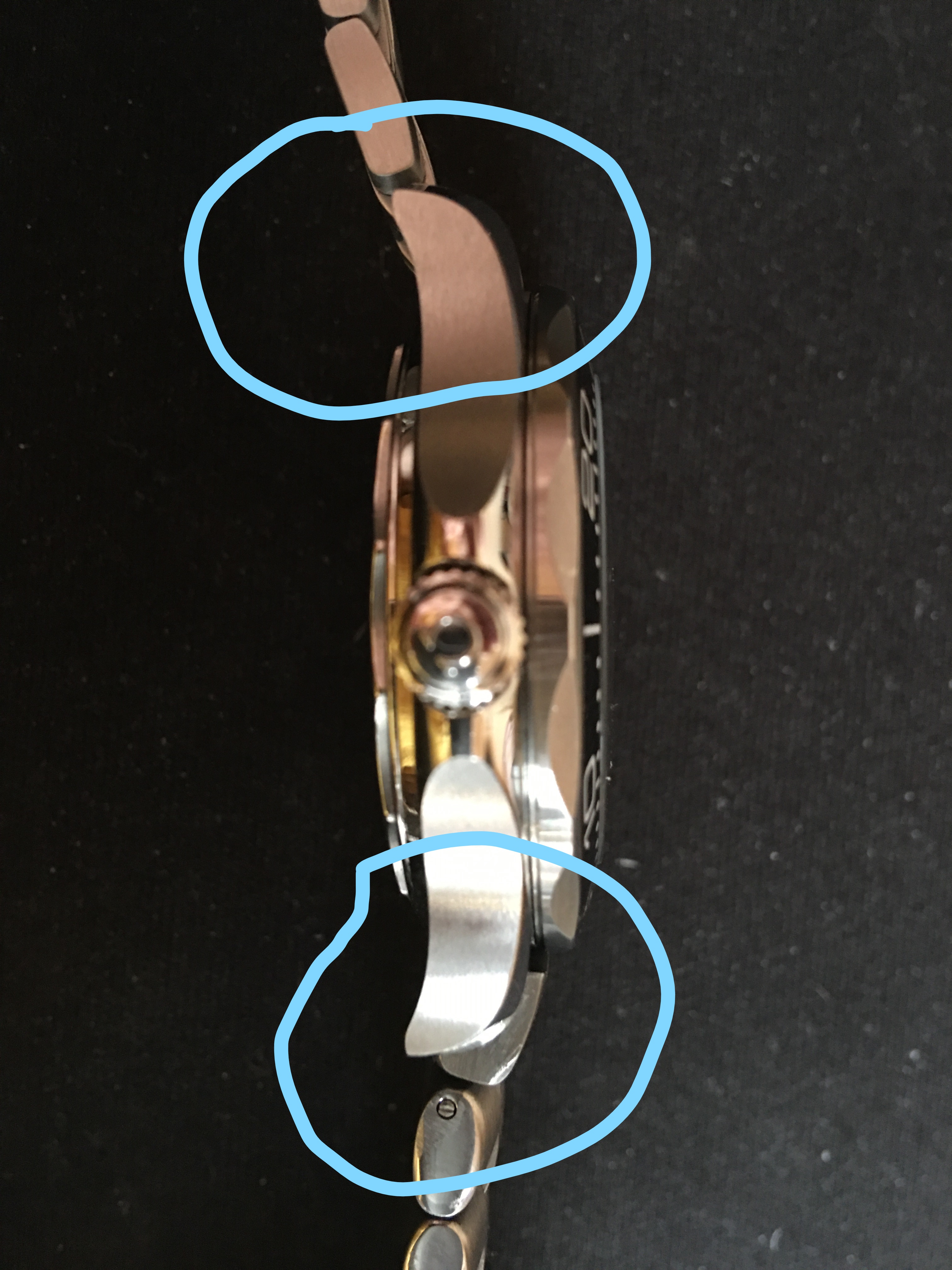

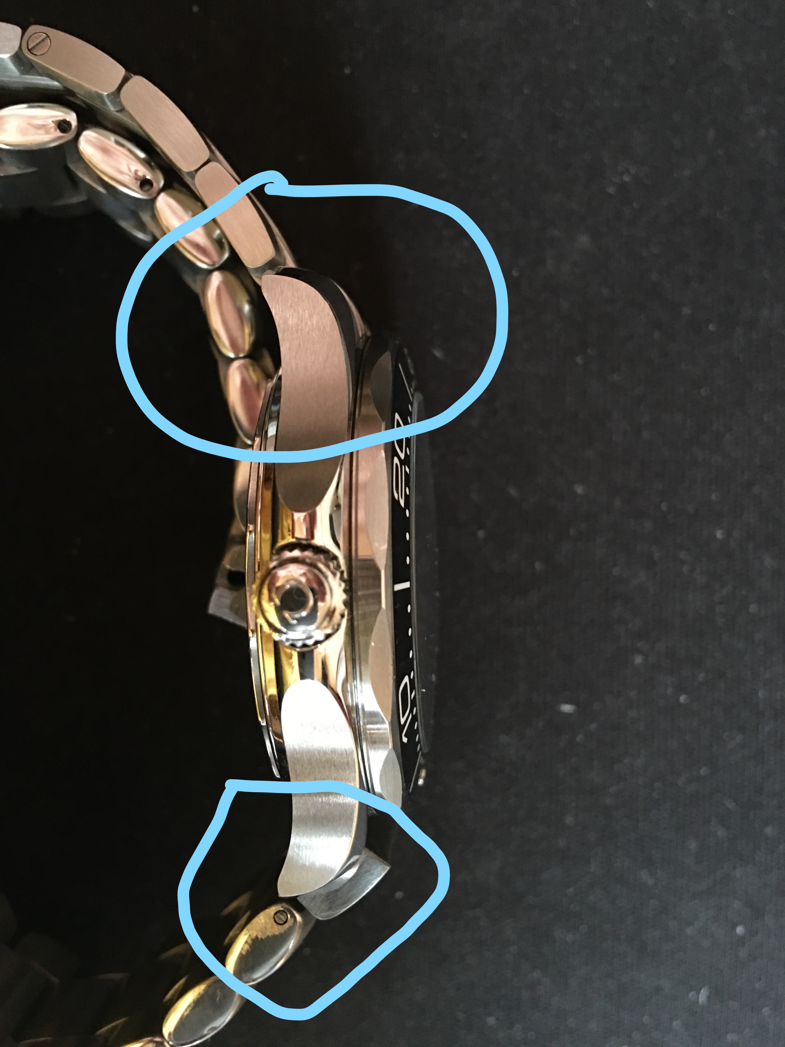

I received the OP replica bracelet and conducted a modification fit test on it before I went and purchased the original PO OEM bracelet for $800. The fit shows that the link does not lineup flush with the top, I filed off those little wings from the OP bracelet, but the problem is that the link sticks above the watch as you can see. I placed the SM on one side and OP on the opposite side to see the difference.

That’s unfortunate. The 3 link looks so much better. Thanks for doing the research.

> basing compatibility off a replica
The replica is a 100% copy of the PO bracelet, you can also confirm this if you wish by buying yourself the original PO and file to fit in an SP. We will be anxious for you to let us know your result and if you differ in your opinion.

100% copy, eh? Tell us more about Chinese quality.

dude, I'm not trying to sell this information, this is my research! All I am saying is IT DOES NOT FIT! (BTW that is my filing you see in that picture using a rasp (don't point to some Chinese guy) and unfortunatly I do not have a 5-Axis CNC milling machine and a CMM system for inspection). And I have two more confirmations, I did contact Omega / Swatch service in Switzerland last week and they said it is not compatible, I also talked to Authentic Watches the same thing she told me, its a no-go. I just wanted to see for myself how can this be!!
The bottom line from all this it does not fit, get it! Stay safe and save you health 😉

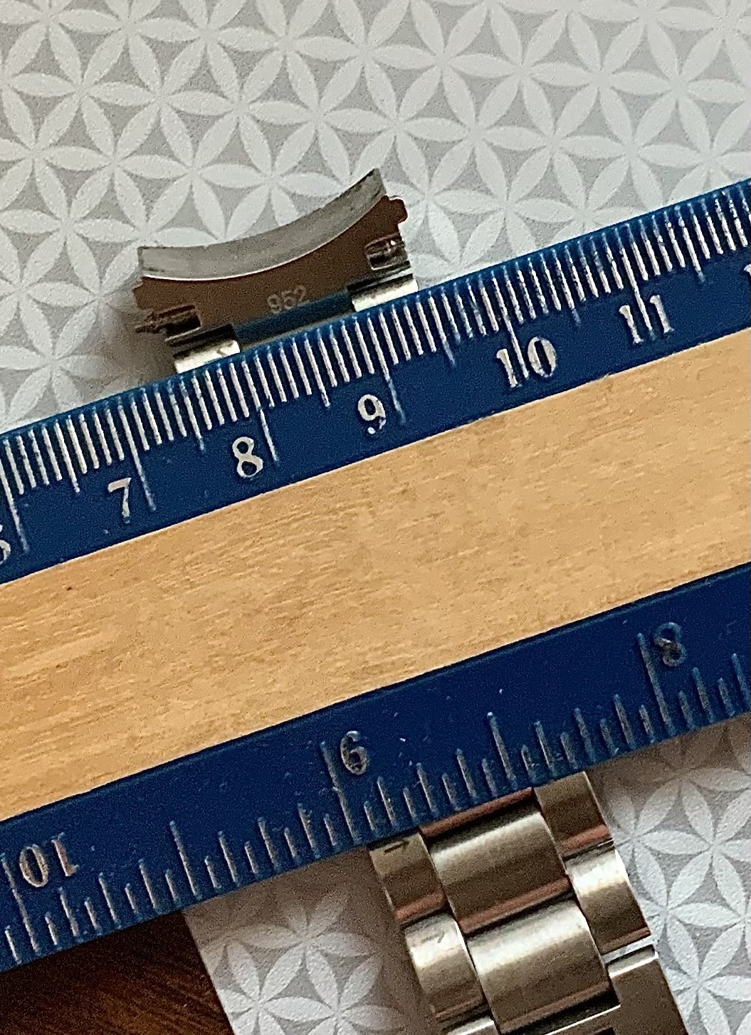

Thanks for your answer. Is the center link 10mm in width?
It has any microadjustment in the clasp?
Thanks

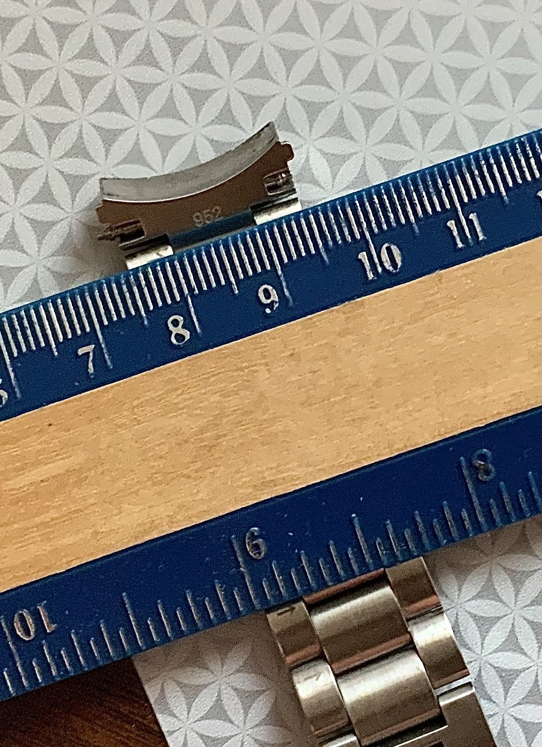

Seems to be a hair narrower than 10mm. With this junky, rudimentary ruler I think I got in 3rd grade and for some reason still have, it appears somewhere in the 9mm or 9.5mm width range…
This particular version of the PO bracelet does not have micro-adjust in the bracelet, no. The second gen 8500 caliber bracelet did (and many people bought the clasp from that generation of bracelet and put it on this original planet ocean bracelet as an ‘upgrade’ to get the micro-adjust).
