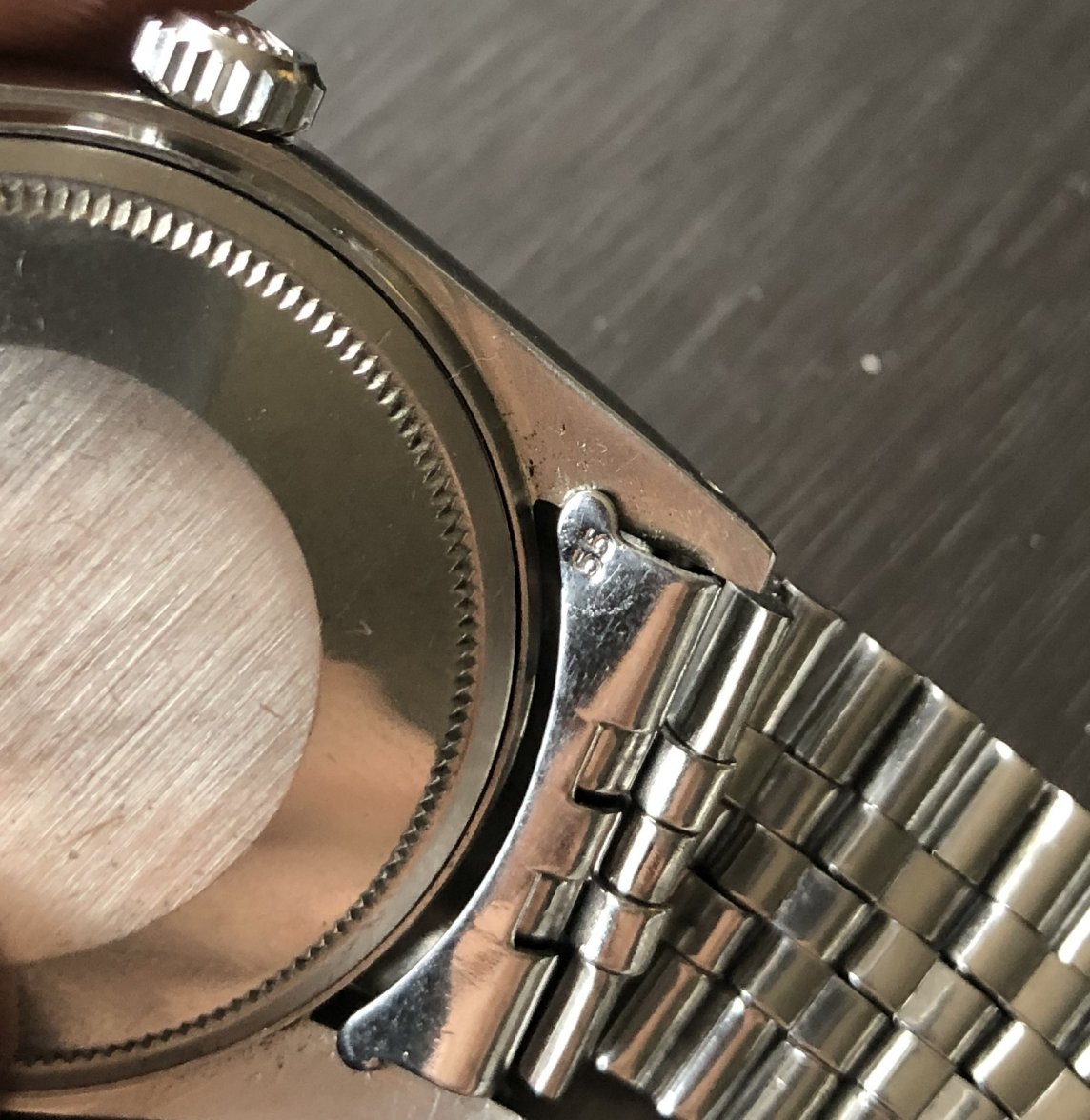

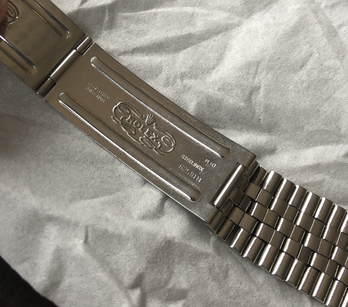

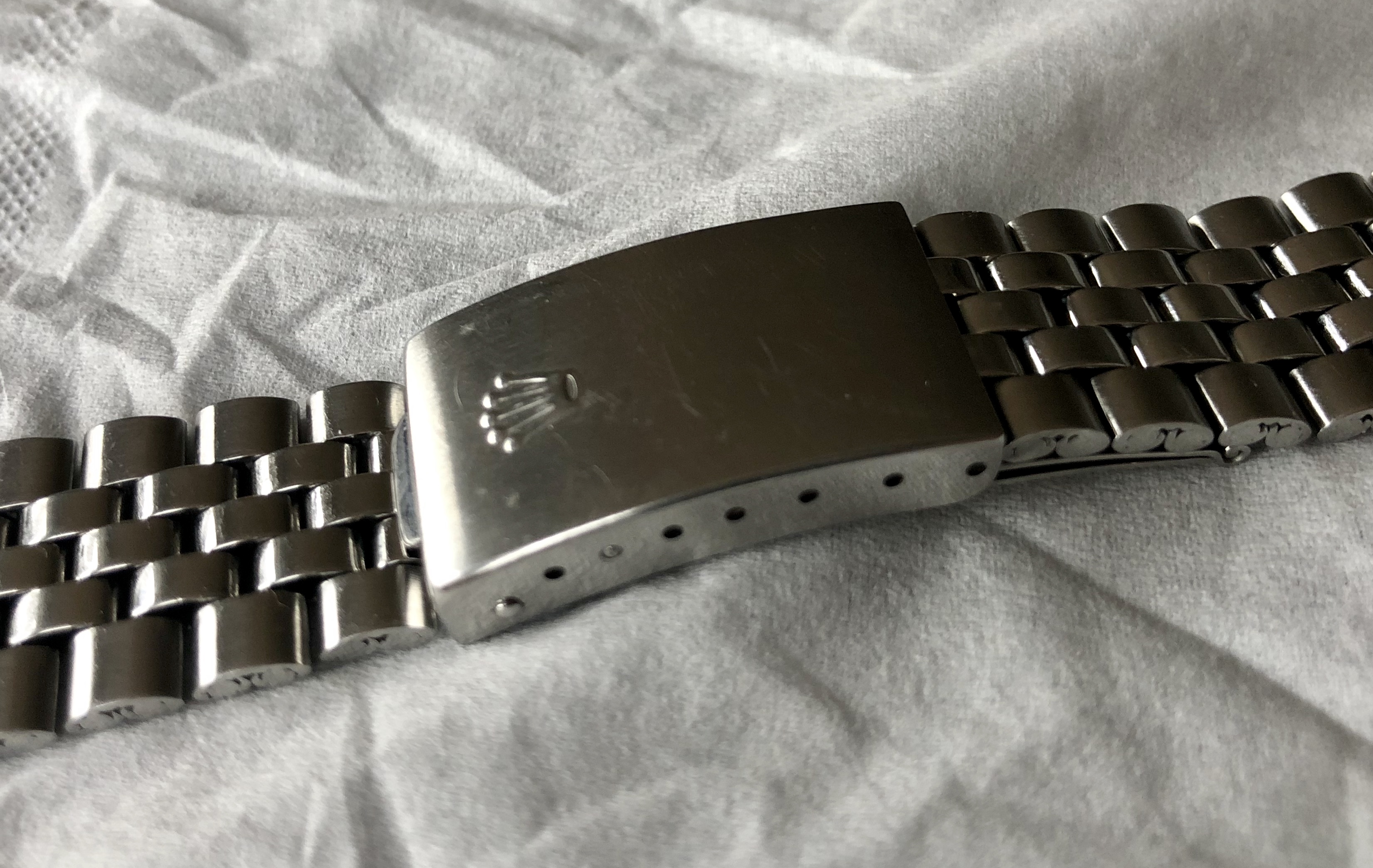

Dear OF,
in my DJ from 1972 i found this bracelet - is correct one?
End links - 55
Bracelet clap - 62510h M10
thanks in advance for Your help!

Please tell me what means m10? And 55 was not from 60’?
4,593
10,813
a lot of the early folded jubilee bracelets had 55 end links for the datejust. i'm not up on the clasp codes but the bracelet looks correct for your '72 watch.
1,320
7,891
The end links and folded link jubilee seem correct for an early 70s bracelet but the clasp is a replacement from the late 80s.
1,151
1,474
this^
1,441
3,809
the clasp is from October 1988
End links are correct for the period
