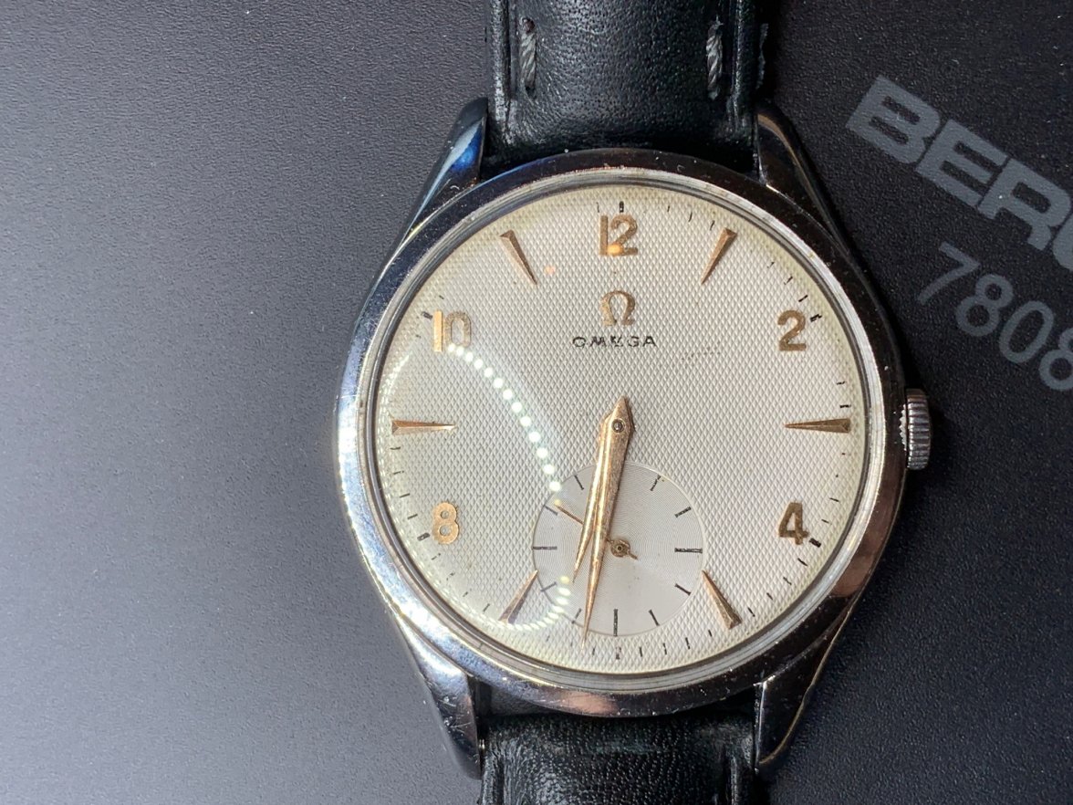

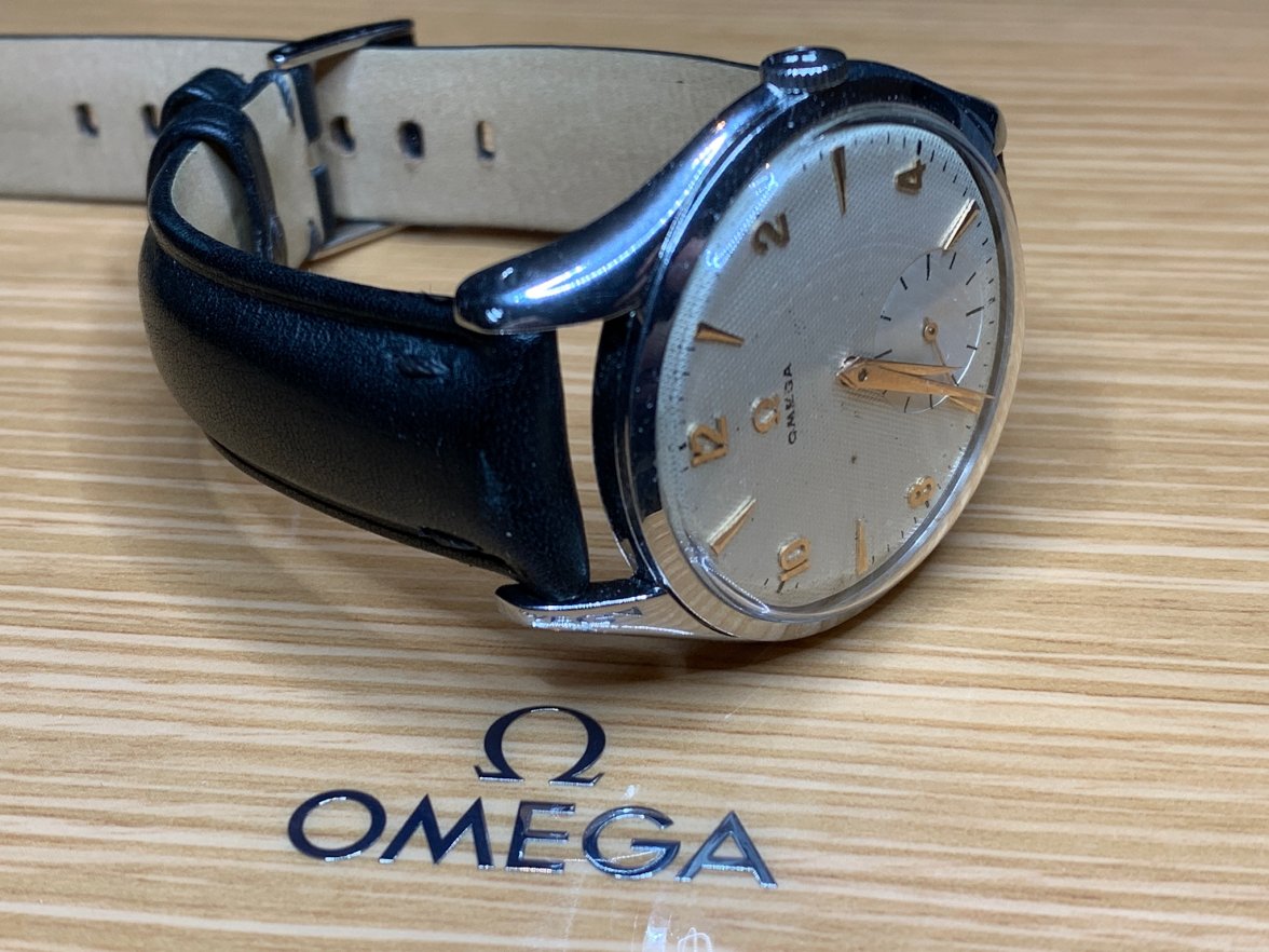

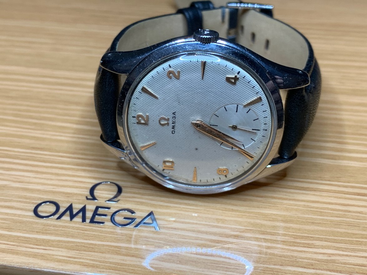

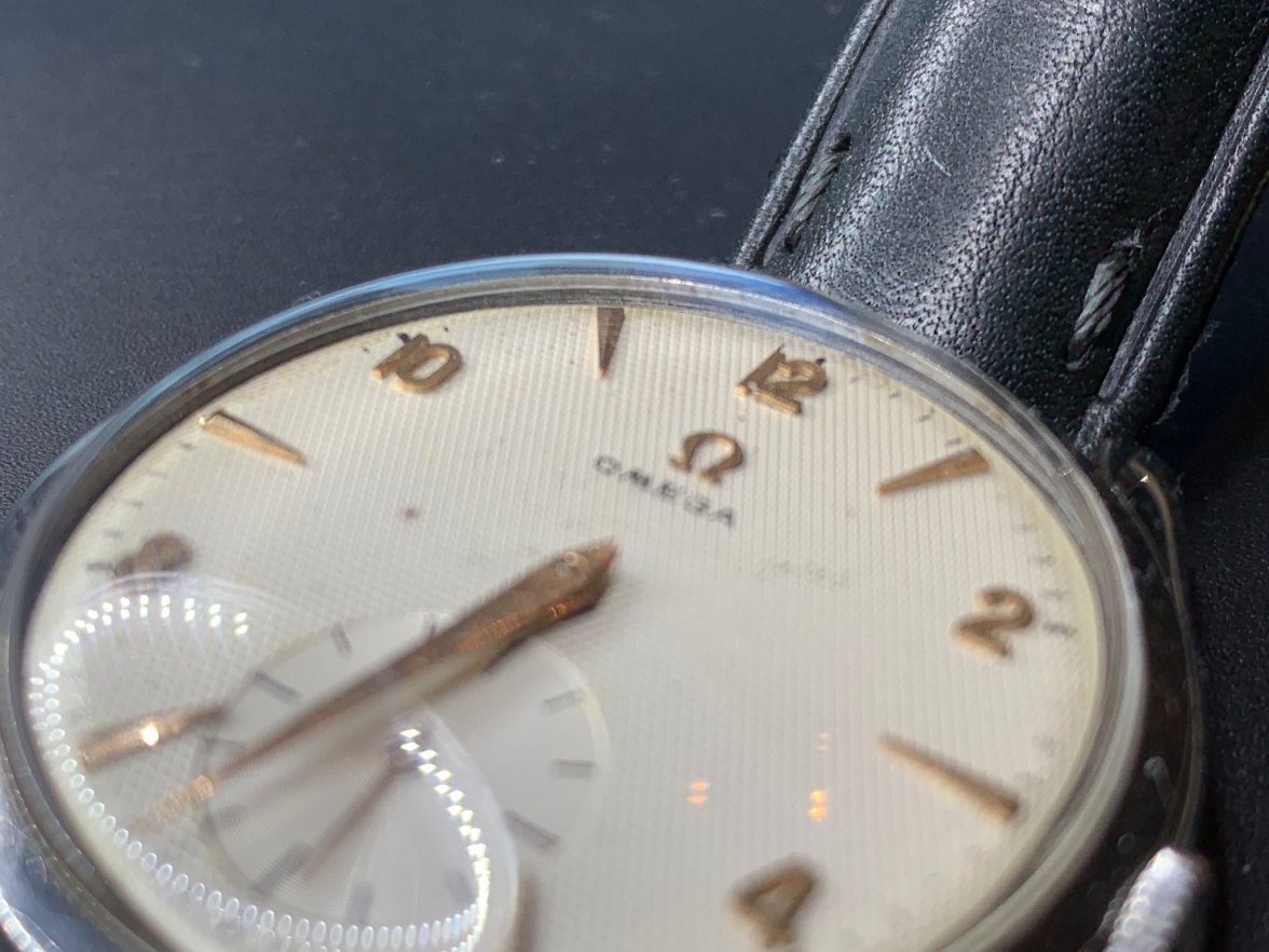

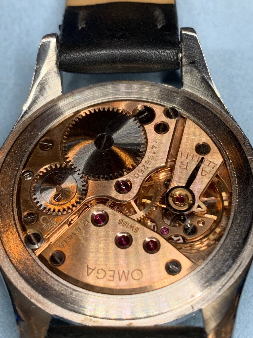

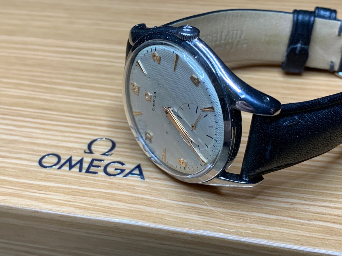

Hi there, I today bought this honeycomb Jumbo. I already knew it was pretty much over polished. However, the movement is good and I like the dial. I have the idea that this dial started its life in a gold one but not sure.

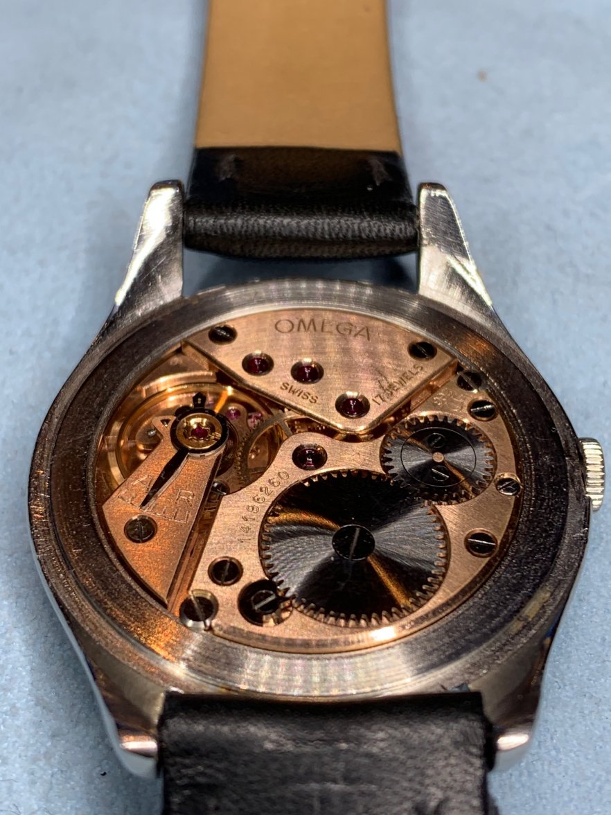

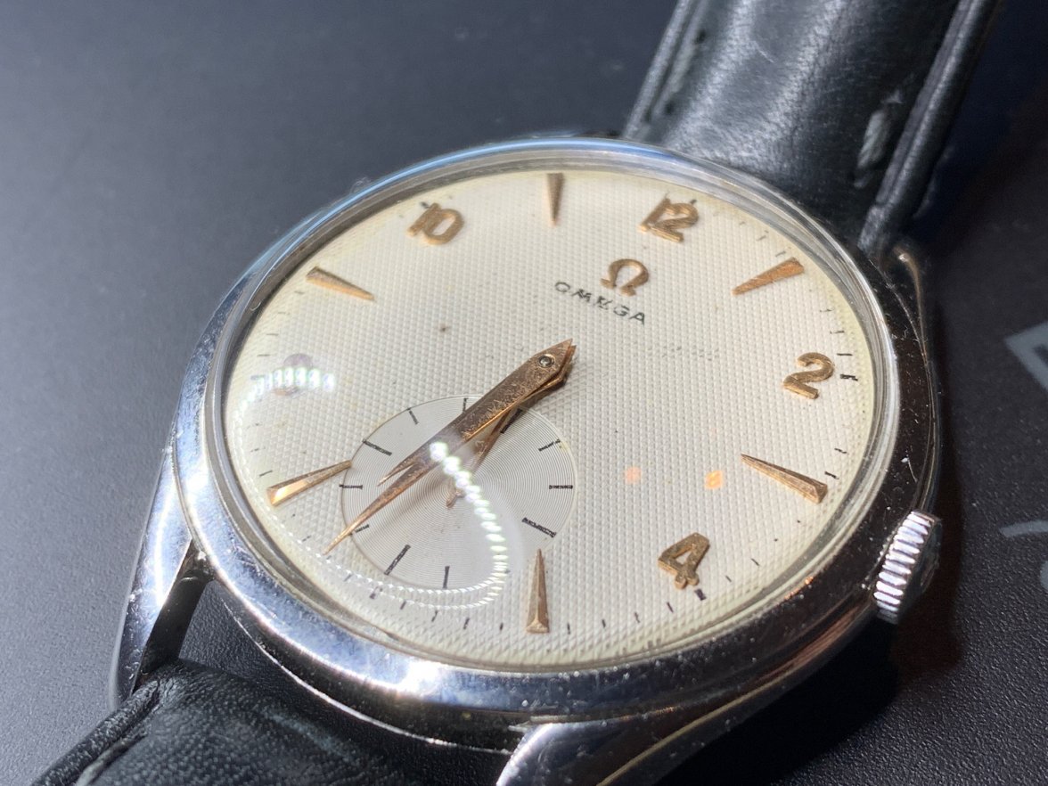

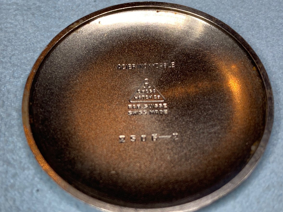

I am pretty sure that the case back is not correct. Would anybody know the correct case back number? Also, does the crown look correct to you? The Omega lettering is a bit faded and appears to be slightly to the left. But under another angle it looks original again.

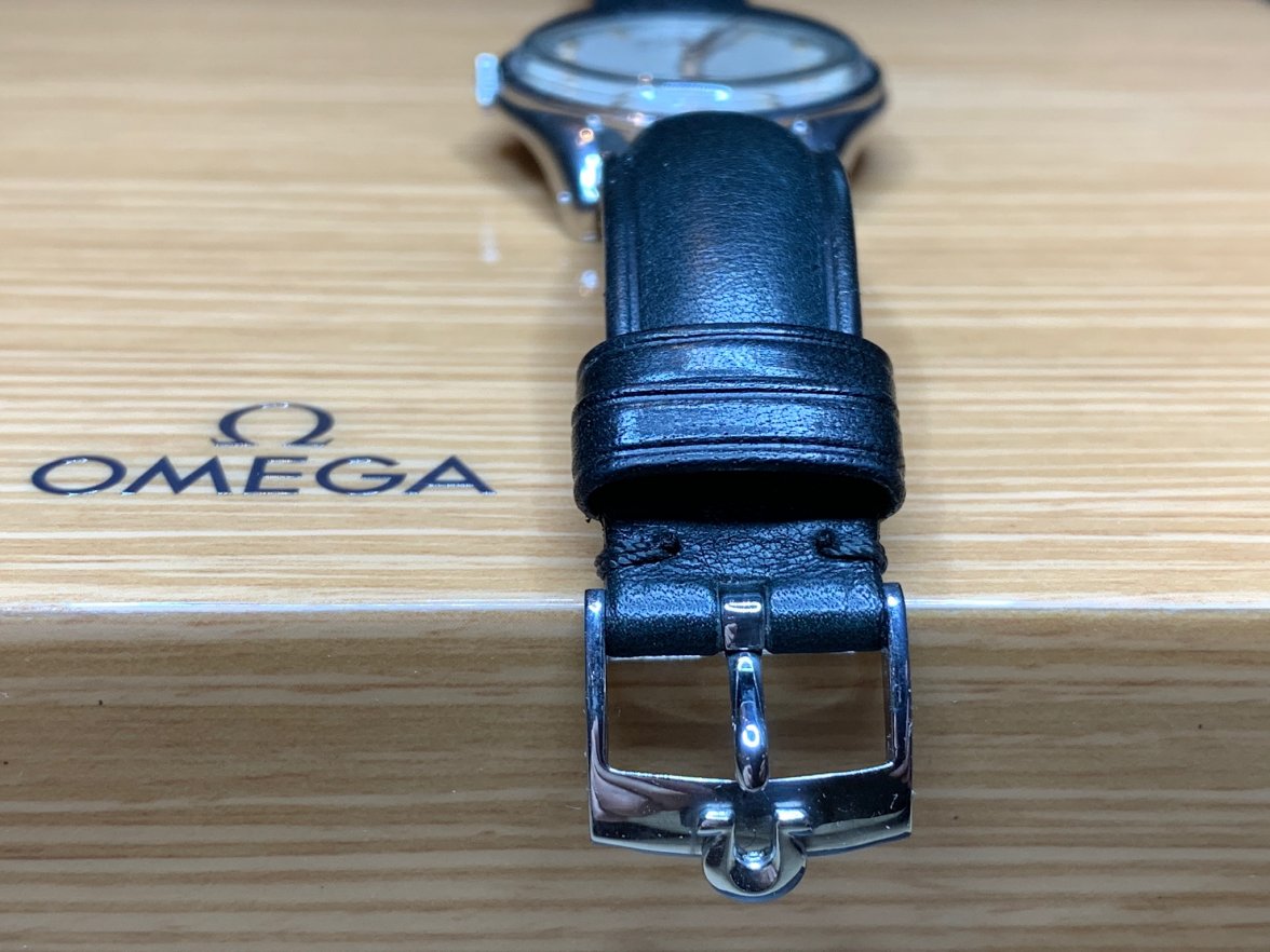

I have it on a temp strap with a wrong buckle.

Hmm is the Omega logo off center? 🙁

Refinished dial. Off-center OMEGA as well as sub-seconds bleed.
Gold figures in a steel case are quite common.
Ref 2505 - sub-seconds, 2506 - center seconds.

Thanks, spent time on taking the pictures but not yet on looking at it!
