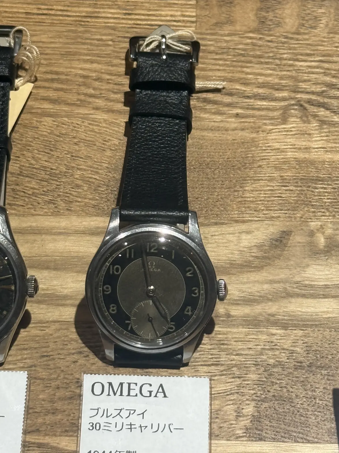

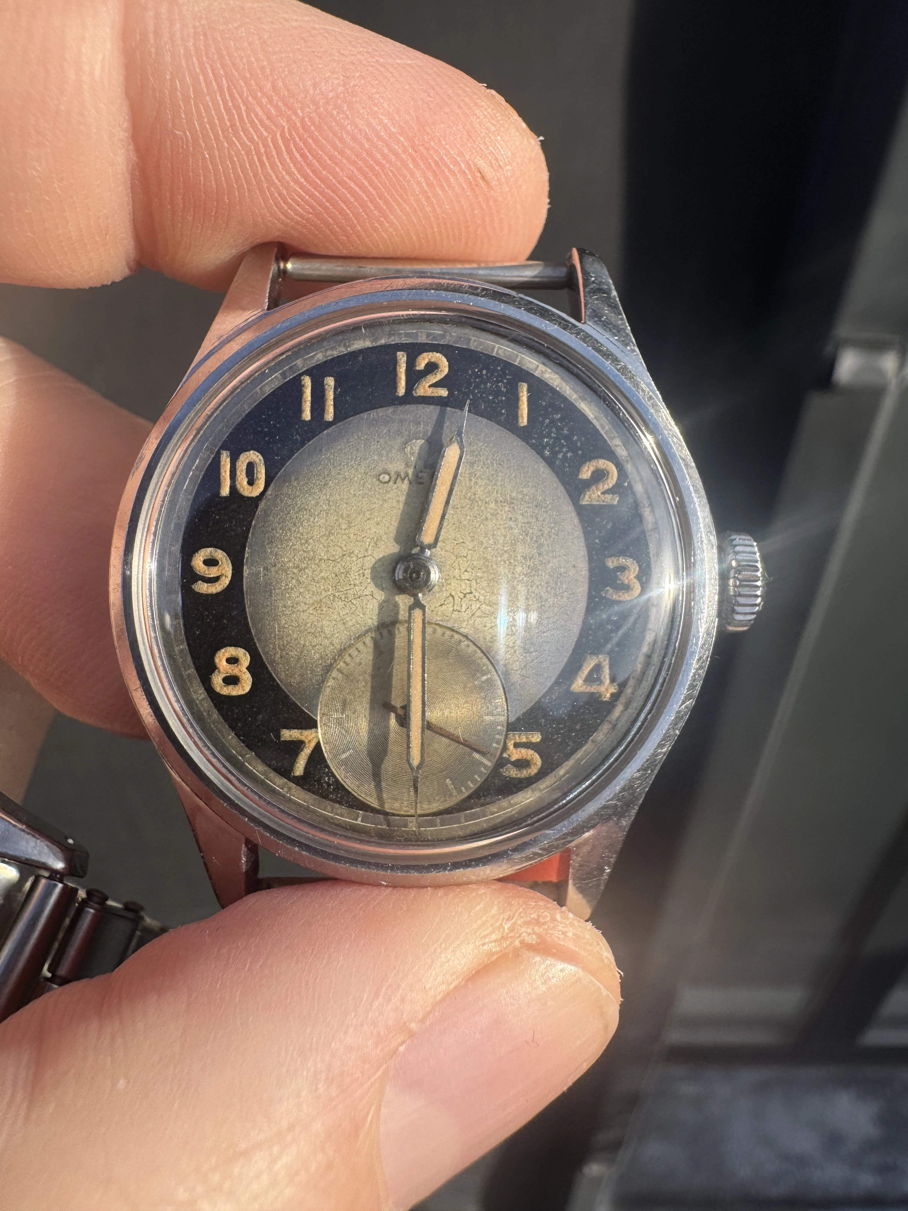

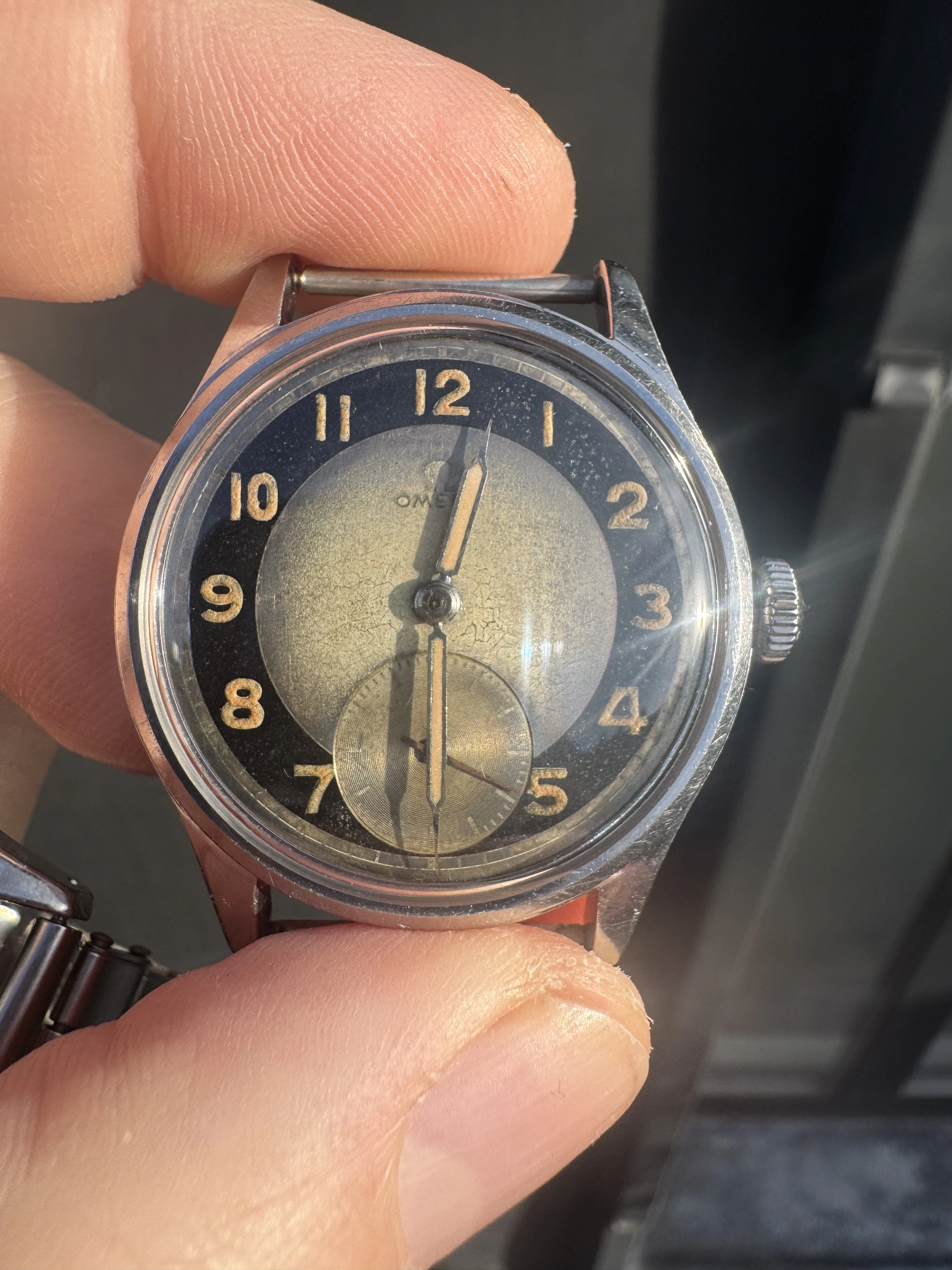

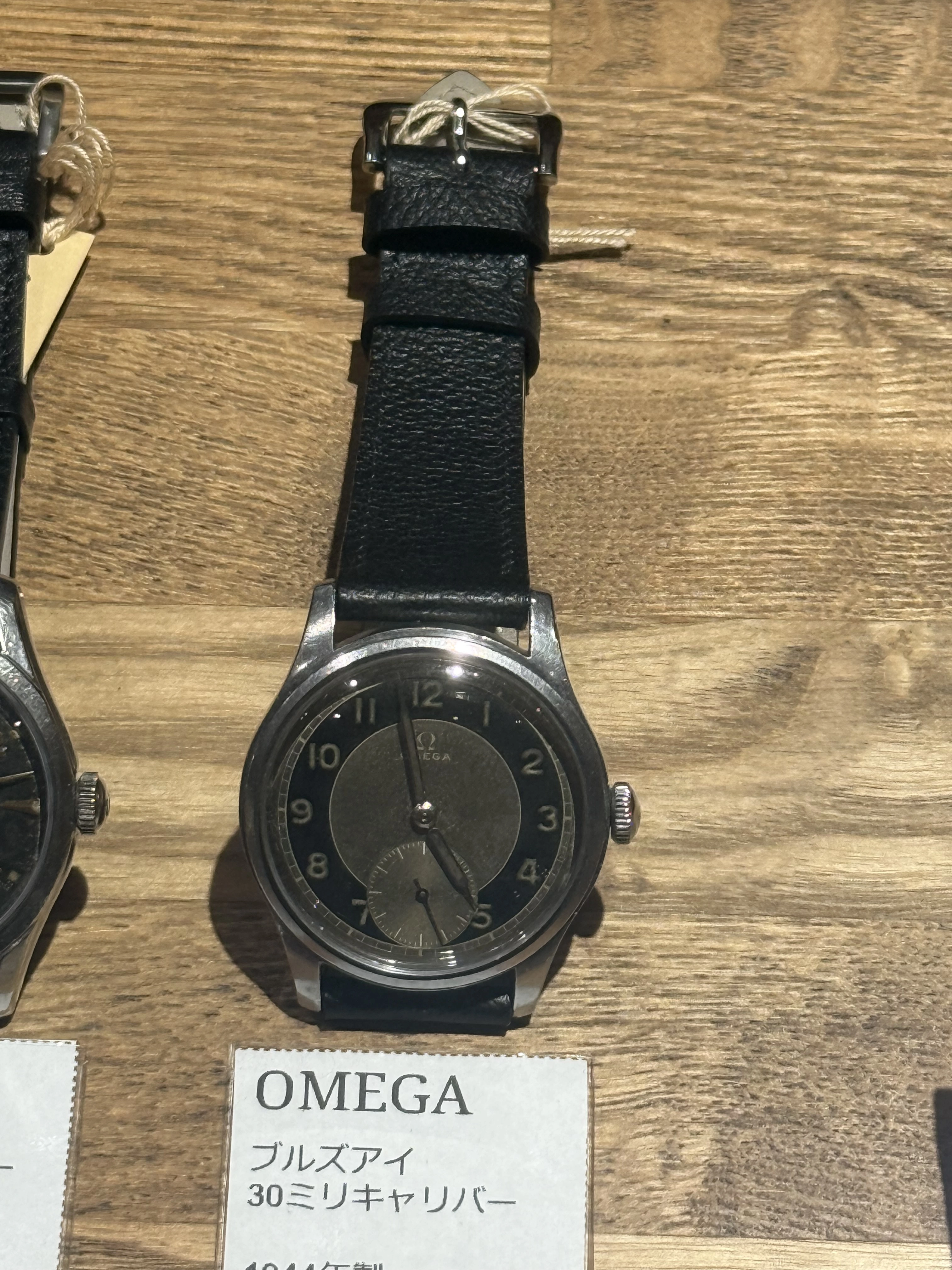

1944 Omega Suveran 30T2 in Japan: Overpriced at 1900?
5
Good looking dial and case, but asking about $1900USD. No papers or original box.

What are your thoughts?
Have you compared to other examples?
Do you have any more pictures?
It’s hard for people to assess a watch from one photo and little information.

I mean, the condition of the head is good and I haven’t seen this color combo before, but buckle/strap not original, no box or papers.
Only other examples I find in eBay are either way under this price and non-running or way over this price with original box and papers.
The lume looks decent, but no idea if it’s a redial or anything. Looking for opinions because I’m no expert. On these. Just like the way they look and don’t want to overpay.
This is the best picture I could get because I was in a bit of a hurry. It’s marked as a 1944 with 30T2 caliber.

Looks later

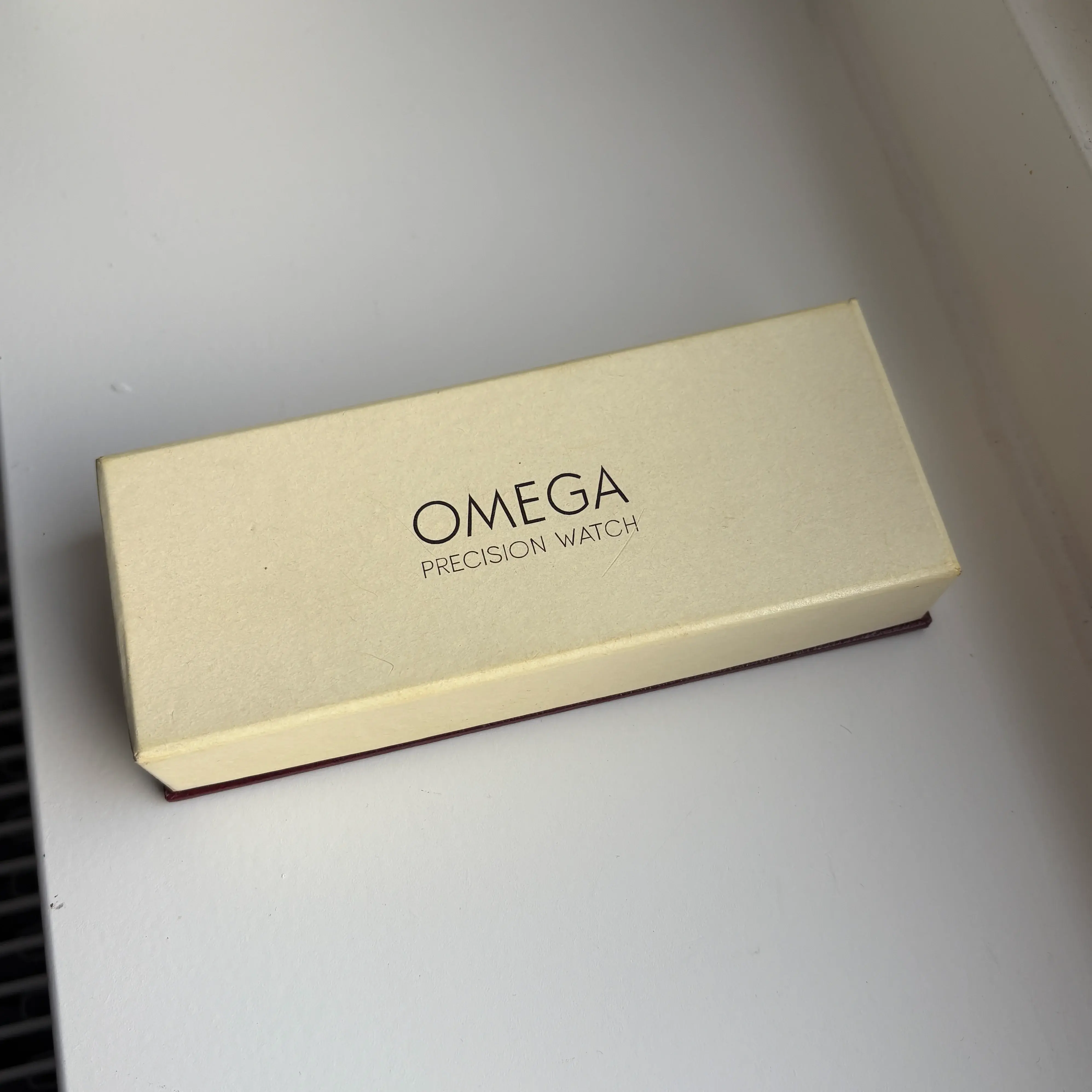

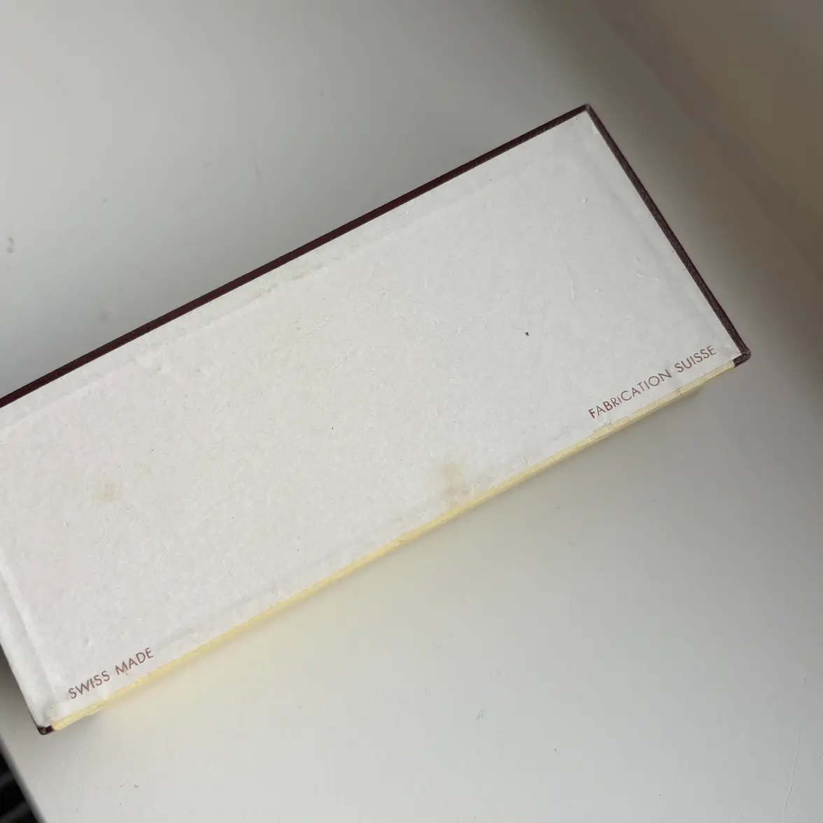

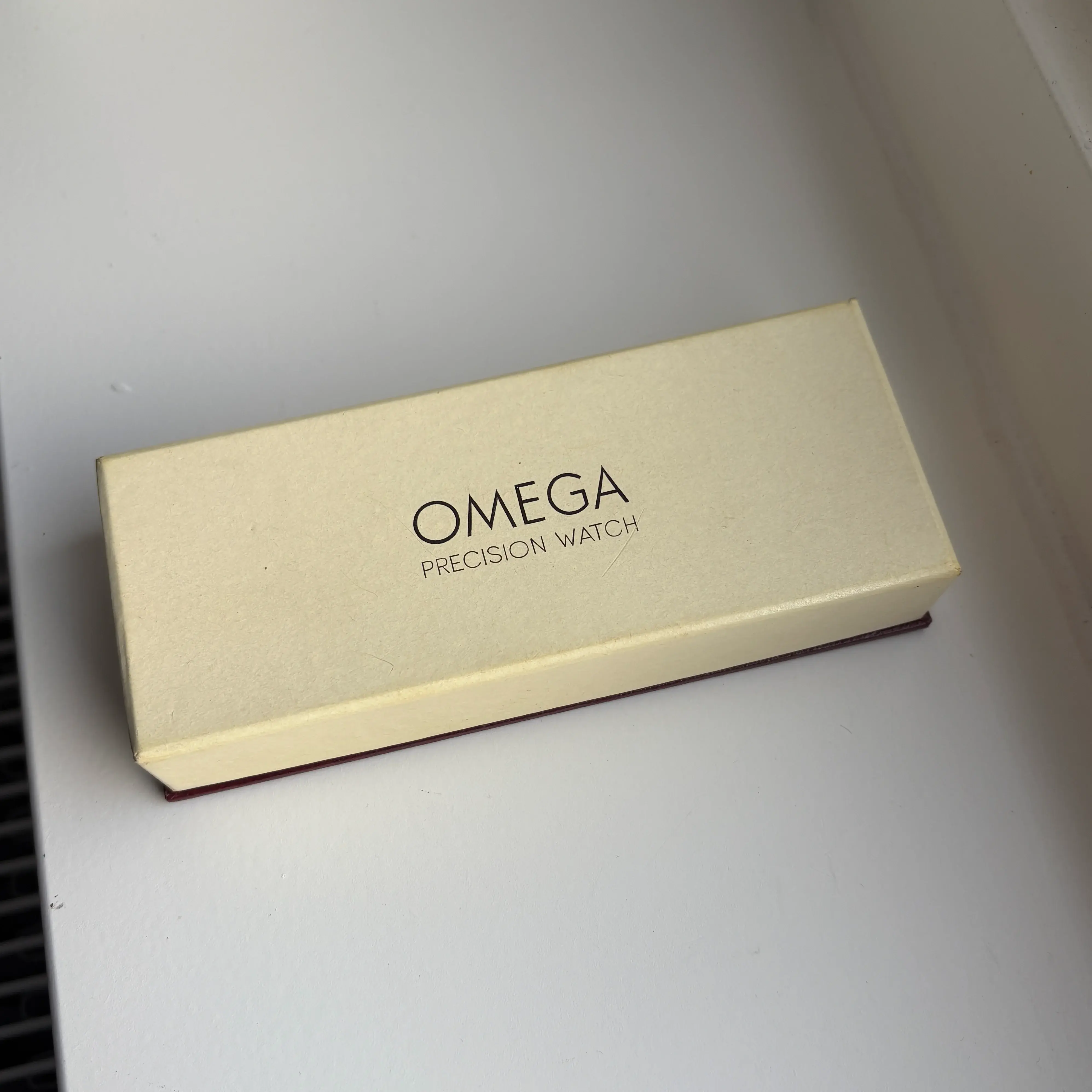

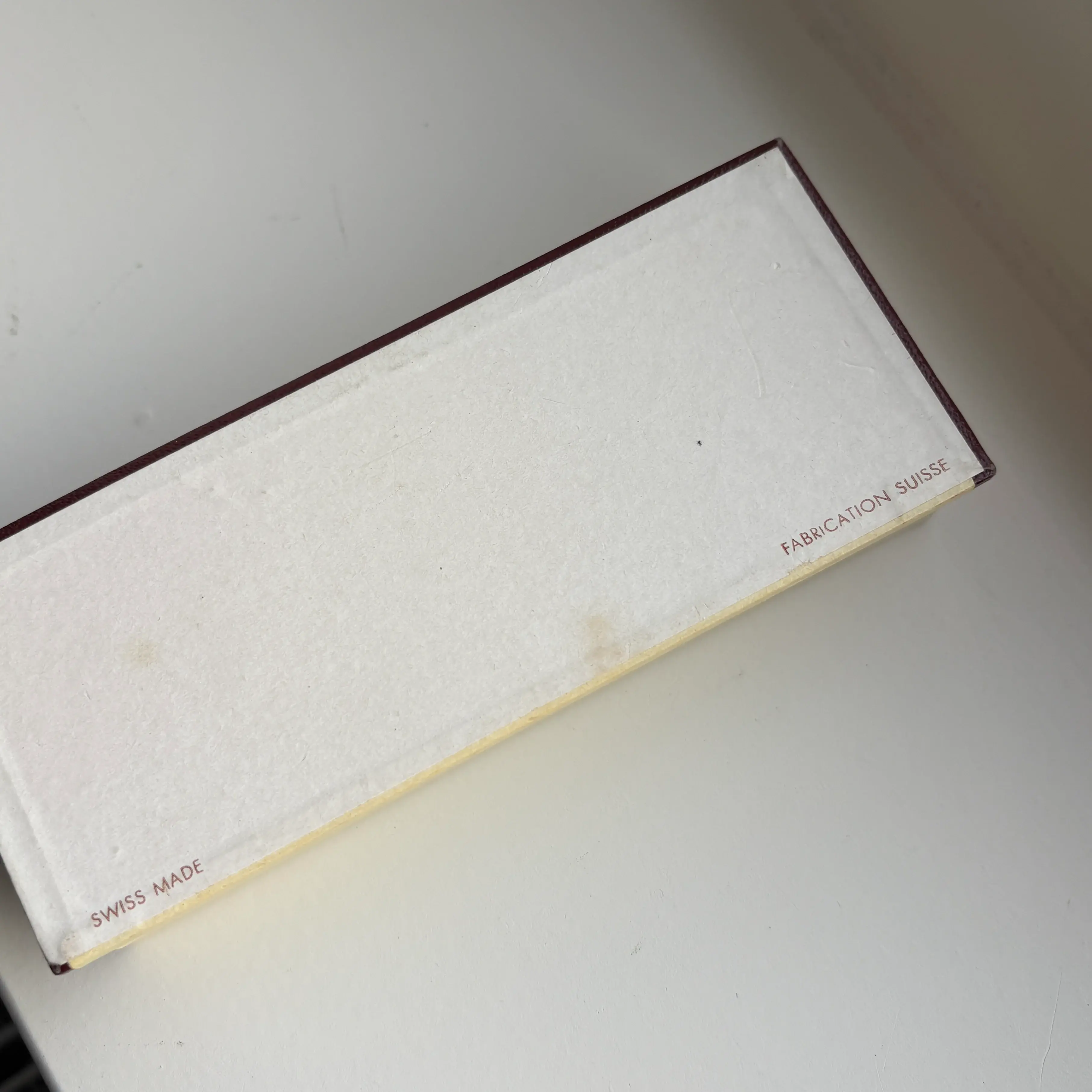

https://ebay.us/m/FnqRVl

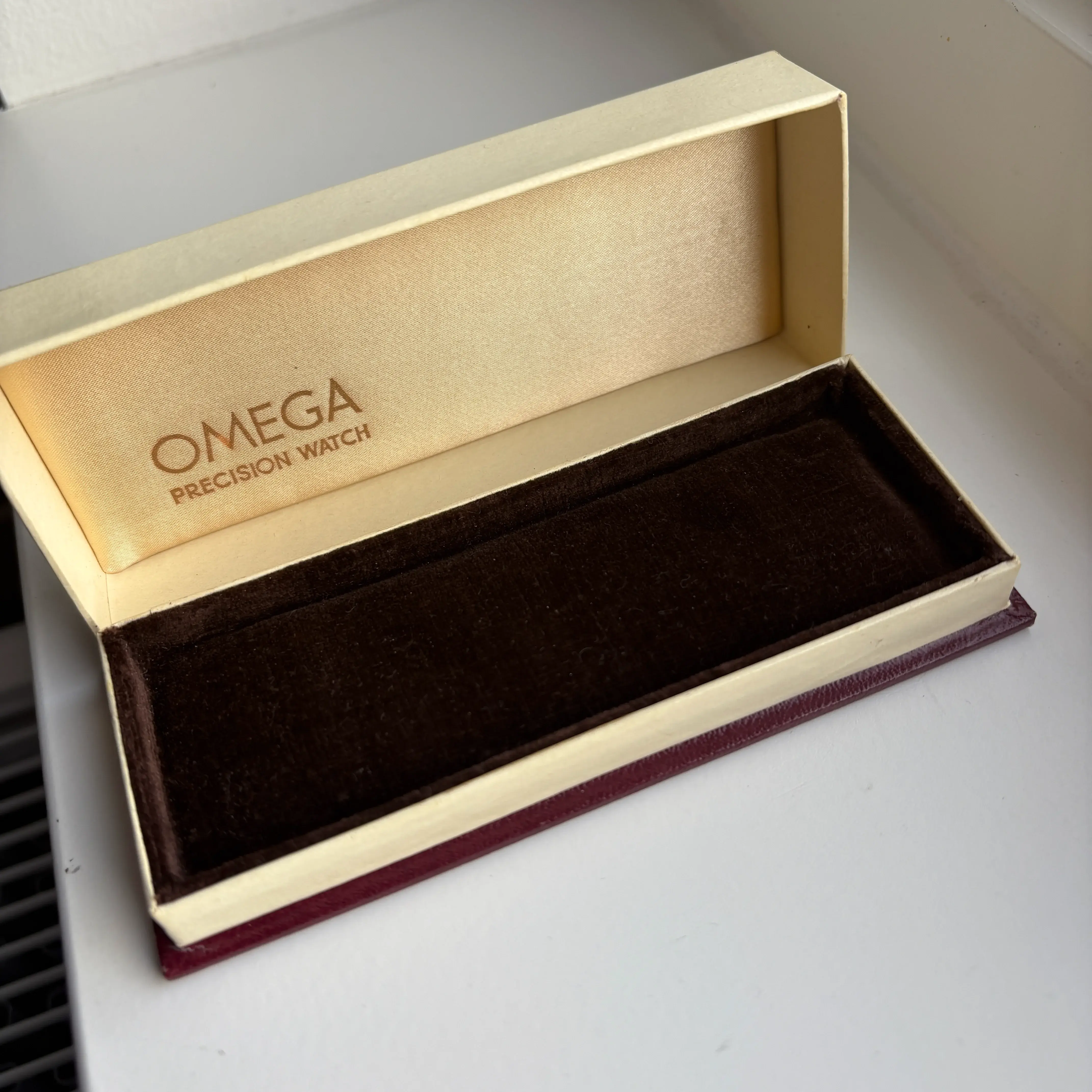

Here is one with the OG box. Beautiful example
That is not an original box or original papers, thats a later Omega box and an extract from the archives.

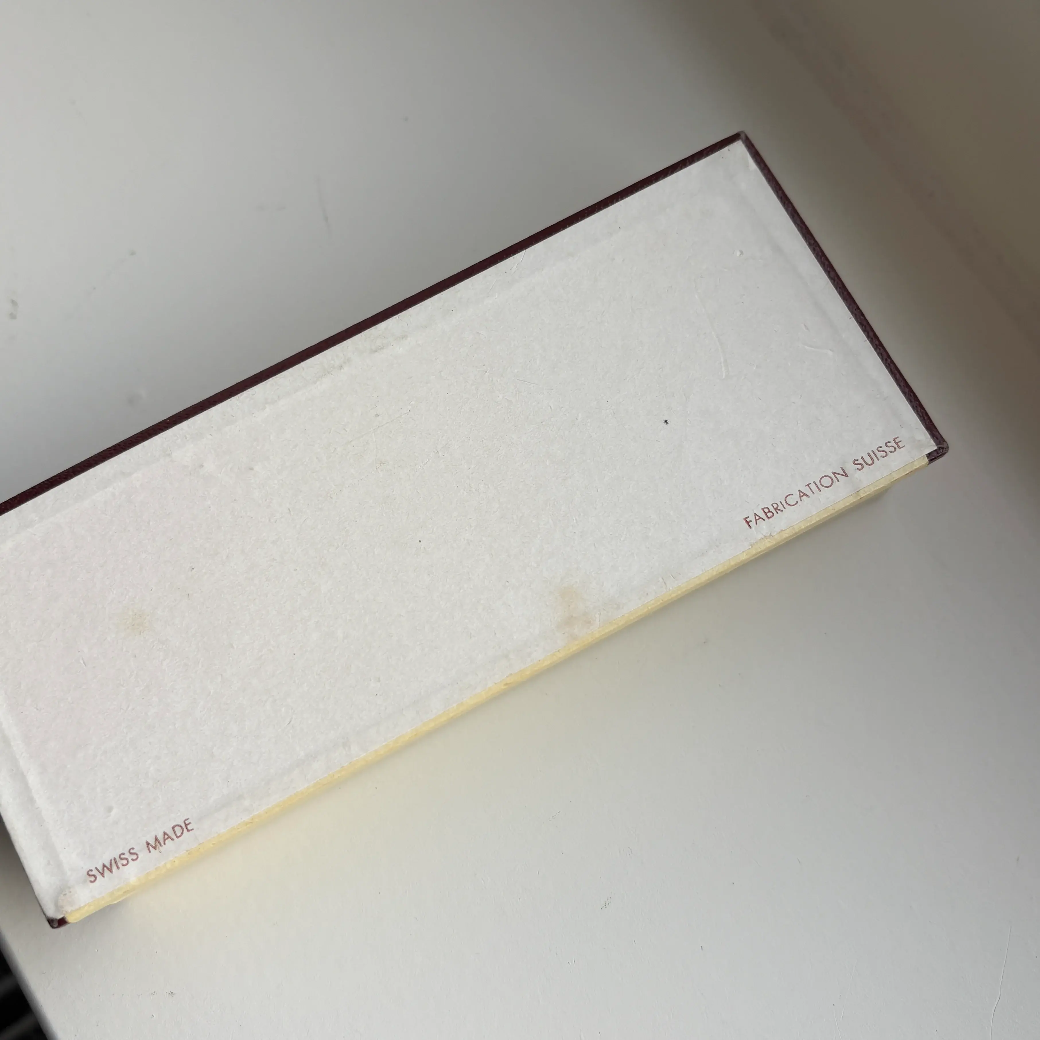

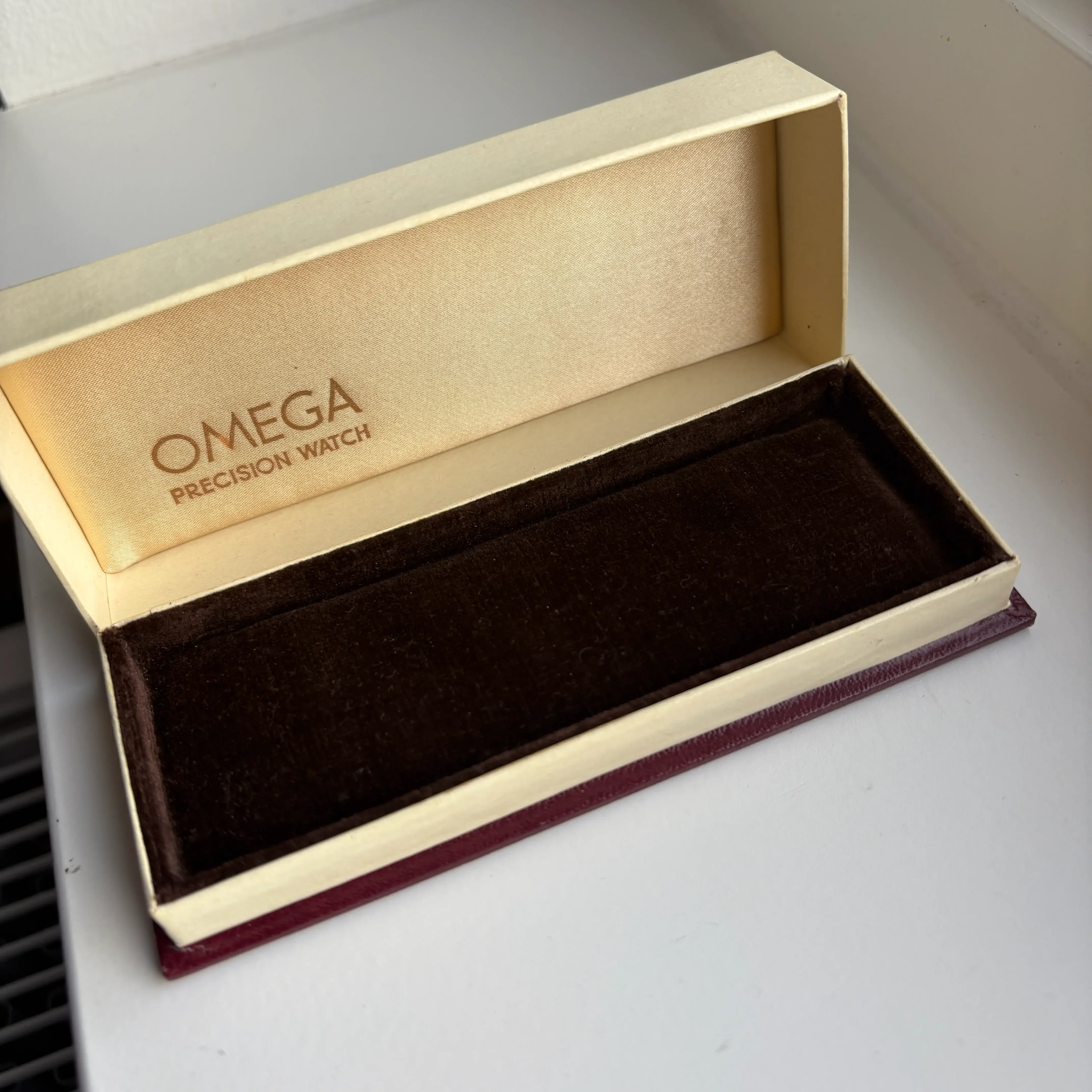

This is what the box for Suverän would have looked like, they are uncommon but out there. Original papers (the certificate) should be very very rare.

Seems to be a normal price.. None of these will ever come with a box or papers
I wouldn’t expect box and papers on a watch from the 40’s. Boxes from that era are around if you look hard enough but the papers? Good luck.
If you definitely want box and papers with your vintage watch your buying pool is going to be very limited
764
1,088
Case looks quite sharp, dial and hands are not very attractive…On auction, the watch would make about a third of the asking price max

I was thinking the dial is possibly refurbished or something too. I would expect more patina or uneven wear but this looks very even to me.

I don't think you are looking closely enough at the photo. The dial definitely shows its age, and the radium lume is almost blackened. But I don't think it's totally unappealing.
If you really like it, you should buy it. The watch is legit, and not everyone wants to wait patiently for a bargain.
5
I’m not even worried about a bargain so much as I just don’t want to get ripped off. Don’t want to spend almost $2k if the general consensus is it’s only worth $800. I’ll take another look at it in a few days if it’s still there.

Buying from a retail store in Japan is almost always going to be a ripoff, by definition. But you get the peace of mind of buying from a brick and mortar store, and probably some sort of warranty and return policy. Finding a good watch for a fair price takes a lot of effort and education, and it's not for everyone. Some people say that they don't mind spending some extra money instead of putting in that effort and time.
The best way to educate yourself about market value is to search for actual sales prices on eBay, forum listings, auctions, etc. and keep track in a document. Also, note condition issues and special features so you can understand valuations for comps. After a while, you'll have a good sense of the market. But obviously that's a lot of work, and you might not enjoy it. For some of us it's fun, and part of what we enjoy about the hobby.
Whilst those are indeed "boxes and papers" in the literal sense, they do not make these watches "full sets". They may somewhat improve the user experience as a gift, but the reality is the box is not original to that watch, and the papers are not either, though they do somewhat add to its provenance. The watch overall is okay, nothing special, and the price is at around 2x higher than I would expect would be a fair valuation.
The correct boxes as shown by @hejsam can be purchased, and regularly come up on ebay for around the £50-100 mark. They do not hold a great deal of value, and they do not really increase the value of the watch, though, they are nice to have for the sake of completeness.
I've never seen an original set of papers for a 1940s Omega, not in real life anyway - I have one for one of my 1950s Omegas, but the real original papers are so rare that, that would indeed add a premium to the price, especially if the correct box is also present.
I disagree, I think that is underestimating their value, they often reach £1000+ on ebay which is $1350 plus, so for a dealer price at $1900 I think its reasonable - and I'm sure they'd be prepared to haggle a little. Now I personally wouldn't buy it because I prefer creamy lume, and this is limiting the value of this example, as creamy lume sells, grey/green lume does not.
Looking through my records, I had a lovely one in great condition with creamy lume that I sold in 2021 within days of posting, and I got £1500 for it then. This one you show here is not as nice in my opinion, but the price is similar, and that is a retail store not a private seller like me.
Suveran's because they have a 'identifiable' name automatically increases their desirability and value as they're easy to find, if you'd prefer to spend a little less you can get many other 30T2 movement Omegas from that era for 1/2 to 1/3 of that cost in very good condition. I sell them periodically as my collection rotates.

@direSquirrel ^ this is the key advice. For something like this, revisit the store and handle/try it on. Can't do that on ebay.
We all have a couple watches where we didn't pull the trigger and we later realize "i would have liked to own that" every time we see one.

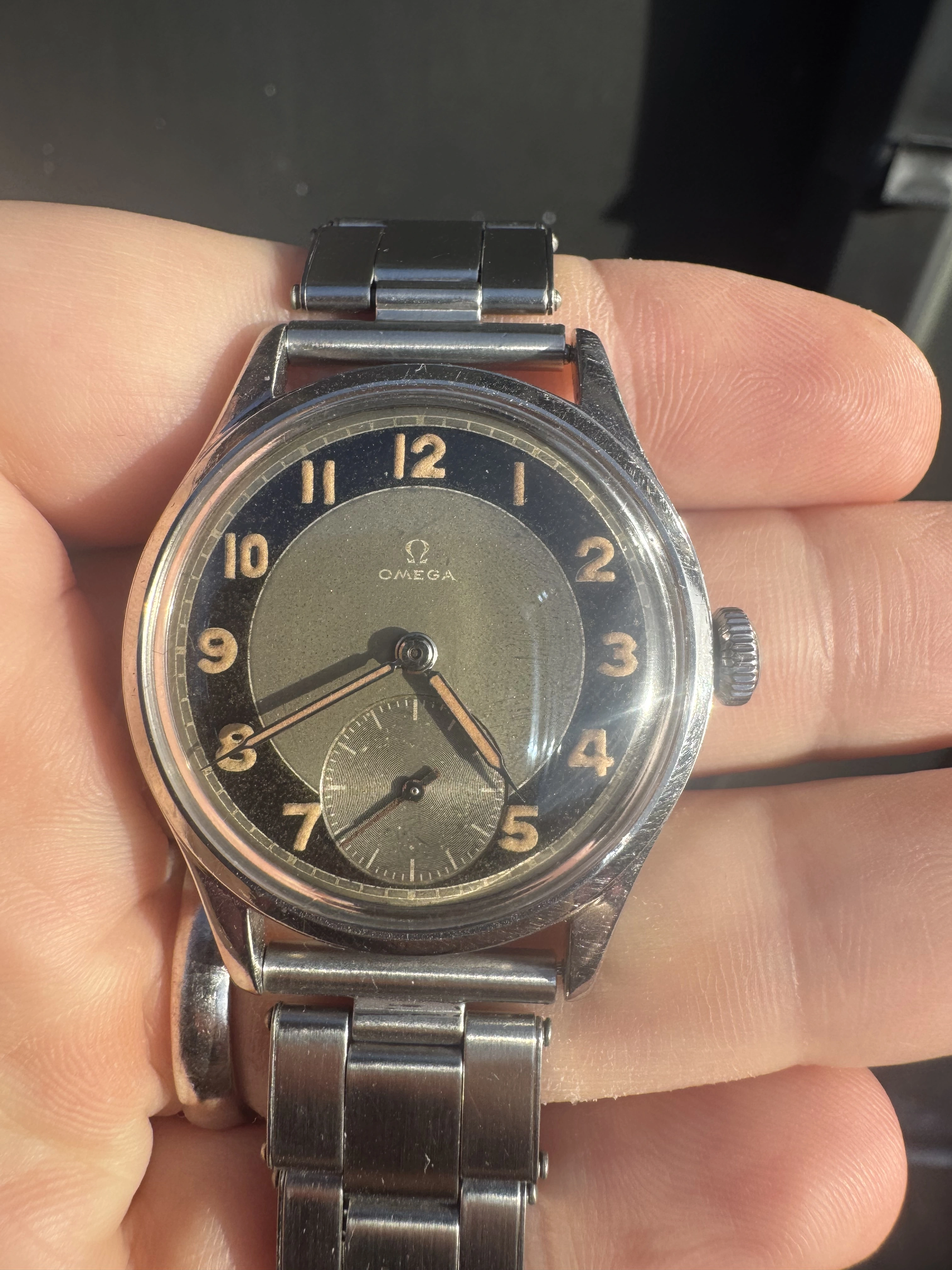

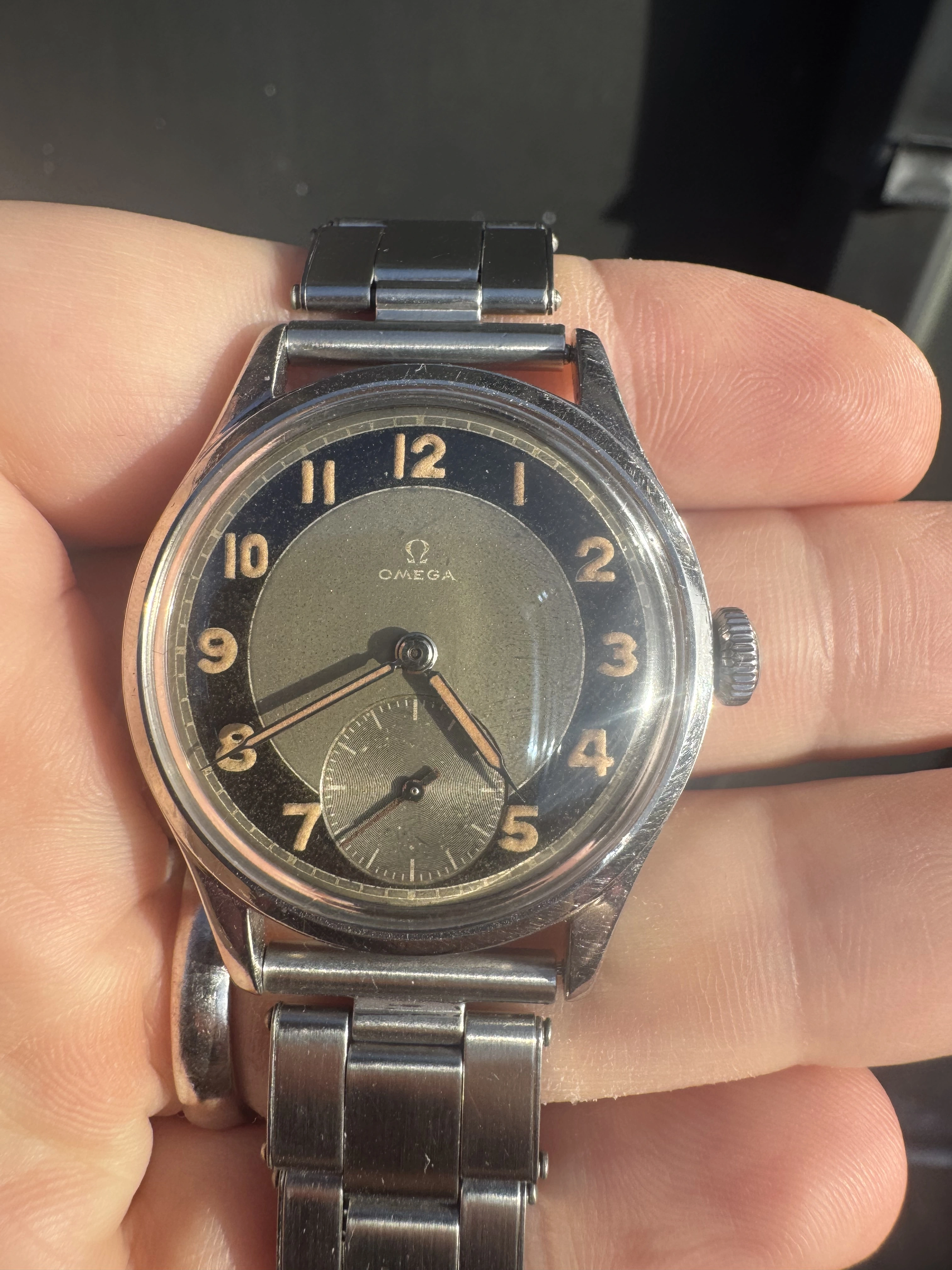

By the way, a little sun this morning to gake pictures of what this setup looks like in good condition :
And with an amazing patina :
