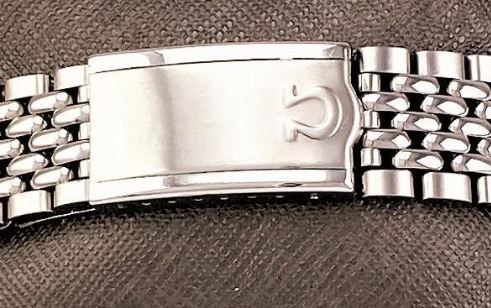

Prefacing this with the fact that I am new to this, trying to learn, and you guys and gals have the knowledge.

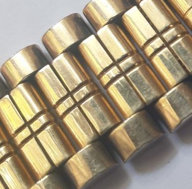

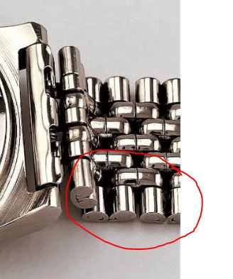

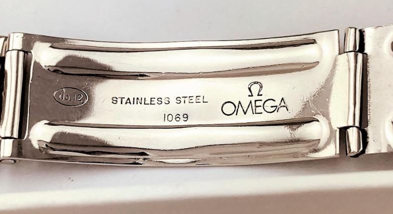

I ran across a watch/bracelet for sale ad and I have a question about the bracelet. The seller lists the bracelet as original Omega. The bracelet is a BoR and the clasp is stamped 1069. From what I have found, a 1069 is not a BoR. I have included a cropped section from a borrowed picture of a 1069. Also, the link sides of the bracelet are open, where you can see the pin and the rolled edges. The pictures I have seen of authentic Omega BoR's have finished, flat sides. I cropped some photos from the ad so not to openly expose the seller. It is very possible I am wrong and do not want to cause any grief.
1069 Bracelet
Bracelet in question.

The short answer is the BOR you have found is not genuine. A genuine Omega BOR should indeed have solid links on the sides. Someone has grafted the clasp assembly on to a non Omega bracelet. Also the end links are incorrect.
Thanks for confirming. Learning as I go.

Those repros with the folded links are indeed very common. I have a BoR that I had in use for almost a year before I noticed one of it's links was one of those replacements. From the top, it's impossible to tell.
