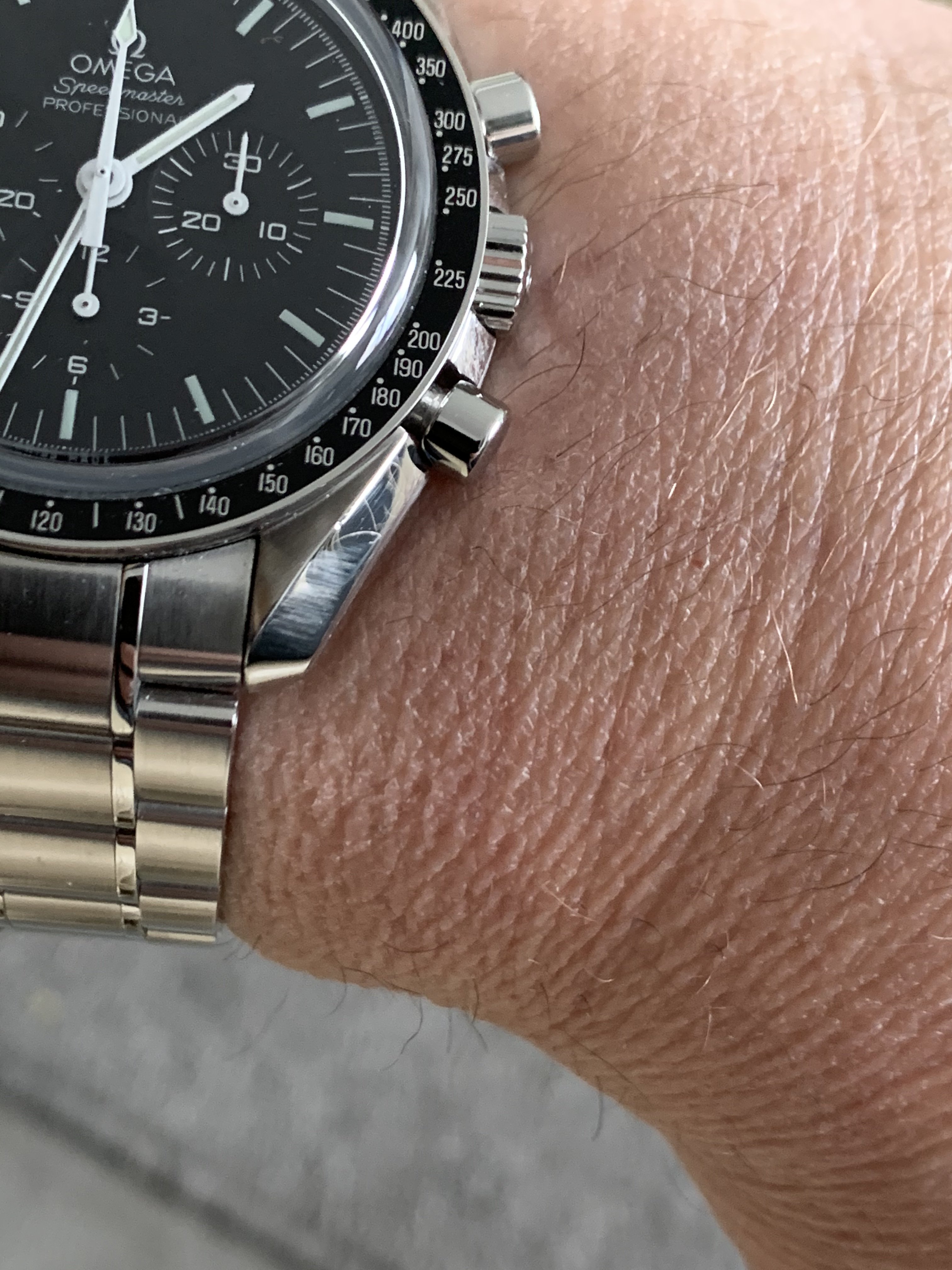

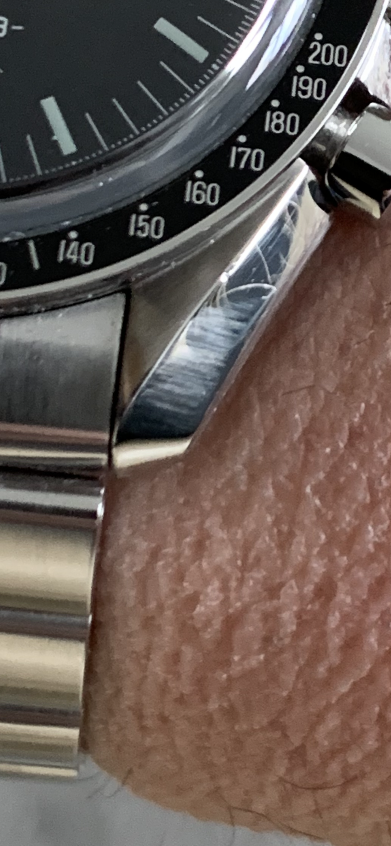

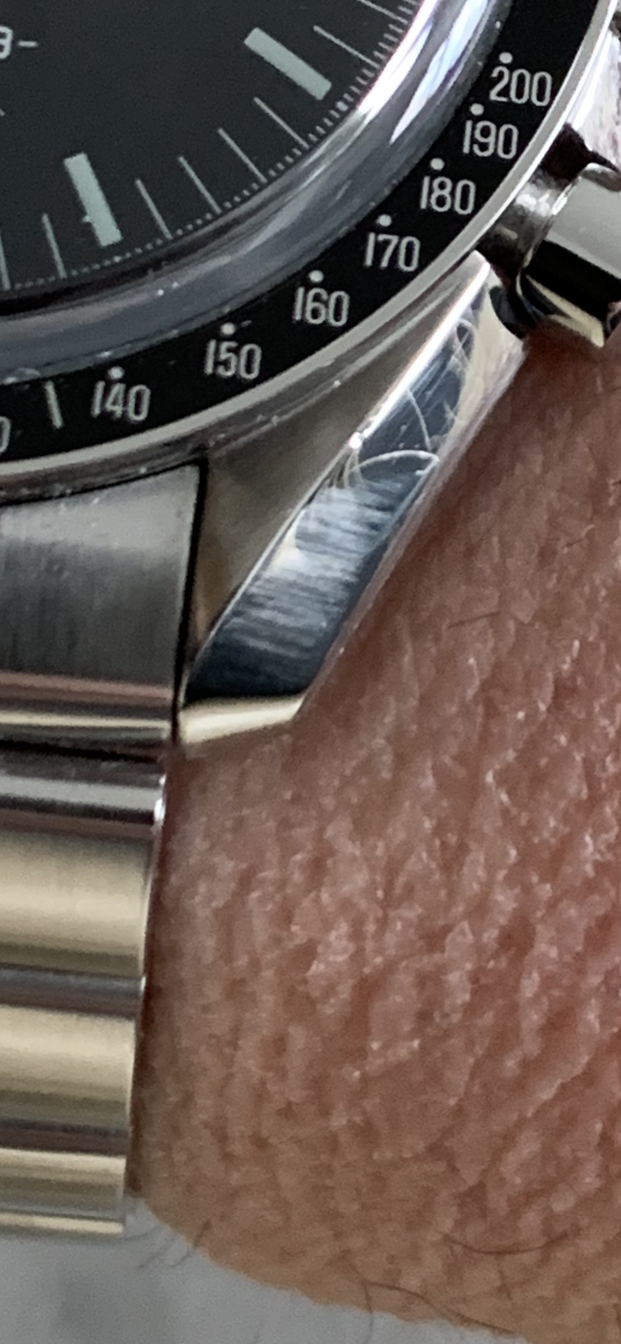

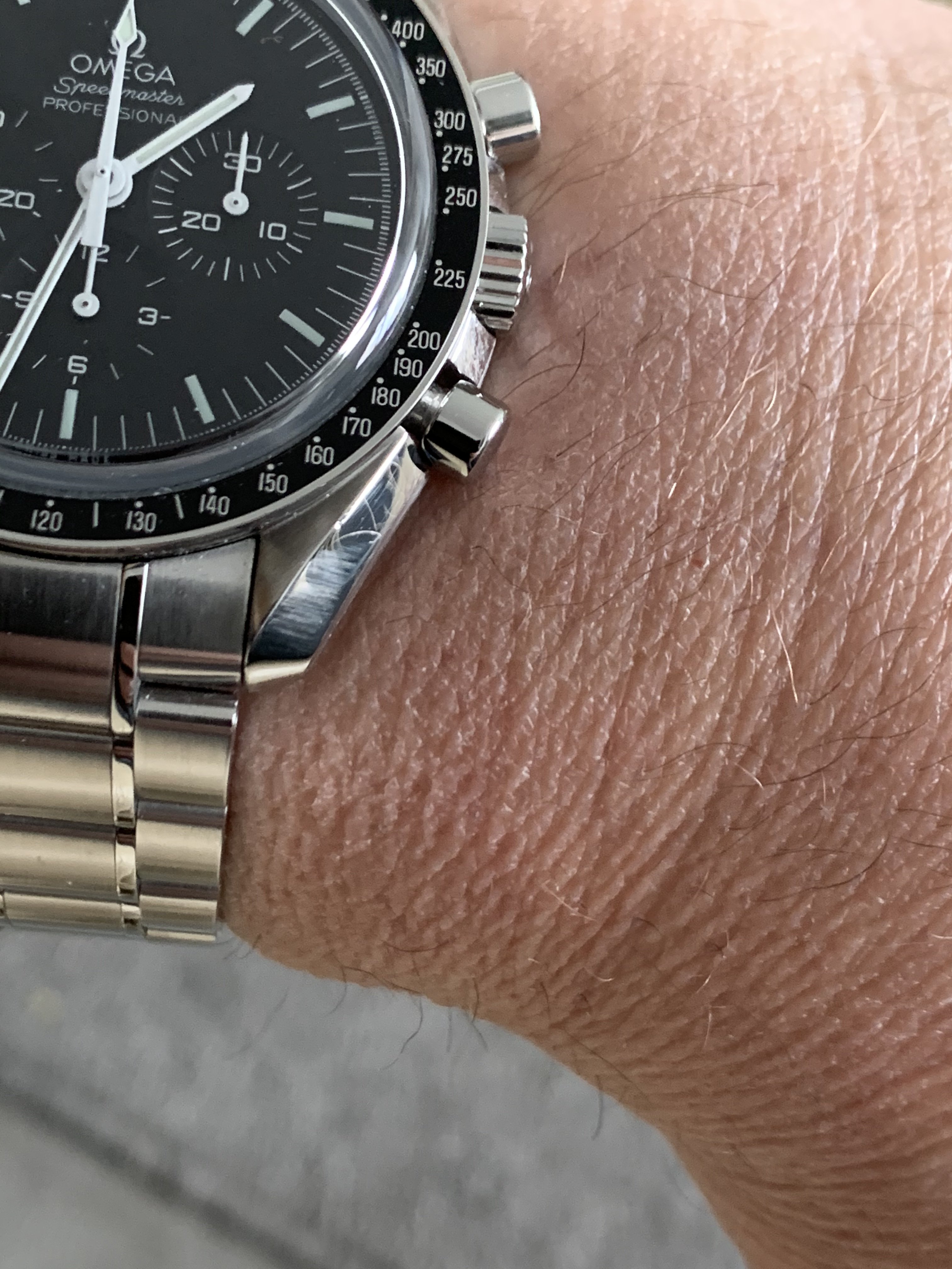

Morning All(from dull Dorset,UK),
I’ve recently bought a Speedy Sapphire sandwich which I love but in certain lights all 4 corner smooth polished(not brushed) shoulders have buffer marks showing as if it’s had a hasty polish and not buffed properly!!! I wonder what you’d suggest to Polish/remove the buffing marks as it’s annoying me!!!
I’ve tried Hagerty stainless steel cloth and it’s shiny but still there.

You should be able to fix that with with a hand polish. Just be patient and try to avoid rounding the edges.

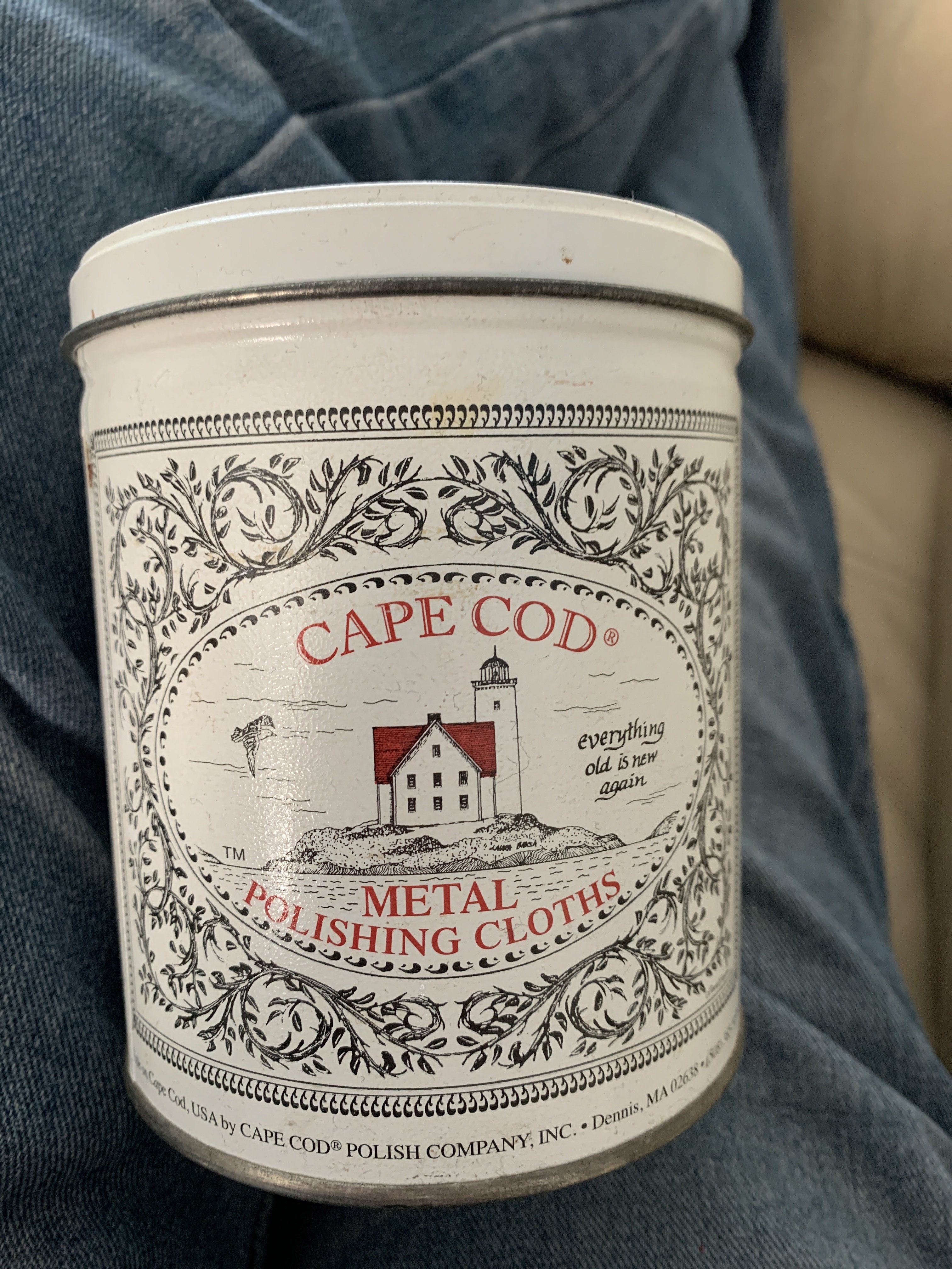

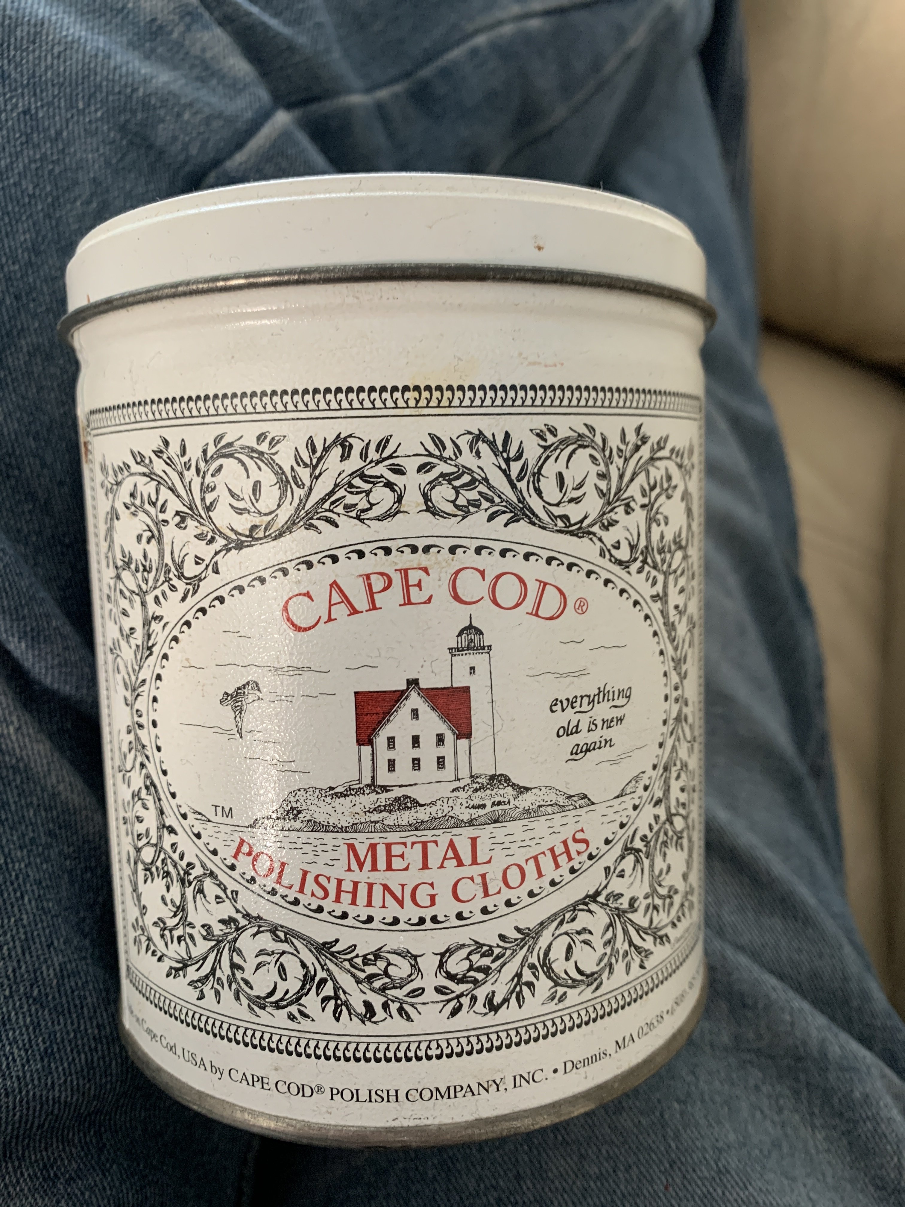

Some cape cod should do the job. You can find them for under 10$€£ and they last quite a while

Yeah, those are a bit rough, as above, Cape Cod cloths (available on Amazon), are your friend, you can apply with a cotton bud for a bit more control.
Bear in mind that it will still have micro scratches, but should remove that marring

I’ve got a tin so I’ll give it a go, it won’t ruin the finish will it?

I know there are a lot of fans of Cape Cod cloths, but I'm not one of them. For these scratches, I'd start with Simichrome, which should remove the scratches and leave a hazy near-mirror finish, then use Mother's Mag to remove the haze and get a mirror polish. Both available at auto stores.

Change of plan now as the Dealer I purchased from has agreed to get it done professionally by Omega(Southampton), at his cost!! Sorted

Tape off the brushed parts! An of these polishes will make the brushing shiny.

I would suggest taking the watch to your watchmaker. I have tried Cape Cod on one of my Speedmasters and the supplied cloth leaves microscratches after application. Pretty sure any decent watchmaker can do a better job with suitable tools.
