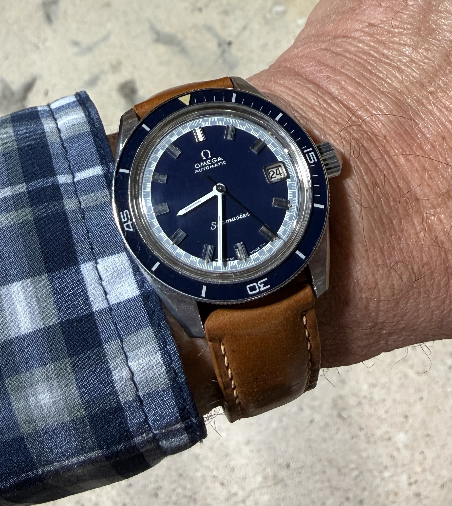

So my restoration WAS nearly complete. I sourced a new crystal on eBay along with an NOS big crown and a donor 565 caliber movement which needed only a new balance and 2nd wheel. I also found the appropriate case back on eBay and the hands from Ofrei. Fine, until I went to pick it up today.

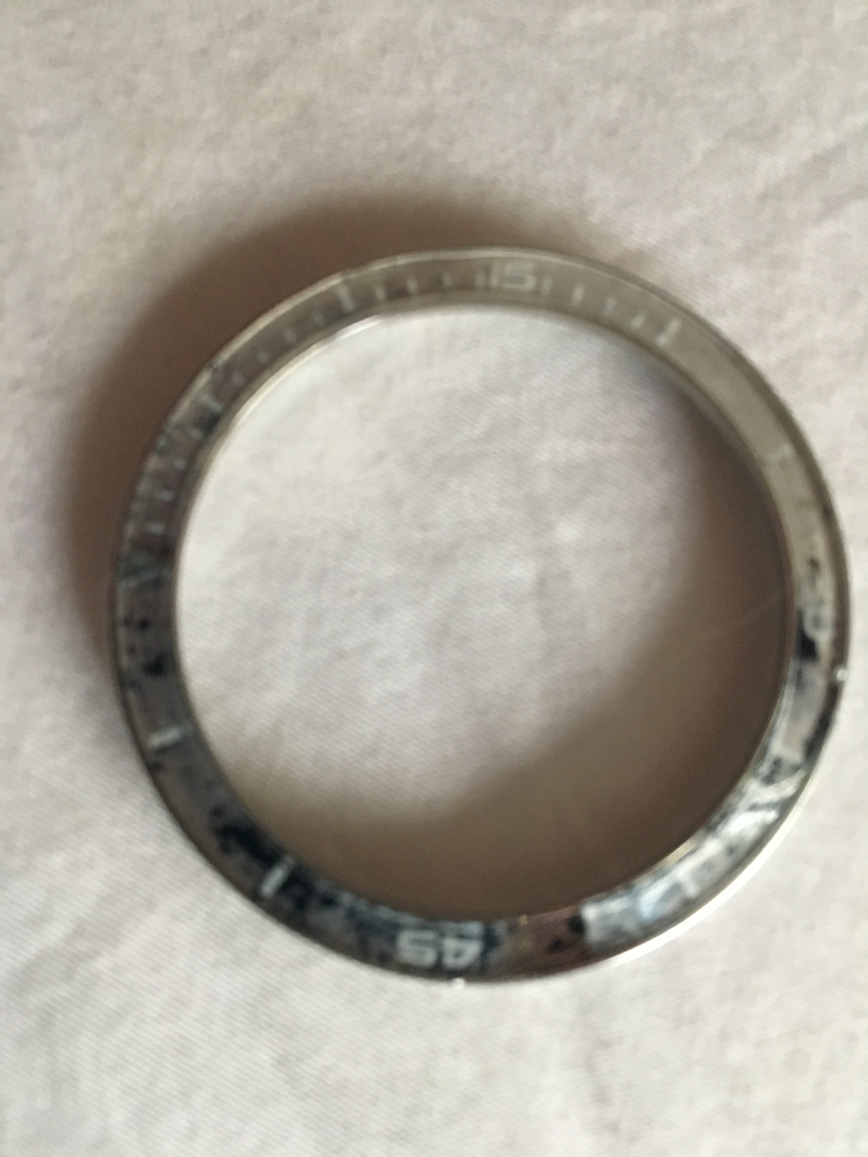

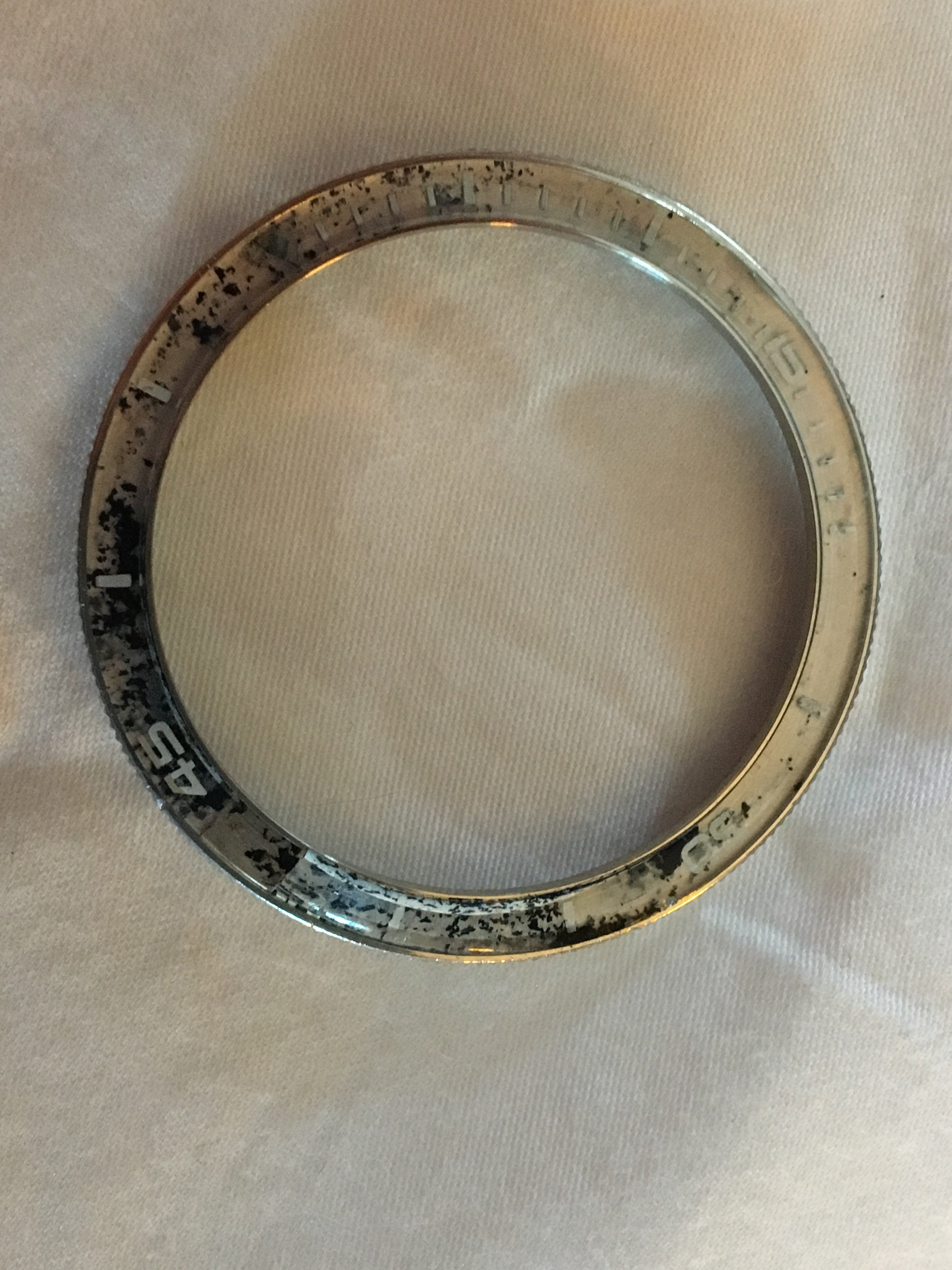

He put the Bakelite bezel insert in the ultrasonic cleaner and it has come out transparent. The blue colouring has all come off and the Bakelite is now cracked and broken.
I have read that these bezel inserts are hard to find. How hard to find will determine the kind of discussion I need to have with the watchmaker.
Does anyone know where I could find a replacement bezel insert (blue) ? Did my watchmaker just ruin my restoration? I am freaking out a bit over this
If I could just find a replacement bezel insert, I am sure he would offer to pay for it. He’s a good watchmaker but I don’t think this is my fault. Mistakes happen
If he put the bezel in an ultrasonic cleaner with just water and the insert fell apart, then the insert was faulty. It would have fallen apart at some point anyway.
If he put it in an ultrasonic watch parts cleaning machine with specialist cleaning fluids (the machine and fluids we use to clean stripped movements) then anything could have happened - it is very unlikely he did this.
Unfortunately, you will probably spend a long time looking for a bezel insert but, good luck.
Do you have a picture of your watch and the bezel insert pieces? Especially the bezel pieces.
Cheers, Chris
