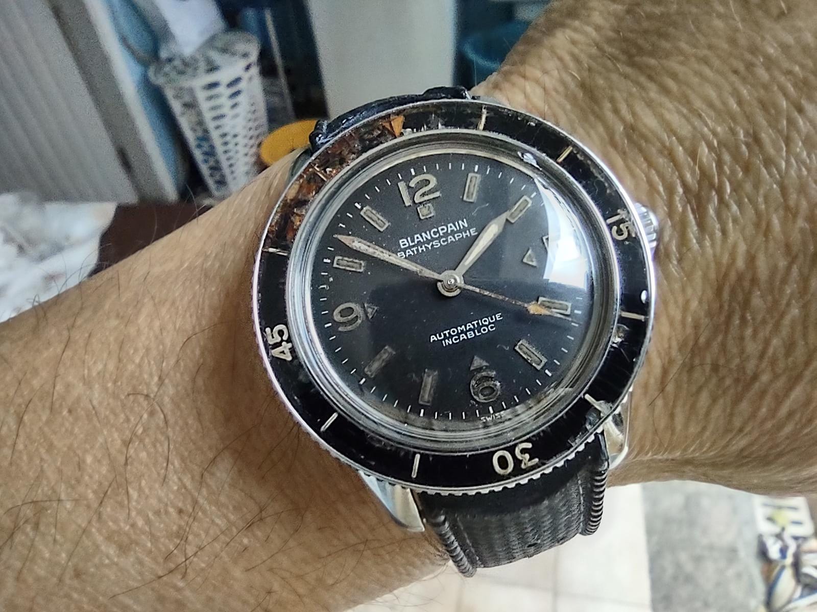

Hi Mike
thank you for your reply. I just bought this one here. I think it is a Franken watch, but since it wasn't very expensive and as I will wear it on a daily basis, I don't mind.
The hands are wrong I think and the case's lugs are not chamfered. Also, the case back is different from all the other MC4s, however it is Rayville signed. The movement is correct, but Waltham signed. I sent the pictures to Blancpain, they didn't confirm the watch to be a Franken, but want to see it physically. Perhaps you have some more observations. Thanks & regards
Pls. Add a dial picture. I'd not send it to Blancpain. There is a good chance, that your case is a complete fake and the BP inner engraving as well. Blancpain has no records left. And the old employees, who could tell, which are Originals, are mostly gone. Blancpain was bankrupt. A shell. And they are not happy to be reminded of that dark chapter; beeing a luxury company now. These Bathyscaphe versions were cheap watches then, starting with the base AS movement. Produced with the hope of getting sales up and survive. Water resistance was not as promised and that is one reason, you can not find many now. Just discarded in the past.

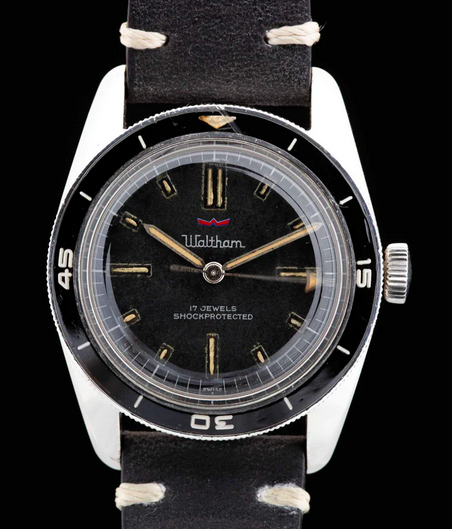

Mine is Waltham version (non Paul Newman dial). How do I check the serial number ? Is it on the movement ?

Waltham did not place the serial numbers on the caseback in the same way that Blancpain did. I don't think the serial number will be on the movement either since they were simple AS movements.

What is a " Paul Newman " dial in a Waltham? Nobody calls it that. Pls. Add a picture. Inside case back engraving as well.

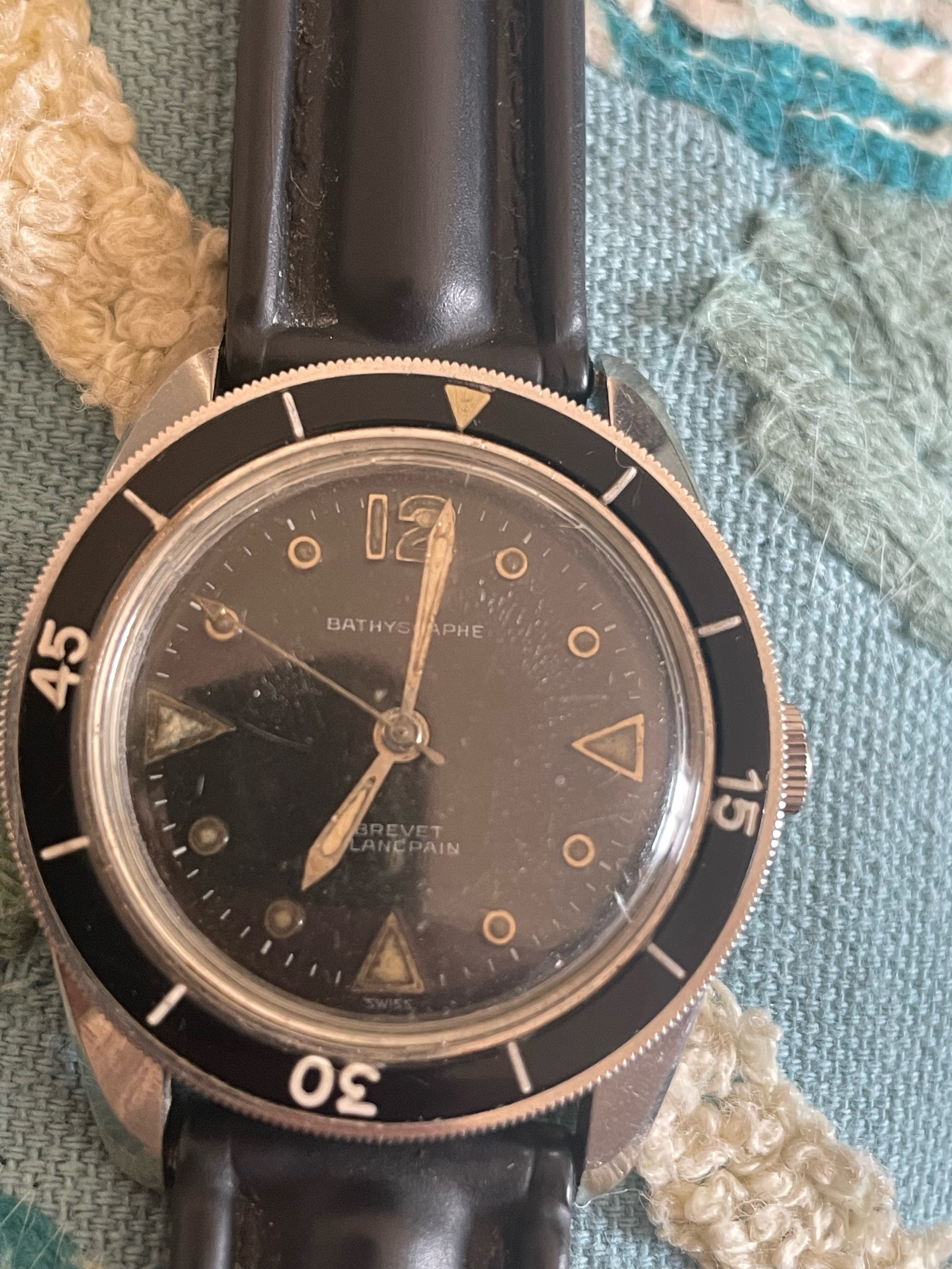

Hi, I was looking for information on this watch that I have and I found this forum. I think it's the same. Can I have more info?

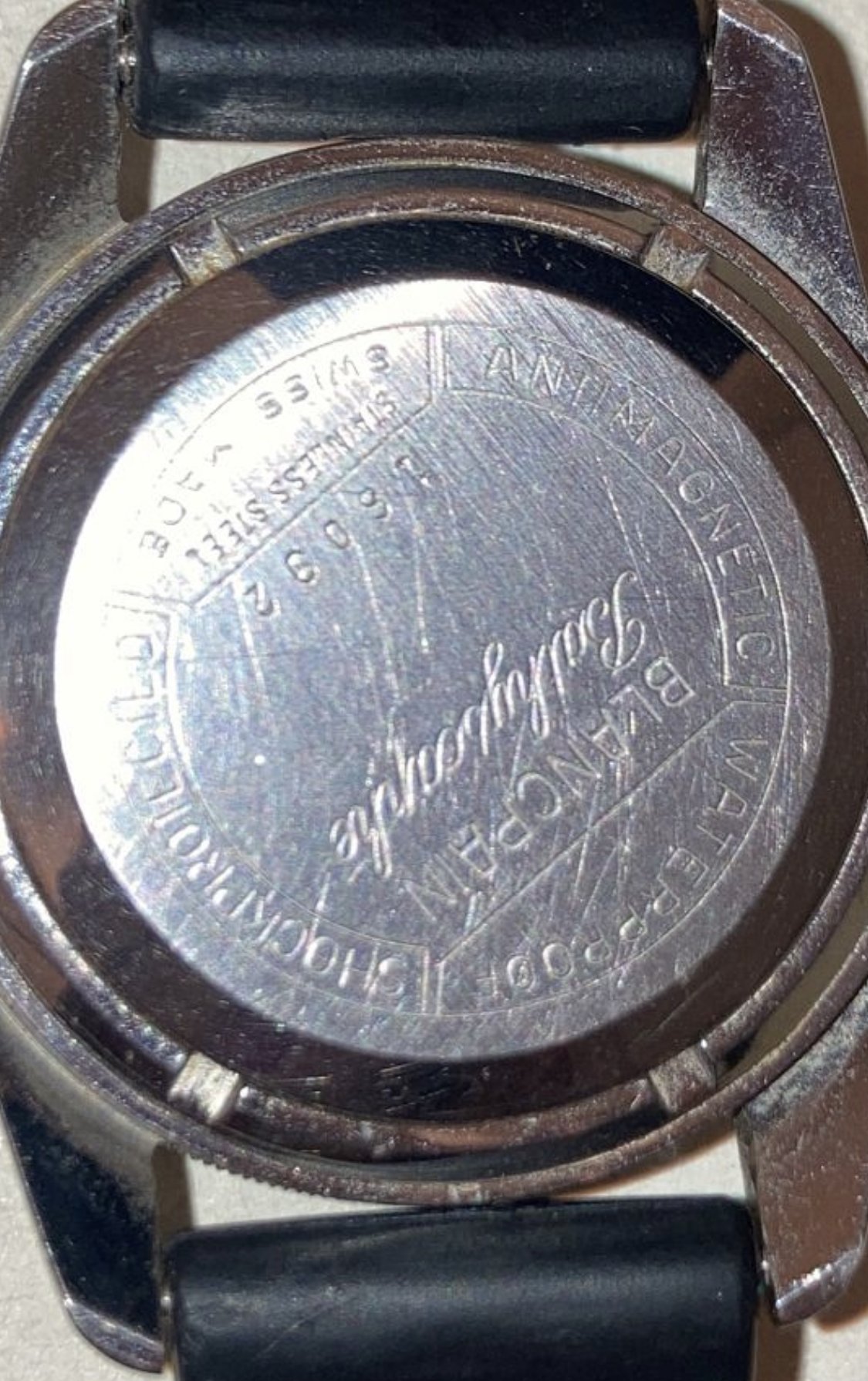

Thanks for posting. A photo of the back would be very helpful.

Nice, looks correct with the serial number falling into the range I have in my first post.
In terms of information, I'm not sure what you are looking for. All the information is in the first post of this thread including history, movement, and other examples.

thanks just a little information, which I will now read carefully. It's a watch I knew nothing about and even online you can't find much. it belonged to my father and is now in my possession and I wanted to reconstruct its history.

I agree, there was very little online about these. I think that due to their use for swimming, not many survived. With your watch, my registry only has 12 examples since 2019.
