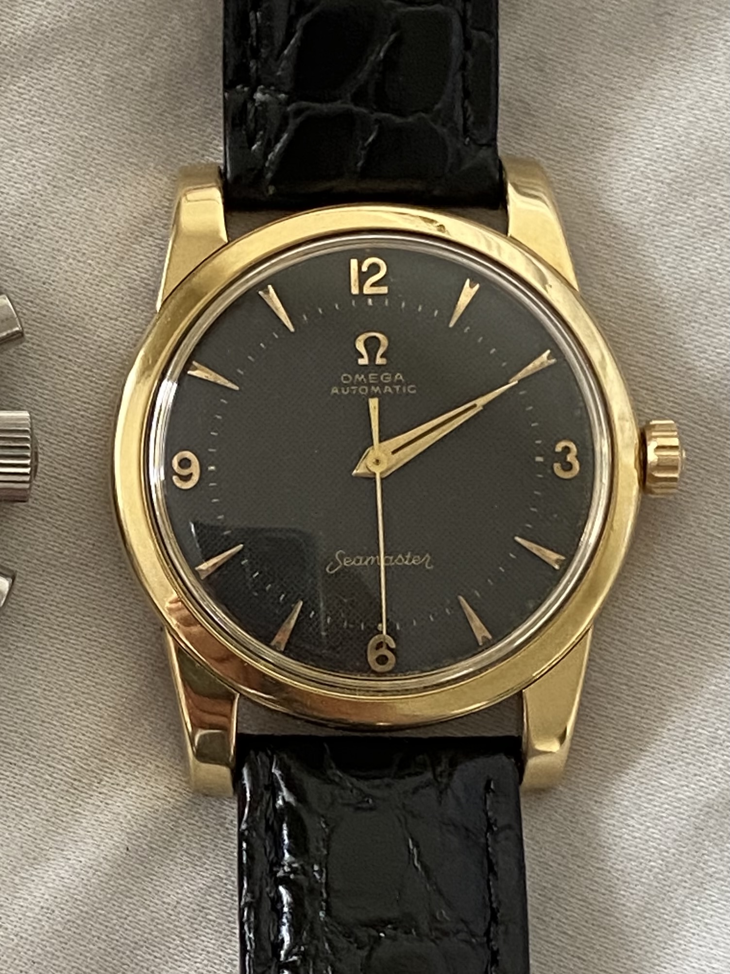

Hi, all. Posting this for comments. It belongs to a friend of a watch buddy friend.
It is 18K. The case back says ref 2577; it’s cal 354 bumper, serial number dates it to 1954. We think the seconds hand is a replacement. My buddy and I know to be wary of vintage Omegas with black dials, and so I’m posting the picture below so that you can have a look and offer your comments if you wish.

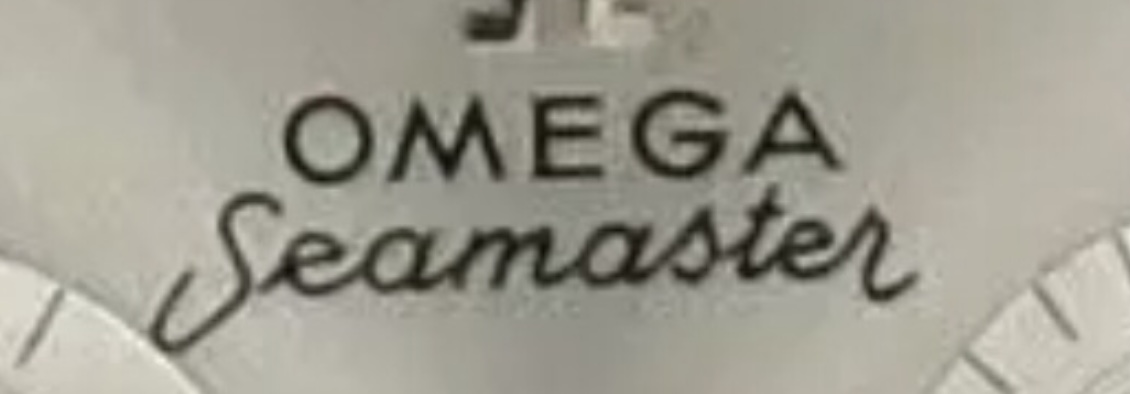

Oh so close but I have questions about that first T in AUTOMATIC.

It looks good to me, so if it is a redial, it is a very good one. The radium in the hour markers looks original.

Without a good picture a waffle dial watch can be very difficult to discern. The texture of the dial can distort the text even in a good picture.

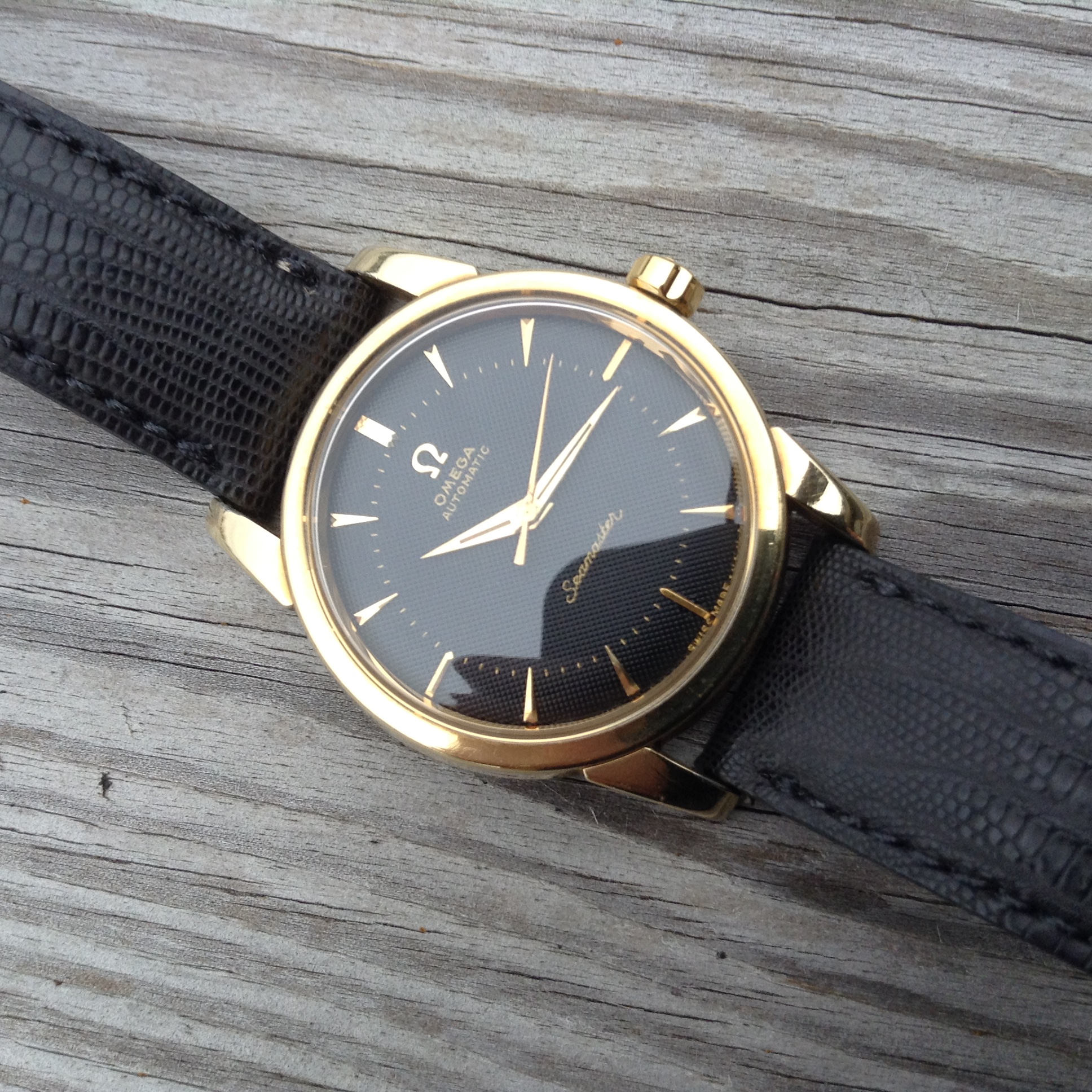

I have a similar watch and you can see my point...
The waffle texture obscures the text somewhat.

Thanks for the comments. I also have some waffle dials, and of course the print can never be a crisp as on a flat dial. Given the overall appearance, including the minute markers, I’m personally inclined to call it authentic.

Agree on this - post a more clear straight on photo without the hands obscuring the text and you’ll get better answers.

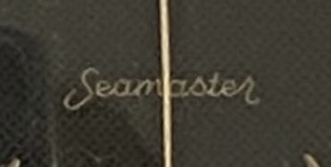

Somehow, that coat hanger ‘S’ looks a little odd to my eye. The top and the way it curves by the start of the ‘e’...
It could be the waffle texture. It could be I’m just wrong.
EDIT: I take it back.

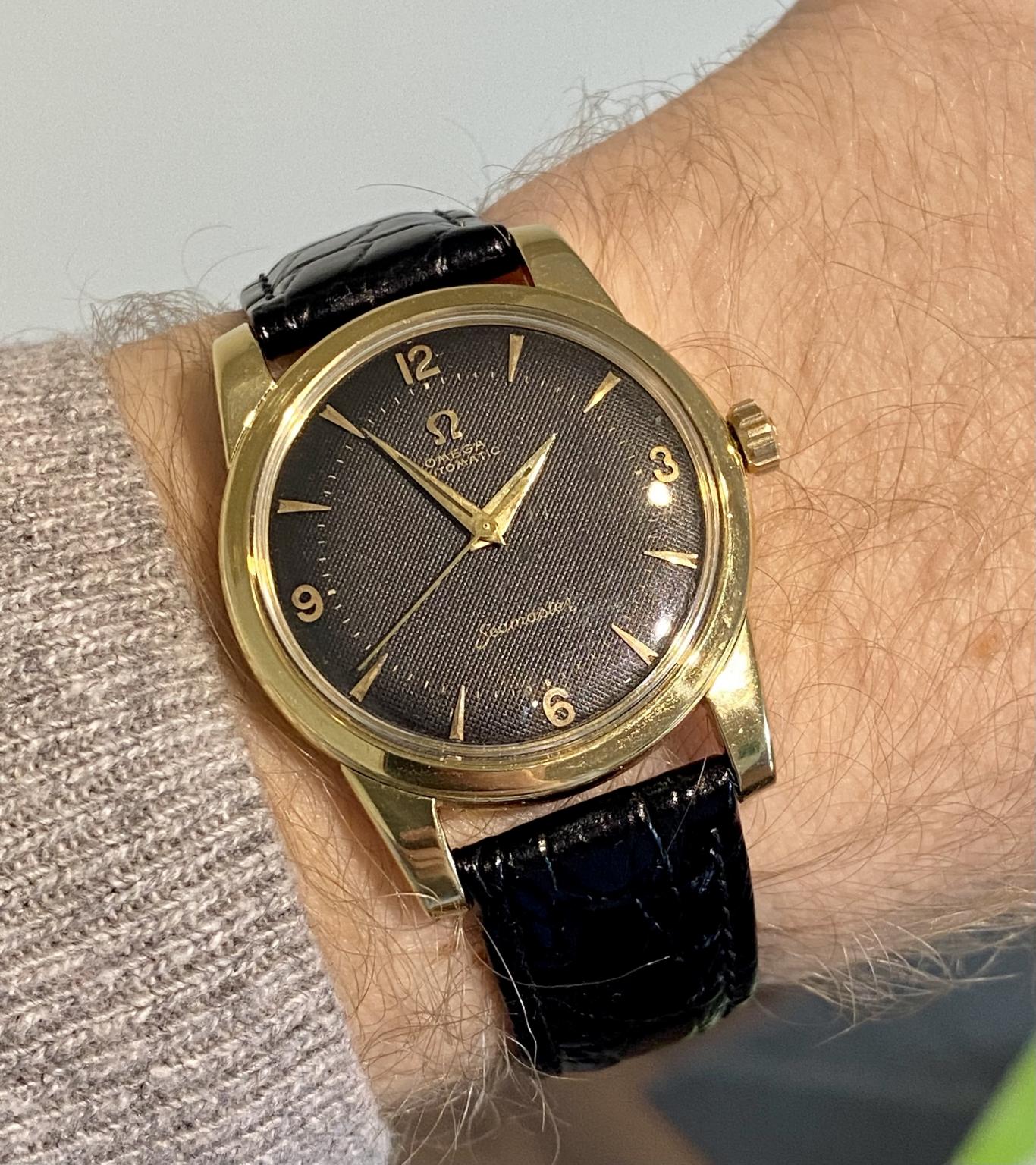

Can't you ask for a clear photo in the daylight? It's nearly impossible otherwise to determine 100% if it's redial or not.

Looks good and genuine, as you mentioned the second hand is replaced. Beautiful watch! 😀

I can't tell from the photos if the minute and hour hands have the lume intact or empty slots. Am I correct that it would have originally had a clover crown? None the less, it is a beautiful watch!
2,270
15,731
Looks like the lume on the hands is intact, just gone black.
Yes this should have the clover crown, but should not be a problem to buy and replace.
