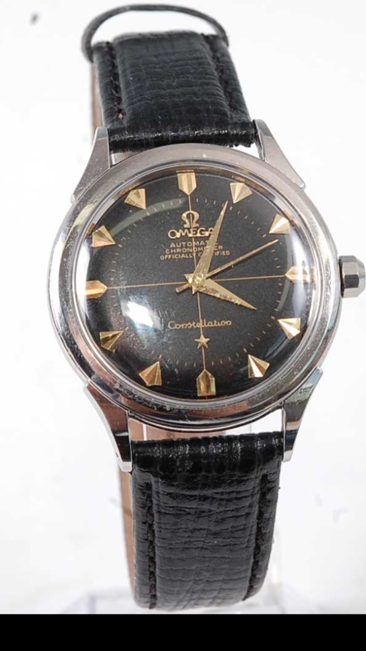

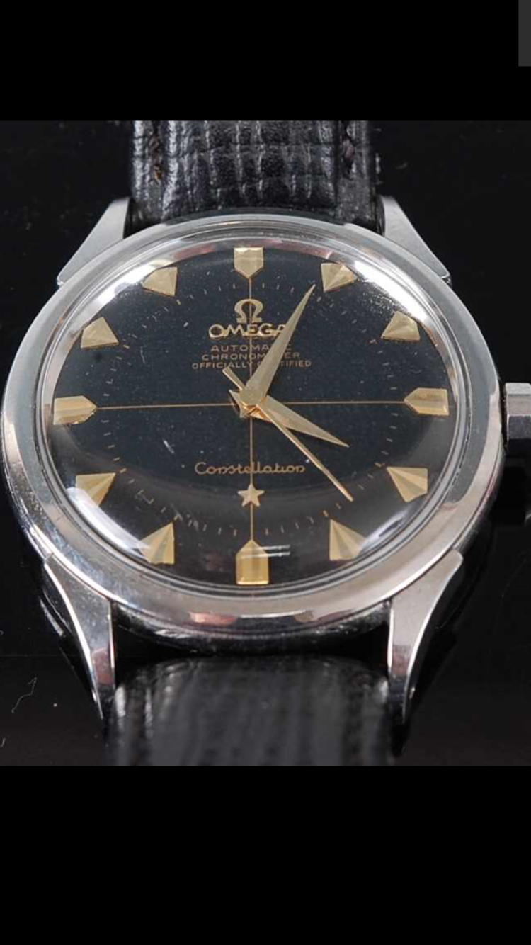

Thoughts on the originality of this black dial Connie?
Initially it looked good to me, but the more I look the more I believe it could be a redial.
Should the M be sloping on dome dials and the straight M seen here used on pie pan dials?
Shouldn’t the printed hour markers be dots?
Printing a bit too thick?

I’ve been looking at that one too! The vertical cross hair seemed slightly out for MOY but I wondered if it was the angle of the picture.

“ChronometER” is wrong for this case reference. There are other issues with the dial.
Redial. 🙁

Clear redial. For starters ER and the 5 minute marks are wrong.

Man that would've been a nice Connie! Look at how far the minute track is from the markers, that stood out to me. Also I agree with what the others said: missing i in Constellation, should be chronometre not chronometer. Btw the crown is aftermarket too.

This is a bumper Constellation dial, those will have dots next to the arrow heads instead of dash markers.
