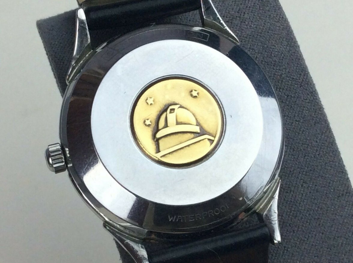

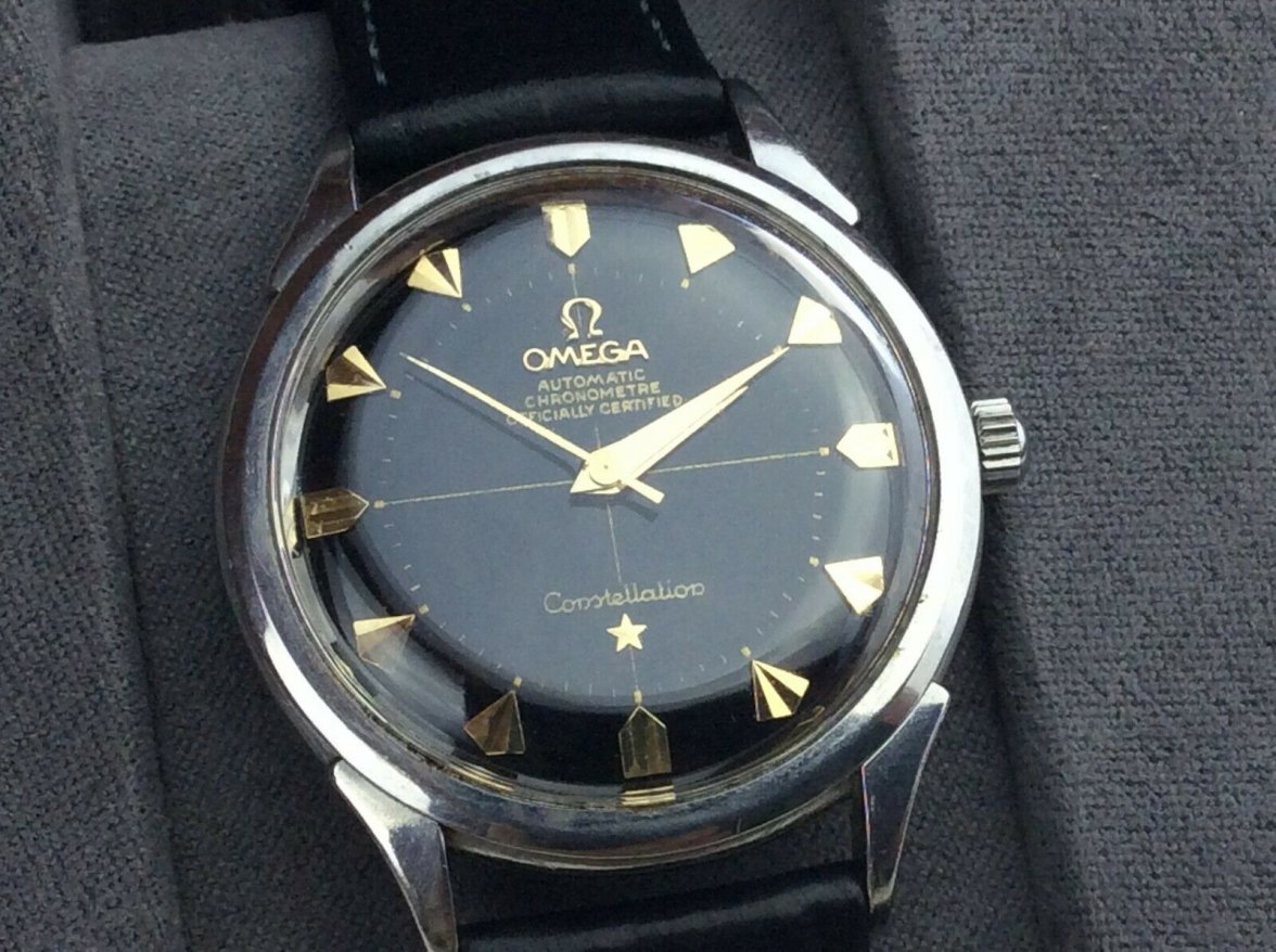

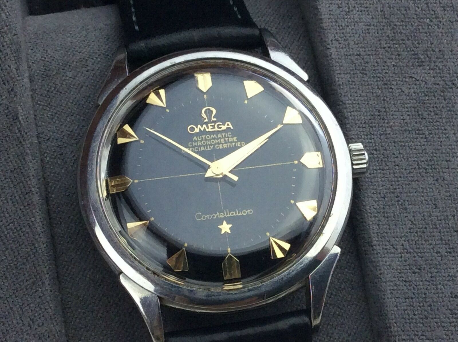

New to the Forum. I'm not really an experienced Omega collector, my passion has been Gallet Chrono's but recently spotted this on the bay and impulsively purchased. I'm fairly certain it's a redial. It also has been polished more than I like However it appealed to me and my understanding is the black arrow dials are fairly rare. The watch is enroute from the UK to me so I am posting the sellers photos to get an impression from the experts here on this forum. Constructive criticism is welcome.
10,804
16,814

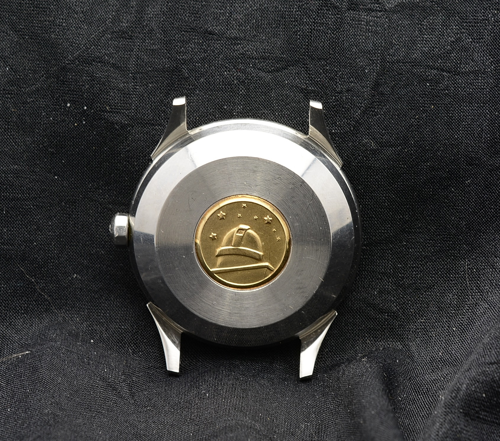

Yes I agree the text suggests redial, black dialled Omega dress watches like this often are. The medallion on the back has seen better days also. There should be 8 clear stars on there. It looks nice from a. distance but you wont be getting sneaky pms from collectors would be my guess. It looks like it is long overdue a movement service so I trust you factored that in.

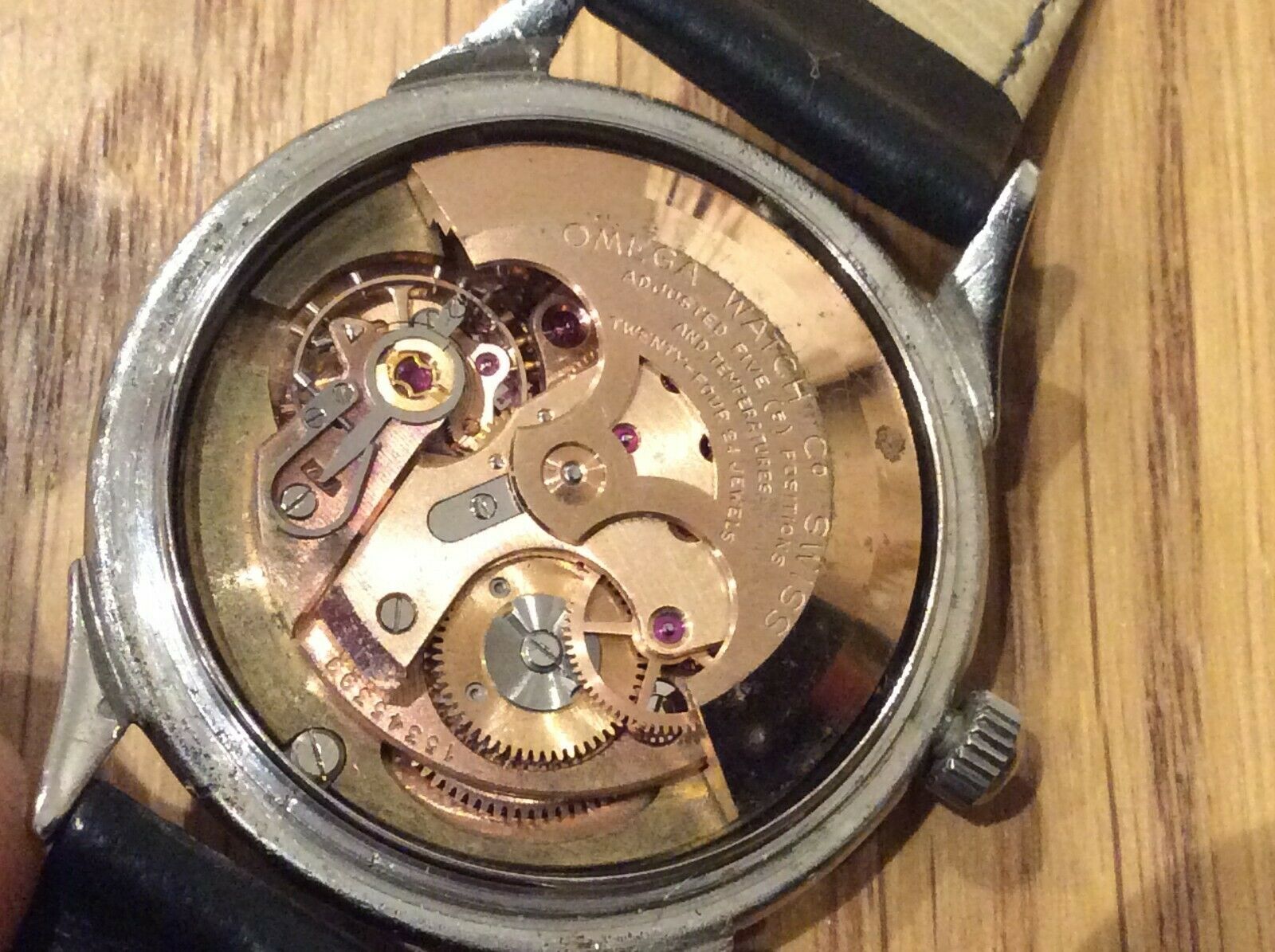

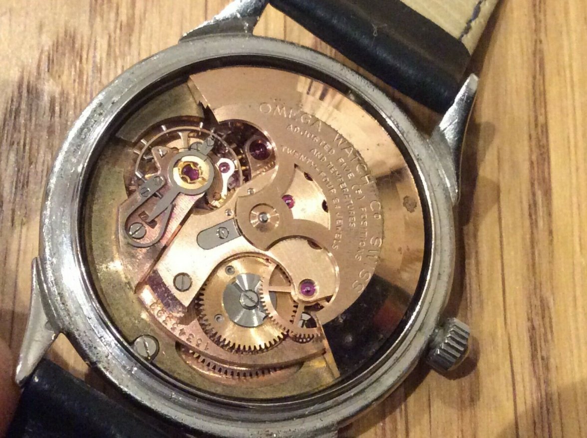

That movement will be a money pit with the water damage and heavy rotor wear. Never a good sign when multiple mangled screw heads are present.

Water damage? Please cue me in as to what tells you there is water damage. Ah the water spots on the rotor. Gotcha. And yes within 24hrs of my purchase I knew I'd paid the noob tax!

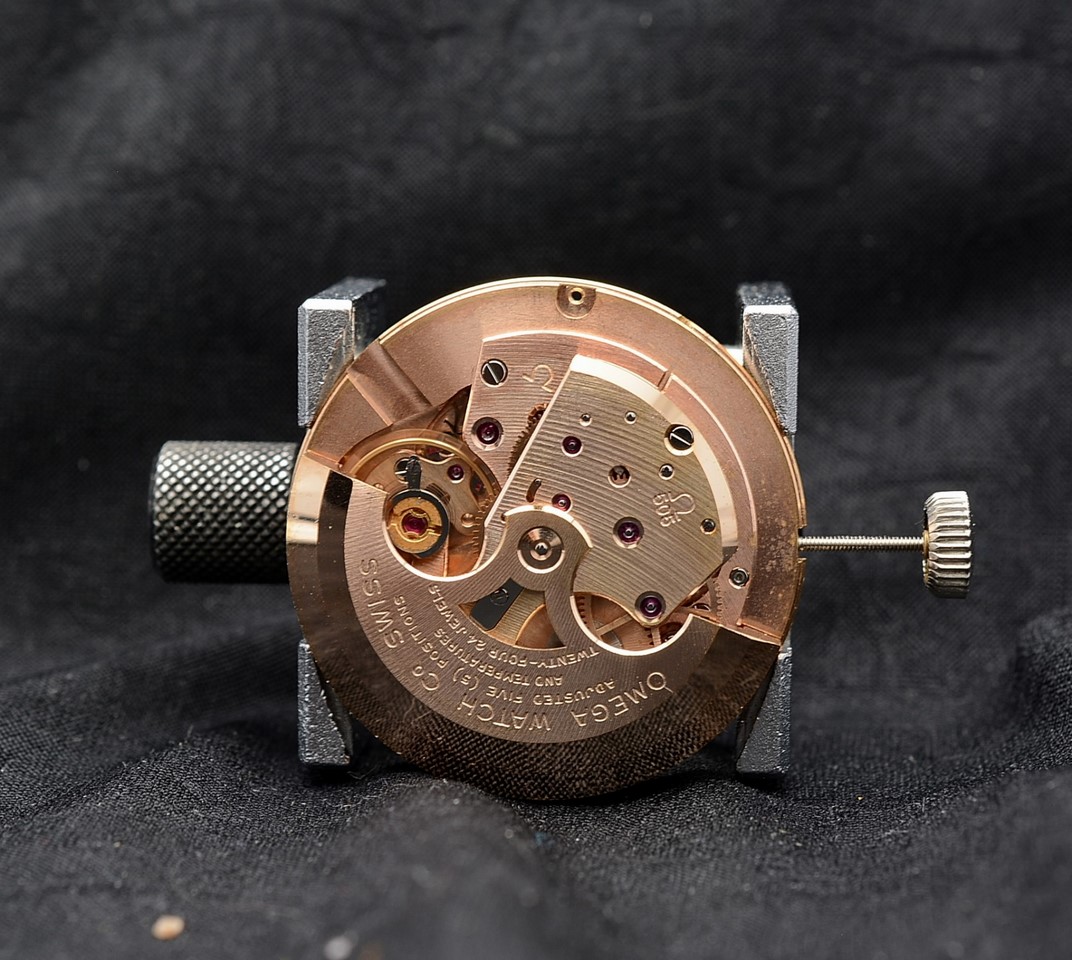

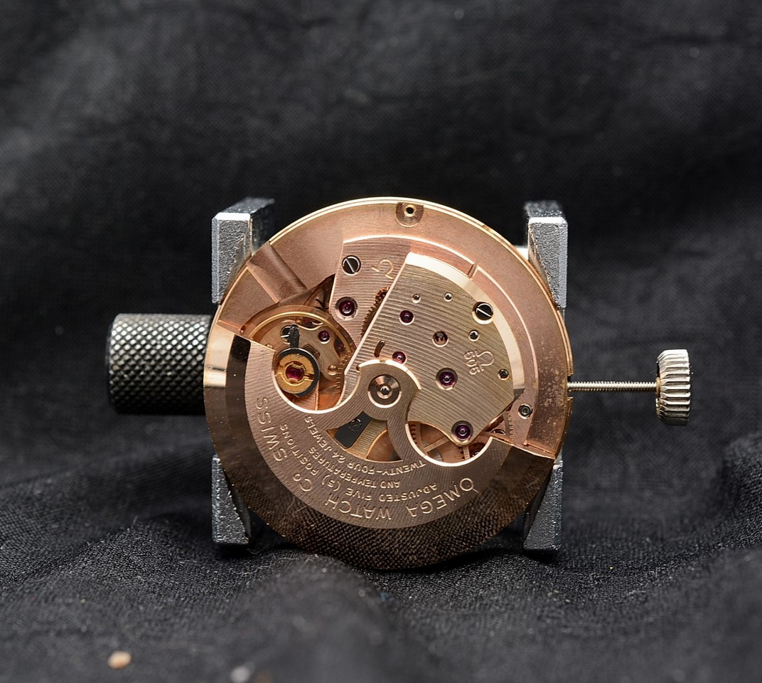

always suspect water damage if you see a redial, especially "black" and it may have left the factory just the opposite of black.

not only there(which is minor), but all the lower plate is corroded. compare colors with my example
