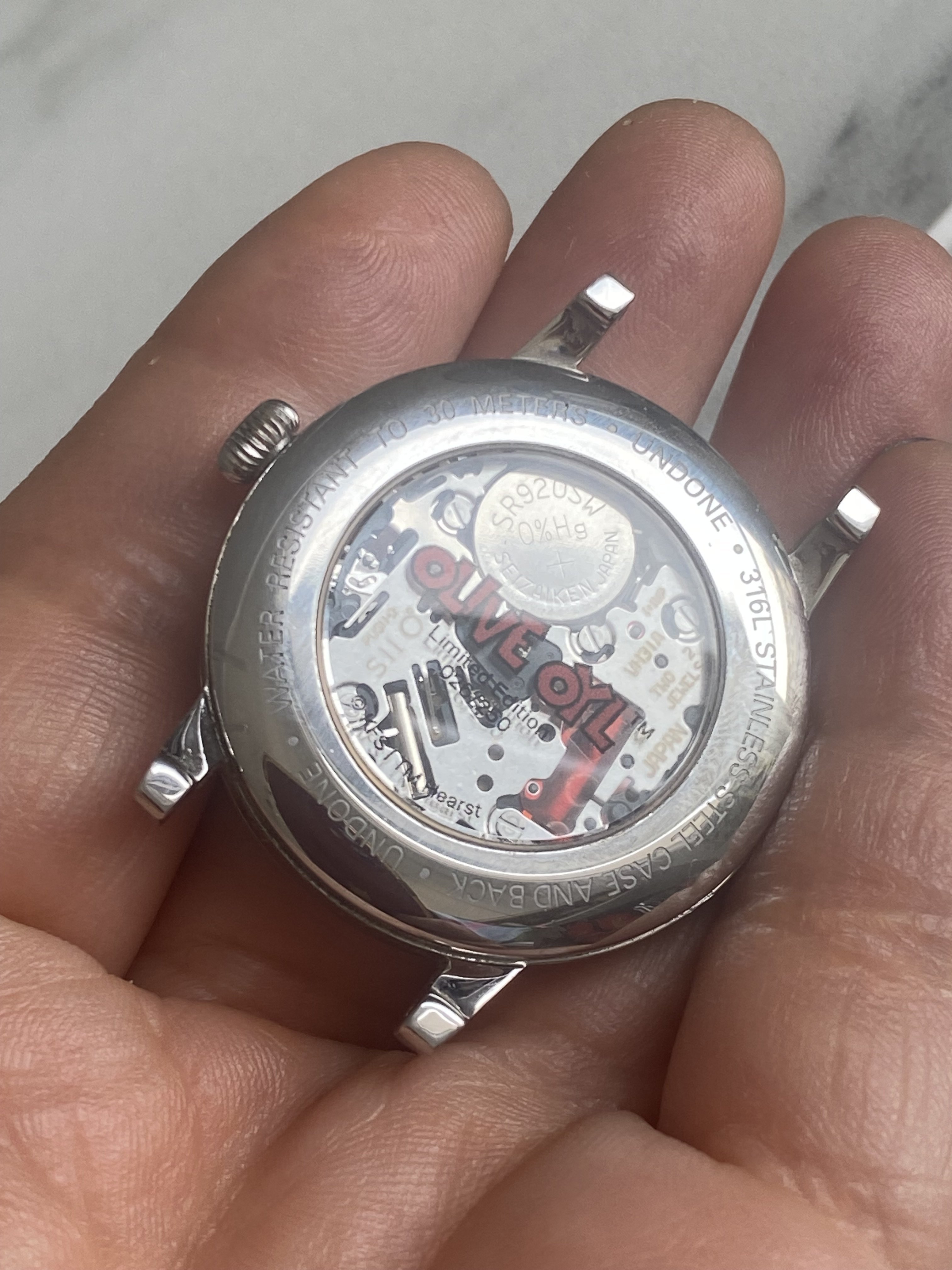

An « Undone » watch I really liked for what I thought was its good value/ quality is now causing a headache, the case is locked so tight that a watch seller/ repair shop near my vacation site couldn’t open it for a simple battery change.
Sure enough I now have a couple of thankfully discreet scratches.

I'm sure a proper watchmaker could open this without too much trouble. We deal with snap on case backs all the time and I have a variety of tools for opening them.

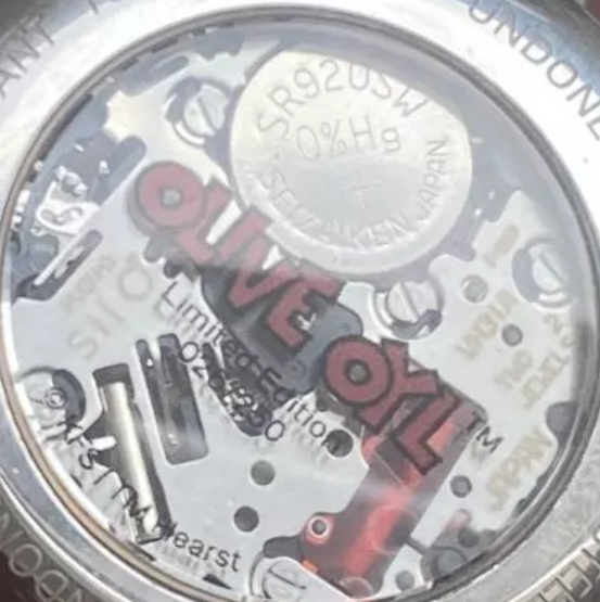

There's a bunch going on with that movement. 2 jewel, 2 hand Japanese movement and it's pretty large.
Meaning? I don’t know much about Quartz movements I must say but I seem to recall it was supposed to be relatively good quality, and Seiko based?
These are the specs published on the web site- which I believe are the same as for other 34mm time only two hand watches they have, mostly for women:
MOVEMENT
Japanese TMI VH31 Quartz with Sweep Second Hand

The movement is a medium grade Seiko caliber made by a number of Seiko companies, In this case, TMI which is essentially a Seiko company based in Hong Kong.
Nothing really wrong with it and it is well suited for the level of watches it's used in.

Nope. Nothing wrong with it at all. Didn't realize it was part of their 'Mechaquartz' family. That cool feature is wasted on this one because there is no second hand.
Back to the case. I could see how this one could be a PIA given the heft of the back and also snap type.

Don't they sell a tool for this?
I wouldn't use the cheap chinese version from amazon as all the reviews tend to say the blades are garbage, but a quality horotec or bergeon should be reliable.
