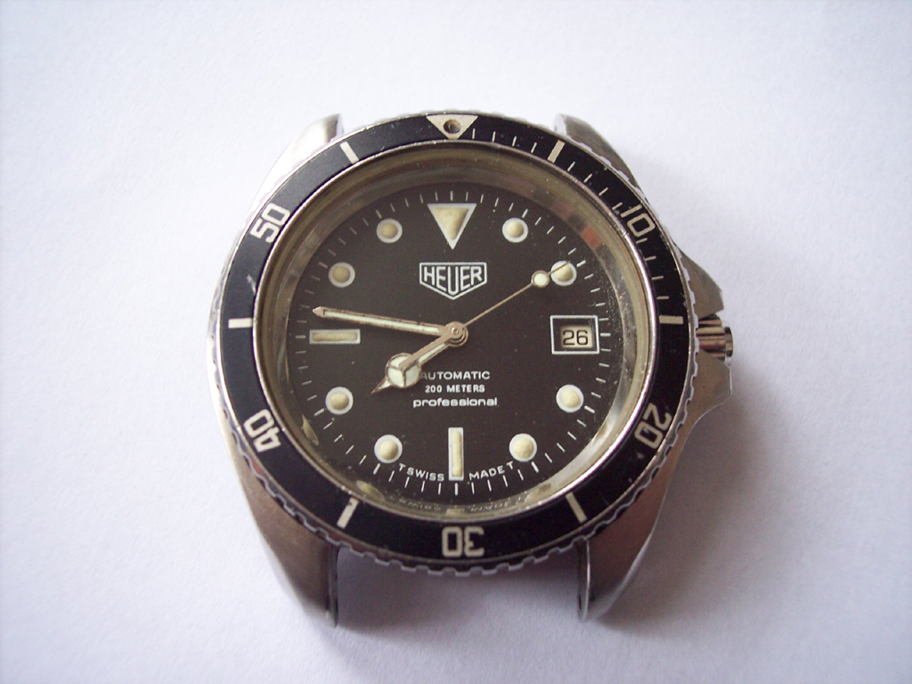

Go for a Vintage Heuer 1000 diver or super pro, you can get them in automatic or quartz. ETA 2824 if its auto and ETA 955.112 it its a quartz. They look really slick in the full size and are an awesome daily wear diver. I work on and sell these all the time and they are a joy in every way.
