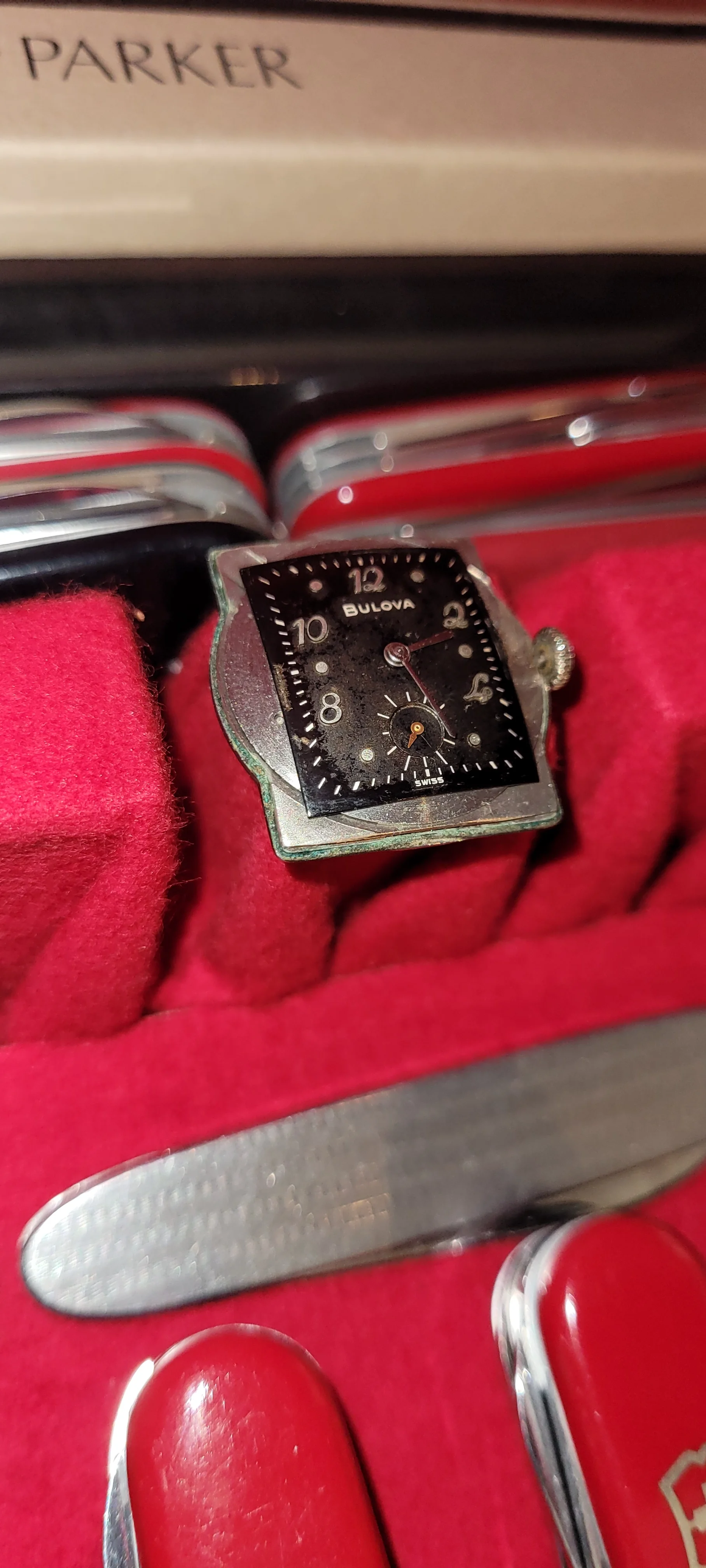

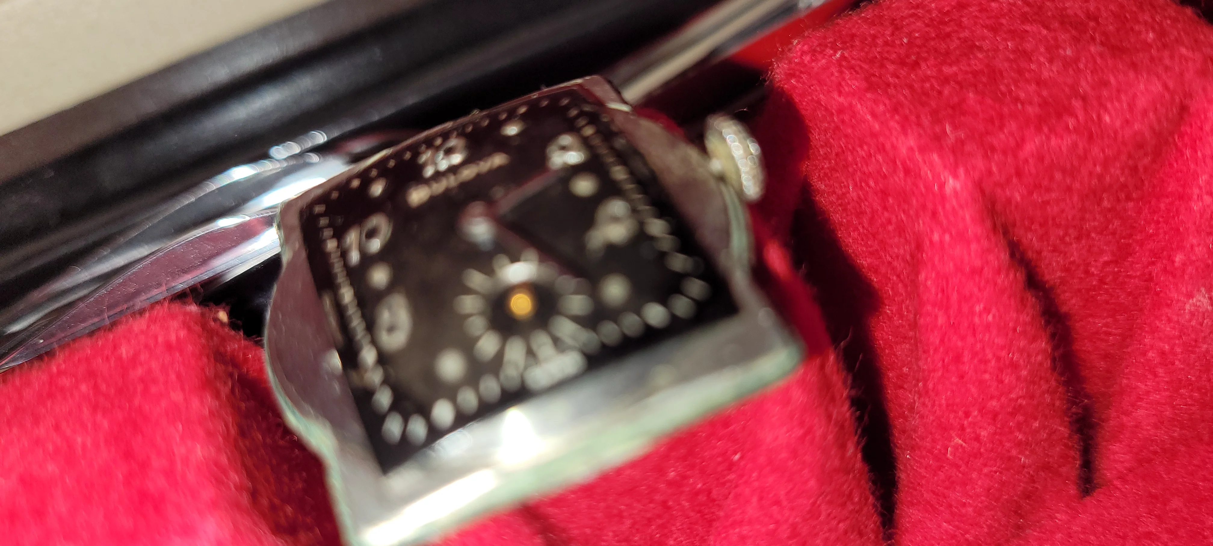

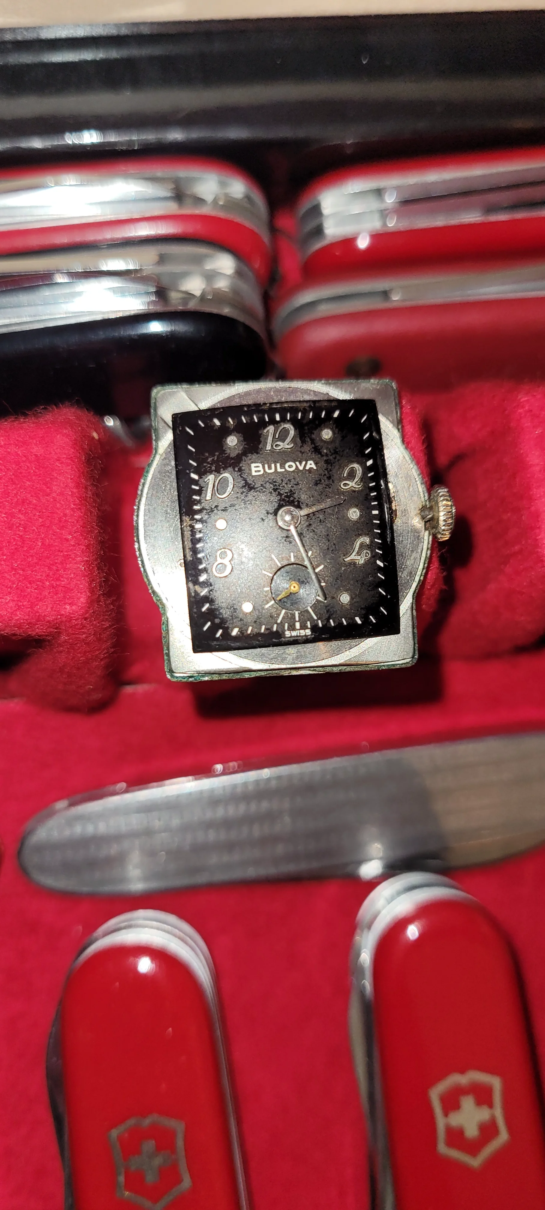

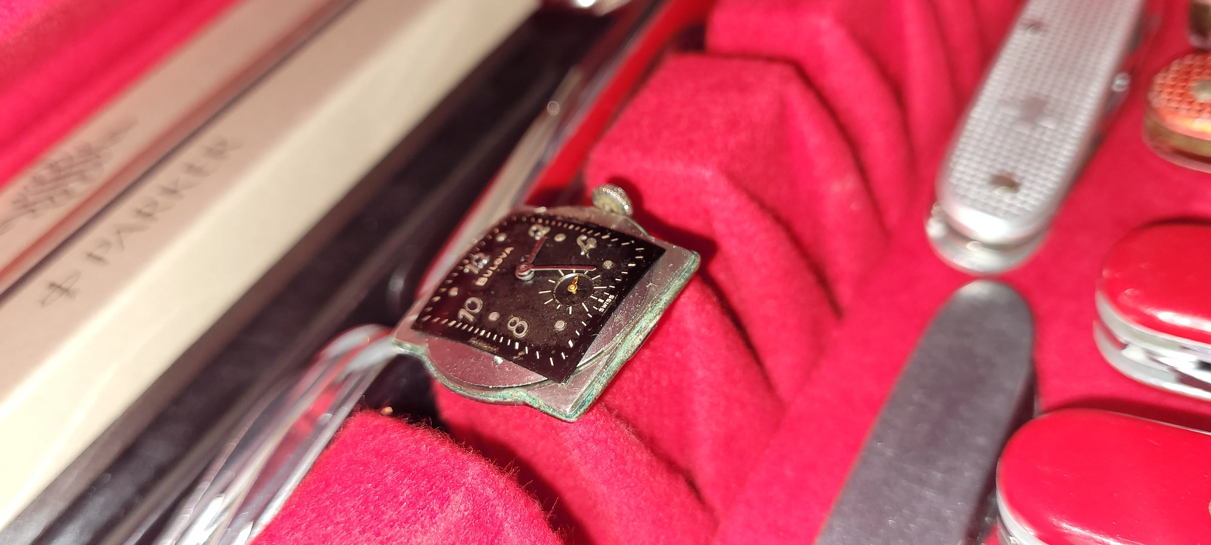

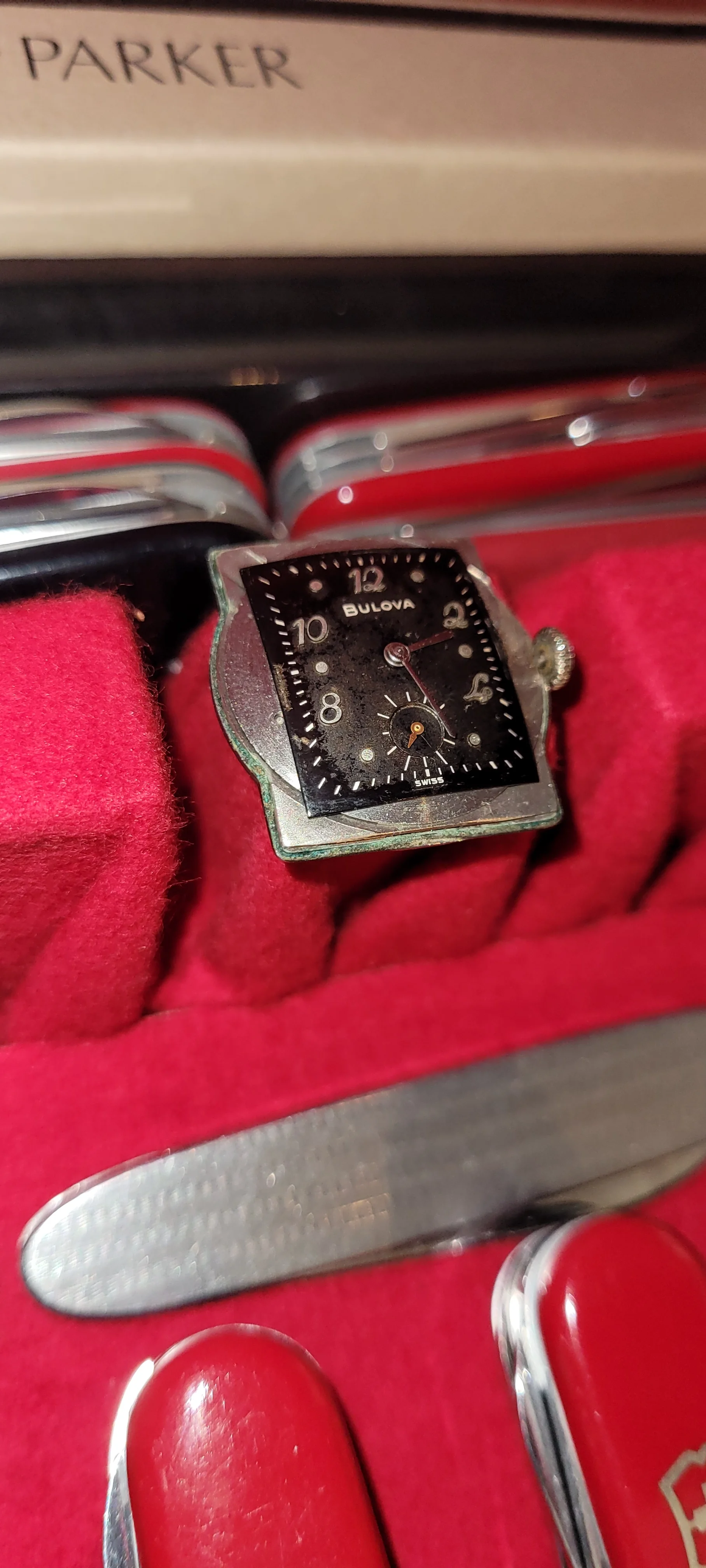

I recently got a 1957 Bulova that was covered in sticky residue that I believe was from the previous owner smoking lots of cigarettes. It got between the crystal & case, and seems to have gotten onto the dial.
I've already gone at it with a damp q-tip, which helped a bit, but the residue is on there pretty good..
I understand that dials should generally be left alone so that they don't get damaged, but this black dial will look gorgeous once that residue is off! So I'm willing to take the risk and keep trying.
Any tips/suggestions? I was thinking a q-tip with a very small amount of wd40 on it would get the residue off extremely easily, but I've been reading that it can destroy laqcuer, so i'm holding off on that until more people chime in on it.

In most instances, trying to improve a dial, makes them worse. Appreciate what you have.

I'm fully aware of the high potential that I could ruin the dial, but I'm willing to take the chance.

What Canuck said. Don’t do it. Vintage dials are about as fragile as butterfly’s wings. If you insist, give it to a professional who has experience doing it. Even then, most will encourage you to leave it alone.

Full speed ahead and damn the torpedoes! If you discover a way you think might work, don’t be ashamed to show us your results.

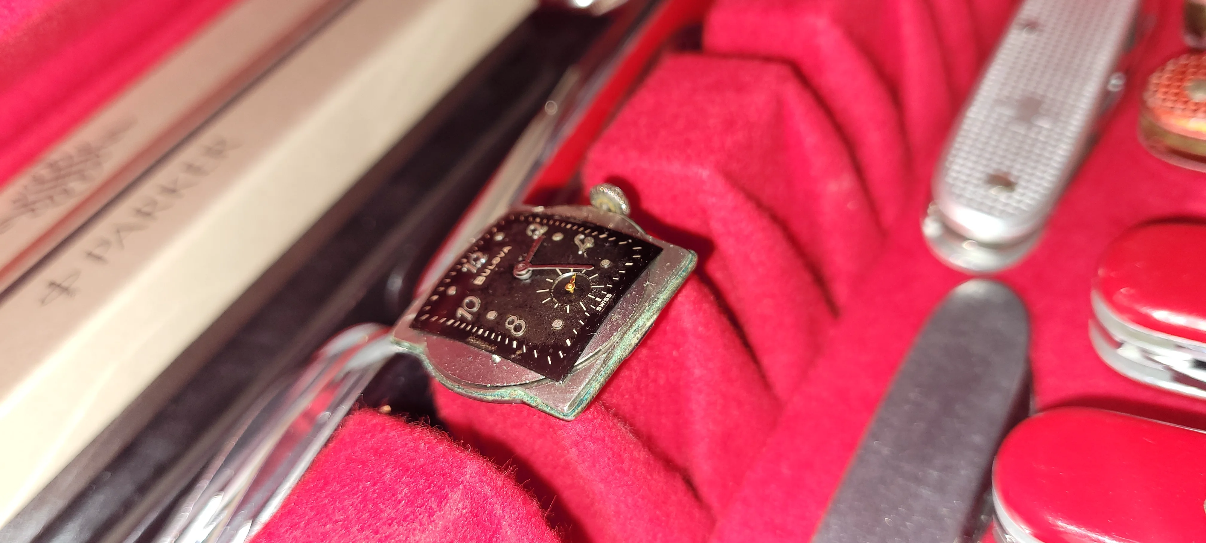

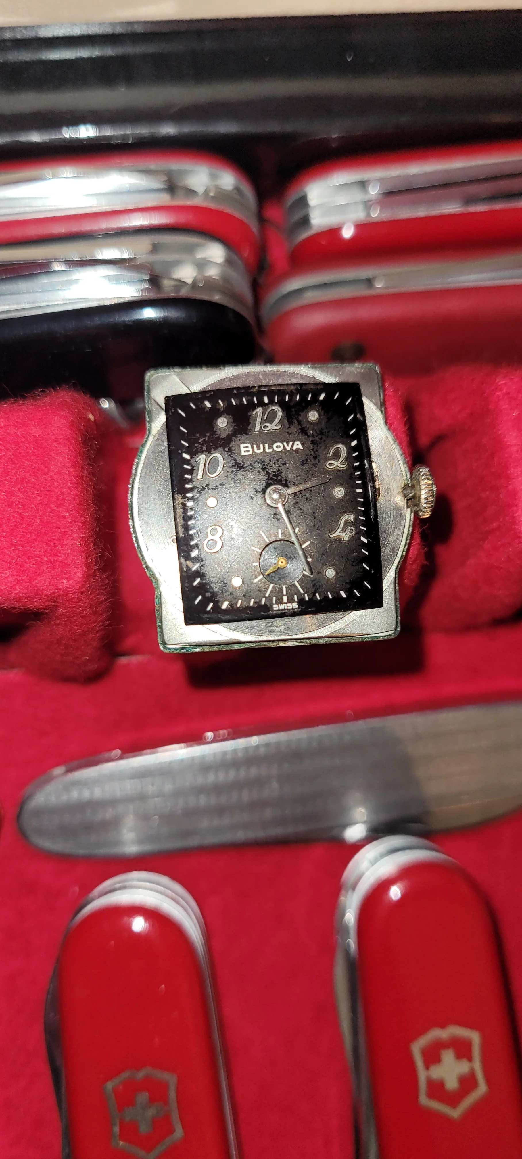

For what it's worth, the photos I uploaded were from before I went at it with a damp q-tip, I safely removed a decent amount of the residue without any harm to the paint whatsoever,
I'm just seeking any info on something that can remove the residue more effectively.
I've seen countless destroyed dials from others attempting to clean theirs, so I'm aware of the risks involved.

The "go to" dial cleaner in the industry is something called Solvent-H. It was primarily used in the printing industry as a solvent, so it's getting harder to find. Ottobock still sells it as it is used in prosthetics.
https://shop.ottobock.ca/en/Prosthe...ment/Elastomers/Solvent-H-(0,25-Liter)/p/83A2
I have seen dials destroyed by it though, so as always proceed with caution.

I use saliva on a q-tip.
You are probably looking at old varnish and not smoke residue.

I'll give the saliva a try, thanks! I'm fairy sure it's smoke residue, the q-tip was lifting the same nasty brown residue that was on the case and in the crevices of the crystal.
Though I'm not going to rule out what you're saying, I'll proceed with extra-extra caution incase it's indeed the varnish/laqcuer.

The main ingredient seems to be n-heptane, so it's a hydrocarbon solvent, an alkane. Something chemically similar you might have around the house would be mineral oil.

Distilled water might be a better choice here.

The only success I’ve seen is on very smooth glossy dials that are intact, using a soft pencil eraser to gently remove mould spots and debris. I start on the outer edge of the dial where it’s typically covered, see how it does, then try in the center near the opening for the hands, if it looks like it’s not making it worse then I do the other areas

I have mineral oil from restoring old pocket knives that I could use, but I briefly read that mineral oil could damage the laqcuer, so I'll have to do some further research on that

That's the exact kind of dial this is, my pictures don't do it justice, but the dial is very glossy and smooth.
I might give it a go with an eraser (very gently) if I can't make enough progress with the other suggestions.
