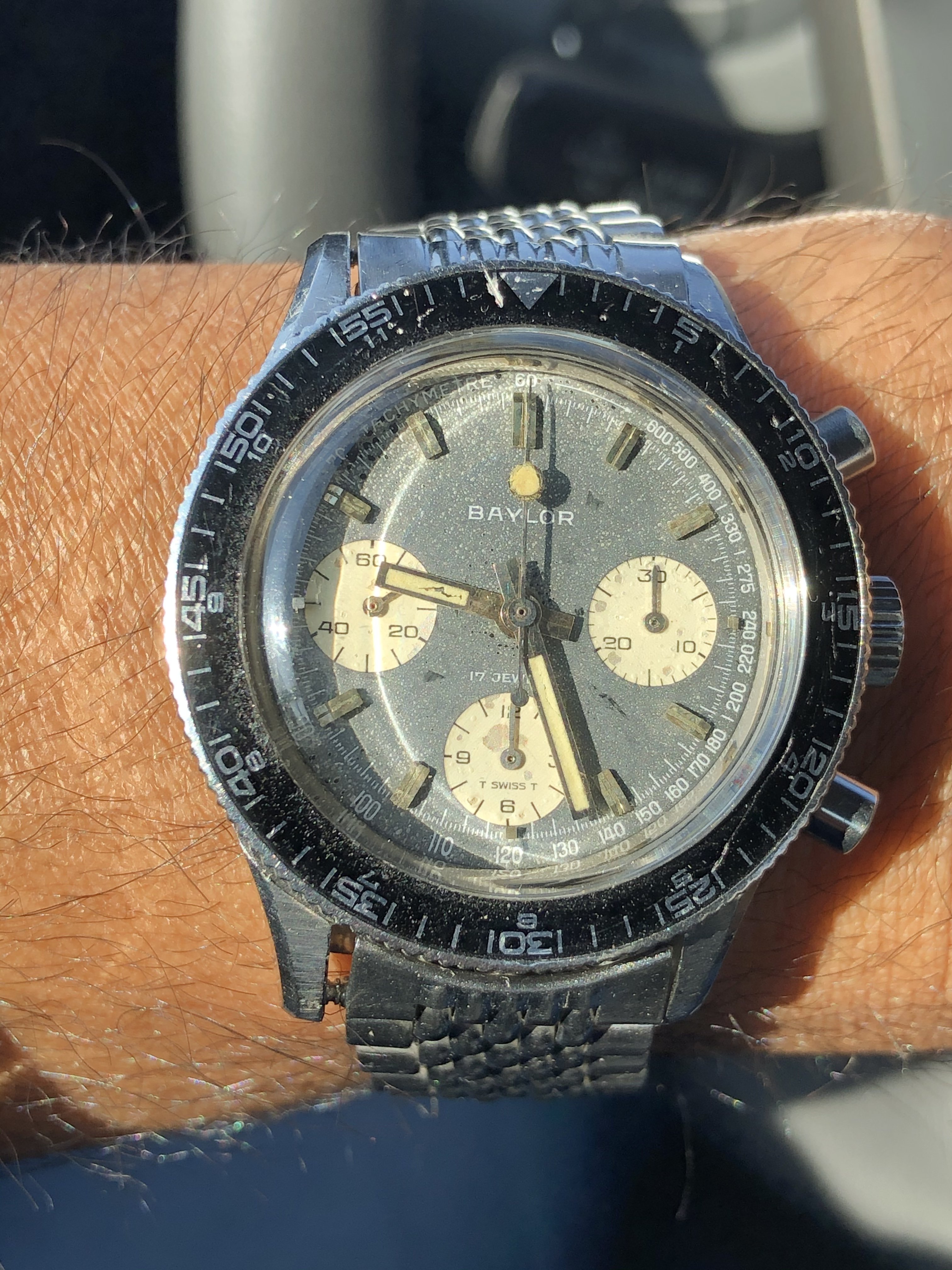

So, we all know that as the price of Heuer Carreras and Autavias have skyrocketed (and I have my own opinions on that), a raft of "poor-man's" versions has been dragged along in their wake. It seems every other seller and their uncle is claiming "X brand used Heuer parts!" In some instances, we can confirm this (e.g. Primato, Clebars, Tradition, see On the Dash for more specifics http://www.onthedash.com/chronograph/poor-mans-autavia-primato-73363/). In others, the relationship is more tenuous.

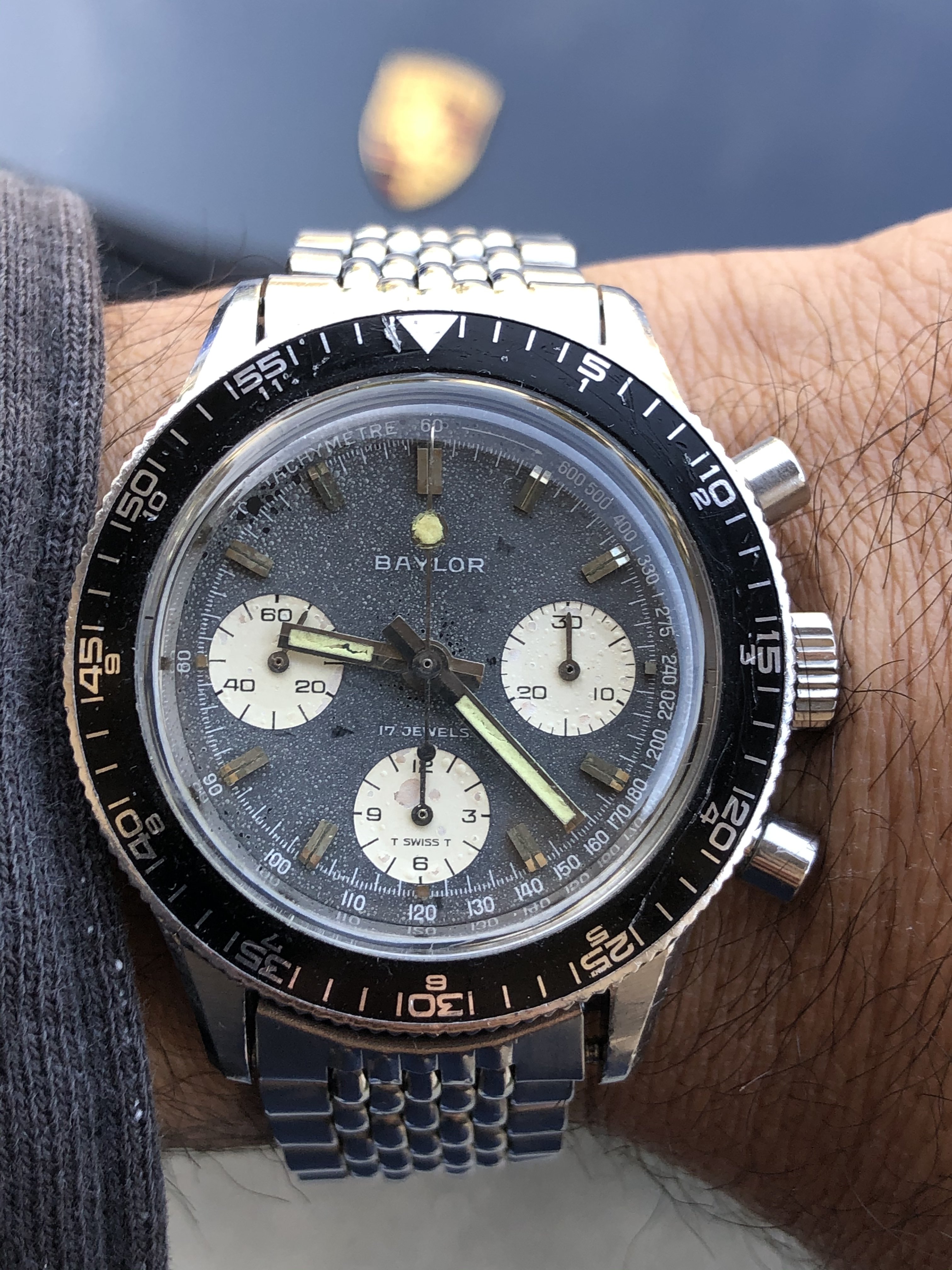

Take, for instance, this recent Ebay auction for a Baylor:
https://www.ebay.co.uk/itm/Baylor-chronograph-inverted-panda-1960s-/224052313872?nma=true&si=4%2Bp5DZylLwIsB%2F42jYTIYXvPWy8%3D&orig_cvip=true&nordt=true&rt=nc&_trksid=p2047675.l2557

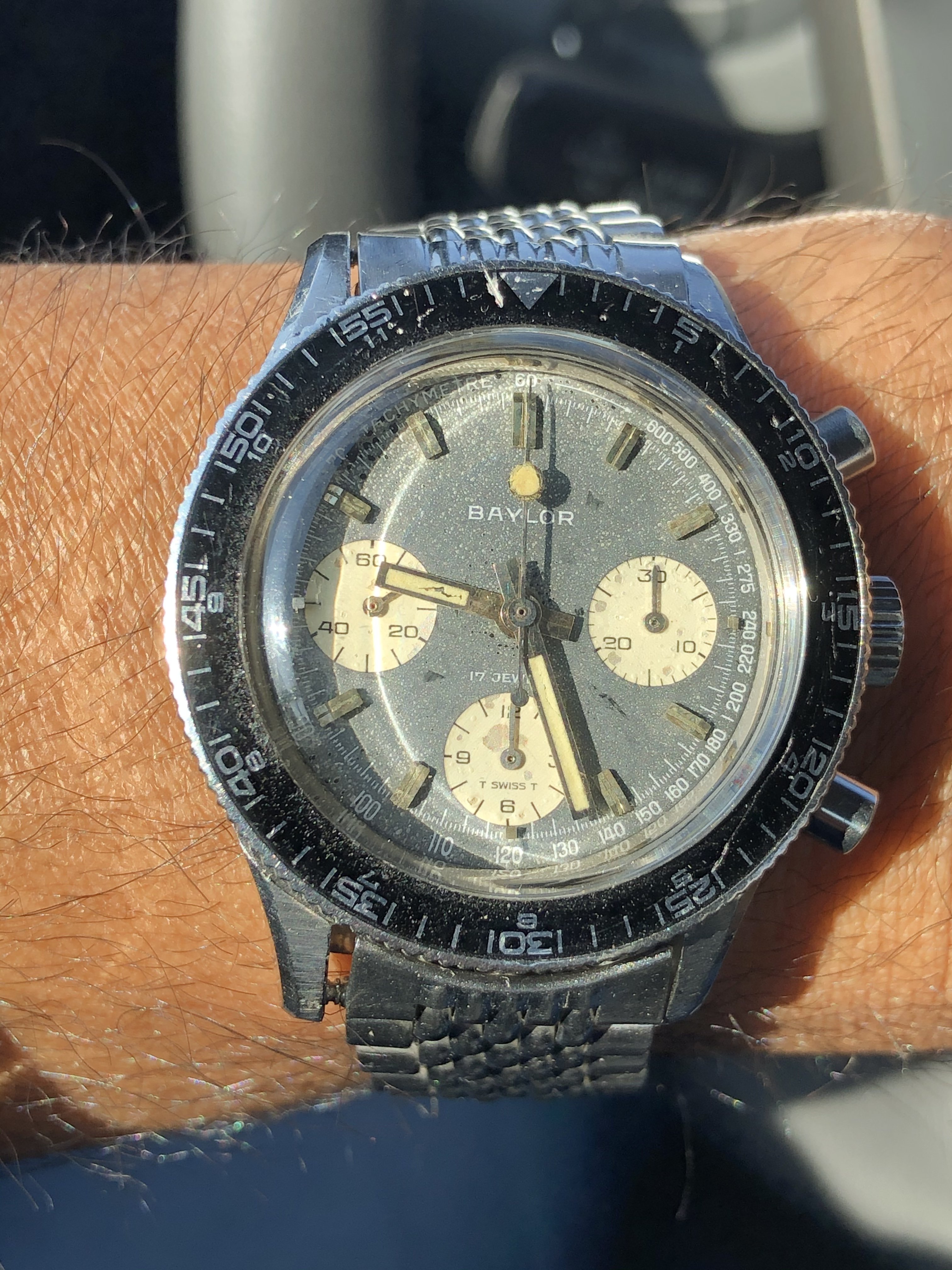

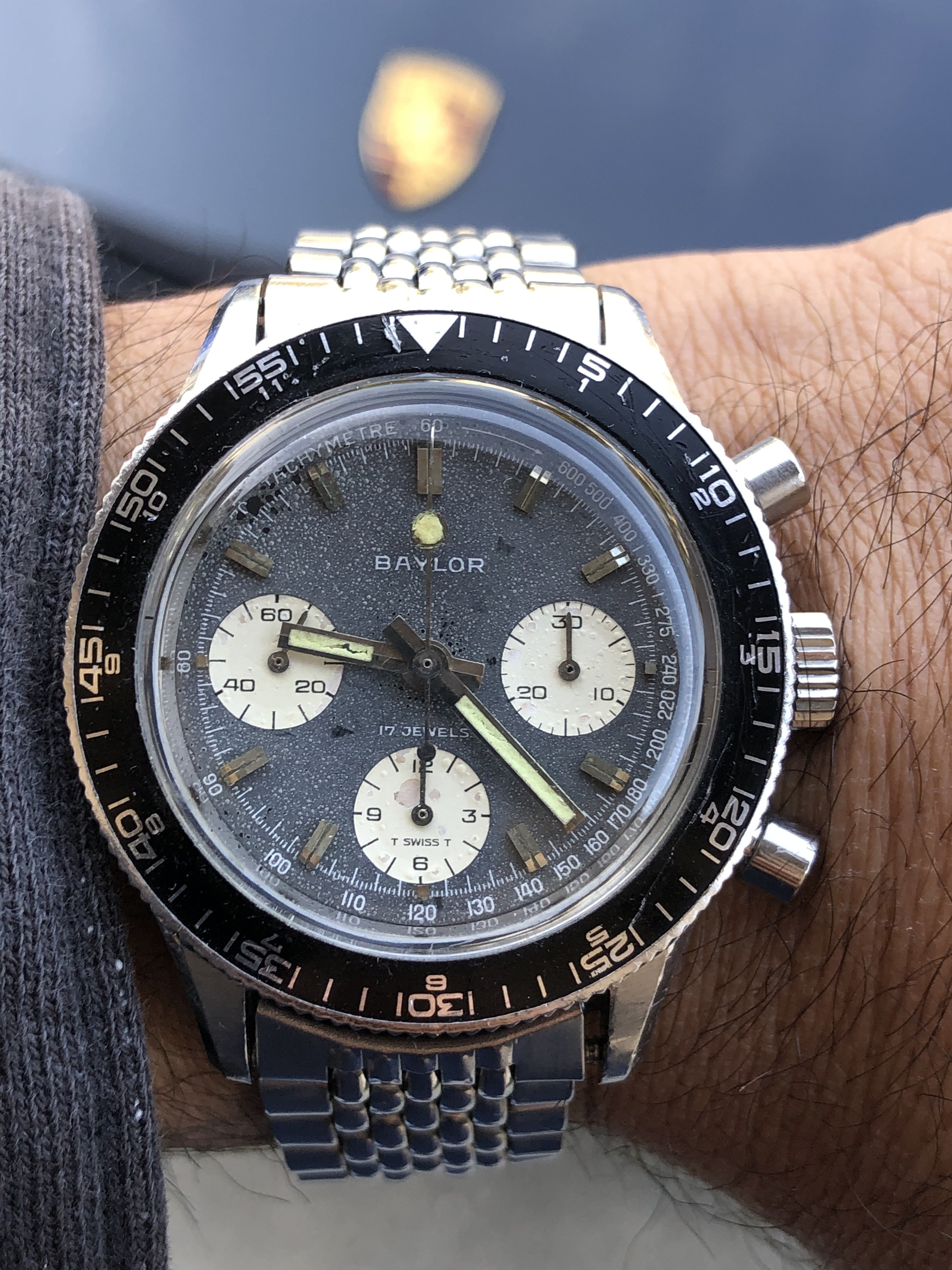

Baylor was sold through Zales jewellers. The seller really doubled down on the Heuer connection: "Baylor-branded watches used many of the same parts as the Heuer Autavias and Carreras of the late 1960s. It is even rumored that as Heuer began to shift its focus toward automatic chronographs with new cases and dials, Zales was able to snatch up parts for pennies on the dollar."
Now, admittedly, the dial is _very_ similar to the Autavia 2446, and even more appealing, in some respects (e.g. the lollipop sweep second). But that's pretty much where the similarity ends. The case, with its narrow lugs and screwdown, single-step caseback, has more in common with the Wittnauers and Croton Nivadas from this period (the 2446Cs I've seen either had rounded snapbacks or double-stepped screwbacks in the 2nd execution--Heuer folks can feel free to chime in here). Most importantly, the Baylor sports the Landeron 349 rather than the Valjoux 72 found in the 2446.
Not familiar with the L349? Why would you be, it's a pretty rare movement. And by "rare" I don't mean "desirable," I mean just uncommon, difficult to source parts for, and expensive to service because of it. Apparently, and I have this from my watch guy, Landeron made alterations during production, so often parts do not interchange between this and more common Landeron movements (e.g. the 149).
And here we arrive at the real problem with this piece, which is that the 12 hour subdial only resets to 3 o'clock. The seller, to his credit, fully admits this, and says it has been this way since his purchase of it. Less to his credit, and likely done in ignorance, was that it merely needs "re-centering by a professional." Again, from my watch guy, the warning, specifically, "if the hour subdial doesn't reset to zero, avoid it!"
I even went to the lengths of sharing this information with the seller, as fair warning that if he passed this off as a minor issue and it turned out to be (as anticipated) a much more expensive repair, he might have a very unhappy buyer indeed.
Of course, hope springs eternal, and someone bought it for £1700. When I think of all the amazing, nearly flawless chronos from decent mid-range makers (e.g. Wakmann, Croton, Wittnauer, Le Jour, Yema, Chronosport, Ollech Wajs) with better movements that one could get from OF members, or elsewhere, for that price, it really made me shake my head in exasperation. I _hope_ I'm wrong. I _hope_ it is a cheap and minor repair and the buyer takes great joy in what is, when all is said and done, still a very attractive piece on the outside. I, in the meantime, breathe a sigh of relief in that, at least this one time, I chose discretion as the better part of valour!
Well to be fair, if the hand doesn't reset to 12, the most common reason is that the hand needs to be reset. Can I ask what specifically your watchmaker believes the issue is, and why it's a big enough deal to avoid the watch if it has this problem?

Good question. His assumption was that if it was an easy repair, then either the original seller or the subsequent buyer and current seller would have had it done and dusted. My reason to avoid it had less to do with that issue in particular, since I always assume that any chrono I buy on Ebay is going to require at least an ordinary service. and more that I am not a huge fan of paying a premium to get a "poor man's X" as opposed a mid-range chrono that has a better movement and isn't aspiring to be anything more than what it is. But taste it taste, no?

For me the bigger reason to avoid the watch would be the aforementioned scarcity of parts. I have passed on some lovely watches because donors weren’t cheap and parts were NLA. Sustainably is a big part of watch ownership for me (wearing, not just collecting). So if parts can’t be acquired for a known problem- it makes it less attractive to me.

I think I actually saw this one on the 'bay, skimmed it, and passed not just because I found the price high but as others have said - that movement may be damn hard to properly service vs the Valjoux.

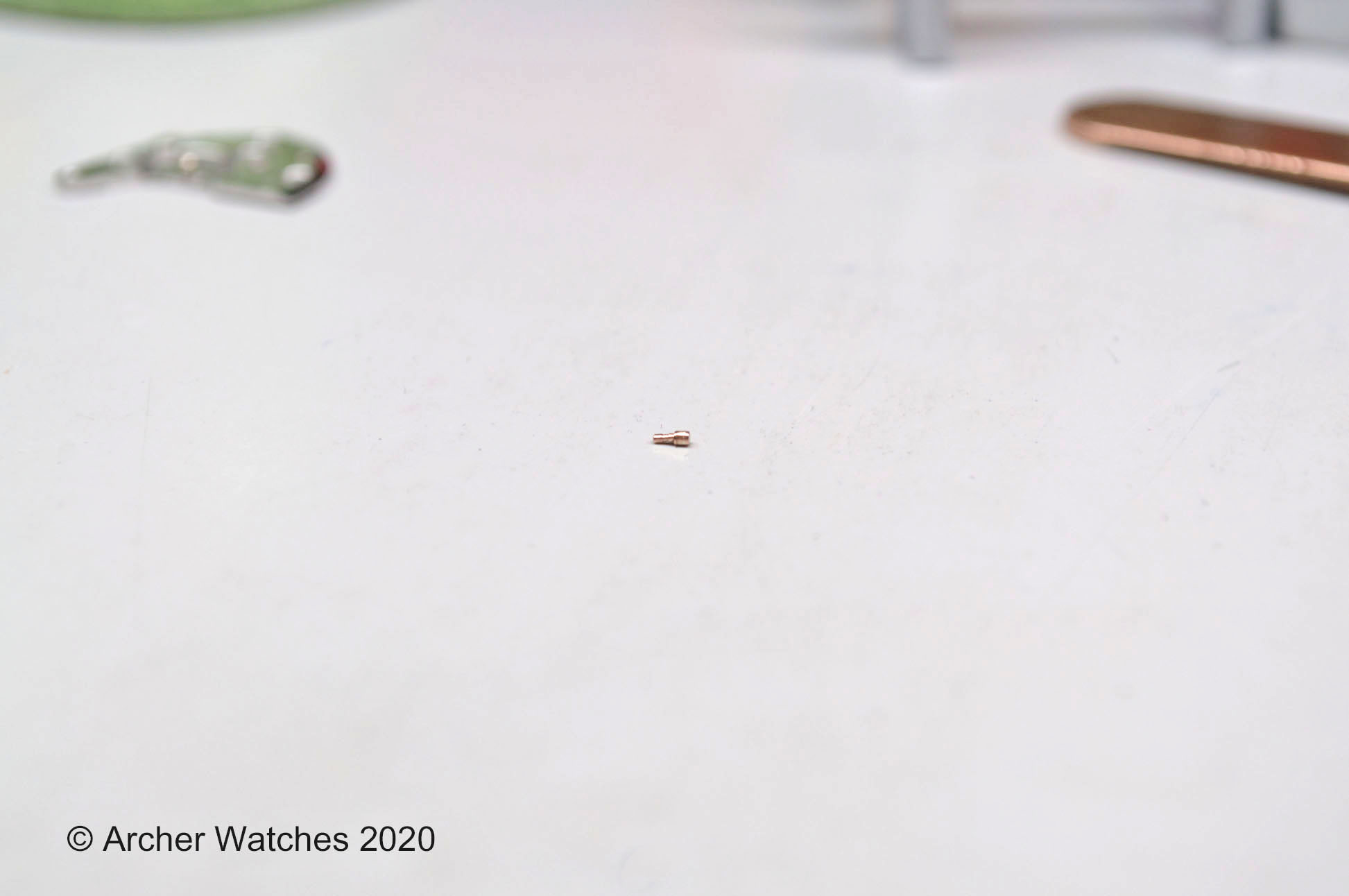

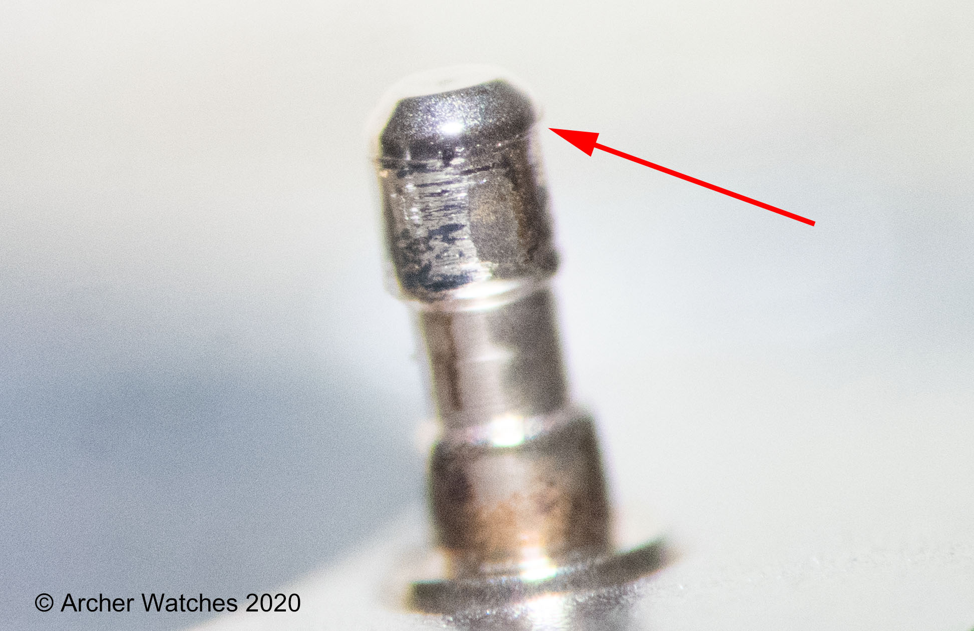

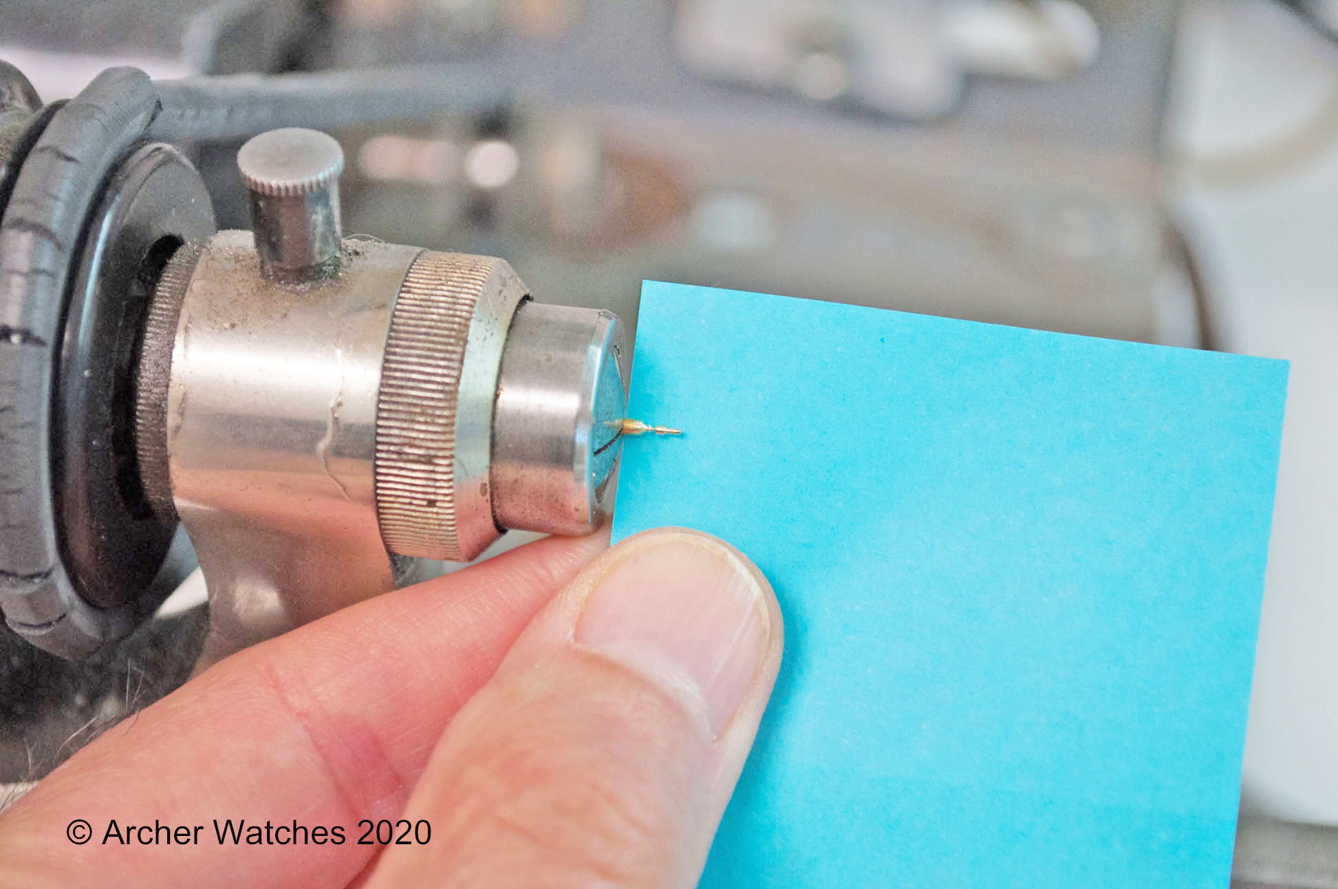

Yes. For more complex parts that I would not make often, there are people who specialize is custom parts fabrication. Years ago I got this Zenith pocket watch in...note the handy bodge that was done by another "watchmaker" to keep the ratchet wheel in place:
The reason for this was that the ratchet wheel screw was snapped off in the barrel arbor:
I tried drilling the old screw out, but it was hard and the carbide drill I was using broke. Can't dissolve with alum, so I was out of options to use this again. Had a guy I know make a new one for me, in far less time than it would have taken me, and it worked perfectly:
He also made the screw.

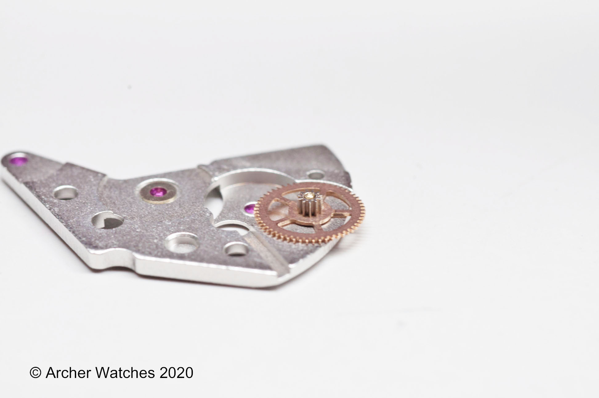

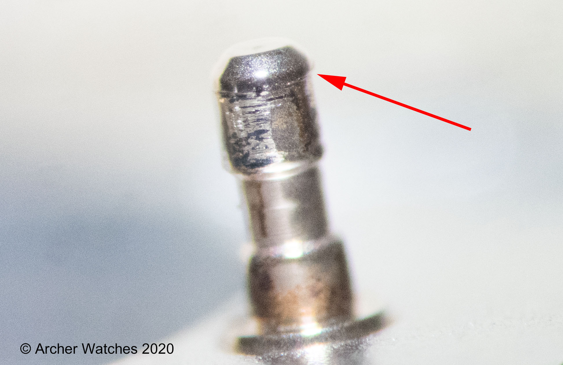

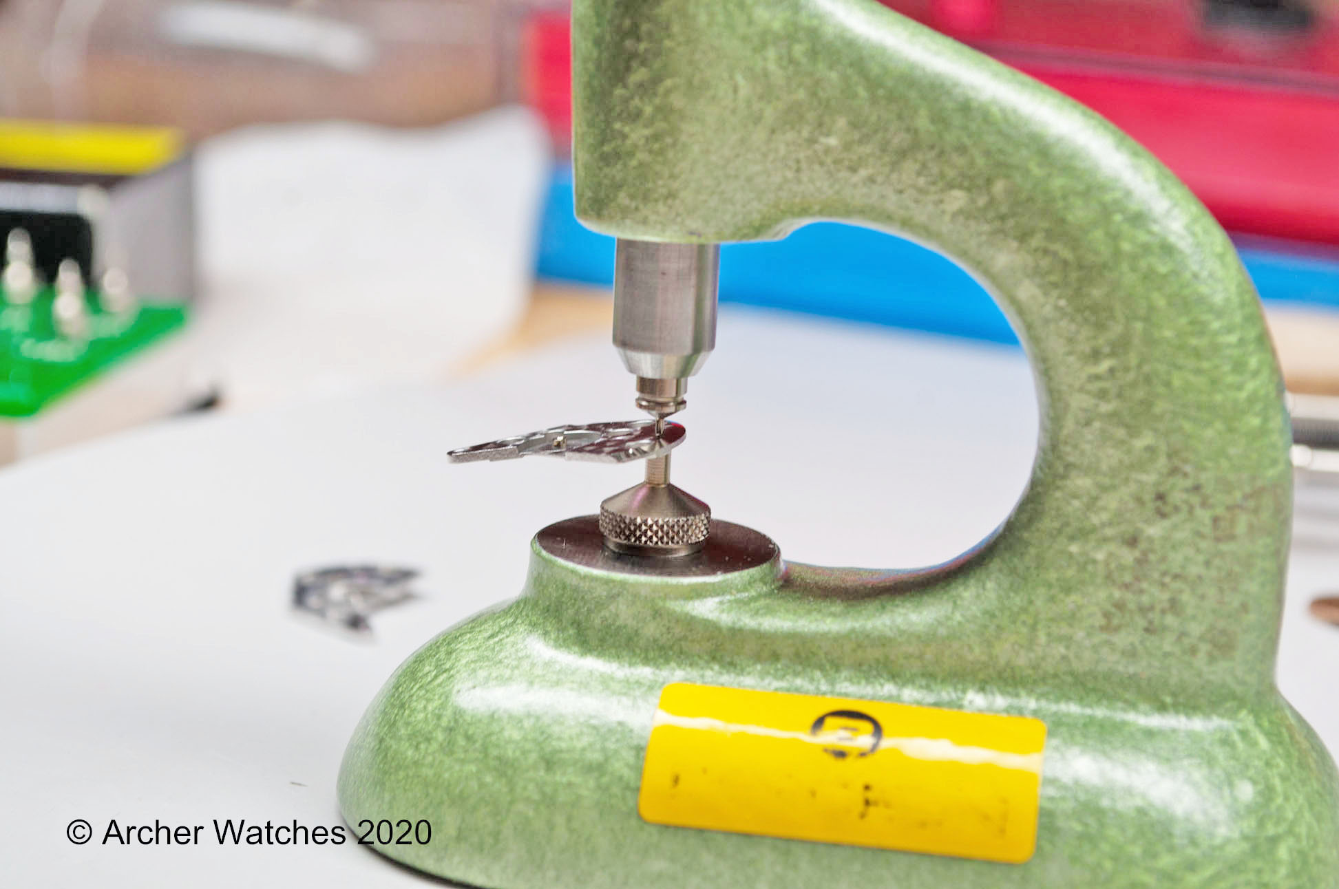

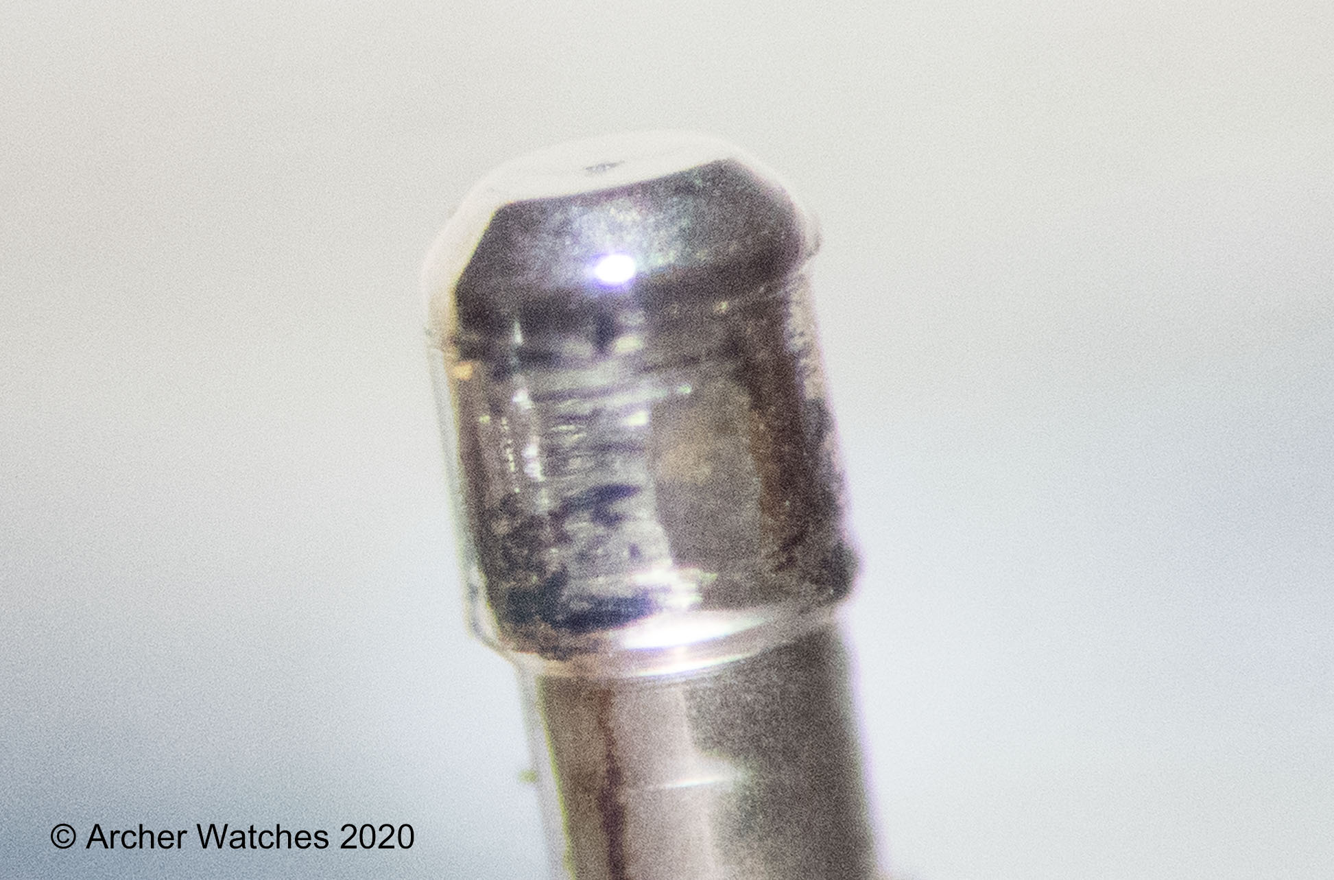

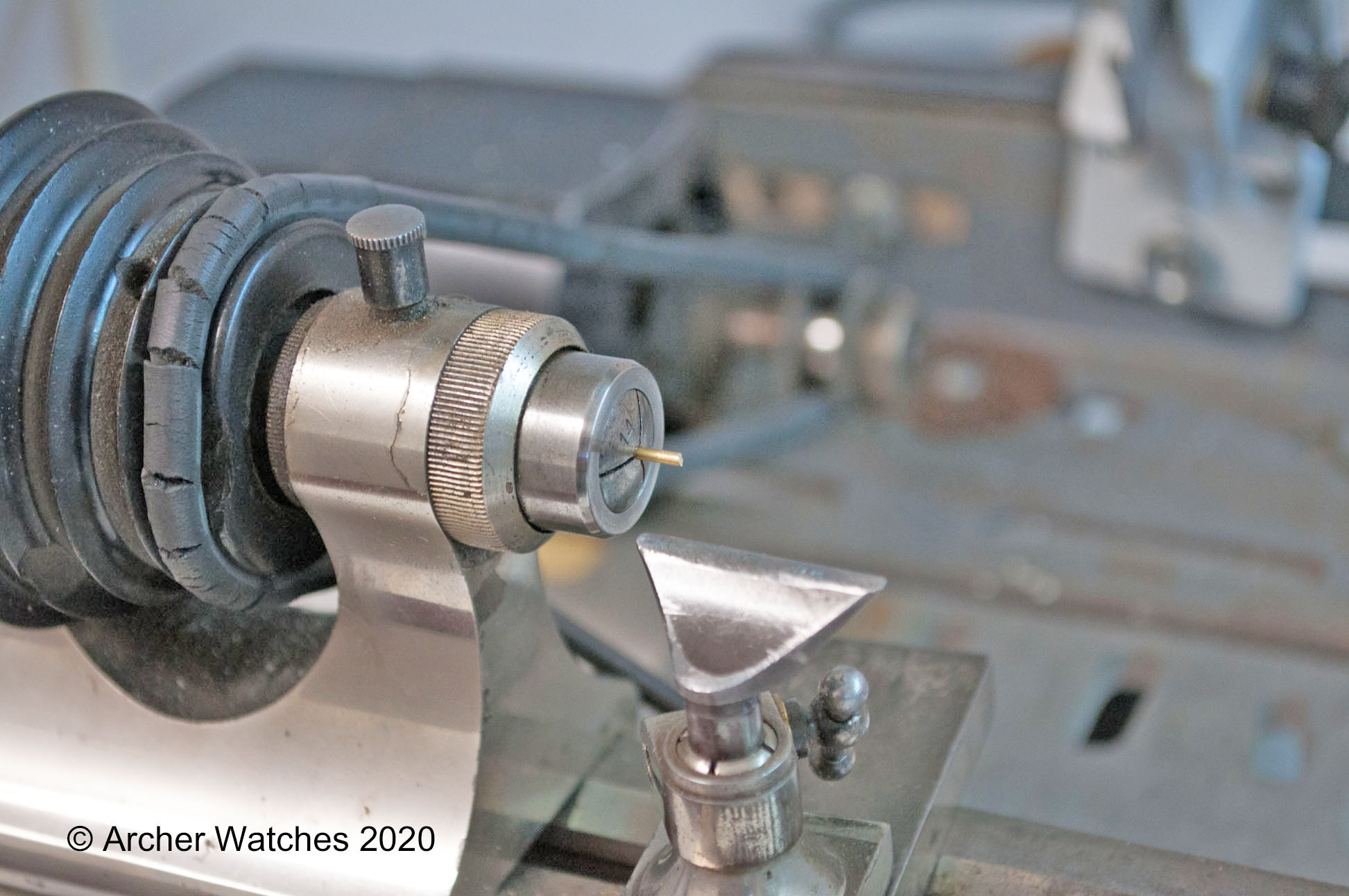

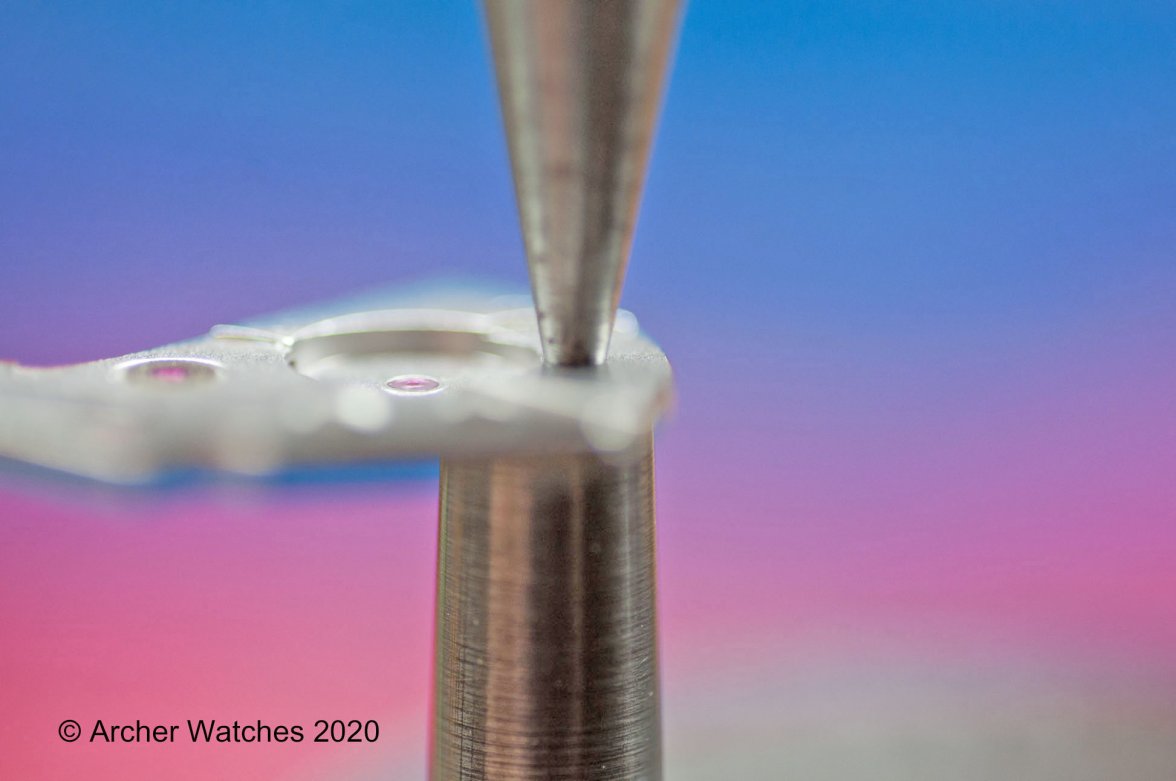

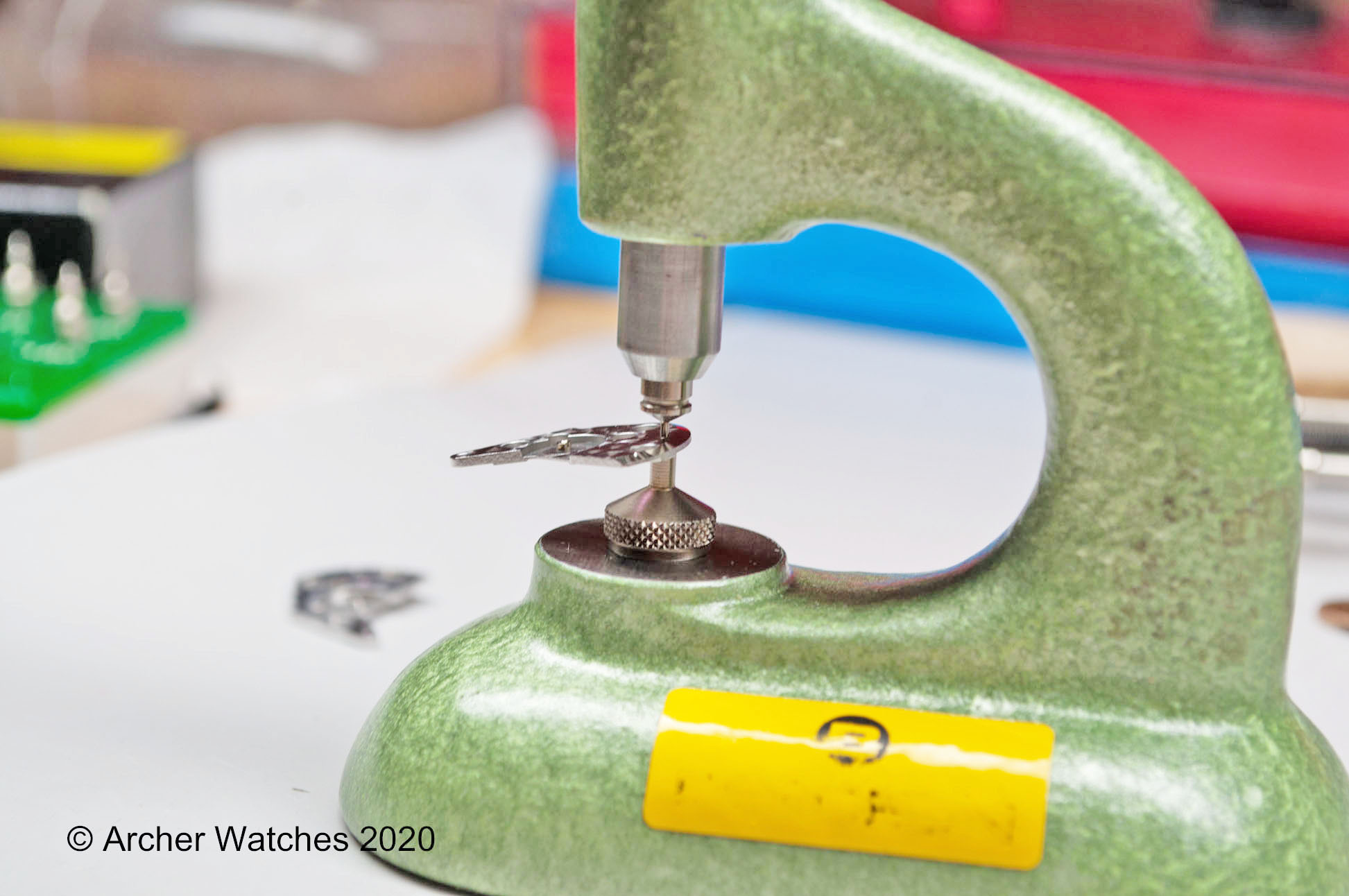

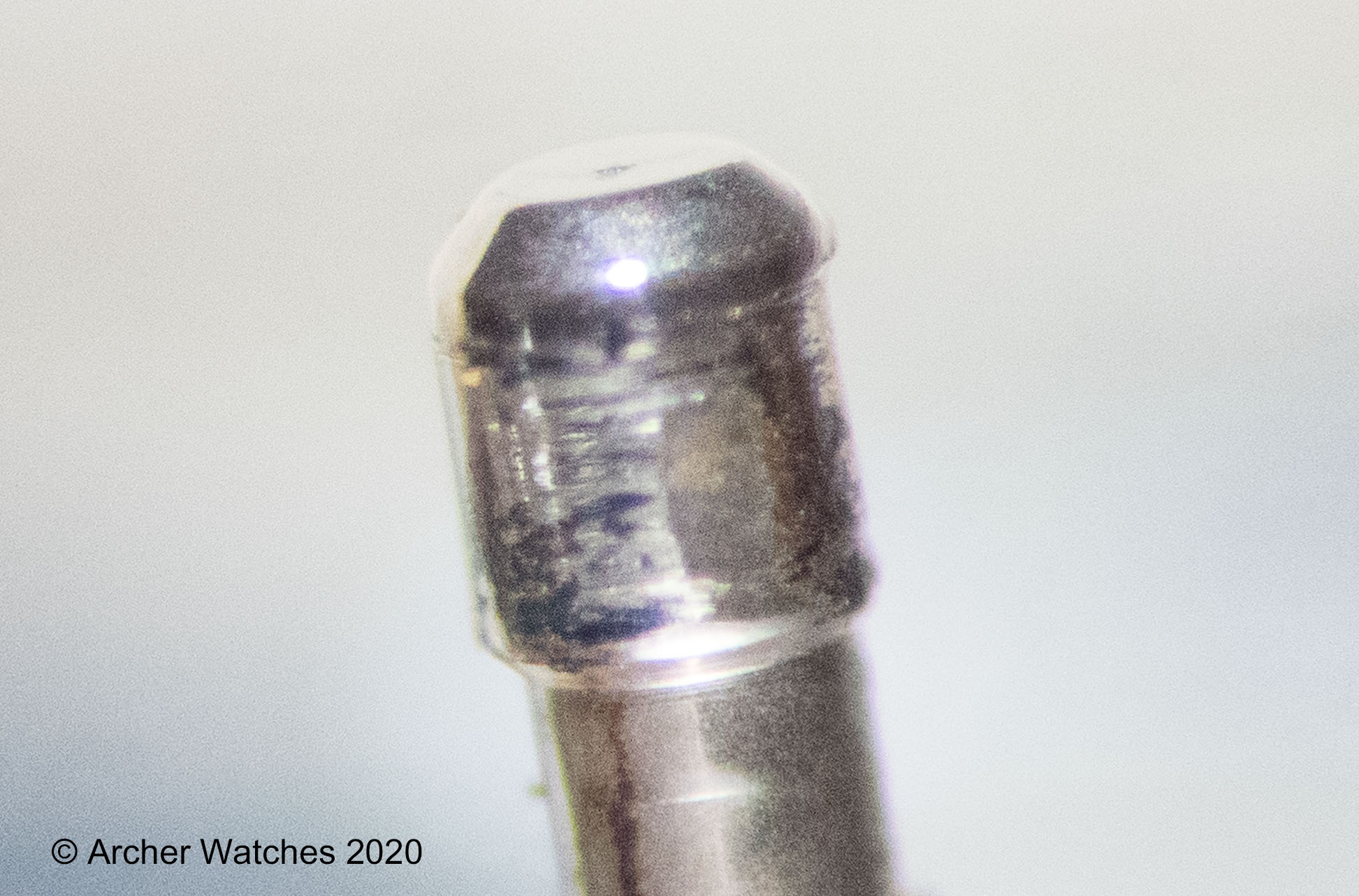

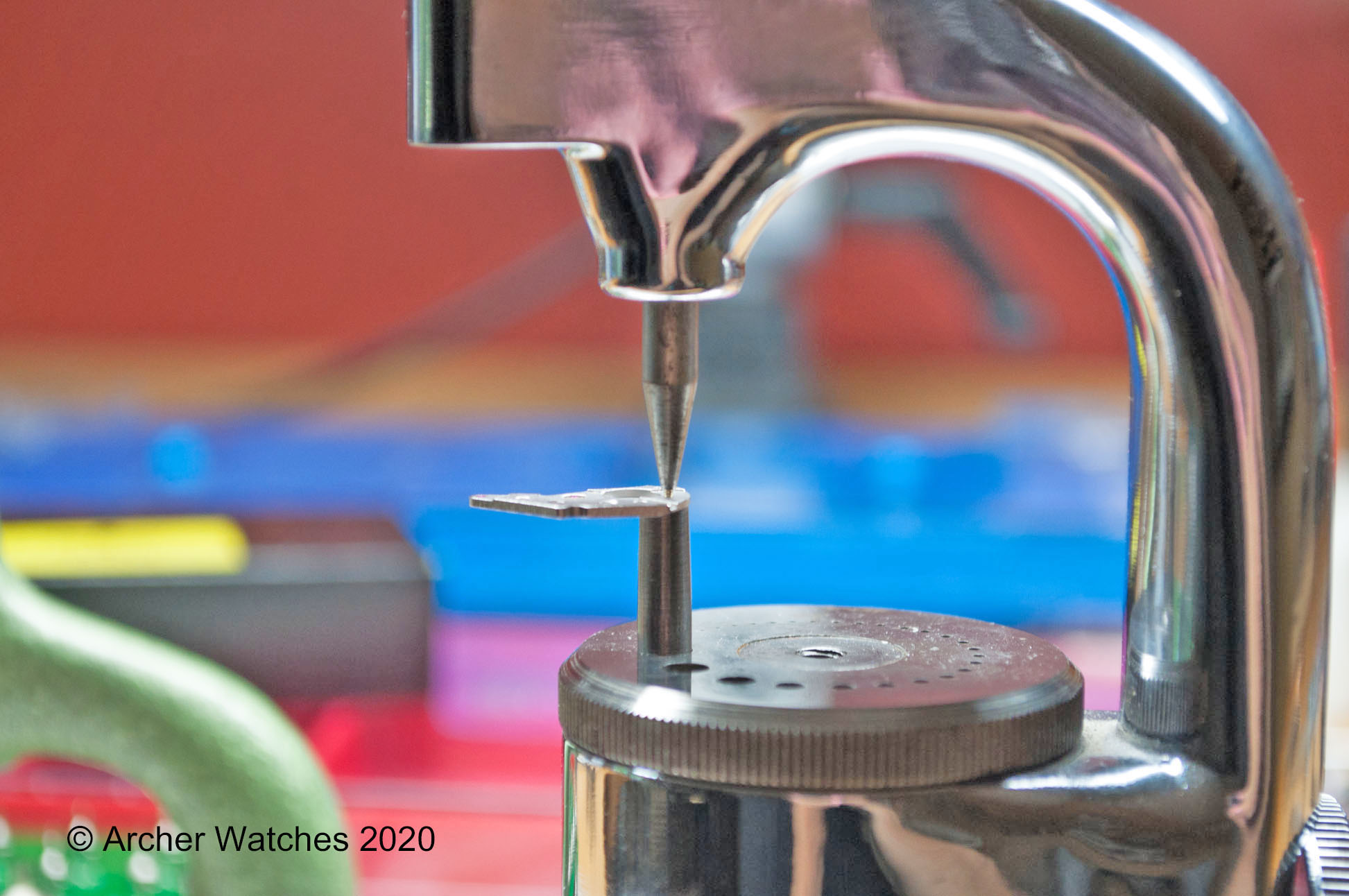

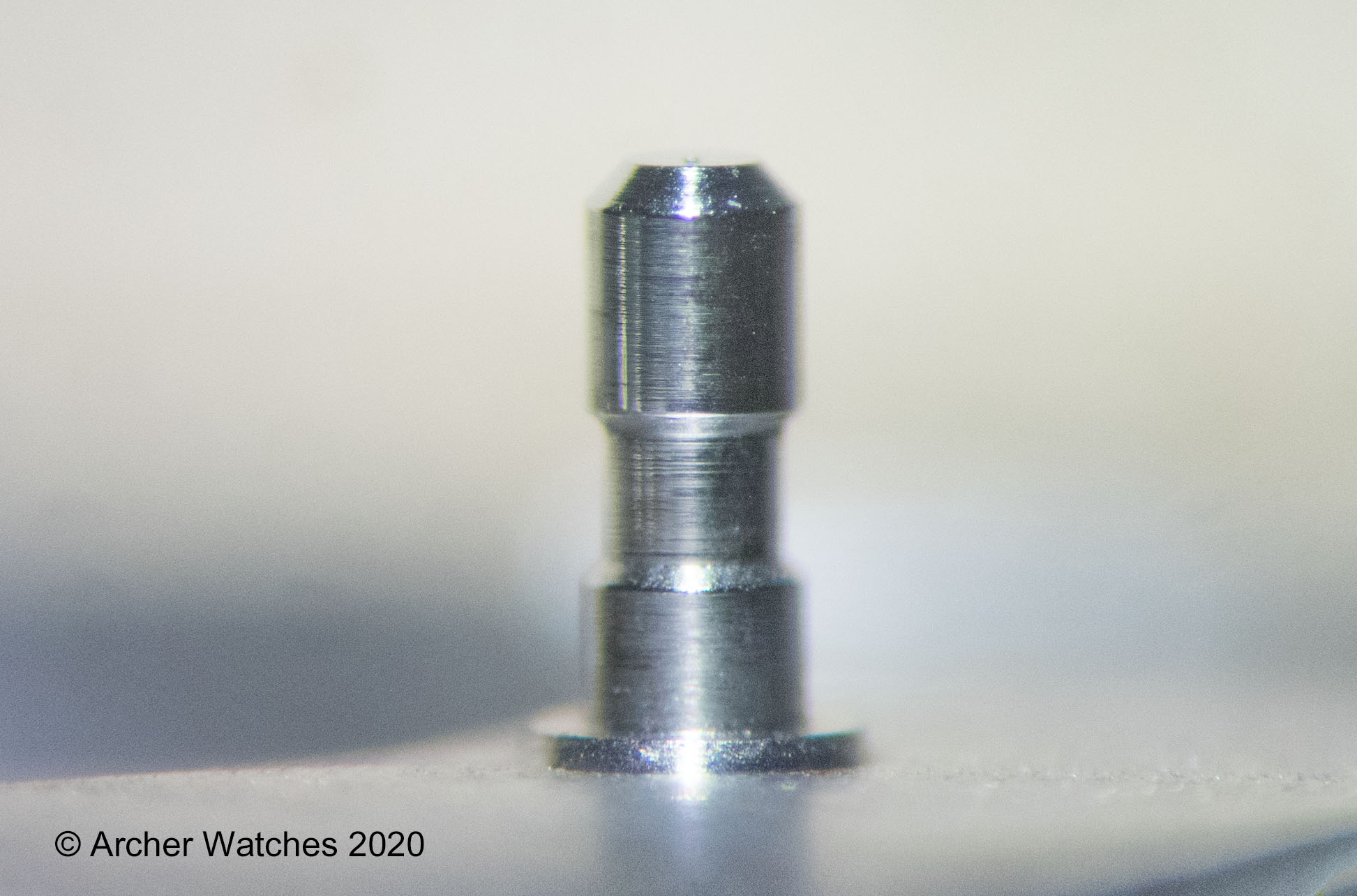

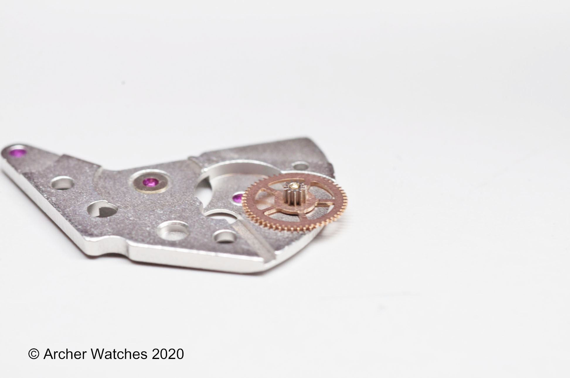

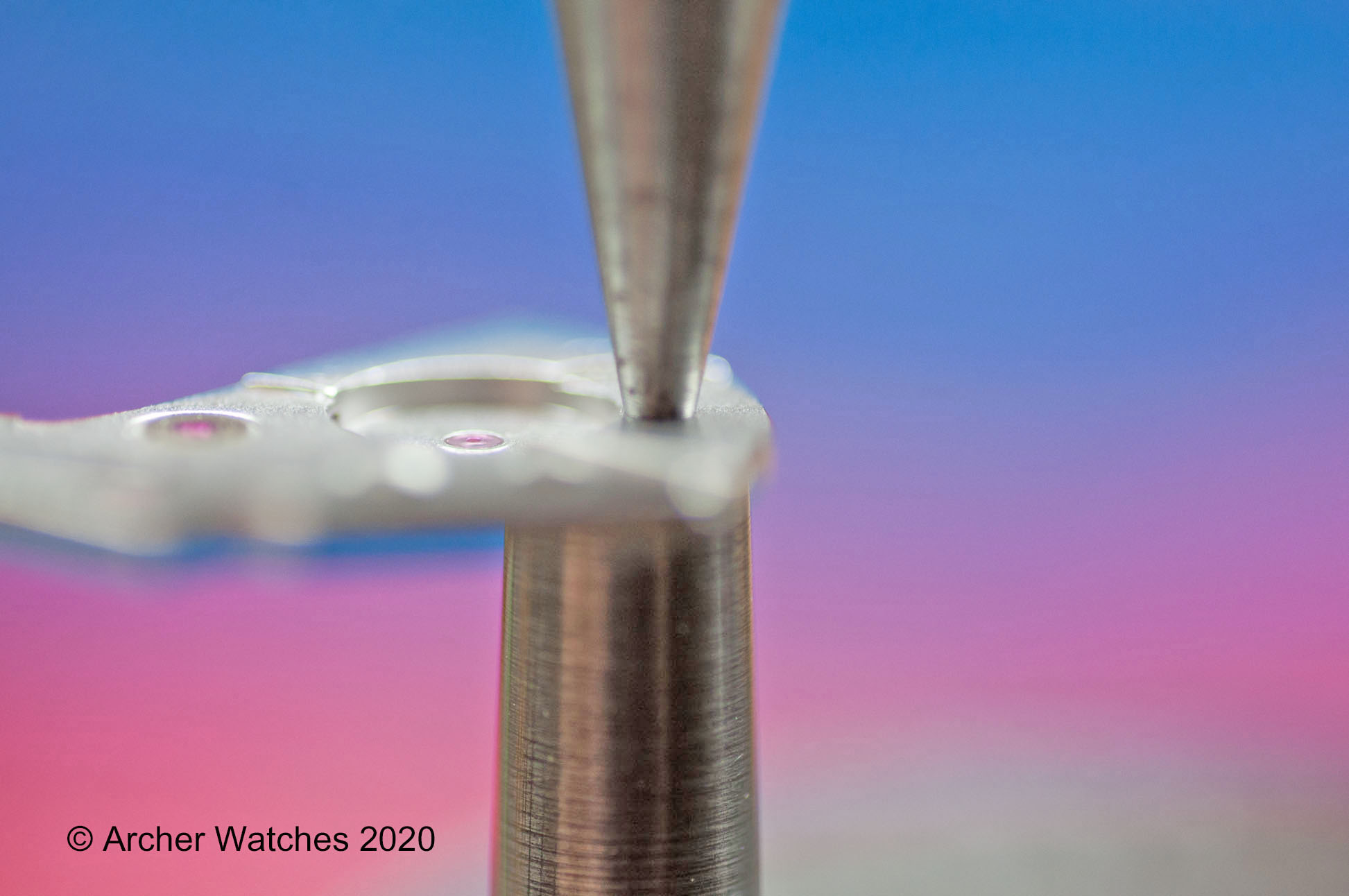

I'll do simple things - for example I just repaired the automatic bridge on an ETA 7753 - this post was worn pretty badly:
This should look like this (this is from a new bridge):

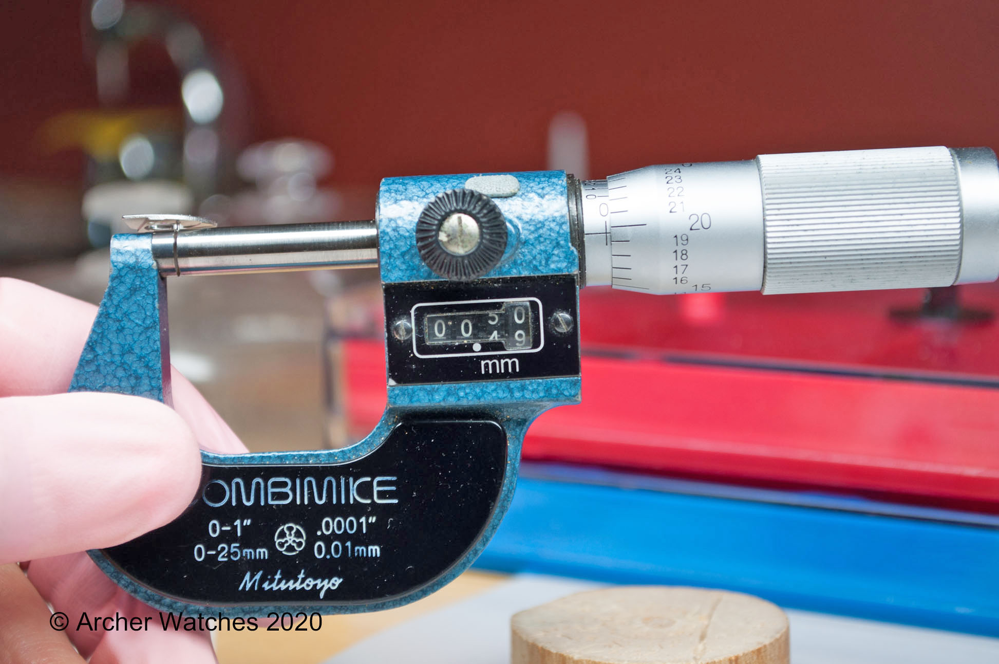

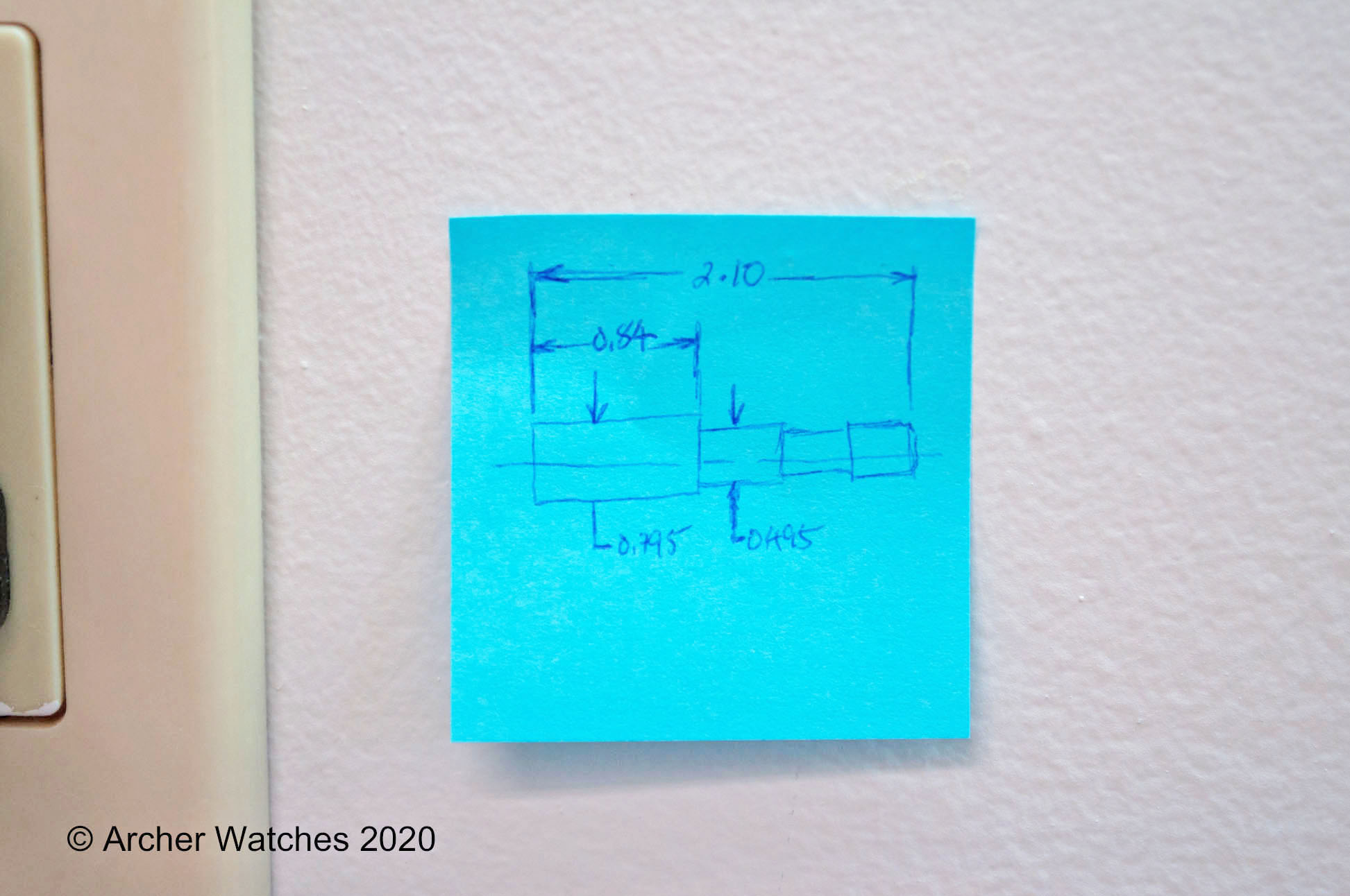

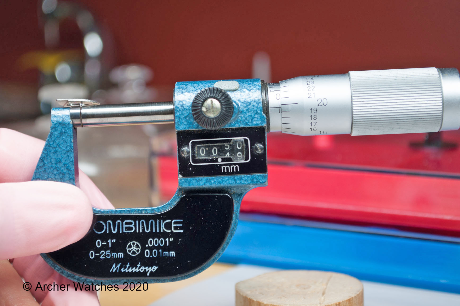

This post is not sold separately, and a new bridge is around $250. So I measured the diameter of the new one:

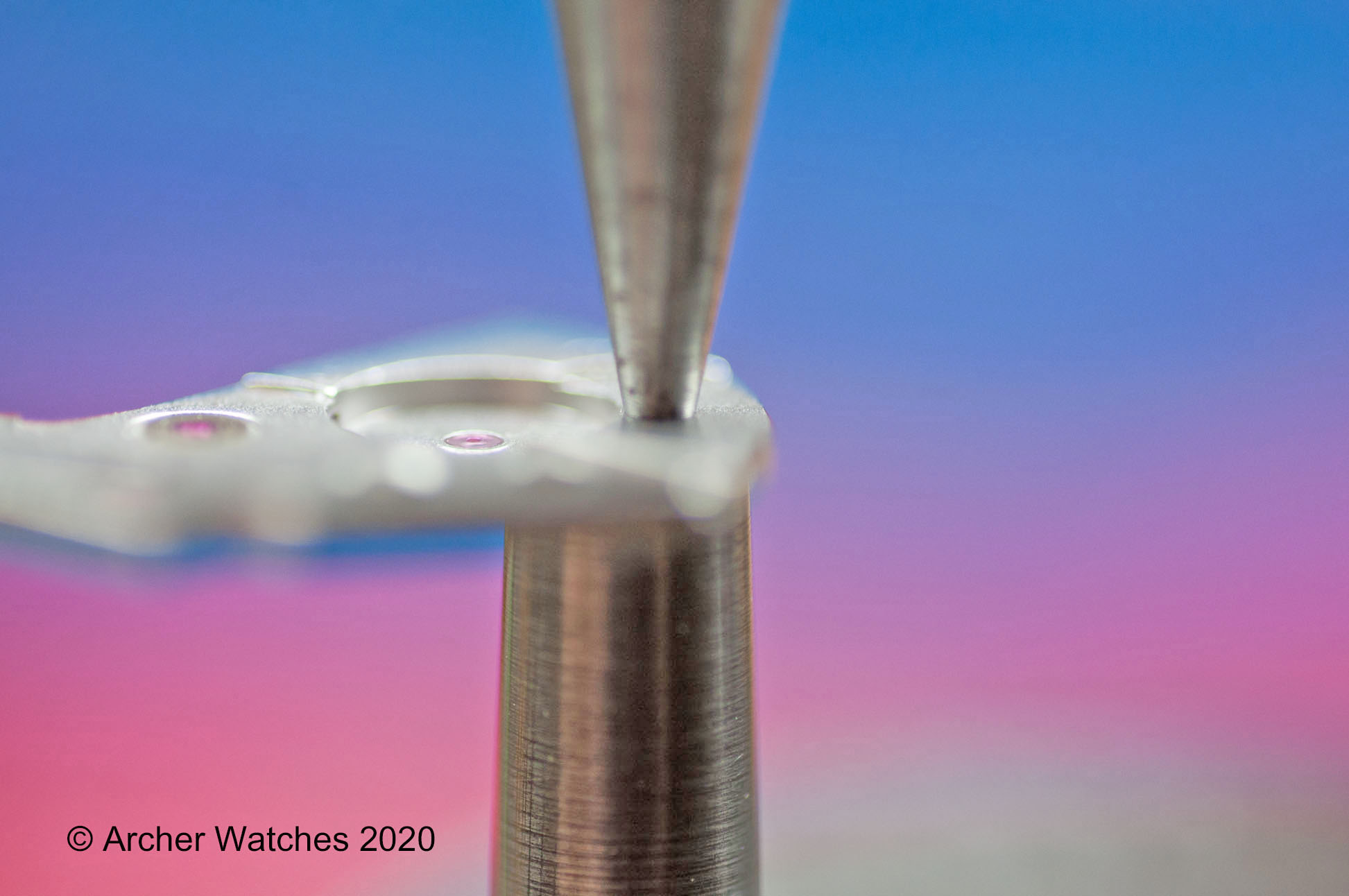

Pressed the old one out:

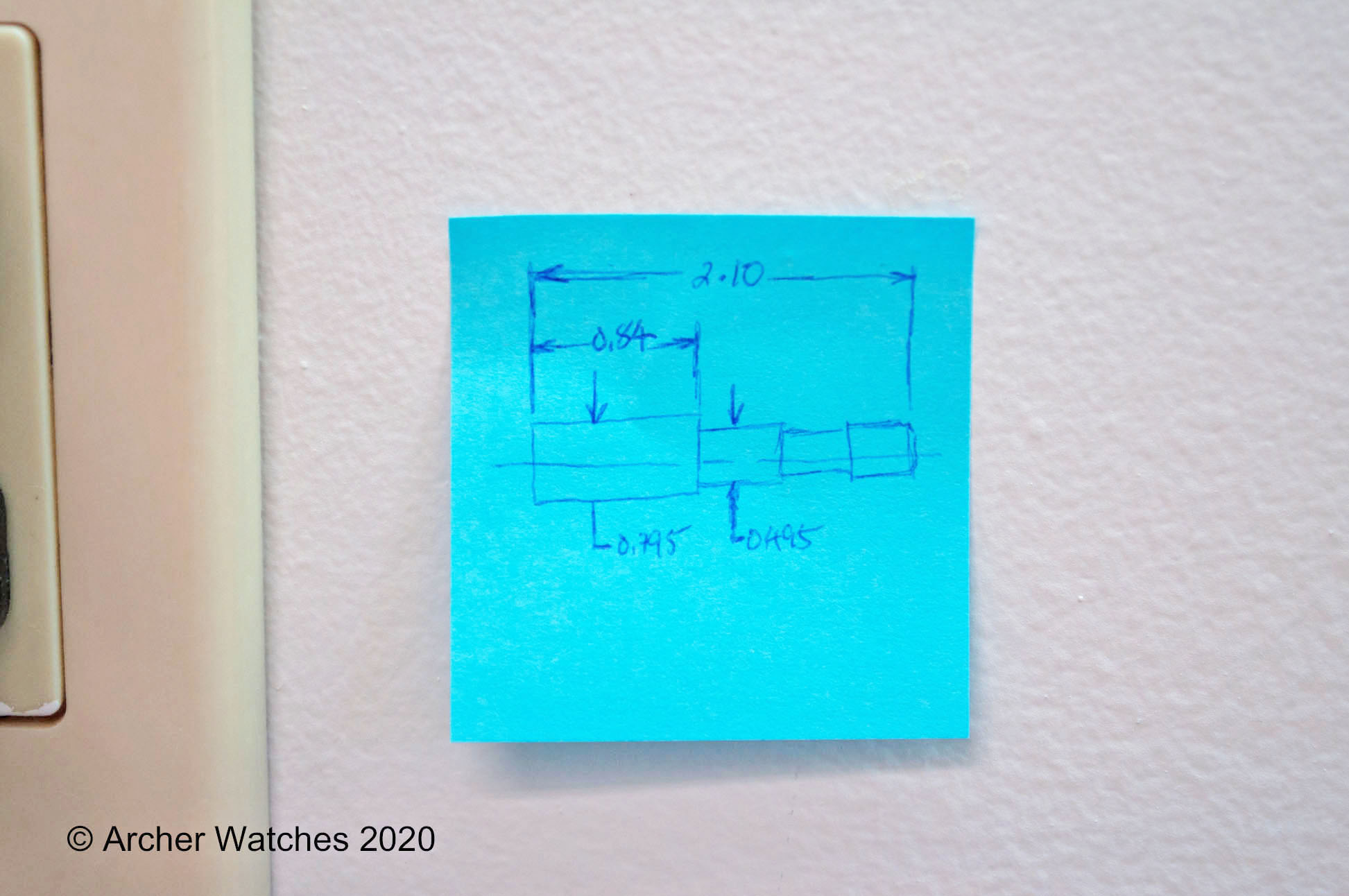

Made a sketch:

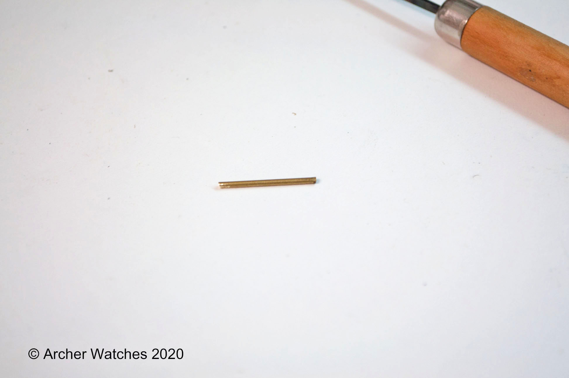

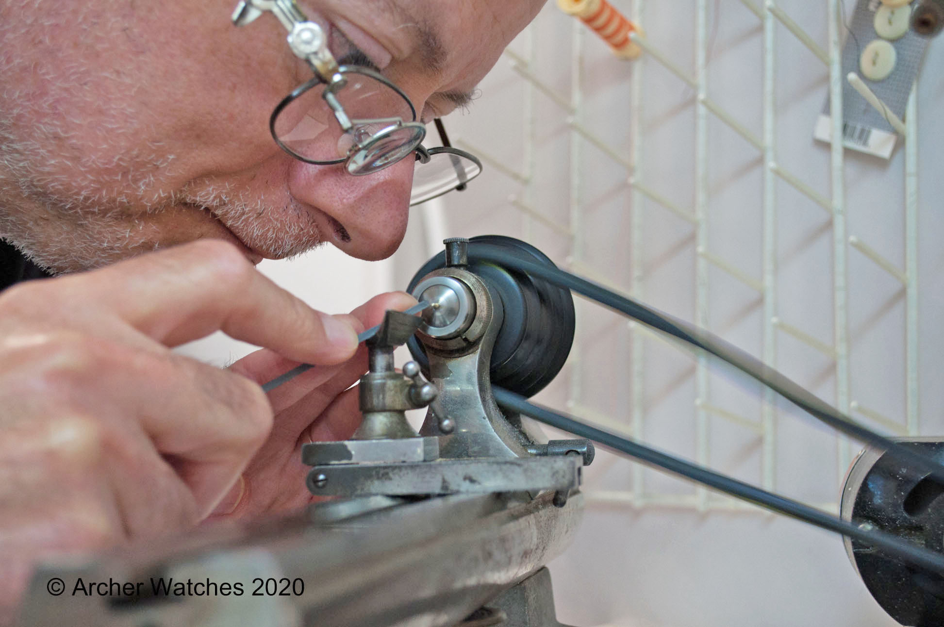

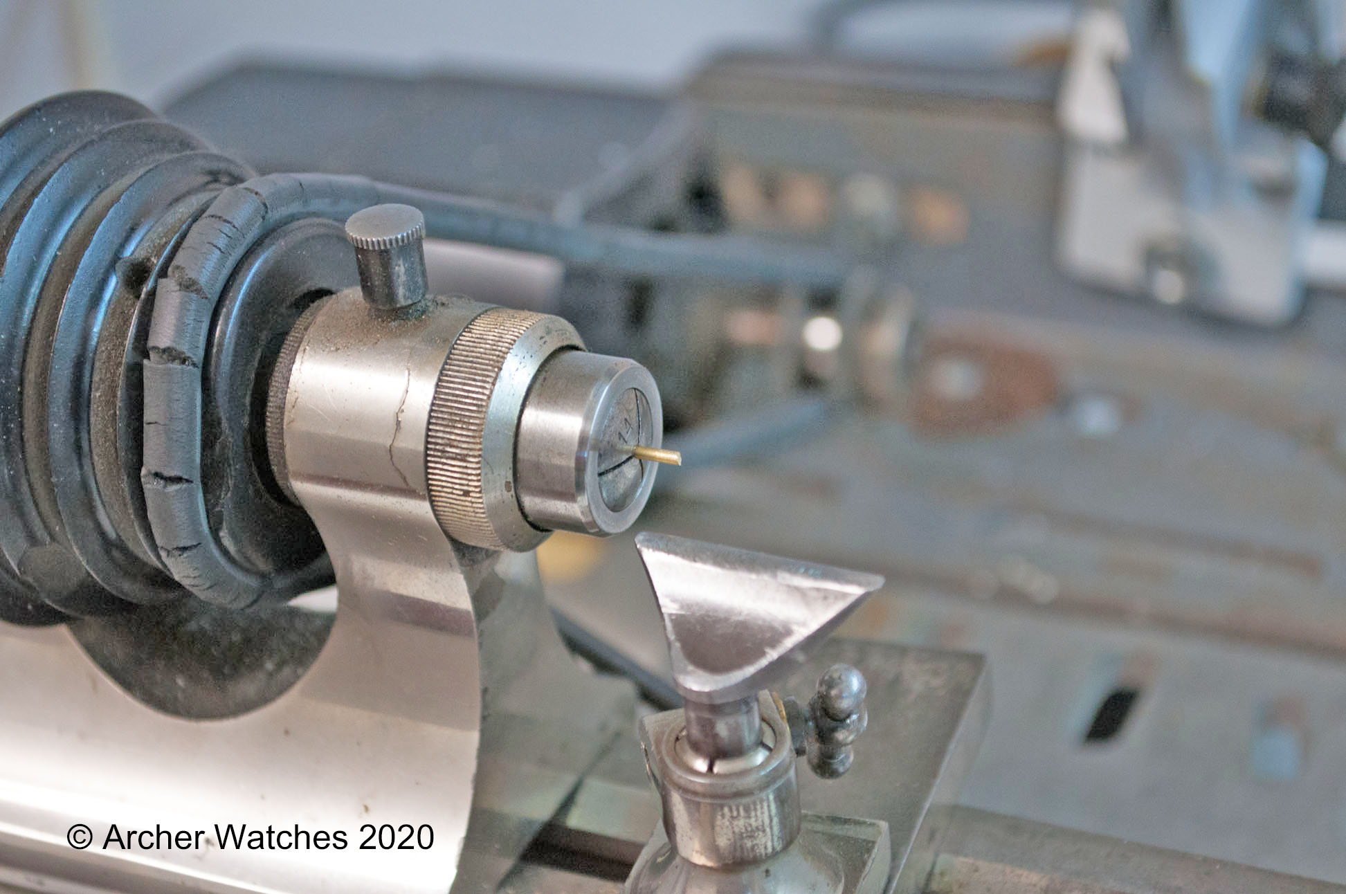

Off to the lathe - stock I used:

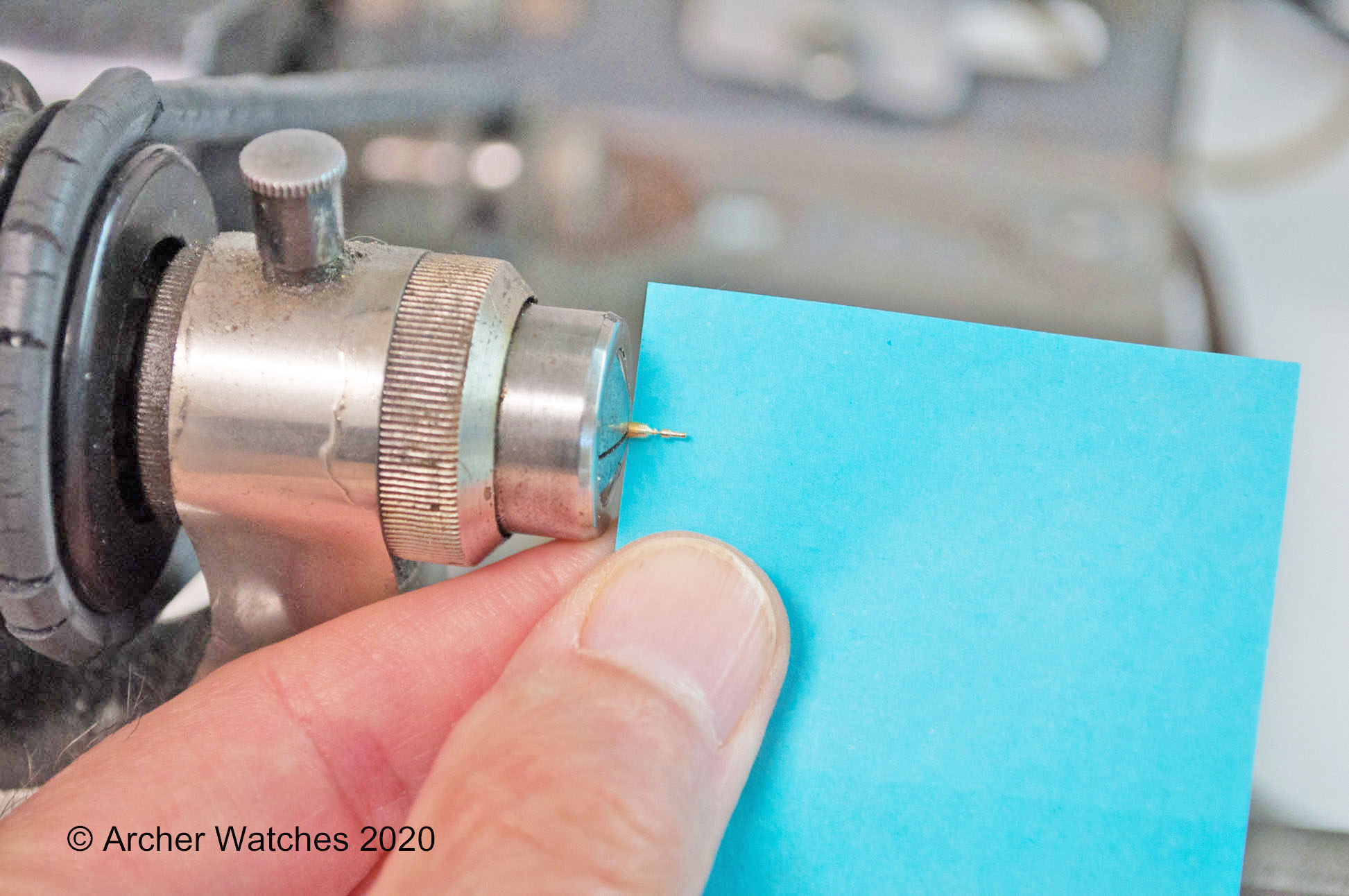

Turning:

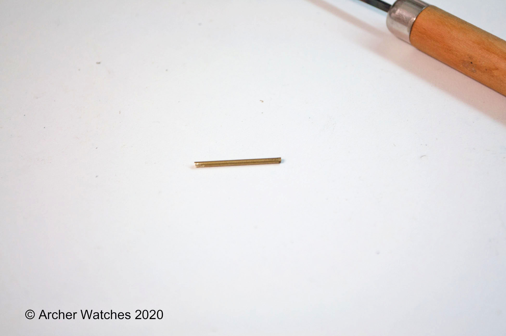

About to cut it off:

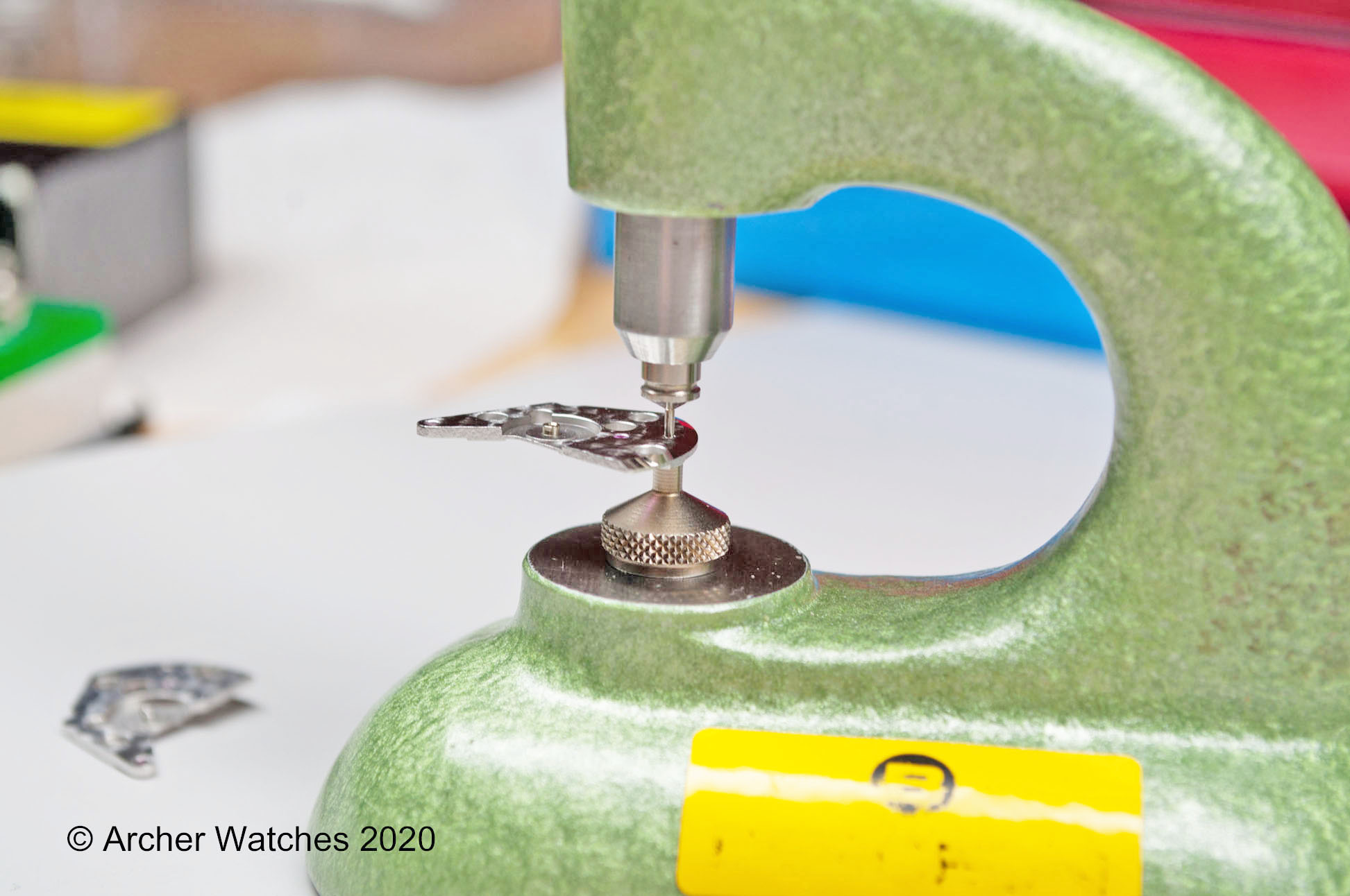

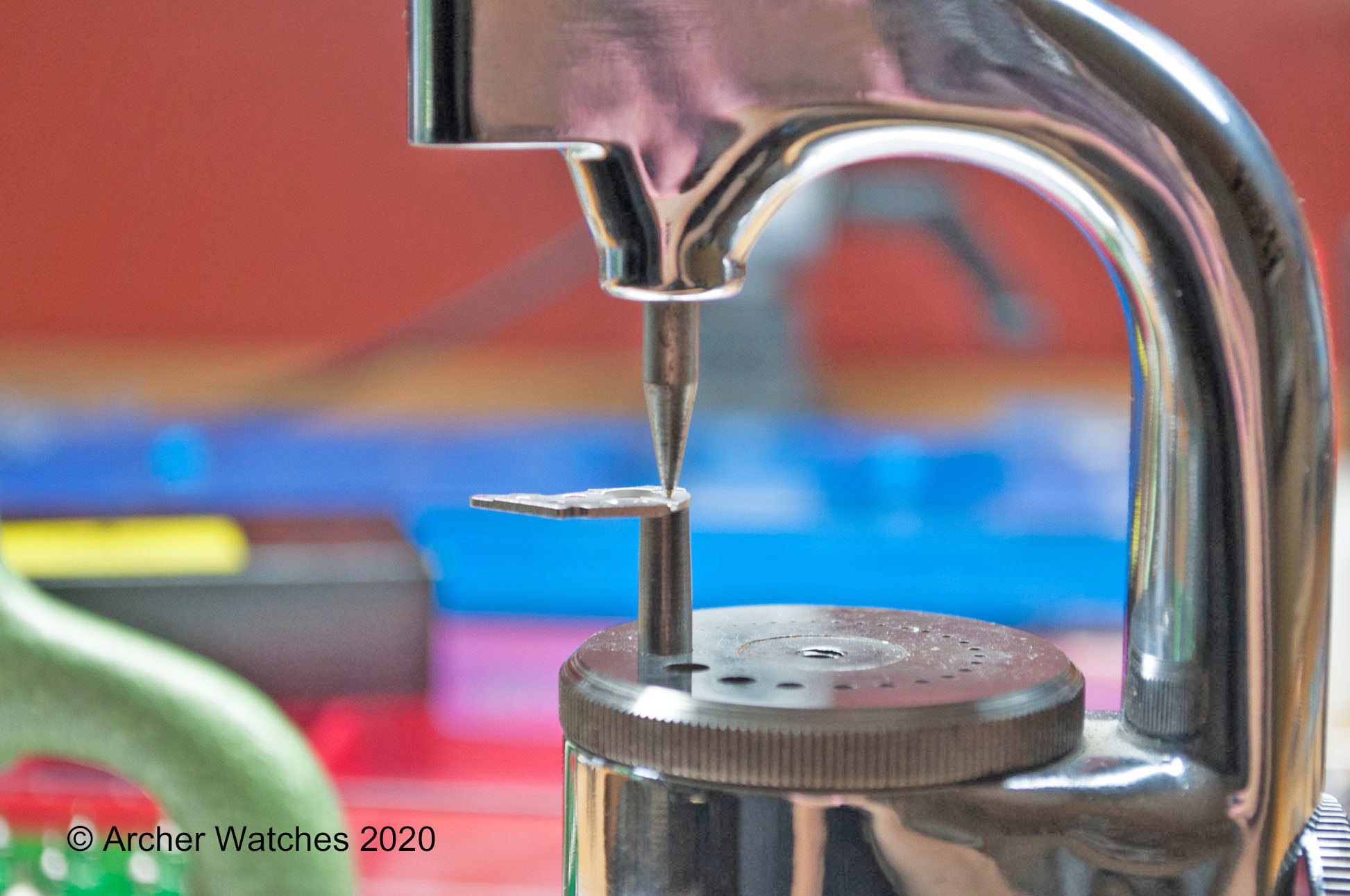

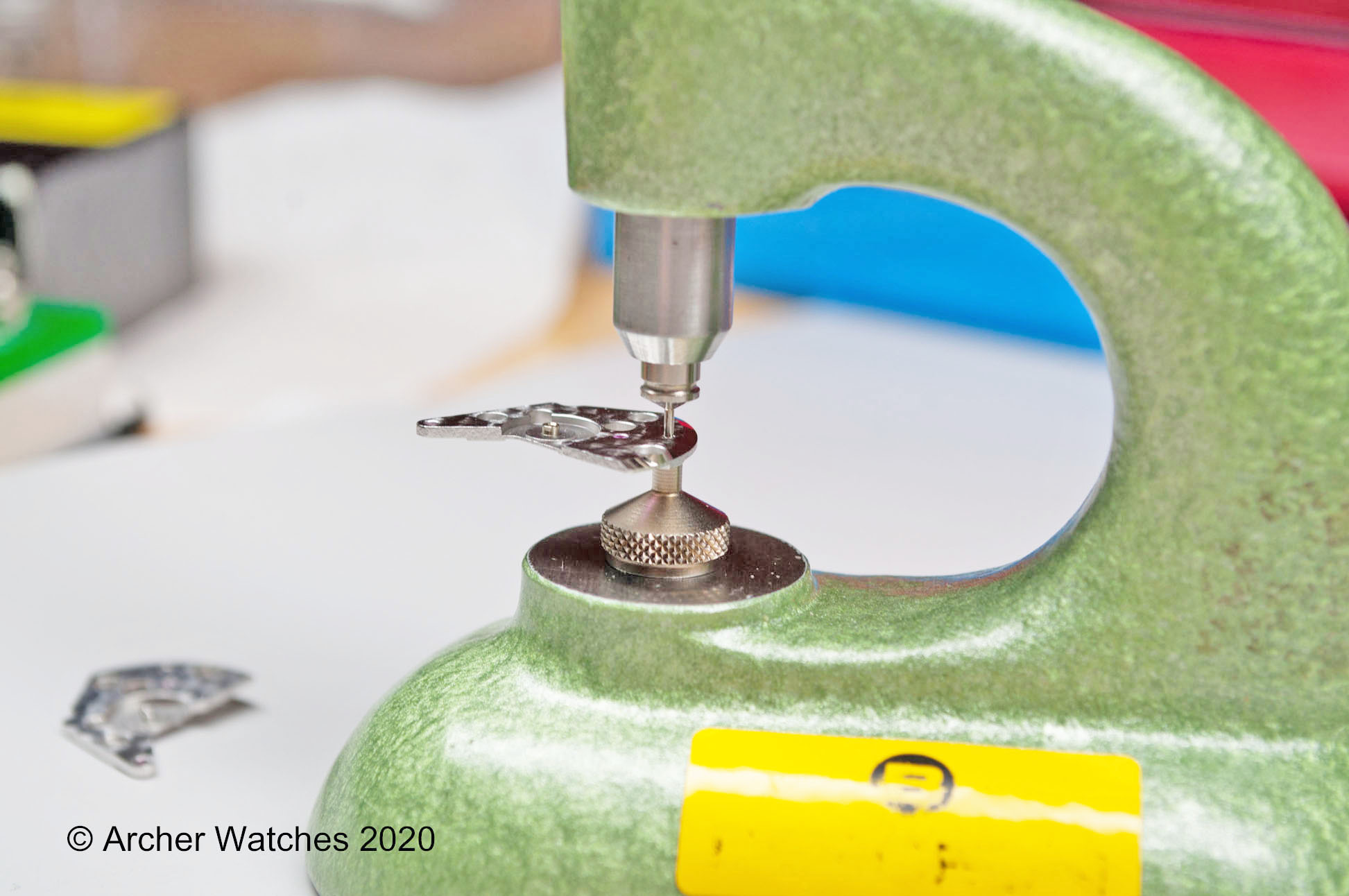

Pressing the new post into the bridge:

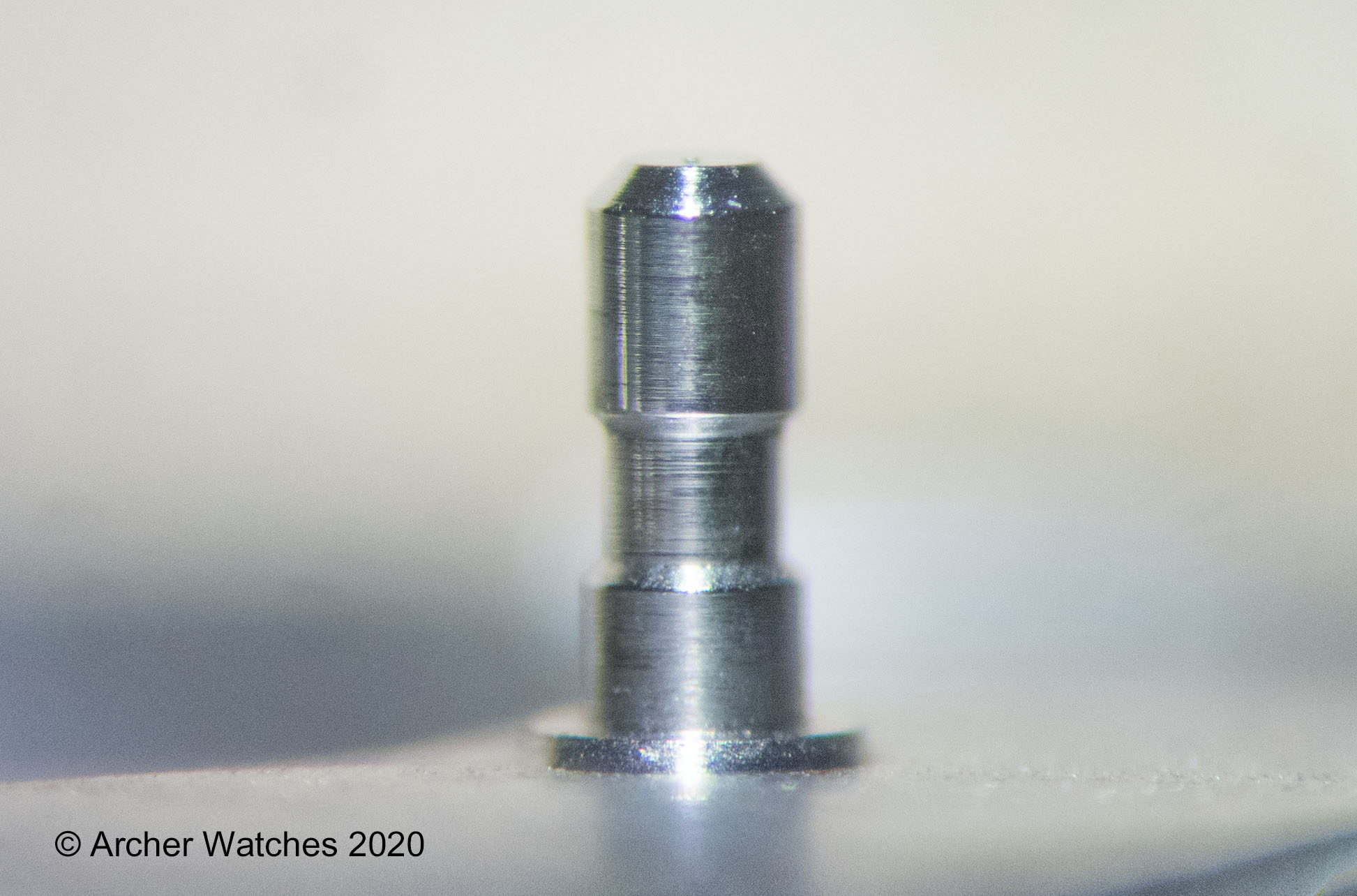

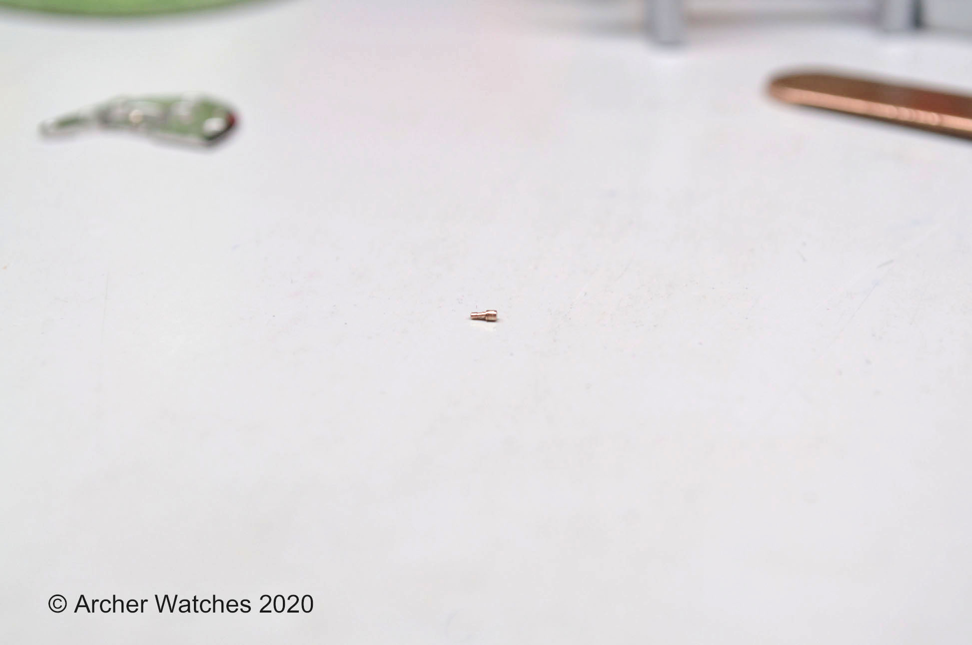

Done:
I'll charge some labour for this, but it saves the watch owner $200 in the end.
This wasn't really "necessary" as I could have just bought and installed a new bridge, and surely this is what I service center would have done. But I try not to be just a parts swapper, even though brands often make it difficult to be anything but that. I will often repair things that brands would simply replace.
Cheers, Al
