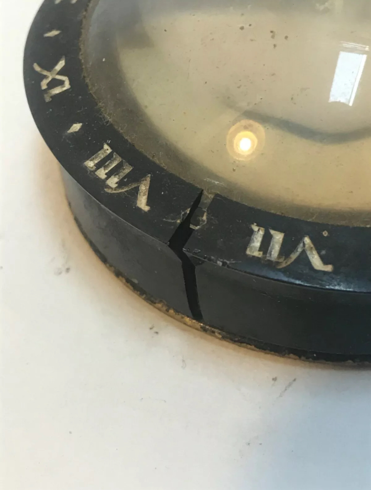

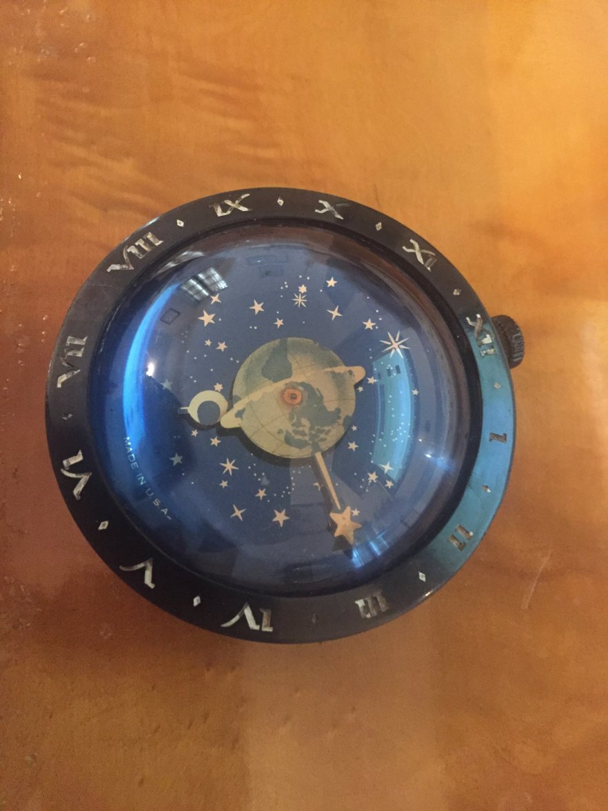

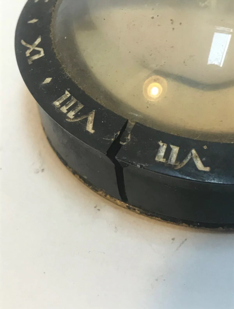

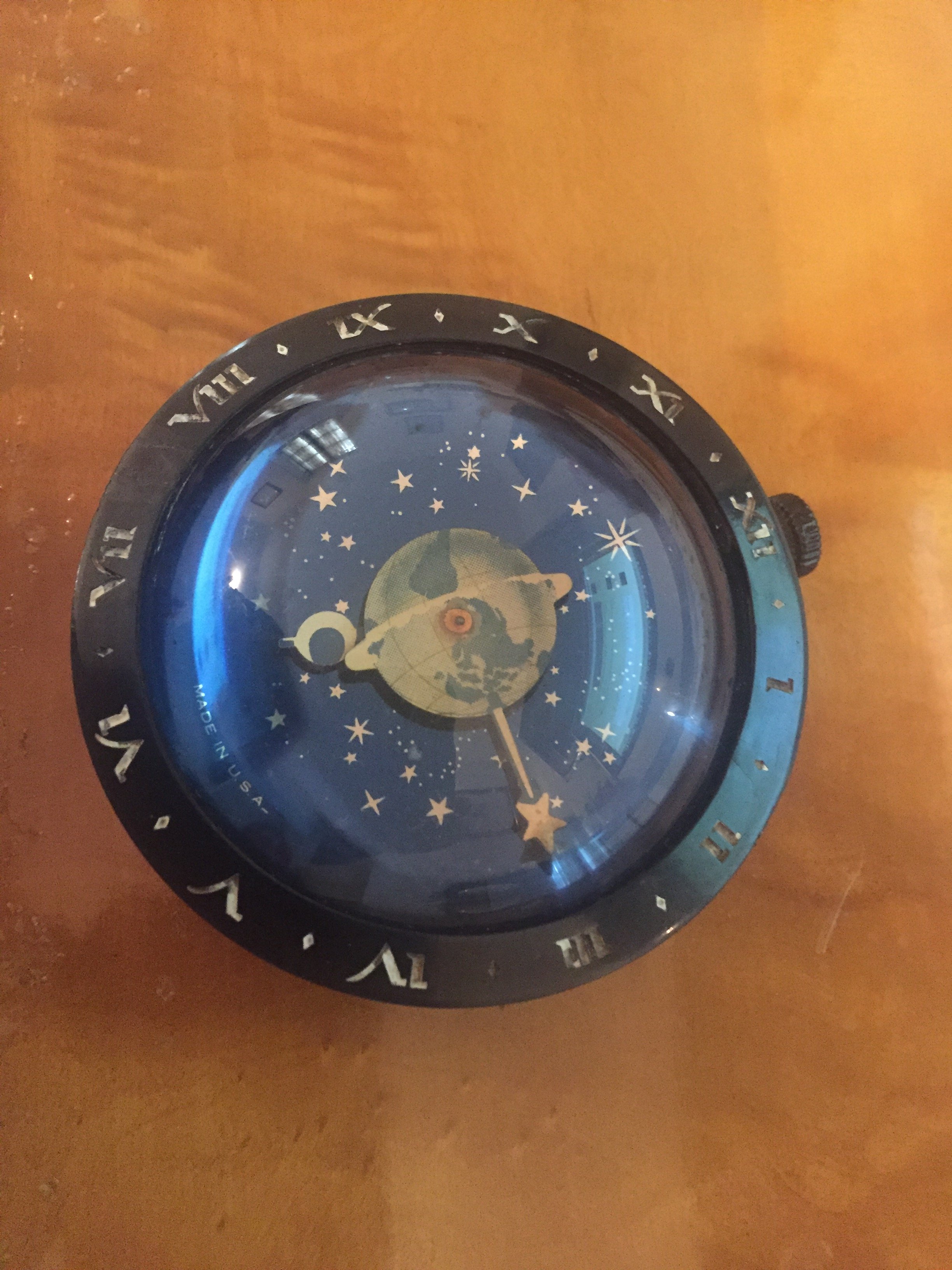

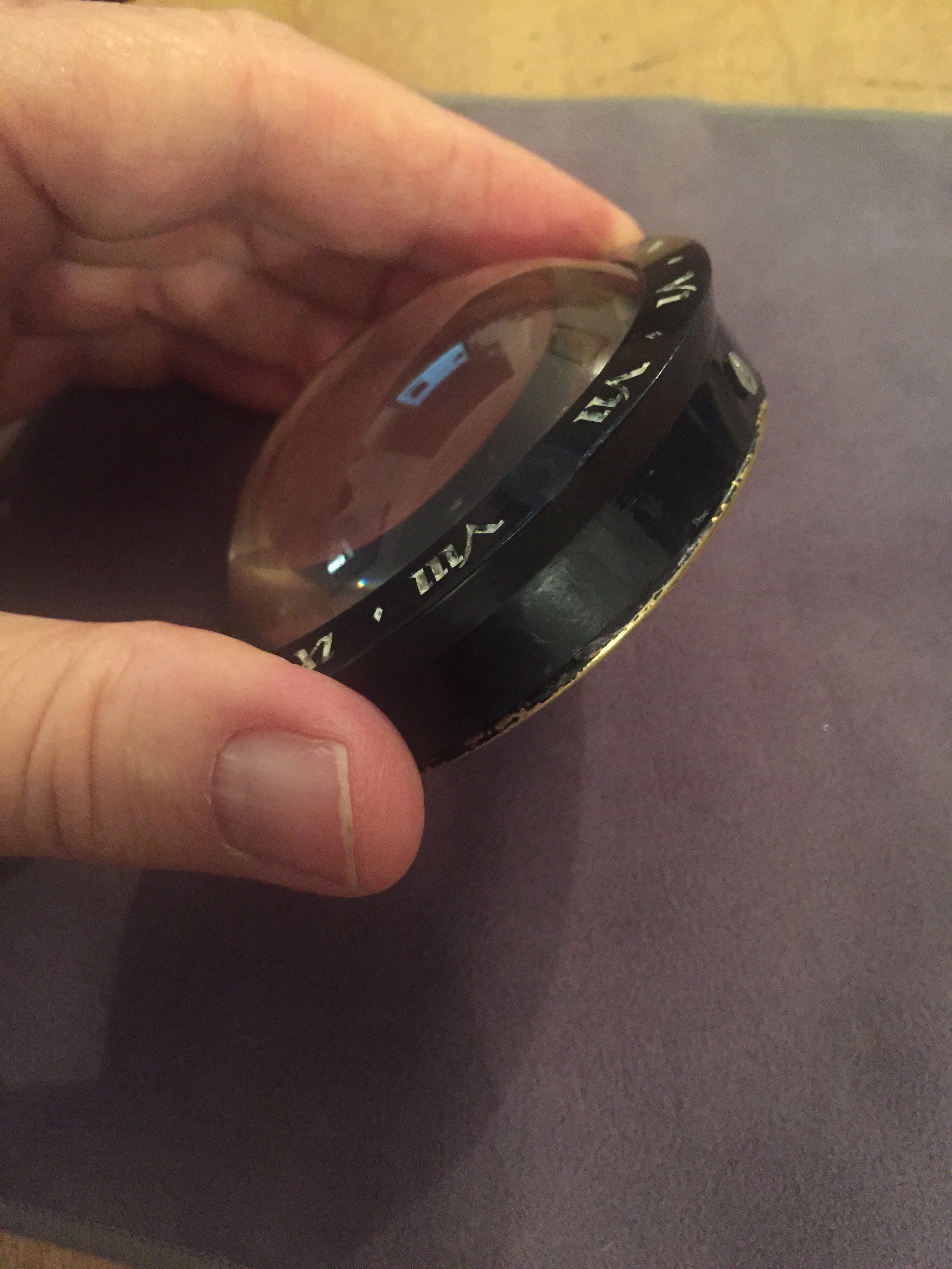

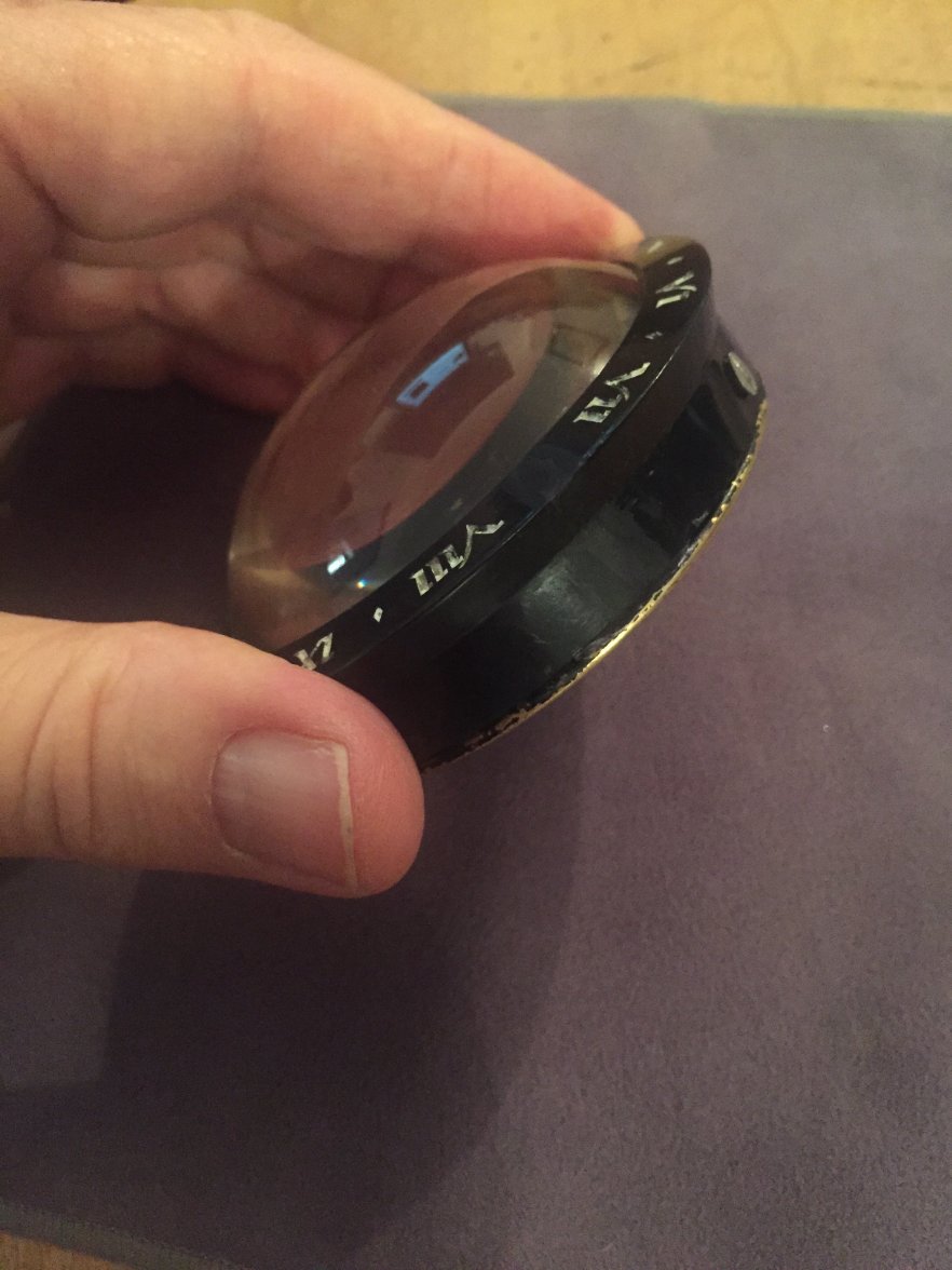

I bought one a few weeks ago in excellent condition, but I saw another recently that needed some work. With the pandemic and fires raging, I had time on my hands. The movement just needed a little oil, the Bakelite base would present more of a challenge. Matching the finish and color of 80 year old Bakelite proved difficult. I used epoxy resin, blended in some coloring, and polished and finished with an electric hand drill using sand paper discs of varying grit with a touch of Brasso. Now, just need to apply a satin varnish coat to the repaired area which should darken color and match finish.
Westclox Celestial Clock Paperweight circa 1936 - 1938
As purchased:

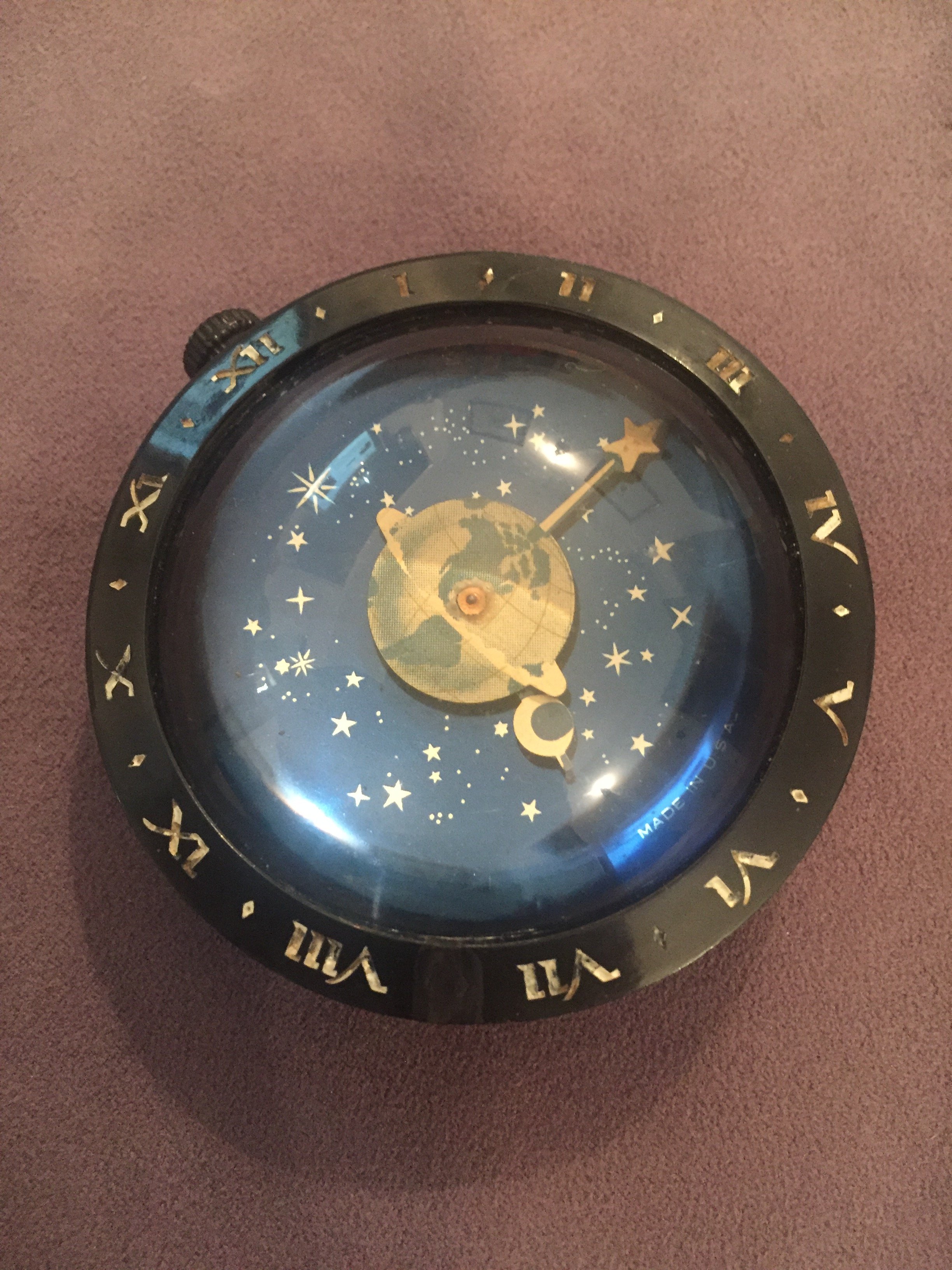

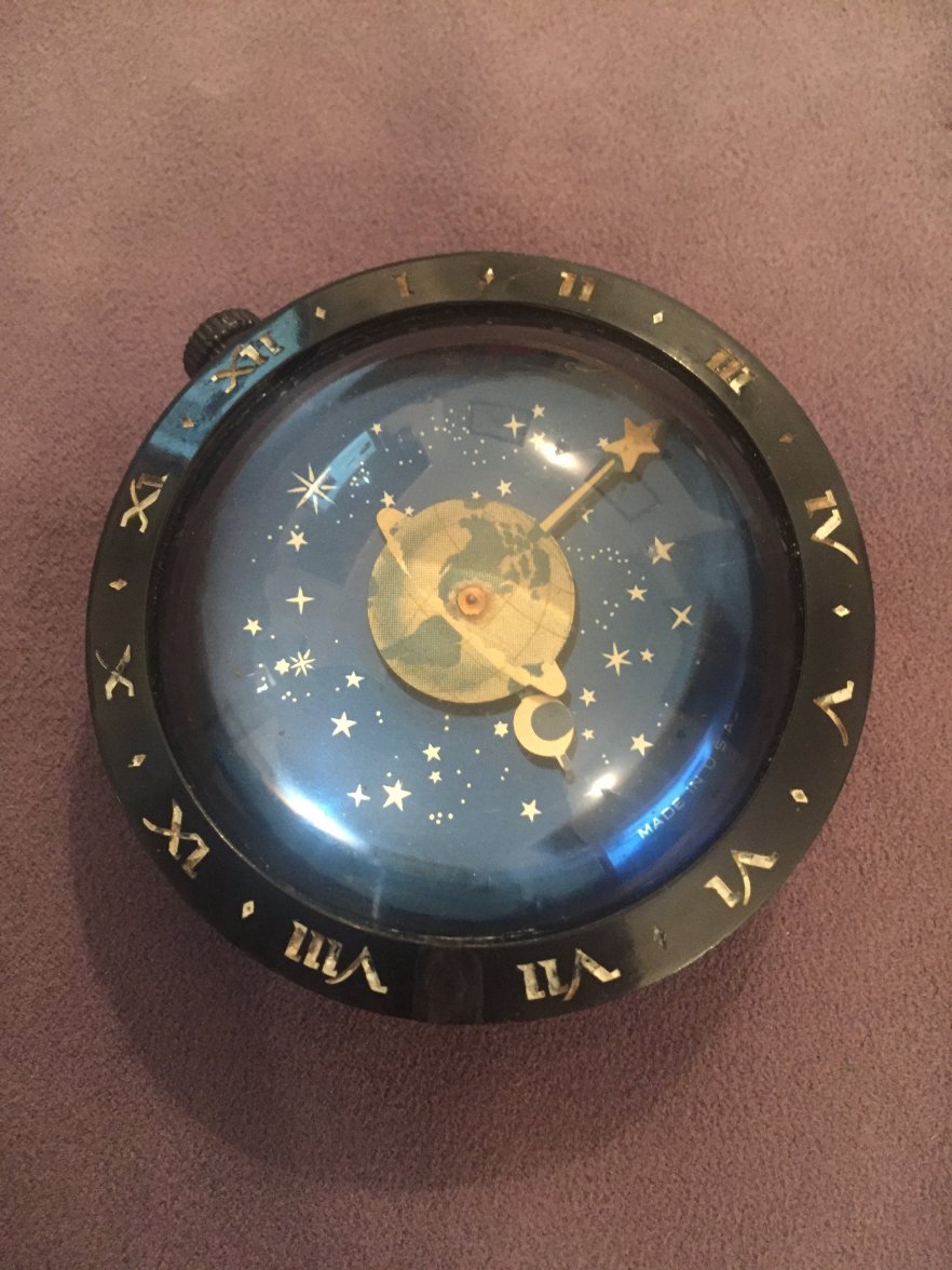

After Repair Pre- Varnish

Very nice work, and thanks for the details.
Thank you. Bakelite is notoriously difficult to repair especially if there is a chunk missing from a conspicuous part. Most just repaint after the repair is done, but, paint doesn't always stick to bakelite. From a foot away, I can't tell if there is a repair, but my OCD may get the better of me and I may continue to work on the base till when I use a 10x loupe.... it looks clean, well, maybe not.

Part of the difficulty is nothing looks like pressure-molded phenolic.
Not to mention the toxicity. Note to self... wear an N95 mask. I did.
