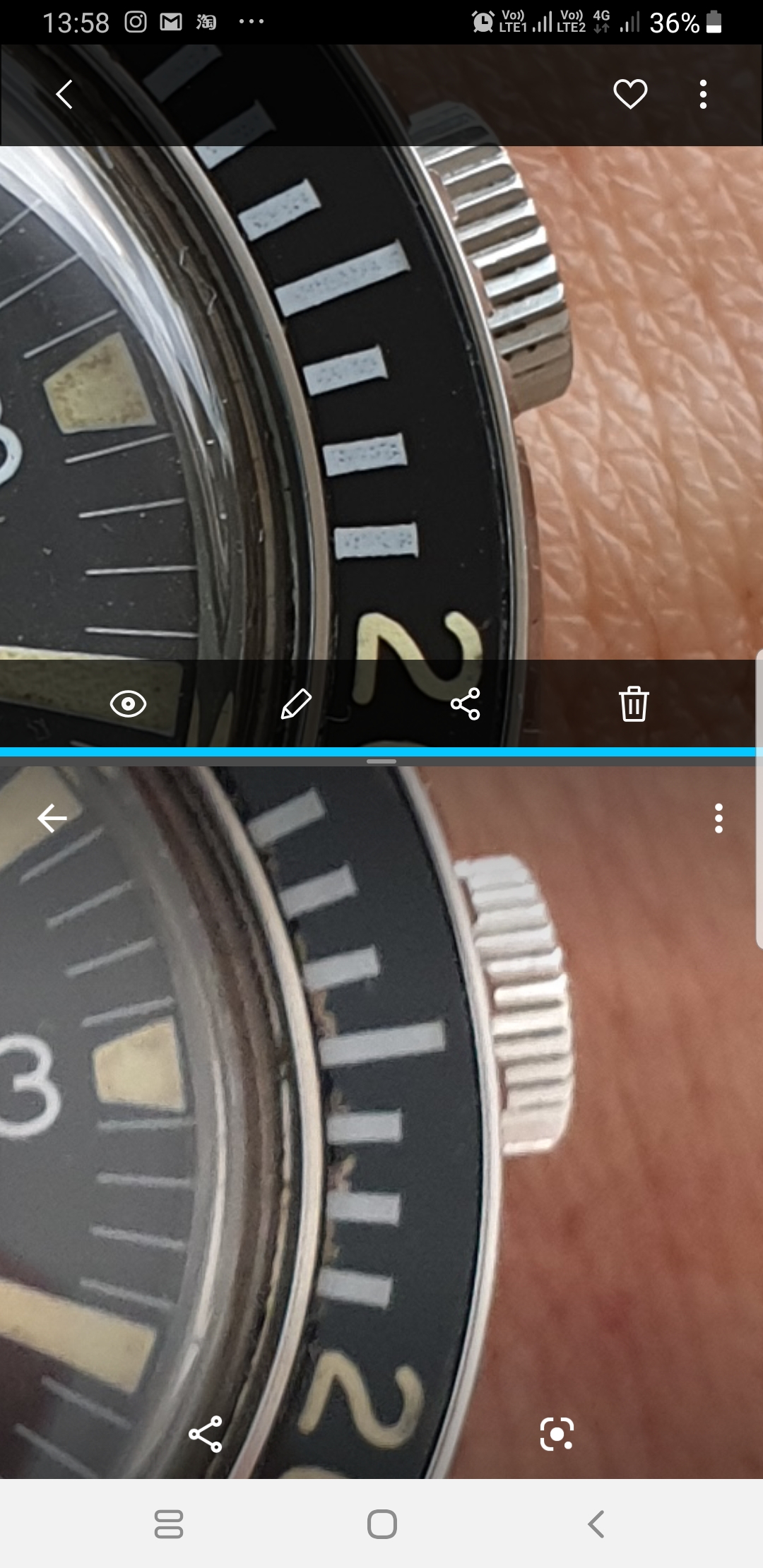

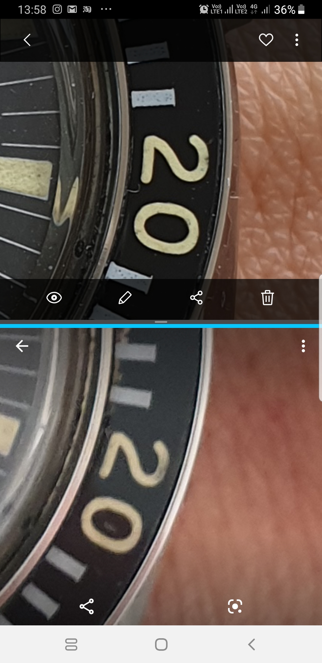

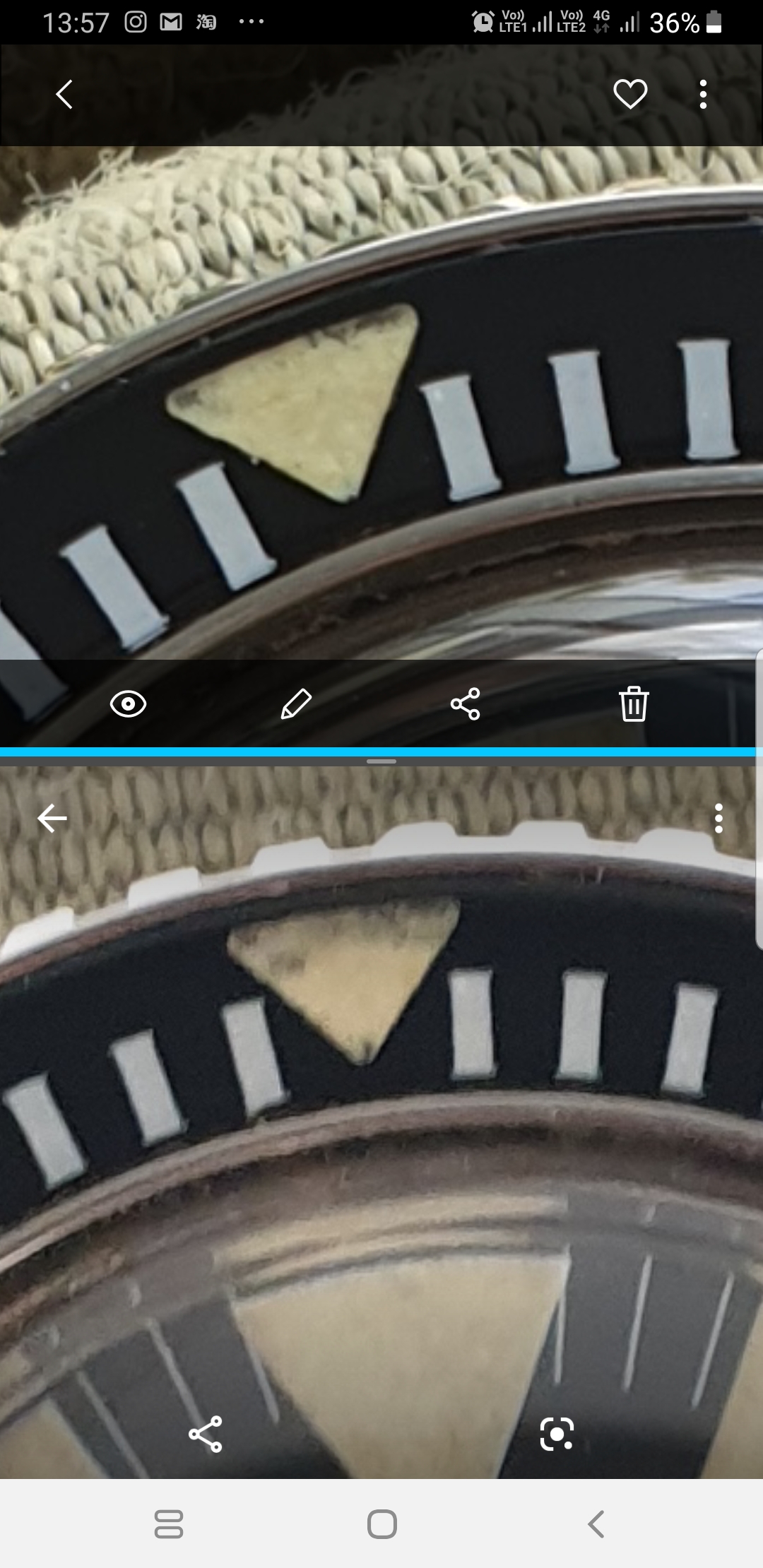

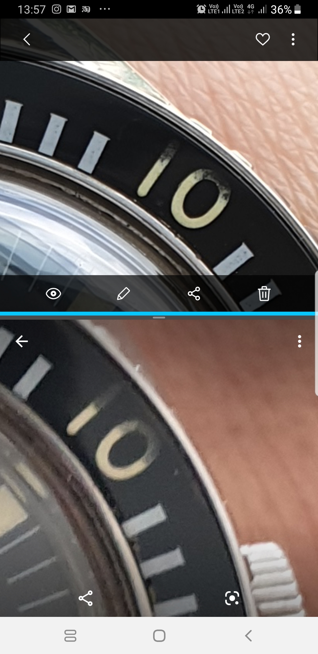

Just realized my insert darkened significantly just over a period of 3 months. Any way to prevent it from spreading further? Thanks

Wau that is a big change in just three months! 👎 Are there any cracks on the bakelite?

The Bakelite looks totally chewed up on the edges too. Do you work with chemicals?

Do you live in a humid environment? If so it might be mold?!

There is no crack. Its been in the safe most of the time. I also suspect is humidity. At this rate, the bezel will be all black in a year time. only thing i can do now is dehumidify the sàfe and see how it goes.

It is probably caused by moisture that found its way inside the insert.
I noticed a similar effect on the tritium dial of one of my watches before.

Maybe the mold idea is true? I have seen all sorts of bezel fading and discoloration but never encroaching black. I would check the movement for any corrosion since the whole watch lives in the same environment but it is a more water resistant case than many. If you have any other watches in the same safe, especially snap back ones and ones without some sort of sealing crown, I would check those movements and dials as well for corrosion or discoloration. I live in an extremely humid part of the world (air conditioned all the time) and I learned the hard way about exposed movements and parts years ago when I was learning what few watchmaking skills I have. Having a dessicant in a safe or safety deposit box is a good thing.

The discoloration does not happen on the bakelite. Inside the bezel is tritium lume that shows discoloration when getting in contact with moisture.
My guess is that either a damaged or the shrinking effect of bakelite caused micro scratches that allowed moisture to enter the bezel and darken the lume
