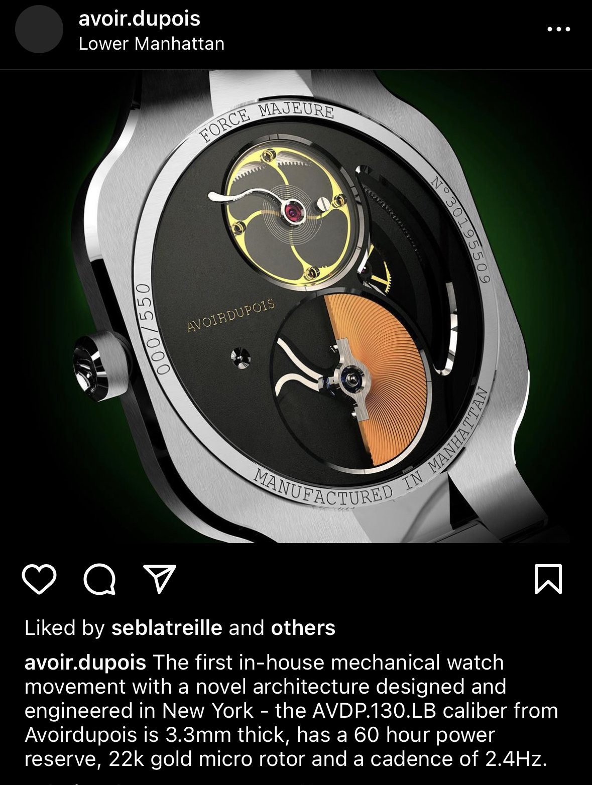

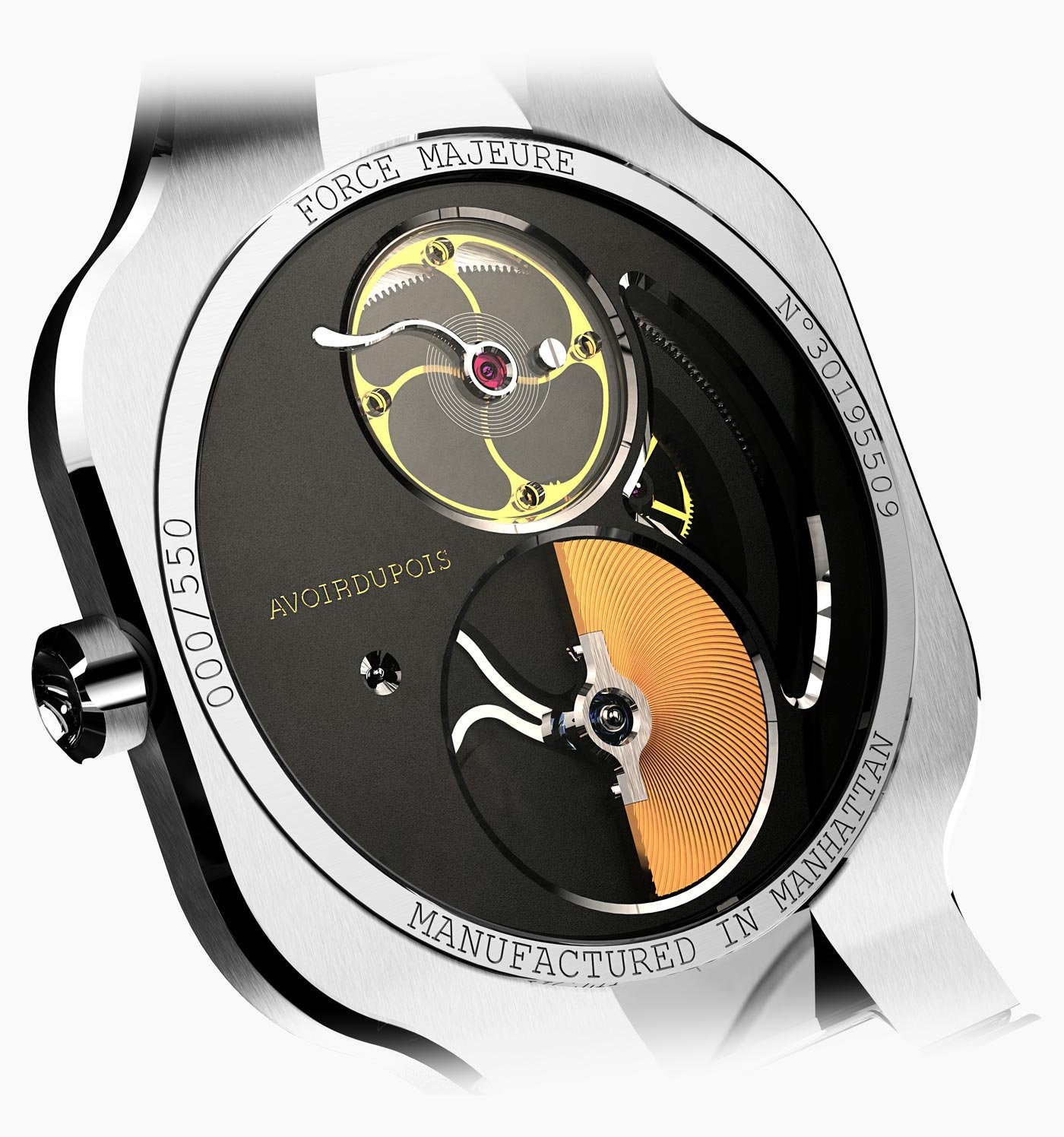

And the movement is very unusual (note these are only renders, I haven't found any actual pics of the movement).
To quote their description....
FORCE MAJEURE BY AVOIRDUPOIS IS AN ULTRA-THIN, AUTOMATIC-WINDING MECHANICAL WRISTWATCH ORNAMENTED, ENGINEERED AND MANUFACTURED IN MANHATTAN. CONTAINING THE FIRST CONTEMPORARY IN-HOUSE MOVEMENT FROM THE U.S.A., CALIBER AVDP.130.LB COMPRISES ZERO SWISS OR FOREIGN COMPONENTS AND ALL COMPONENTS OF FORCE MAJEURE ARE OF DOMESTIC ORIGIN - INCLUDING THE HAIRSPRING.

Looks cool.
However, just looking at the movement construction, I don't see how this movement would actually function. Where is the barrel? Where is most of the gear train and escapement? What's the giant wheel that you can see behind the balance wheel. There is no shock-absorber/cap jewel on the balance.

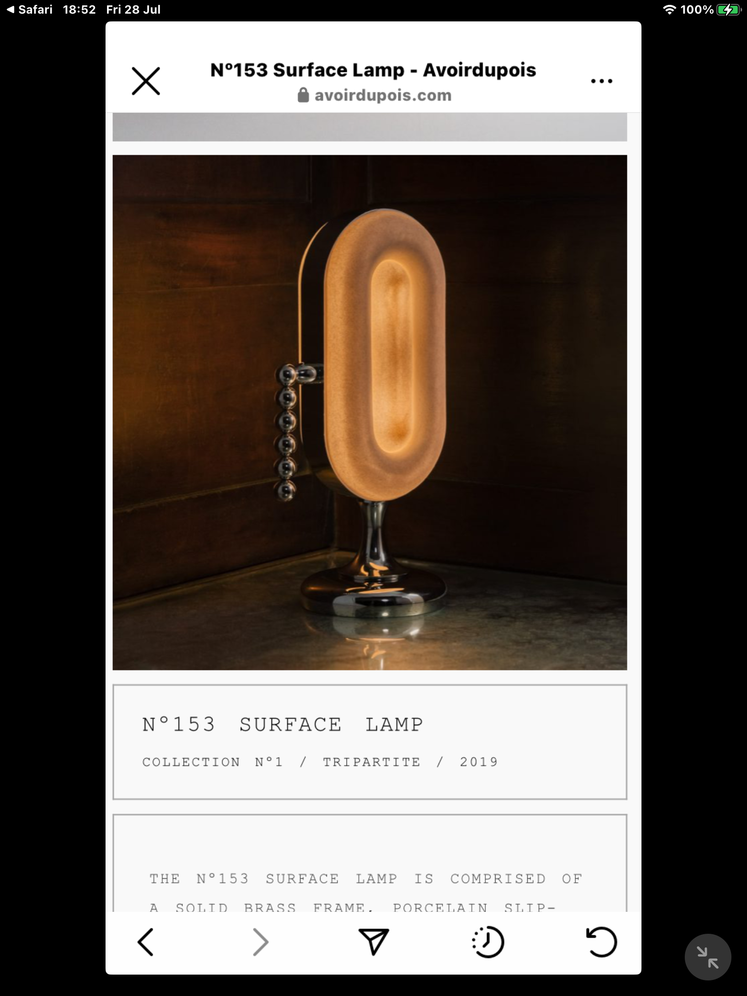

There last hit was a lamp
And

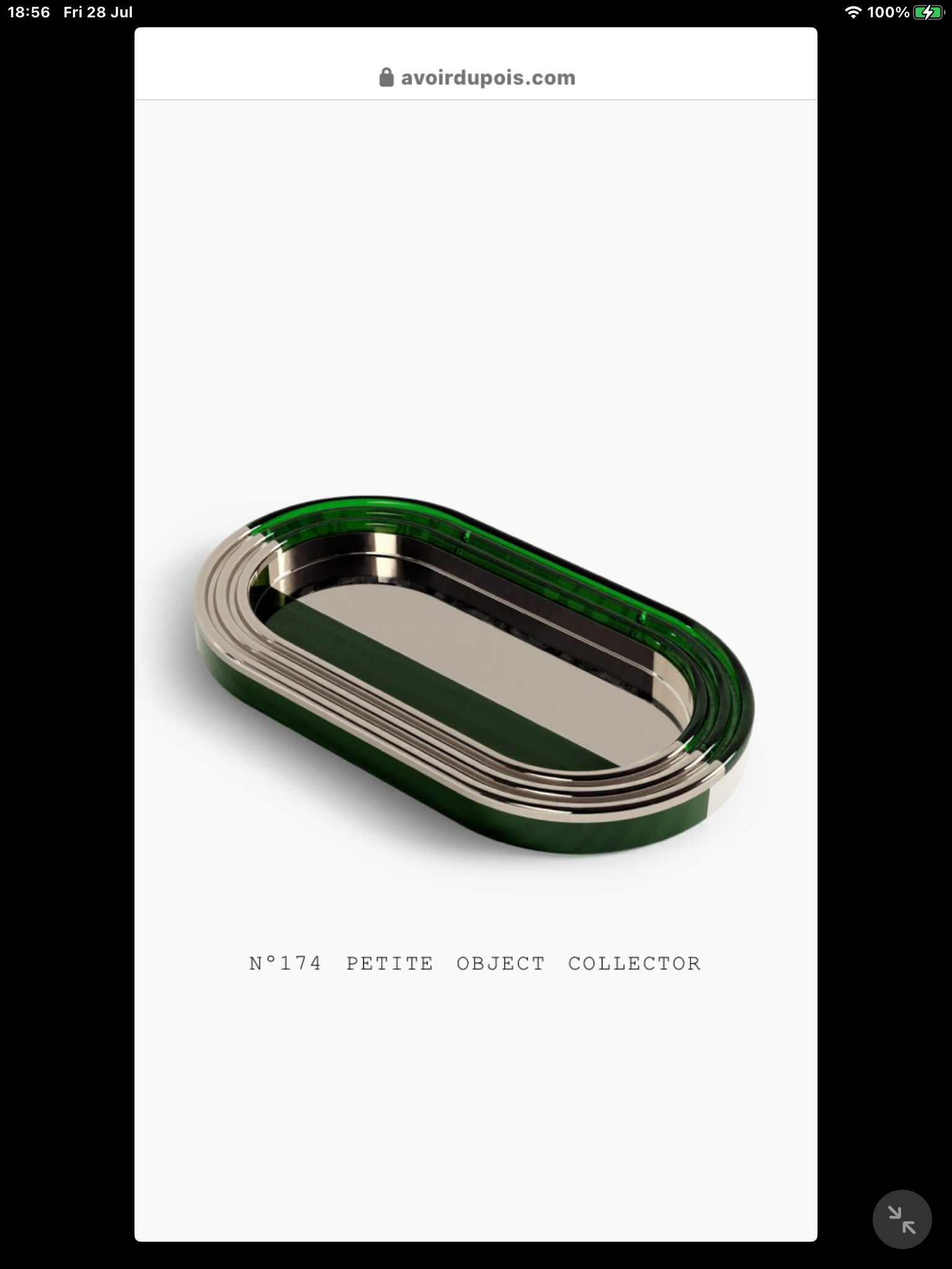

A “Grand Object Reflector” 😁😁😁
followed by the “Petite Object Collector” 😗

The leap from designer furniture to in-house movements is quite ambitious.
Curious to see what will come of the project.

Beyond the unusual gear train, I notice no obvious shock protection and the regulator, if that's what the wavey steel bit is, has no adjustment marks.
I have seen 8 day pocket watches with massive, movement-wide spring barrels - so if that's what the large black wheel in the back is, I can understand it. But I don't see where the pallet and escape wheel are suppose to be with the black wheel (barrel?) so close to the balance assembly.

I think it looks like a free sprung balance wheel with adjustment weights on the balance.
Having said that, the movement looks like a fantasy to me.
And
😁😁::facepalm1:: Can't wait to see how the Tiny Time Teller works out.

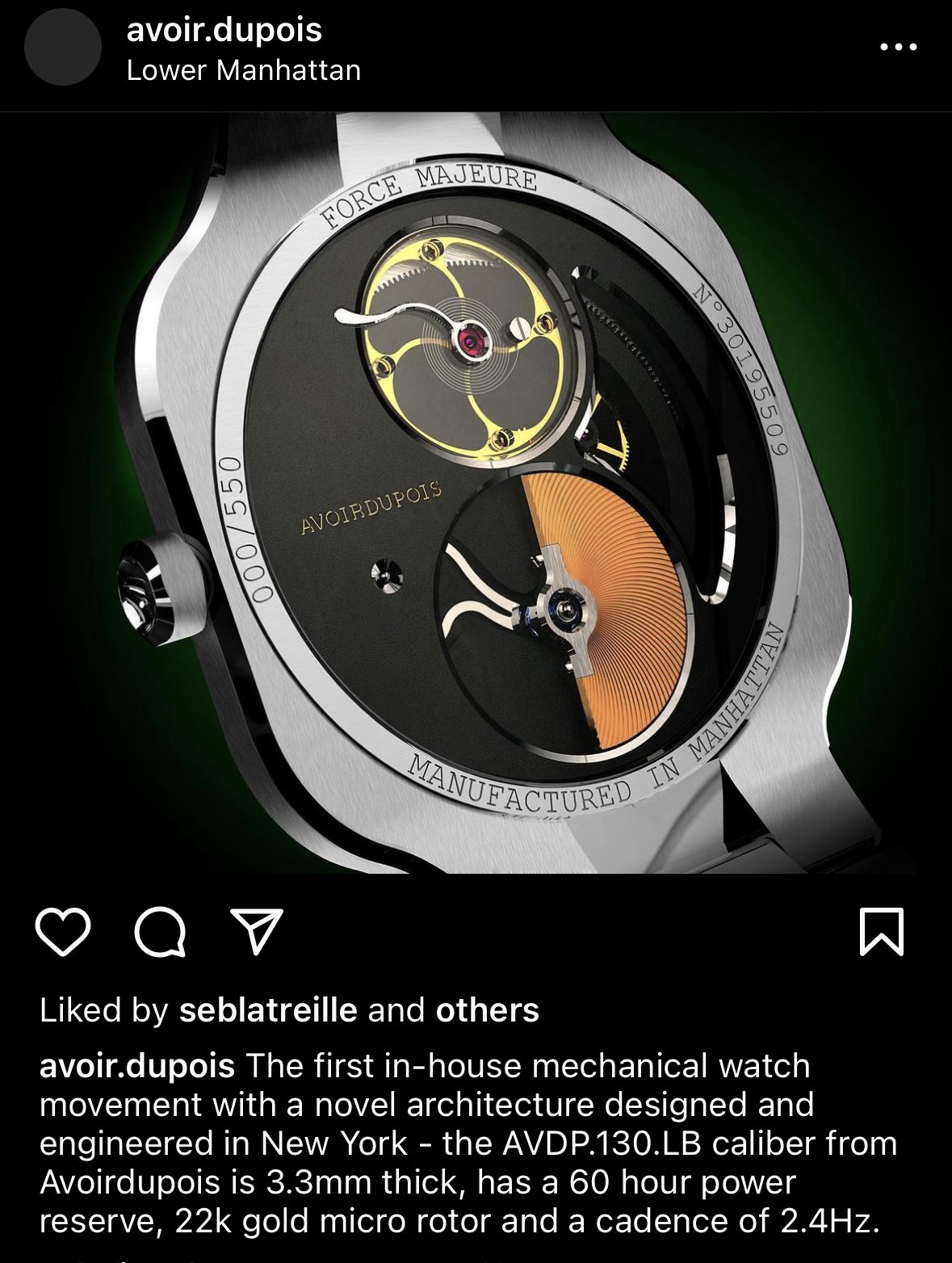

I’m very curious* about this too, but as Jim stated above, Avoirdupois is claiming that everything is of domestic origin with zero imported components:
“COMPRISES ZERO SWISS OR FOREIGN COMPONENTS AND ALL COMPONENTS OF FORCE MAJEURE ARE OF DOMESTIC ORIGIN - INCLUDING THE HAIRSPRING.”
*Specially considering they have zero watchmaking history and their first go at it will be a 3.3mm slim movement?

  • MOVEMENT SPECIFICATIONS
  • CALIBER..............AVDP.130.LB
  • CADENCE................17,280VPH
  • MAINSPRING STORAGE.....60 HOURS
  • WINDING.22K GOLD ROTATING MASS
  • DIAL...................INTEGRAL
  • REHAUTE................INTEGRAL
  • MAINSPRING BARREL.......ORBITAL*
  • TIME SETTING....PAUSED BALANCE
  • JEWELS....462 SAPPHIRE SPHERES*
  • *PATENT PENDING
  • $12,950.00
