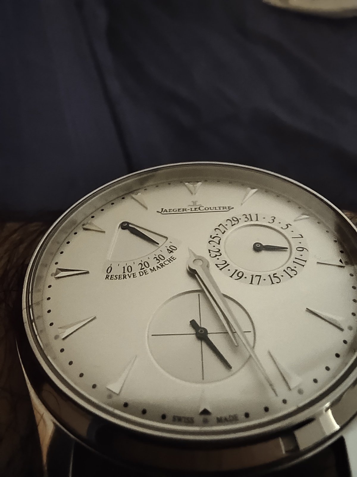

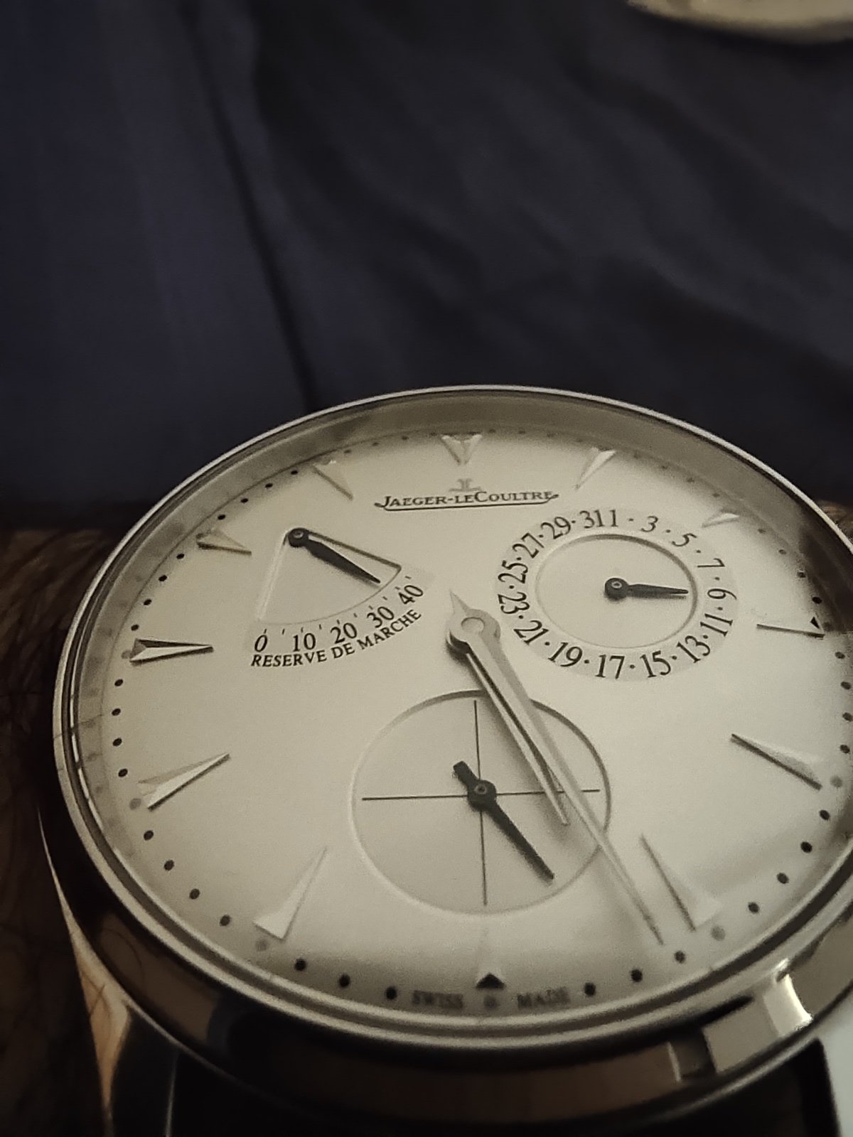

While driving my car from home to office for 40 minutes having both hands on steering wheel and negotiating Delhi traffic and turns, I wind my JLC to the full. Same I can say with my other automatic watches. Even a brisk morning walk for 45 minutes with hands moving both ways has the same results.
