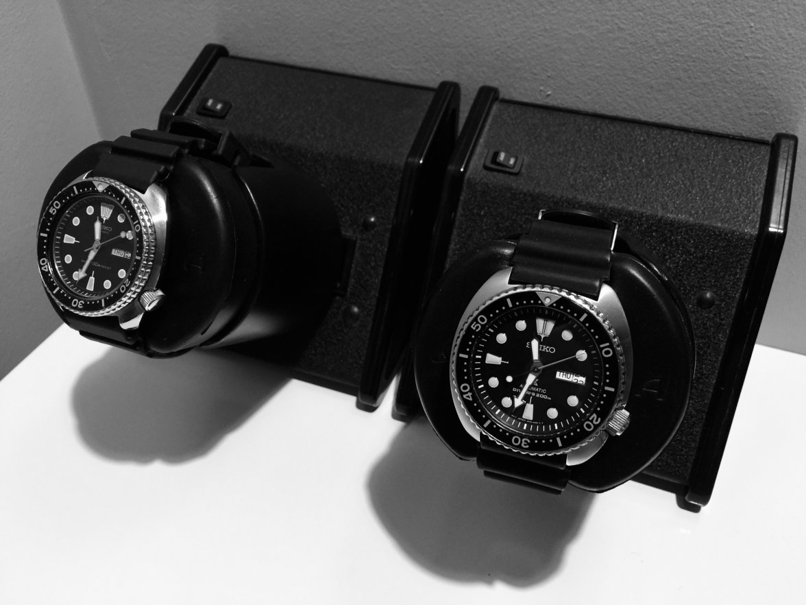

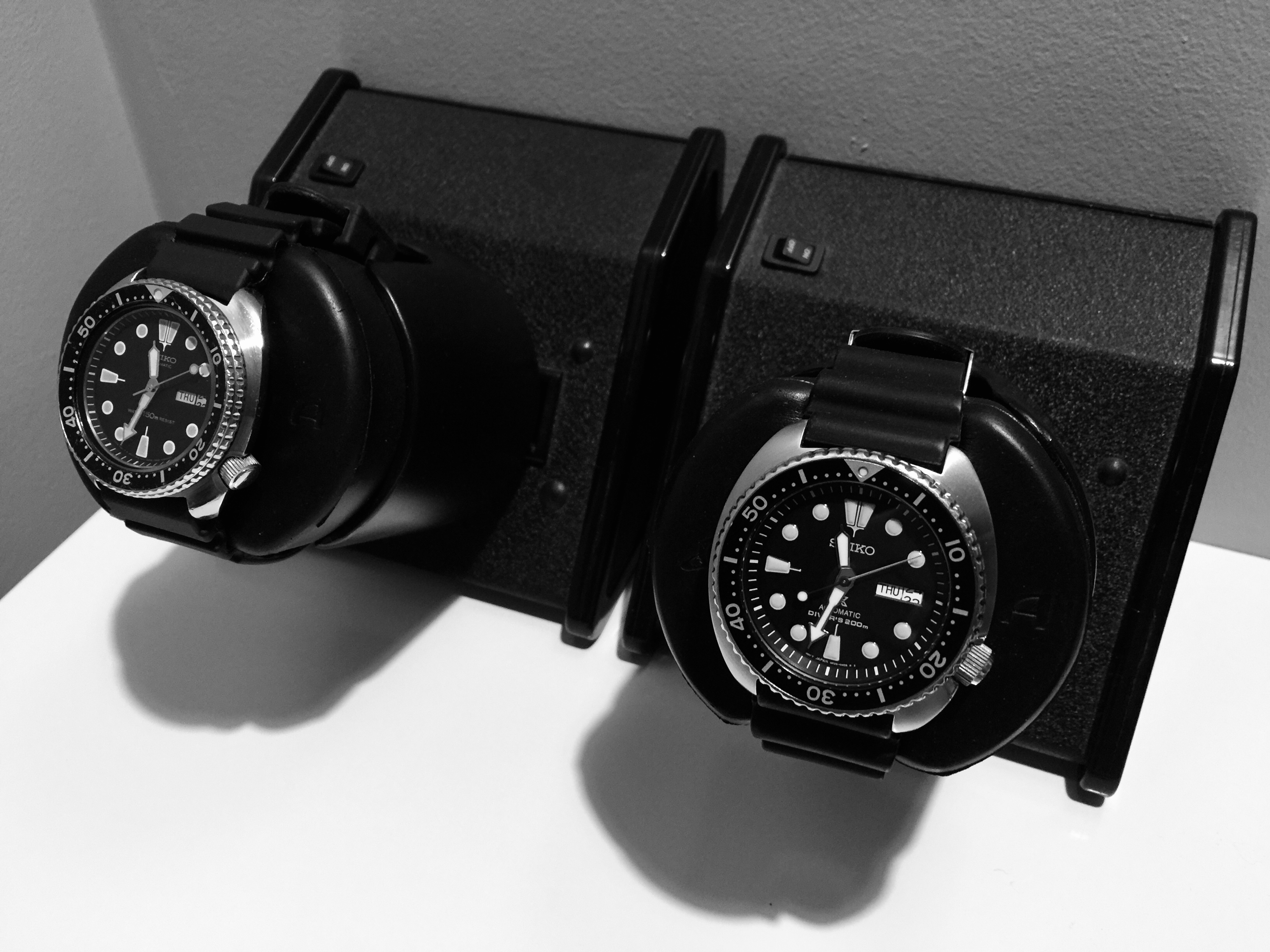

My two SEIKO autos pictured below [6309-7049 and SRP777K1 respectively] seem to lose a few seconds per 24 hours while on their winders...compared to on the wrist or dial up on the nightstand.
Regardless, I dig the winders...machines that’ll keep your machines running...or machines that’ll wear out your machines prematurely.
Pic from a few minutes ago...because I dig seeing pics of my watches...on my watch winders...on the internet...
