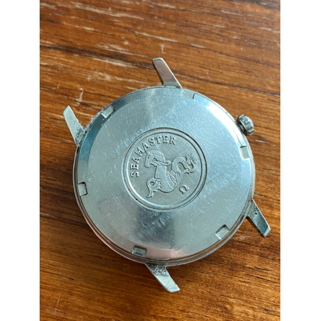

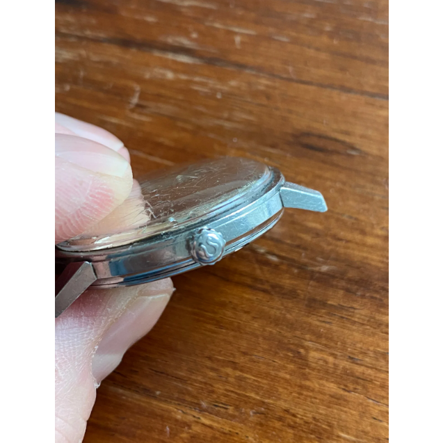

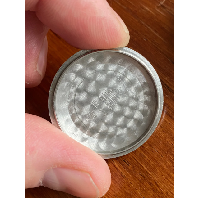

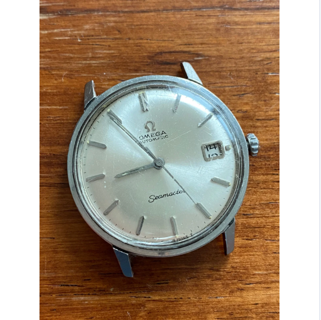

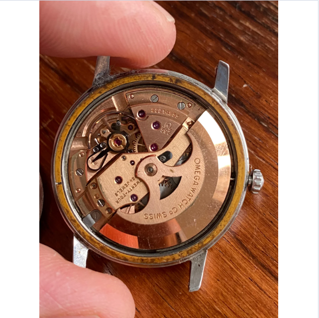

Hello everyone, I've found this Seamaster ref. 166.002 cal. 562 shown in the pictures for 500 USD or around 416 GDP. I really like it, but the thing is that I can't figure out if I'm overpaying. Seller says that the crown is a little loose and the date is sometimes struggling when shifting, so it'll definitely need servicing, but it is running. Do yall think its worth it? Would you buy it? Thanks in advance

Looks like a decent original example, but you're going to have to figure $200-300 or so into service/repair, possibly more if it needs parts. Looks like the winding rotor is rubbing the case back (more parts).

The hands show 5 to 9. The date disc is in the middle of changing over, which should occur around midnight. The date disc is either stuck , the hands taken off and misaligned or somebody just messed around. Better factor in $400 for a service with maybe date section parts needed.
