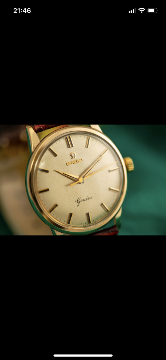

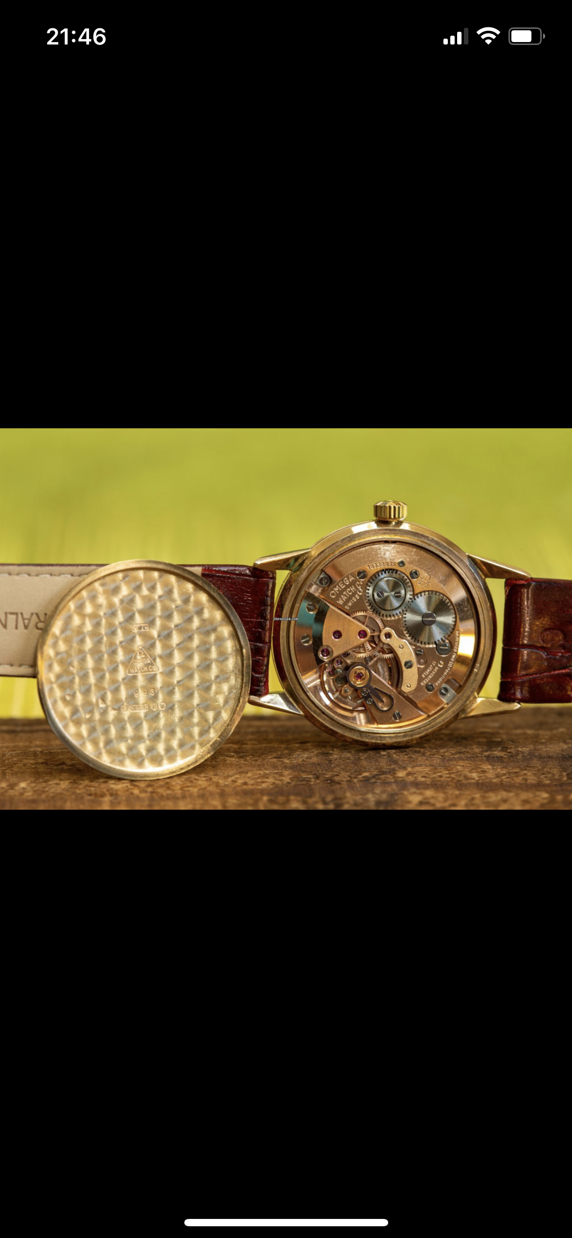

The London date letter in the case back looks very much like a lower case ‘q’ for 1971.
The serial on the movement is 26,9xxx which would normally be seen as 1968, however, movt serials often have a much wider year spread than is often attributed and as it was cased locally it could easily end up in a 1971 case.
I did think that movts and dials were shipped together, (sans precious metal case) so it doesn’t explain why a lowly Geneve has a top of the range cal 564 movt but it may be that Shackmann had spare movts, dials and cases and created this hybrid watch.
A 9ct Seamaster/Deville case, a Connie movt and a Geneve dial.
A definite frankenwatch but perhaps one that left the (English) factory that way.
I did find one other example on the web but is was just a dial and movt without a case (Geneve dial/564 movt) - so who knows?

I asked the question to the seller about it being an odd combination and his reply was:
The 564 is part of a generation of movements produced throughout the 1960s into the early 1970s that were used across several models including Seamaster, Constellation and Geneve. The 564 was chronometer rated and a better movement than some of the other calibres so was mainly used for the Constellation that stated it’s chronometer rating on the dial. So it is rarer to see the 564 in the Geneve models but it is correct and I have seen others.
The reason you are probably not finding many is partly due to the nature of the case on this model which requires a watchmaker to open through the front of the watch after separating the two section crown. This is difficult to do and why you see quite a lot listed without stating the movement calibre or photos.
This also shows the movement is correct for the case (front loading always with 2 section crown movement).
I hope this clarifies…”

Until this thread, I had never seen a chronometer rated 564 in anything other than a Constellation or a marked Seamaster.
Each have the prefix reference 168 (or 167) and have chronometer on the dial.
I don't believe that the 564 was ever used in the general Geneve line. (which from memory was the basic Omega line by this time?)
IMHO the ONLY reason that a 564 could legitimately be in a Geneve is that it is is in a precious-metal locally cased watch.
BTW the 564 was used in the uni-shell 168.015/025 Connie and so can evidently be adapted to suit that kind of case, so not a smoking gun for authenticity.
link to to the other one I found 29,4xx serial so in the same ball park age wise -perhaps it lost its gold case?
https://www.catawiki.com/en/l/36847191-omega-geneve-chronometr-cal-564-men-1960-1969
I'm afraid the long and the short of it is that the watch may well be authentic but is an anomaly and without the original sales documents (or multiple other examples) it will always be an outlier.

Thank you everyone for your help. I think I’ll avoid it as it doesn’t seem to be a common combination which makes me think it could be a mash up.

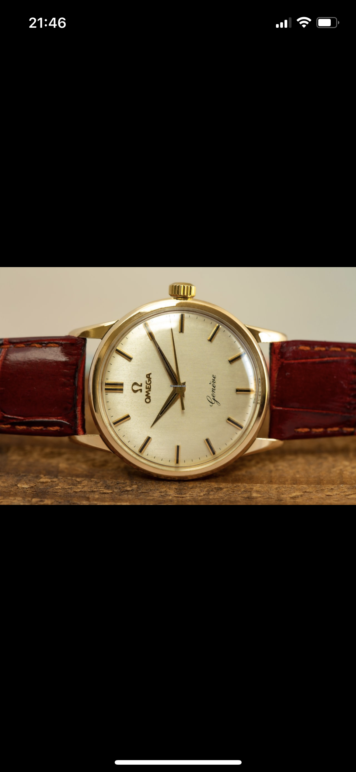

How about this 1961 Geneve? Has just been serviced with proof.
I have seen a lot of posts regarding the cal 601, but not 600. Is there a big difference?
Matt.
10,804
16,814
Be aware that is also a UK made case. Not a bad thing but it is a thing. Being from 1961, I'm not sure if it is Dennison or Shackman produced. I guess Shackman since Dennison normally say so, and OWC is more a Shackman thing.

It stands for Omega Watch Company but ironically shows that the case was made in the UK, see the earlier posts by Aussie Jim and PMG for the explanation. It was common back in the day for Swiss movements to be put into local cases. You have managed to pick out 2 made in London. I am guessing you are searching the UK market for 9K watches, this will throw up a lot of local stuff as 9K isn't universally popular, in some jurisdictions like the USA it isn't even considered gold!

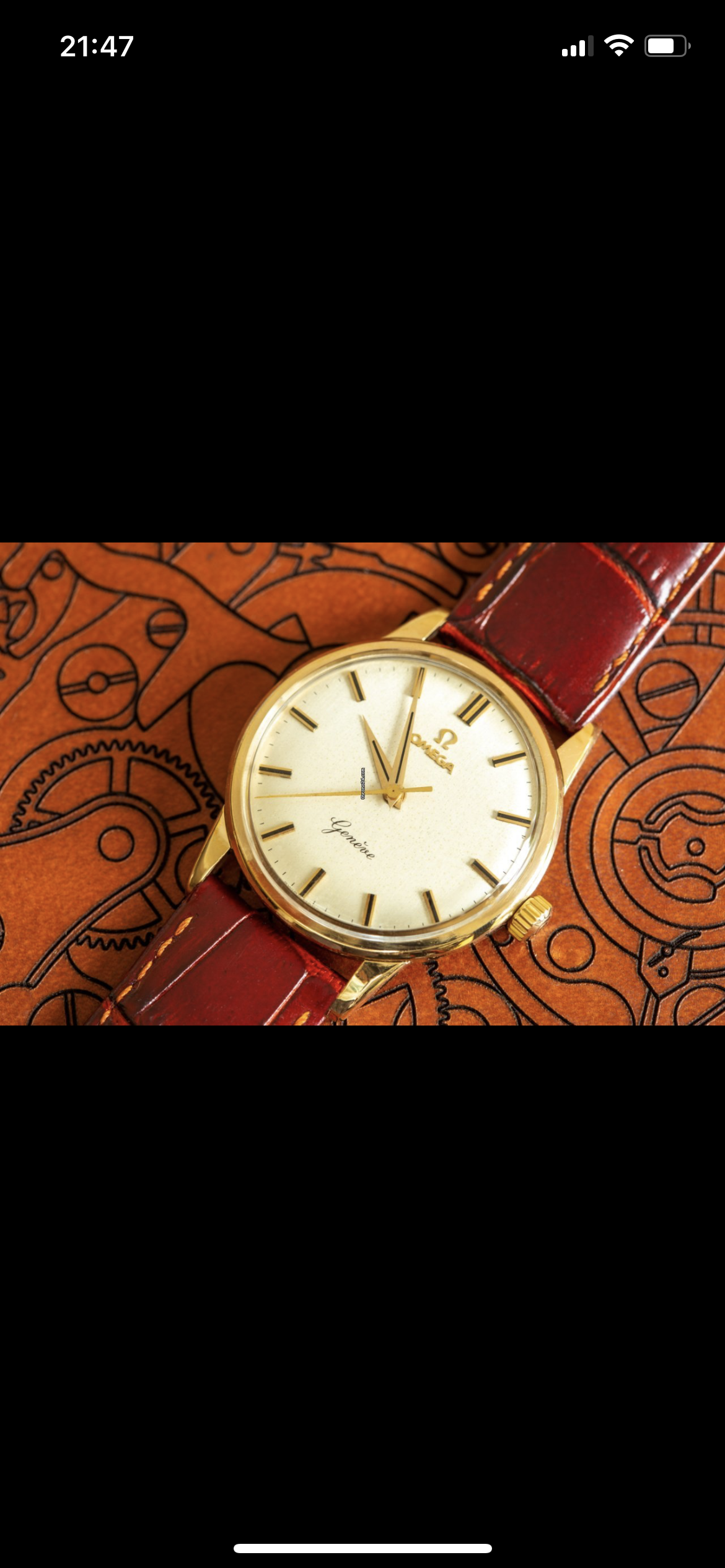

Thanks everyone. I’m not fussed about it being made in the UK as I’m not buying it for resale value in the future, I just want it to look smart enough that I pick it out for special events after my wedding day. I obviously do want it to be genuine though and not a Frankenstein. I’m thinking of pairing it with a green leather strap when I get one.
What about the manual wind calibre 600? I’m sure it’s not as good as a calibre 56x, but I’m also leaning towards manual wind as I think the process of setting it is a little more ‘romantic’ considering it won’t be worn regularly, so no necessary need for it to be automatic.
18,836
39,175
The 600 was essentially a manual wind version of the caliber 550 and is a fine movement.
It was well designed and is not much different to the 601.
The 600 has a nice swan neck regulator whereas the 601 changed to an eccentric screw regulator. That's about the only difference I've noted.
It would be an excellent choice for an infrequently worn manual watch.
