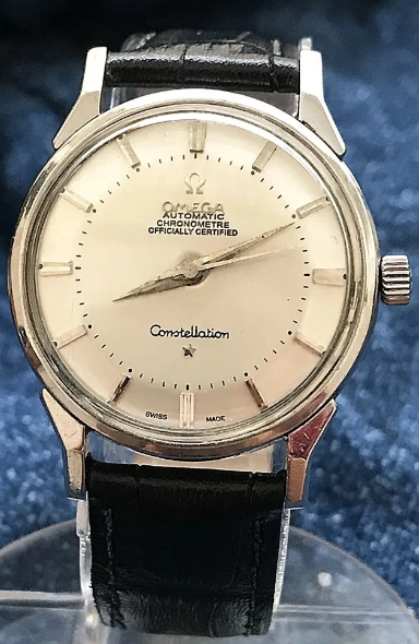

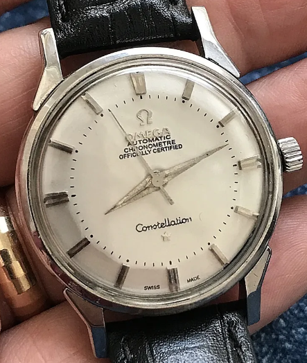

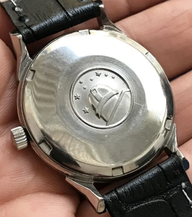

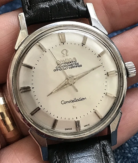

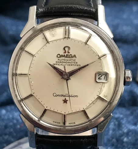

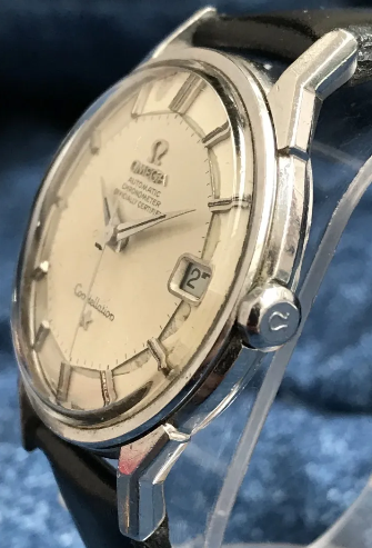

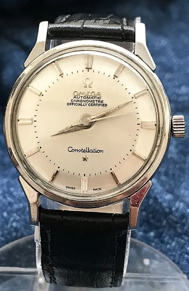

#1 - Constellation 1
Concerns: the minute hand appears to be in bad shape. The "Automatic" writing looks too close to the "Omega" insert - this could represent that the dial was remade, I guess.

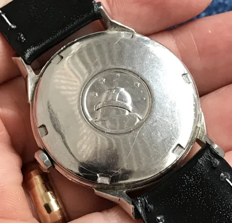

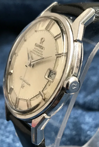

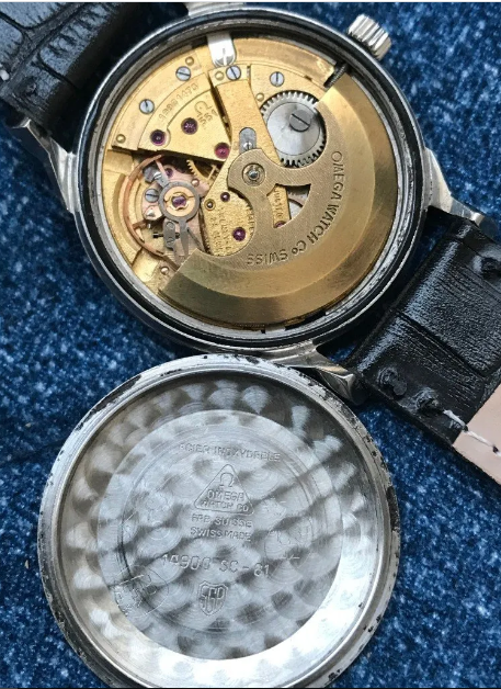

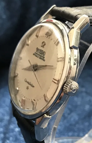

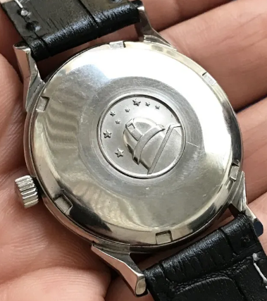

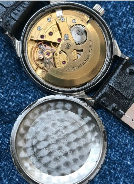

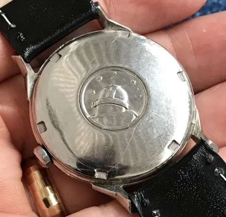

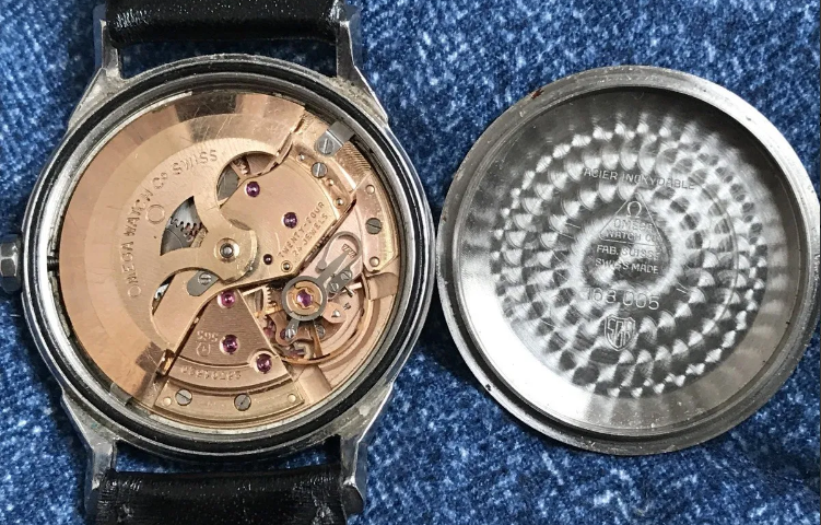

#2 - Constellation 2

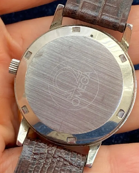

Concerns: The caliber is the 565 (not chronometer) and I think it should be the 561. I've read that a few Constellations were made with the 565 caliber, but I'm not sure if this info is correct.

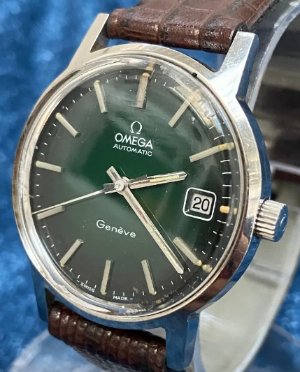

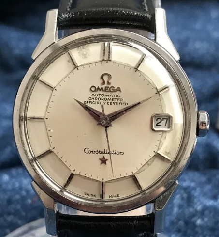

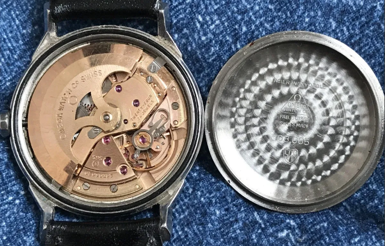

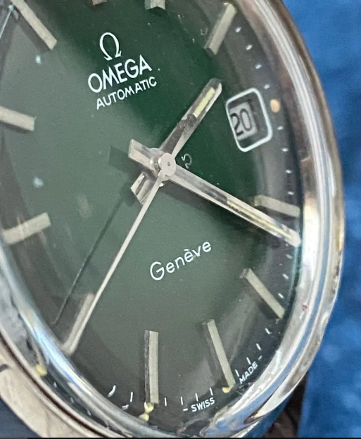

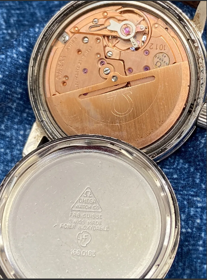

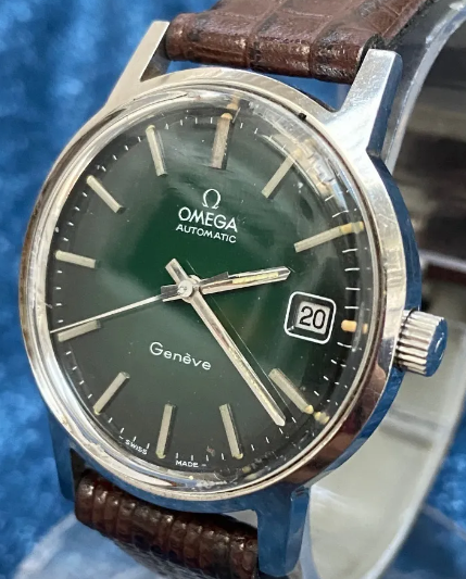

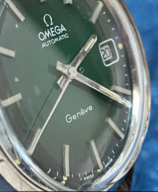

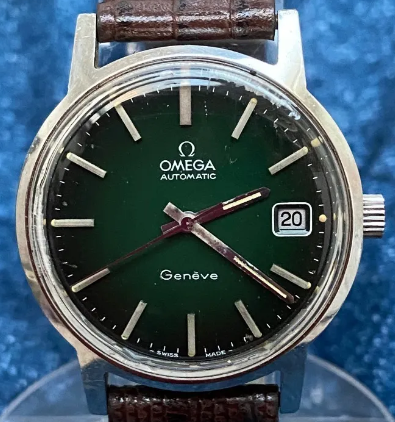

#3 - Geneve
Concerns

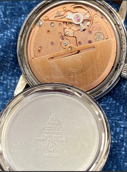

: The plexiglass is slighty chipped between the 1 and 2 markers, but I'm fine with that. The plexi is also marked with the Omega logo right in the center (pic #2) and I haven't seen this on other watches - is this correct / makes sense? I compared it with other Geneves and the hands seems to be odd (most of the Geneve hands I found have 2 different colors for the luminous part). Maybe the hands were changed?
I'm tending to go for the Geneve, because of the green dial - I really liked it.

Edit: there is a lot wrong with all of them, the last one being the most decent out of the bunch, but I still would not buy it simply because you can find a better example than that. That lineup was the affordable one, therefore they are a dime a dozen. The connies are very very bad. The blog I linked to is a great resource that, judging by your questions, will help you lots.

If you like the Geneve, and it's cheap, then go ahead, but don't overpay since it's not the most collectible piece. I wouldn't touch either Constellation because of originality and/or condition issues.

Redial bonanza!

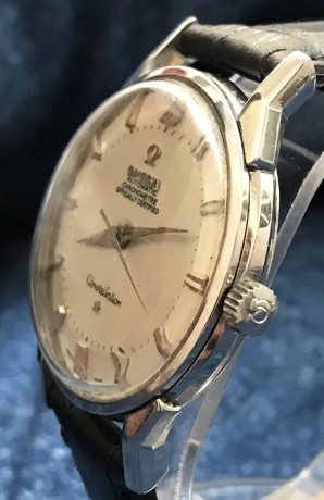

I don鈥檛 know about the Geneve but the two Constellations are a hard pass.
First has polished case and very bad redial.
Second has very bad dial damage (pics aren鈥檛 good enough to tell if it is repainted) and wrong movt.
FYI you are right about the movt - it should be a 561.
it is rumoured that there maybe some Chronometer rated 562s in Connies but not 565s.
(but no-one has ever shown one)
if the seller is saying they are all correct, I鈥檇 be inclined to avoid this seller.

Thanks very much, guys! Amazing help, greatly appreciated. (@Peemacgee - beautiful maine coon haha).
Regarding the Geneve, seller is asking me ~US$460. Do you think it is worth it?
Thanks again.

I really think the price is up to you, since we don't know your circumstances and other options. Some of us might pay that much and some of us wouldn't, but we aren't in your shoes. If you want to know market prices, try using the eBay advanced search feature and look for recent sales of other Geneve models. You can also search for listings in the OF classifieds. They won't have green dials, but that shouldn't affect the value very much. Just try to find examples in similar condition. This reference is pretty common, so valuing it won't be hard for you.
