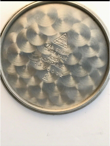

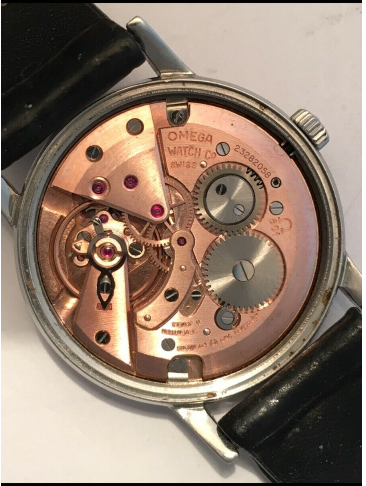

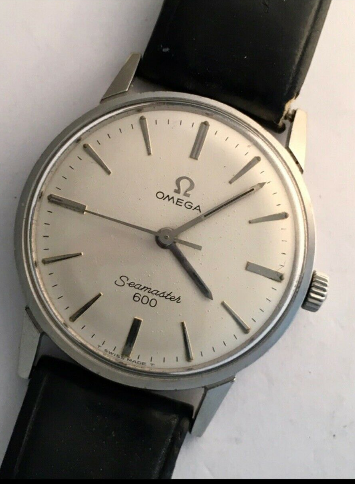

I am a total Omega-newbie and I have tried to learn as much as I can about how to tell if a watch is an authentic omega or not, so that I can buy one for my husband's birthday.
I have found this watch below, which I am on my way to muy in a couple of hours. From all I can tell it is real, but I would so much appreciate the input from others who know much more!

The 135.012 is smaller than the usual Omega dress watches from this time with 33mm
Could be a bit small for a man's wrist.

As far as I know: If there is luminous material on the dial there should also be this material on the hands which isn't the case here
So the hands seem to have been replaced with incorrect ones

I’d say these are more 32mm. Even with small wrists they wear very small.
I’d really advocate looking at the 34mm 135.011 if you like these Seamaster 600’s. They aren’t too hard to find.

The case seems to be in very good condition.
The pictures are not the best but the dial printing seems legit.
The movement looks good but the gasket seems to be missing
With 600€ I think you are on the high side for a hand wound, small Omega.
