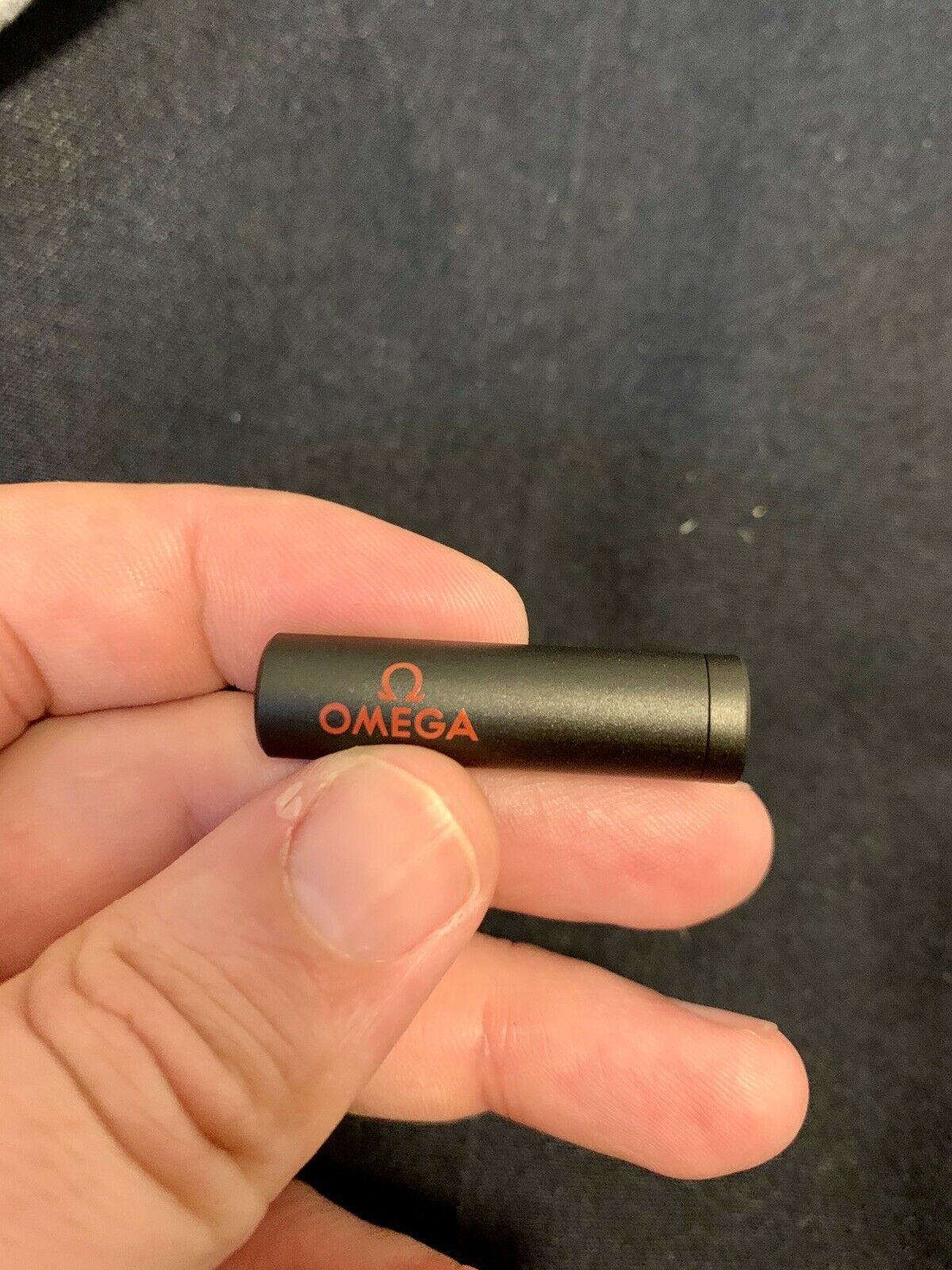

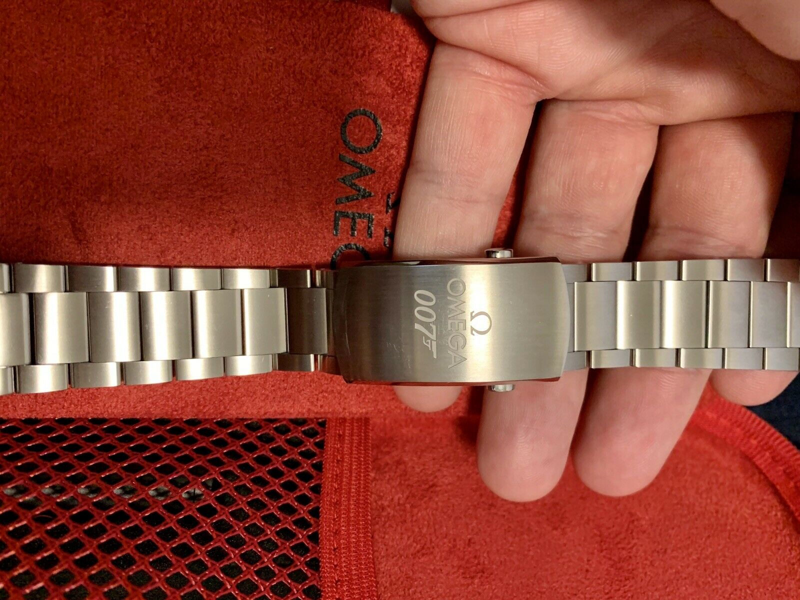

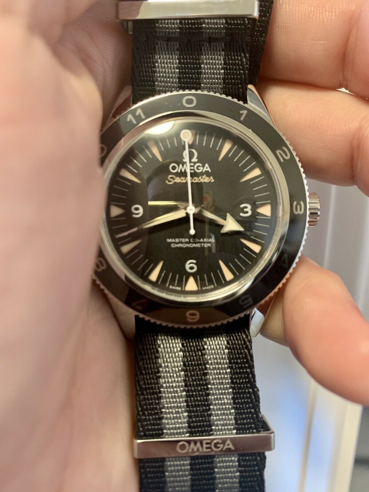

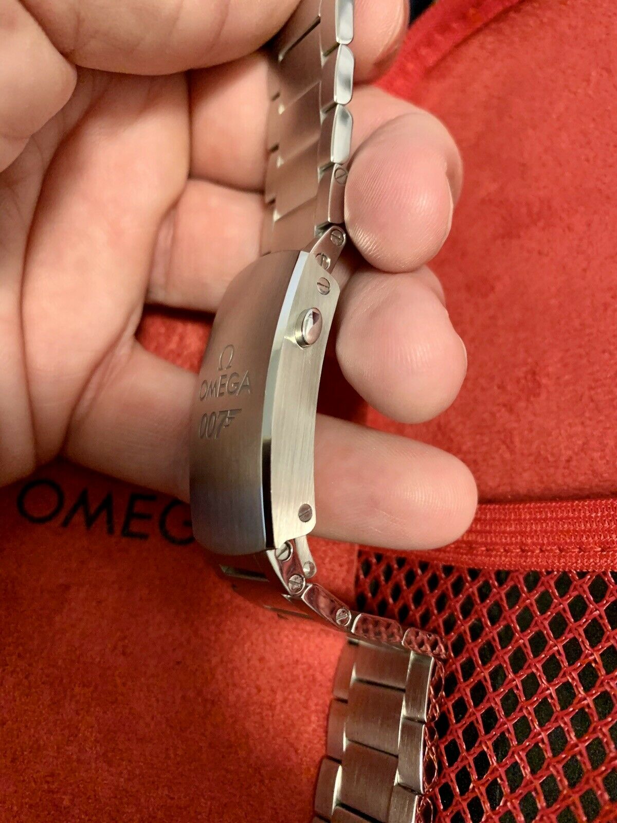

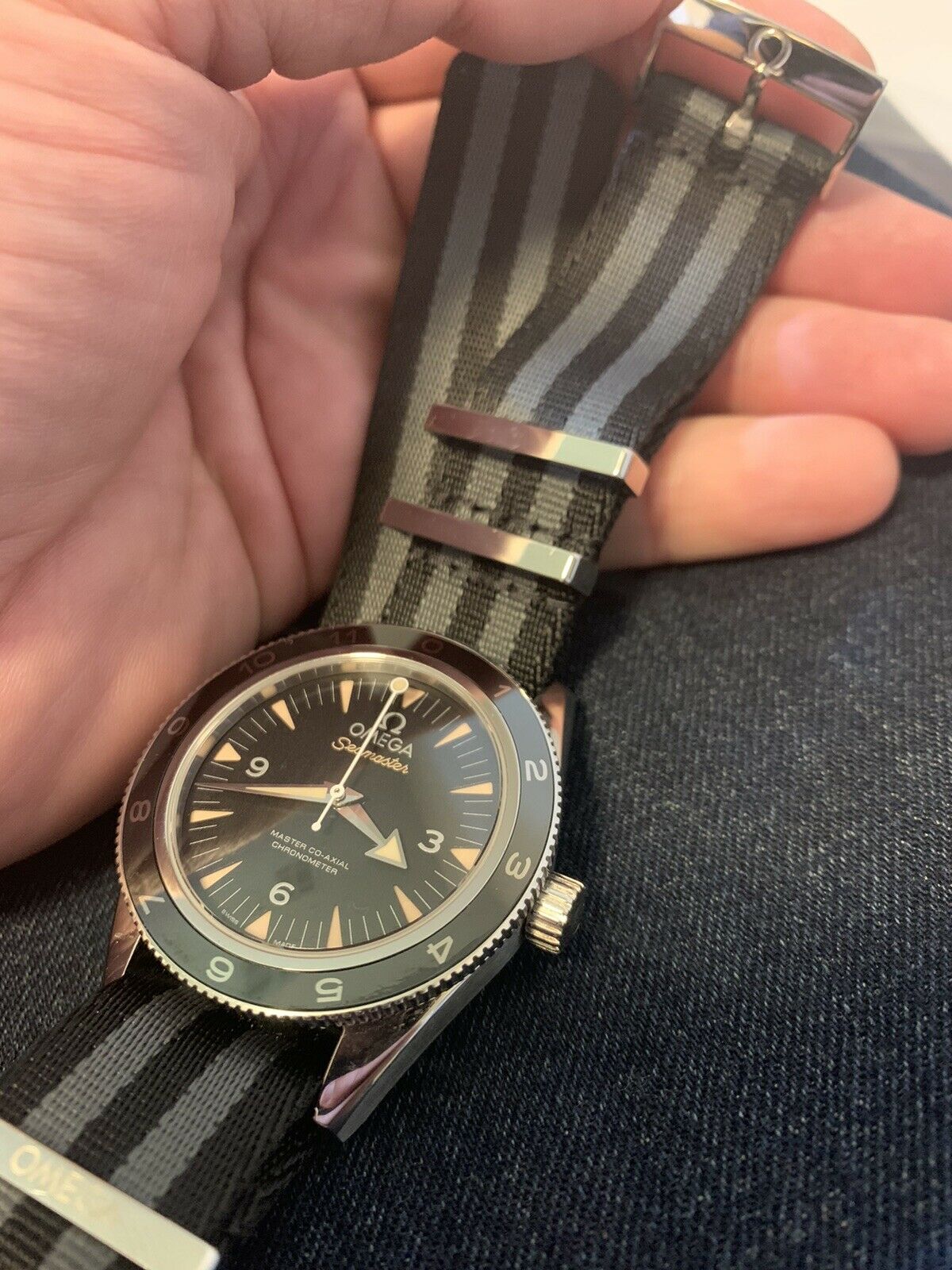

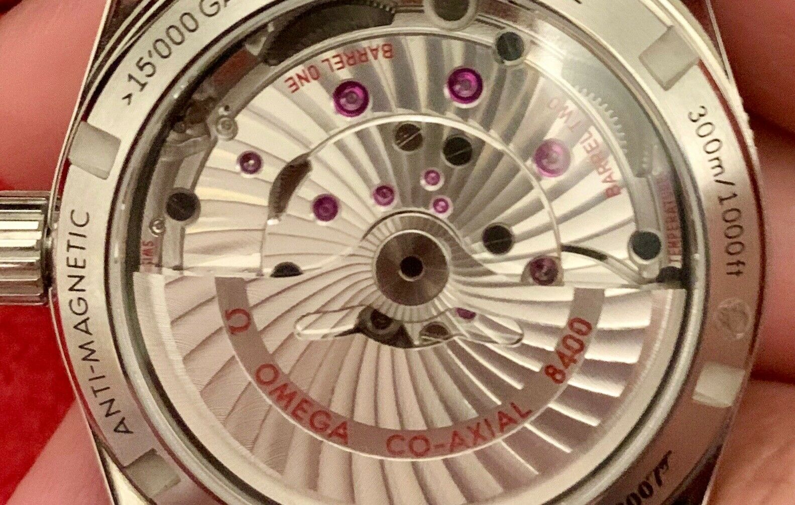

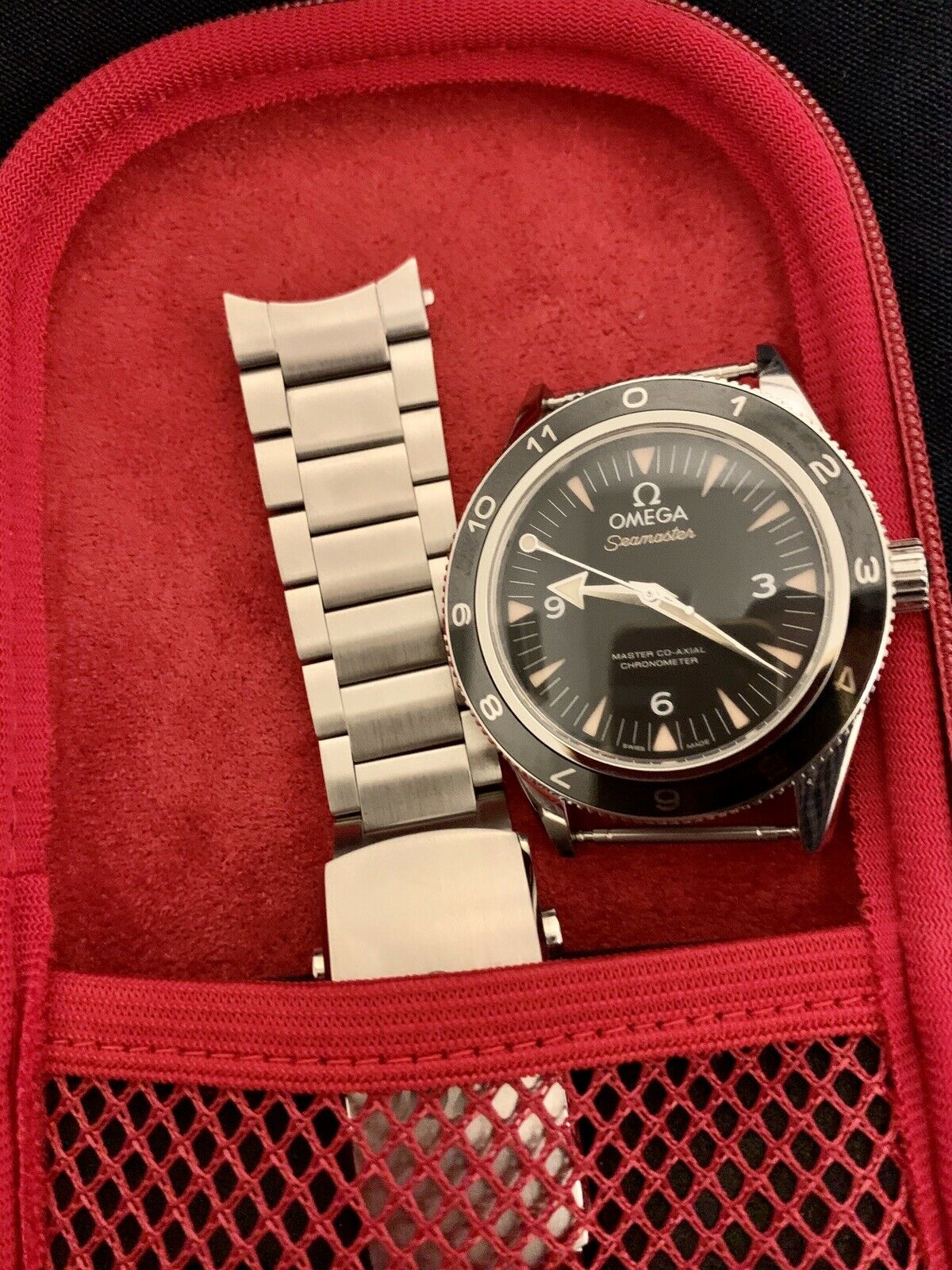

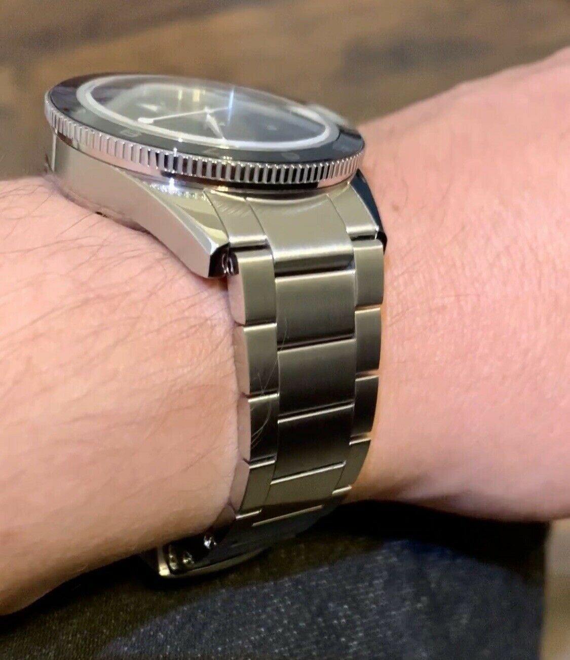

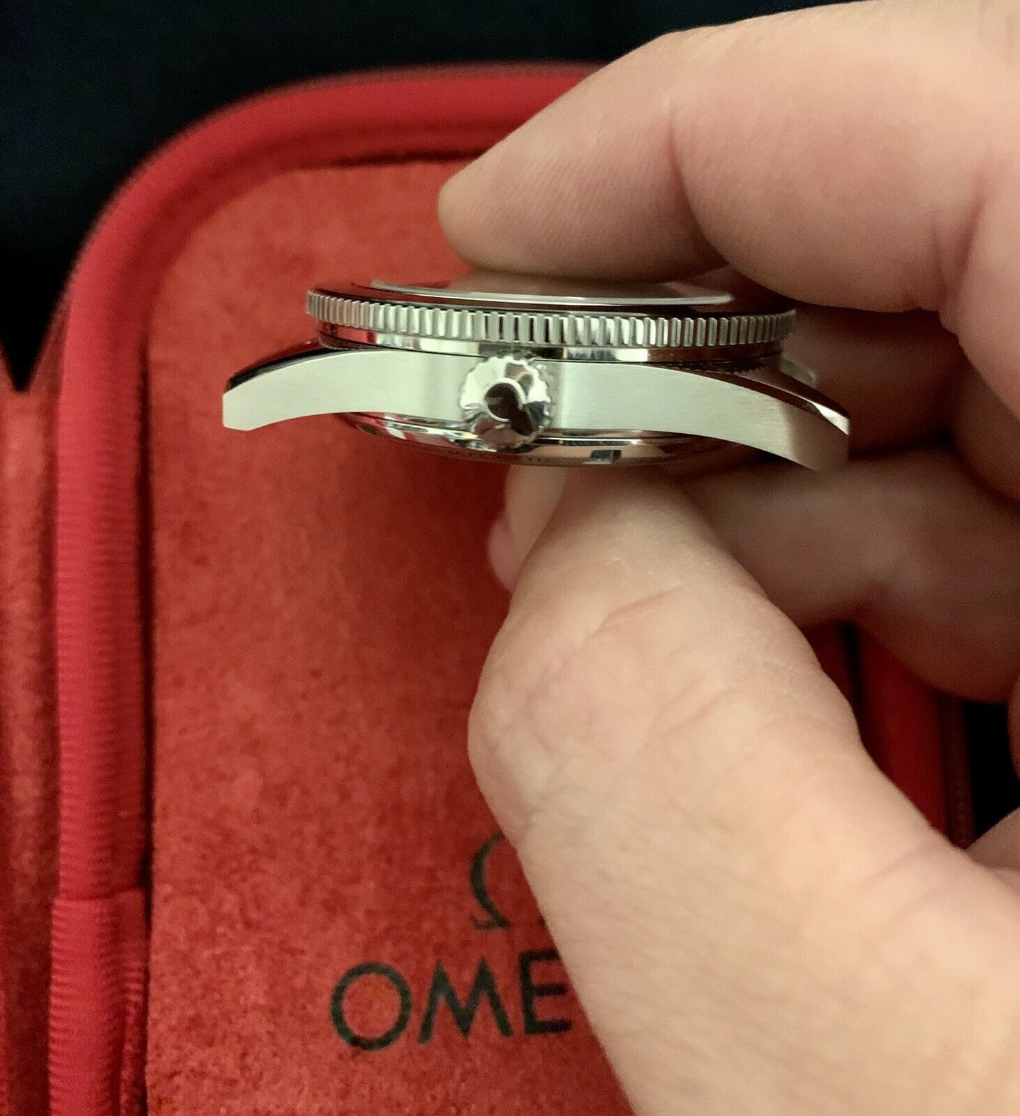

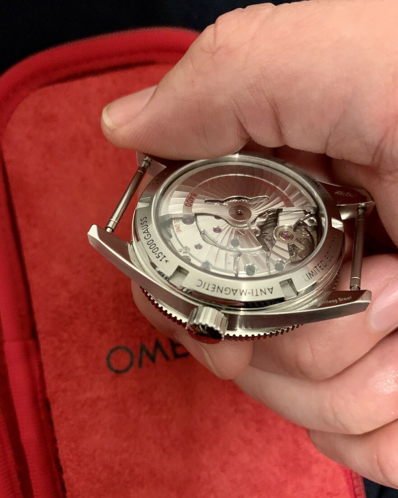

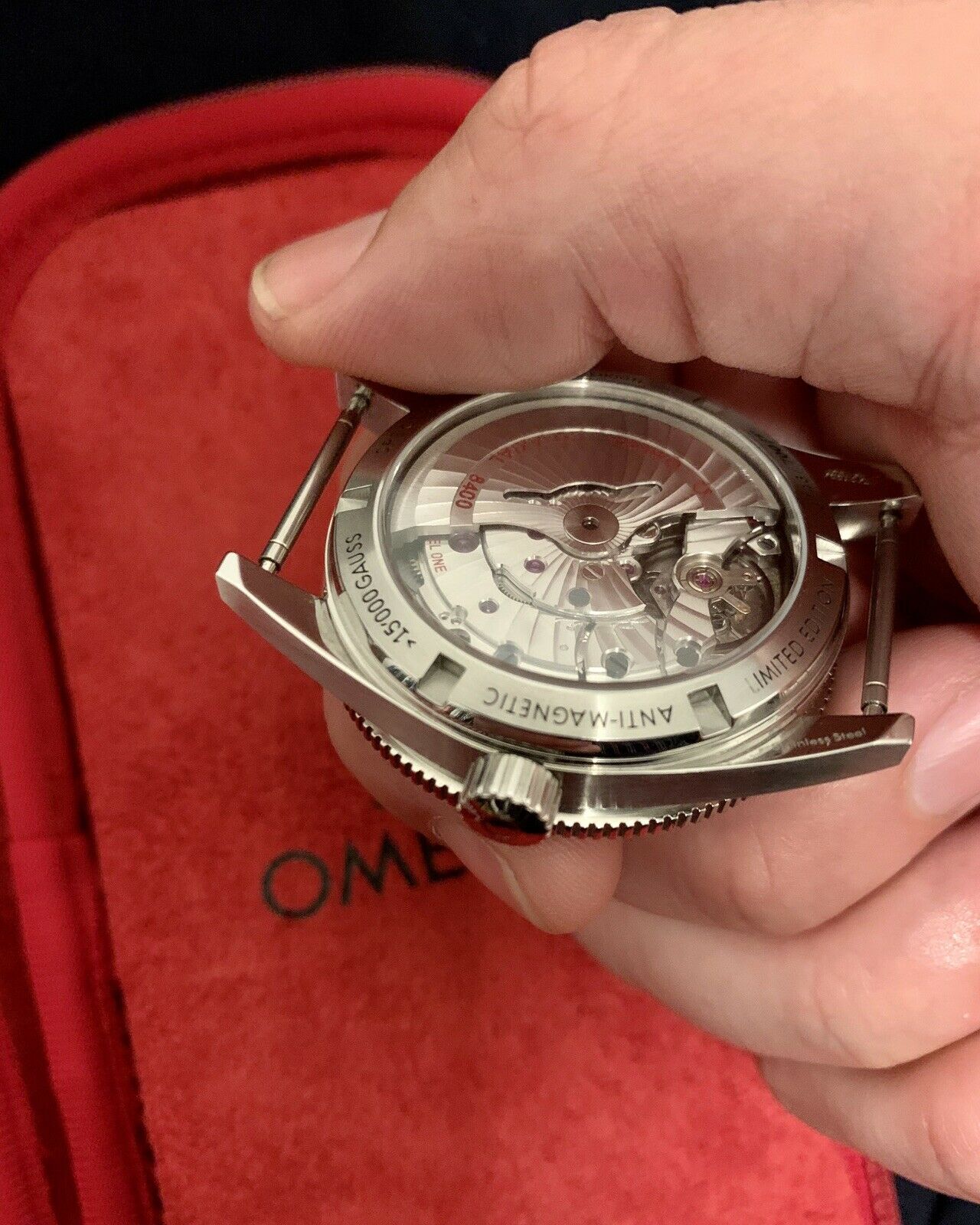

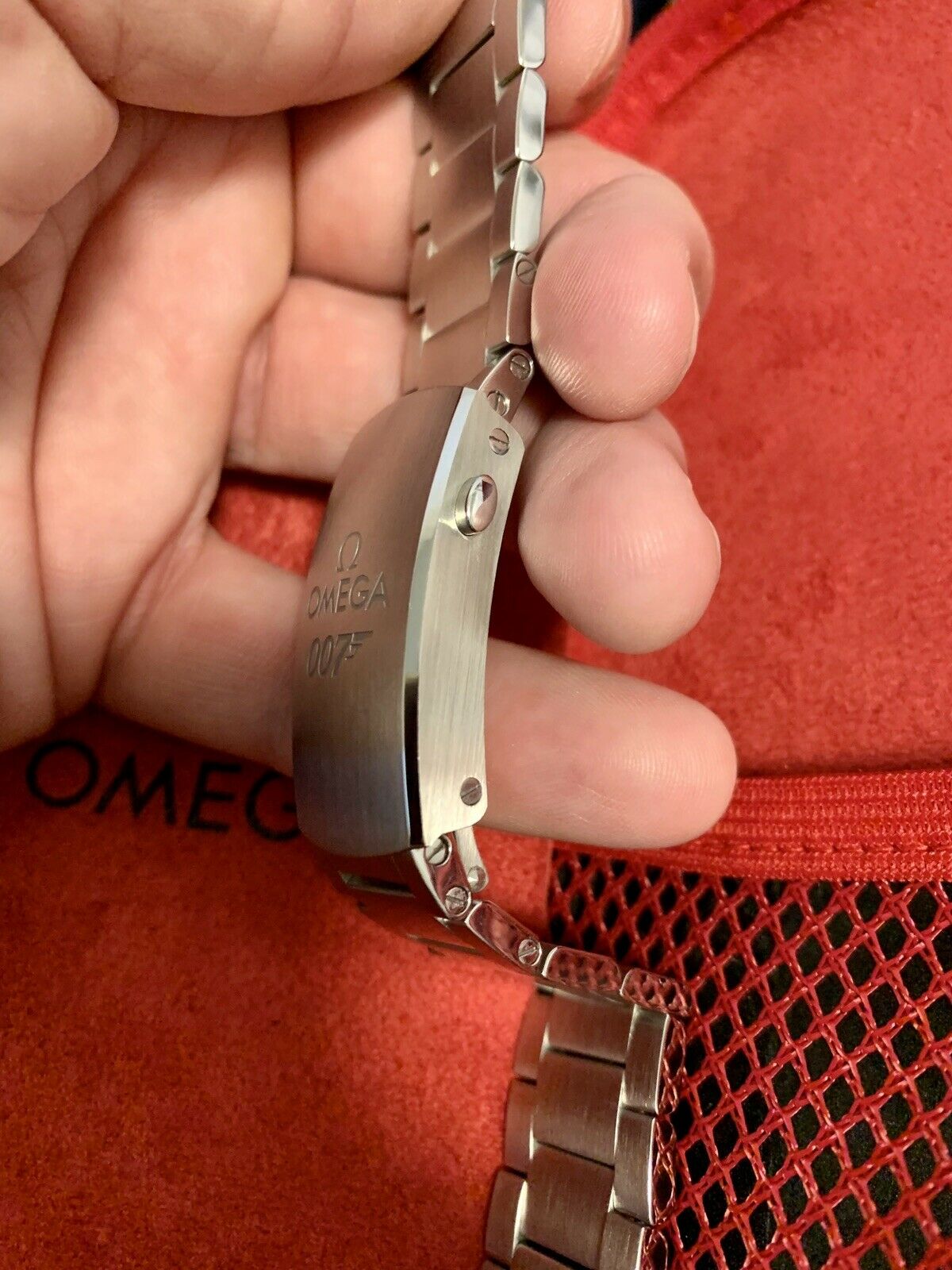

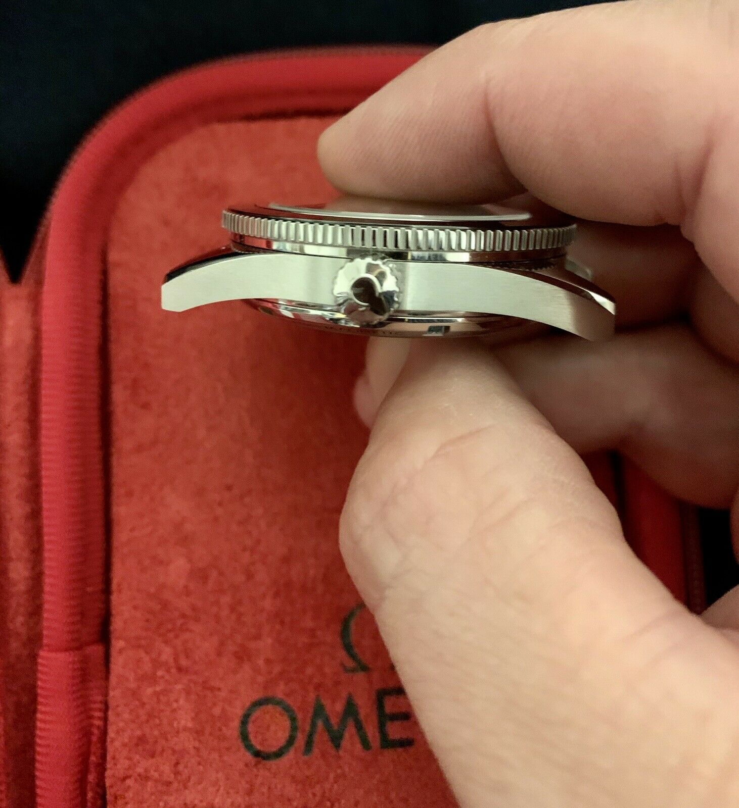

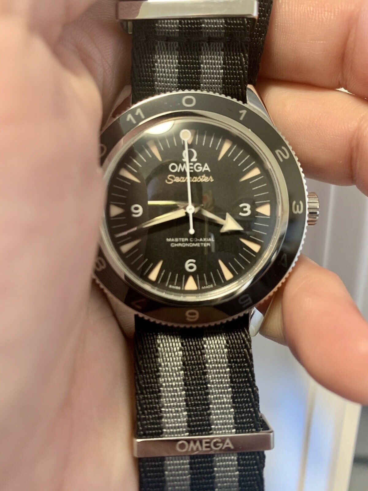

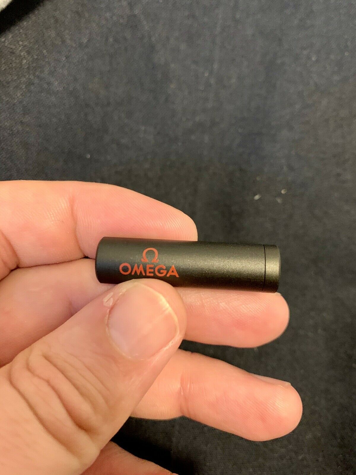

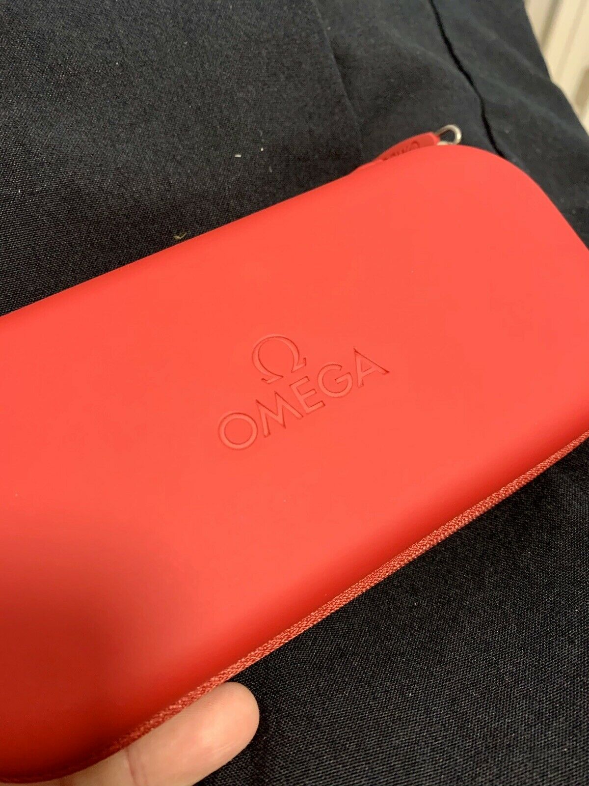

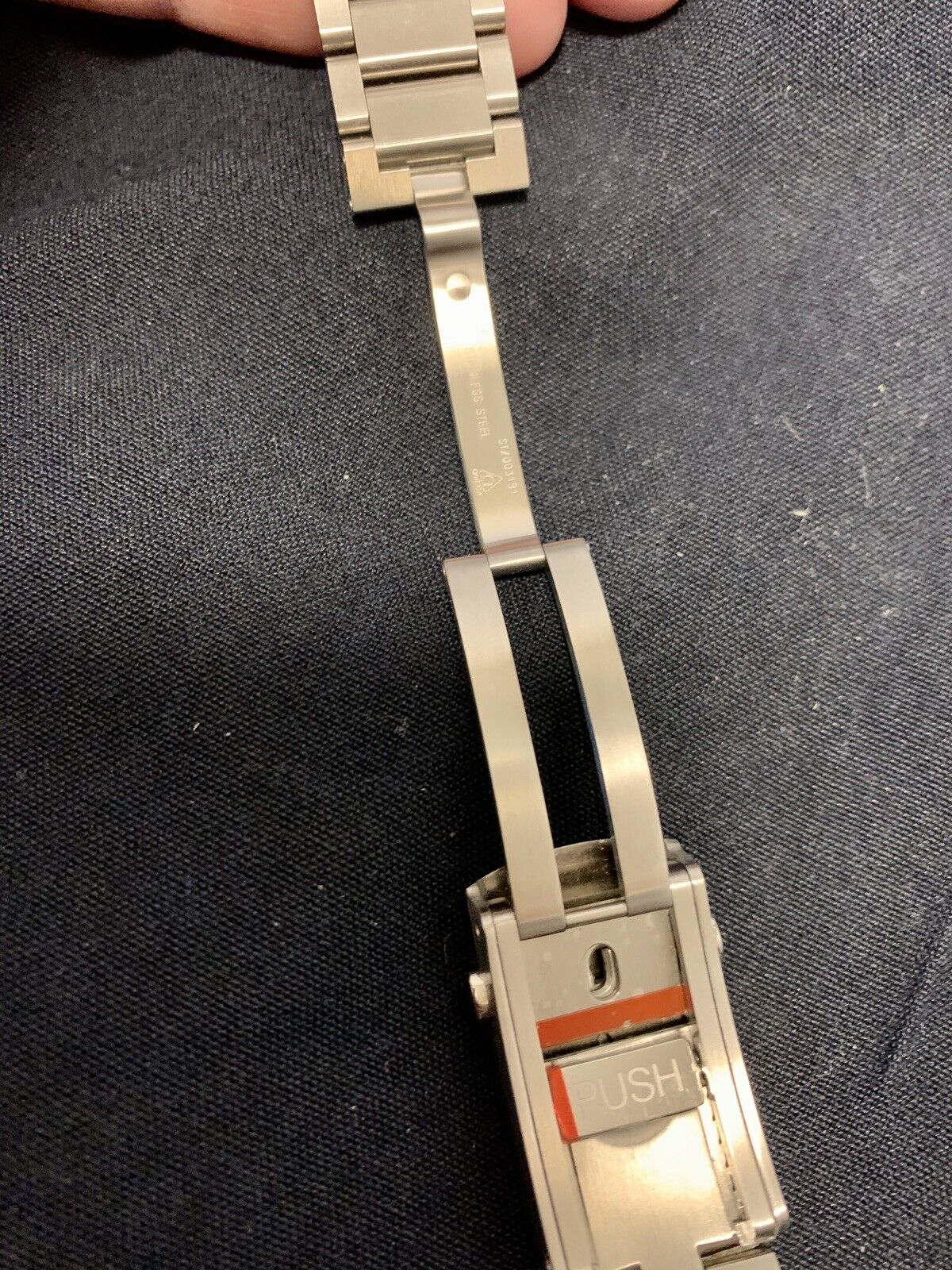

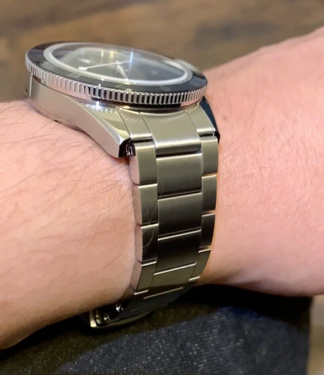

I appreciate your help guys. I hope the photos will be a tell tale for the trained eye. What worries me is some of the caseback is obstructed with his fingers.

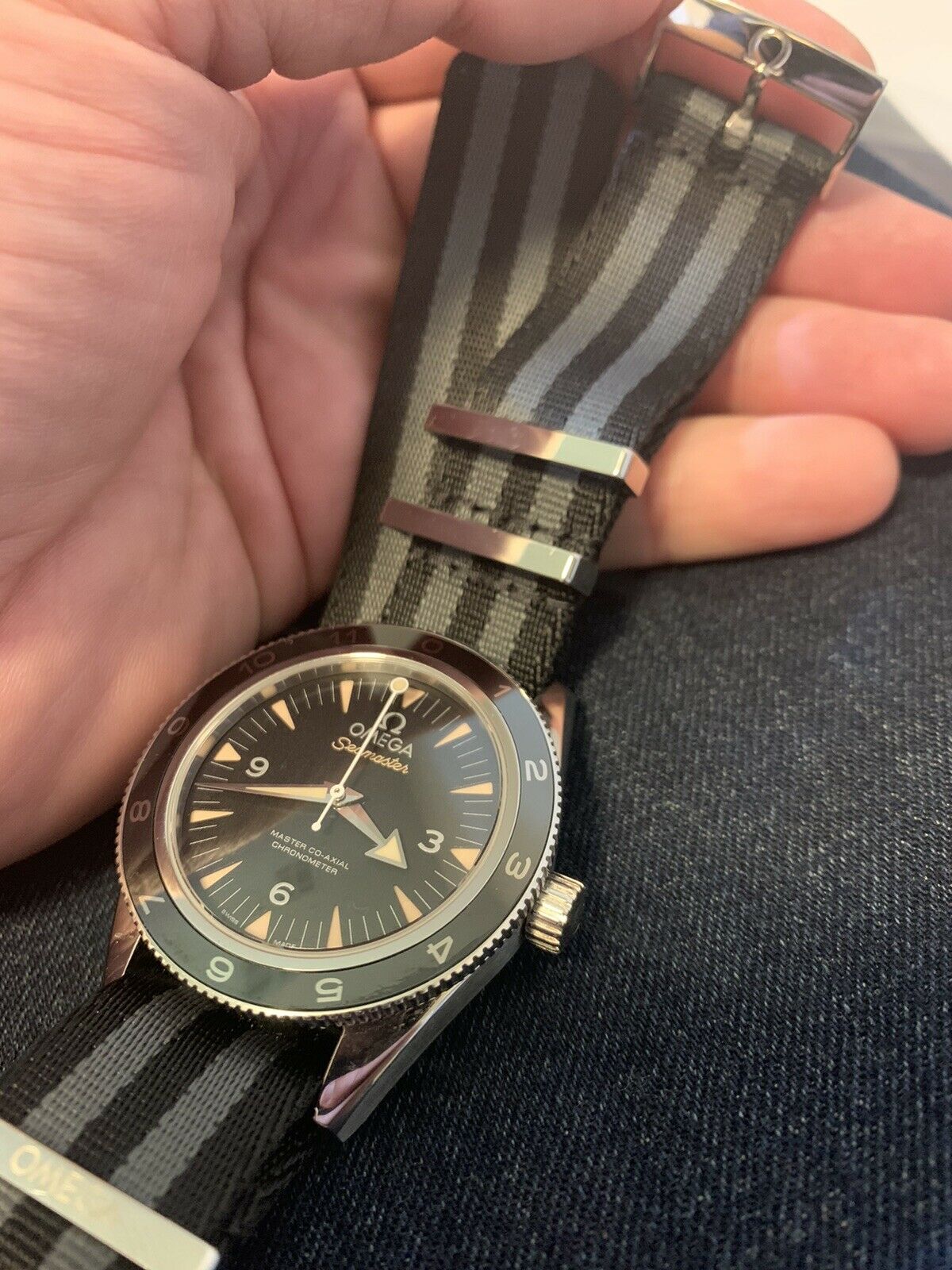

There is something about this watch that just doesn’t seem right... it starts with the NATO strap. I believe a genuine Spectre NATO has 007 etched on one of the keepers? This doesn’t. And photos that are even slightly blurry (as these are) set off instant alarm bells.

That is a fake. Look closely at the balance. It's not free sprung.

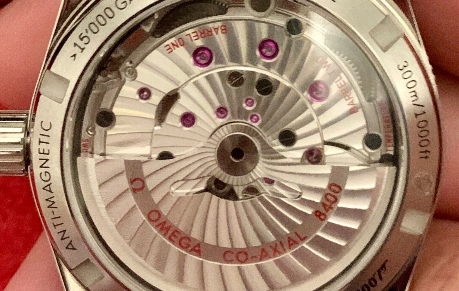

I'm calling fake. The regulator and balance is wrong. This is what the real one should look like:

Looked at the photo of the movement and knew it was fake, but because the crowd here is rather sharp, a bakers’ dozen of you beat me to it. The escapement gives it away on these fakes.
