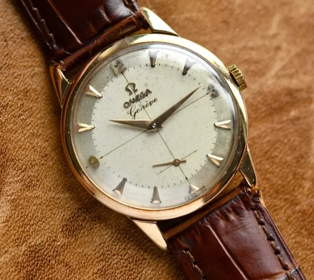

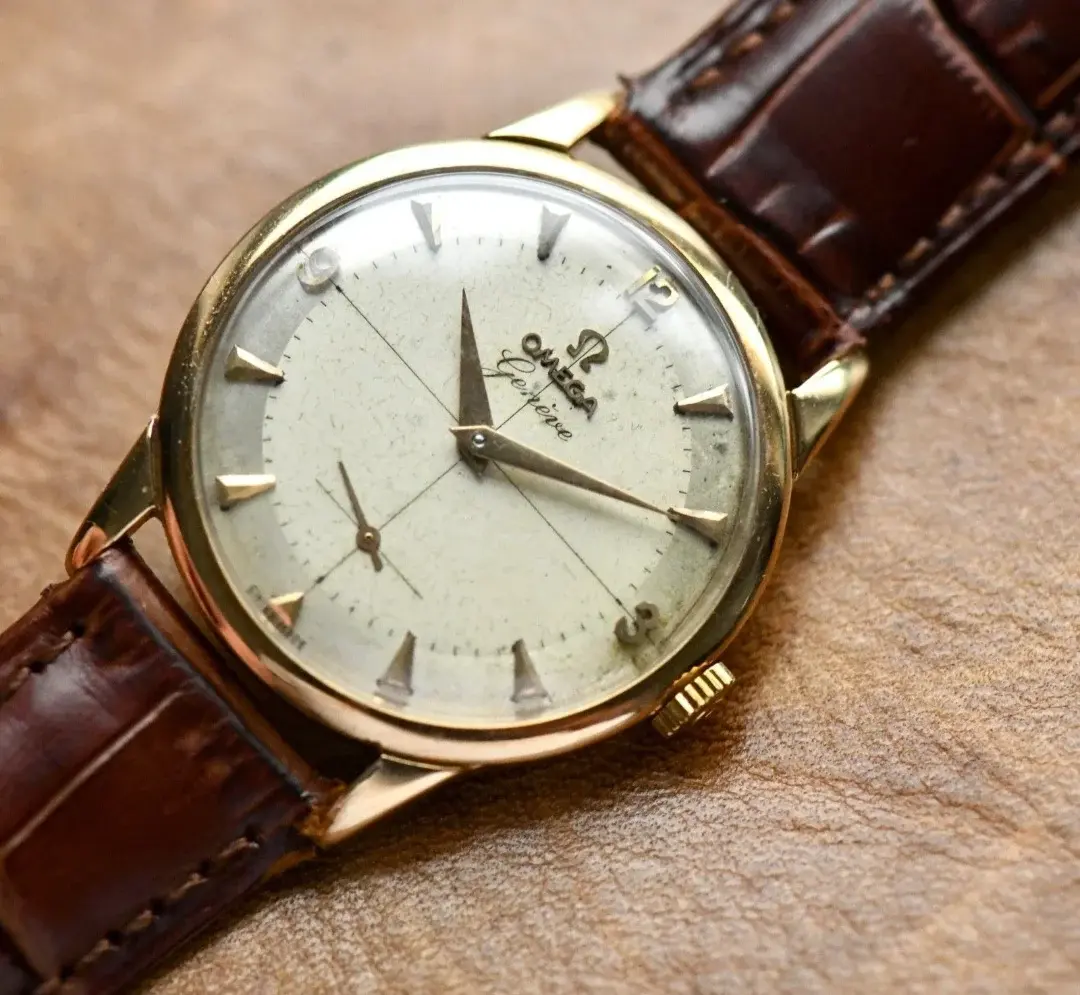

Hi All,
Just wanted your input on a Omega Geneve from a UK watchmaker!
This will be my first Omega watch and primarily buying it for my wedding, so I wanted a more 'dressier' watch.
The description is as follows:
Omega Geneve two tone crosshair SOLID GOLD
Manual wind cal.267
ref. 13332
serial-1579- 1956
Case size 34 mm without crown-light scratches,SOLID GOLD 9CT excellent condit -One scratch on Case Back 1,5-2mm
Original dial TWO TONE CROSSHAIR !!! -
omega crown
overall condition Very good
case original vintage condition
new dark brown/ burgundy leather strap
fully serviced
without box and papers
Please let me know if I need to put more info in.
Thanks in advance,
912
1,256

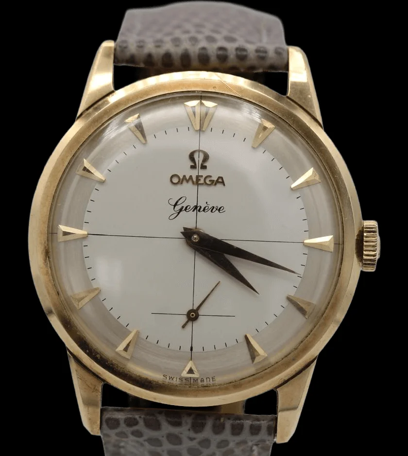

Hello. Congrats on the wedding.
The dial looks fine to me, but the picture isn’t great to be 100% sure. However I think there are a couple of the other issues…

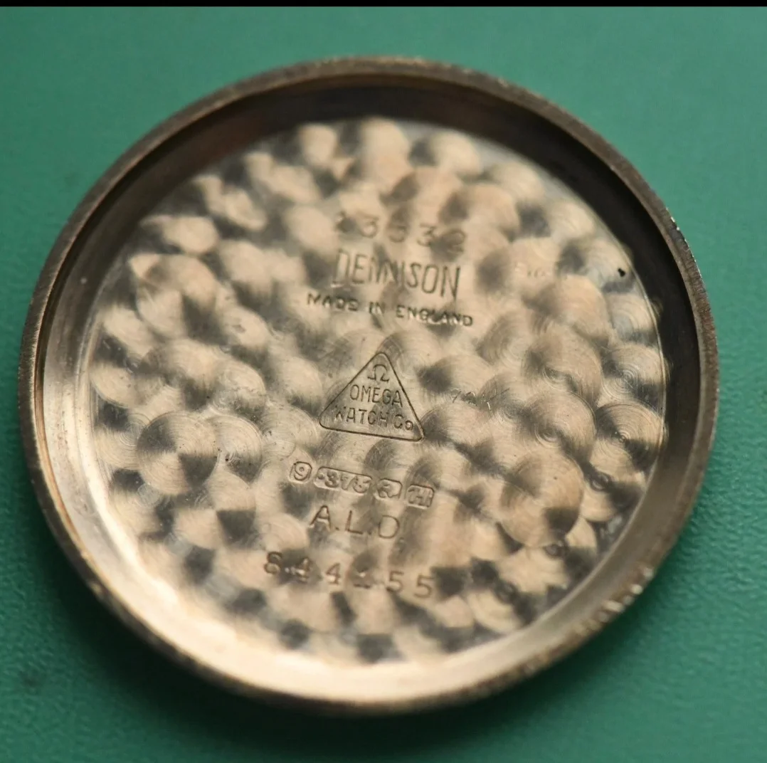

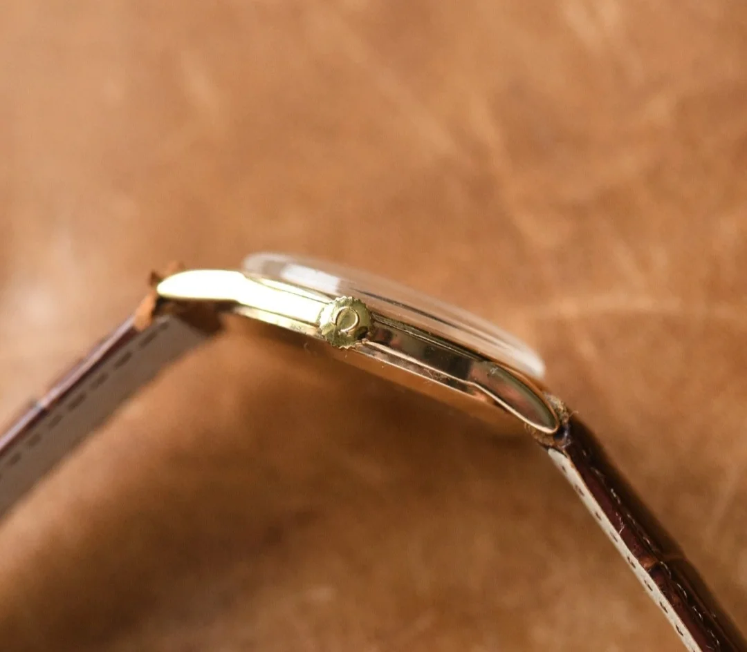

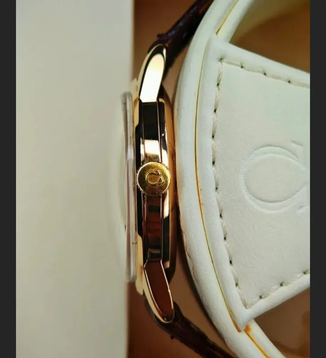

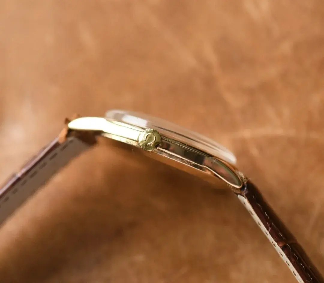

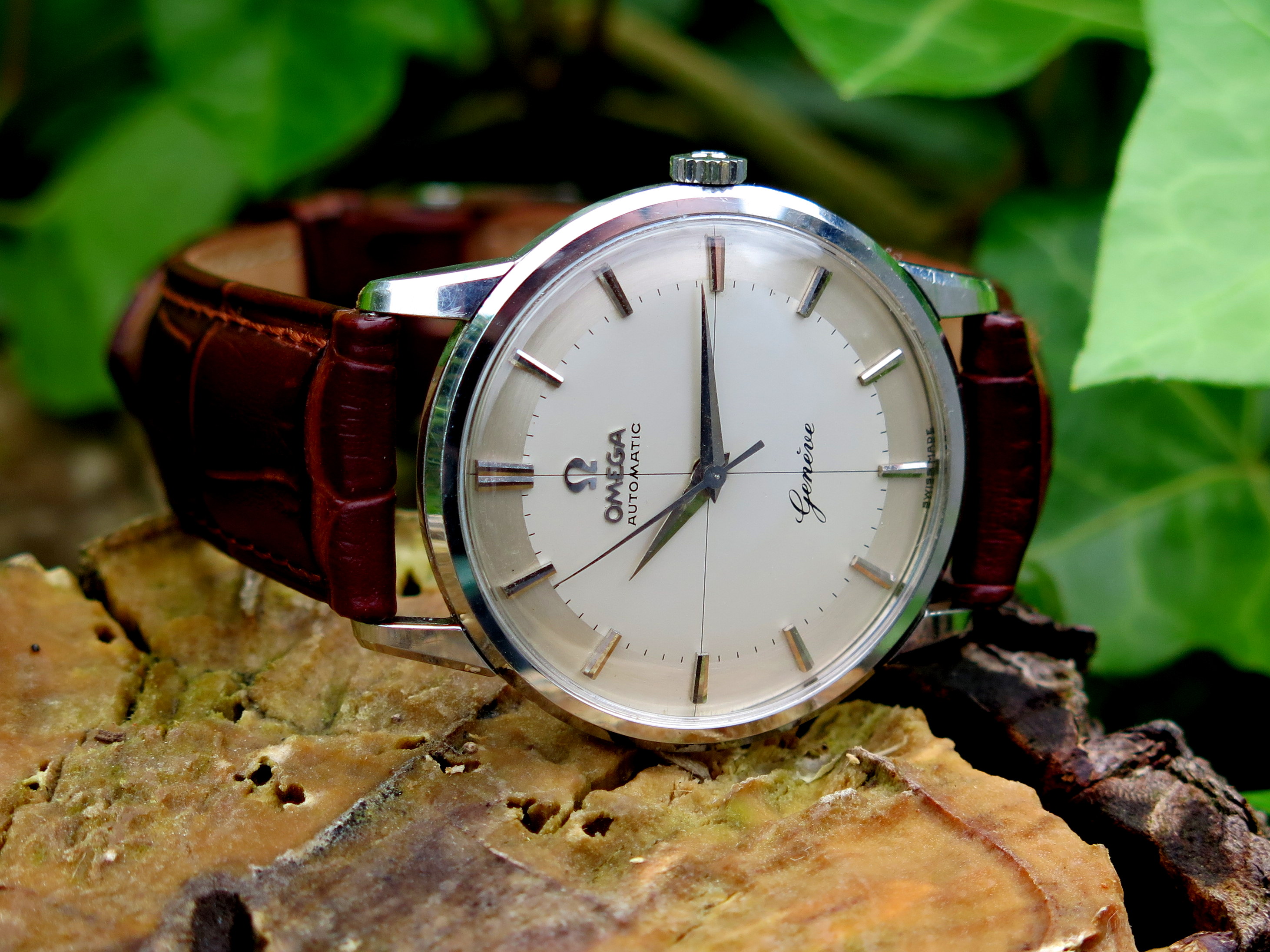

First the case isn’t that sharp - see picture below and look at the lugs for comparison. Also the hands seem long. The crown looks close to what’s expected but not quite the correct one.

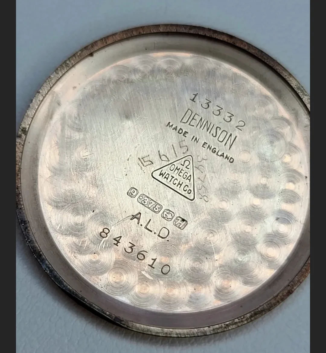

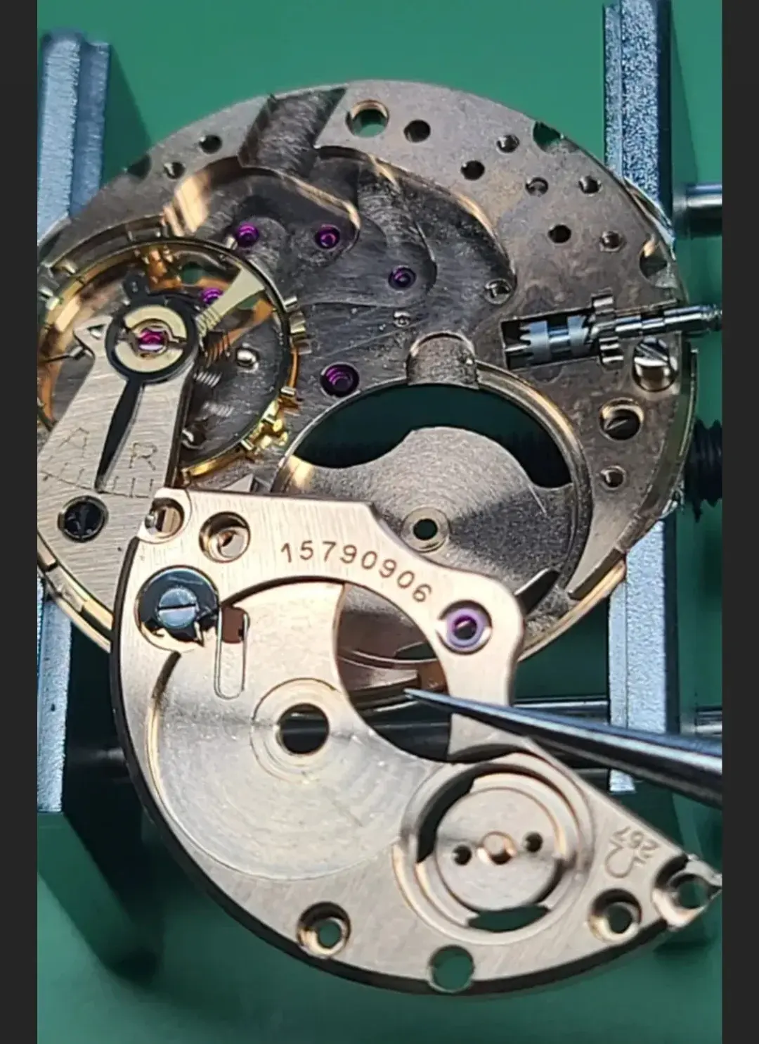

Note that the numbers on the case back (last three digits) need to match the lug number (not visible in the picture) on this ref.
Maybe you care, maybe you don’t! Not everyone is looking for a fully original example, but if you’re asking here you might! However I have a feeling this will be priced insanely high. What’s the asking price?
Given it’s 9kt this would not be as much as a 18k gold example.

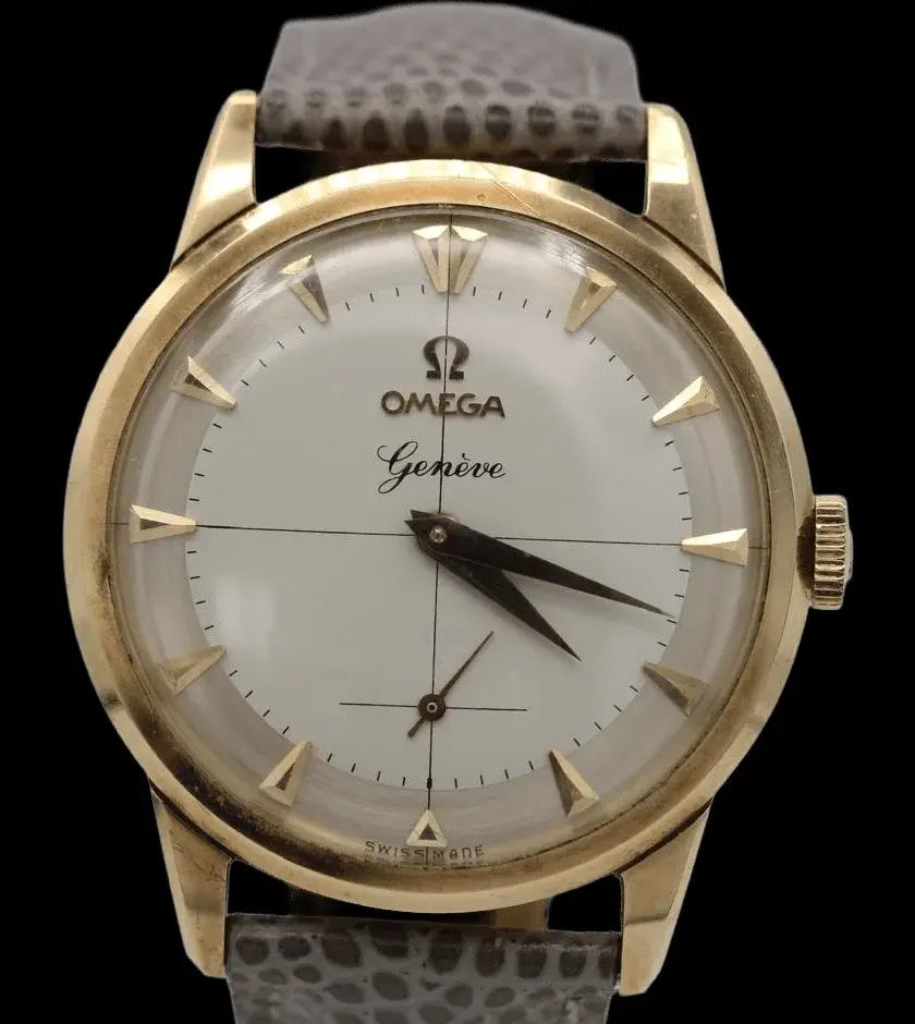

The watch below sold in the UK (at a dealer) a few months back for around 1300£ as a reference. Some of these 9k Dennison have also sold for 800-900€ on eBay in the past year- two years if I recall properly. Just to give you an idea of a “fair” price point between private people / dealers.

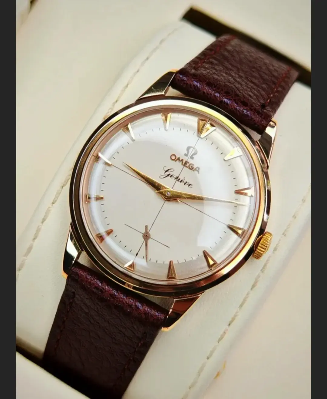

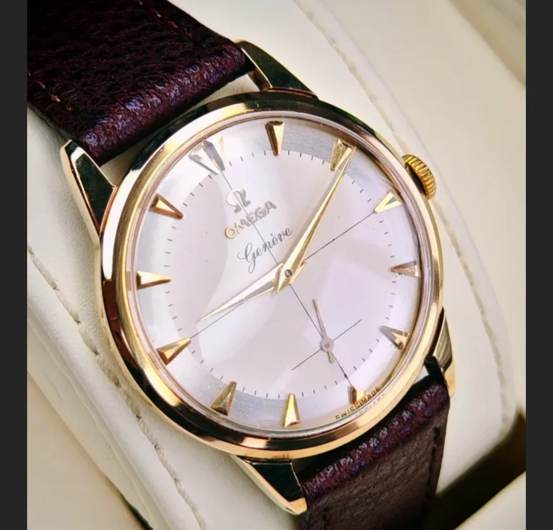

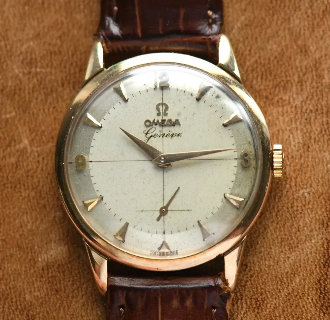

Omg thank you for your quick reply and all the info.
I can completely see what you are saying about the hands are too long etc and the rest of it.
Yeah it was quite expensive, the asking was 2k...I have just found one on Ebay for £1300.

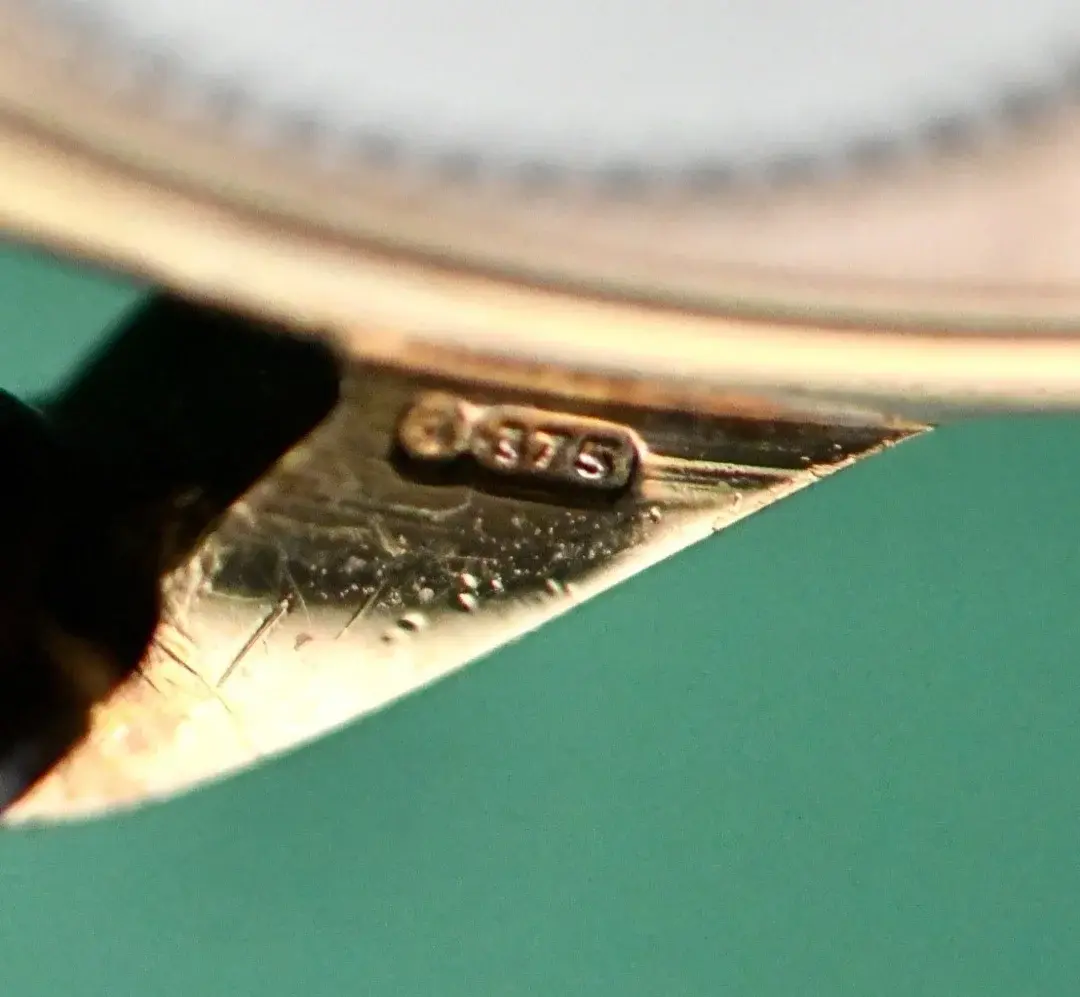

The hands look much better, and there is an image of the lug reference which matches the case.
The dial has more patina but it looks good, can you please take a look for me?
I have also found one being sold by a member of this forum, from the Netherlands for the same price. But I don't know how to link other threads etc But it looks clean etc
Thank you

When is your wedding?
For me the second one is a no go at whatever price. The dial is too patinated and the case is completely polished.

I think you may need to be more patient. At any given time, there initially seem to be a lot of watches for sale, but most of what you are looking at has been sitting unsold for months, for a reason. When something good is listed at a fair price, it sells quickly, so you should keep your eyes open.
The first one has been pimped for sale, but has issues that make it uninteresting to a collector, and the price is far too high given those issues. If you are going to overpay to that extent, you should get an excellent example. The second has an ugly water-damaged dial.

The first one has some problems, and is a franken at best. No way a case that has been that polished has a dial that looks like that. I'd guess it is a replacement dial (though, it looks authentic enough). The hands are very clearly wrong/mismatched and $2000 is A LOT for it.
