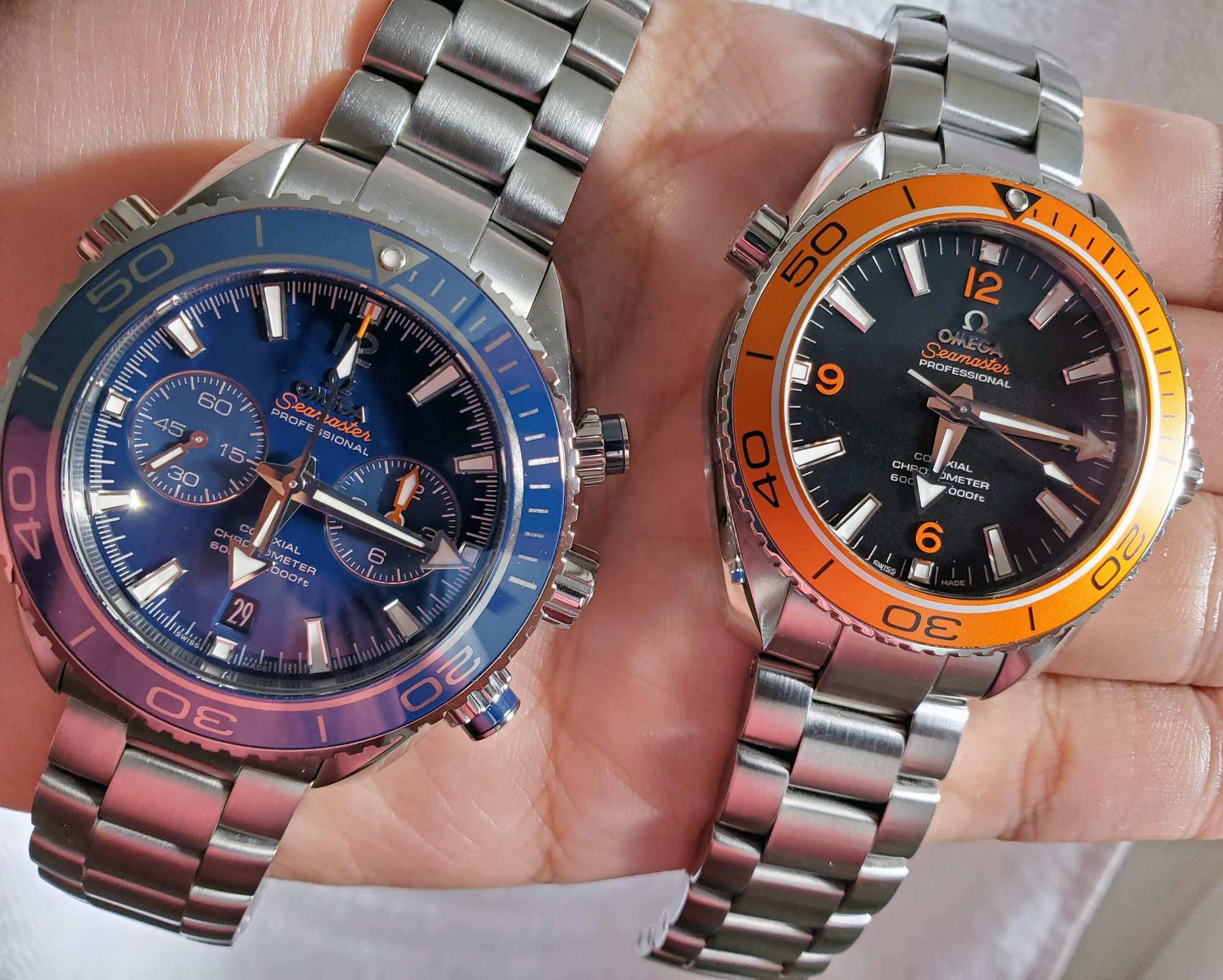

My previous daily automatic had the Omega 3603 so the 9904 is still quieter to me 😀.
