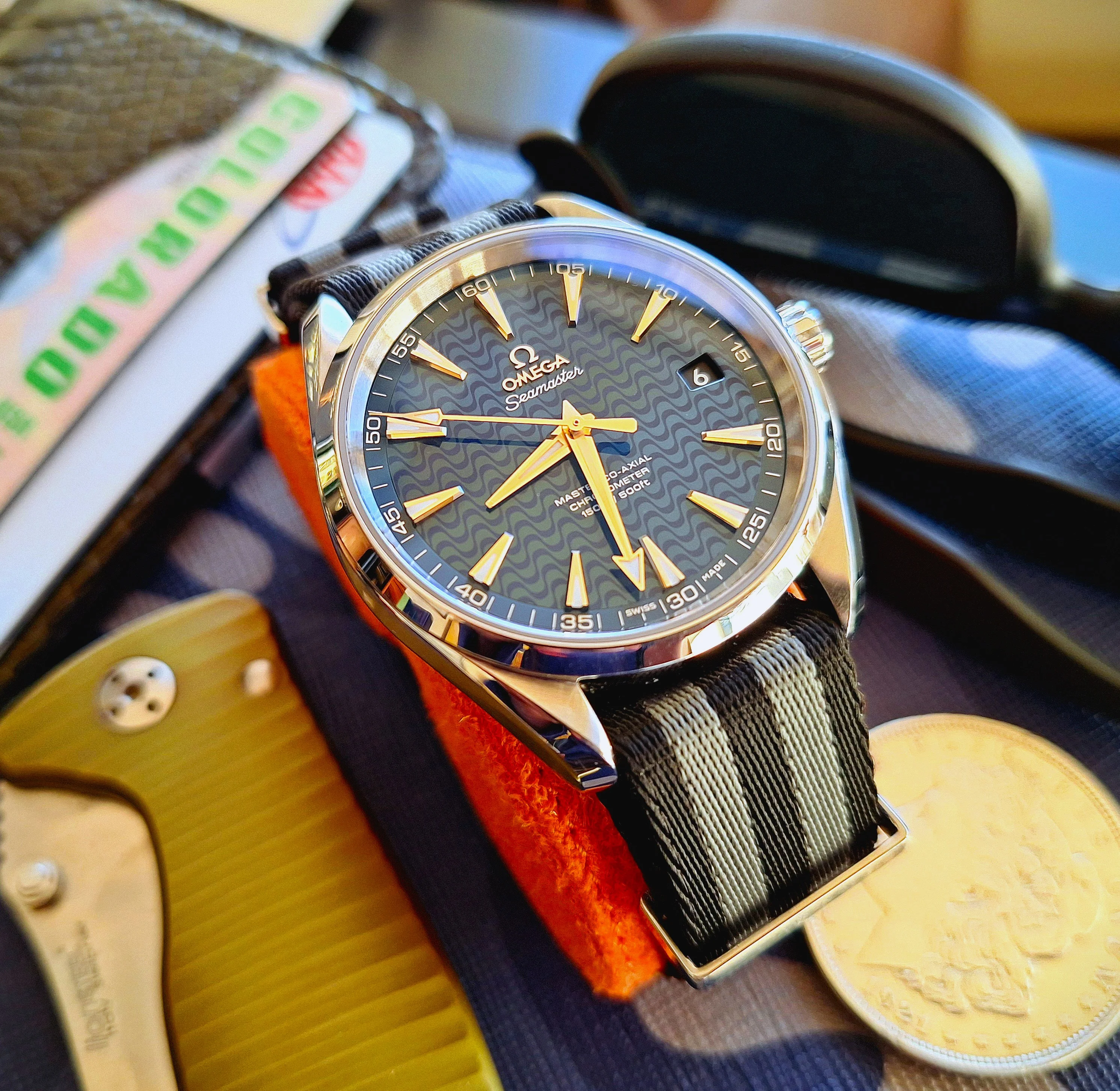

Greetings, friends. I have an AT 8500 Master Co-Axial (8500G) watch ref. 231.10.42.21.03.006 which is the “Copacabana” blue dial with yellow gold hands/indexes, 41.5mm case size from ~2016. This watch bears bracelet 1567/693 p/n 020ST1567693 which is the bracelet for the AT 8500 41.5mm with polished center links.
Ref: https://www.omegawatches.com/en-us/...r-co-axial-chronometer-41-5-mm-23110422103006
Ex: https://omegaforums.net/threads/my-first-omega-seamaster-aqua-terra-blue-wave-41mm.92042/
My question is:
Will the 1586/985 p/n 020ST1586985 bracelet for the AT 8500, with fully brushed links, also fit my watch?
Ref: https://www.omegawatches.com/en-us/...m-co-axial-chronometer-41-5-mm-23110422103001
Ex: https://omegaforums.net/threads/omega-aqua-terra-bracelet-1586-985-20mm.140054/
I don't see why they wouldn't be interchangeable. I did search for a definitive answer to this first but came away uncertain.
Please advise. Thanks!

May I rephrase? Does the earlier brushed center AT 8500 20mm width bracelet from the "Skyfall 41" (i.e., bracelet 1586/985) fit later AT 8500G 41.5mm cases that came with the polished center link bracelet (i.e., bracelet 1567/693)?
I realize that this is potentially a stupid question and that the answer is probably, "yes, obviously." I can also synthesize reasons that they may not be compatible, for instance, the pin holes moved.
So far, SGUS has not responded.

I think it's interchangeable. To my knowledge the only thing that changed from the Skyfall 41 to the Spectre version of the AT was really the dial. The case is identical. If you go to an Omega Boutique, they'll be able to order it for you to try on to see.

Thank you for pointing out that this watch is in the "Spectre" line because that term landed some better search results. Pretty sure that both bracelets are compatible at this point. I have a line on a private sale 1586/985 still wrapped for a great deal, so I'm not purchasing through an AD/OB or SGUS on this one. Cheers and many thanks!

Not that anyone cares but just to be complete: OMEGA responded, yes, the fully brushed bracelet 1586/985 is interchangeable with the PCL bracelet 1567/693 and thus will fit the later 'Spectre' era AT 8500G case. And they will happily sell you one for your AT 8500G model. Thanks, again, @texasmade ✌️
