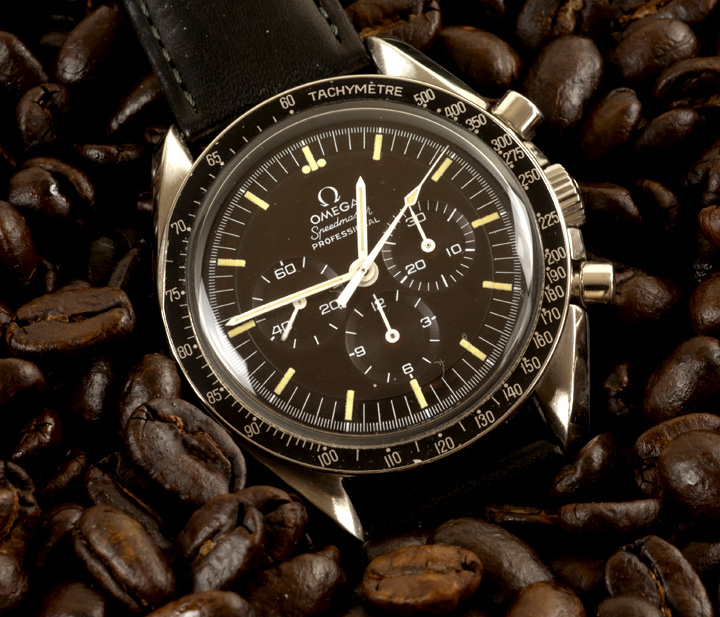

I recently lost out on this auction but I'm curious whether I should have bid more. speedmaster101.com seems to suggest this price is about right. I am new to vintage Speedmasters and would also like to know if I missed any obvious problems visible from the pictures. (Apart from the fact the chronograph doesn't seem to zero at 12.)

Hi Bitt3n,
watch went for an average price in today’s market IMHO. hands look to have been re-lumed to match the dial , as for the chronograph not resenting that could be an easy fix the person how fitted the hand may not have lined them up properly or there may be underlining problems with the watch. if you’re looking for a speedy try the forum the watches are honest as are the sellers .

Doesn't look like a great example. Not bad but not great. Is that a step dial? No DON either.
Price wasn't bad, Movement looks clean but pushers etc look dirty and if it was going to be a daily wearer would likely need replaced.

Was also lurking on this one. Decided not to bid and finally the price went higher than what I'd have offered for that.
That's something I didn't notice. Am I correct in understanding that it's the uniformity of the lume that suggests it was re-applied (no darker or lighter parts)?

For me it's not a question of is it great or not - it clearly isn't great. But it is attractive.
It is a fair 145.022-69, with an incorrect bezel and in urgent need of a service.
The bezel is relatively easy, DN90, and the service is without problems if you life in uk.
The hour hand lume is not an issue for me. They look nice and that's what counts. And way better than SL hands. I might keep a pair of naturally aged hands nearby if I owned this watch, but honestly after all this is done I think it's a £4000 watch.
If you think I am wrong, and I may be, then show me another late 69 in attractive, correct serviced condition for similar money.

@Spacefruit dial's wrong though, it's a MWO C3 from the late '70s / '80s - meaning you'd be looking at approx. US$500+ for a correct stepped dial. Not sure about those pushers & crown either - if you ask me, the only value in this one is in the caseback

I'm not sure I believe that watch. The lume on the hands and dial just doesn't look naturally aged to me. Especially the hands which are bright white, yet somehow have very aged lume. Add this to the new service bezel, and flat dial and I think it's been knocked together to look older than a lot of its part actually are.

It looks like a service dial and without the correct DON bezel either. A service would run 850 here in the US so take that into consideration. A correct dial(if not stepped) would go for the cost of a service and then some. I would have passed as well.
My thoughts exactly - those C3 dials usually don't age like this. Most are only slightly yellowed

I'm surprised no one has called out the bubbling on the dial near the indices for 8 and between 5 & 10.

The 31,xxx,xxx serial dates it to 1972 so a 1969 is out of the question
29/30/31,xxx xxx are all fine for -69's
Chronomaddox is a bit off. I just checked speedmaster 101 and they have it as ok. My mistake

Isn't the crown also wrong for a 69? It should have a 24(?) step crown or something like that?
