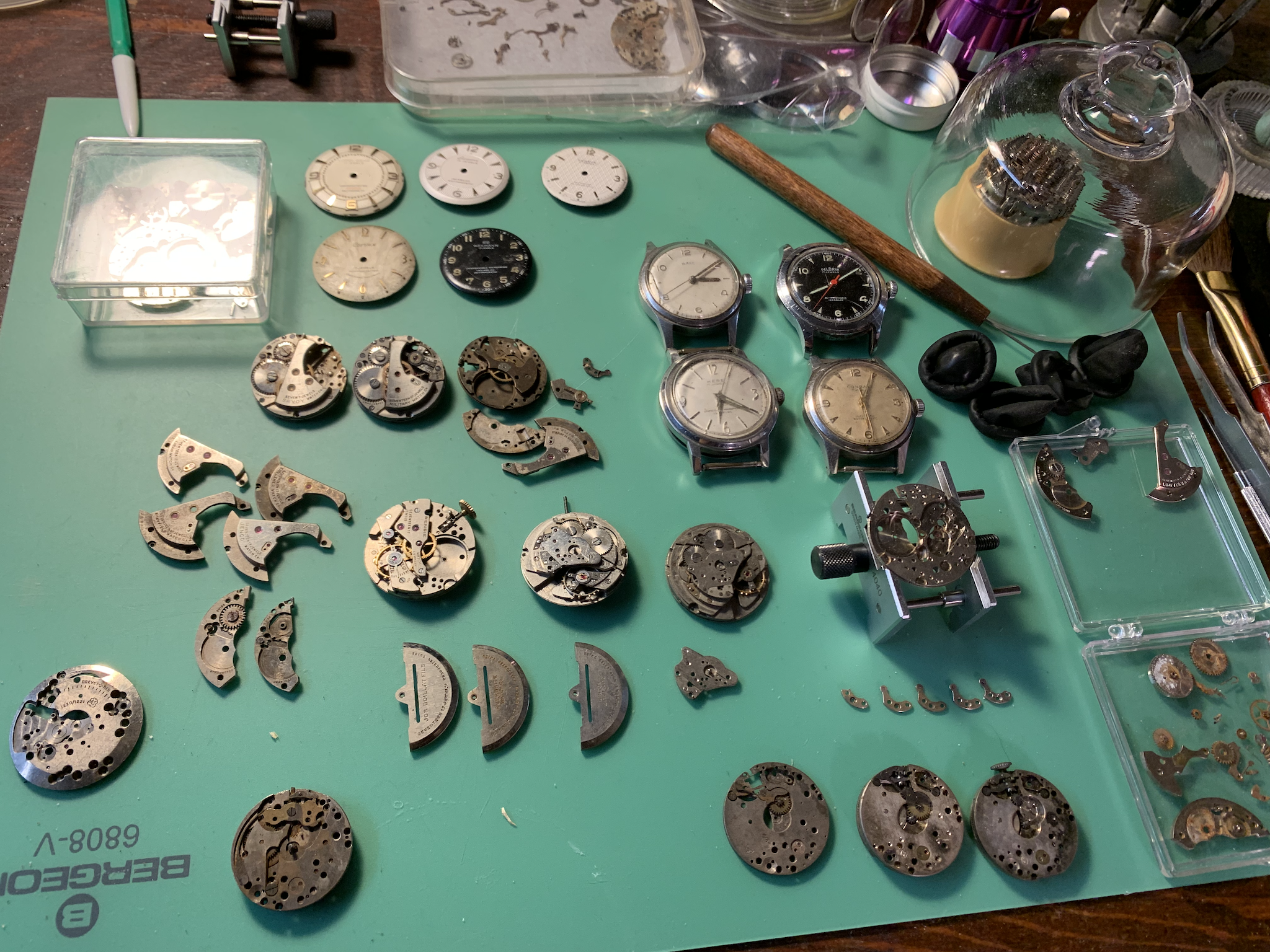

Encouraged by the success. I took some pegwood and cleaned up the movement whicl letting the Val-72 plate soak.
I thought I would see if I had a bridge in my box of spares since I had a pattern to match. I then noticed other movements had the same pattern. These had a distictive bridge. I was able to match a few more parts. I think the delbana I got recently may be a similar movement.
I then started cross referencing the movements on ranfft. Some of the parts look similar across the calibers. I have not done any best fit cross references yet. Looks like I have half a dozen or so of the 1187.

Maybe there is an interdimensional Santa Claus. The thing I was wanting most on Christmas morning was a new watch project as a box of parts. While I have been letting the Val-72 plate soak (the pallet bridge is out but one of the other broken screws is being stubborn.) I sorted through my box of junk movements.
The odds of finding a complete movement in the scrap bin of random parts are not good. There might be parts from 200 movements sorted into the boxes. So the best I would give might be 100 to 1 and that is being generous. At best one can find three or sometimes 5 of a given part. Nothing really matches until this week,
I found a Wakmann dial which fit the plate I have been using to test the Alum solutions and other chemicals. The one thing I figured I would not have is a balance. Years ago in a fit of whatever, I sorted many of the parts into trays. All of the balances got sorted into a tangle. More recently when looking for the Betlach stuff I sorted out those and the remainder to large and small.
Sorting though the smaller balances I found 1/2 a dozen candidates. Some might even have good pivots on the staff. Most of the hairsprings might be tangled. (They have been in the tray for over 20 some years) There is also the issue of incabloc vs flat balances. I think the over coil hairsprings are more likely to tangle. I have the book and I often state I would rather untangle a hair spring than list something on eBay. So now I have more to practice on. (careful what you wish for.)

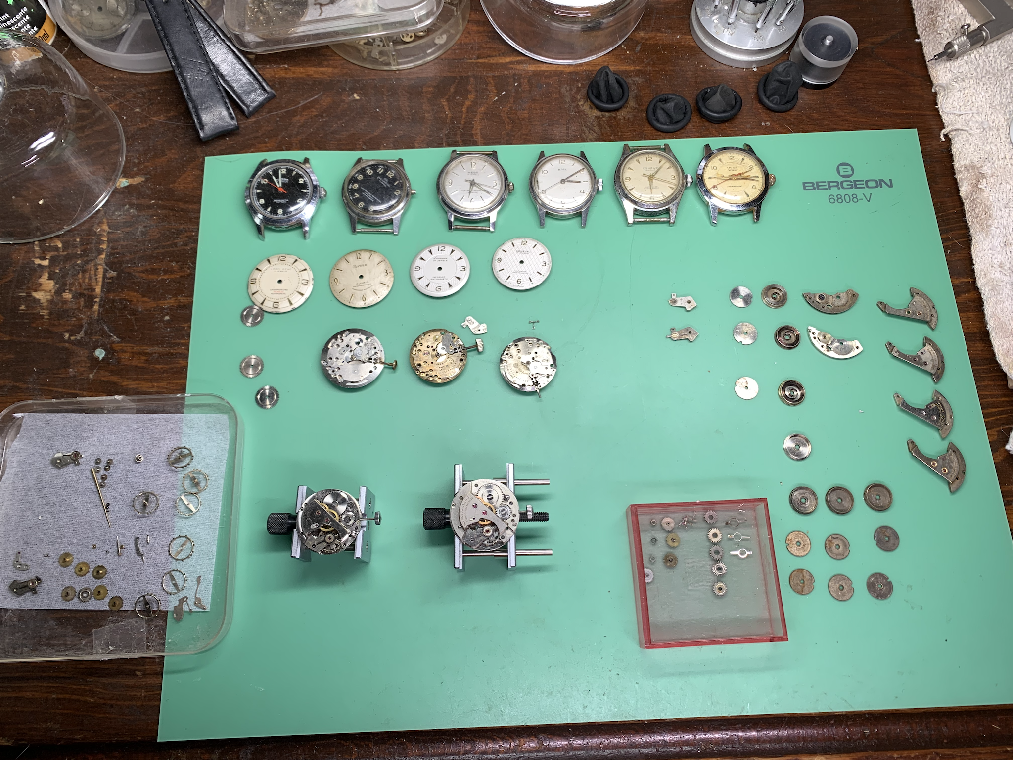

In the meantime while waiting, I decided to assemble what I could of the five movement plates that were in various states of assembly. I got two movements complete with one ticking. The other one will not tick. I think it is the hairspring which still has some deviation in it. Since I got the other rusted one (Upper right in the photograph) I wanted to clean the bench for other projects.

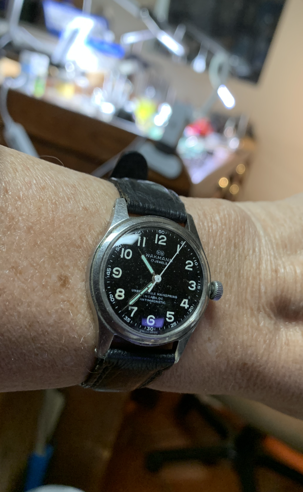

And it is cased and strapped.
I am impressed how It came out. The NOS hands look really good even if the sweep hand is not quite correct and the lume is more green which the photograph tends to enhance.
Pretty good for a collection of random part that have been in a drawer for decades. I still think Santa Claus hid the dial on Christmas as I did not realize I had all the parts to complete it til then, when I was looking online dreaming of getting a project watch for Christmas.
The main plate, Is the one I tested the Alum on as it had a broken pallet bridge. So was somewhat identical to the Val-72 stuck screw. I also ran some of the parts through the Evap-O-Rust.

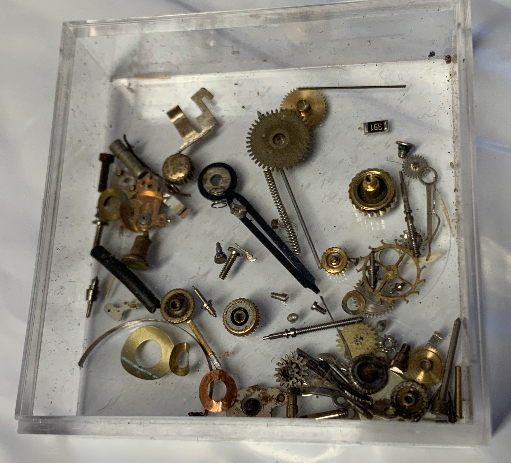

I keep a small tray for parts I find on the floor. (sometimes several trays in different parts of the room.) This is a mix of watch parts, camera parts, and electronic parts. Even clock parts.
Granted this is a six month to many years accumulation. Sometimes I do find something interesting in it. I separated out the chronograph parts, which also do not make sense when the part is accounted for in all the existing examples.
I have posted this before as 'sacrifices to the watch gods.' Where do these parts come from? why do I find unrelated parts when I sweep the floor at least once a week. Or daily when I am working on a watch?
Currently I am only aware of one missing part which I think went behind the bench. So why do I find screws that do not fit anything I am currently working on?
I can sort of understand hour wheels and dial washers. These fall out when I inspect things. Spring bridles shoot out when the mainspring unwound. Some of the camera parts make sense as well as I was scrapping APS cameras.
