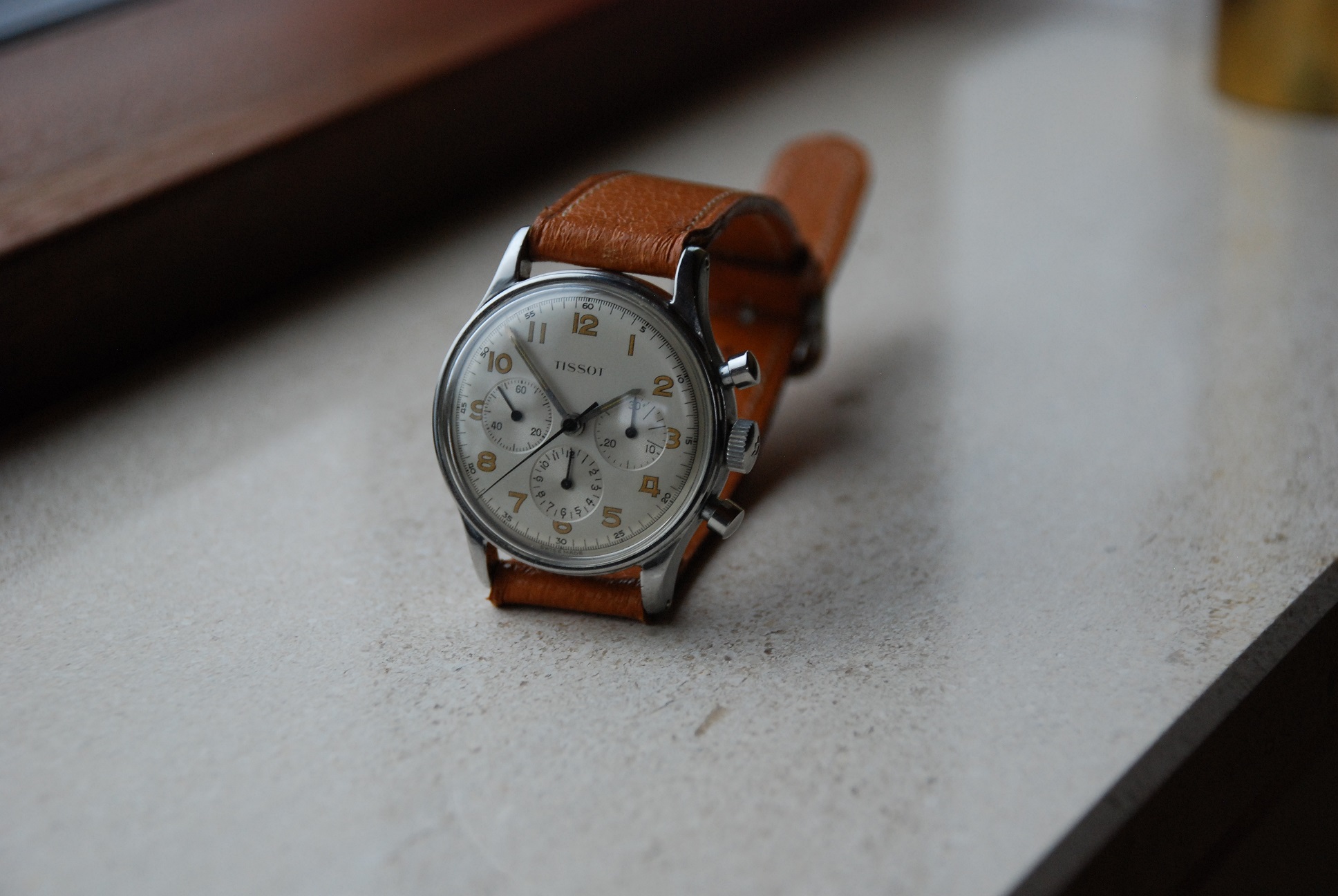

Finally, arrival!
It's just bloody good-looking! It's surprisingly hefty (a good thing) and has very few cosmetic issues (a VERY good thing!), but the chronograph suffers from resetting issues. As @Hijak said, it's clearly not a redial and in the flesh it is really something! Looking at the photos in the listing, I was certain that one of the pushers had been replaced with a different type, but hands-on I cannot discern anything off... The patina on the markers is sweet and after being subjected to some LED lighting for some time, they glow briefly.
I haven't had it opened yet, and I will have to book an appointment with my watchmaker, but... I'm very happy 馃榾

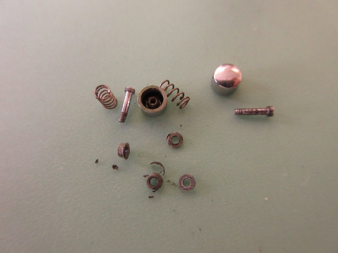

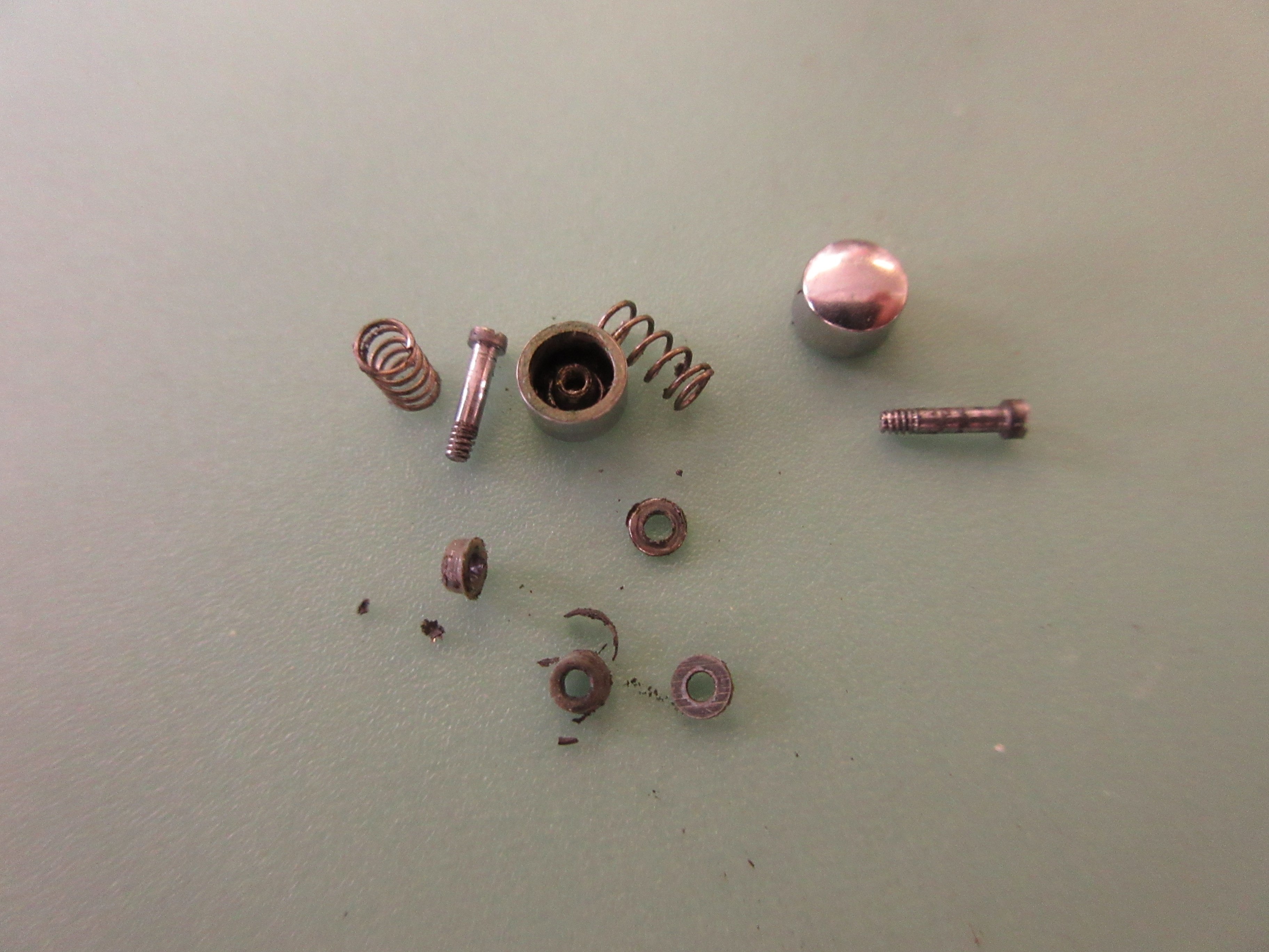

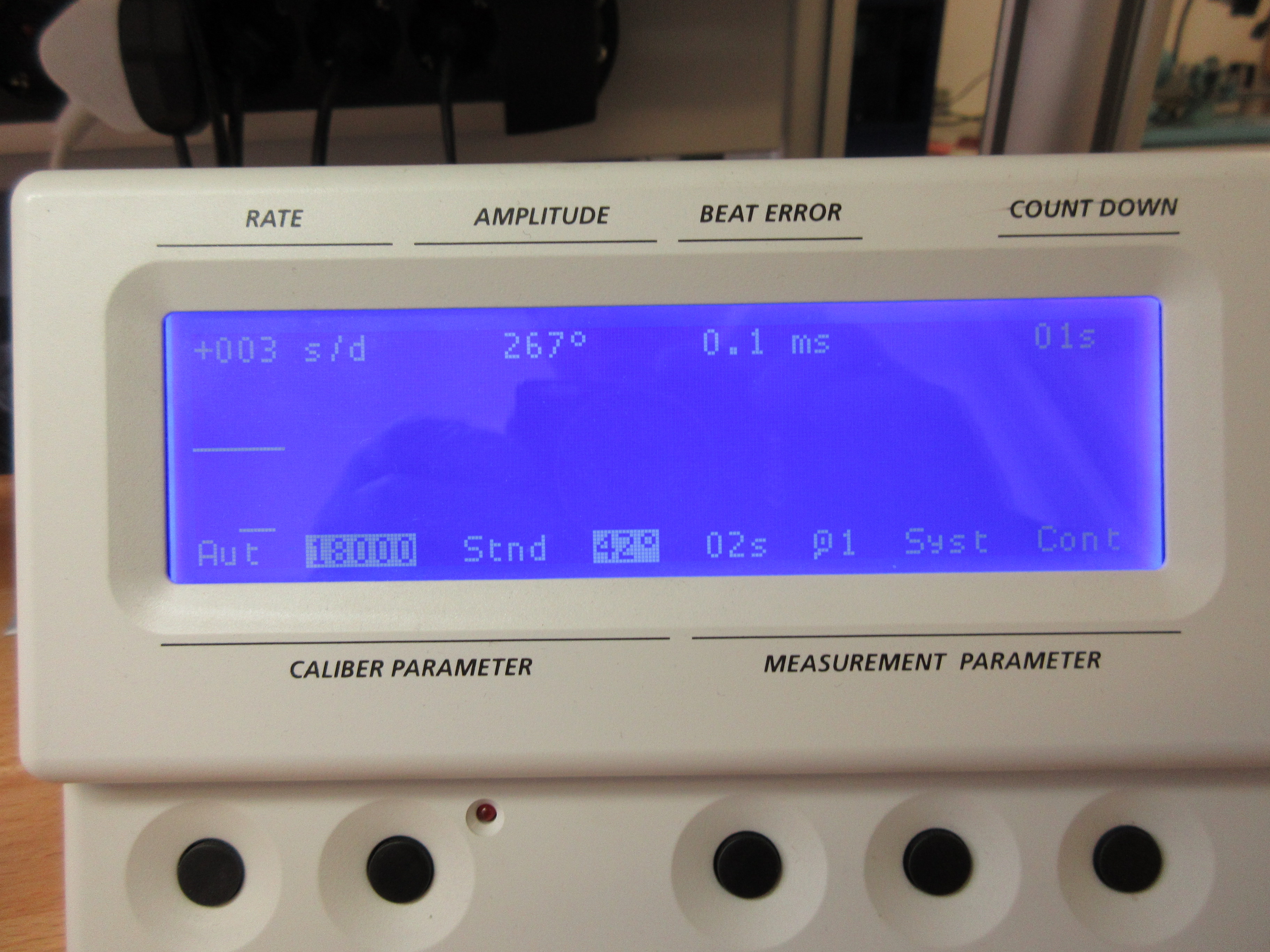

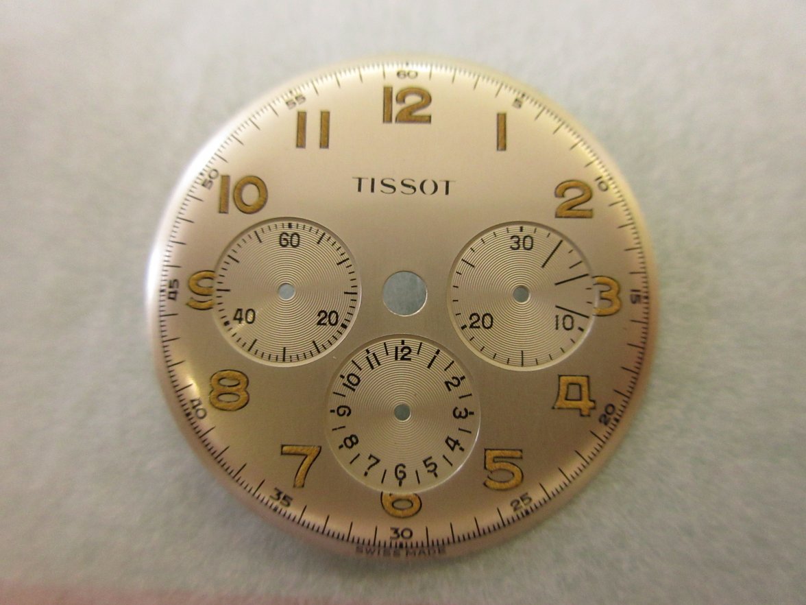

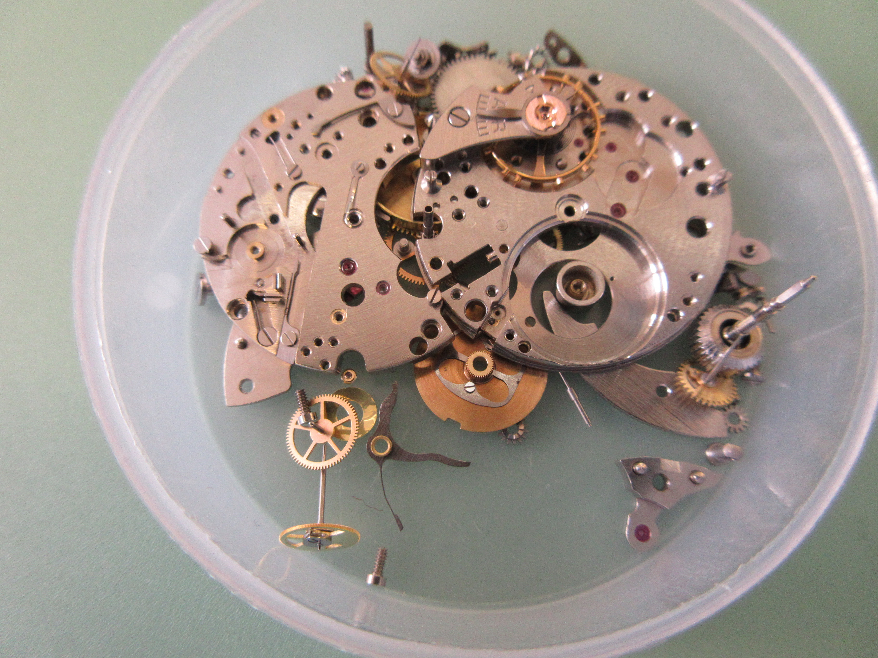

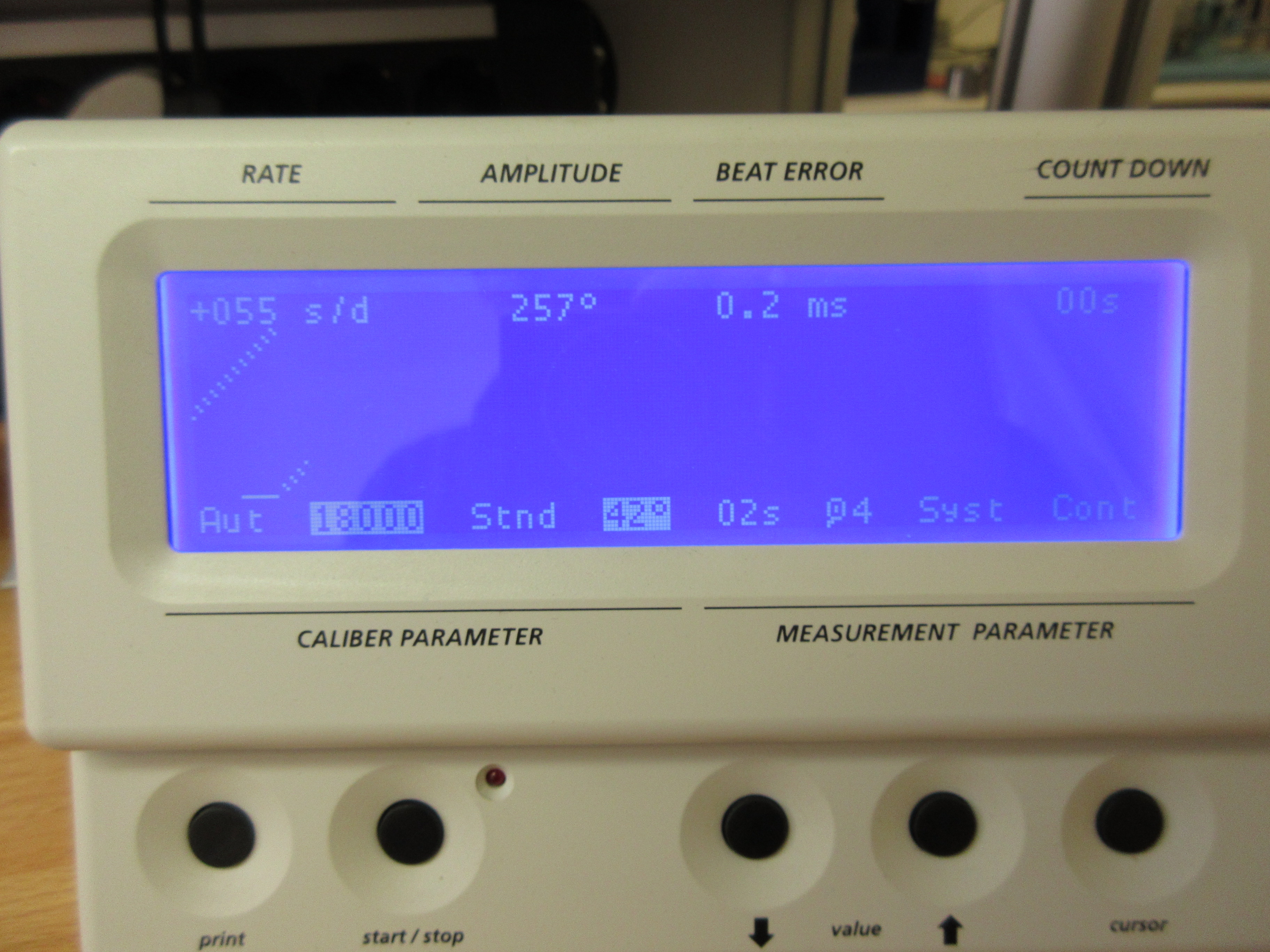

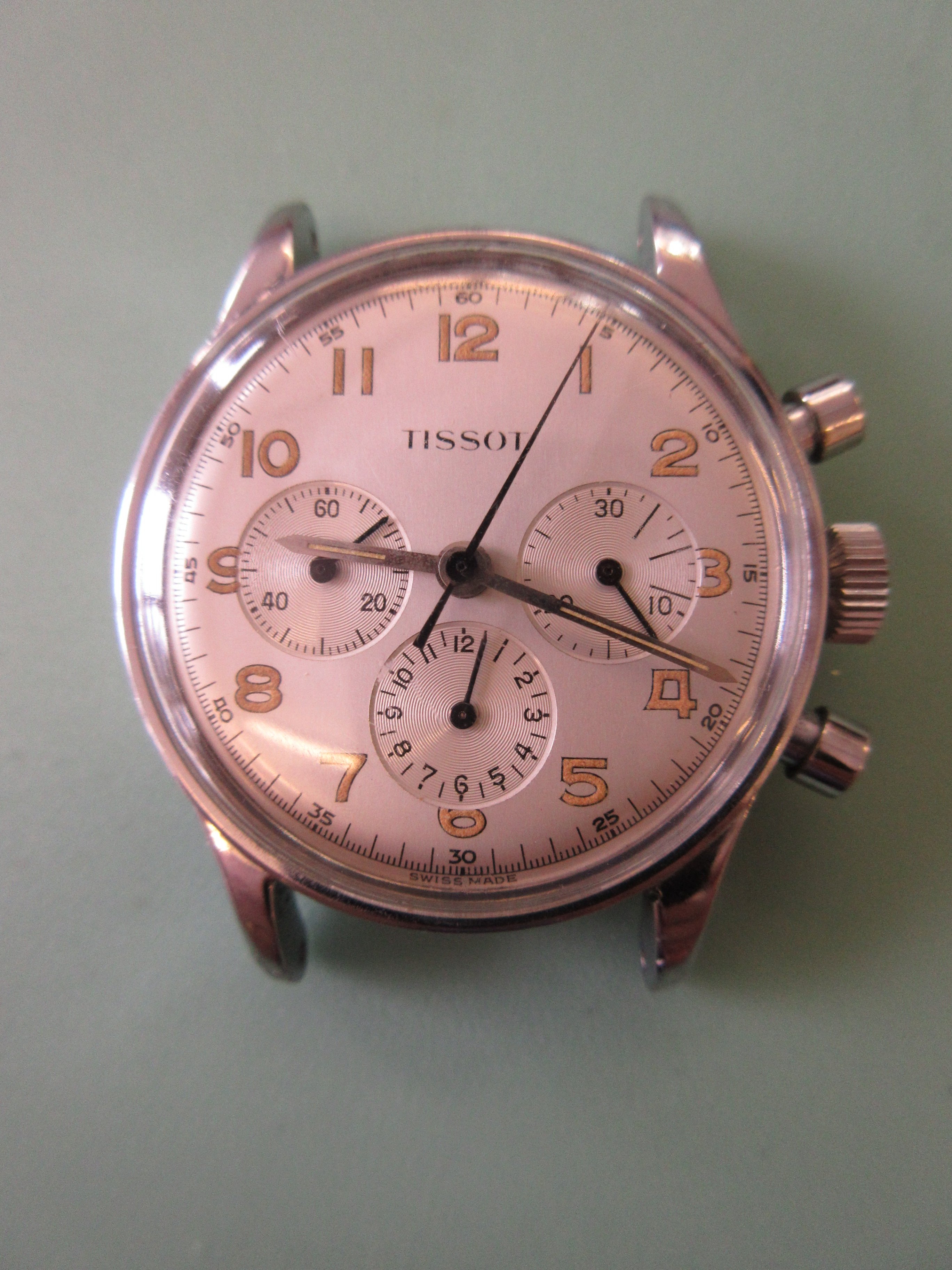

The Tissot is now in the final stages of testing at the watchmaker's, here's a few photos:
At arrival:
Not too impressive...

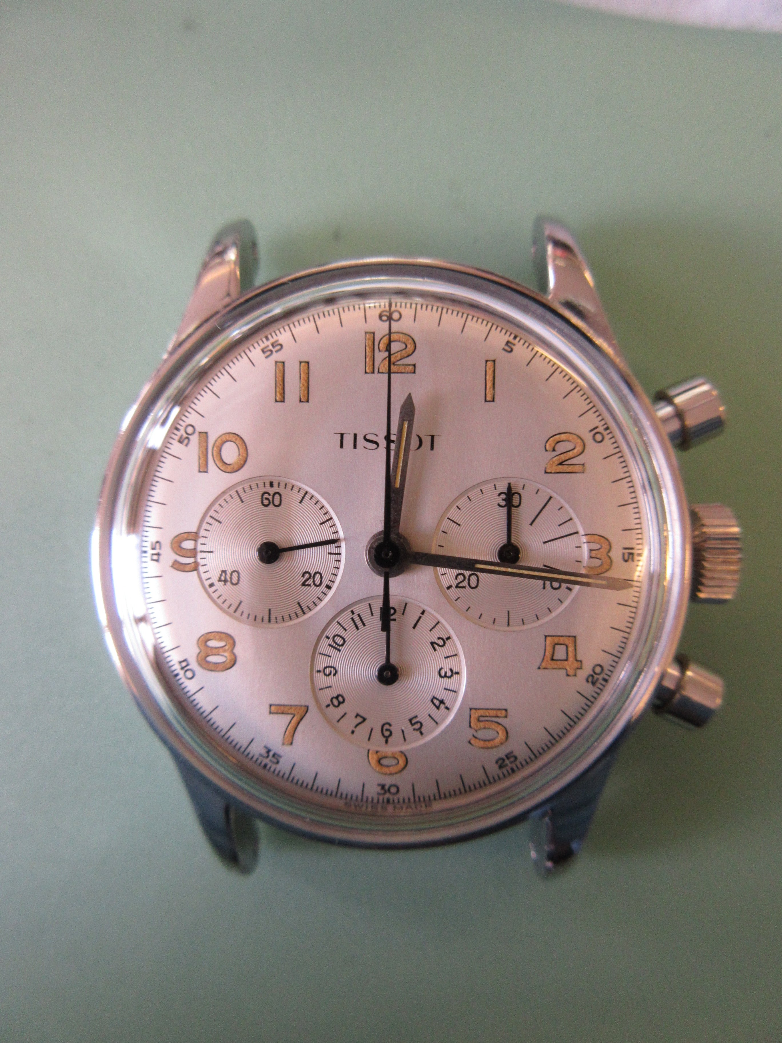

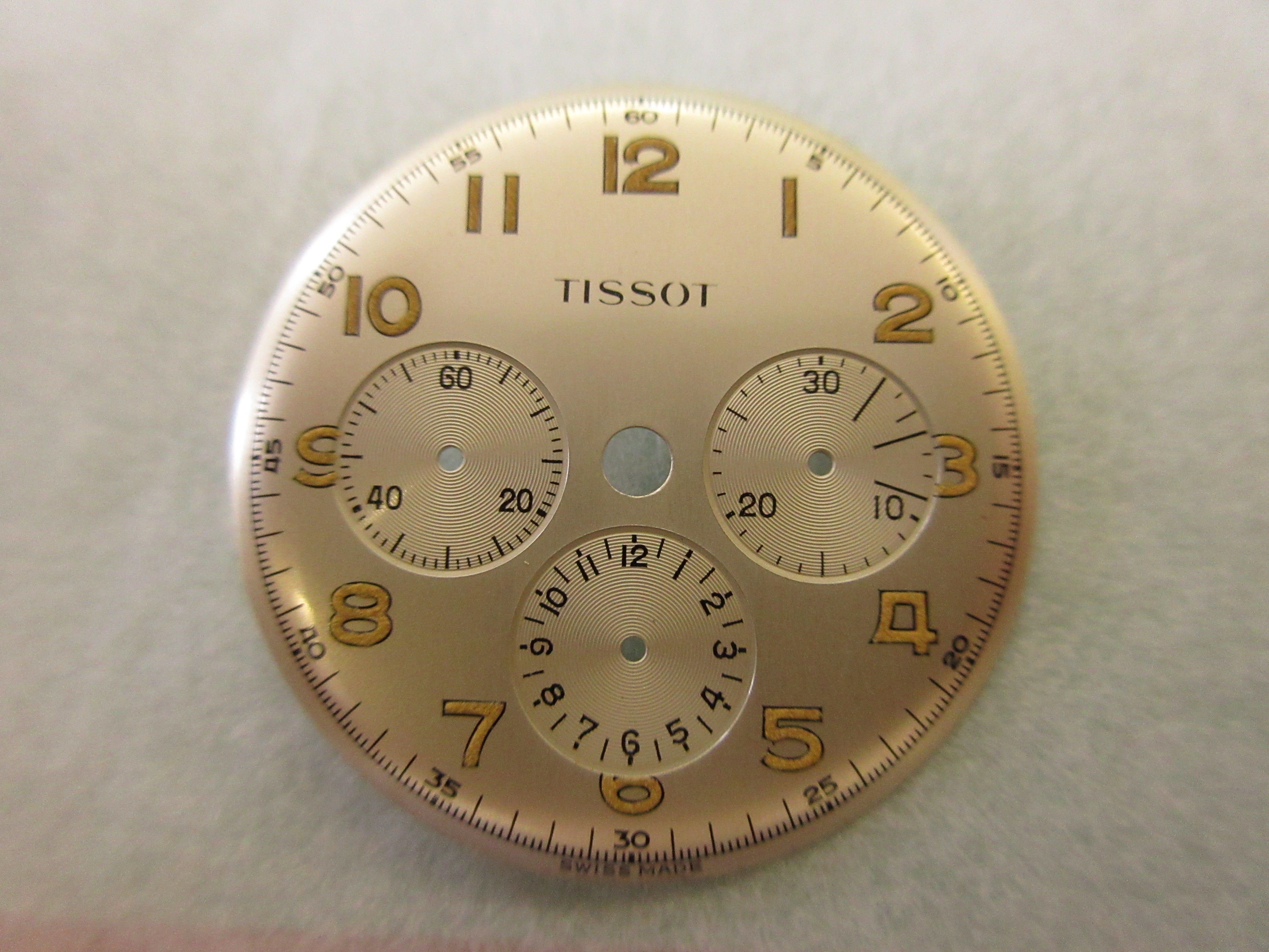

Nice dial, though! 馃憤

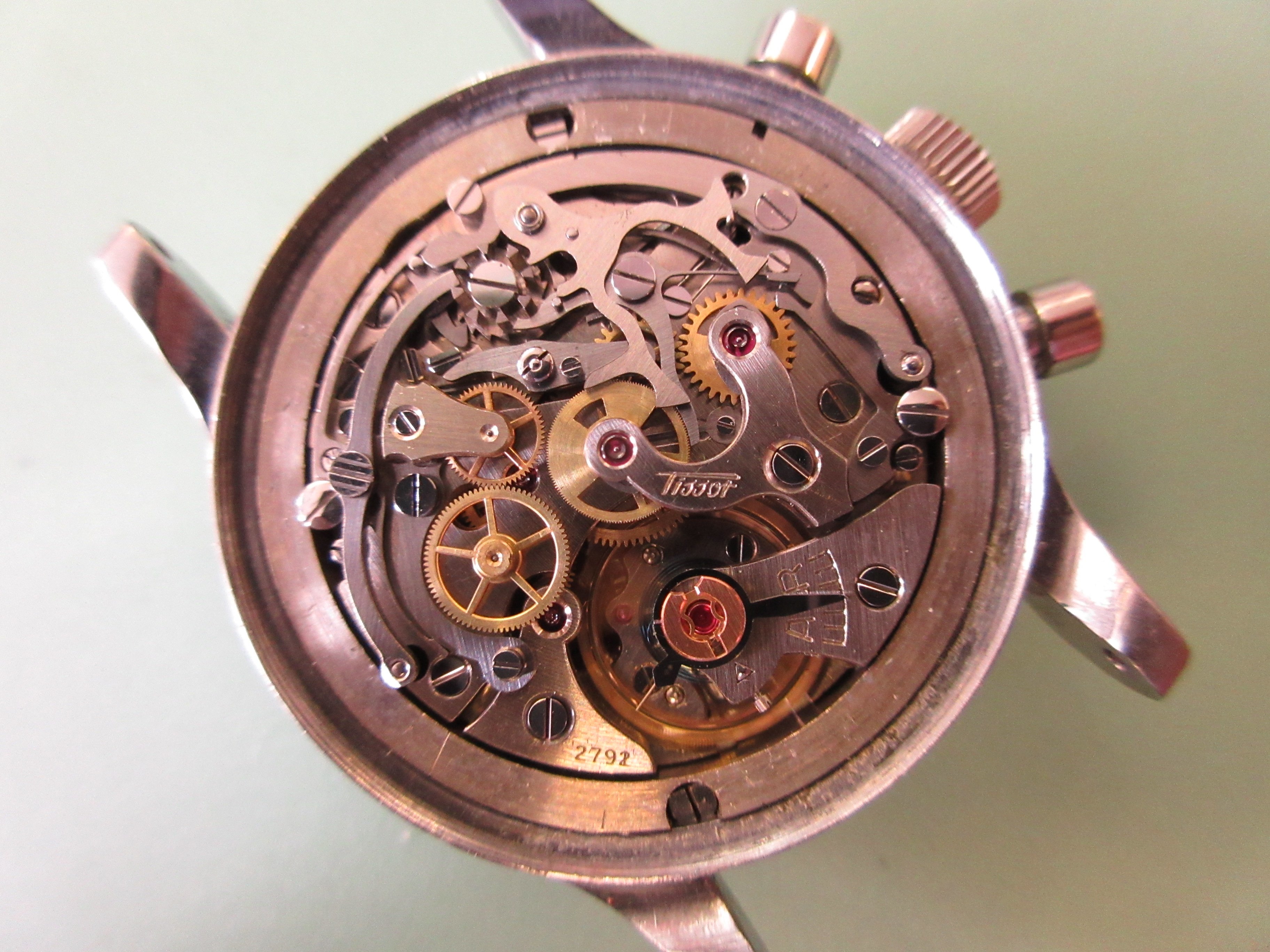

Movement in and out of case...
And together again:
REALLY looking forward to getting this back!

Wow, that looks great!馃グ It all looks to be in fantastic shape.馃憤

Well, the pushers needed new seals..!

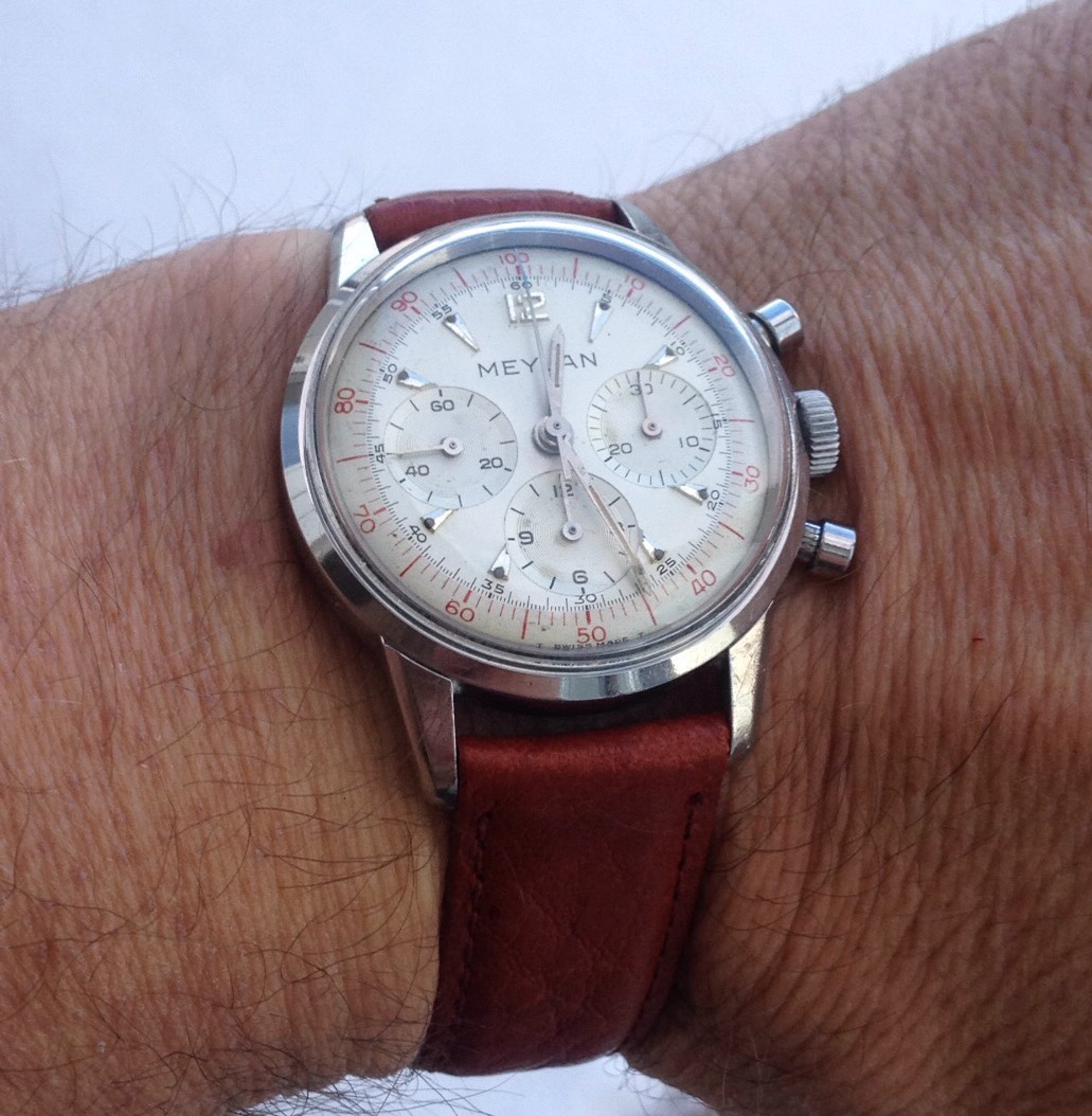

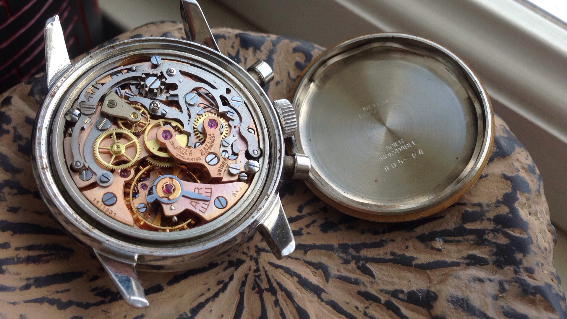

There is a general misconception that only Omega branded CH27 had "high" finish.
What finish is "superior" may also be debated but, true to tradition, Omega normally had their movement plates gilded. No other real difference is known to me.
Here is a Meylan branded one.
Meylan was a family name connected to Lemania, and the name of a Swiss controlled US (NJ) importer of stop watches/chronographs.

Thanks! Just curious and trying to piece together which ones was "all Lemania", and which was cased in their own made cases.
Several Omega variants with the cal 321 have Lemania/Omega double referenced cases.
At least in the case of Omega it seems the chronographs came completely assembled, case, dial and all, from Lemania.
This is also true for 1960s (and perhaps earlier) Speedmasters it seems.
