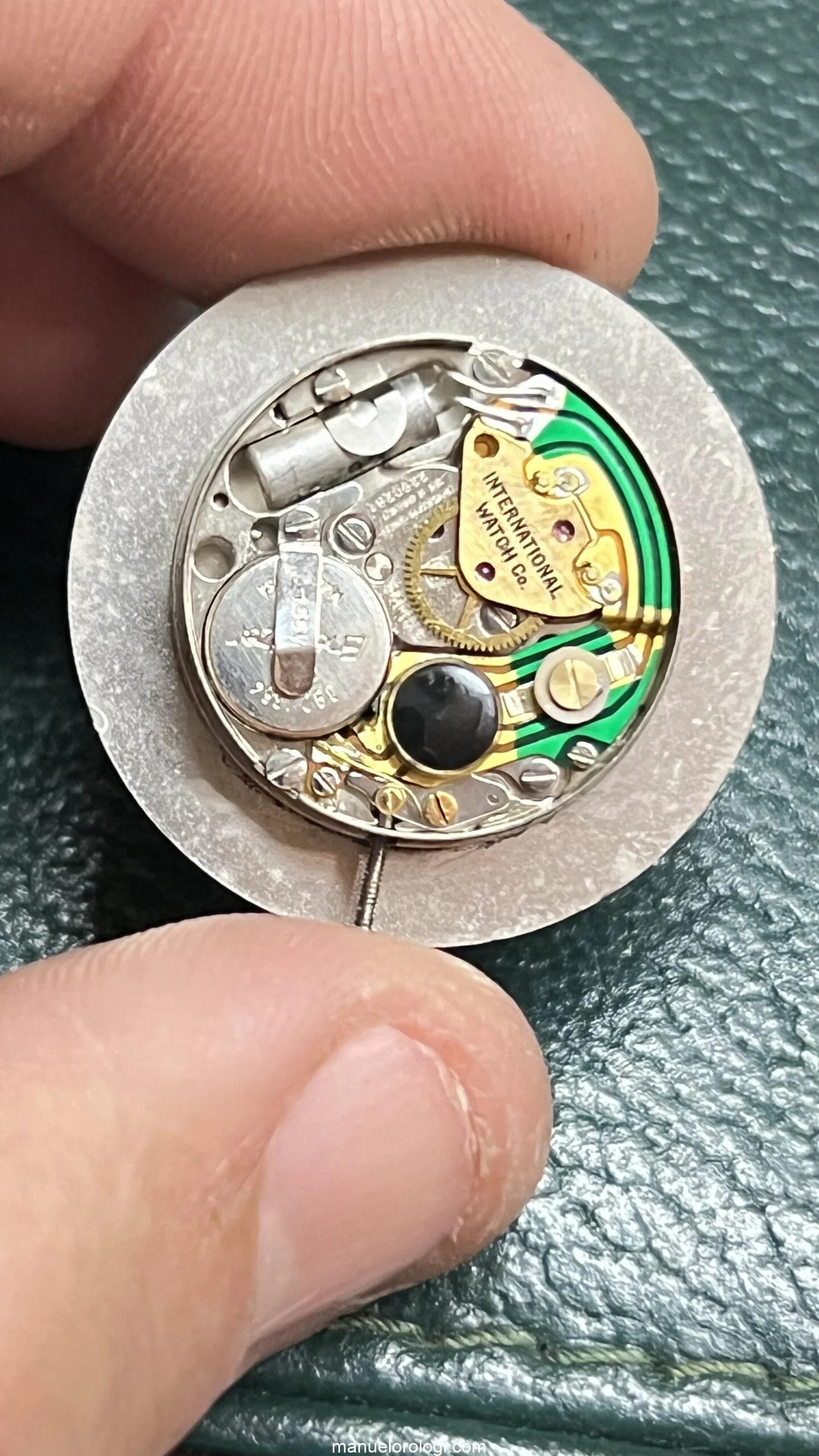

Hi,
Are these quartz IWCs legit?
I felt these movements were not typically what IWC would make. But then again, these are quartz.
Thanks

You might want to edit your post there. You are showing an Omega quartz movement, not an IWC.

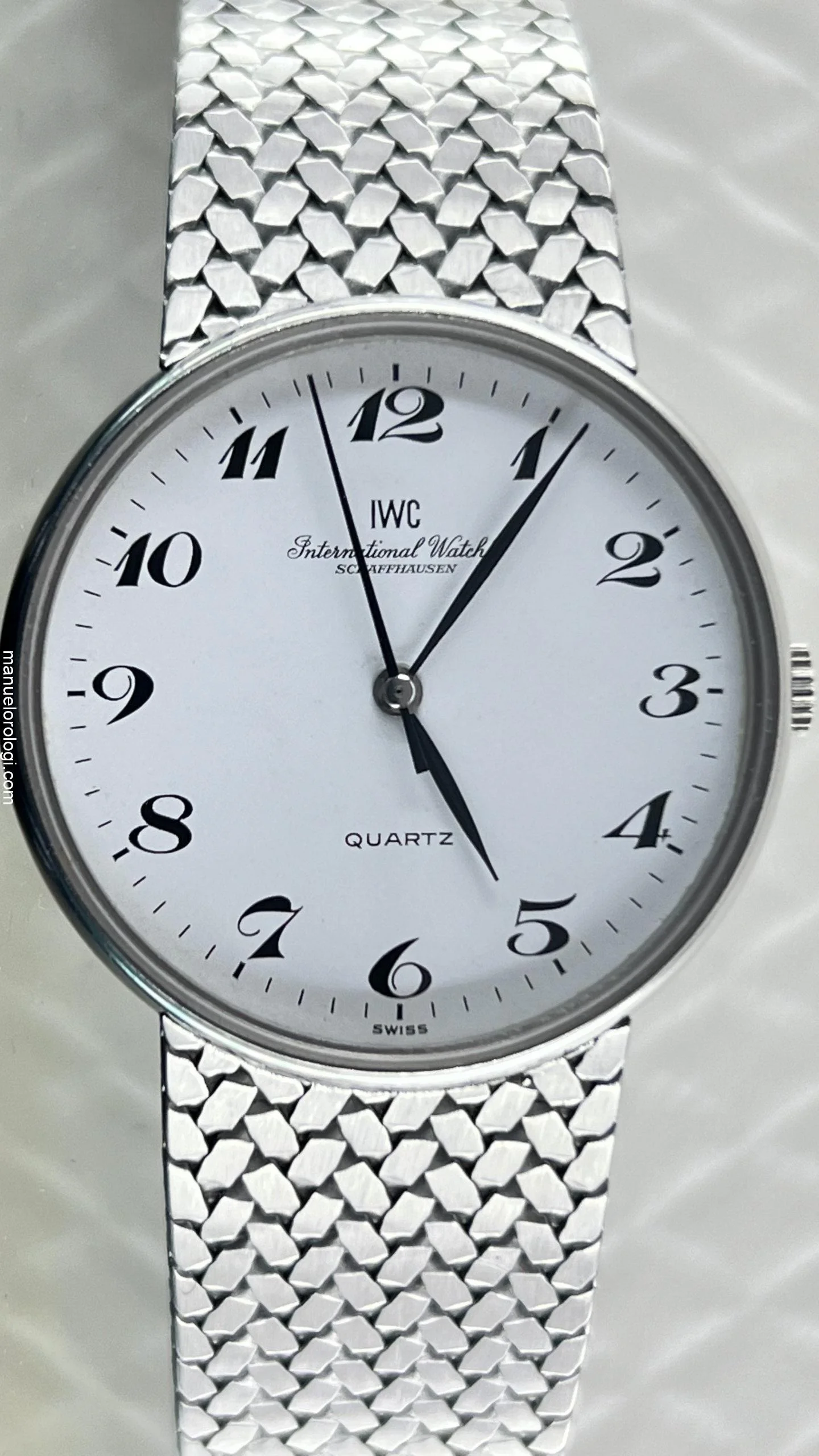

IWC did make quite a few vintage models with tuning fork or quartz movements in the 1970s and 1980s.

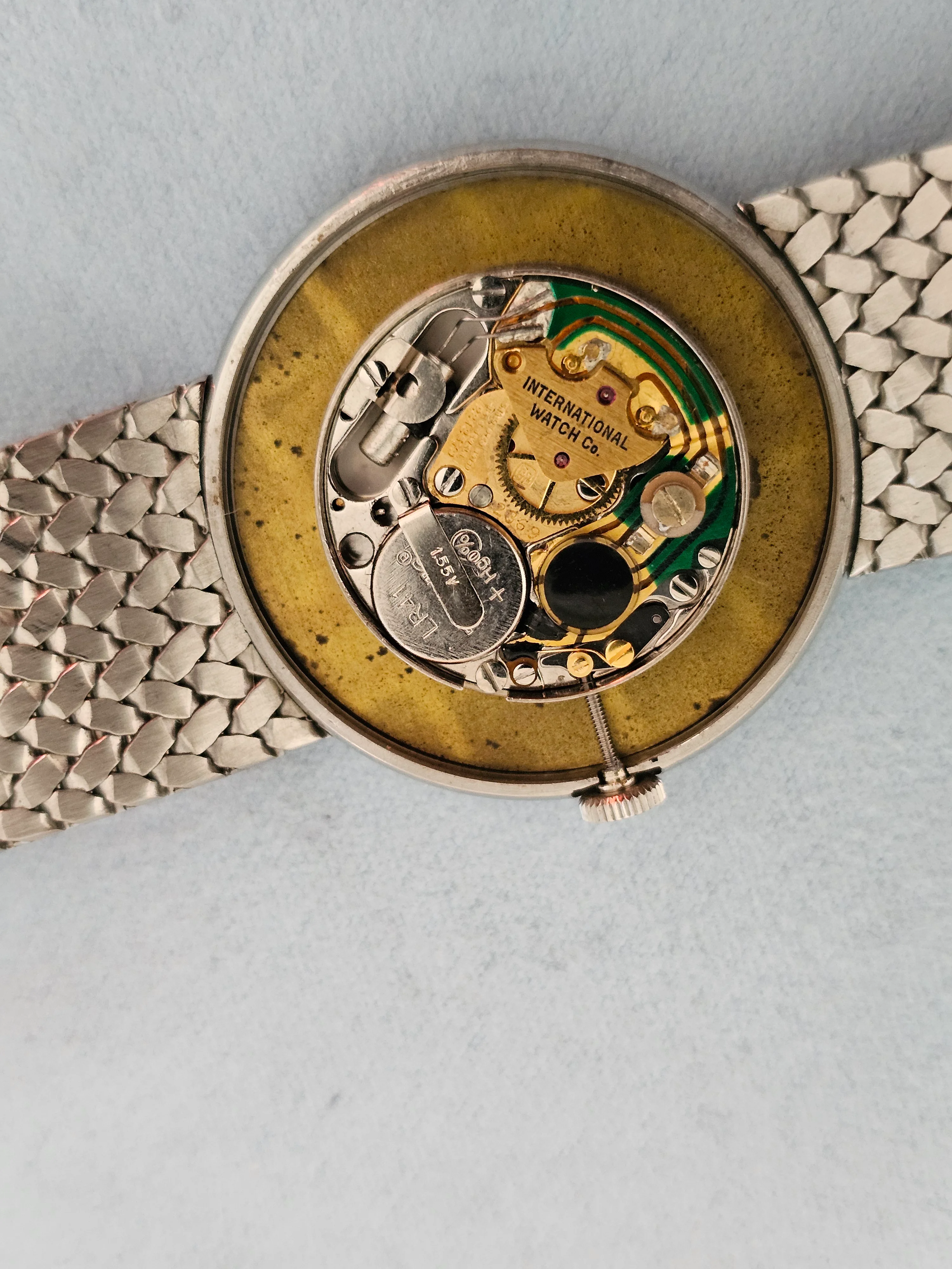

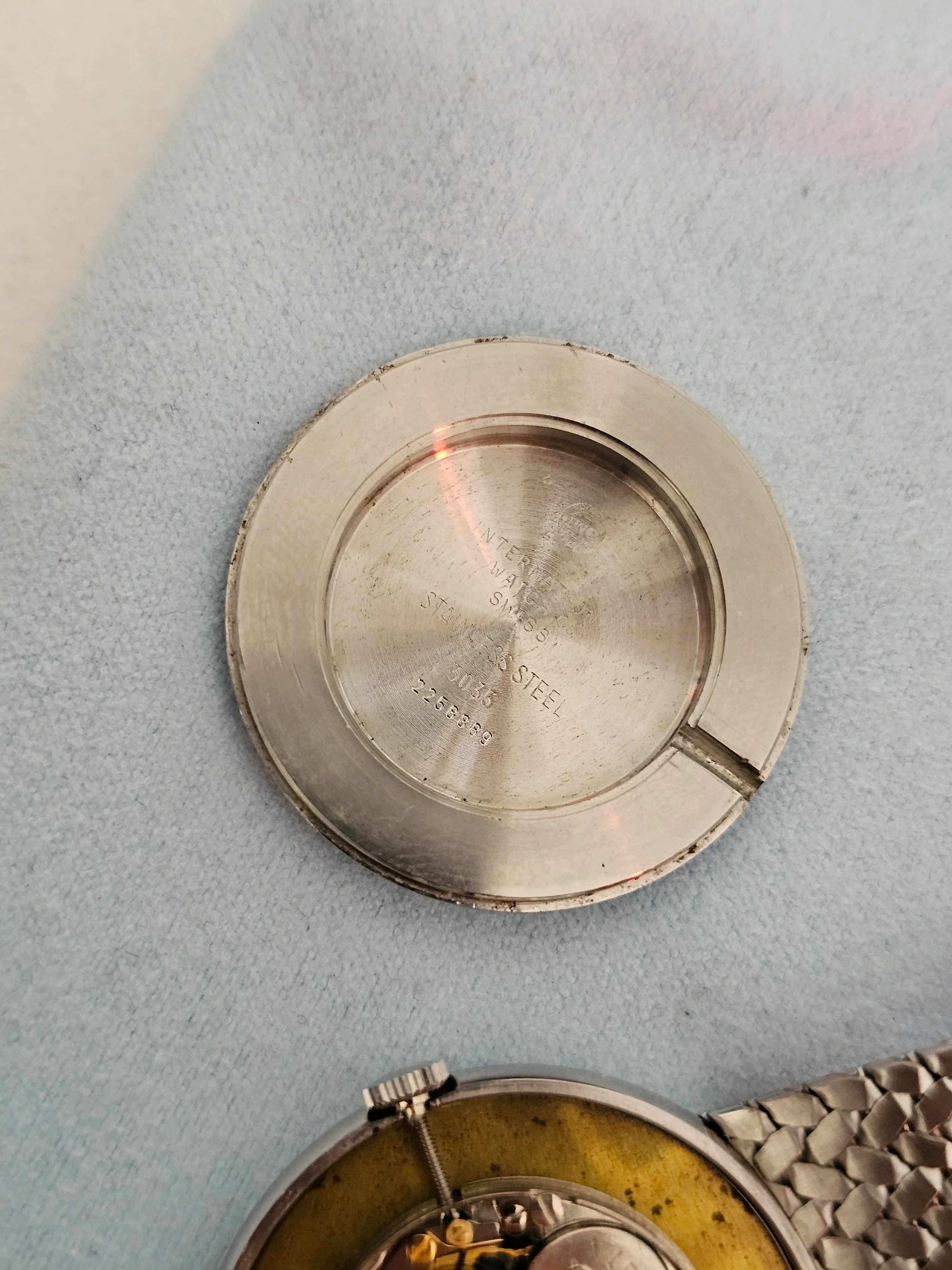

Do you have a picture of the inside caseback of the second watch?

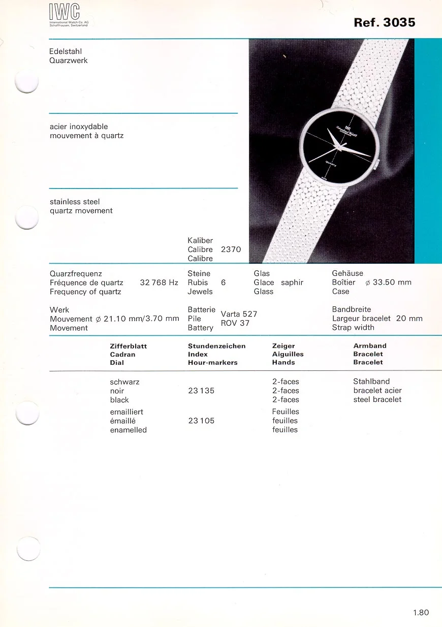

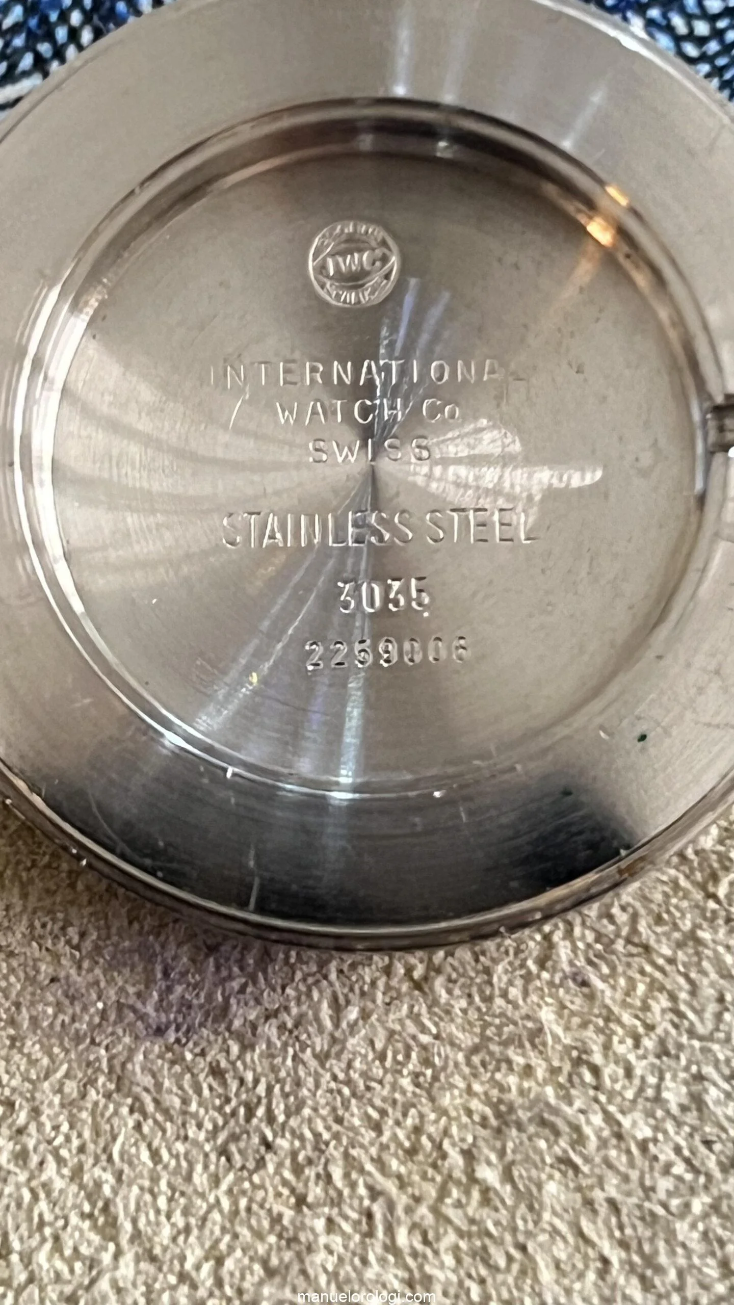

Not sure which one the caseback you have shown belongs to. It's a Ref. 3035, and the case serial number dates it to 1980 (DateYourIWC). Here's the official datasheet for it (which shows the black dial watch you have shown - the white dial one might be the same model, there was an enamel dial version for the 3035, too):

The "outside overall-impression/design " looks OK for me. classic 70ies/80ies...

Here is the case back for the black dial one.
It is actually the same reference, 3035.
Mine has a 2369 caliber, which I suppose is just a version below 2370 indicated in the profile picture you've shared.
So I suppose this indicates the watch is likely legit.
But I am not able to find anything about these movements.

These detail pages come from an old catalogue that has been on the internet for a long time, thanks a bunch to the guy who hosts it - you can find it here:
https://www.gregsteer.net/IWC/IWC_Index.htm

The second case serial says "1980" too, I think this is more or less the latest date it will show. But fits well in this case.
I don't know anything about the calibers 2369 and 2370. I know that IWC used some ETA calibers around this time - which they did refinish to a nice standard - but the google AI at least seems to think that the 2369 is a Girard-Perregaux movement. Girard-Perregaux were among the leading developers of quartz movements in Switzerland, very high quality at the time. These days, very old and hard to get replacement parts for, having a specialist who can repair them would be a bonus as the factory won't be able to help.

You are actually spot on regarding the GP movement. It happens that "GP" is inscribed in the movement but I didn't pay attention to it!

Cheers, I appreciate the opportunity to learn more about IWCs from this time. It's not a well documented period, after IWC was sold in 1978, and collectors today mostly avoid quartz watches from this time. However, in 1980, Ref. 3035 would have been a pretty expensive, technologically advanced watch, and if you like the design (and if the bracelet fits), wear and enjoy it!
