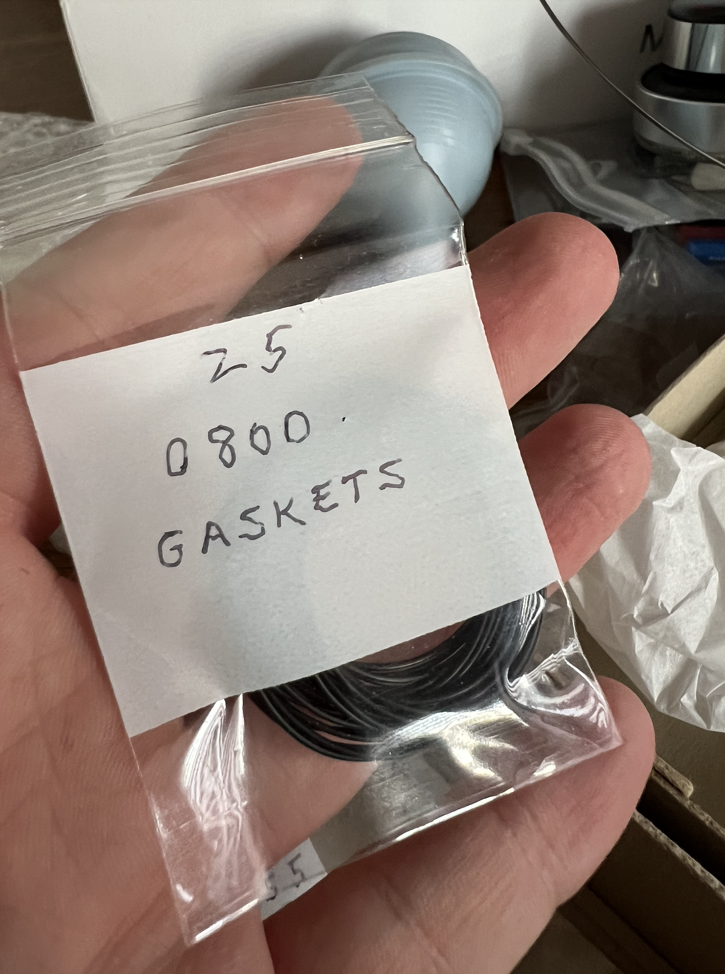

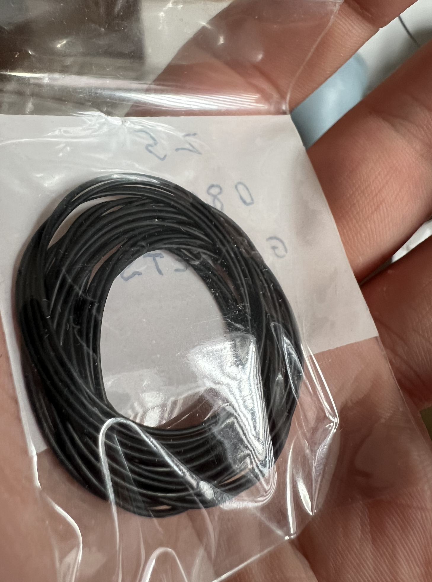

Are these 088-0800 gaskets?
2,648
3,105
They seemed like regular generic o-rings to me
I was expecting a 3D gasket that would just fit the case slot

Stating what brand and watch you are referring to might help...
29,815
77,157

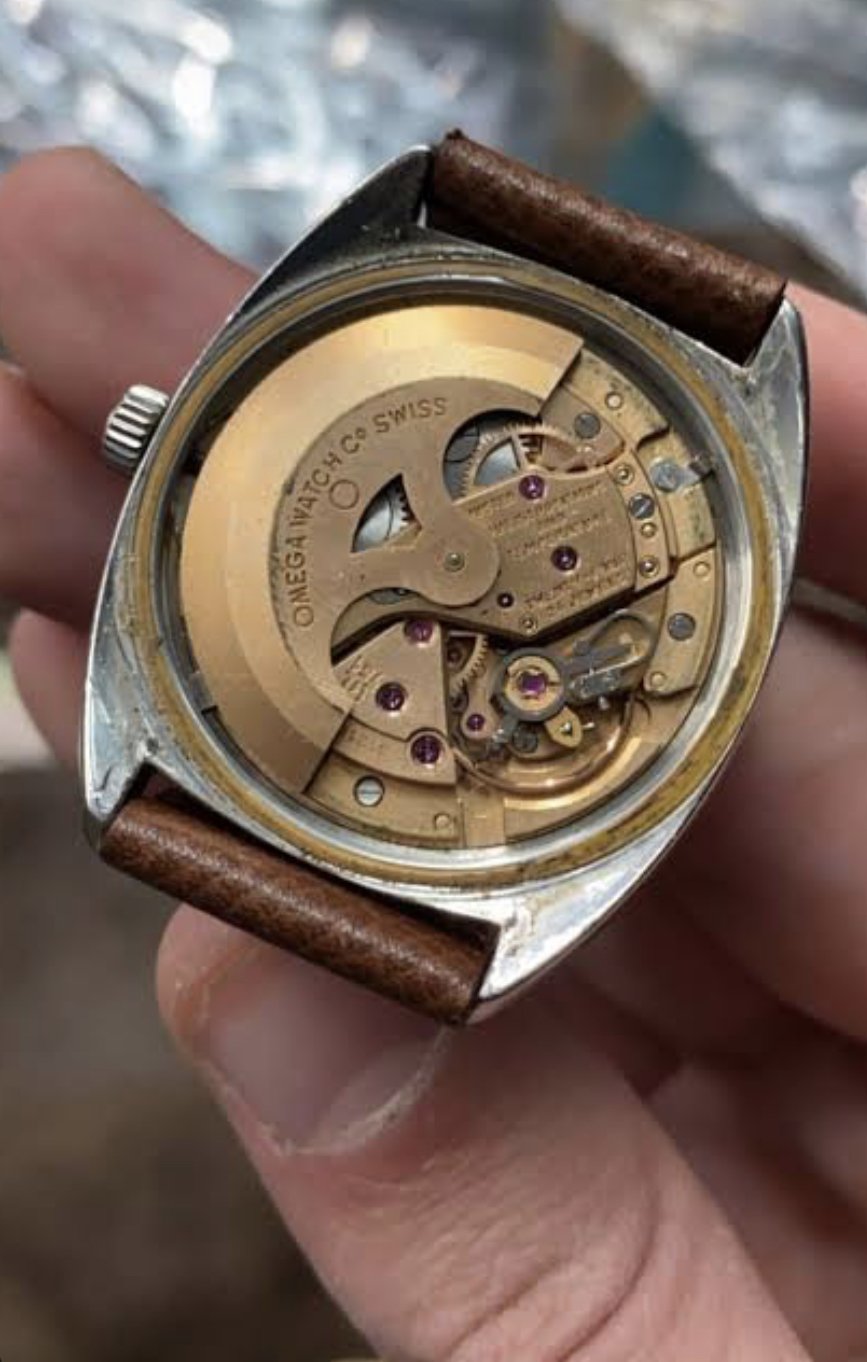

Omega 168.017
That case number comes up with "no results found" on the Omega extranet...are you sure that's the number?

Yes it’s a very common C-Case Constellation
For reference vintage watches usually have these yellow gaskets, I was expecting something similar

Strange - I entered that case number 3X with no results - just did it again and now it comes up...
The yellow seal you see is a very old compressed yellow O-ring...the new ones aren't yellow, but are certainly 3D. 😉

Thanks 😀
I always assumed they were rectangular gaskets

Only after they have deformed.

I come up 088NS5081 for the part number and these dimensions:
31.60 MM OD
0.80 MM DIAMETER
SHAPE :CIRCULAR

Yes, that's correct. Not sure what the OP has bought and where he got the number from, but if it's meant to be 088NS0800, that again comes up as "no results found" for me.

088-0800 is the old format, 088NS5081 is the new format part number as far as I gather for the same part
