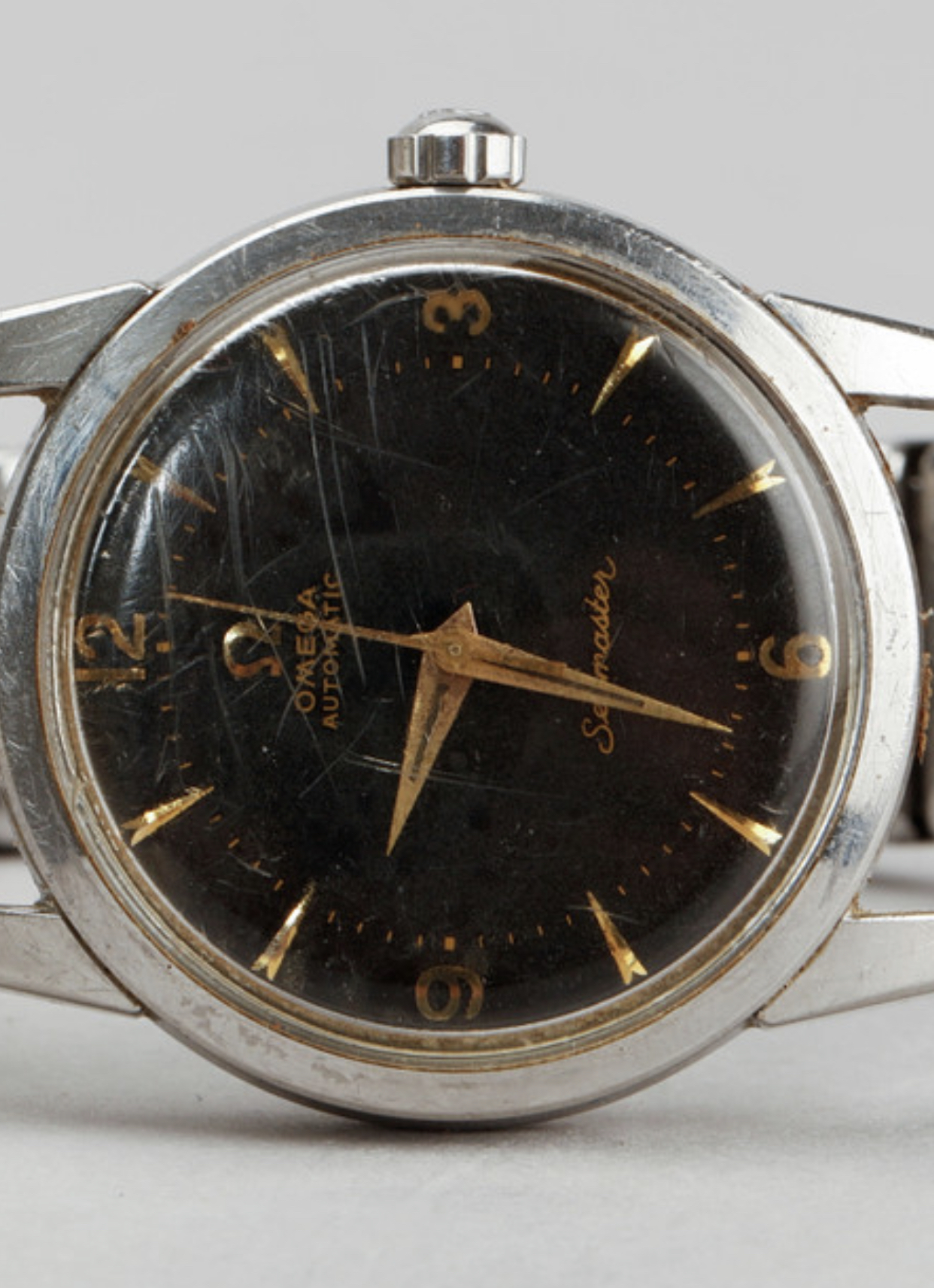

Quick question. I noticed that the markers has no lume dots present. Did Omega make some of these beefy lugs without the dots or did someone have them removed? The hands has lume as you can see. I have only seen these with lume both on the hands and markers before.

In my experience, lume would have been placed in the grove at the top of each dagger markerS on these Old Seamasters - but never say never with Omega
But did you try UV/ black light to see if there is any trace of lume remaining?

Sometimes the lume just crumbles and falls off and when that happens, sometimes the watchmaker just removes the rest of it.

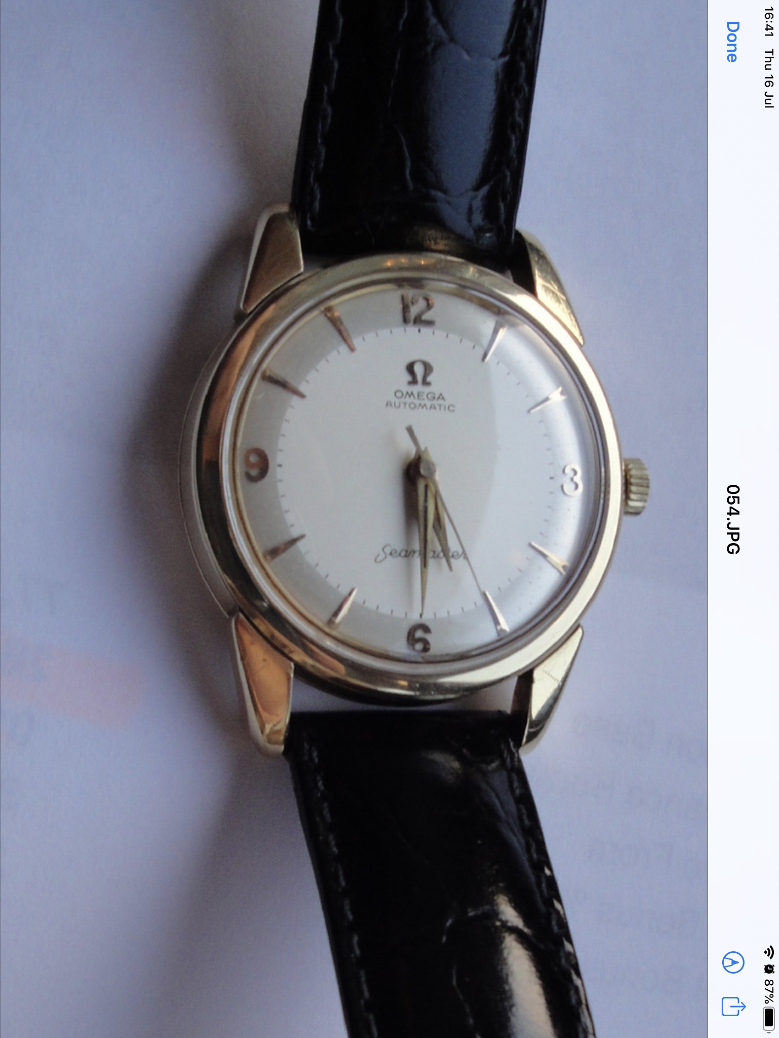

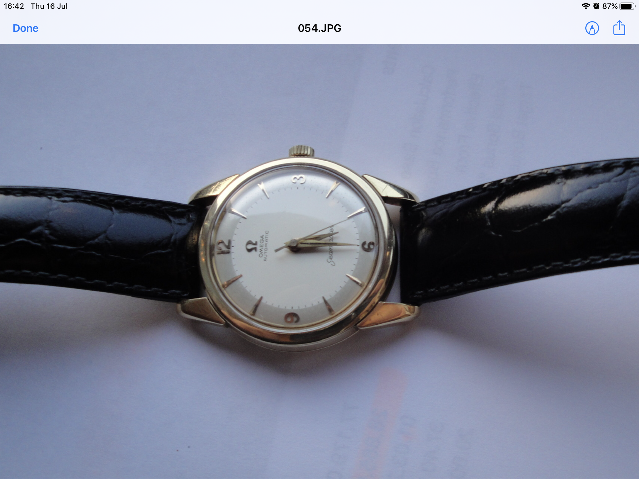

Here is my Radium lumed, cal 501 from 1958 in a 18K gold Dennison Cased Seamaster - you can still see the lume in the dagger markers

It's possible the radium line has blackened, and is now hard to see against the black dial.

I second the idea of checking with UV illumination.

Yes, that was my thought too that Omega may have manufactured it like this. But im not convinced. I cant check it my self because this example is not in my possession :/ At least not yet... I want to be sure that its complete before or if its worth buying even if the lume is missing?

To me it looks like it is not there but i cant tell for sure by just this picture. Photos can sometimes play tricks on you 🤔

Looks to me like the lume was originally there and has crumbled away over the years. It wouldn't stop me buying the watch which looks pretty nice!

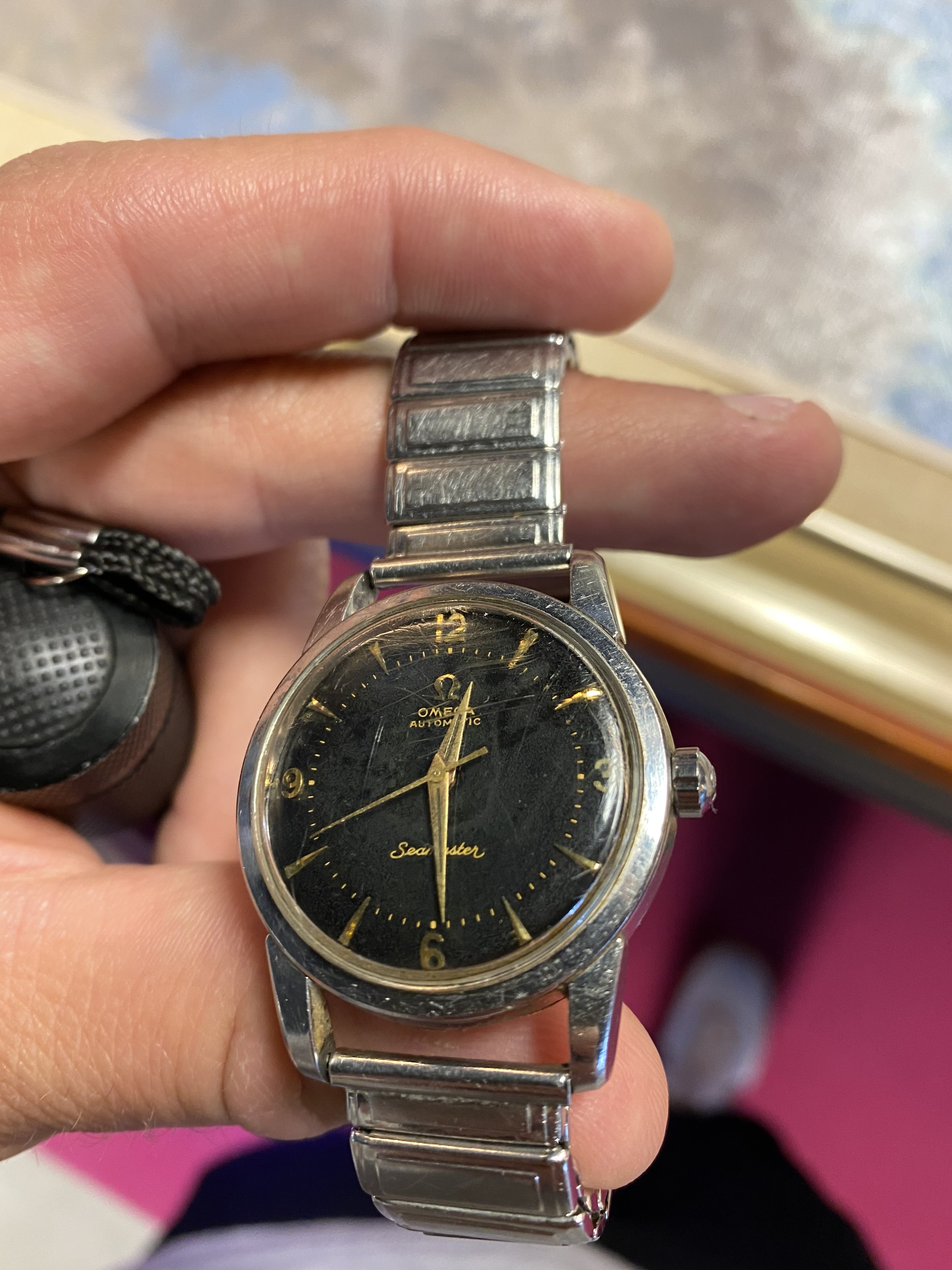

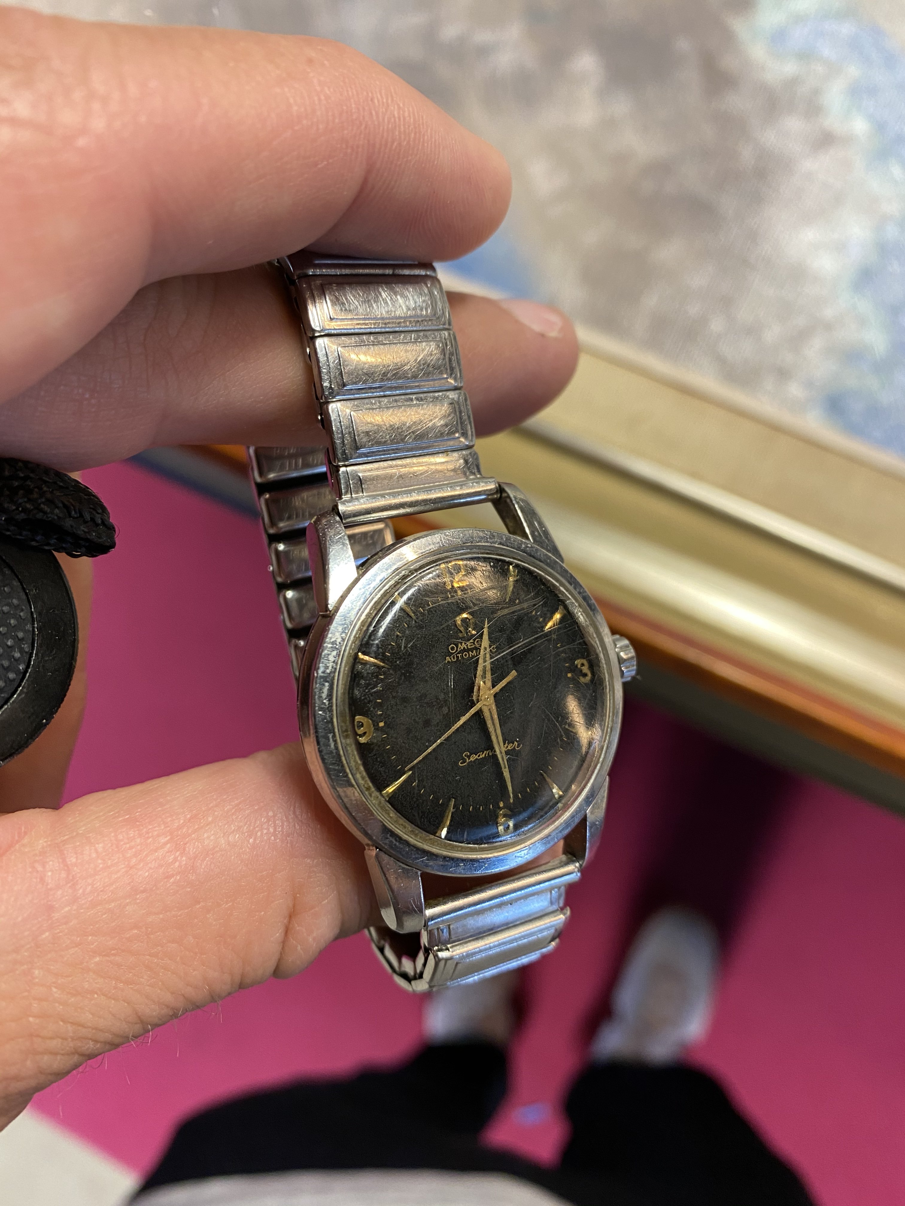

Update: Today i had the opportunity to look at the watch and hold it in my hands personally. I purchased an uv flashlight. I shone with the flashlight over the dial, the dots shimmered up and showed their presence👍Tried to take pictures of it but i failed, the scratched up crystal and reflections of light made that impossible. I took a regular photo just to show it in regular lighting. The smudgy looking dial made me a little disappointed as i hoped for a glossier look...
