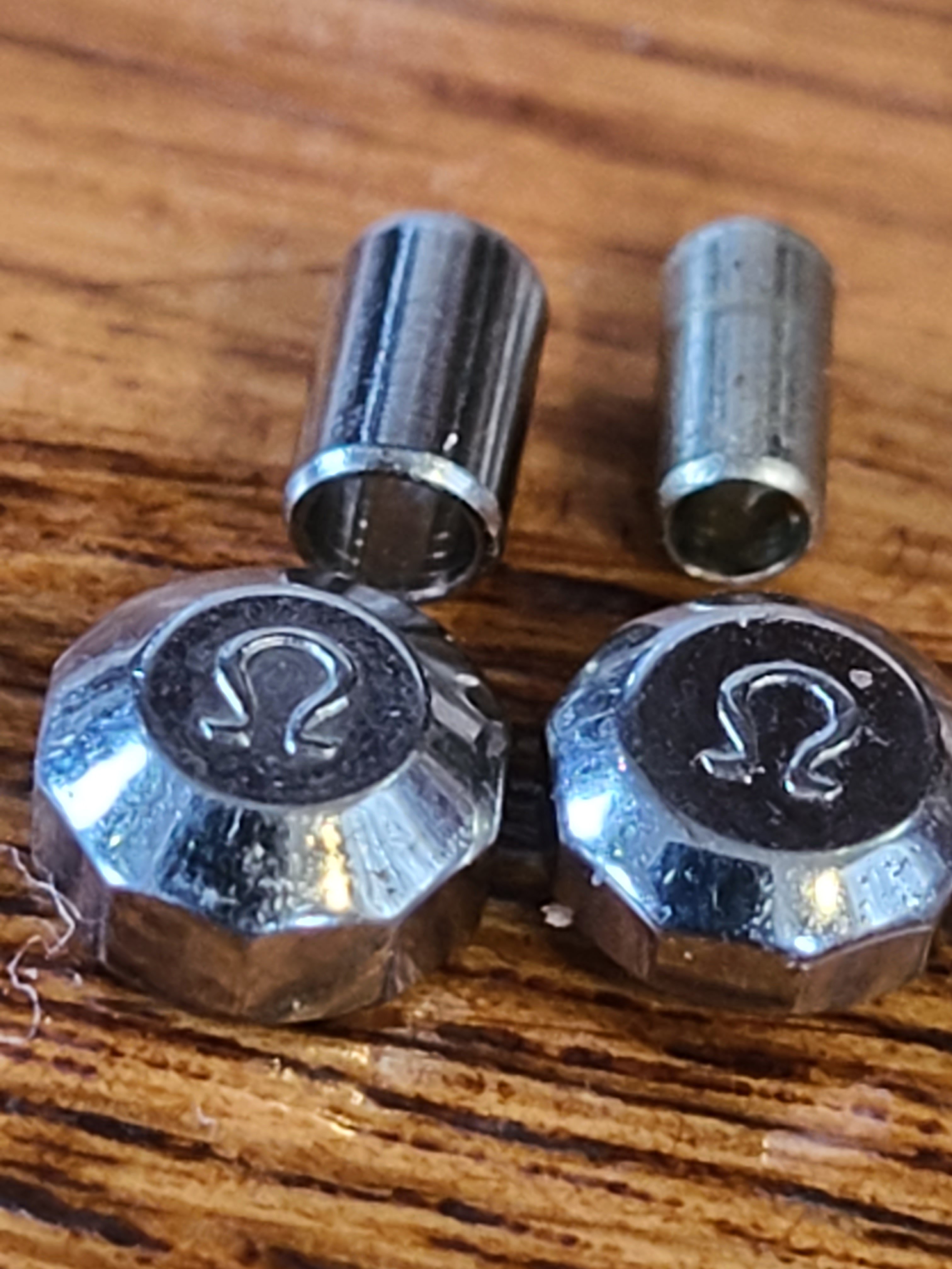

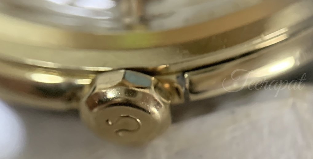

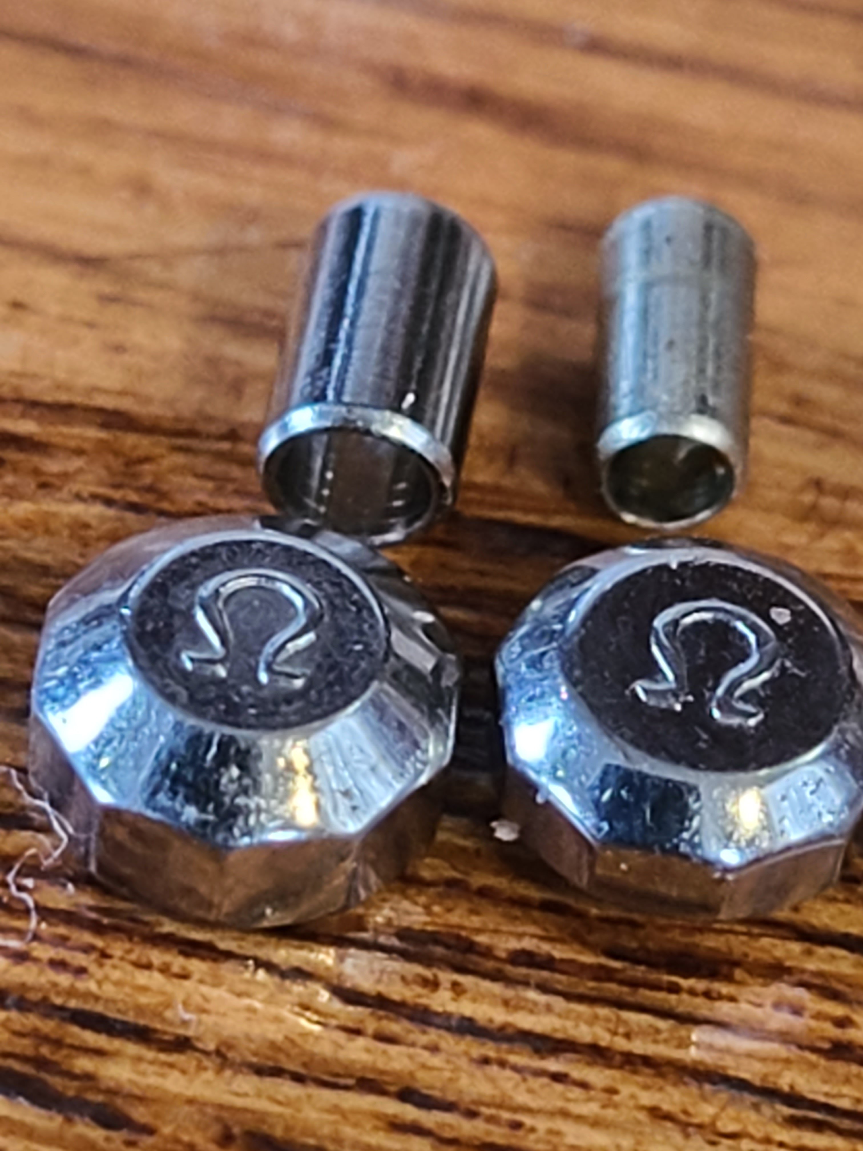

The one on left is for 4 digit case reference. If you can find one with thin logo, you are lucky.

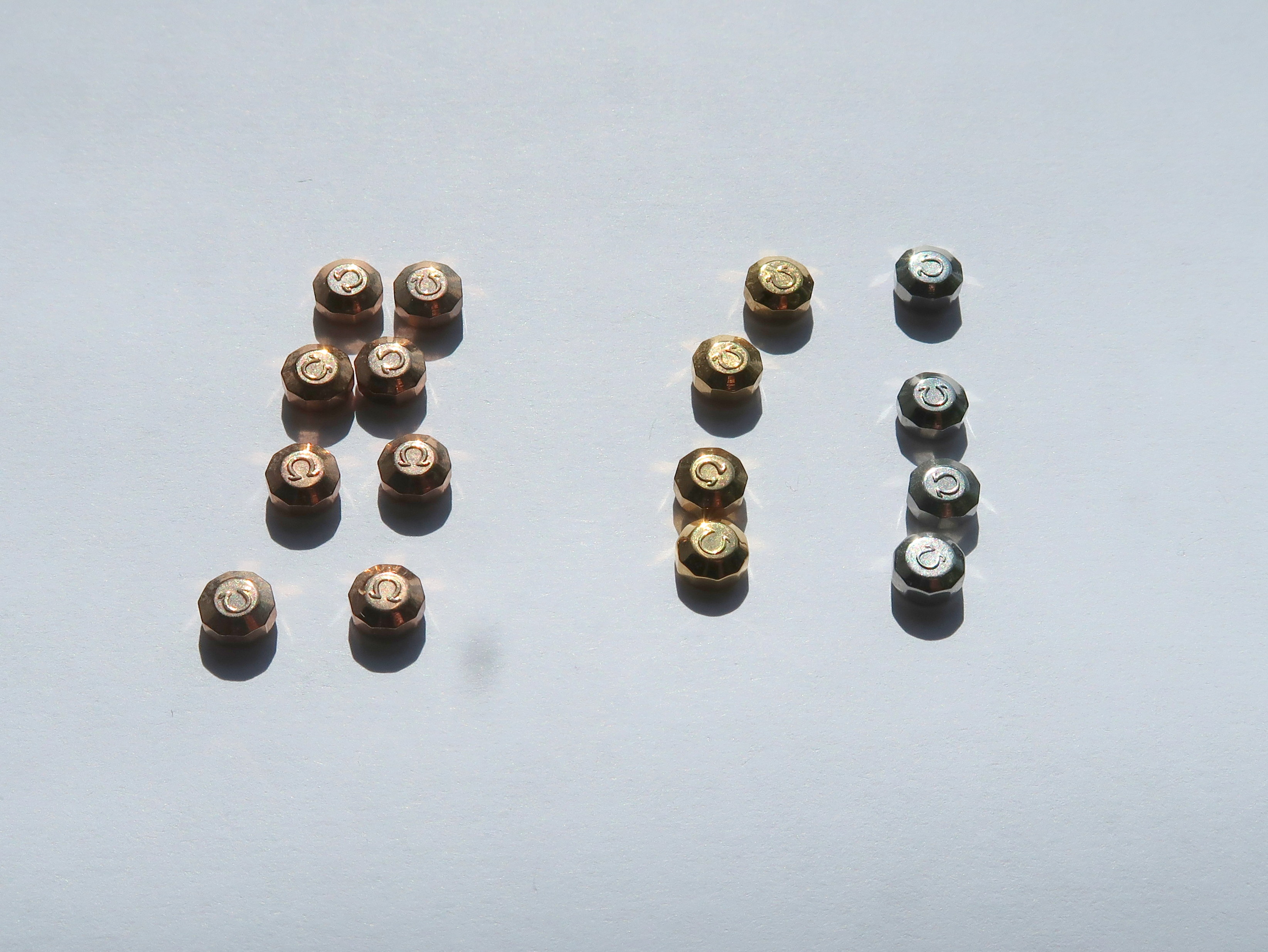

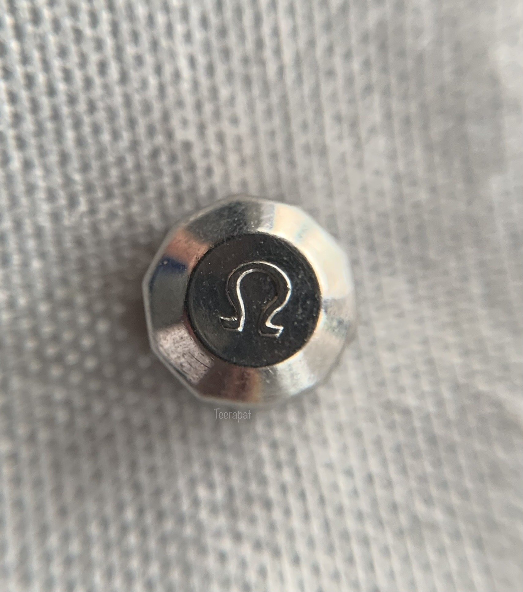

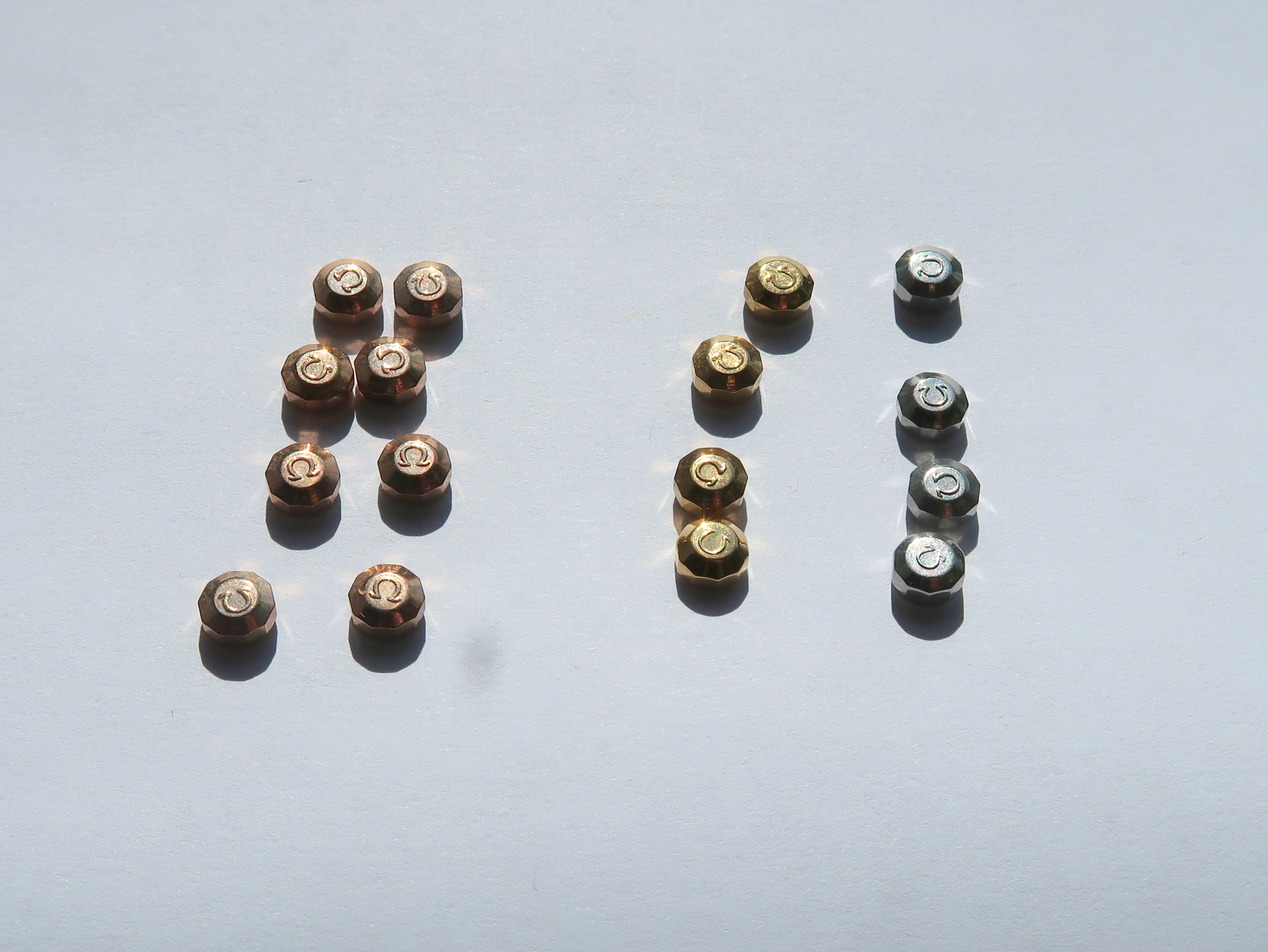

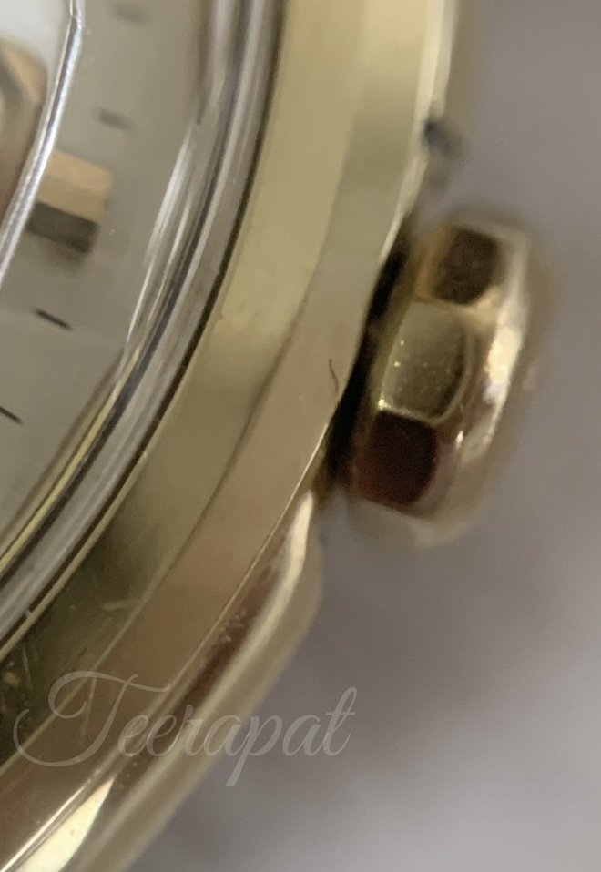

Got a lot with many different Omega crowns years back, and there were some ten sided also in rosegold, yellowgold and steel. Not sure if they are for the older Constellations, they are higher that slim ten sided for 167/8.005.
3,790
6,452
Looks like newer production with round logo.
If they are higher than the slim ones, they must be for 4 digit case reference.
The ones for six digit reference are slimmer and have smaller tubes.
Five digit case reference are tricky, sometimes they are happy only with scallops.

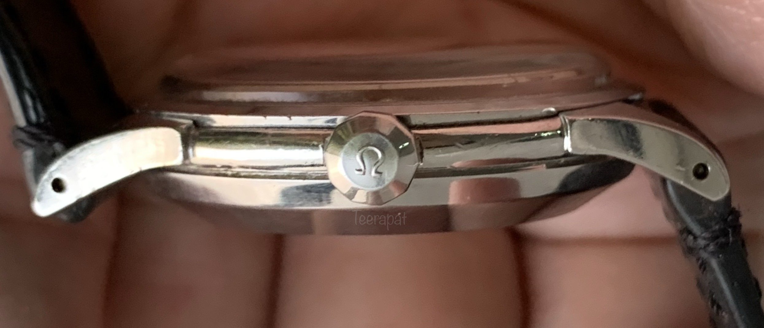

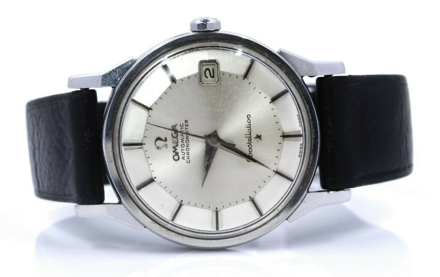

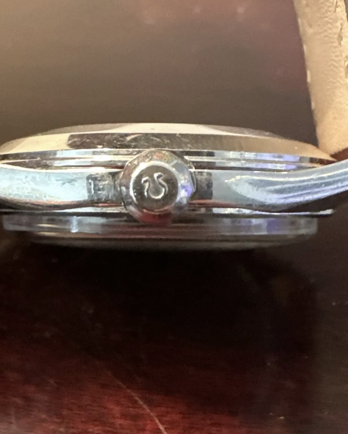

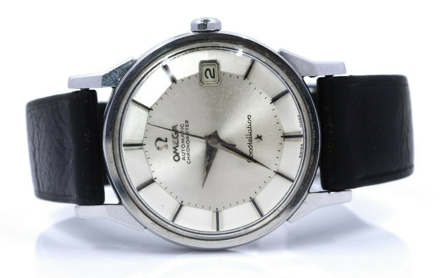

The older 4 digit reference like 2852 (Internet picture for reference)
I think the 14902 came with the "thin" ten sided like this (Internet picture for reference)View attachment 1014877

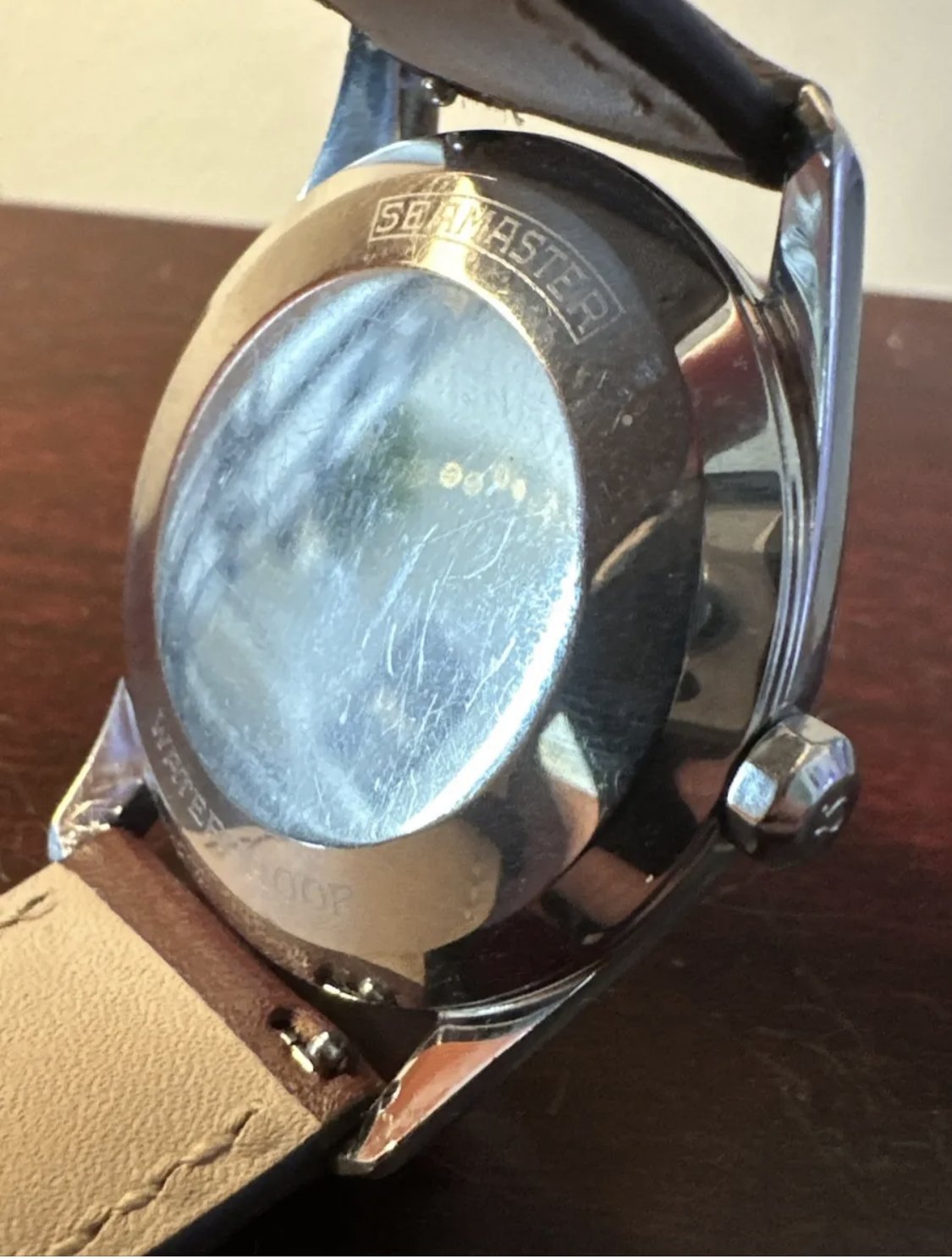

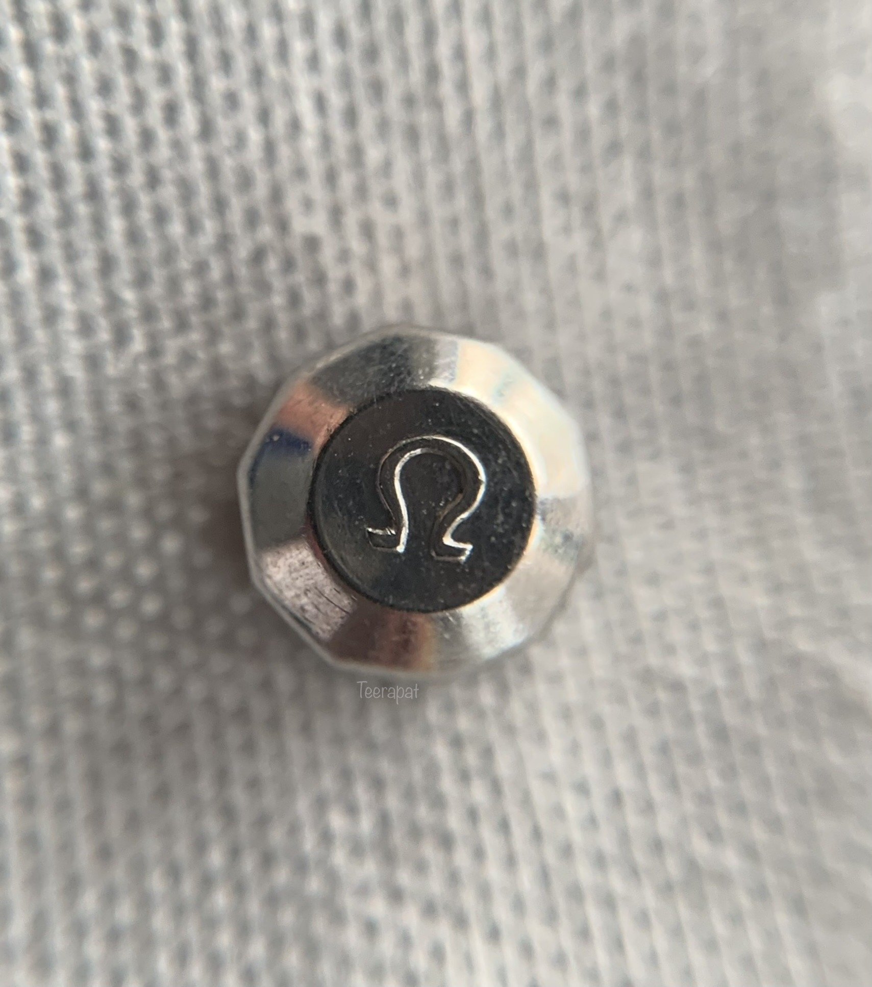

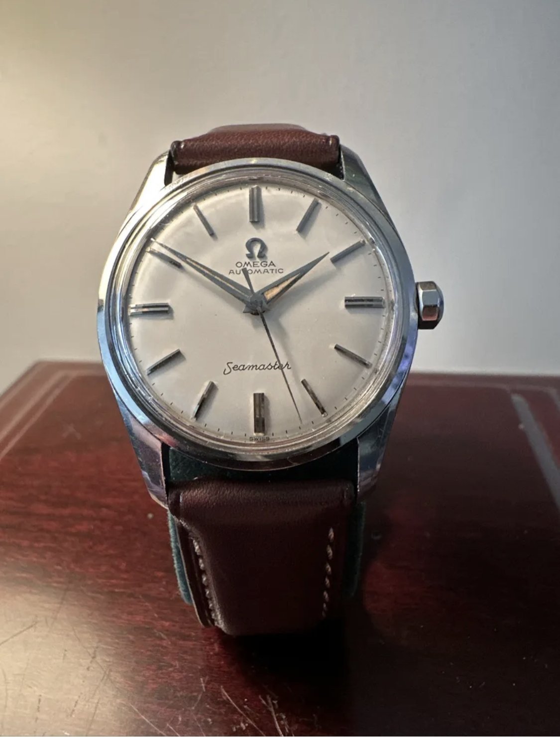

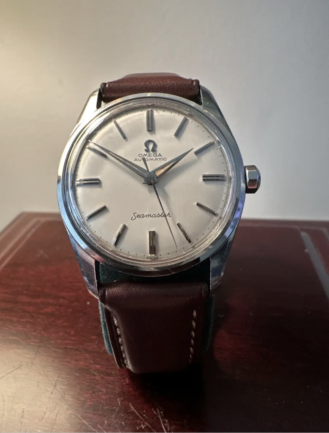

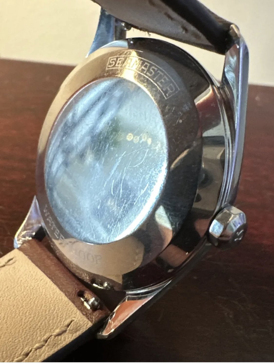

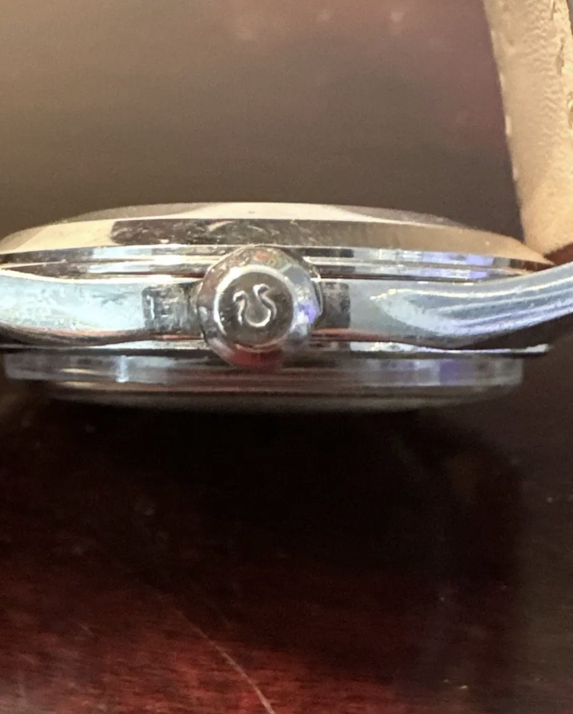

Old post but hoping to get an answer. I have this 10 sided crown. But it’s not on a constellation. It’s come on a 1950s seamaster 2767
Was this crown originally only on the constellation?
thanks

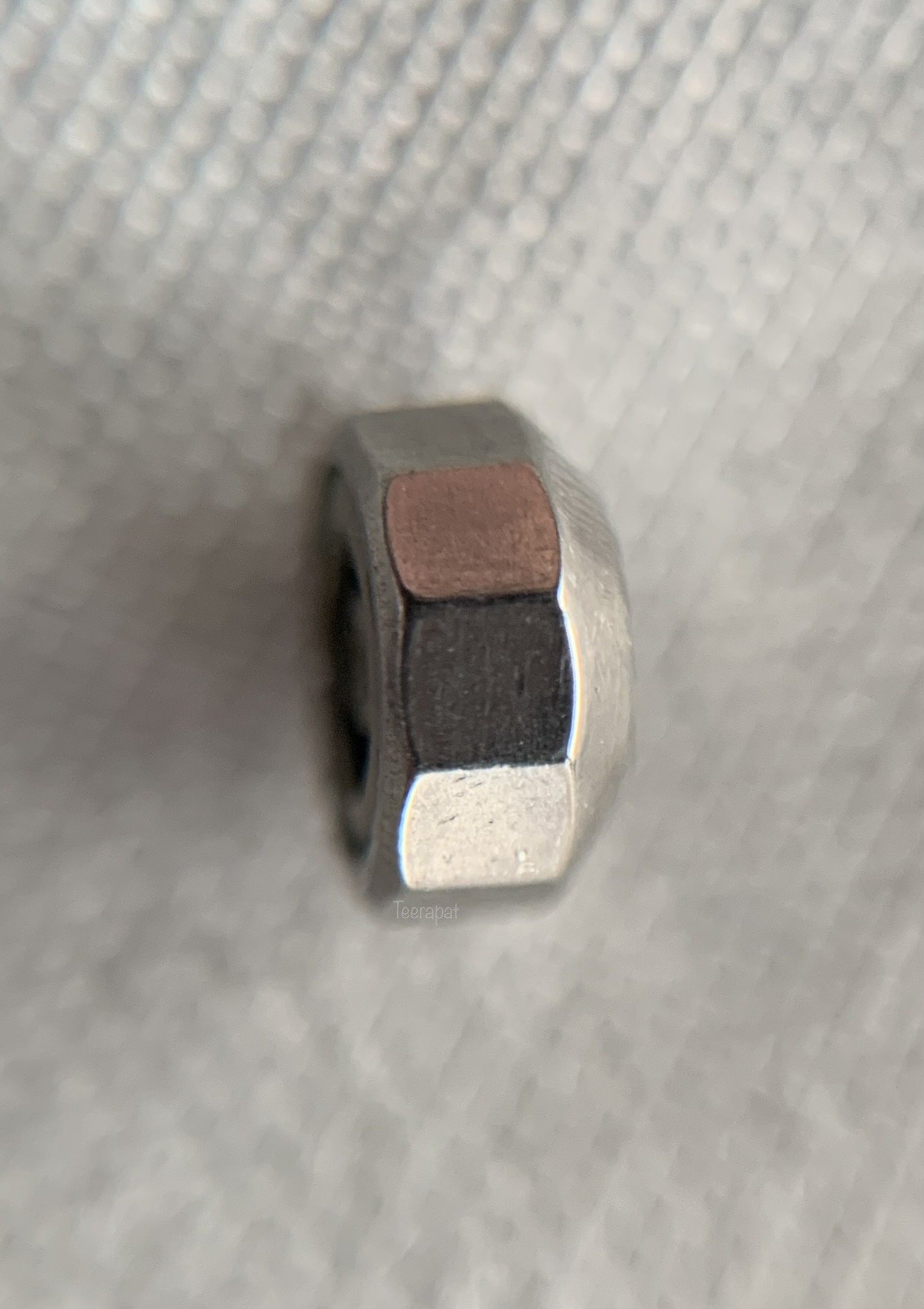

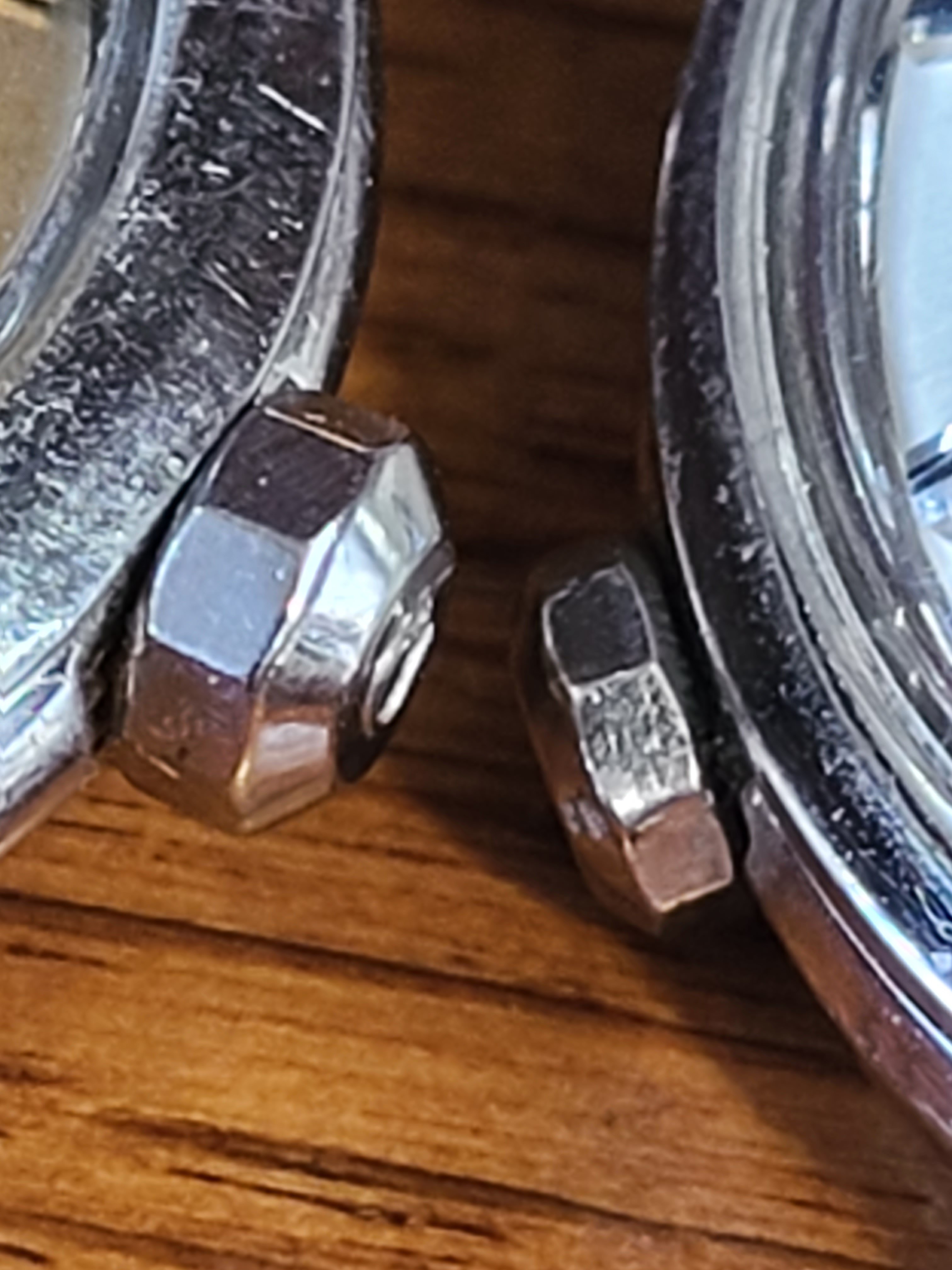

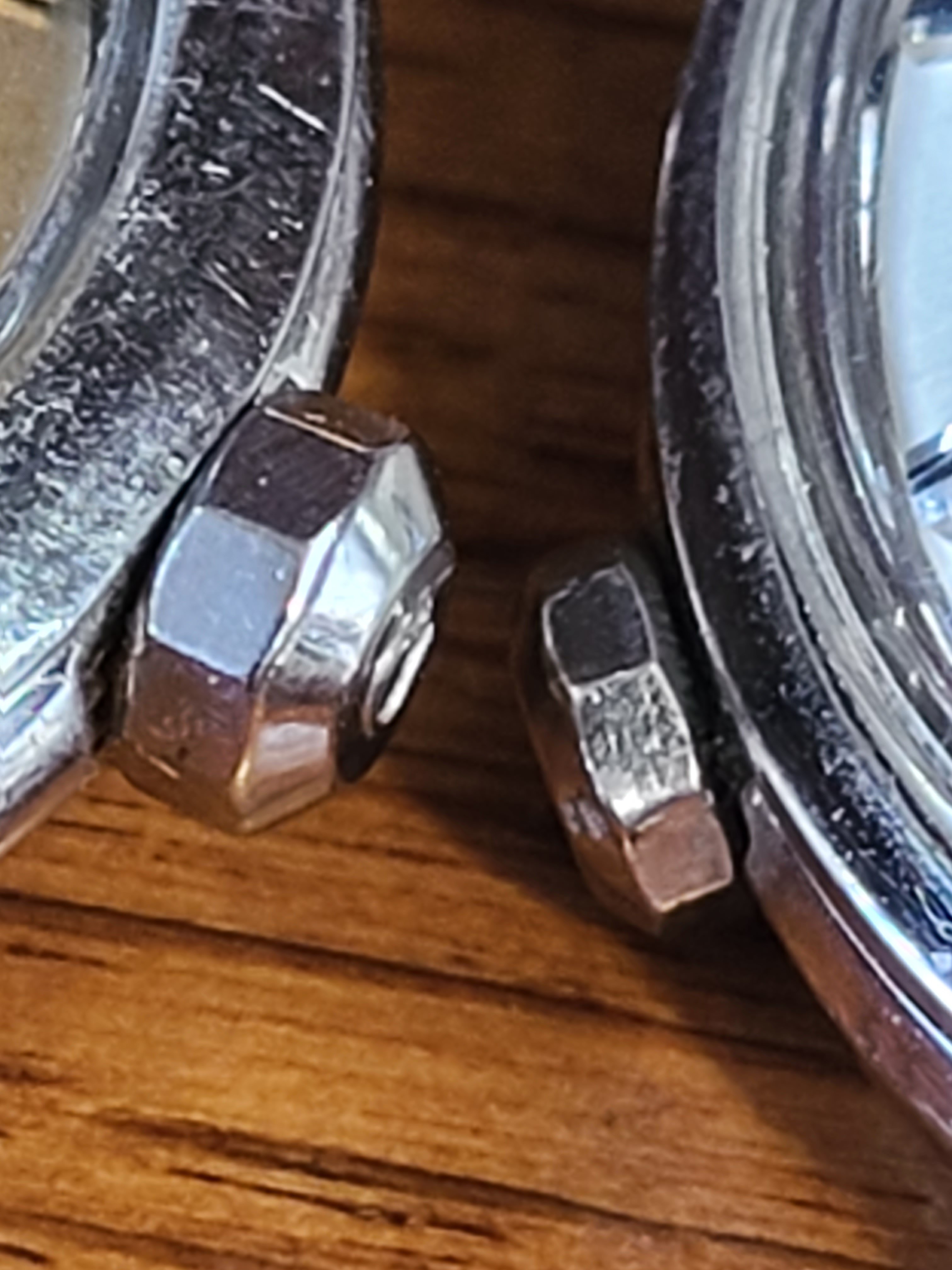

An example of flat feet thick decagonal crown.
Also, flat feet thin decagonal crown.
