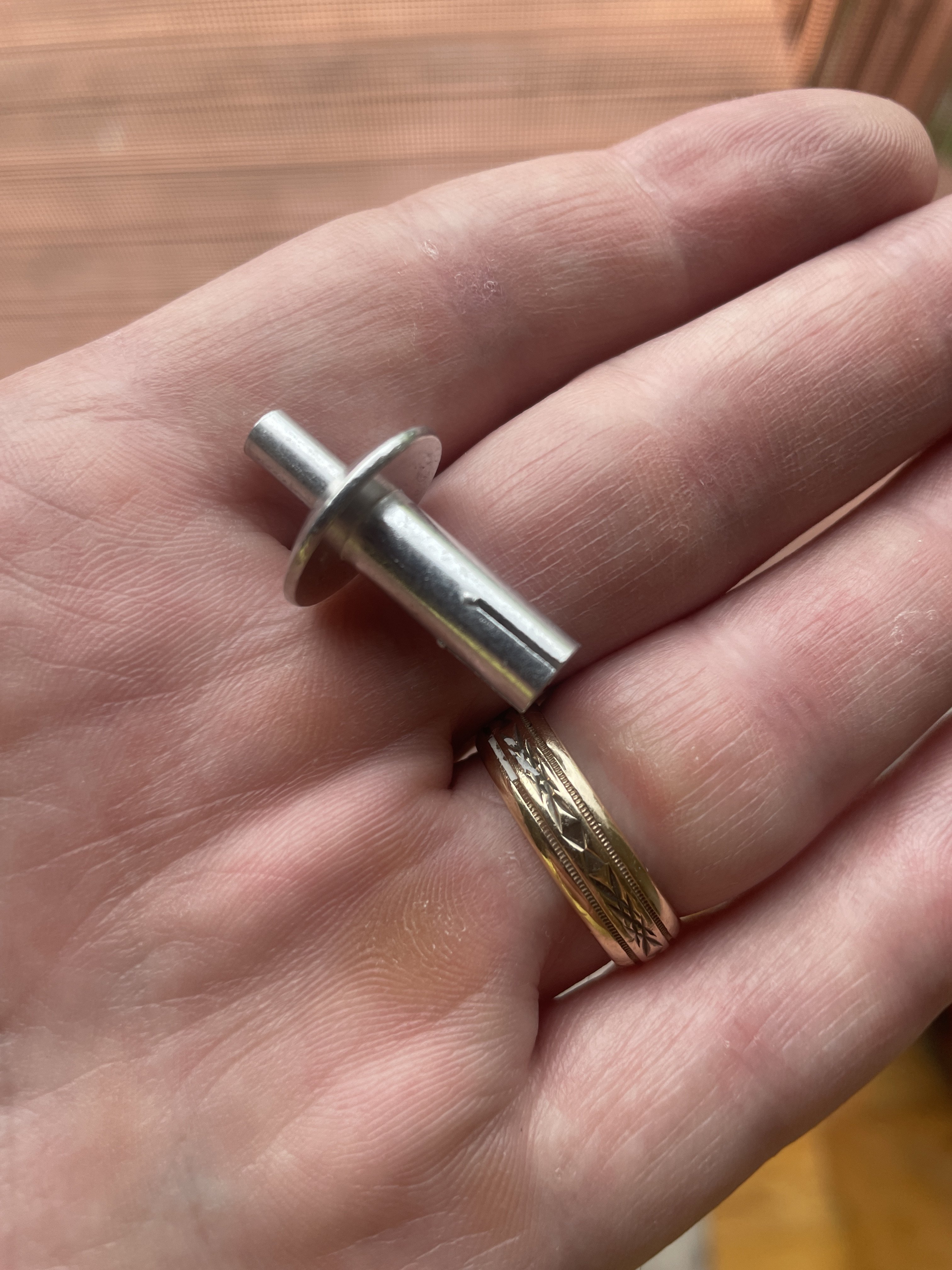

Has this happened to anyone before? Looks like the glue came unstuck…???

These dials use rivets to affix the indices. These are the two pins placed on the ends of your dial. Sometimes, these indices can be knocked off by a hard, well-placed shock. You might want to contact an Omega service center to get the watch serviced.

There's no glue - these are held in by pins that extend through the dial, which are ground off on the back side:
You can see all around the dial small patches where these feet have been ground off - when this is done it creates a burr on the feet that keeps the markers in place.
Yours is certainly not the first marker to ever come off, so this is an easy fix, and if the watch is under warranty ti should be covered unless there is evidence of an impact.

LOL and on WUS there is an entire thread of people damning Omega for gluing them. Oh ignorance is a bliss.

I think the rivets they use were probably too cheesy I like to make sure every thing on very secure I can send you a few of these no charge

The parts that fell off so it became loose..
