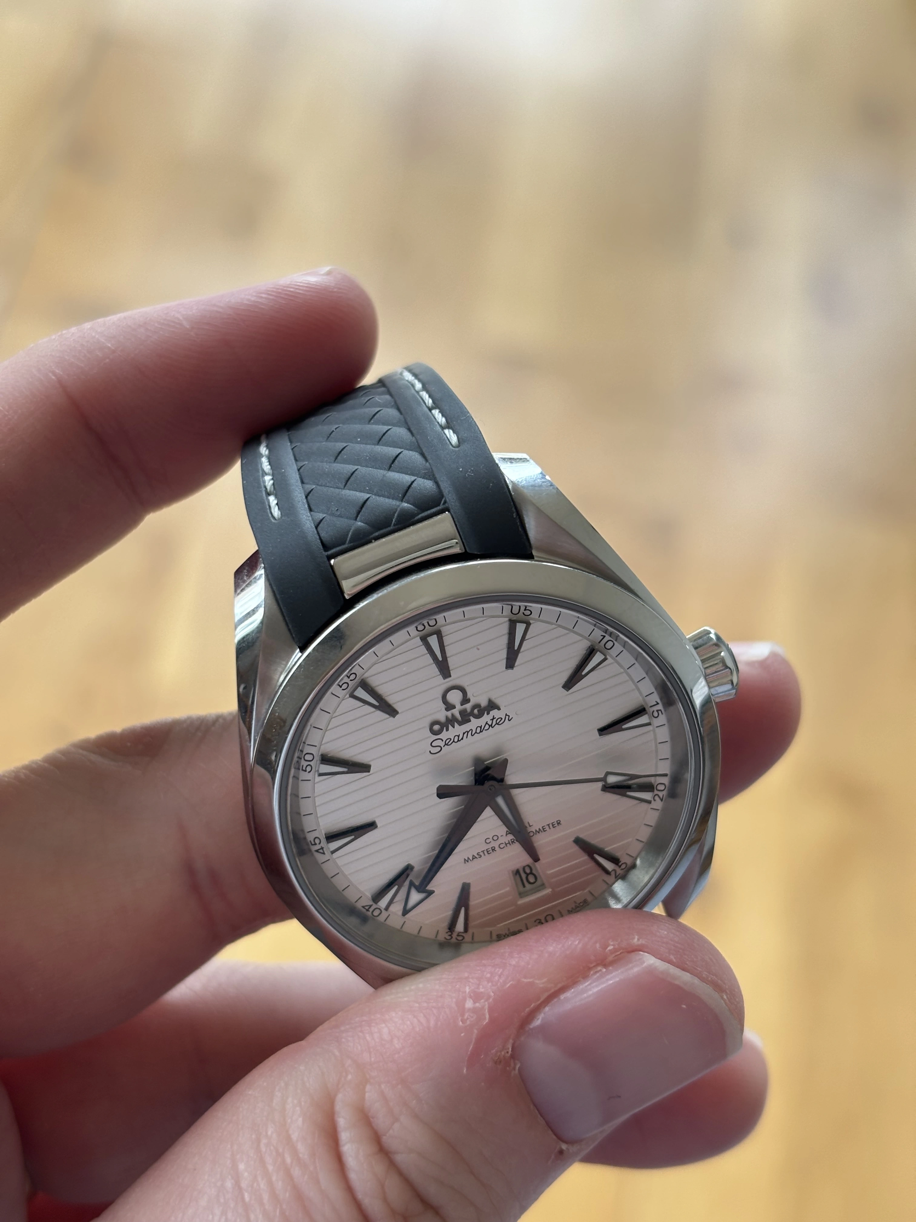

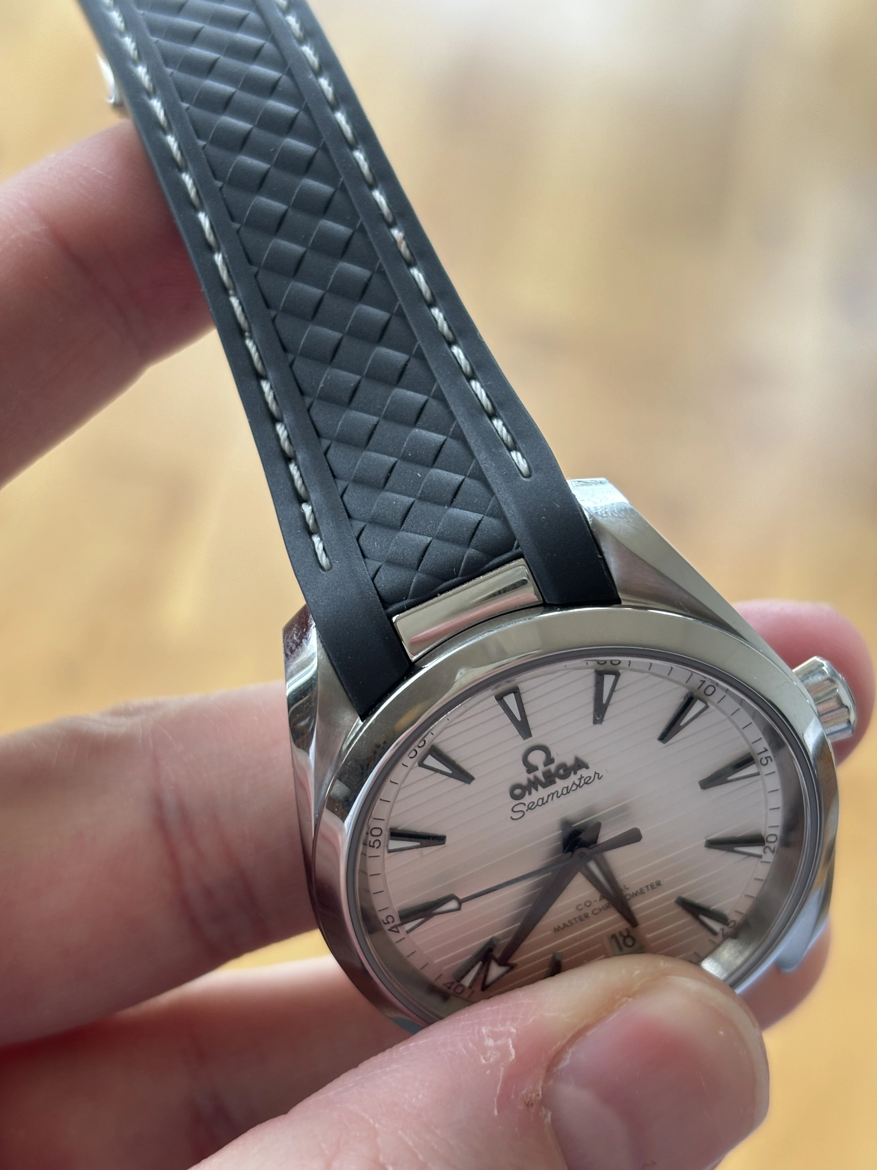

Hi all,
I recently purchased the official rubber strap for my 2024 19mm Aqua Terra. I’ve noticed that there is a gap at the end between the watch and strap. Is this normal?
I’ve been back to the boutique where they changed the spring bars, but the problem is still present.
Any advice appreciated. Pics attached.

That's not normal. Usually, it's a problem caused by a spring bar that's not thick enough, but since they've already tried replacing the spring bar at the boutique, that eliminates that possibility.
Does this happen to both the top and bottom sides or just the top? If just the top, try installing the bottom strap at the top to see if it exhibits the same behavior. If not, the strap is out of spec and can be replaced. If it still has the gap, it's something with the watch's lug hole position.

You know, now you've mentioned the width of the SB, I've looked at all the ones they provided. They're all the same diameter (at least to the naked eye). What should they be? 1.8mm? I did swap the positions of the strap and the problem is still present. It is also present on both top and bottom straps. Thank you.

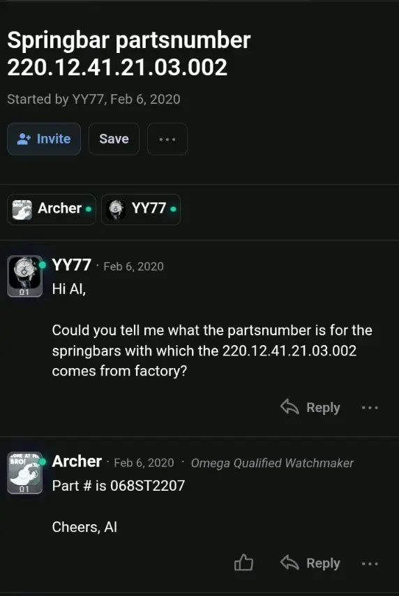

OP 19mm 220.12.38.20.02.001
20mm 220.12.41.21.03.002
30,259
78,107
Confirmed 2206
2207 as above
