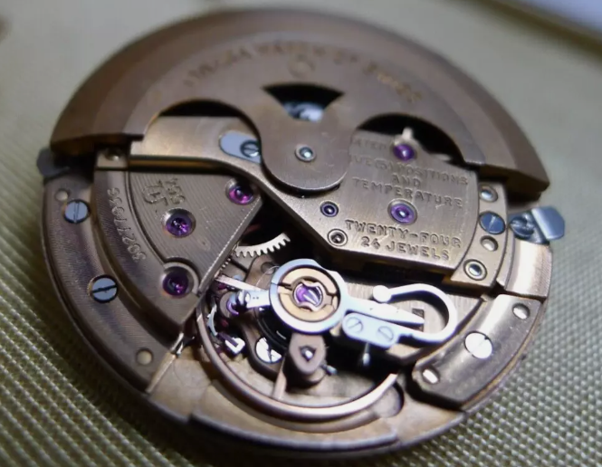

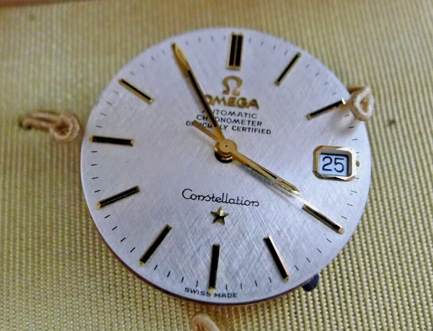

I've found a good looking constellation dial with 564 movement that is without a case. Considering buying the movement and casing it, but was struggling on which ref is "appropriate"? The caliber is obviously used with multiple different reference numbers so trying to understand if it is "appropriate" to use any of them, or if there is more to it to ensure the dial matches the reference? Is it by using the movement serial number to find a production year and then a corresponding reference number? Is there a table with this kind of information? A fellow forum member helped point to ref 168.017; are there are other references that would also be correct, or is the 168.017 the one to get?

Ref. 168.027 could work also. The issue with trying to match a movement to a case reference is usually the dial. Both have to fit the case. That style of dial came from a “C” case. I’m not sure it would fit any other style of case.
