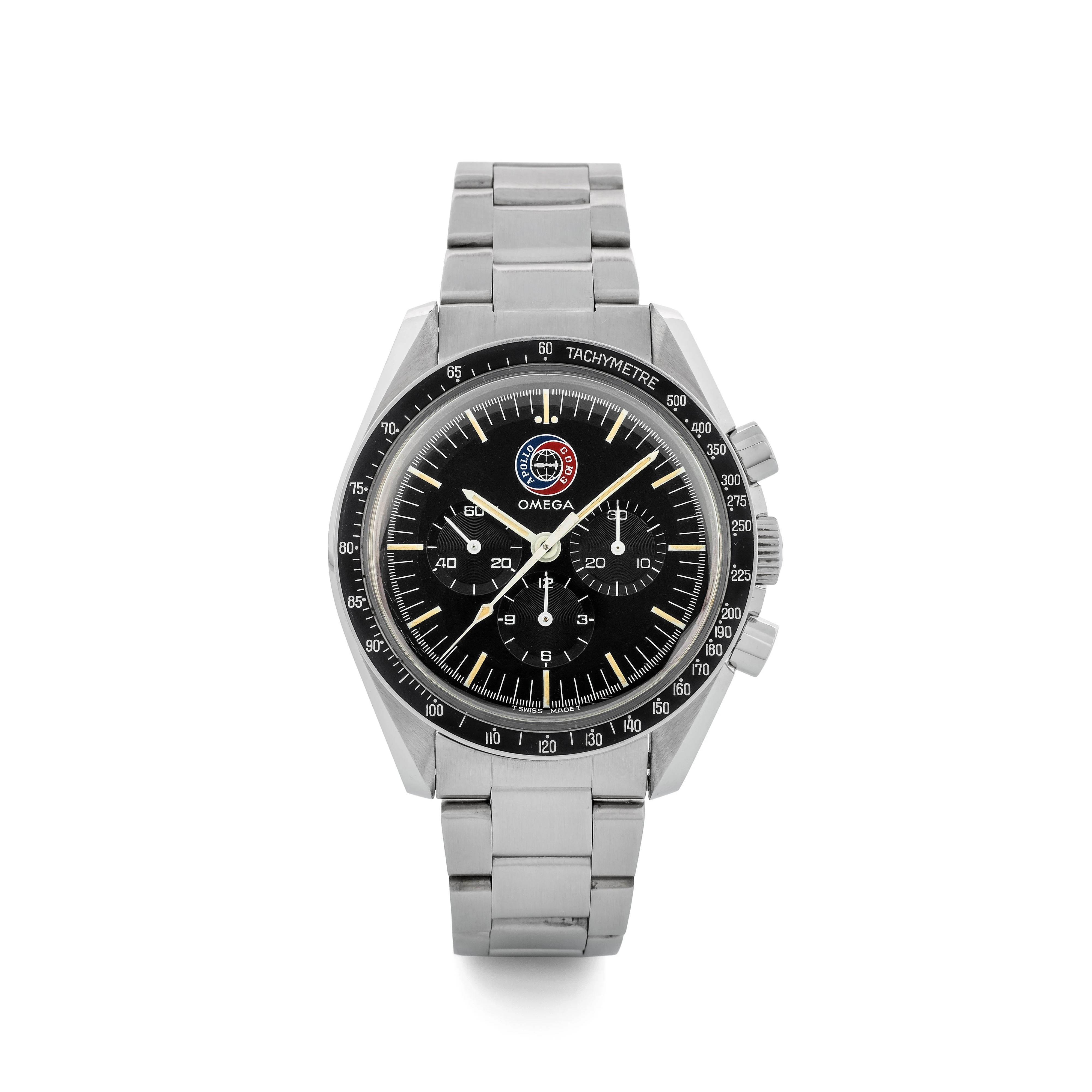

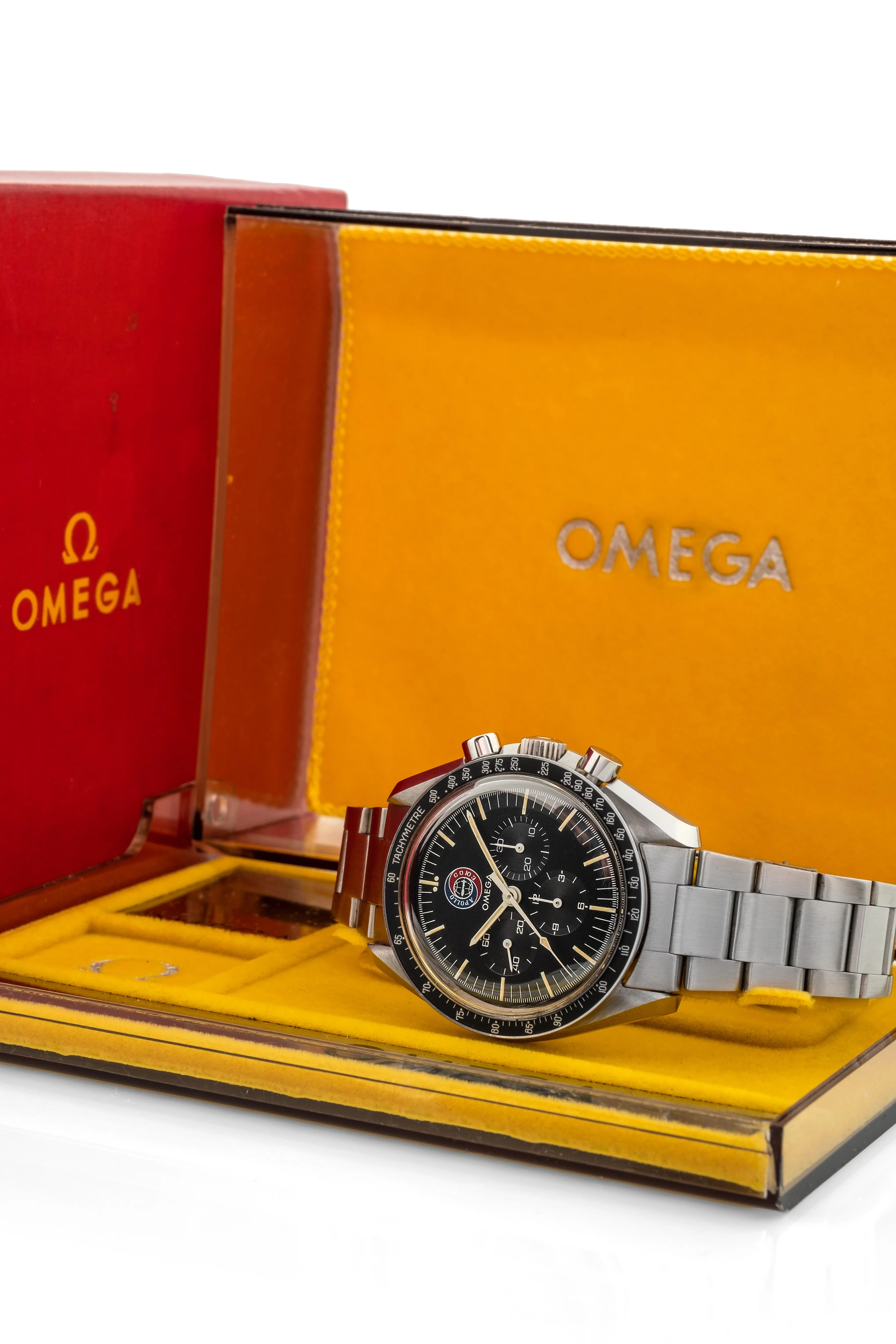

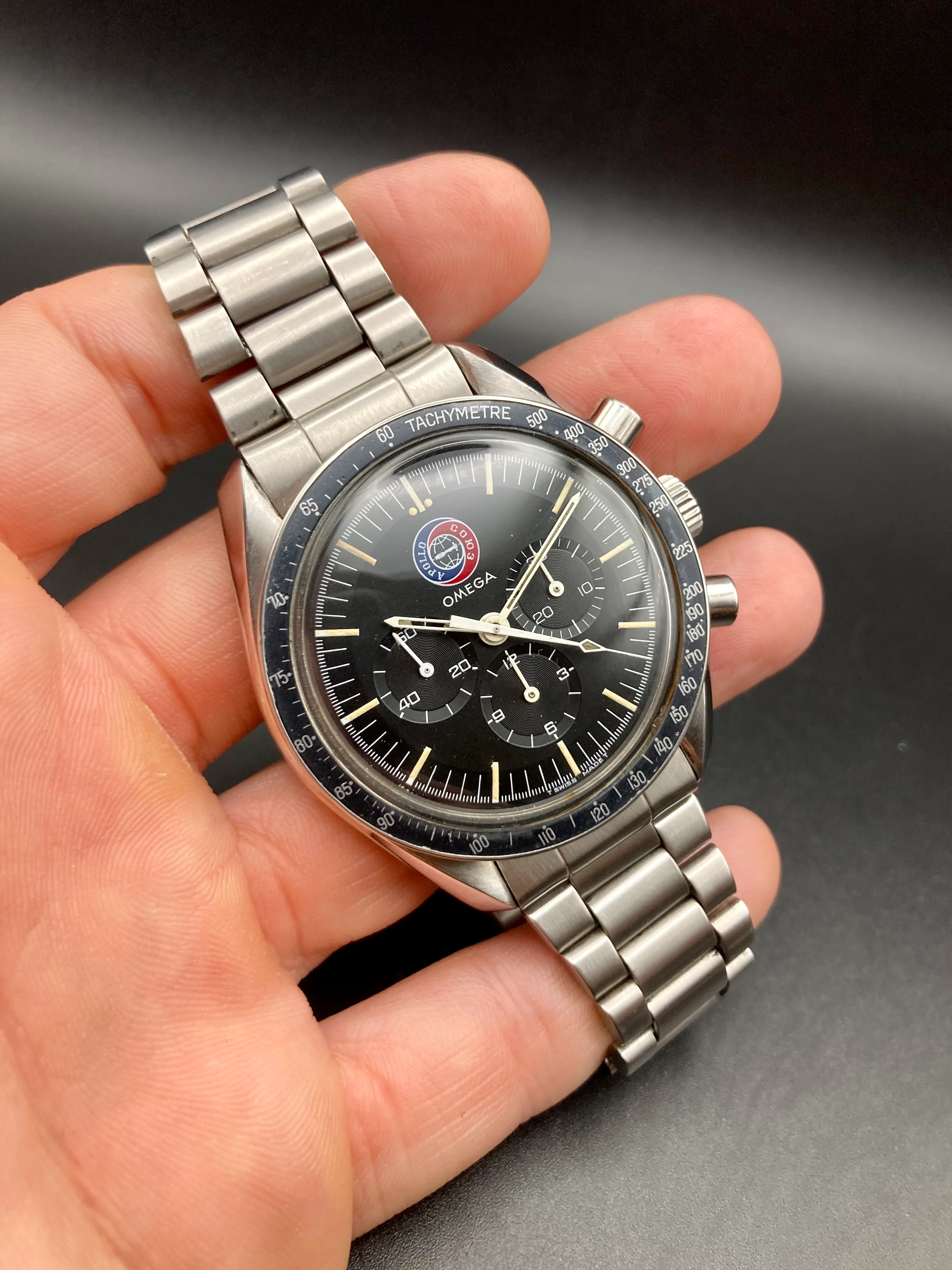

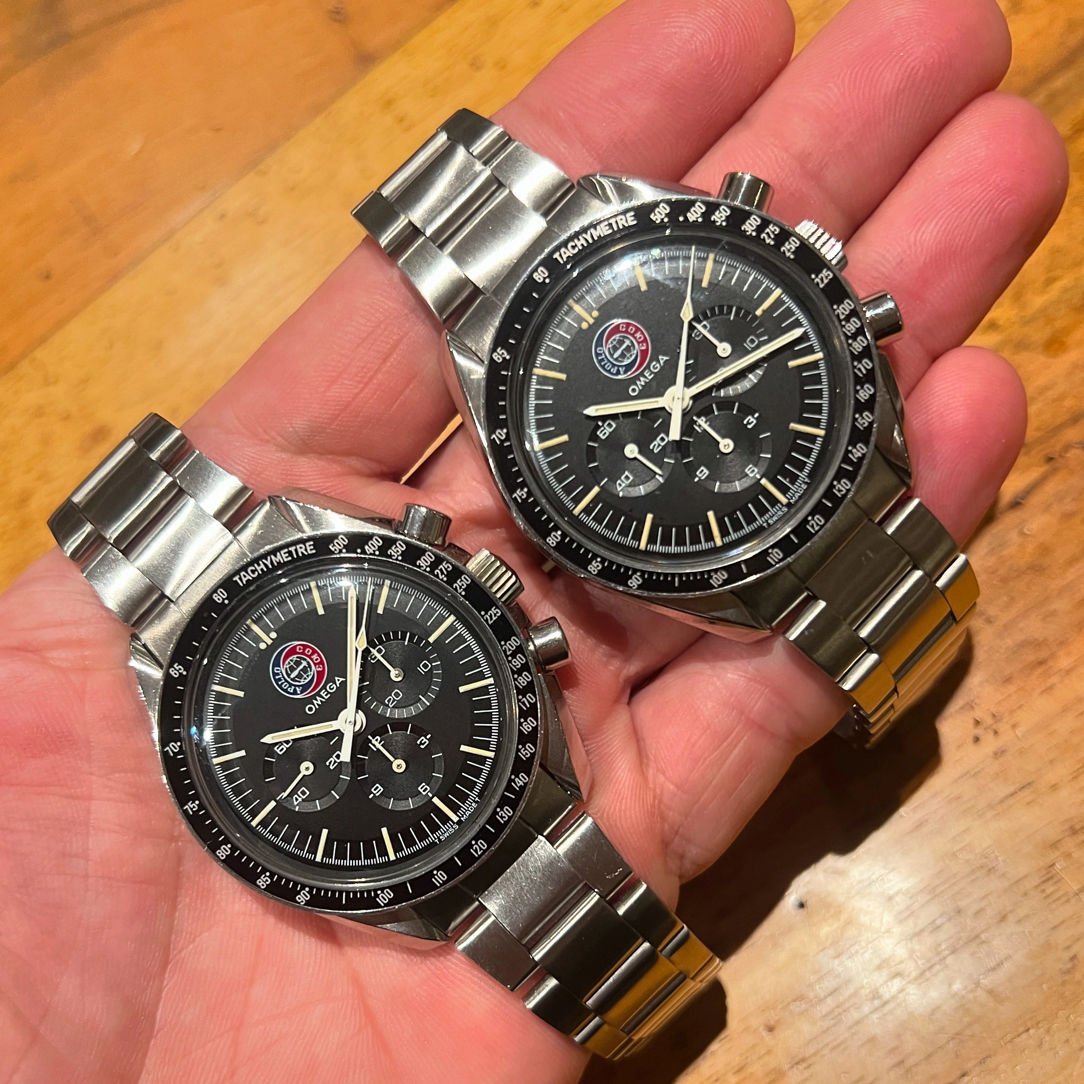

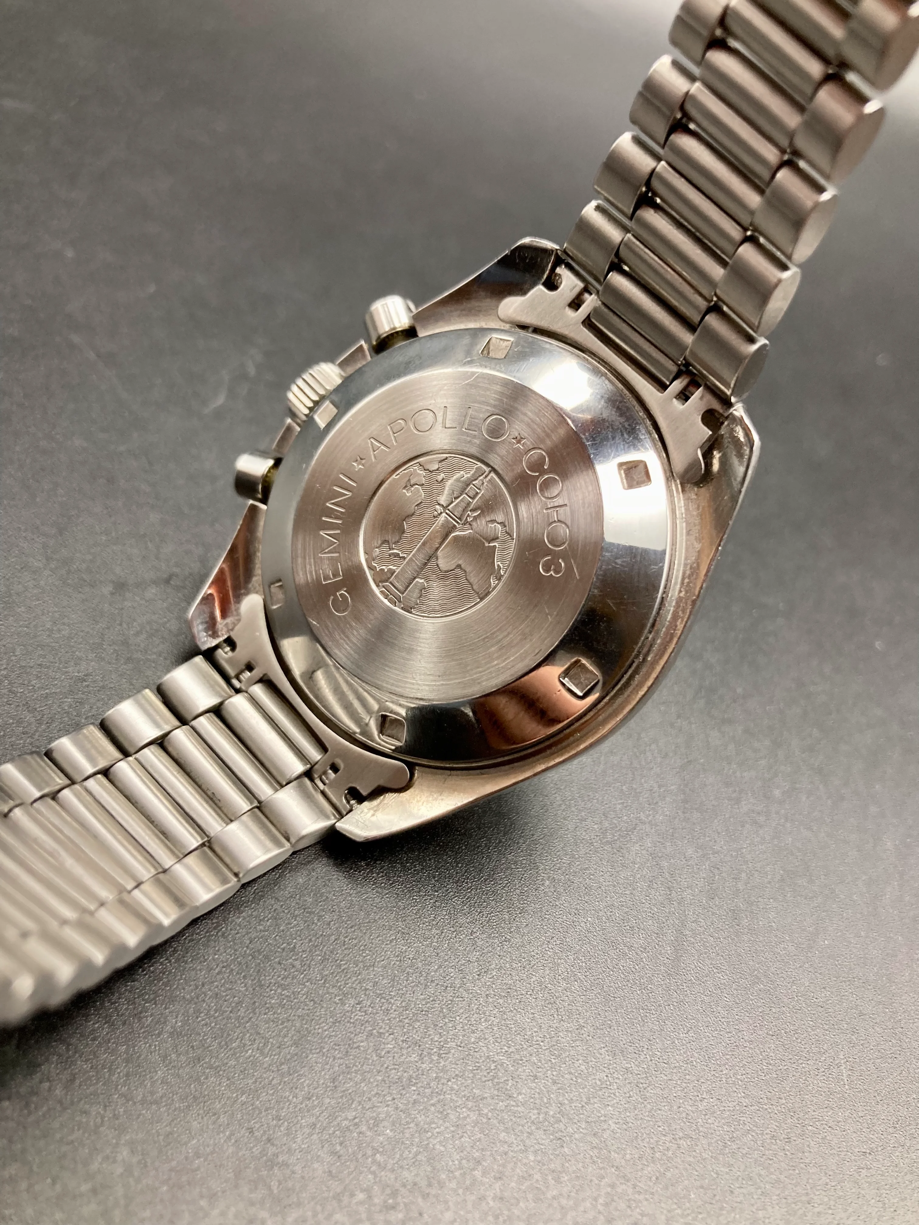

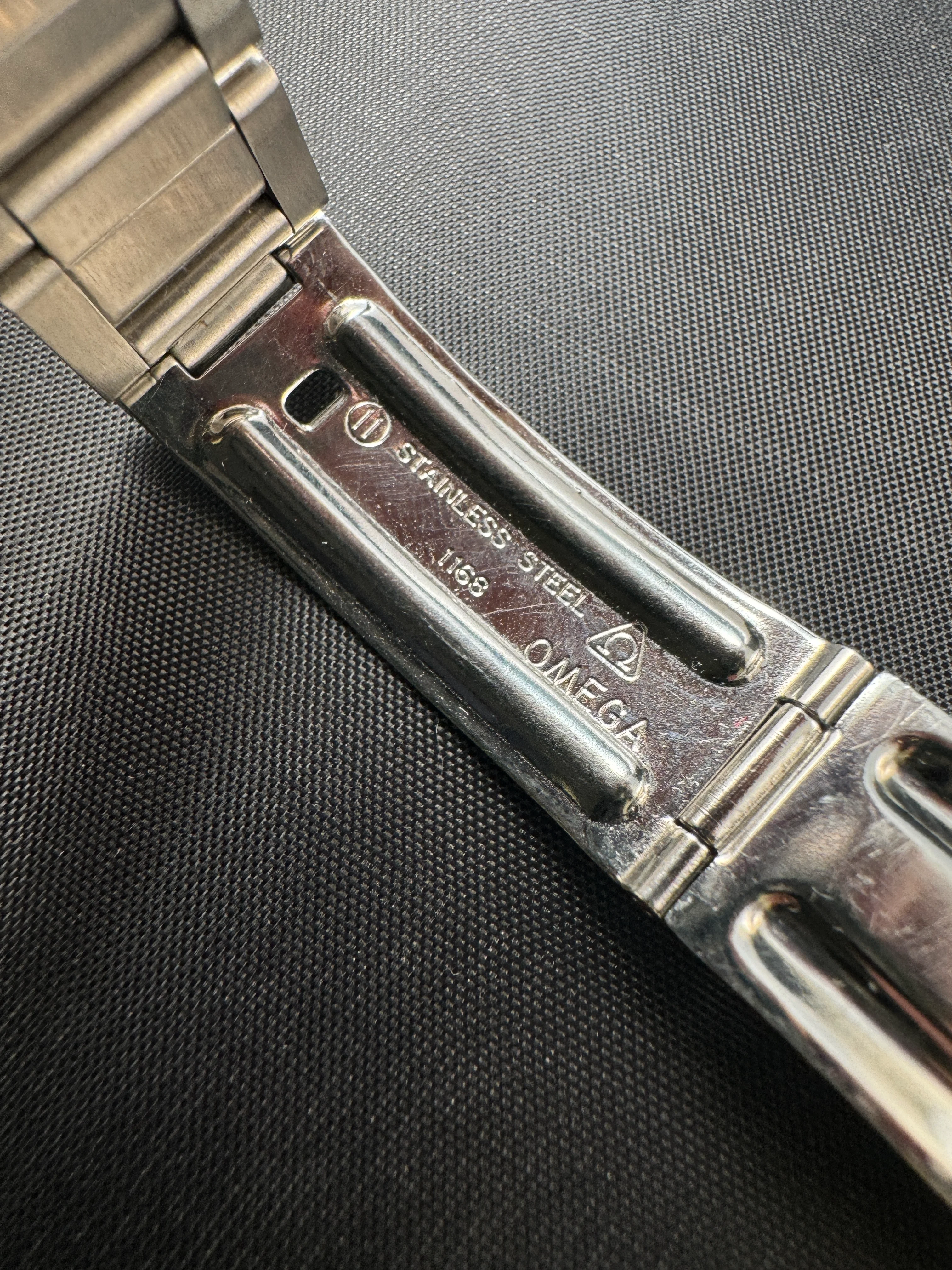

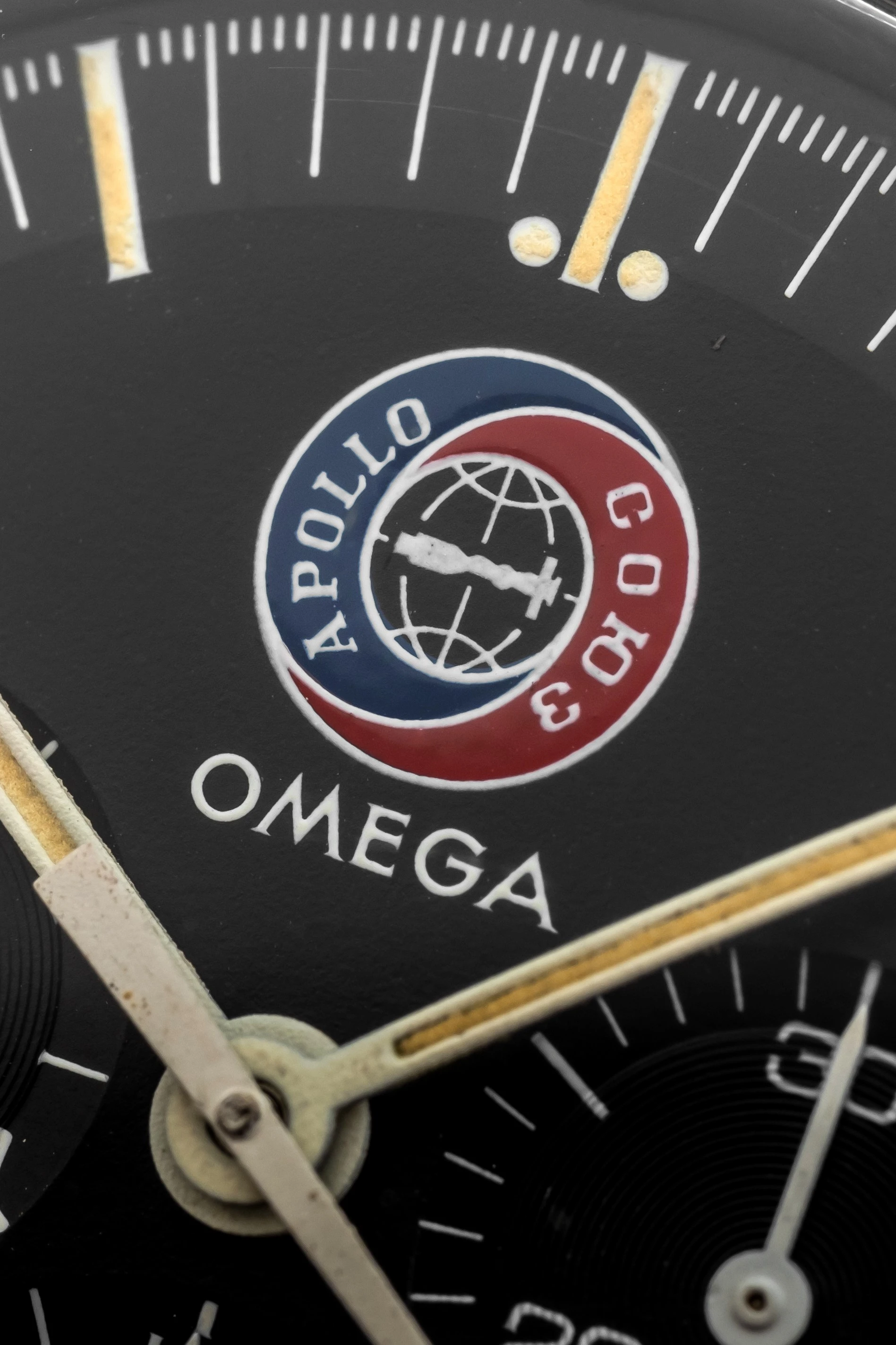

Here’s the already known no. 111 next to a new entrant; no. 174.
(My picture, not my watches unfortunately)
2,462
11,849
I remember the mission, but i don't think one of these will ever be attainable for me.
763
1,088
Wow, is that as good as it looks?

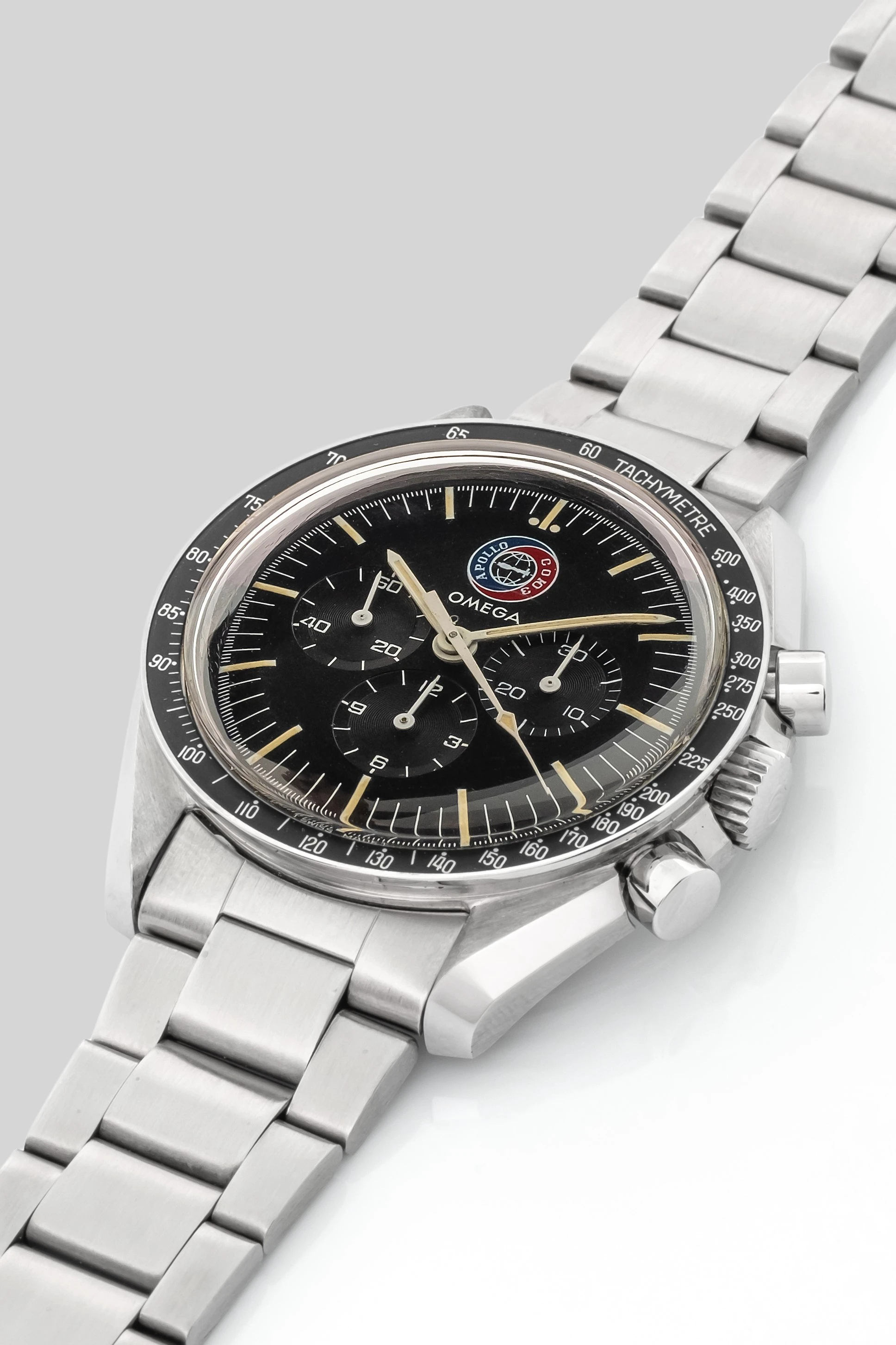

Looks attractive…Serial is hard to place in the timeline though. Not part of the original Al batch, depends on what you feel about the »other/later » one vastly discussed in the forum

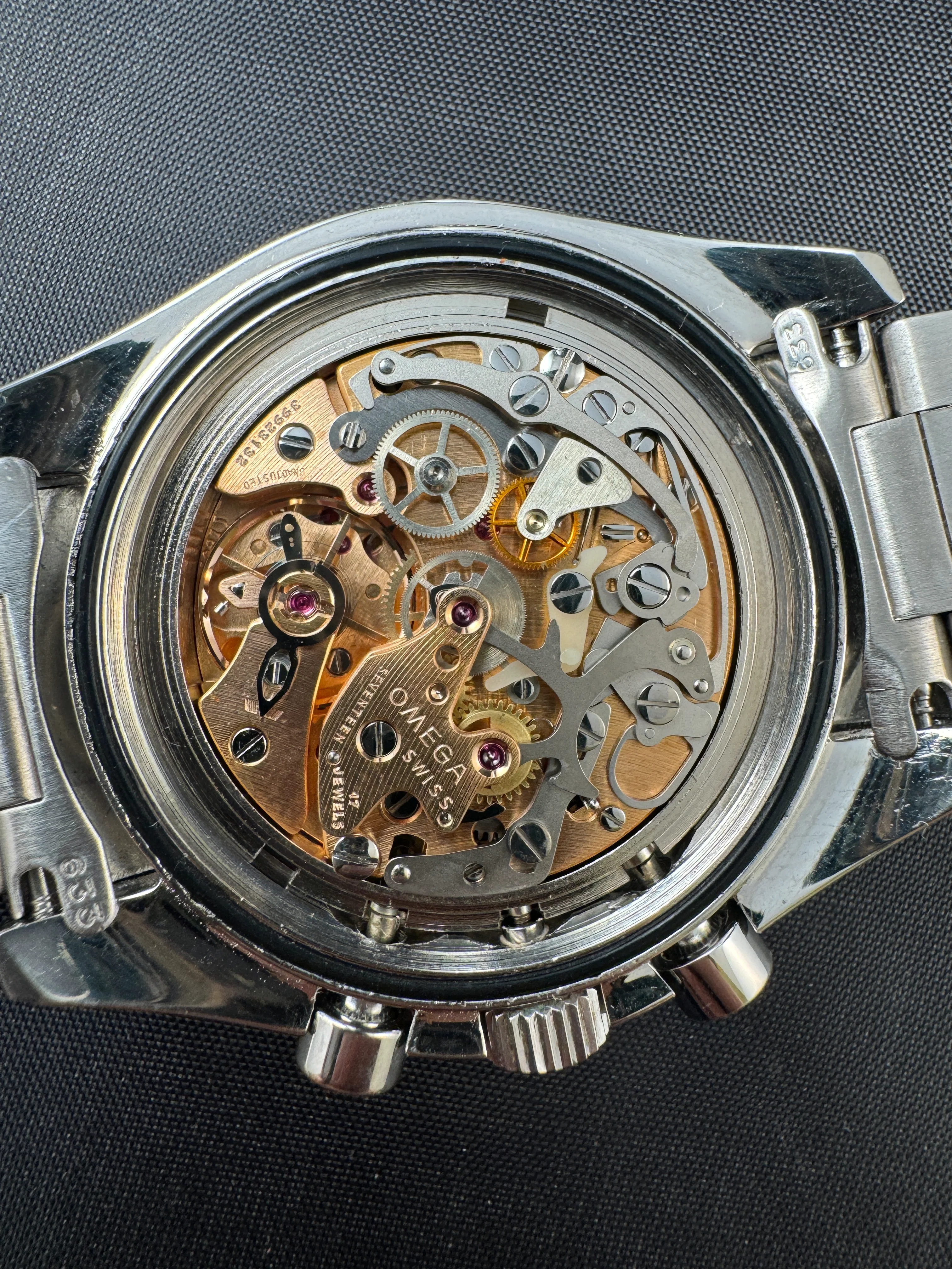

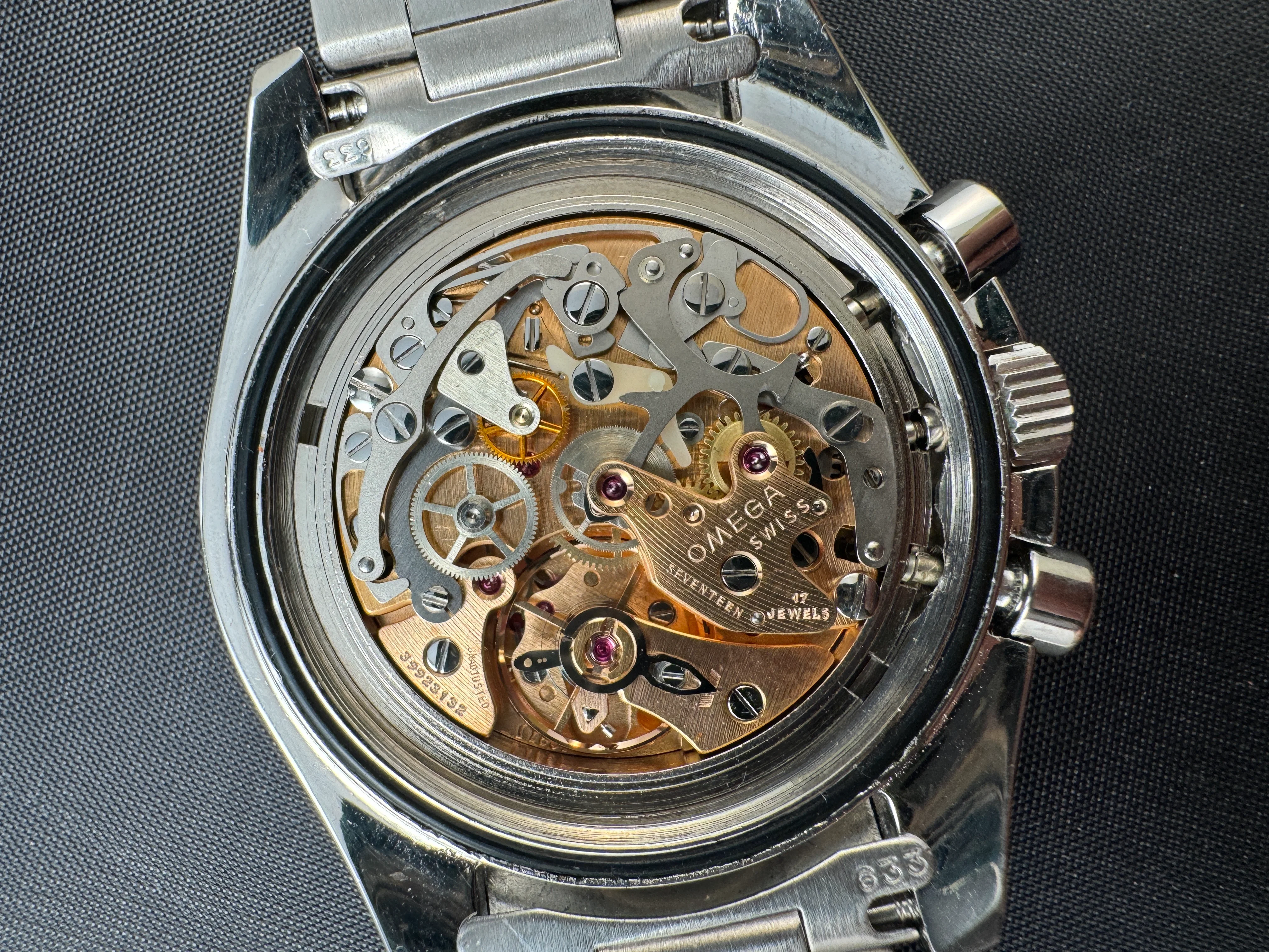

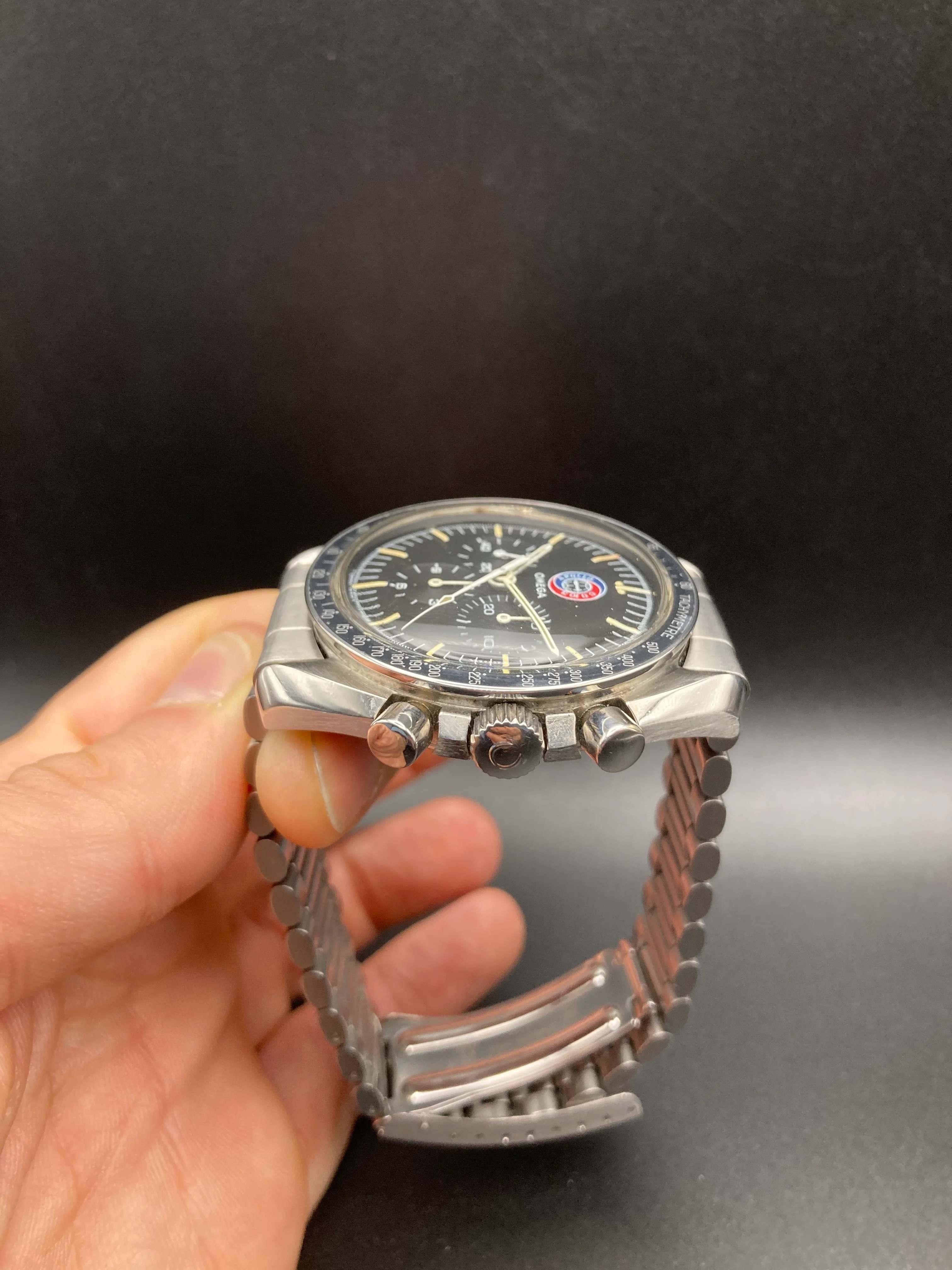

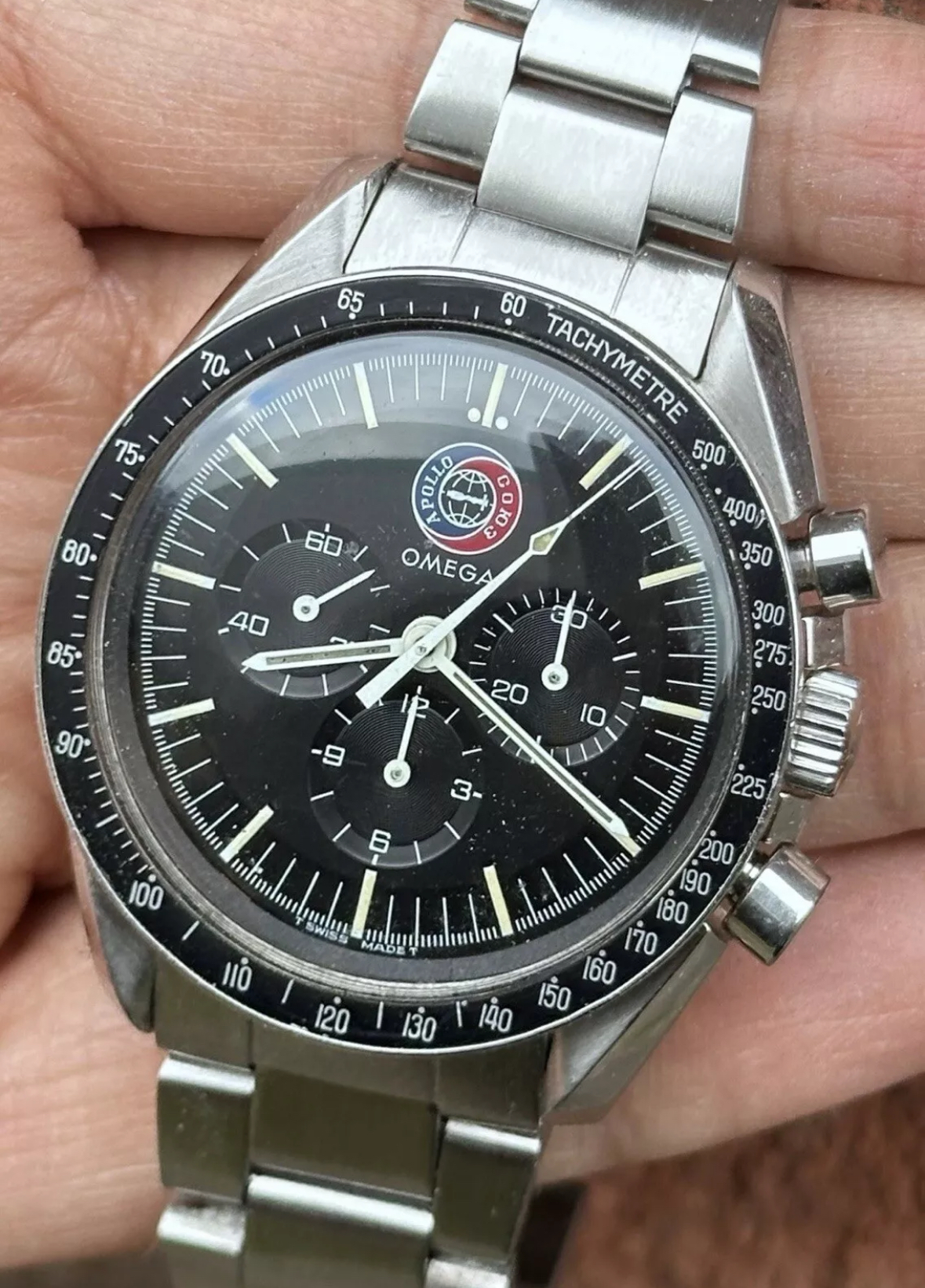

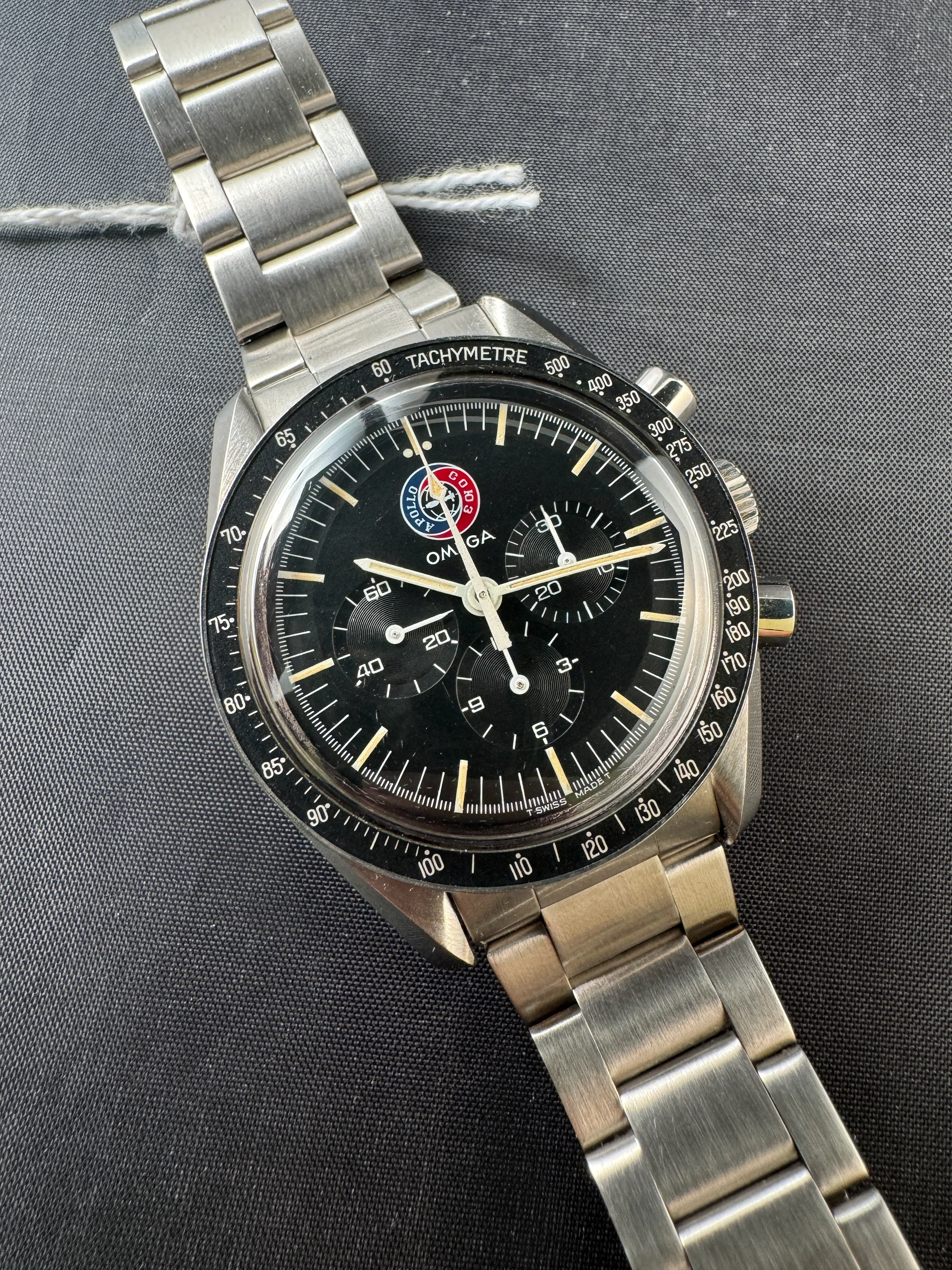

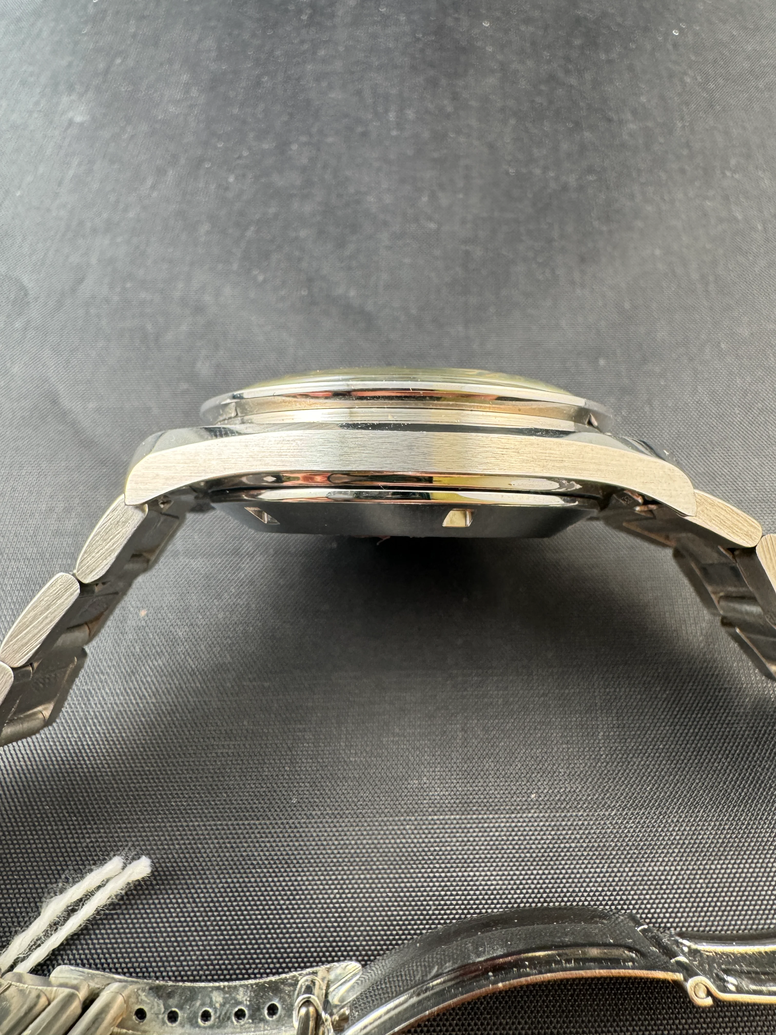

This "so called" A-S got sold (a few minutes ago...) for 21950 € / 23100 $ incl the premium!
Serial nr 39180932, not the correct pushers...and no engraving on the caseback.

Small pusher, no serial…
Sold to De Marchi but not officially an AS.
Yeah, I’m familiar with that and only shared for discussion purposes and not to catalog in the registry. Though I think the other Soyuz thread could have been more appropriate for that. I’m tired 😅

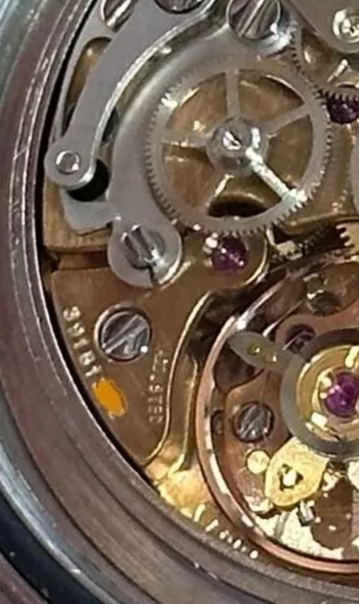

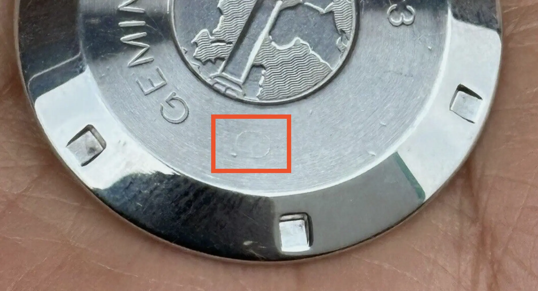

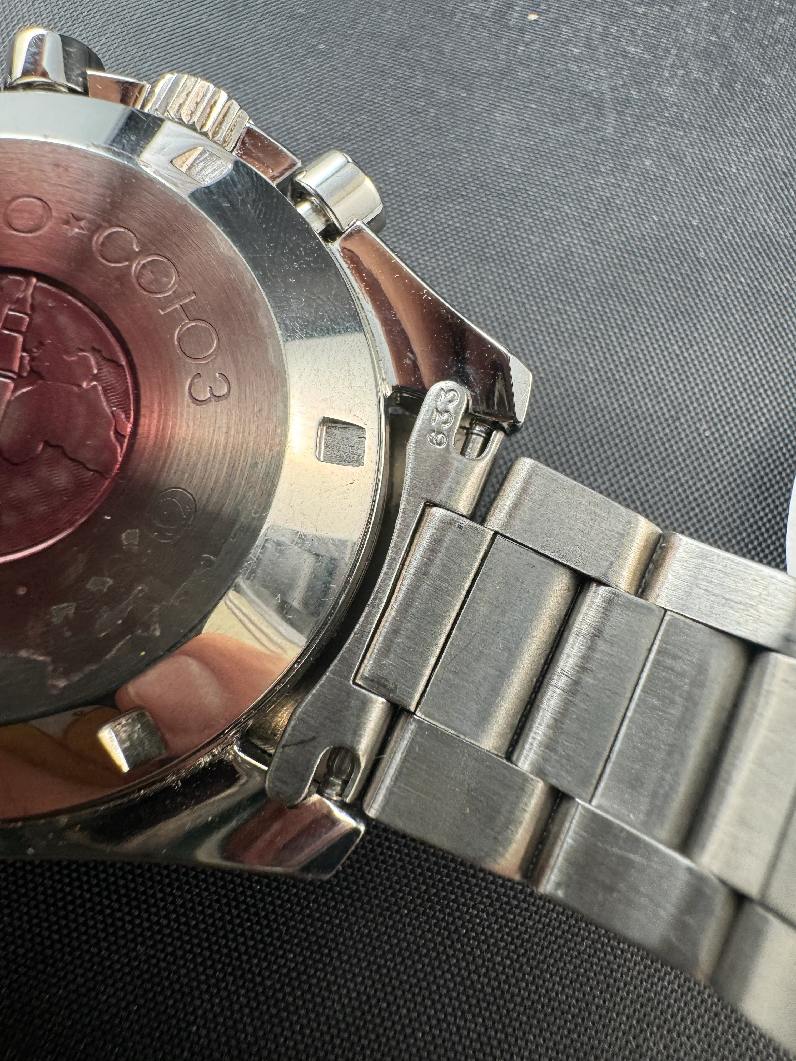

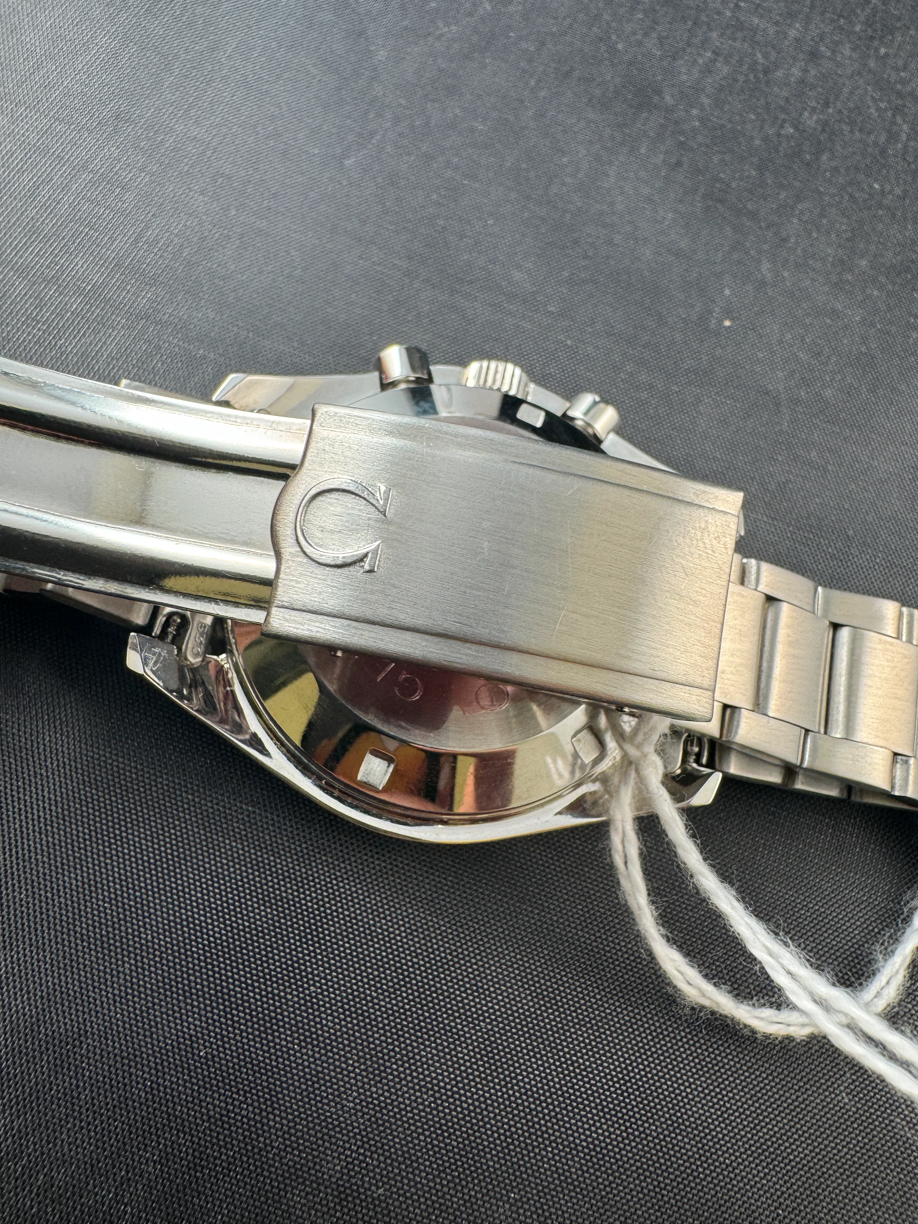

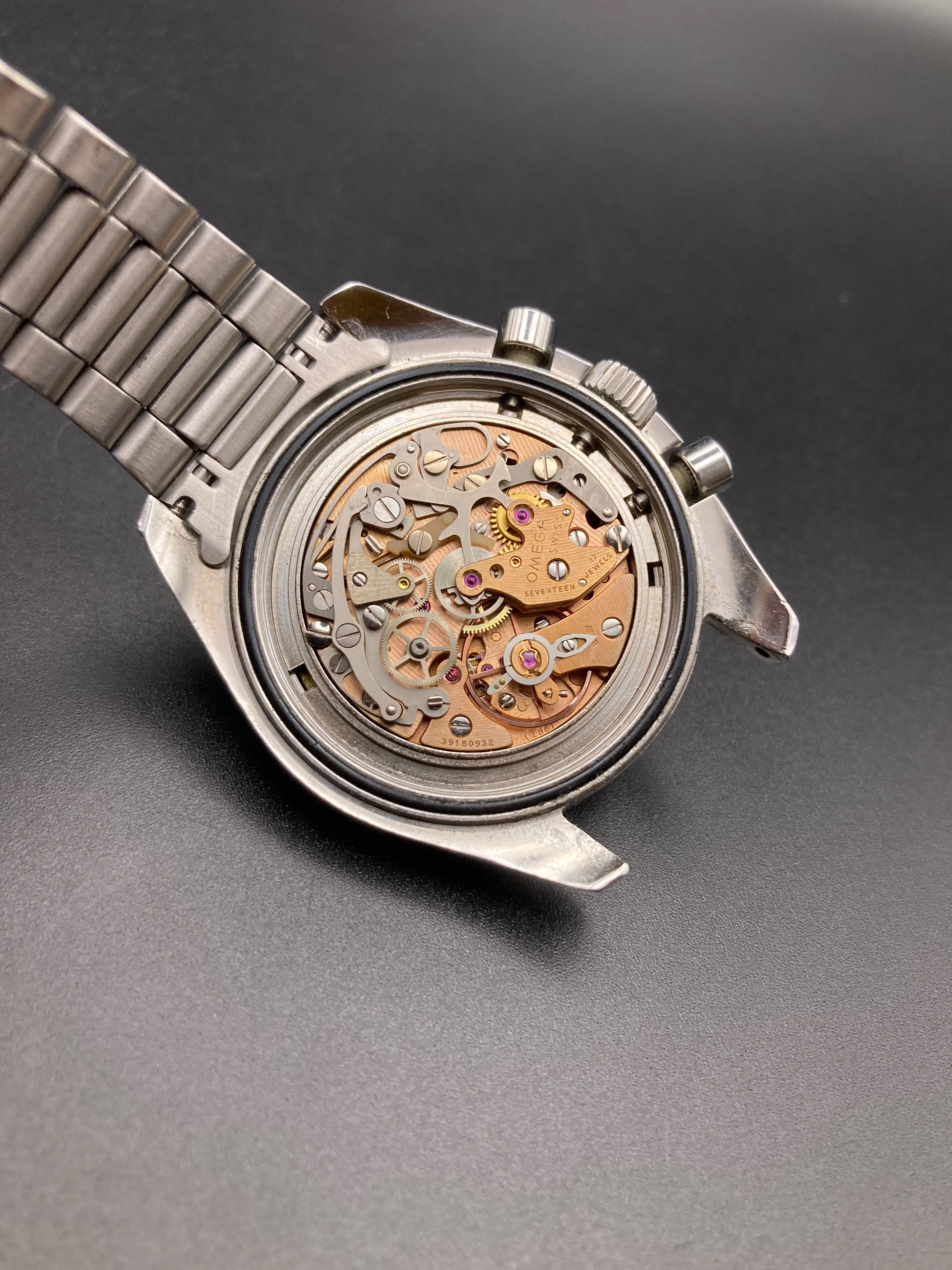

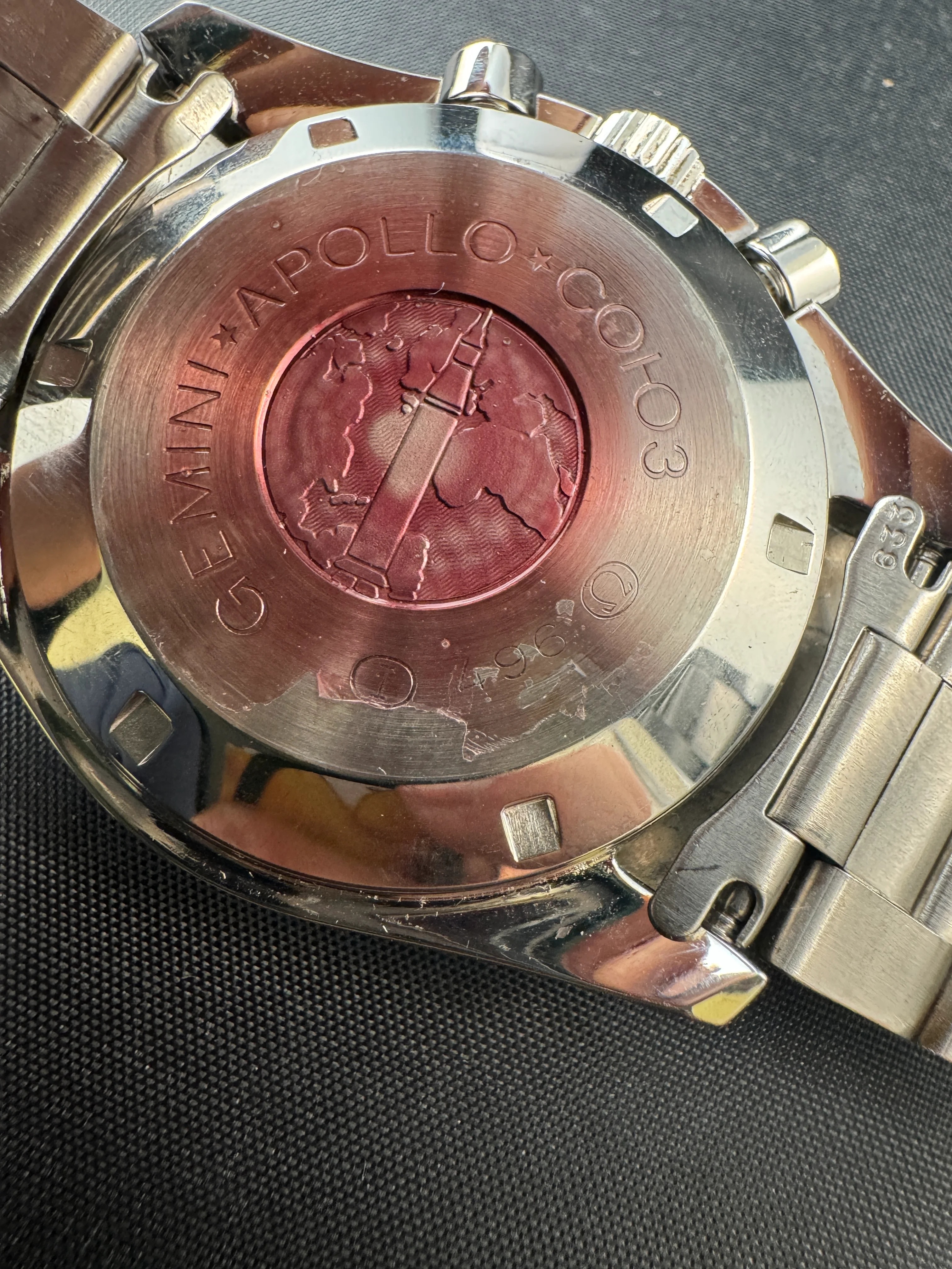

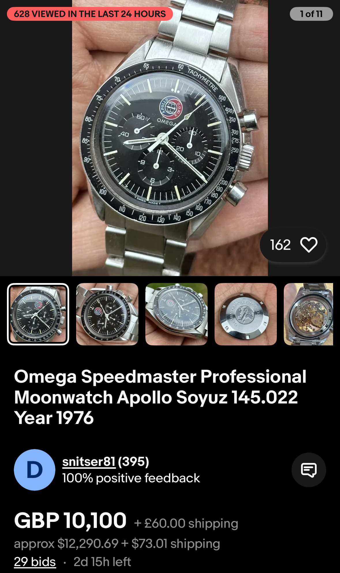

Ive asked for the full serial for this watch but the seller hasn't replied 39,181,3?2 can be seen on the movement. You can also see a faint engraving on the case back.
I am still very sceptical on it though.
I remember dials on eBay and ive seen case backs too many years ago, same for the fake radial dials that are knocking about.
I also requested the serial number and nothing but crickets. No box, no extract, no serial number.

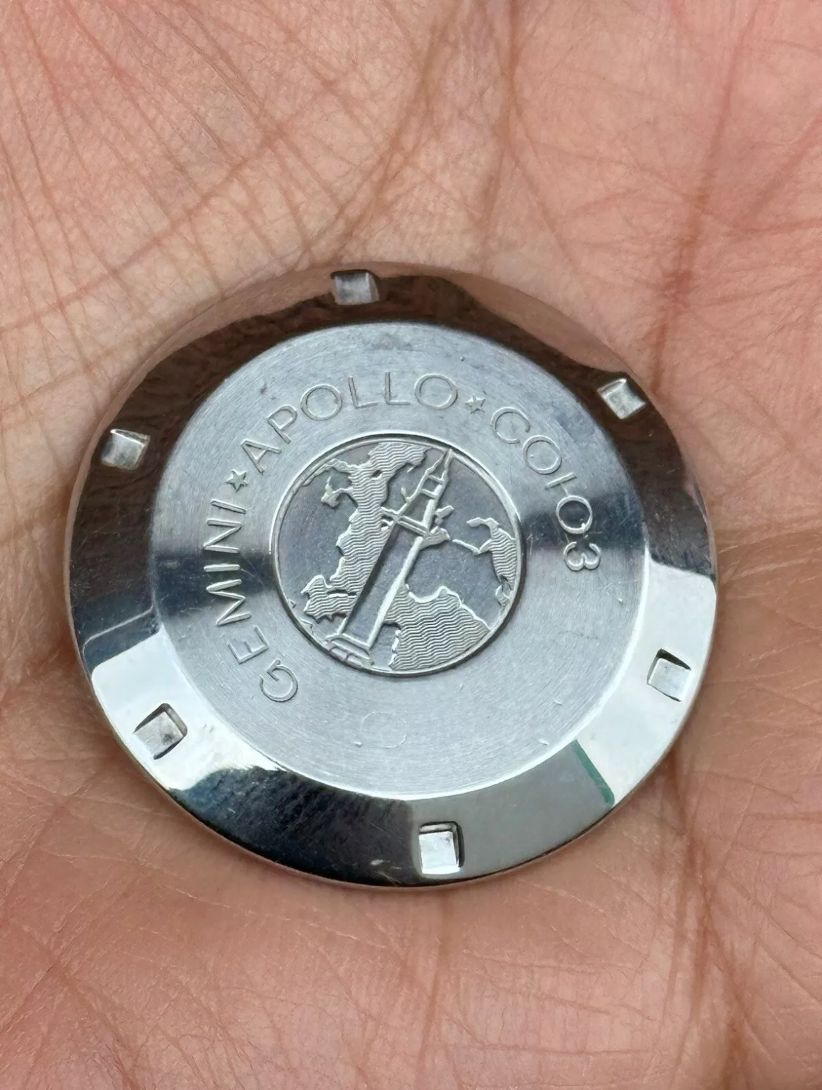

That has a small pusher case. So that’s all you need to know.

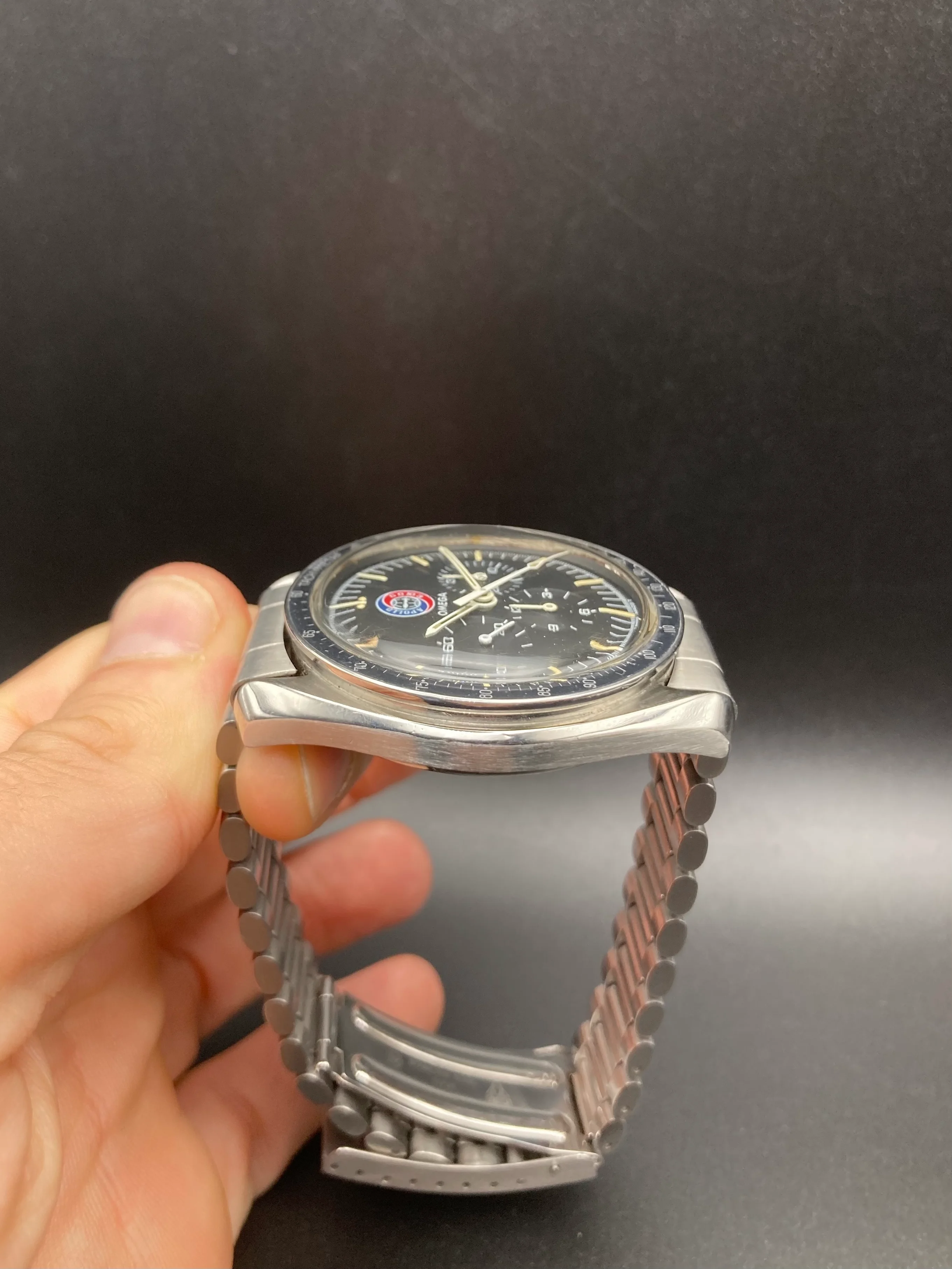

Might there have been an engraving on the caseback at one time with a
I noticed the engraving remnants as well, but as Foo2rama pointed out to me, the case is incorrect. It’s a cool franken, but a franken nonetheless.
I know. Just interesting to know the serial etc. I already clocked the case and pushers when it was listed with no bids. Soyuz pushers with no crud on are near impossible to find in NOS condition. Sceptical because it would be interesting to know where the movement originated from.

I wonder how many have asked for the serial number lol
1,993
3,689
Less than two hours to go. Once the buyer figures out it's a franken I wonder what their options will be.
