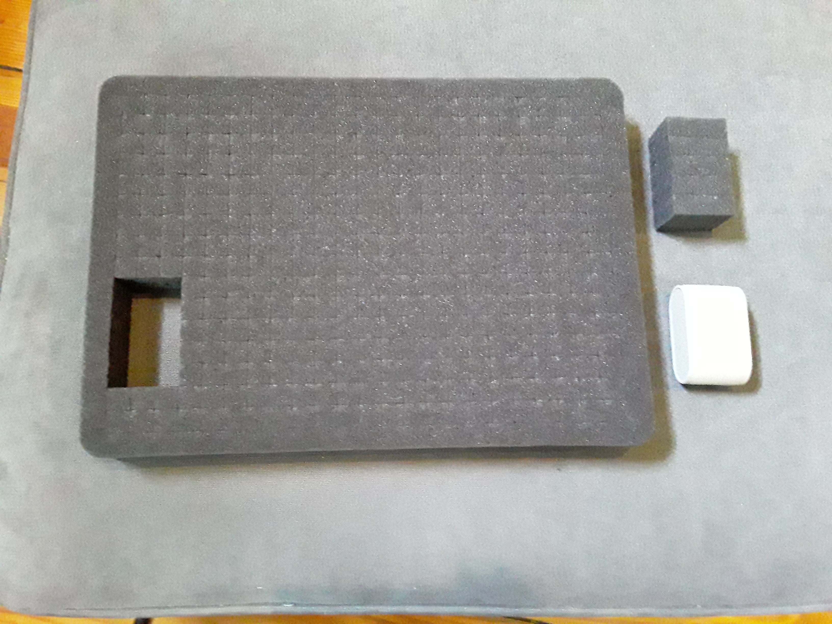

this looks like a 5/3 cut out
all these watches seem pretty big in terms of size
imageuploadedbytapatalk1327257748-472976-jpg.609233
confirmed 5/3 below

so my options are
the first two numbers will be he amount of squares removed for each watch
4/3 - 8 watches
4/3 - 15 watches
5/3 - 8 watches
5/3 - 10 watches
5/4 - 8 watches
6/4 - 8 watches
7/4 - 8 watches
seems like the 4 square width is universal. but i wonder if going to 3 might be better because the watch will be wrapped around this foam which isn't that strong and is quite malleable. unlike the hard watch type holder/pillow from many watch boxes
the 3 square option will likely keep the watch sitting high in the hole and not as deep as well. i don't know which option will be the best
one thing i didn't consider is if each pick and pluck square is a universal size?. if it isn't things are gonna get really hairy for me.
has anybody done this before and wish they cut the foam differently?
the question is how big i want to make the cavity in relation to the dimensions/size of most of my watches in the collection (no watch over 41) vs how i want the watch to fit within it.
snug and close to the top vs deeper and maybe not as snug

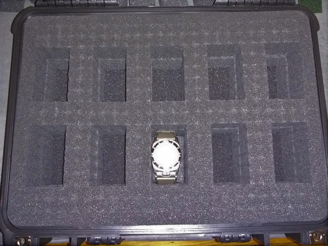

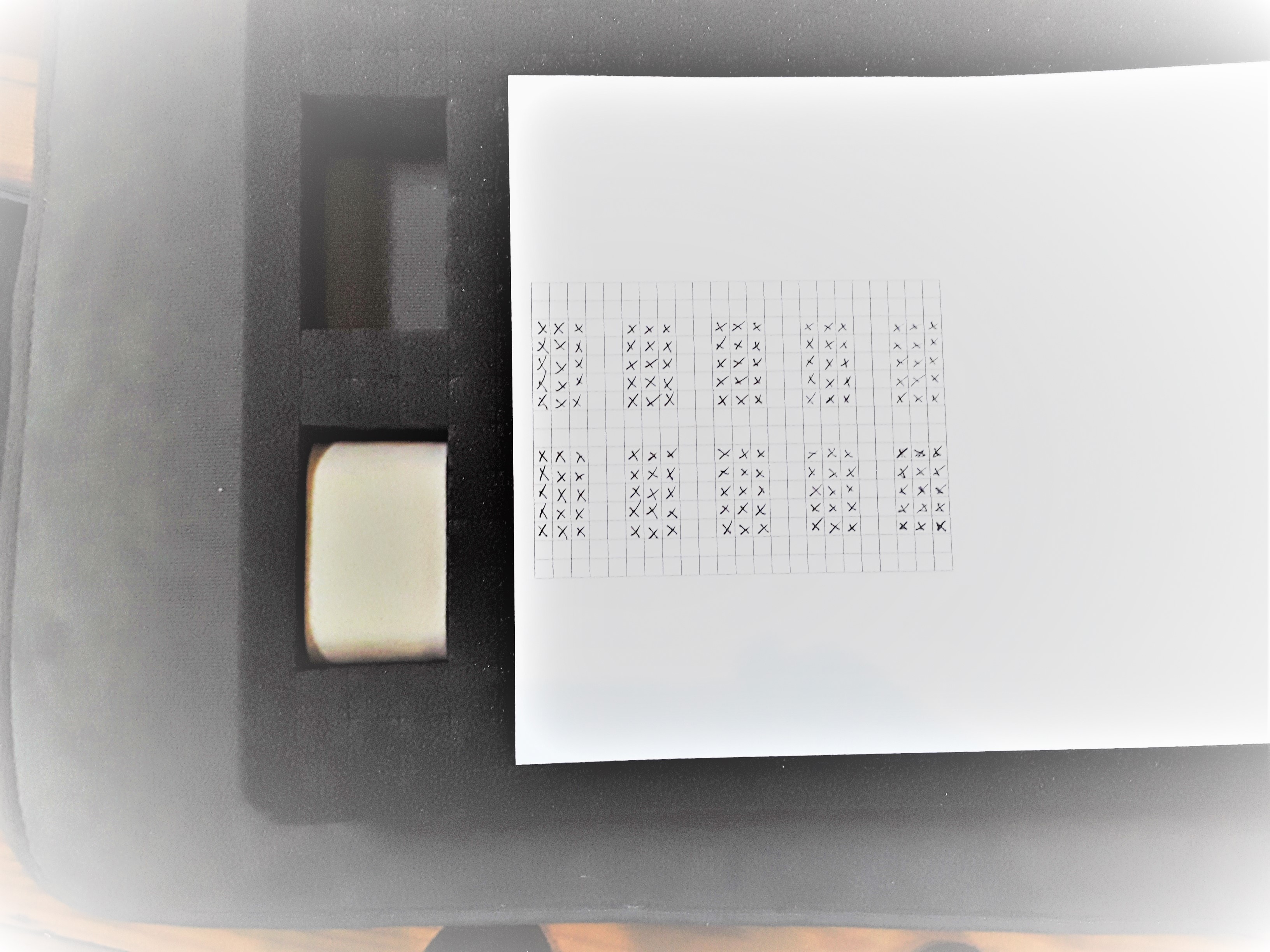

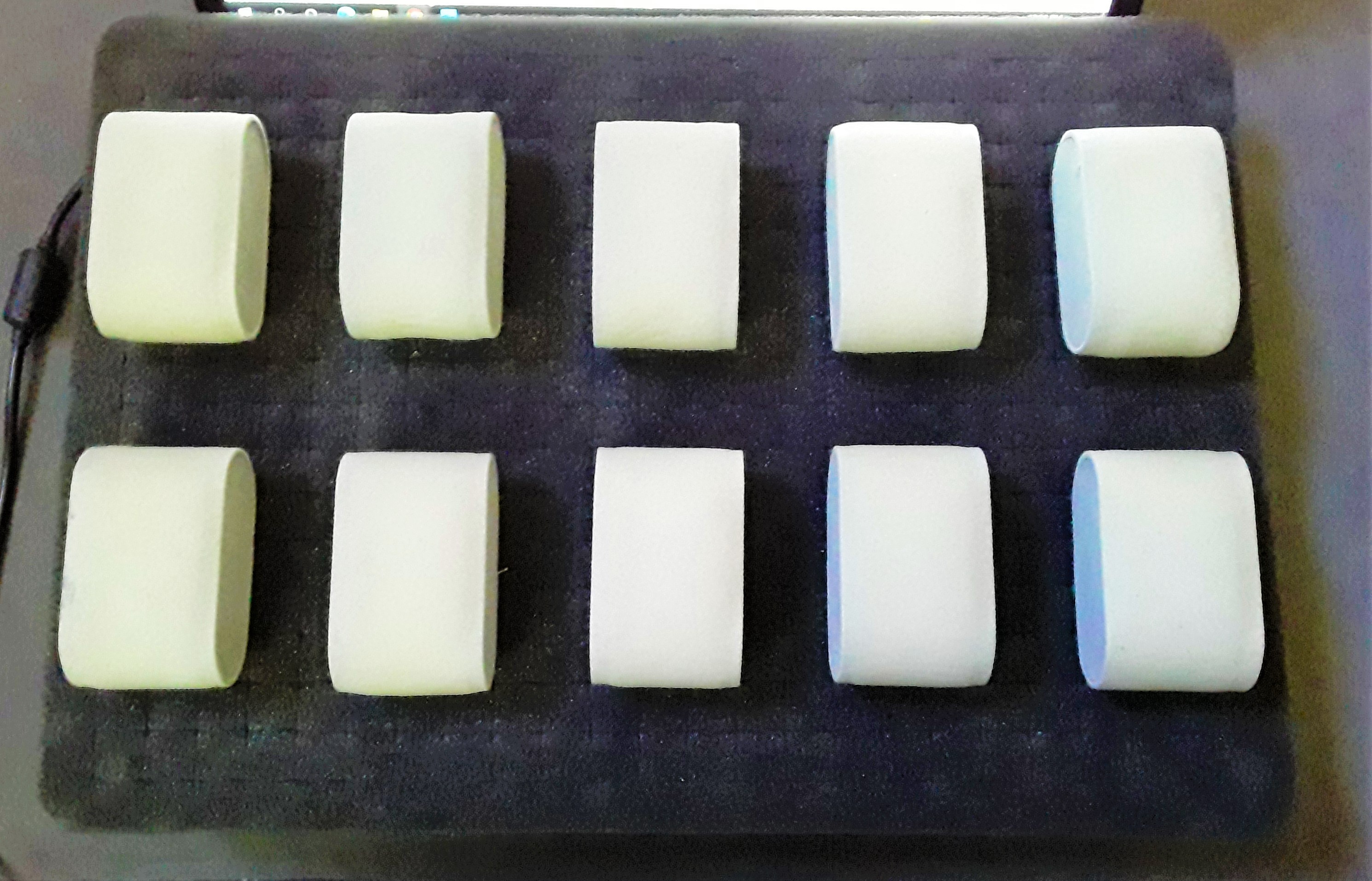

here is a 5/3 cavity for 10 watches
thing is, i won't be using these holders/pillows. but these semi hard holders will fit in 5/3 but it's tight. (they would be perfect for 6/3- or a more spacious 6/4)
for 10 watches i will only have the perimeter buffer which is a lil bigger than 1 square left/right
good news is that i get a 2 square buffer everywhere else and 3 top bottom

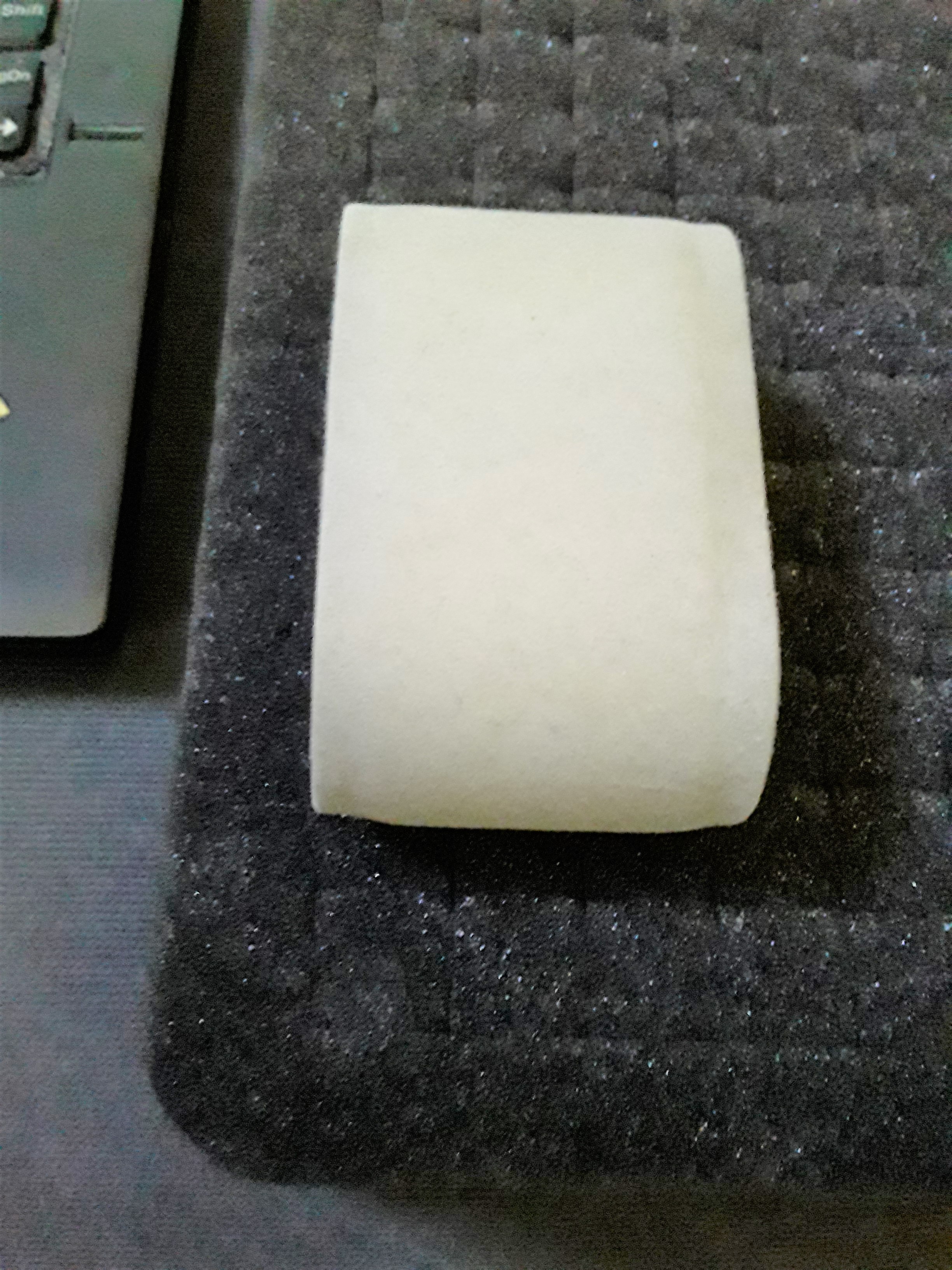

i lighten the pic and give a different angle that the first pic doesn''t show which make the 1 square amount seem worse than it is. even eye balling it i couldn't get it straight. the light exposes it (see the overlap)

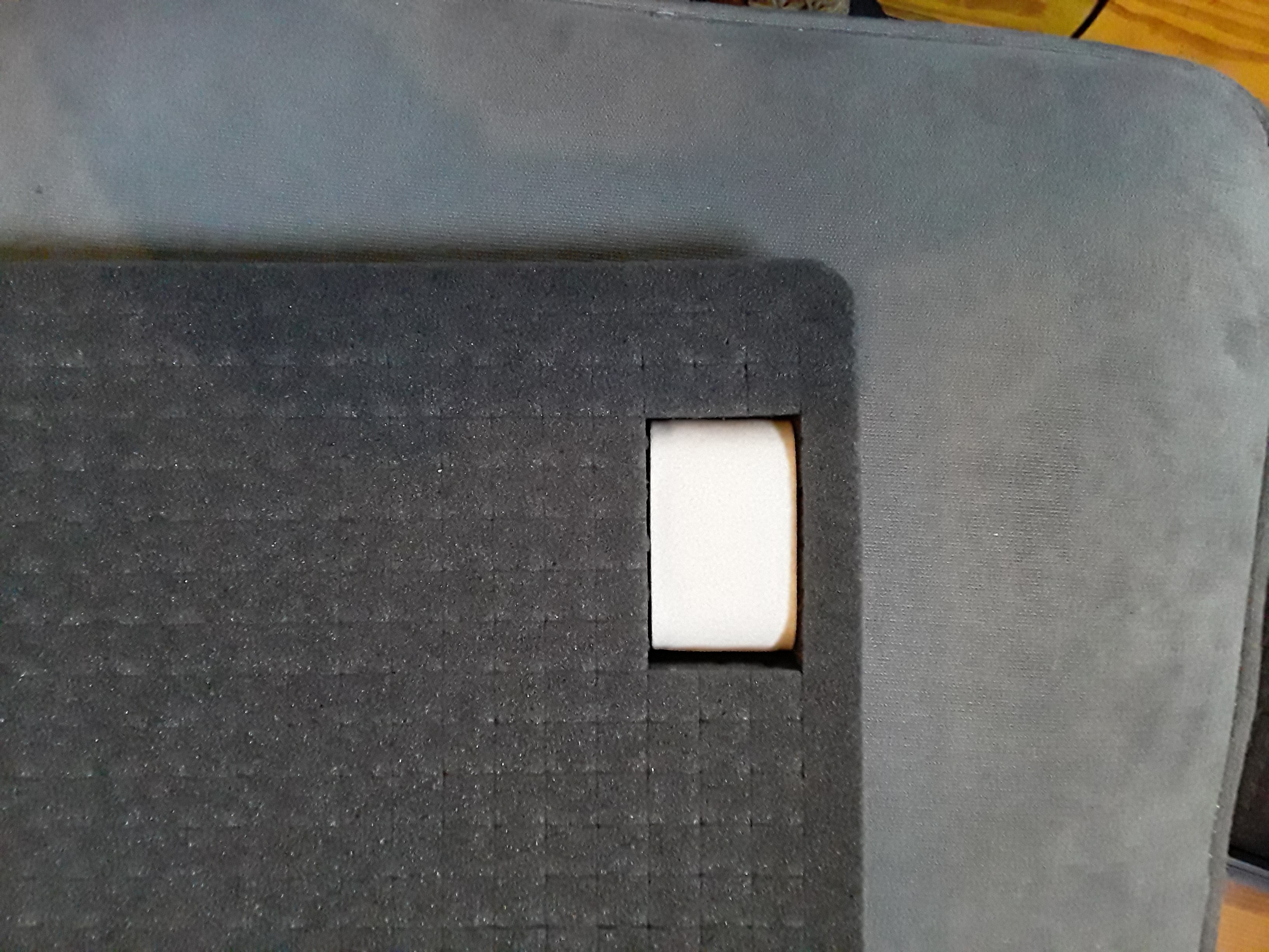

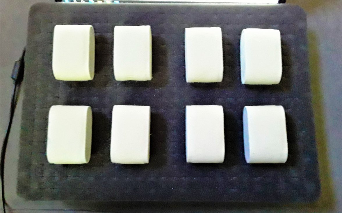

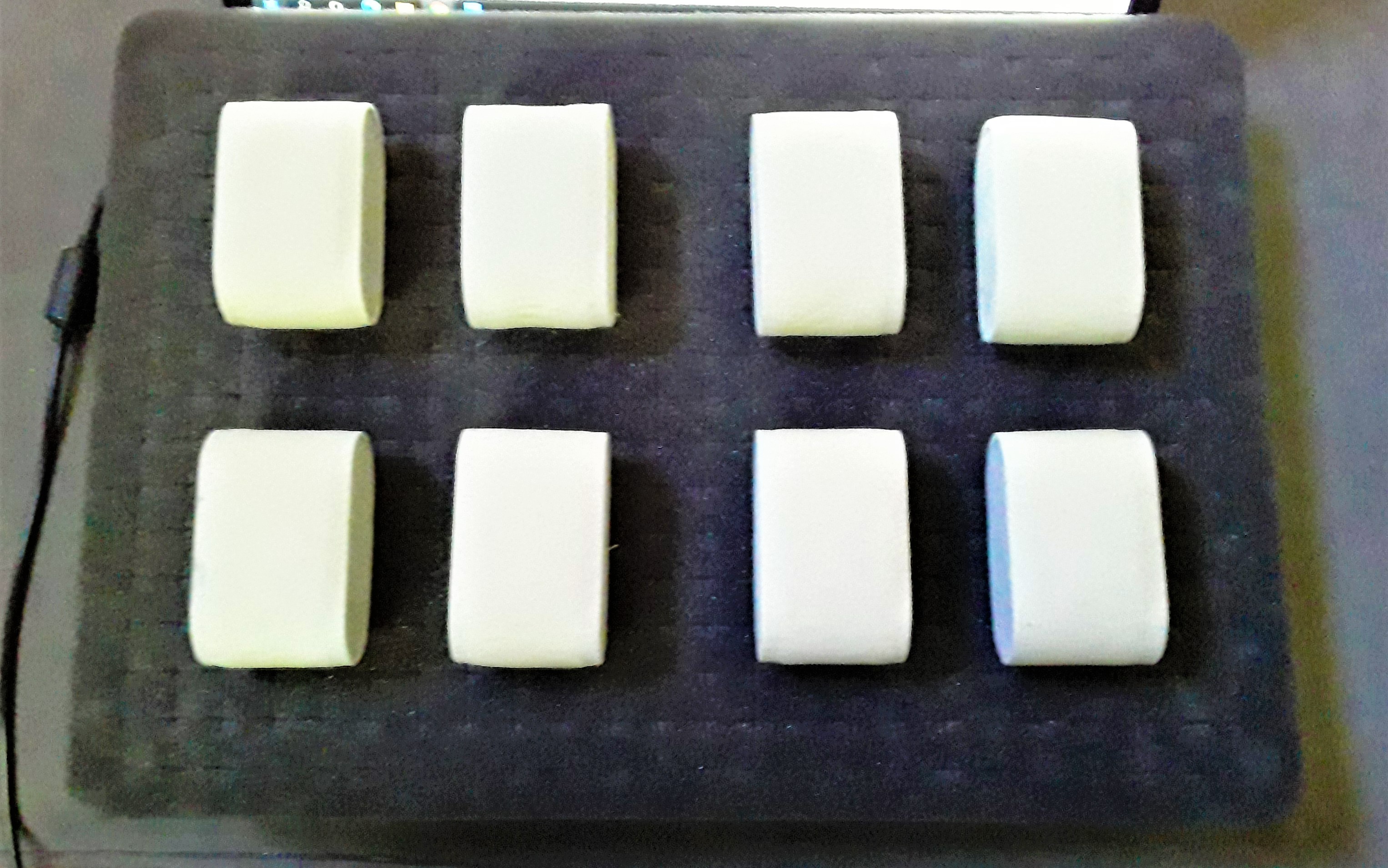

here is a 5/3 pattern with 8 watches
2 and 3 square buffer/protection everywhere (can't avoid the larger 3 square in the middle)

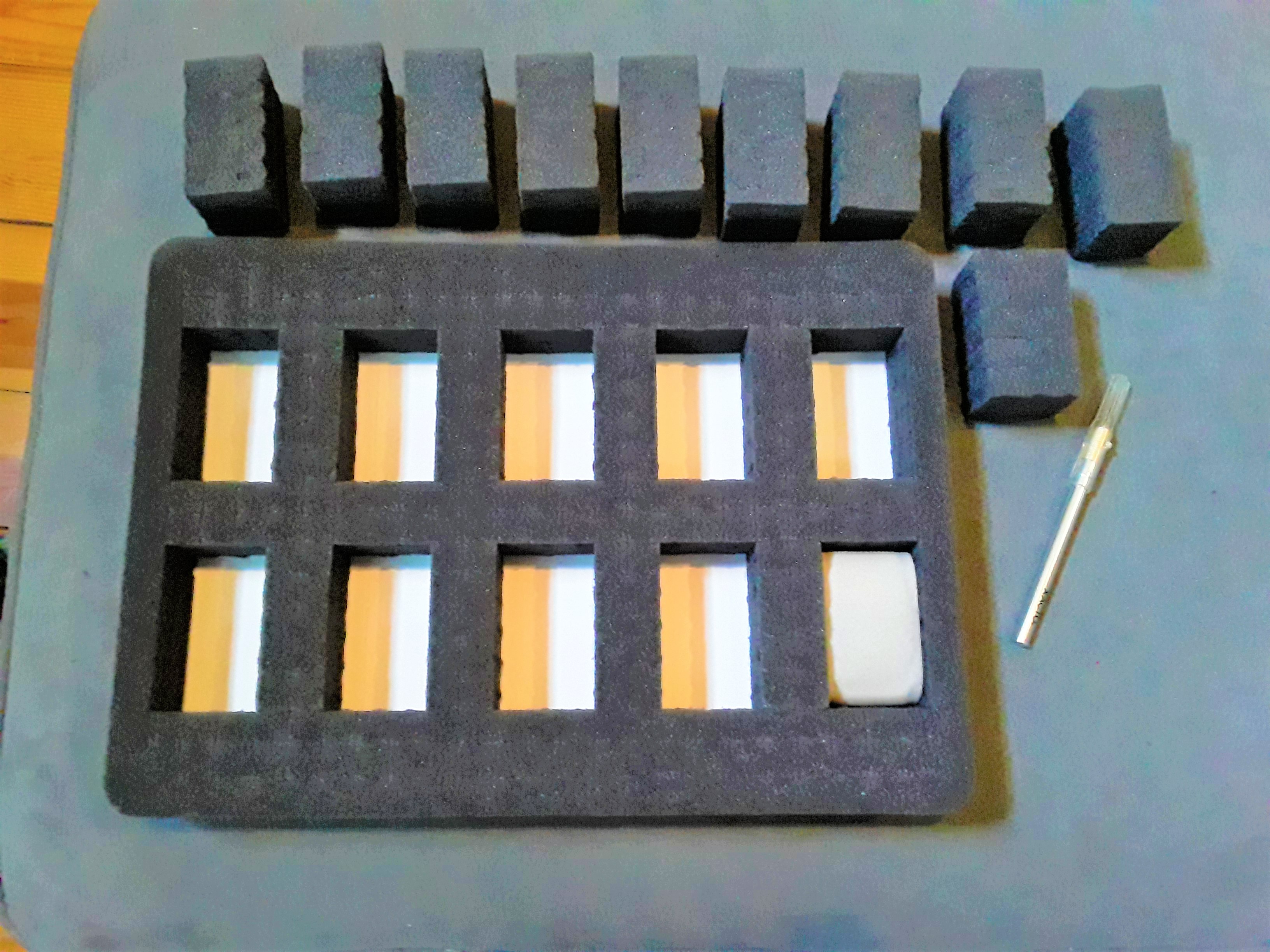

if i keep the pick and pluck foam as a watch pillow holder 5/3 will work.
if i upgrade (using the term loosely) to some pipe foam which can be had for aprox $10.oo per 6ft it will give it a much cleaner and professional look, because it's contoured perfectly to hold watches. pretty sure i will have to go to 6/3 cavity
1,099
1,085
enough planning.
there's only so much you can do before you have to make a decision without the best visualization.
went with 5/3. (3 inches x 1.75 inches) this will allow me to go to 6/3 if i wanted to
what i've noticed cutting 2 cavities thus far:
-a two square buffer between each watch is the best way to go. if i only did one it's vulnerable to rip or not be strong. i do only have the outside buffer on the side but it's not perforated, so it's stronger and it's slightly bigger than one square
-pretty sure you want the watch in the cavity as much as possible. not on the edge
-take your time. it takes aprox 5-10 minutes per cavity. don't be a butcher with your exacto knife. make sure the blade is sharp. your first instinct is the jam the blade in and start cutting away at the perforations as quickly as possible without seeing your cuts. don't do that. try and always cut down and once you start cutting try and not take it out until you've finished with one of the four sides
-the pick/pluck foam moves as you slice into the perforated squares. so you have to hold it while you're gently cutting it and opening it up. if you don't do this and take the knife in/out you will get an uneven cut.
(hold, spread, cut. all at once)
-try and go at least 1 square deep with your initial cuts..then open it up some and get to the second layer. (you want clean, even cuts) after that turn it over and cut the opposite side. all the while you're doing this you want to use your hand to try and separate the block you're cutting out. you have to be a little more aggressive doing this portion and getting it out. there's no avoiding it.
aprox 1 to 1.5hr later depending on how fast you work you will be finished with your cuts.
so far so good. i really think the size is perfect as well for <41mm watch.
in process of sanding the foam residue stuck to the inside of the cavity that remains of the perforations
next step is pillow/holder considerations + plastic dip

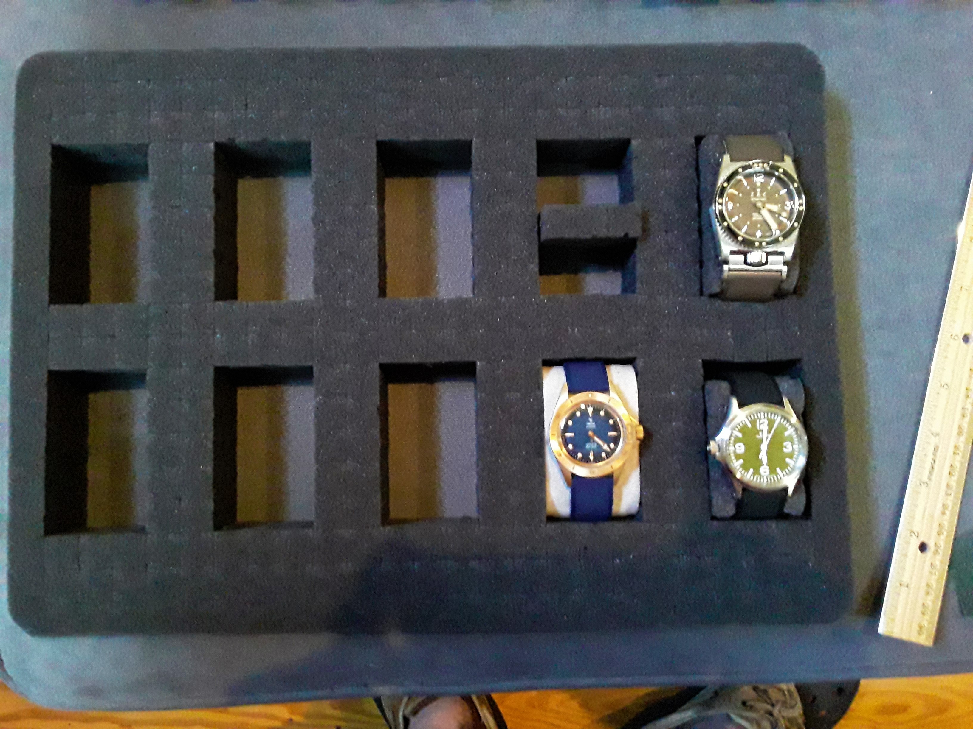

show in pic
yema 39mm in semi rigid holder
sinn 38.5mm in pluck foam where i took away a row. (see pic next to zrc)..watch seems to move around as well
zrc 40.5mm in pluck foam that i directly removed
it's pretty obv the semi rigid holder (not withstanding white color) is a much cleaner professional look
still haven't made it to lowes/home depot to buy some pipe foam insulation which i hope will look as nice as the semi holder

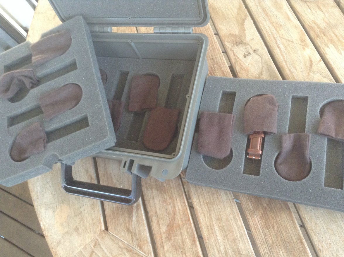

Here is mine.
Different style but a way to hold more. Softer foam also.
1,099
1,085
Here is mine.
interesting method. i like it. you can fit more that way.

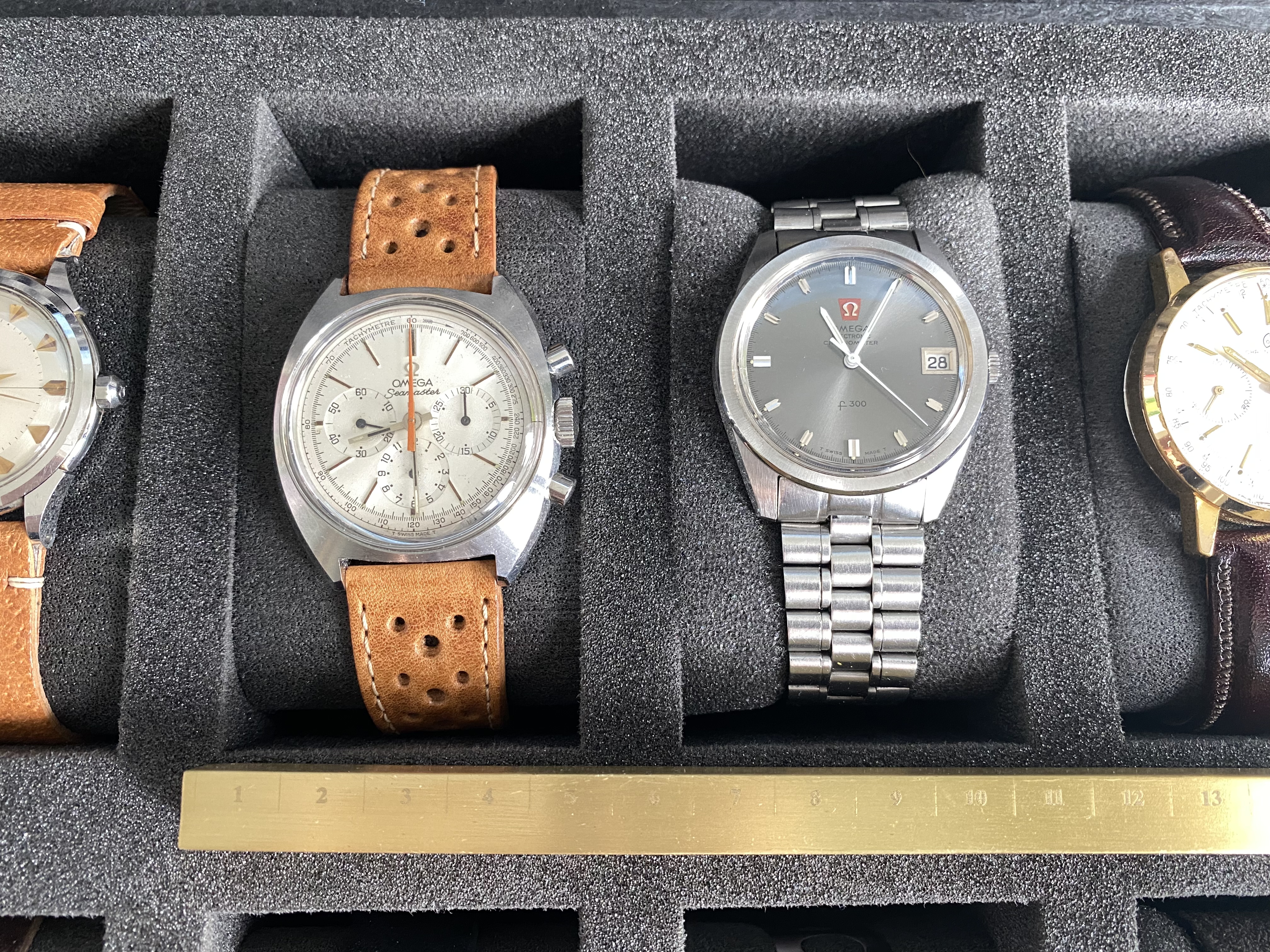

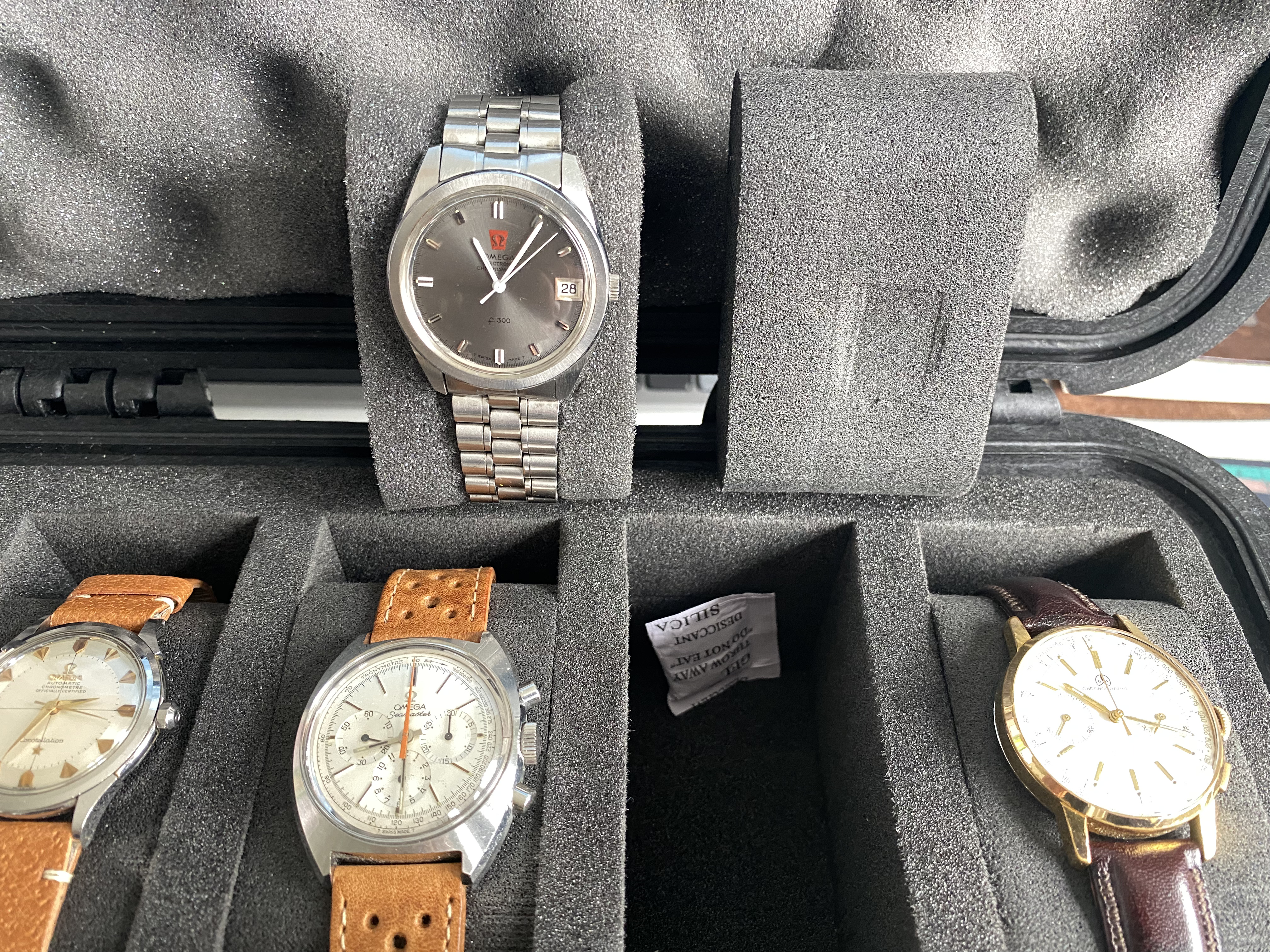

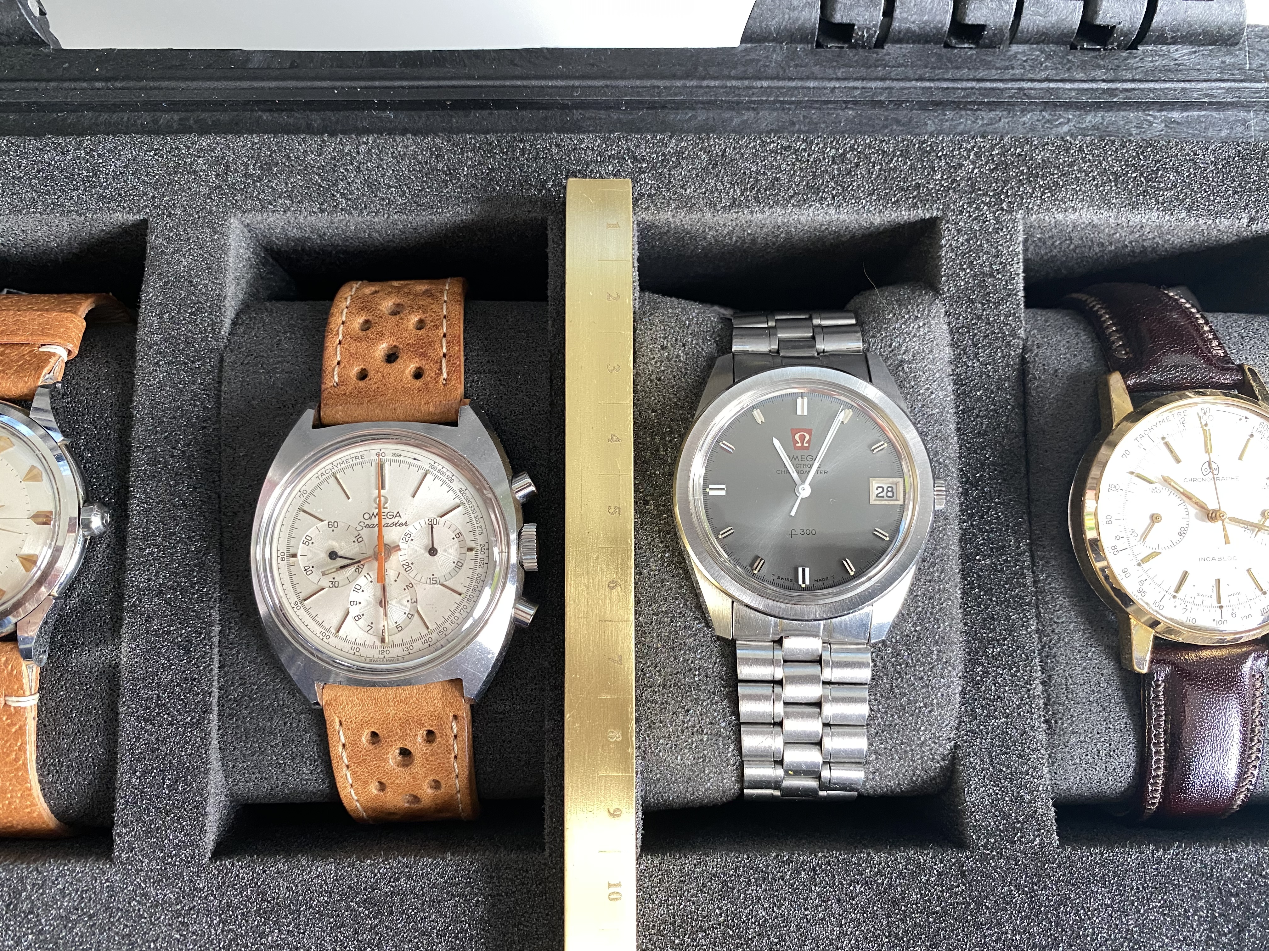

My apologies for going off radar, hectic few days. It looks like you’ve done a great job anyway but in the interests of completeness I thought I’d post up some pics of the casefarm peli case. Hole size is approx L:9cm W:4.5cm D:6cm. It comes with a hard and soft foam insert - because I have small wrists I tend to use the soft for watches with bracelets and hard for straps. Then I lay a soft cotton cloth over the top as I was worried the foam on the lid wasn’t as soft as it could be. Also plenty of silica sachets hidden in the depths.
1,099
1,085
why the frig does the usa use imperial when every other country uses metrics?
similar cavity size.
your length in inches is 3.54". mine is 3"
your width in inches is 1.77" mine is 1.75"
your depth in inches is 2.36" mine is 1.5"
the holder/pillow make all he difference in looks. using the p&p foam as a holder ruins the look
(i might try and shave/contour it and spray it with plastic dip. especially if i'm not going to use it.)
