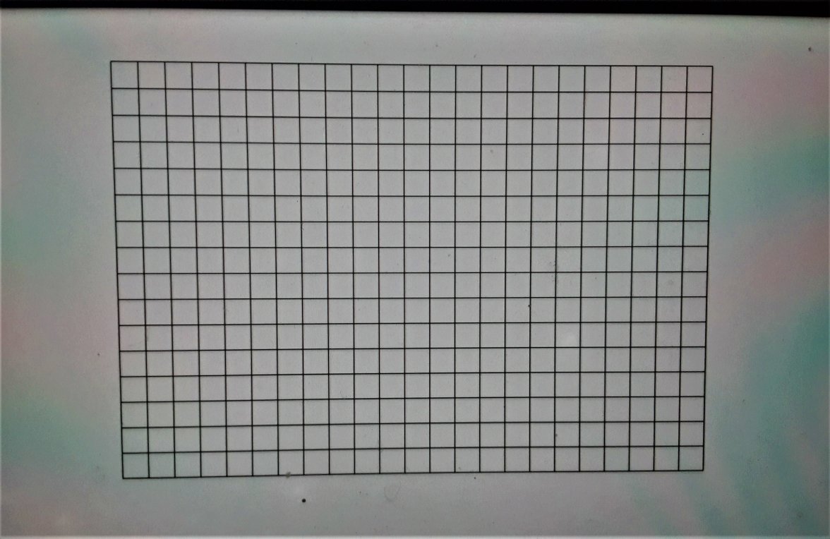

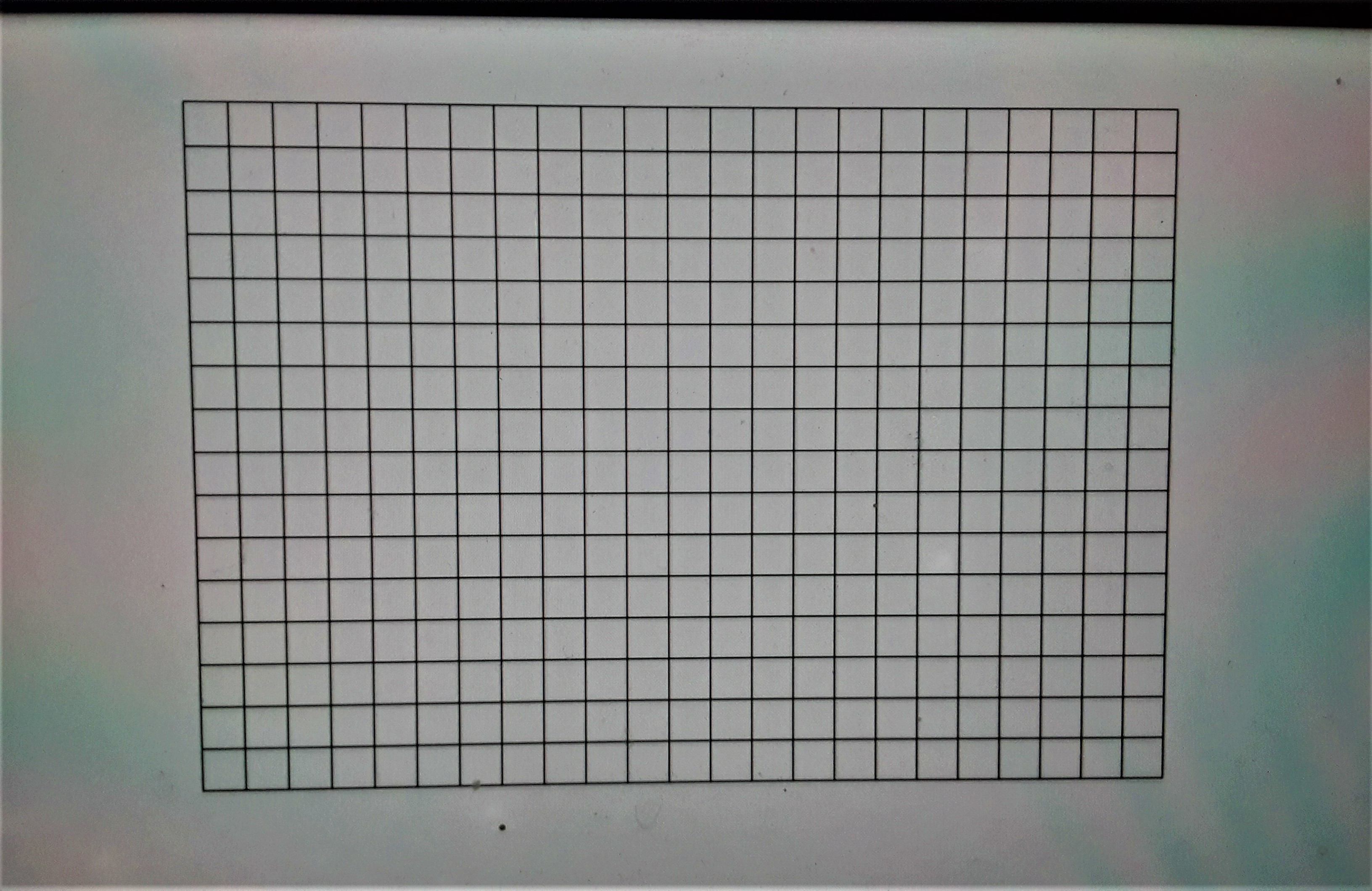

now to find a program so i can print it a grid
23 squares length
16 squares width
looks like the border is slightly bigger than 1 square around the foam
total of 368 pick/pluck squares

since the border size is practically 1 square i'm going to have to take away some size and build up the perimeter to have 2 square around the whole piece of foam
new total square size is
21Lx14W
or
294 total pick and pluck squares

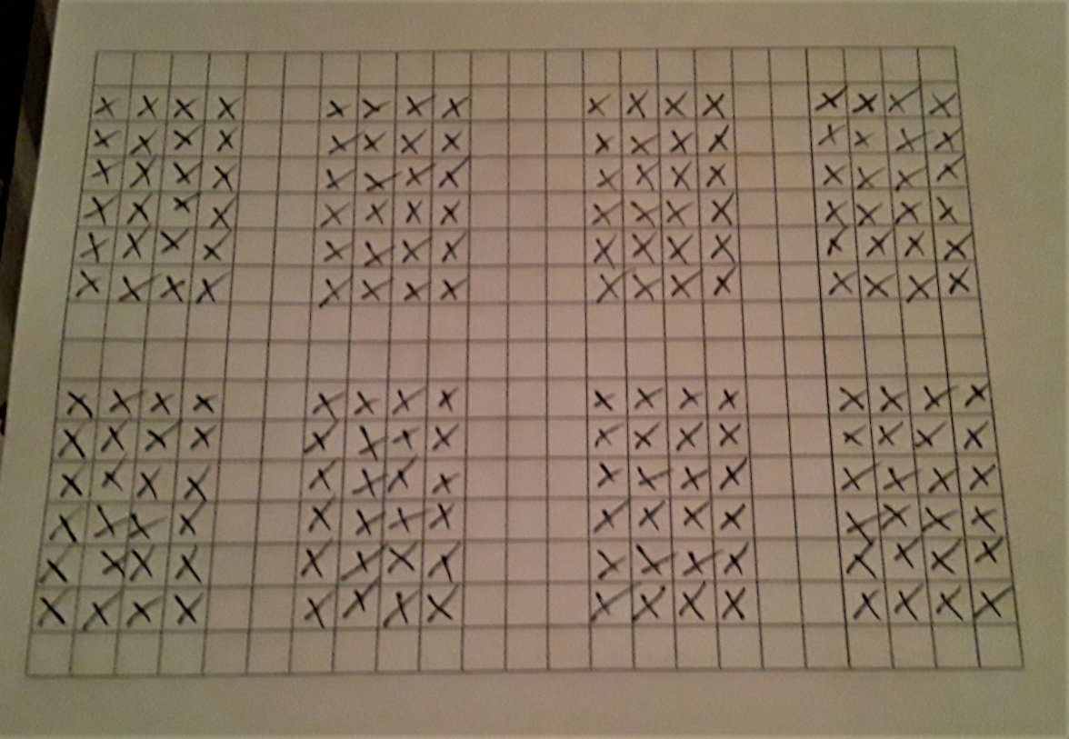

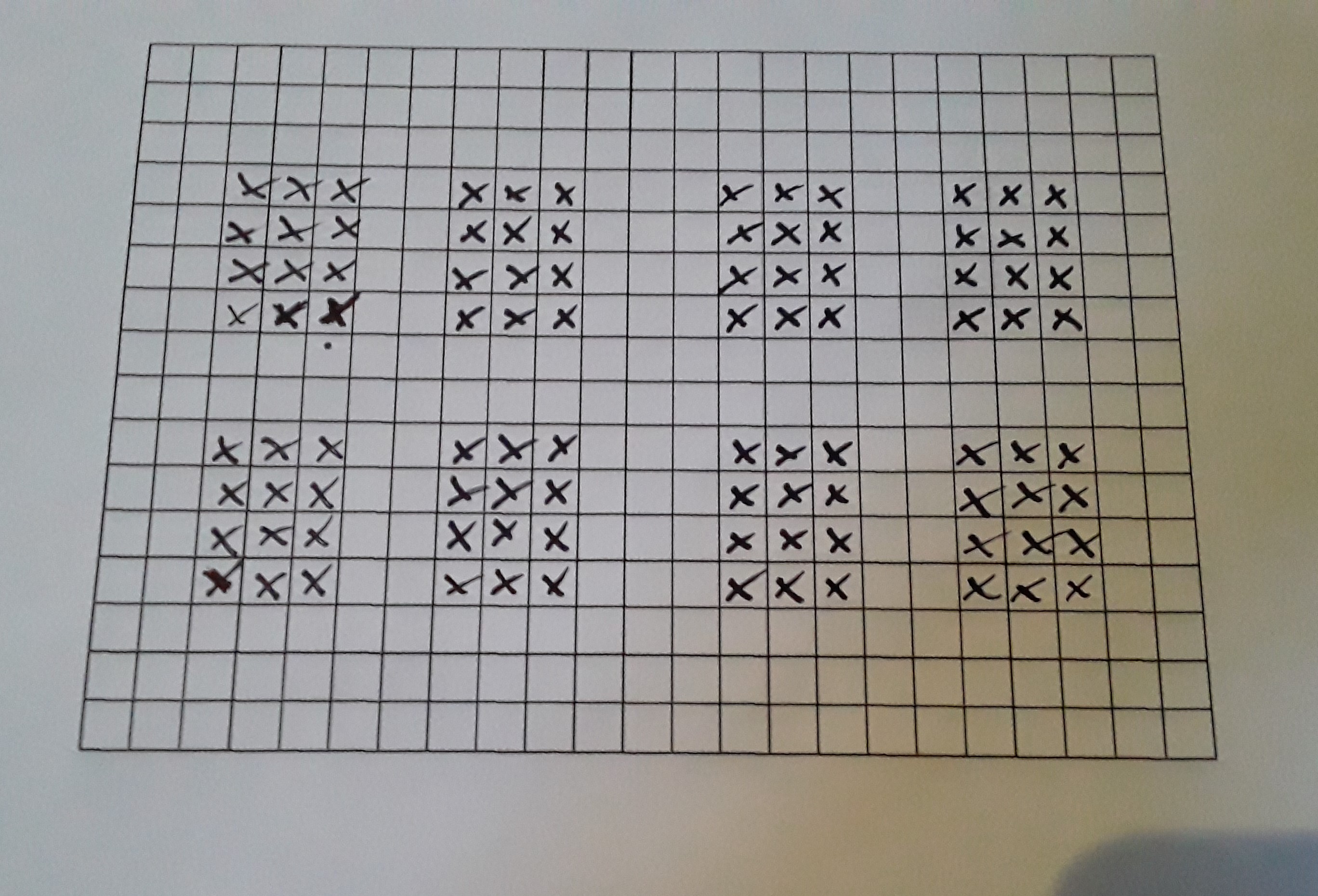

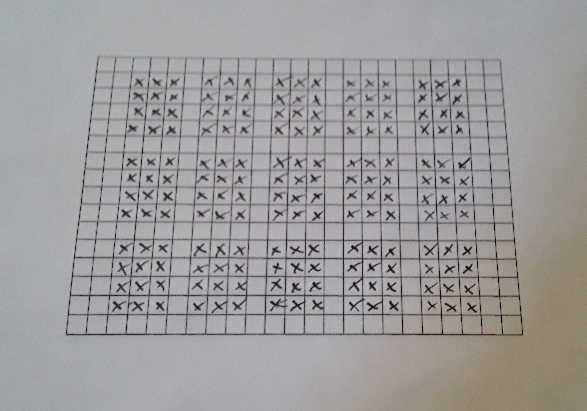

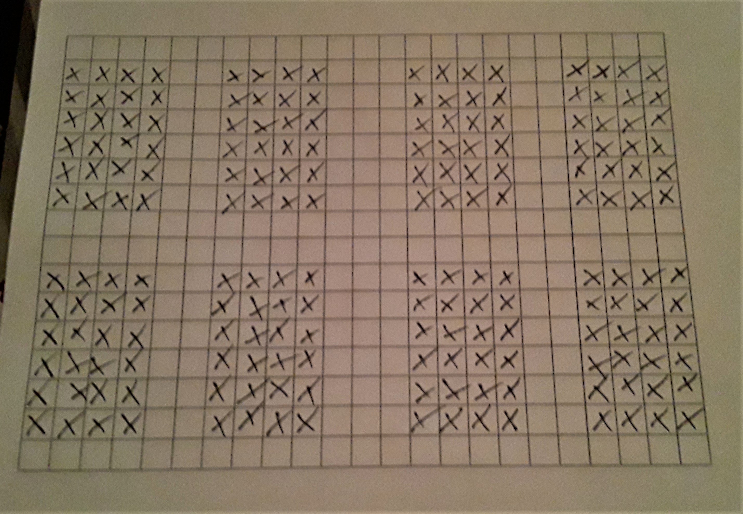

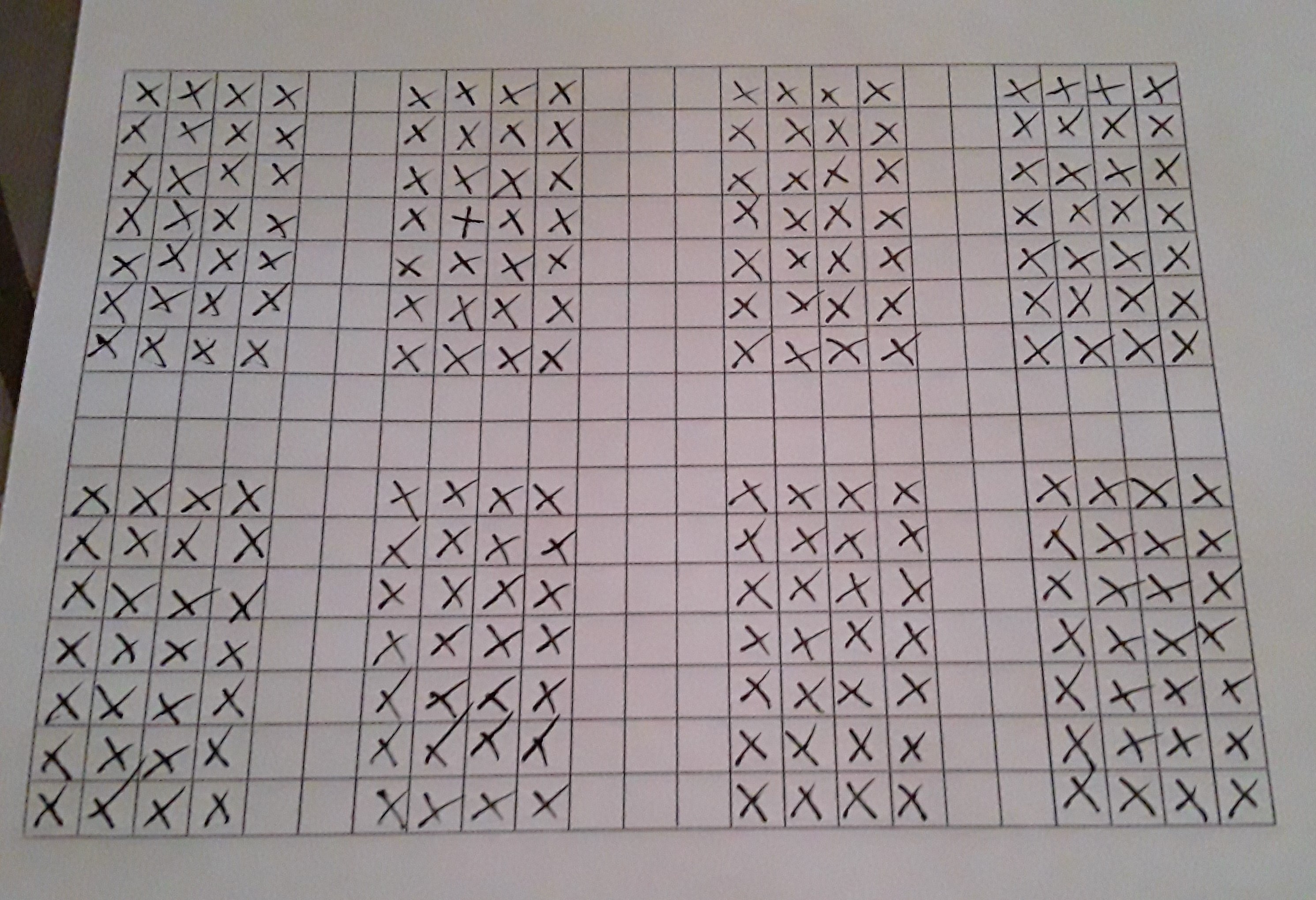

i have 2 grid patterns that can work.
one with 15 watches
one with 8 watches
the grid with 15 watches only contain 1 square in between except on the whole perimeter. the sides even get an extra square protection
the grid with 8 watches contains some dead space. it is protected by 2 squares in between and 3 squares top/bottom. not to mention 3 in the middle intersection

so my options are
the first two numbers will be he amount of squares removed for each watch
4/3 - 8 watches
4/3 - 15 watches
5/3 - 8 watches
5/3 - 10 watches
5/4 - 8 watches
6/4 - 8 watches
7/4 - 8 watches
seems like the 4 square width is universal. but i wonder if going to 3 might be better because the watch will be wrapped around this foam which isn't that strong and is quite malleable. unlike the hard watch type holder/pillow from many watch boxes
the 3 square option will likely keep the watch sitting high in the hole and not as deep as well. i don't know which option will be the best
one thing i didn't consider is if each pick and pluck square is a universal size?. if it isn't things are gonna get really hairy for me.
