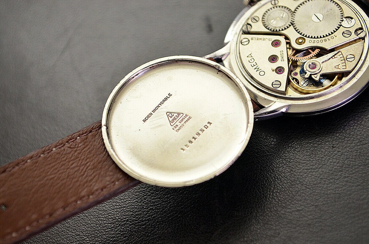

Anyone know what ref this vintage Omega , cal 30T2 has ?
666
485
This is an oversized 37mm without crown Omega
Cal 30T2.

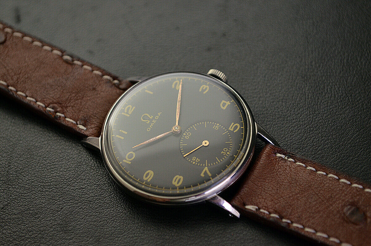

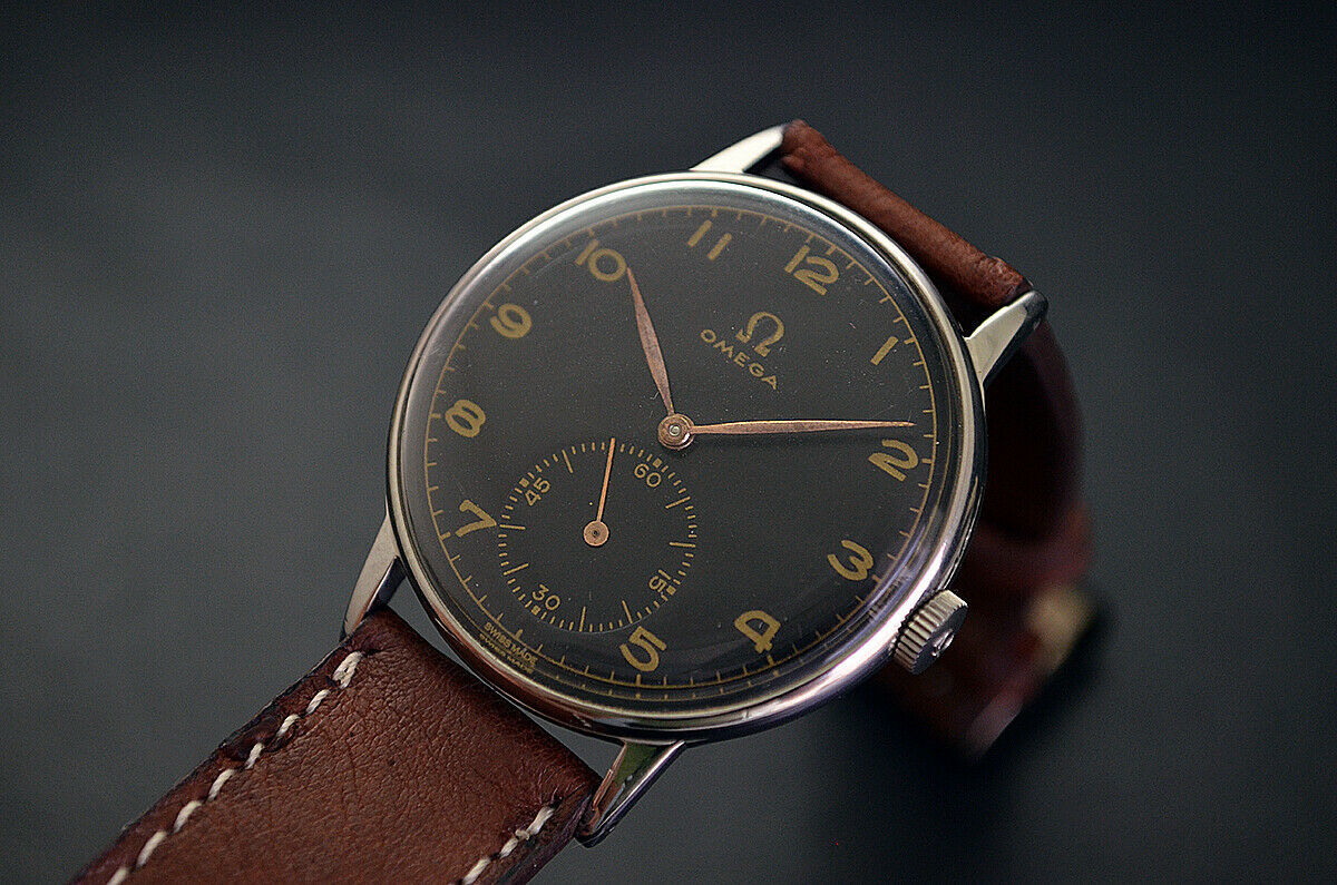

Anyone know the ref on this model. And is this dial renovated, there are no rings on dial inside the subsec area I guess it’s not legit ?
149
239
The case might be a ck2325. But some more experienced collectors should help us with the identification. Overall the dial is suspicious but the photos are not good enough quality. Maybe there are circles under the subseconds that are not visible on the photo because of this. But also the lettering seems to be a bit off (i cant describe it better).

Doesn't appear to have a standard reference number, which is not uncommon for that time period. IMO, the dial has been repainted.

IMO the dial is repainted. I have owned several watches from this period without "swiss made" being inscribed on them.

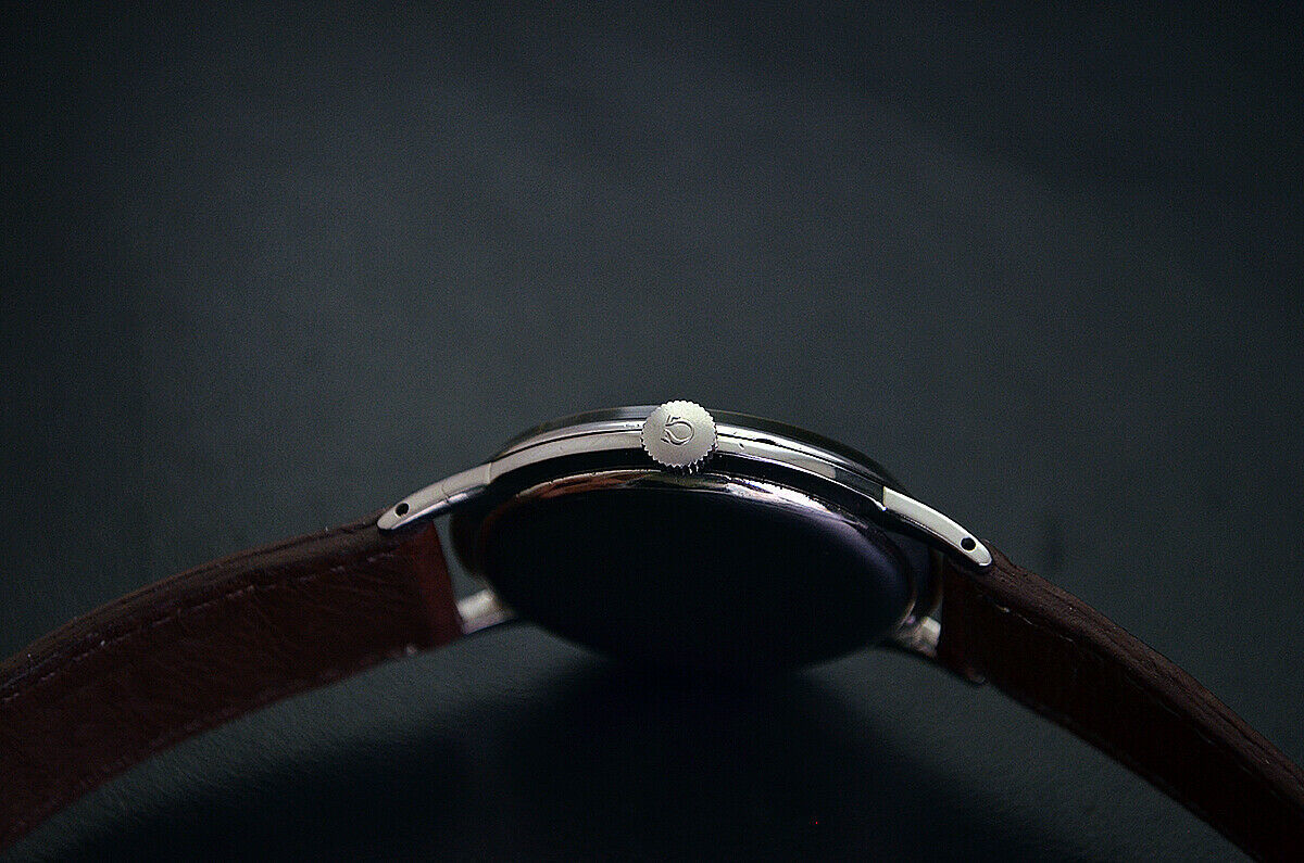

the rhodium-plated caliber is classic from before 1945, which poses a problem with the crown, which should not be signed.
my advice is to stay away from this watch.
