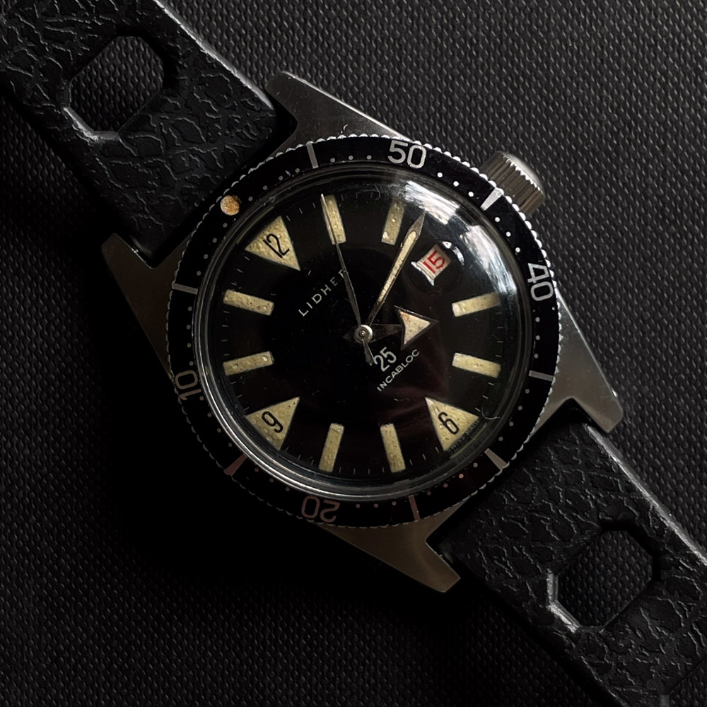

This seems to be a reasonable assumption when discussing the skin diver with the generic 36 or 38mm case, but yes, when you get into proprietary or more special case construction you're 100% correct. Although, this LIDHER with what looks like a generic case has a really interesting round cyclops. It also has a DODANE/Tramelan 2000 case.
img_3012-jpg.1420657
I have a watch landing today that is the latter. I don't know if the crystal is OG or not, but I hope that I never have to replace it because needle in a haystack.
