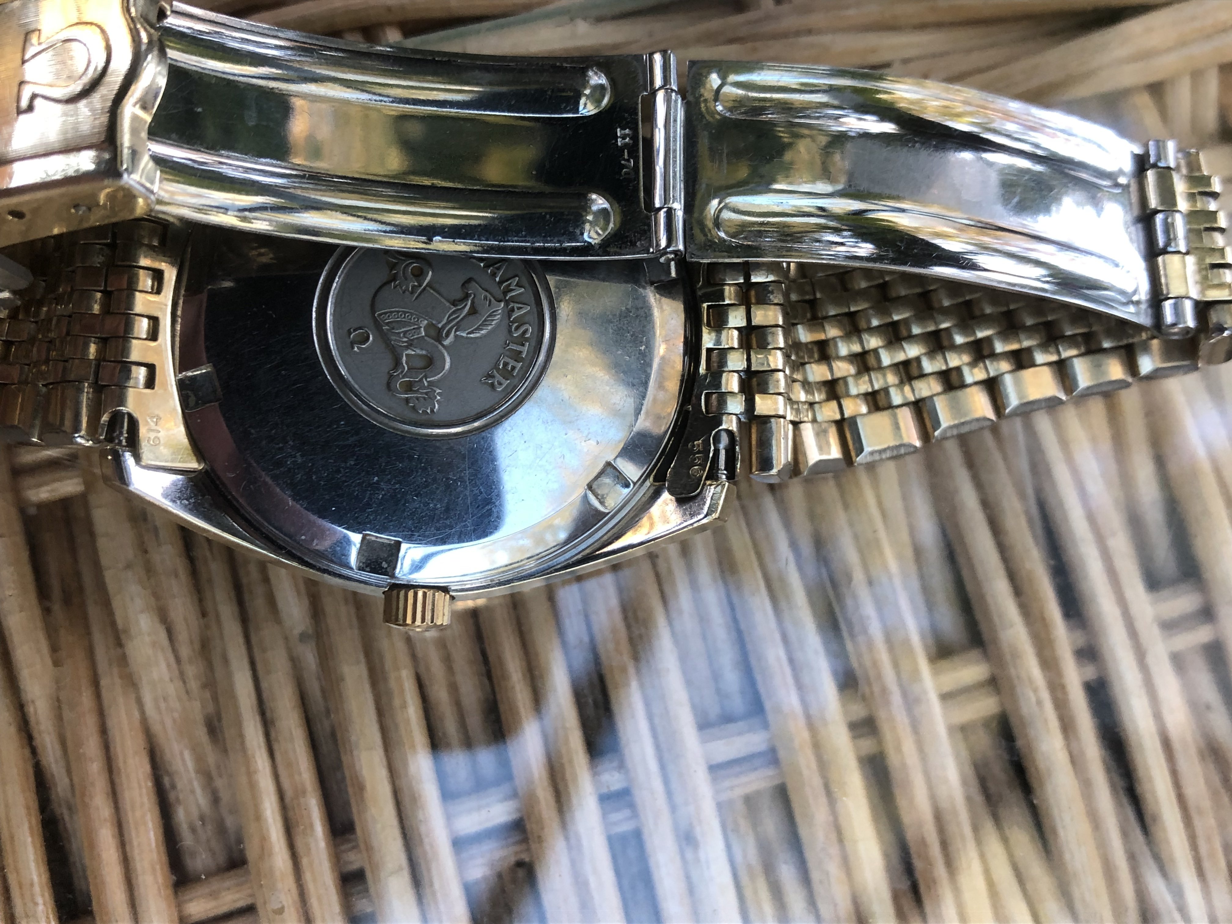

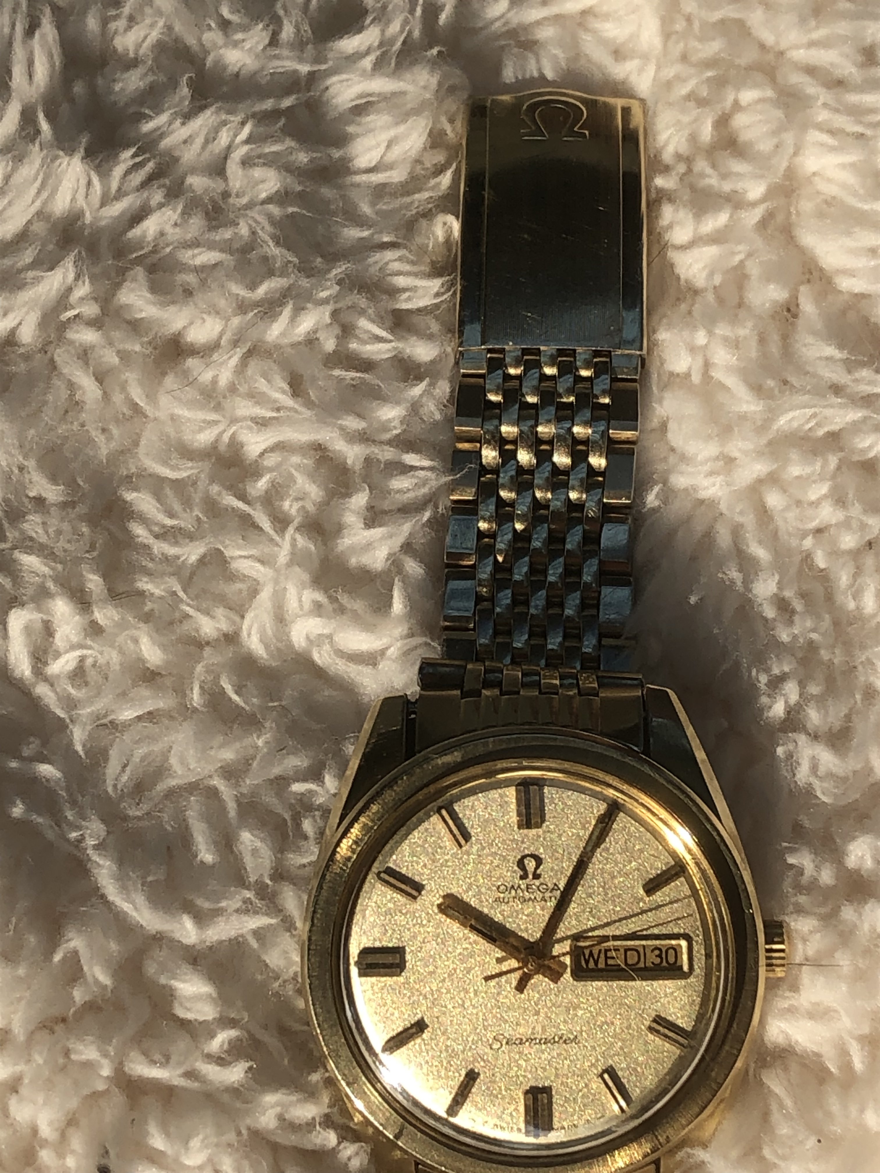

Anyone able to advise on this Seamaster bracelet strap please
42
42
Contacted my watchmaker who is kindly going to provide latest service ticket and take watch-back off so I can photo mechanism/casing for insurance/provenance
Meanwhile, could any ‘expert’ please advise or point me to source to fully ID/name the braclet strap? Has code 614/556 on lugs.

Missmatched endlinks. One is 614, the other is 556, they should be the same.
The 556 is suppose to be on a 1068 bracelet. The 614 endlink is matched to a 1037 bracelet, which yours looks like it is, despite not being marked on the bracelet. As @ConElPueblo points out, both endlinks are incorrect on this reference. If you could give me a more exact reference I would be able to see if I have it logged on my table.
If I were to hazard a guess, the 19mm endlinks which match a 1037 bracelet could be 555 or 620. I would think 555 though based on the shape of the lugs.

The bracelet is an original Omega bracelet, but not one well suited for your watch; the end links are only 18mm wide where they should be 19mm. It is probably the same reference as this: https://omegaforums.net/threads/ome...racelet-with-620-end-links-gold-plated.64866/ (bar the end links, naturally).
Your Seamaster is a good 6-9 years earlier than 1976, btw.

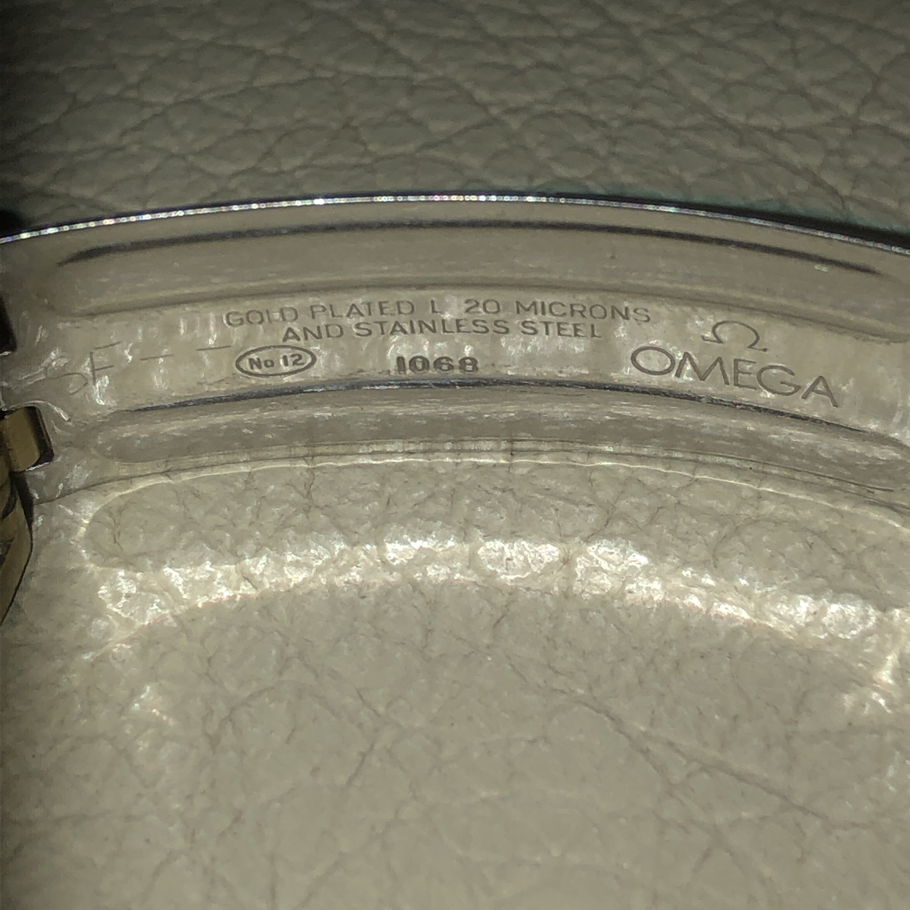

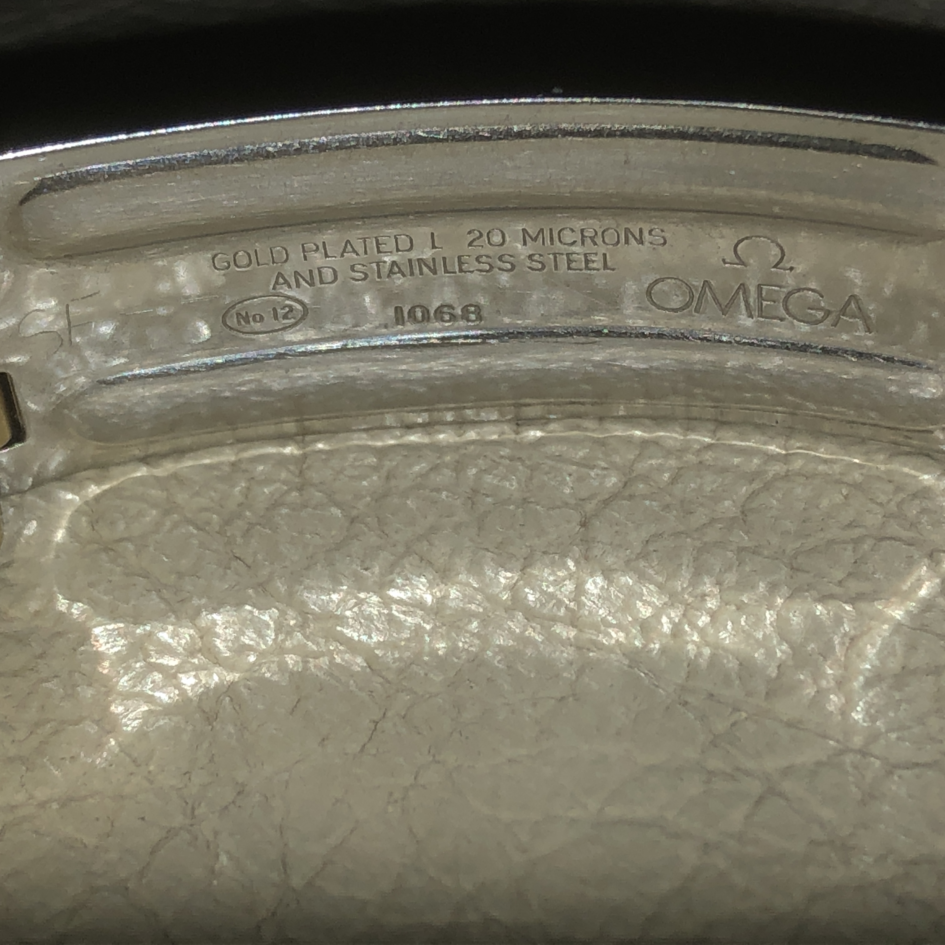

Thanks for replying and info, now you say, the 614 end link does seem to fit the lug profile more exactly, the 556 seems more sunken, though the bracelet is denoted 1086 (see poorly lit photo), is that the ‘exact reference’ you refer to (apologies, newbie!).
TIA
I think that says 1068, not 1086. Regardless of the profile, the end-link is too narrow for the lugs, so you will need 19mm end-links for your bracelet.

Quite correct thanks, 1068 indeed!
