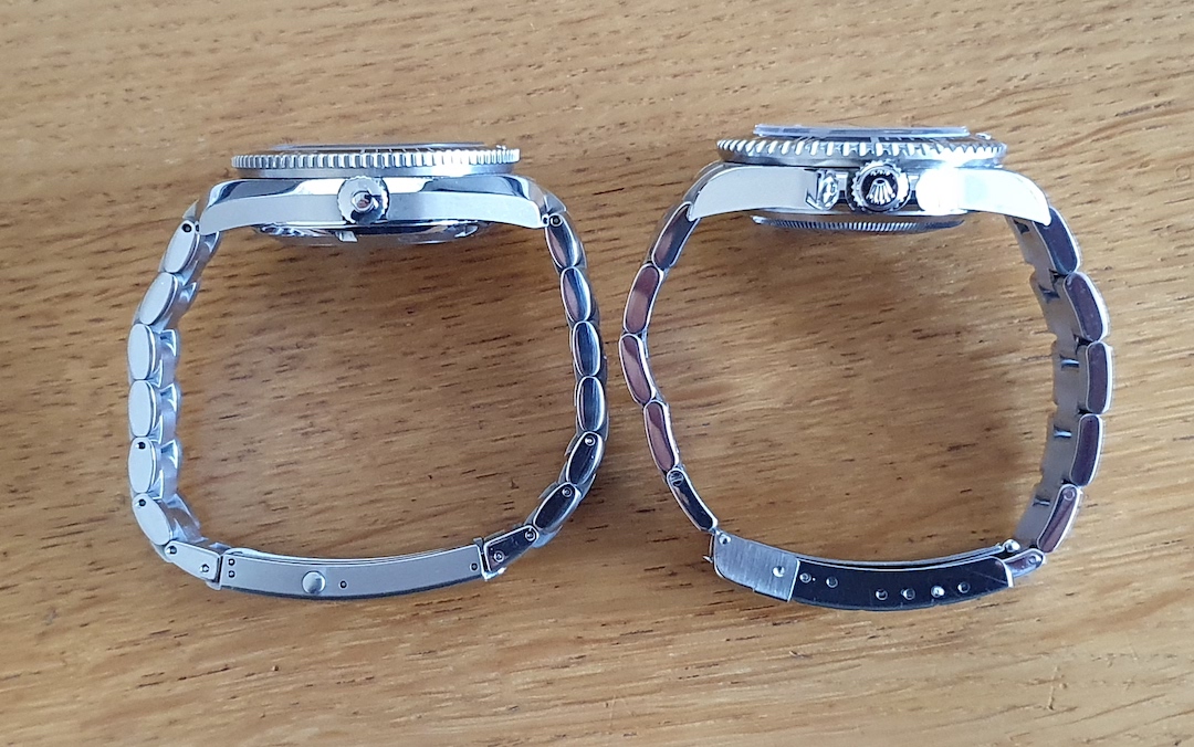

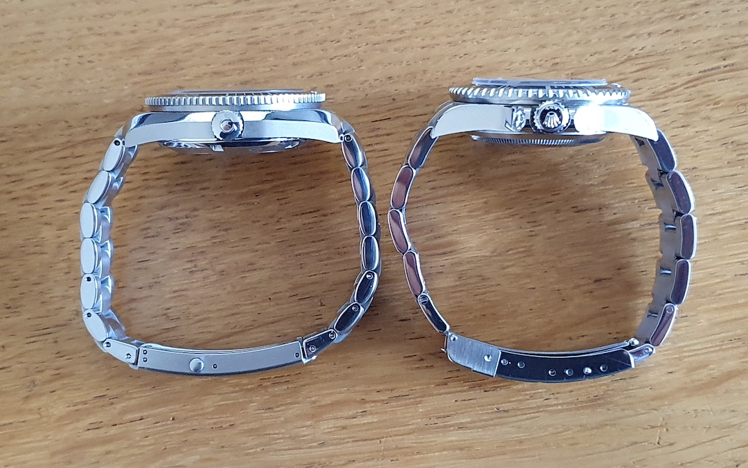

I know the argument is on water resistance and depth however from memory the older Planet Ocean watches were still 600m water resistant and were thiner 14mm?
And the classic Sea Dweller is about the same thickness as the PO2500 with twice the WR...
Guys, the problem here is the modern movements' thickness. The 2500 is 3.6mm tall.
To survive the higher pressure you basically need a thicker caseback and a thicker crystal. These are the largest surfaces on which the high pressure can produce deformation. The mid-case of the SeaDweller only got thicker to accommodate the He Valve.
Not sure where you get this information from, but it is incorrect. The 2500 movements are 4.1 mm tall.
People have this odd idea that the newer Omega movements are unusually thick, and they simply are not.
The 8800 is 4.6 mm tall, and the 8900 is 5.5.
In contrast the Rolex 3135 is 6.0 mm tall.
The movements are not the issue, as I've said many times. It's the cases, and in particular the addition of the transparent case back.
