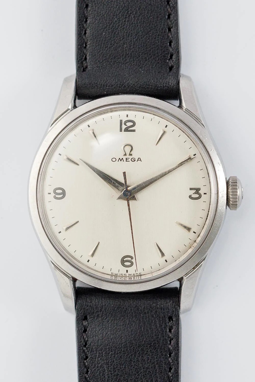

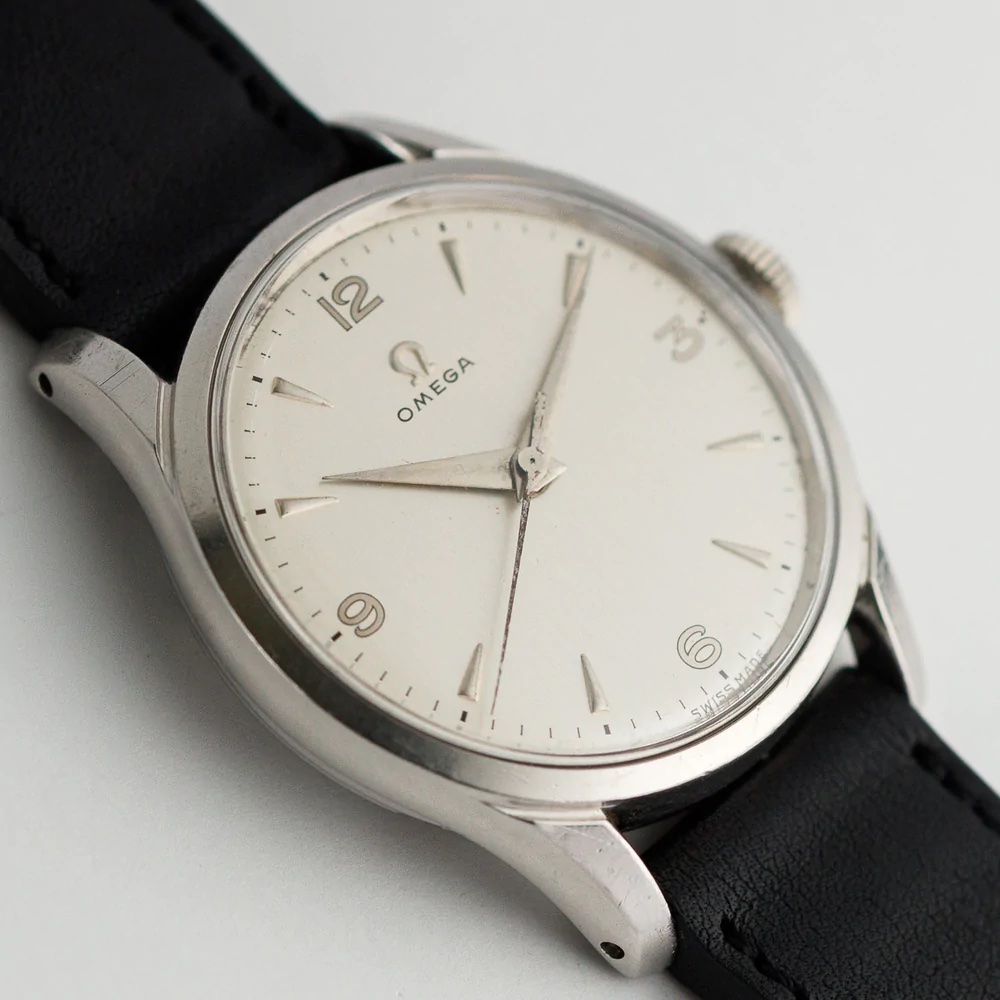

Hi Omega Forums Members,

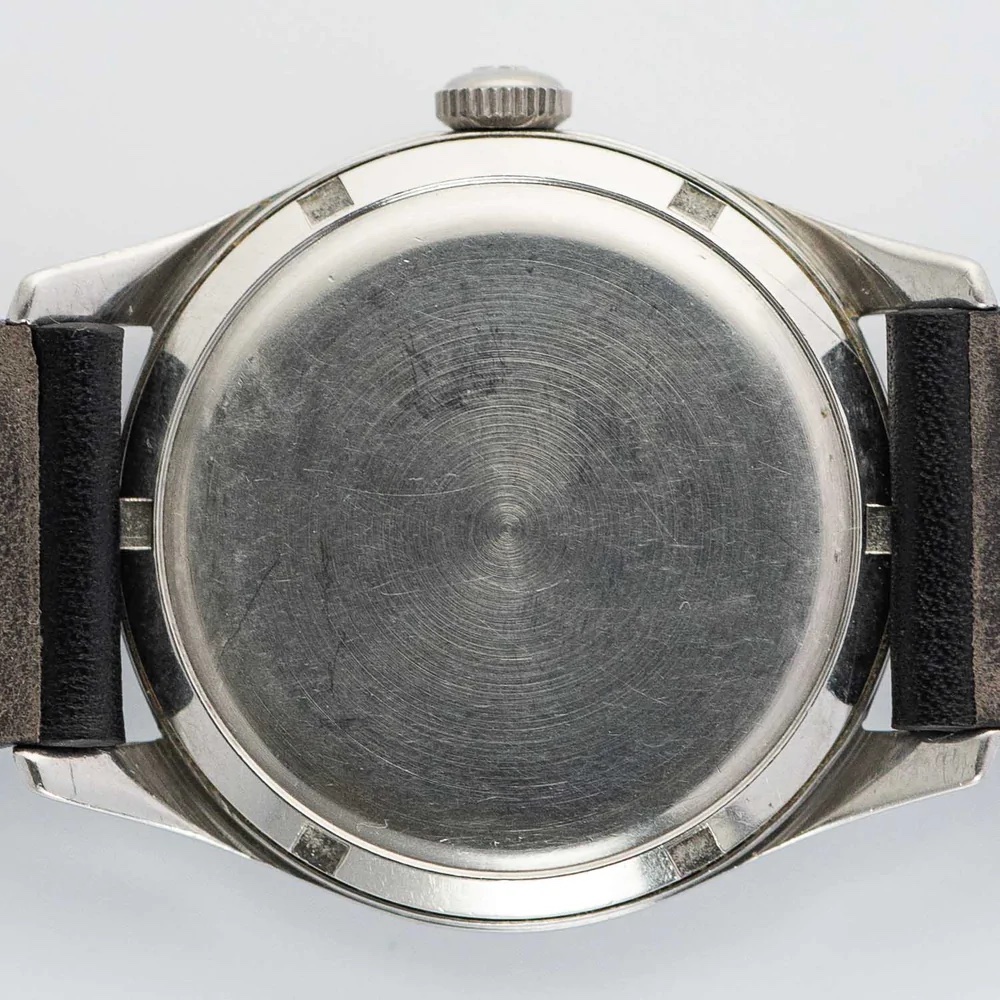

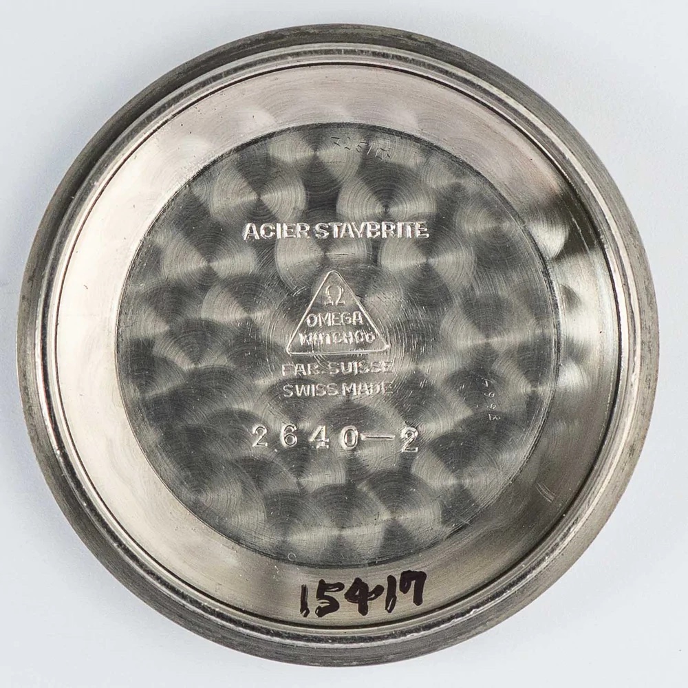

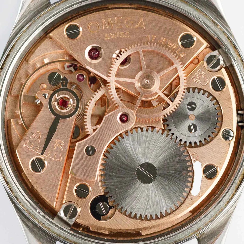

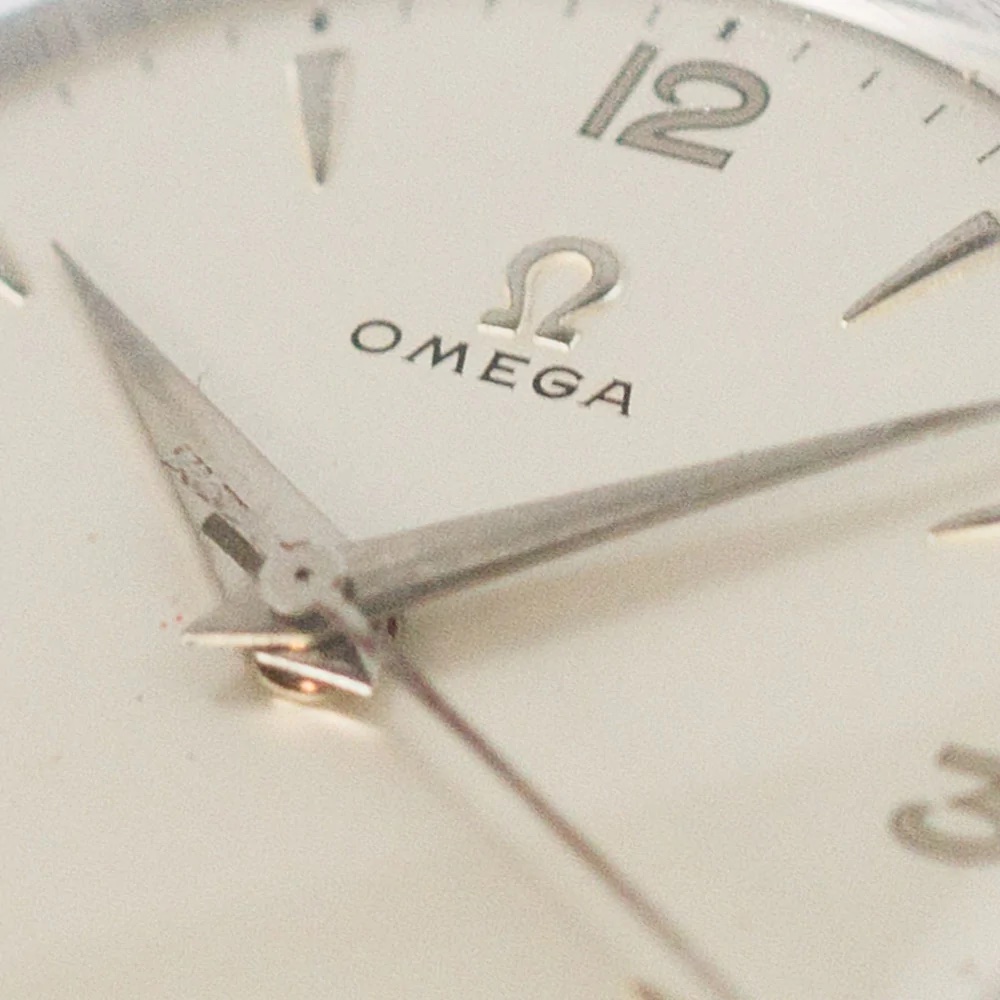

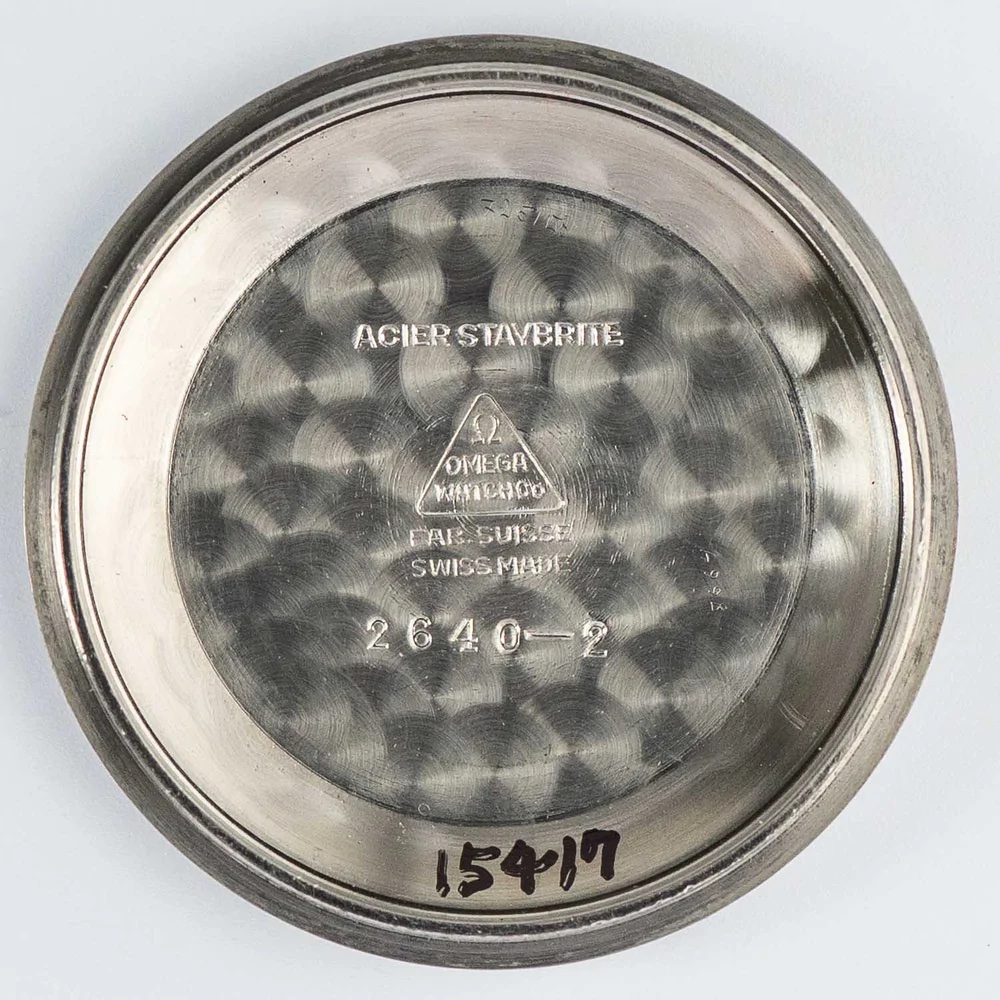

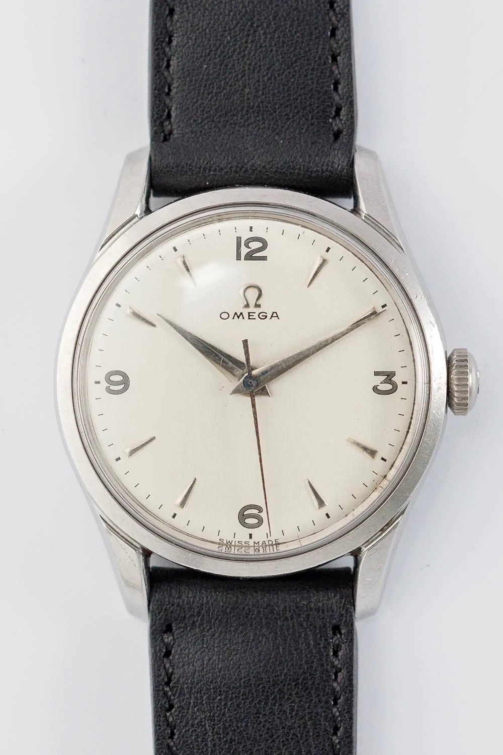

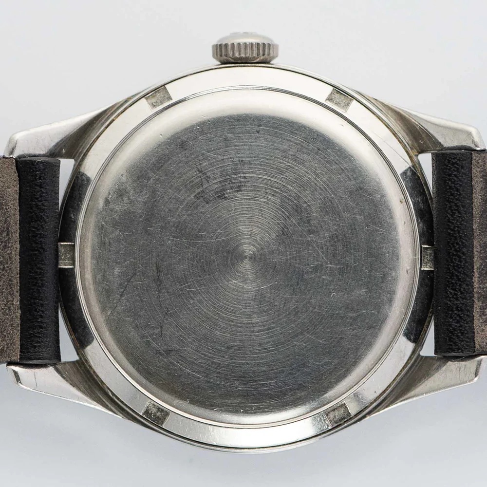

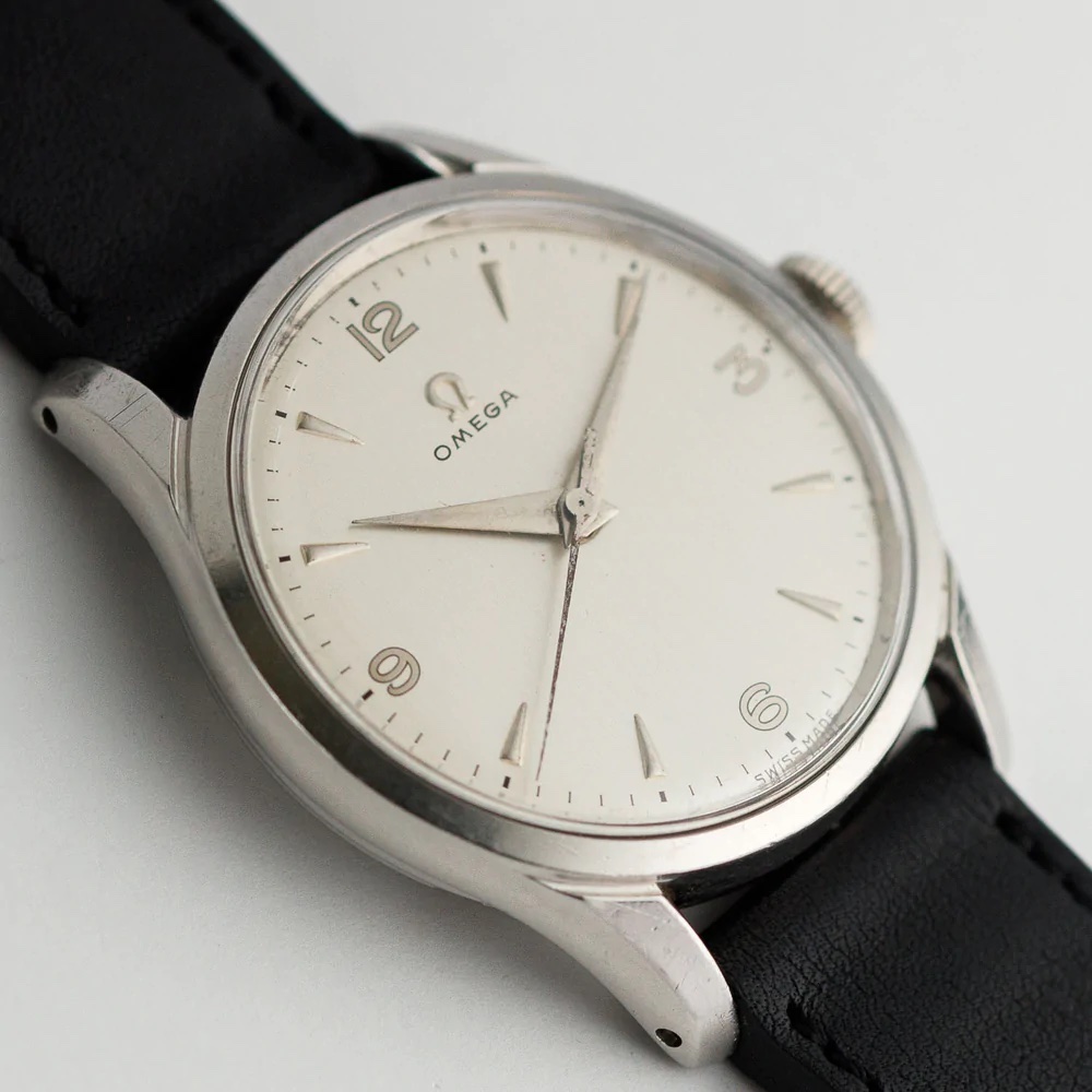

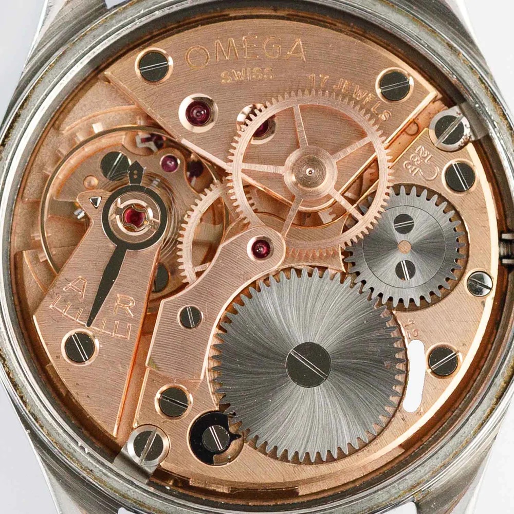

I'm a novice collector. Can the experts of the forum let me know if they see any red flags for this potential purchase? It's a ref 2640 with a 283 caliber and SS screw-in casebook, which seems to be the correct combo per the Omega DB. Seller states watch has been serviced and comes with a 1 yr warranty.

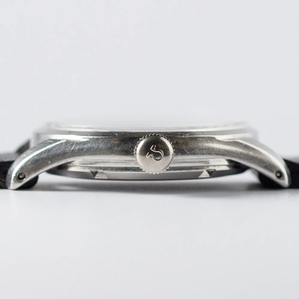

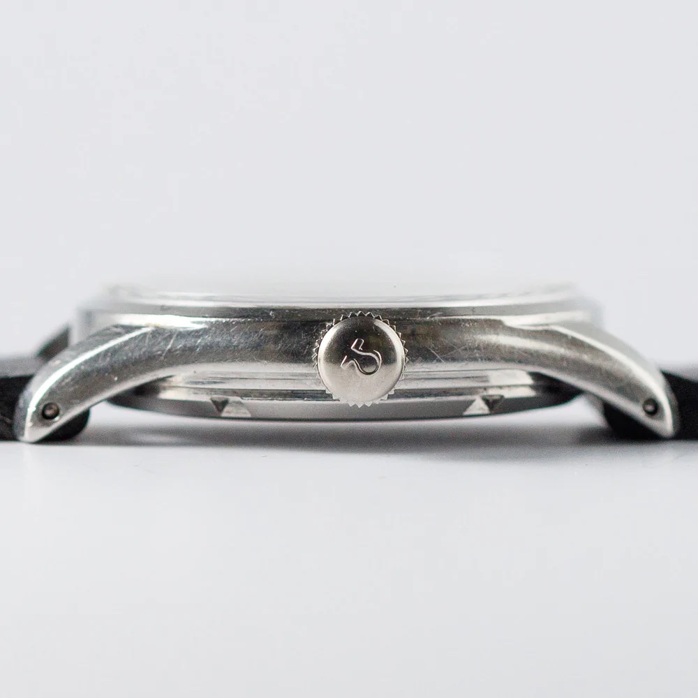

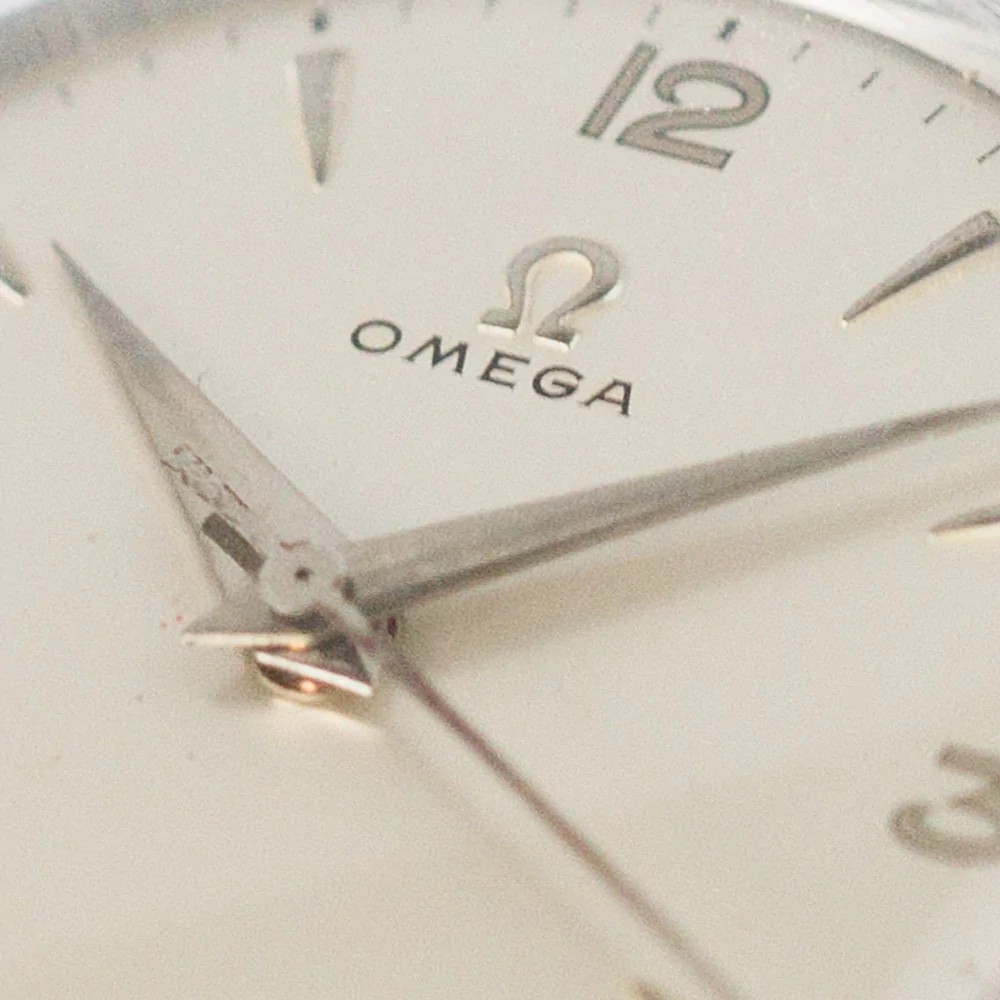

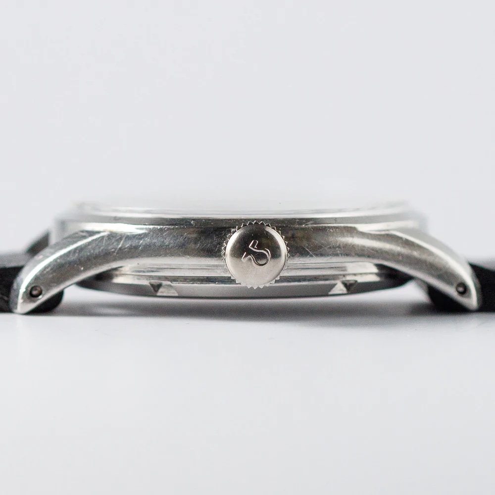

Here's my simple take. Case looks pretty good with minimal polishing. Signed crown could be original based on photos of similar period ref watches that I've seen from reputable sellers. The movement looks pretty clean. Dial does not appear to be retouched. Sweep second hand finish has deteriorated though.
What do you think? Am I missing any condition issues?

It looks like an honest watch to me. The lugs have been polished. Top right lug slightly more than the others but nothing crazy. Let's see what the experts have to say.

Top right lug more polished ? What gives it away ?

Sweep hand can be replaced. OEM or generic

Nice clean watch, a great starter. You're not likely to notice the second hand with it on your wrist.
As noted comes down to price, recent service and warranty are a plus.
