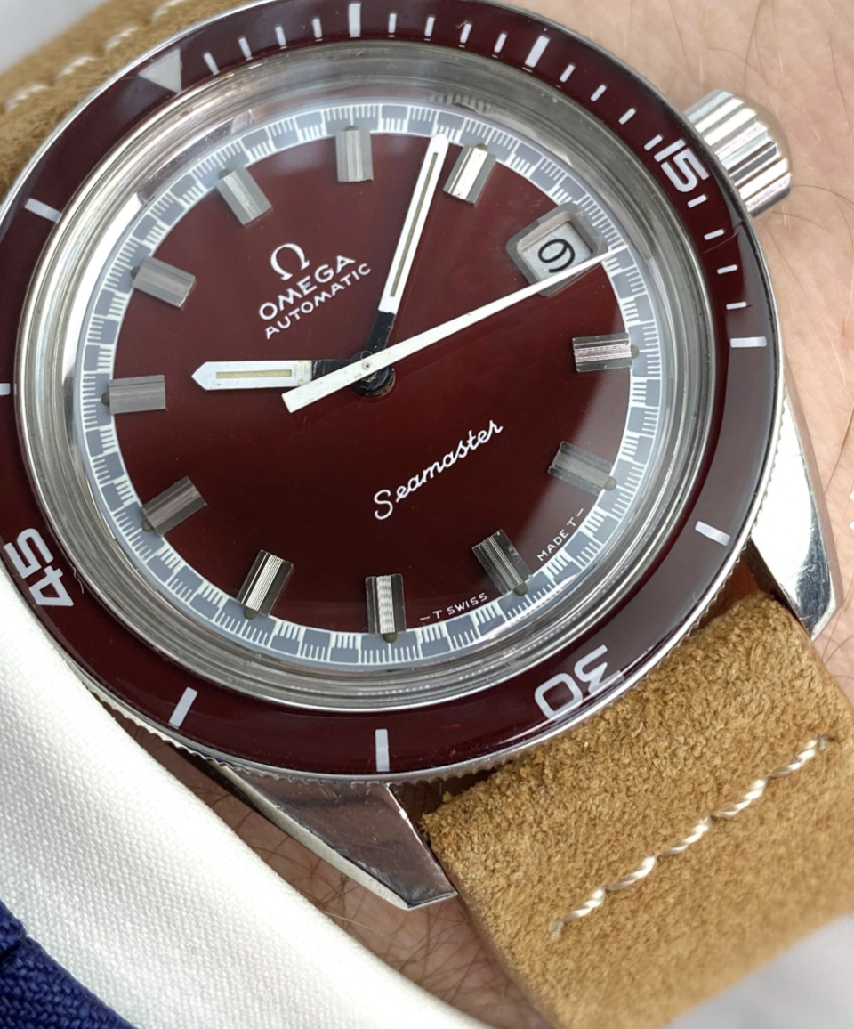

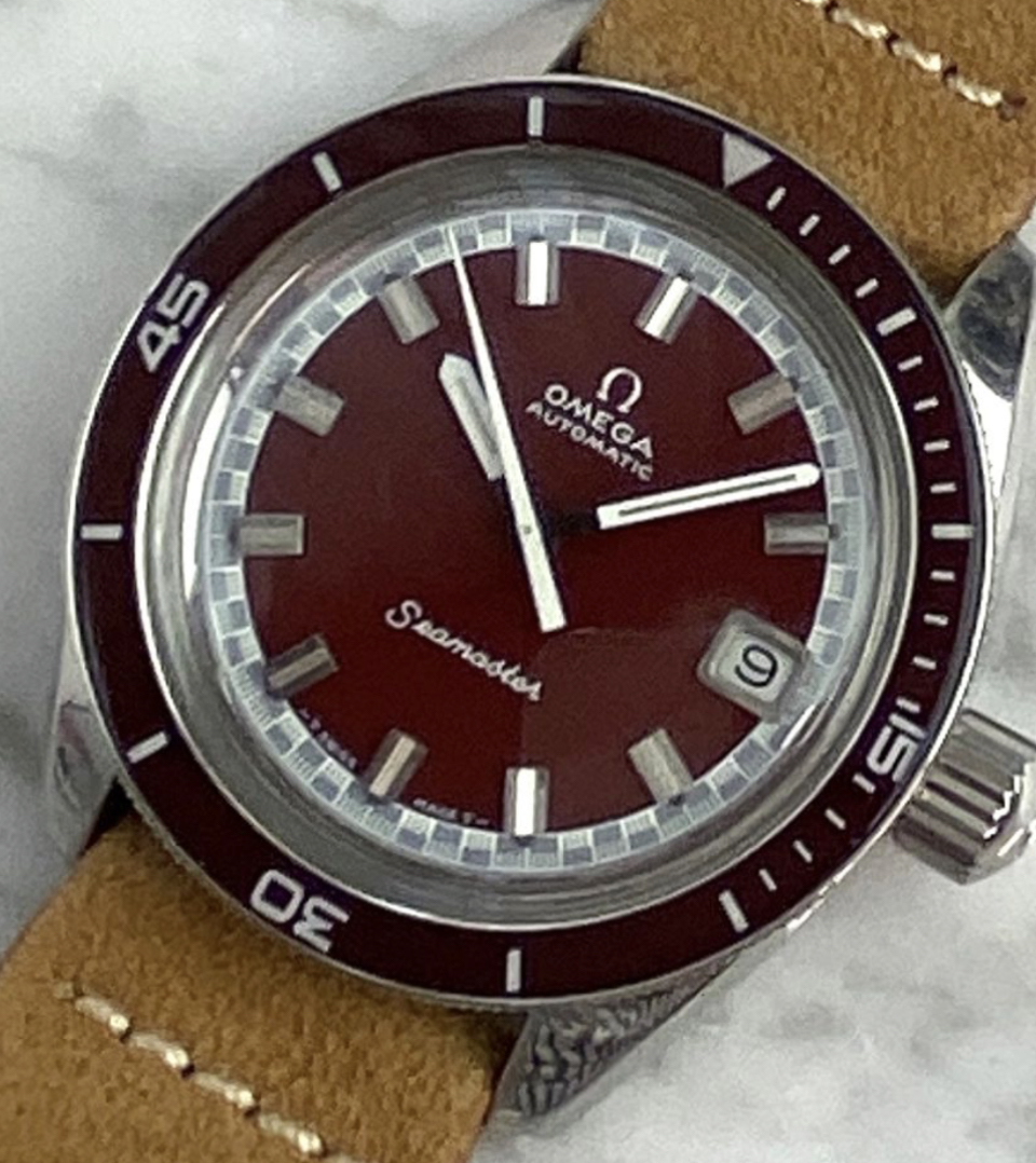

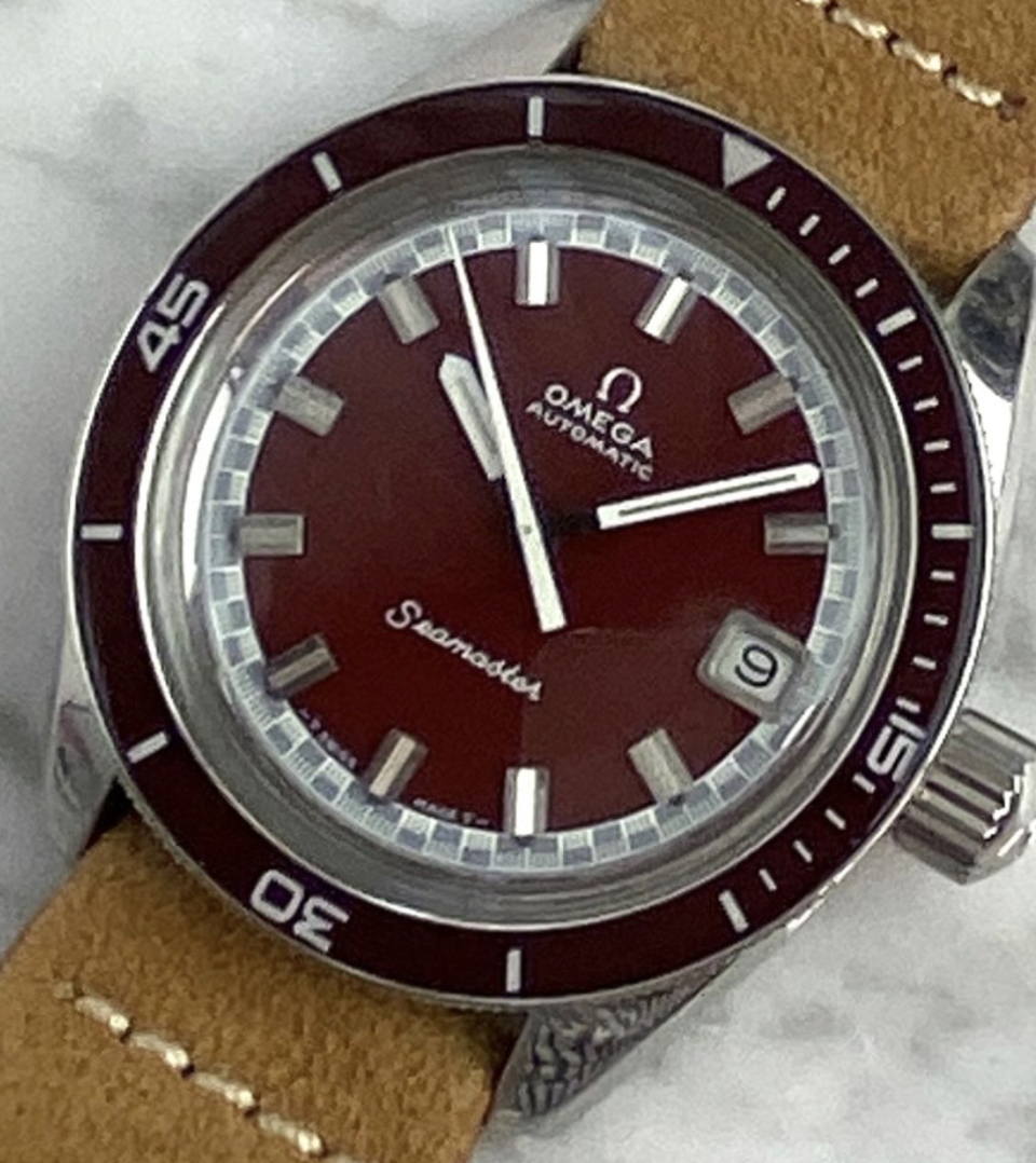

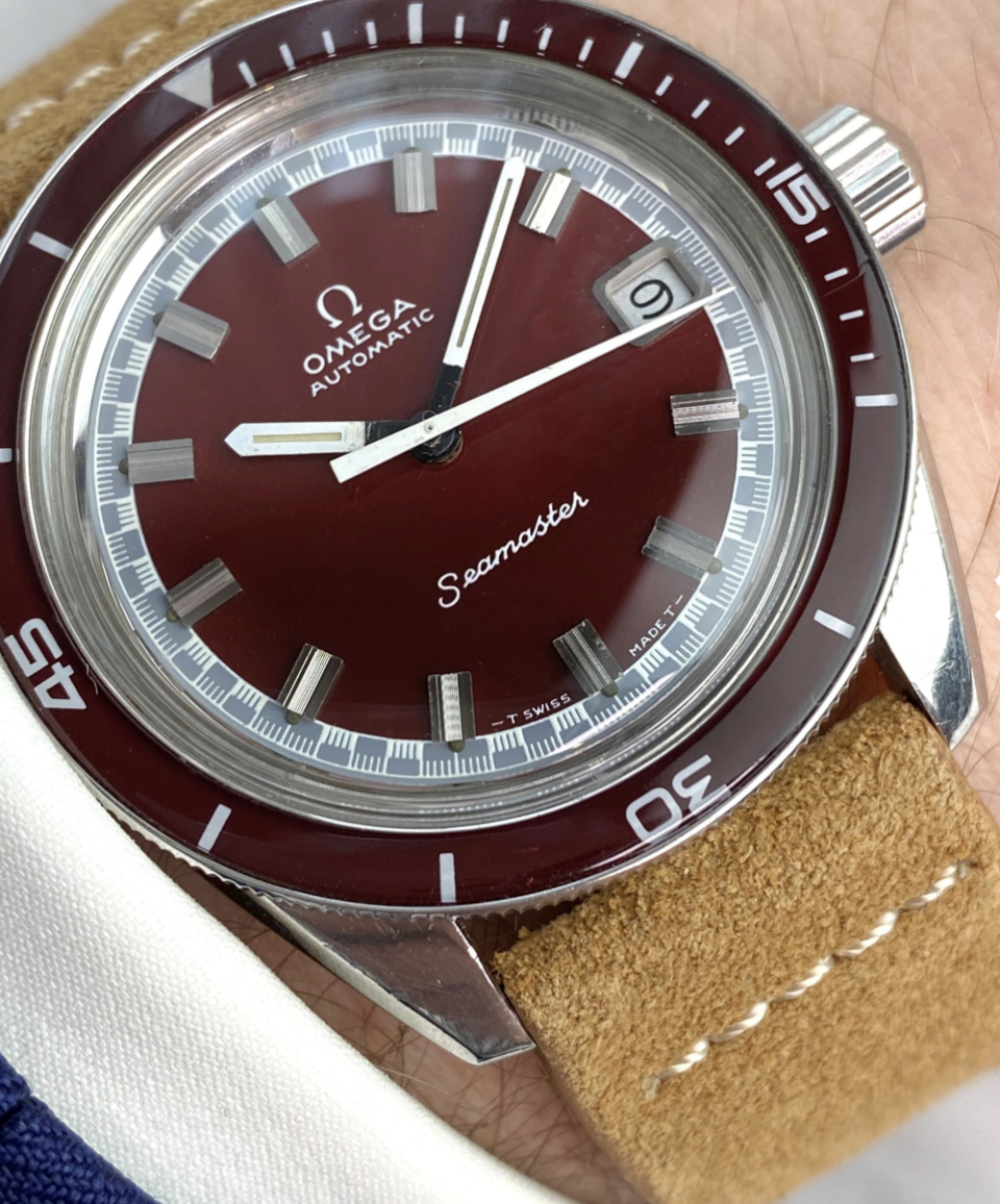

Great points about the pics. Please find attached . Thank you so much for the feedback and advice!!. Yes Maximillian does spin a good yarn … a pattern is emerging and the watch seems too clean for its age. If anyone knows of any other examples worth looking at, I would be very grateful if you let me know.

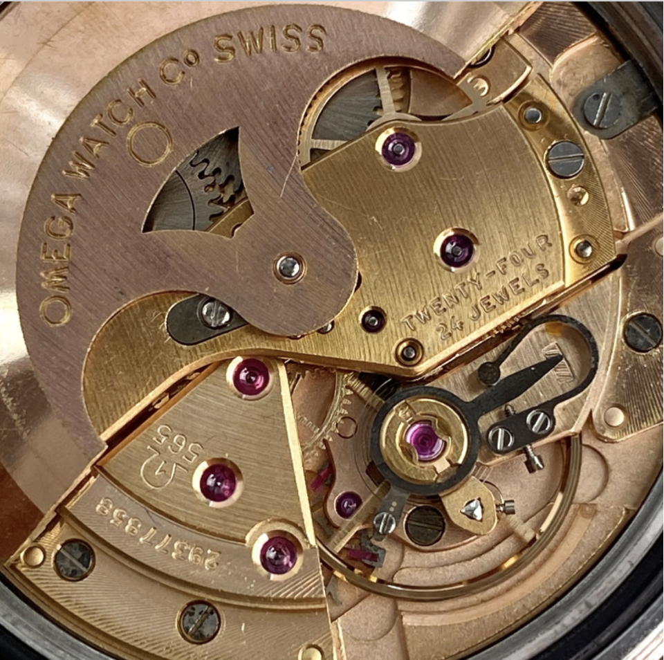

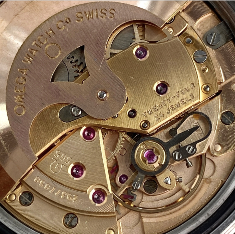

Service rotor and parts from multiple movements? Asking the experts.
what leads me to say is that the colours are all mismatched.
24,836
55,256
Service rotor apparently, but not such a big deal in a watch like this IMO. I would just never even consider doing business with this seller.

Sorry, you're absolutely right about the service rotor, and for some people that would be a big deal. It's just my feeling that it's not uncommon to replace a rotor during service to repair the watch, and on a watch like this, the visible cosmetic parts are much more important.

The hands are also wrong. The minute/hour hand seem to be from a Dynamic. These had white batton hands and silver second hands.

Personally for me a service rotor is still an omega one. For it to be replaced means the original had it at one point so best to be replaced with original parts.
the line markings on the bridge plates all need to sort of line up or that doesn’t matter too much? I know if the plated colours are all different then it’s had parts from a few different ones.
Can't beIieve I missed the hands when I quickly looked at the photos yesterday... The seconds hand is also obviously wrong. Sorry @PMcI

At first glance it looks like a nice example.
At second glance, well… as said the hands are wrong. The case has been polished. The movement has been reassembled from parts. The watch used to have a steel bracelet which is missing.
What puzzles me most is that the dial and bezel look so new compared to the rest of the parts. There is something not right here. And for that kind of money you would want it to be straight.

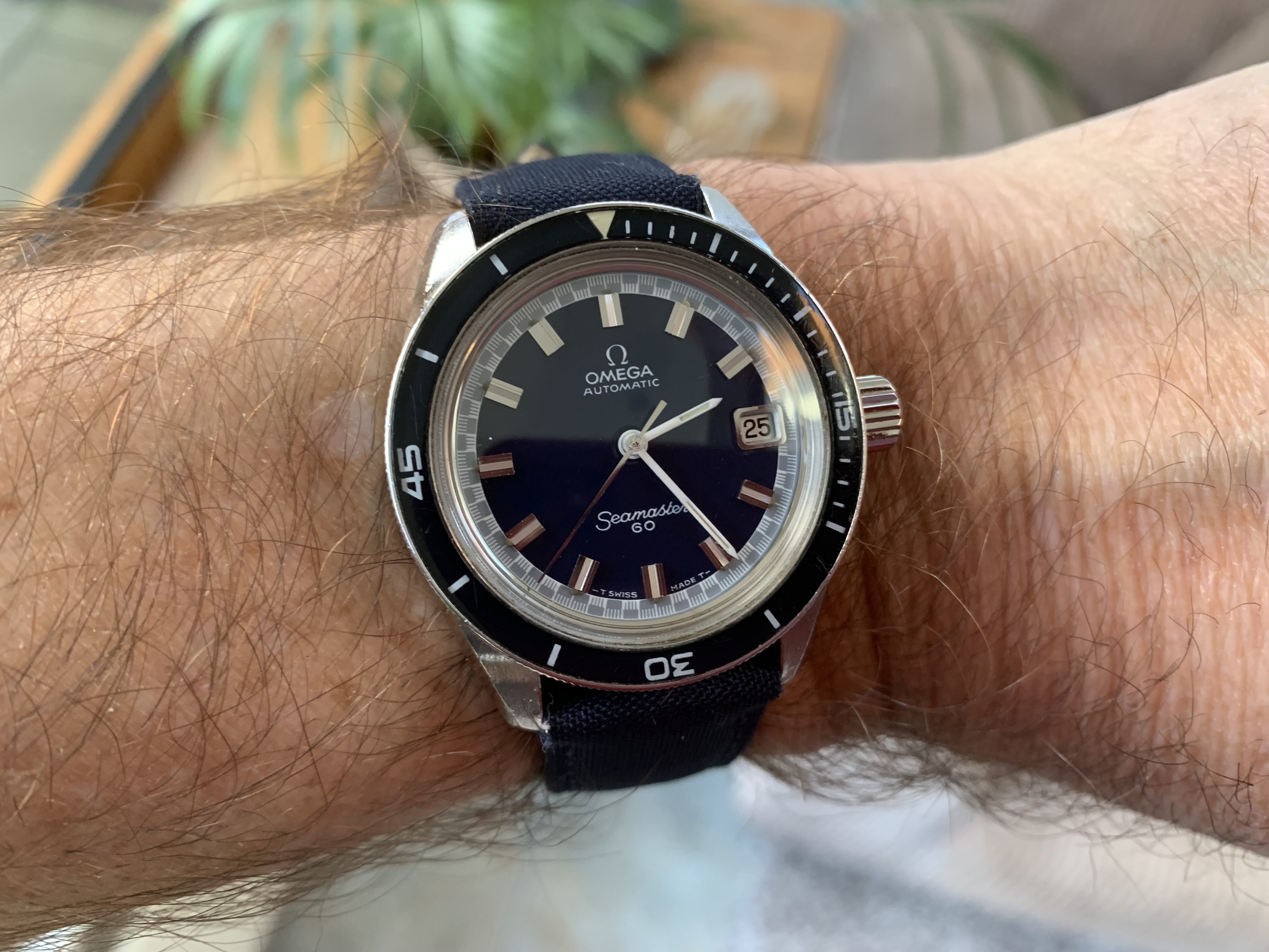

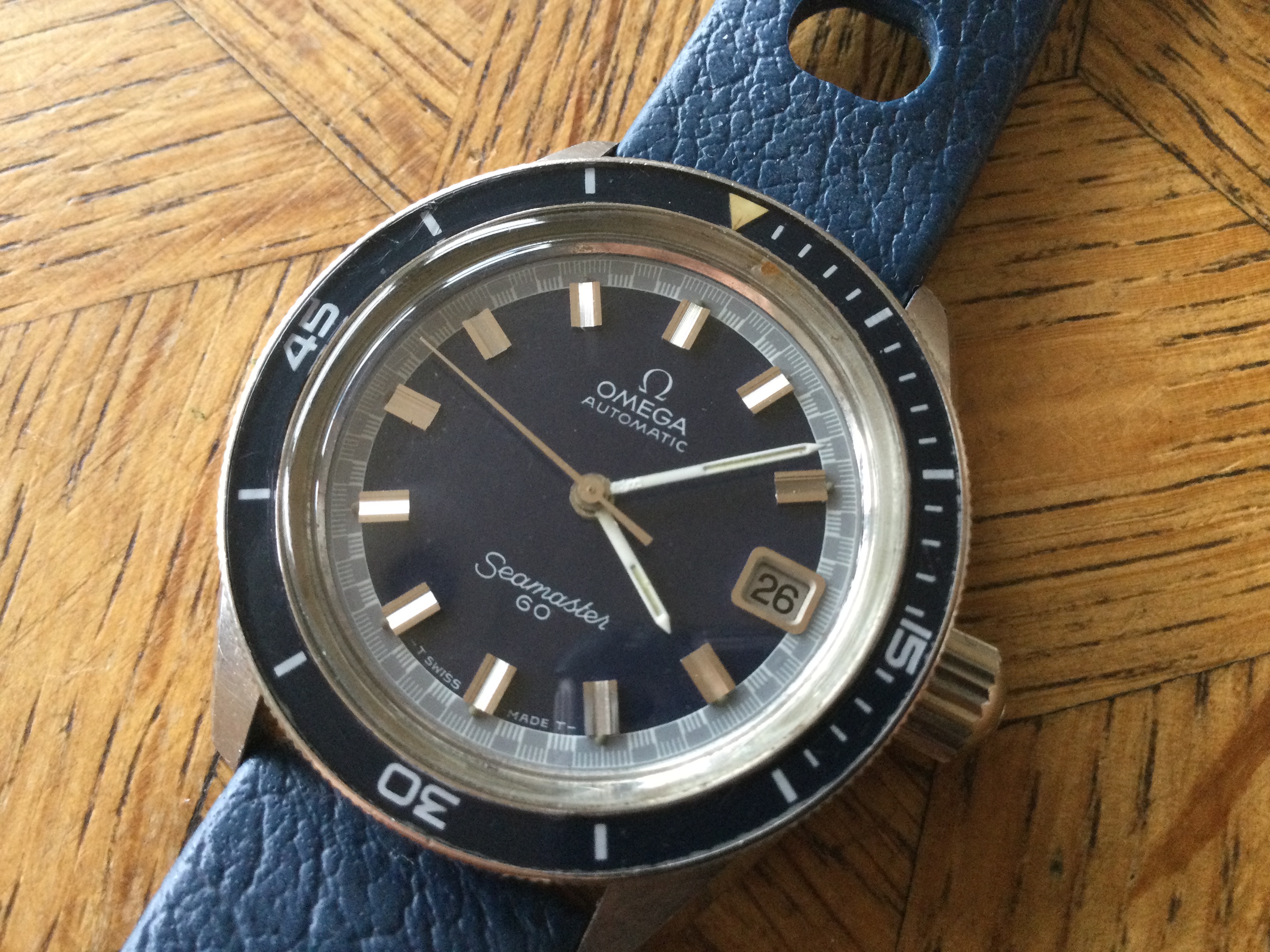

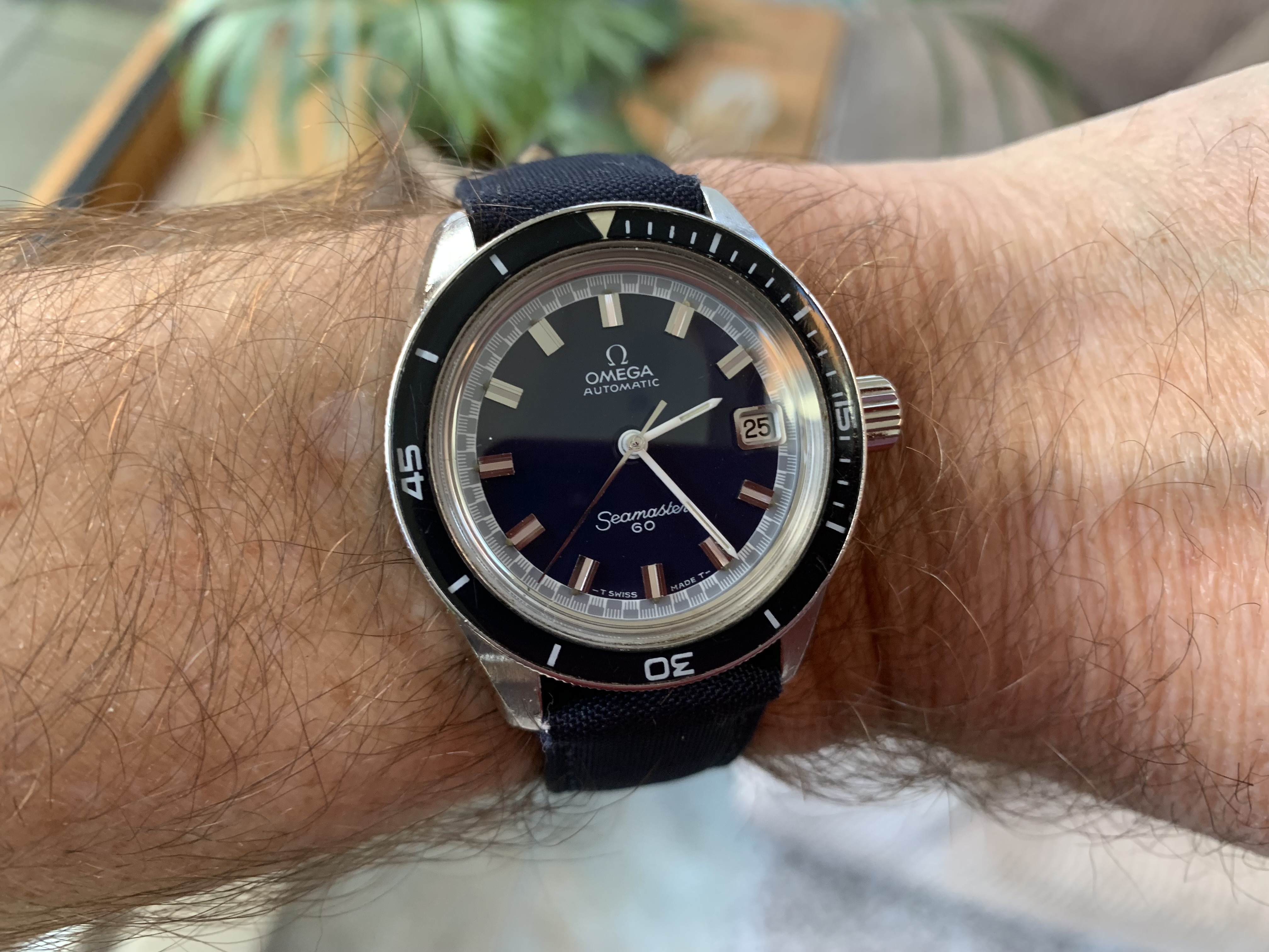

It depends on your wrist size I suppose, I find it perfect on my skinny 7” wrist.
Thanks to ChrisN for parting with this, it’s still one of my favourites.
Thanks to ChisN for parting with this one, still one of my favourites.
I have not yet tried it but, like Noddy, my wrists are custom made for the 36-41 area and not much bigger. I will try to find one locally to try on but I trust it will look great and I will be thrilled. That watch is lovely Noddy well done !
