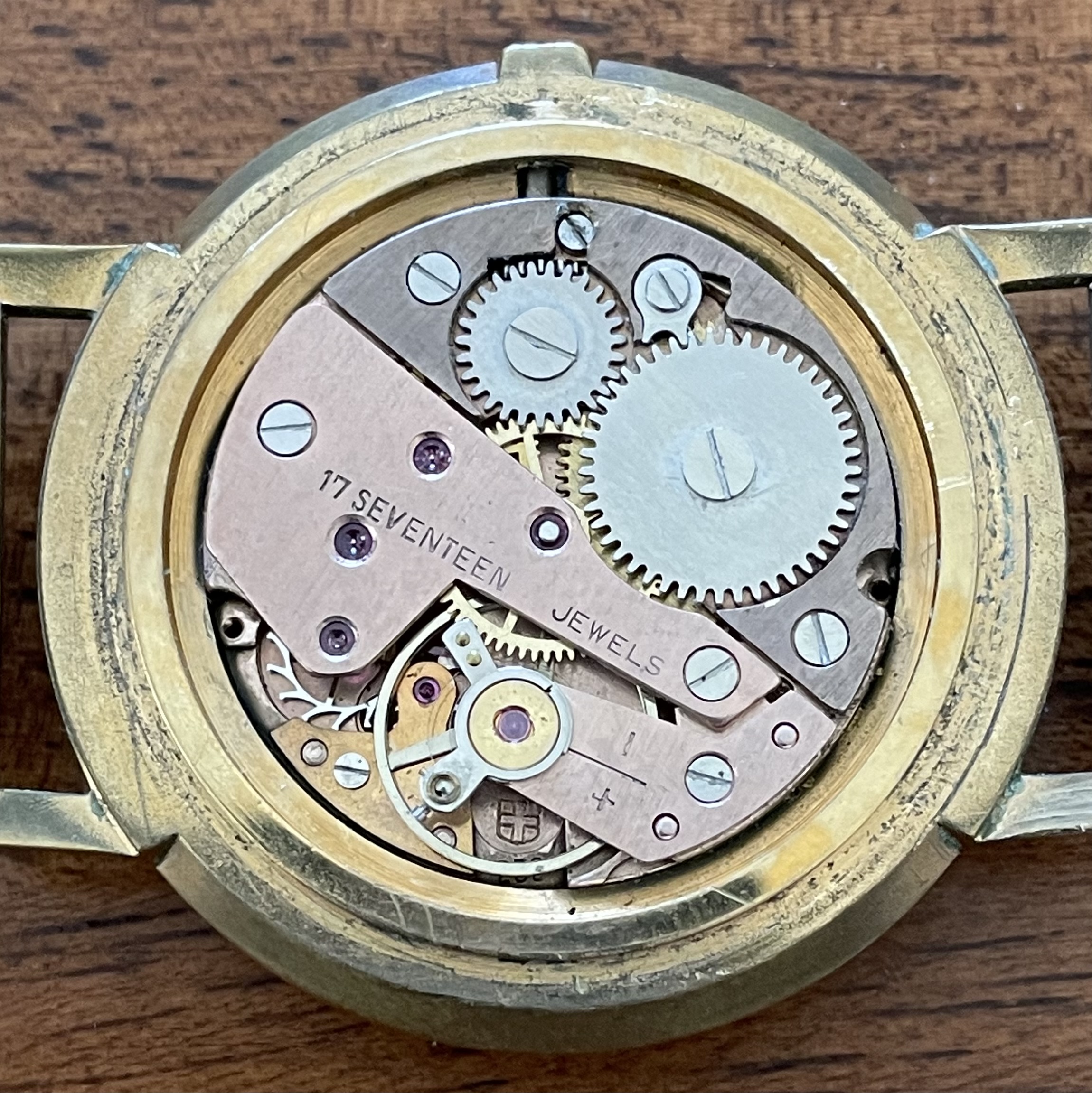

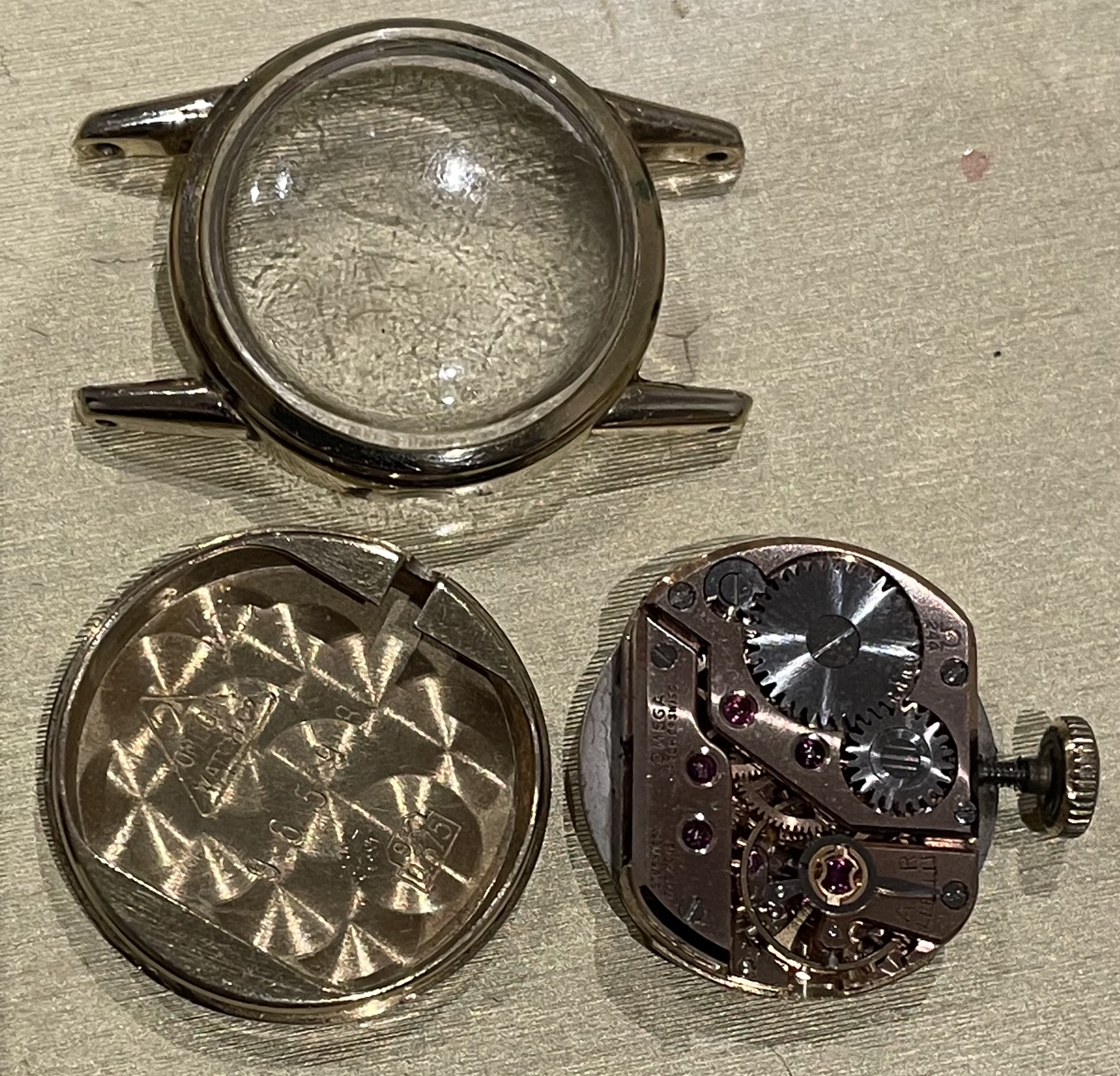

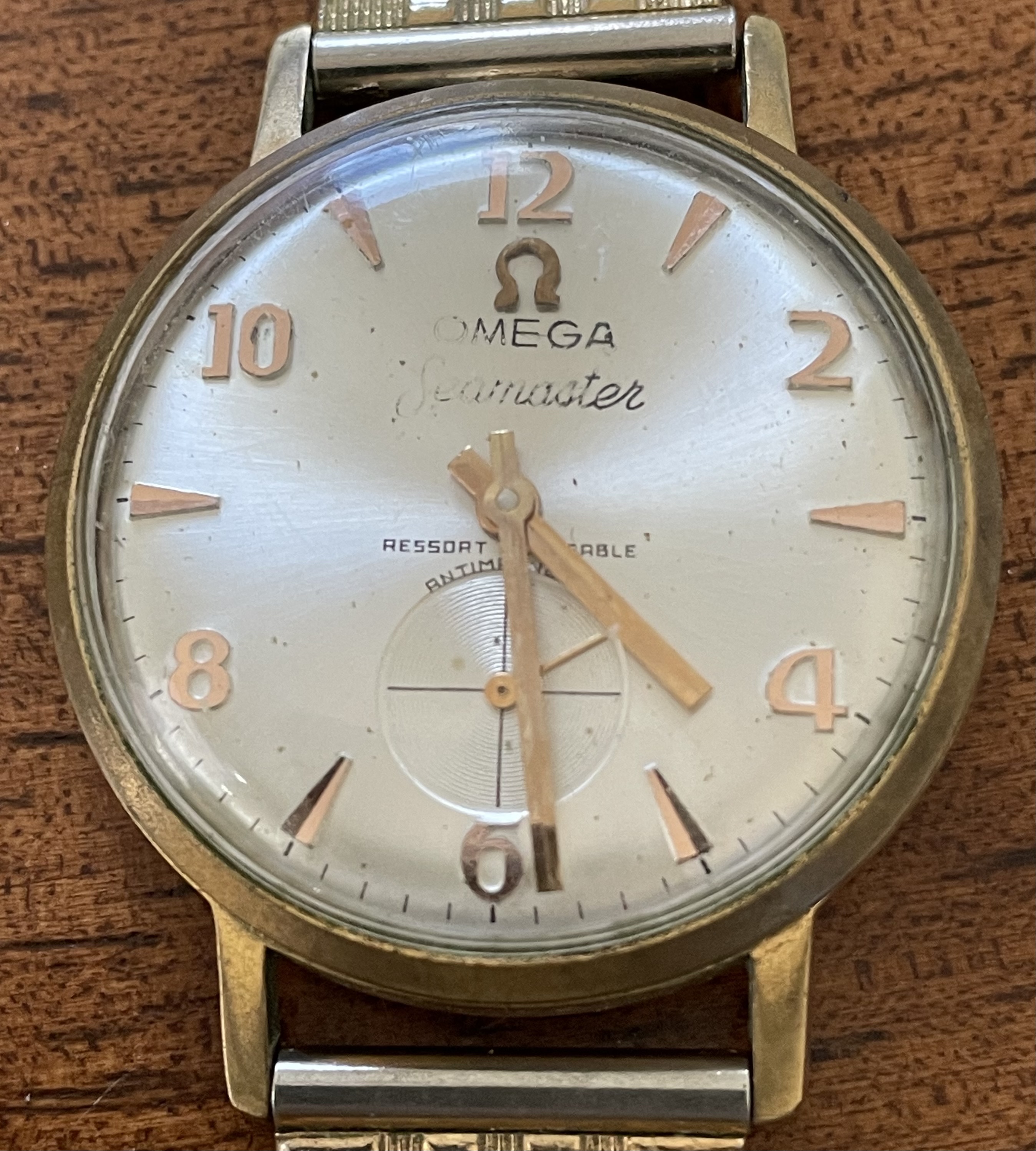

Any Ideas on this Omega Watch
10
7
The watch is not working and has the crown missing
The movement has no Omega branding but beneath the balance wheel you can see a Swiss Symbol
Thanks
Jeff
614
836
What has your research suggested so far?
Is this a watch in your possession, or one you're considering purchasing?
13,674
19,043
As fake as fake can be.
Not worth the time to research.
gatorcpa
But if one didn't know it was fake, wouldn't it at least be worth the effort of finding that out?

It's hard to prove a negative. Much easier for us to say, not Omega.

Sorry.
I mean: the dial, movement, case, caseback all point with 100% certainty that it's phony. The dial alone has several features that never appear on a legitimate Omega watch. Any one of these would be sufficient for someone with any familiarity with real and not-real Omega styled watches to recognize it as a pile of garbage.
But if OP knew it was a pile of garbage, he wouldn't have asked the question.
So, research is how you get to recognize these sort of things.

As noted, it's not an Omega. It looks like a Lorsa movement to me. The caliber number is beneath that Swiss mark under the balance. For what it's worth, it's quite an old fake, so it is a bit of a curiosity.
I’m trying to save him from wasting time.

My opinion: from a certain price on I need a 10x magnifying glass and should know what an original (dial) looks like. Studying at C24 helps, but doesn't rule out errors. I know, for example, my original Seamaster and Constellation under 30x magnification.

It looks like a Lorsa movement to me. The caliber number is beneath that Savoie mark under the balance.
Probably a Lorsa 238 variant. BTW, it probably wouldn't have a "Swiss mark" ...............
Ah shit, as I was typing this I saw the post above 😁

Thanks everybody it looked dodgy to my uneducated eye. It was given to me with a number of real vintage Omegas.
It will go back to the bottom of my junk box..
thanks again.. I think we can close this thread now

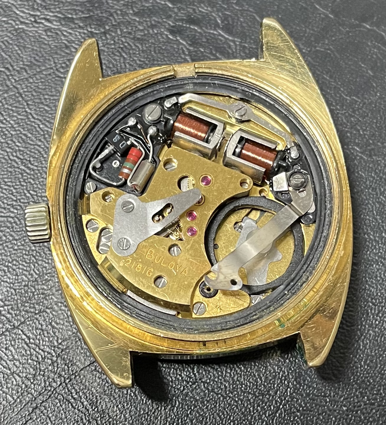

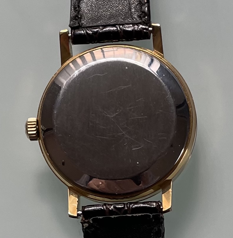

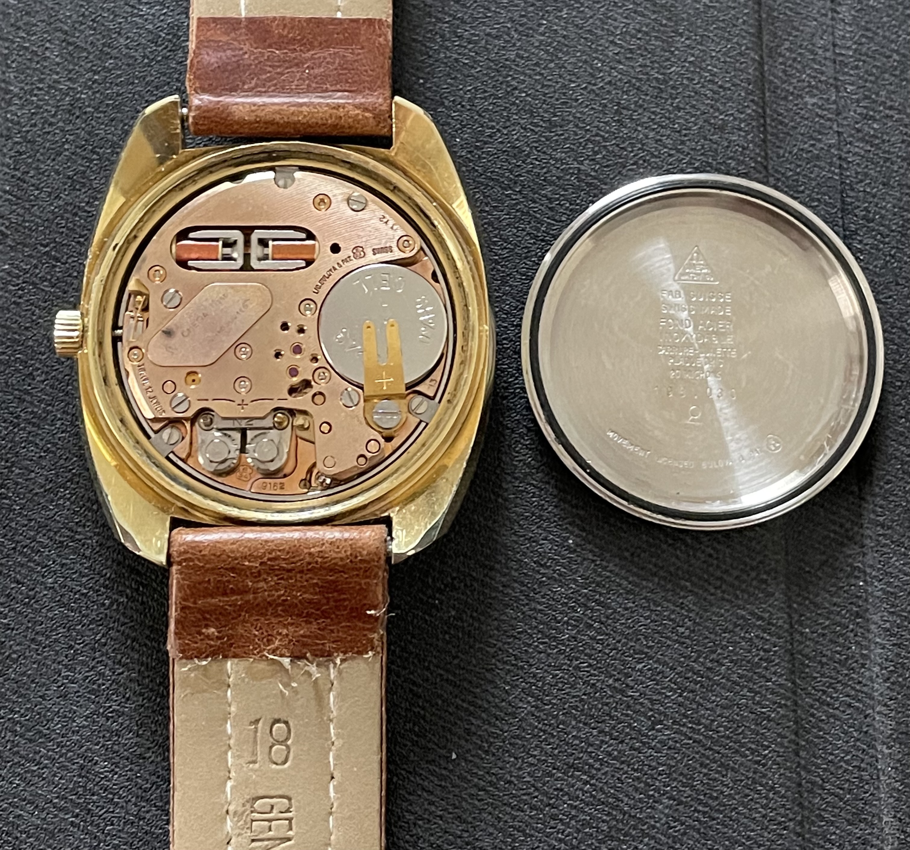

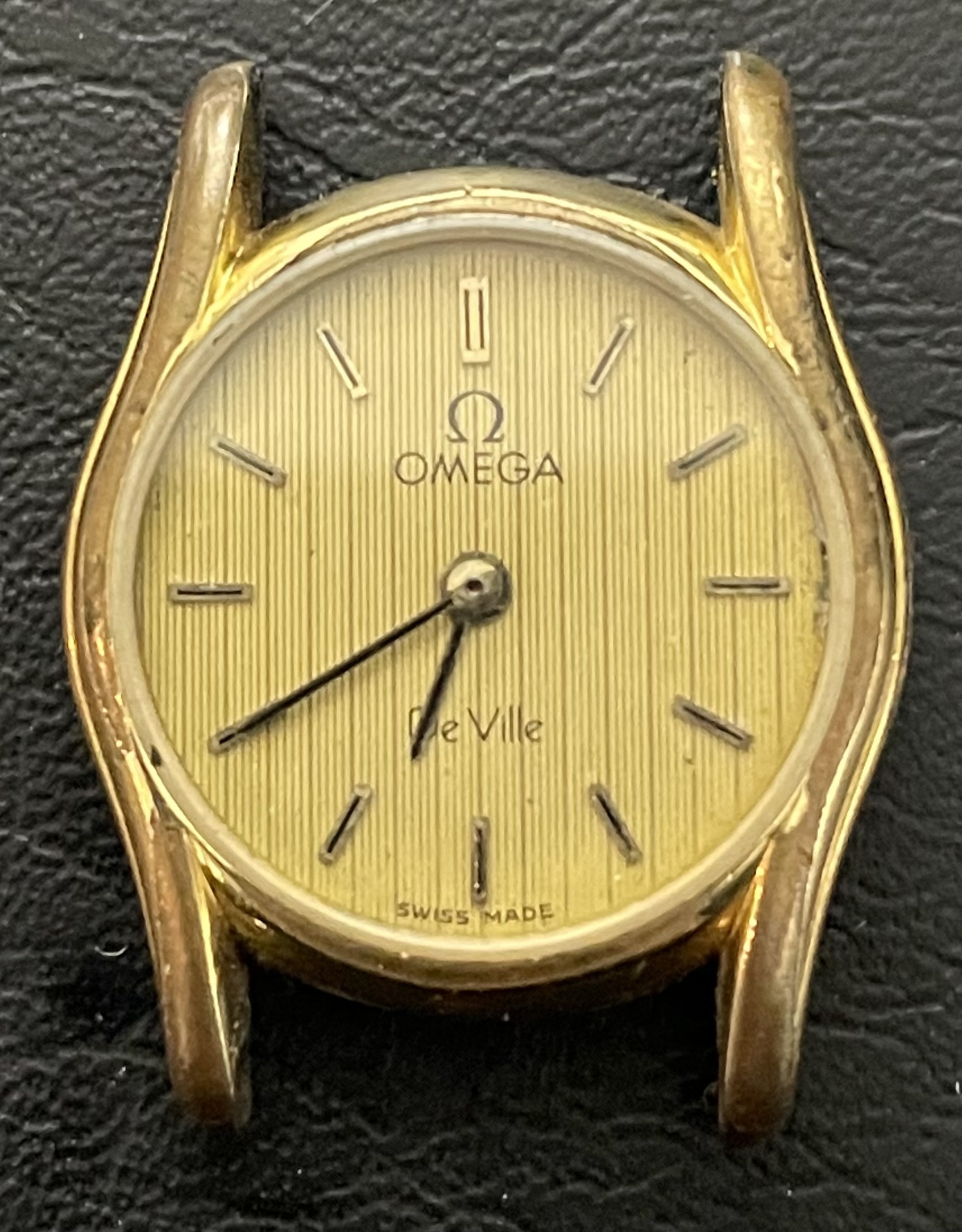

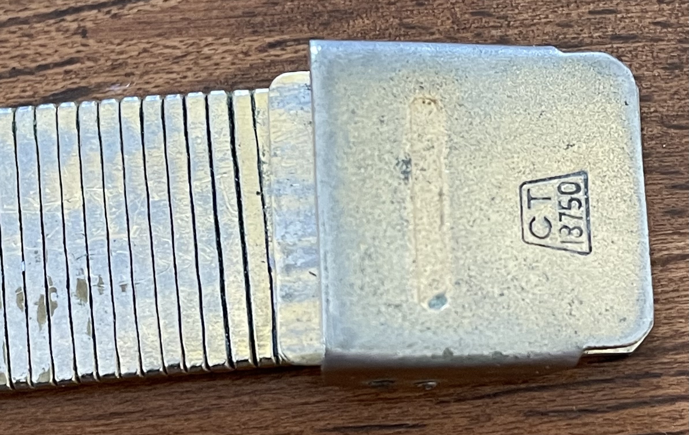

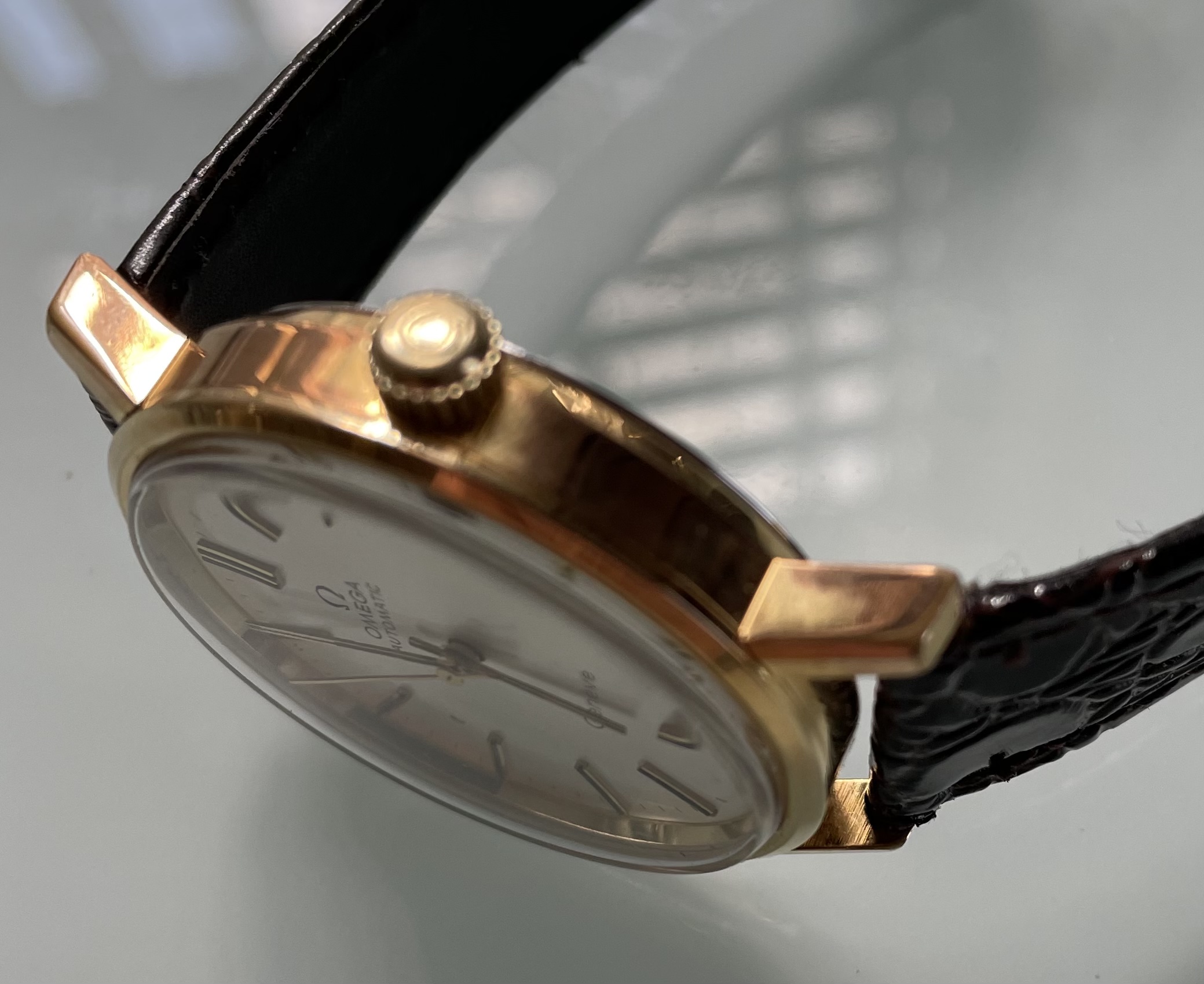

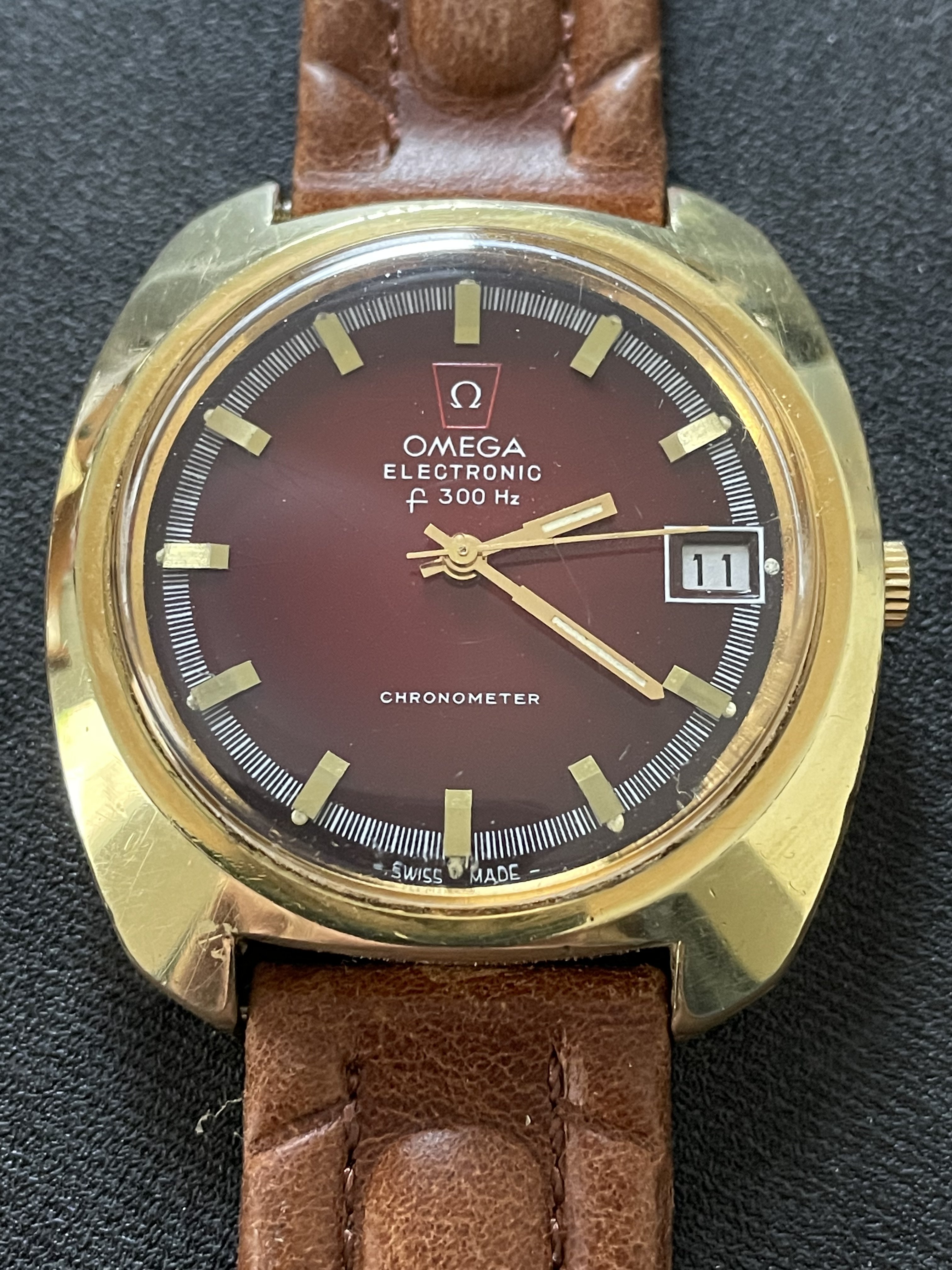

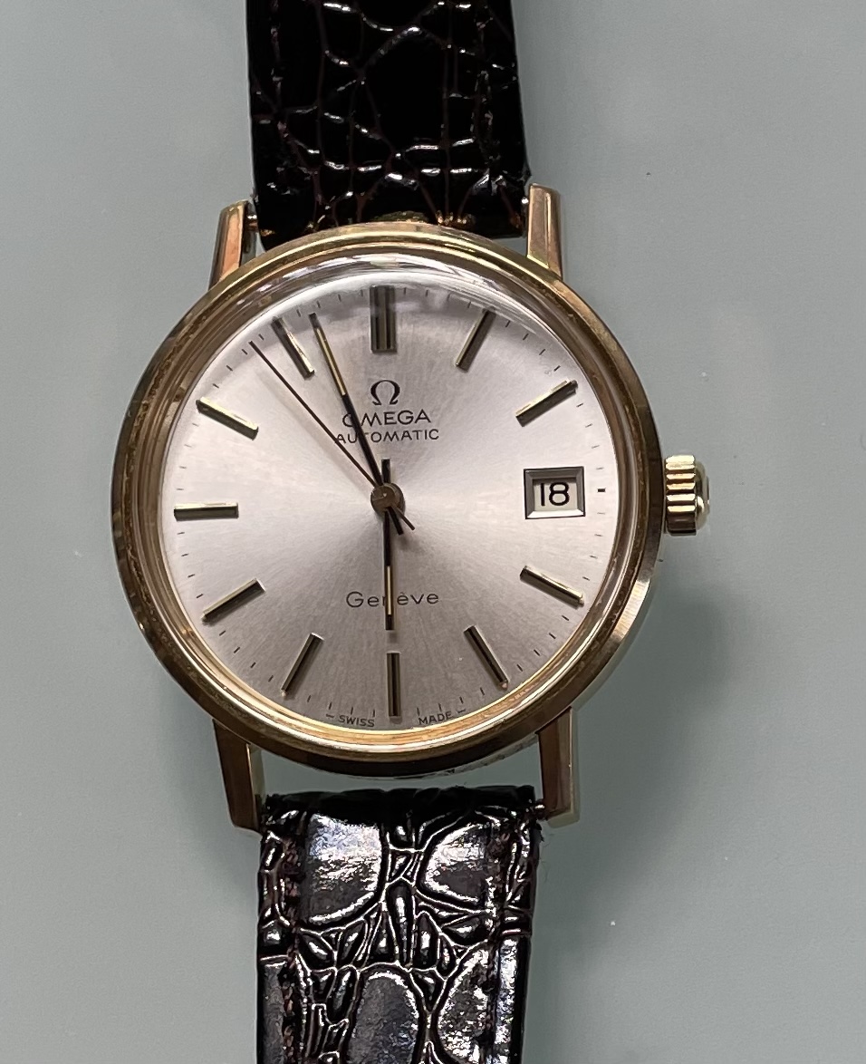

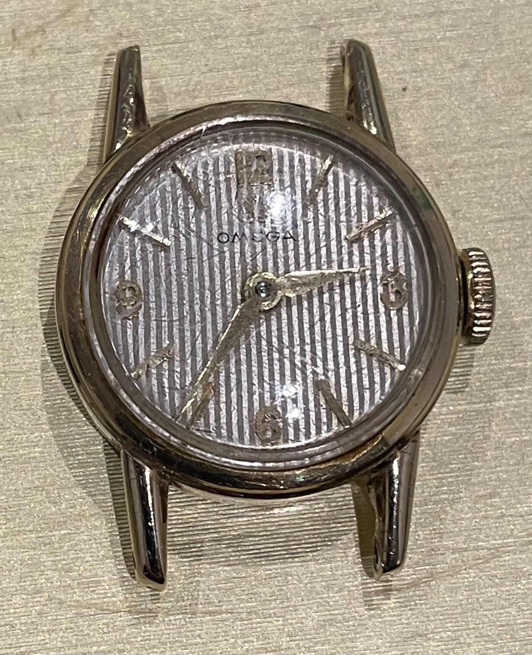

Well I have
1. Memomaster quartz in gold a bit worn but still looks good. Need batterys to see if it’s functional.
2. F300 with the tuning fork movement in gold with a red bezel. Looks great and runs well
3. Another f300 in SS in a different case almost like the Seiko Helmet Case. Runs well also.
4. A beautiful slim Geneva in Gold..
5. A couple of Devilles
6. A few more Genevas that run but in not so good condition.

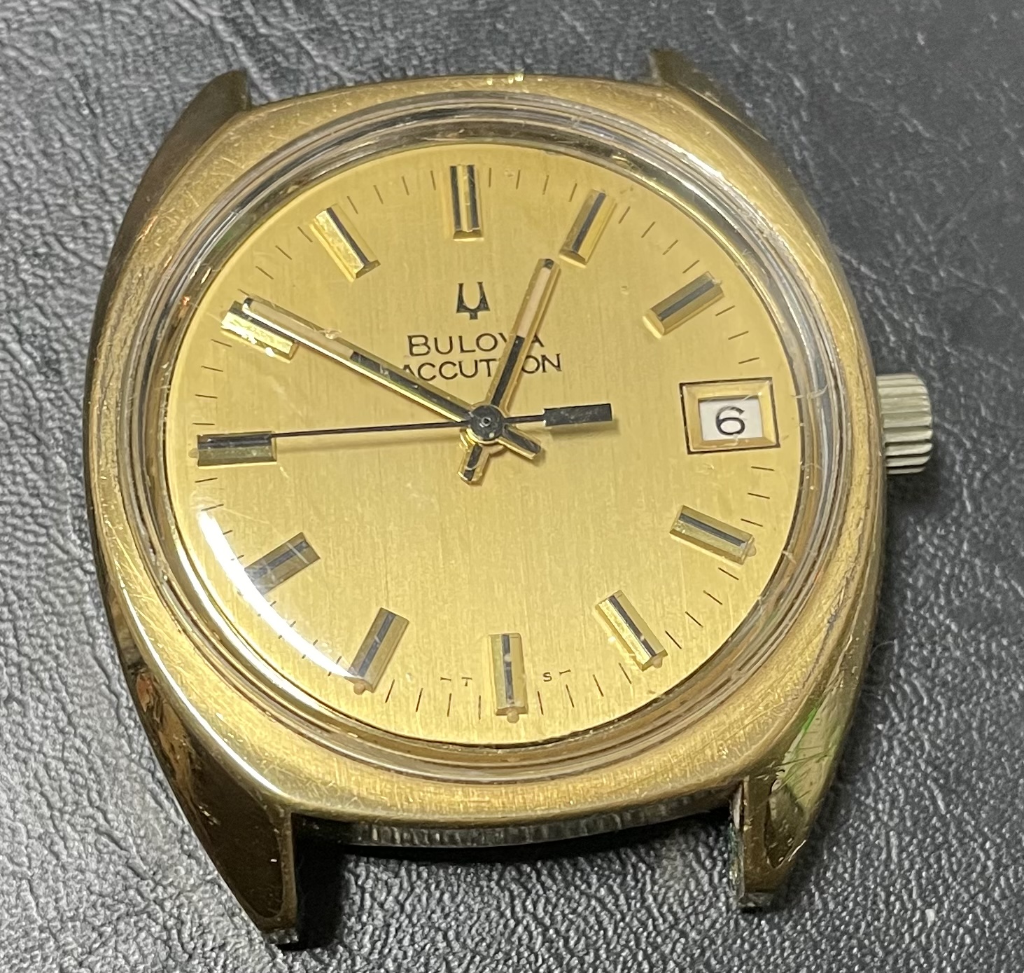

7. I also have a Bulova with the same movement as the f300’s
Plus others I’ll post some photos I have and photograph some others..
10
7

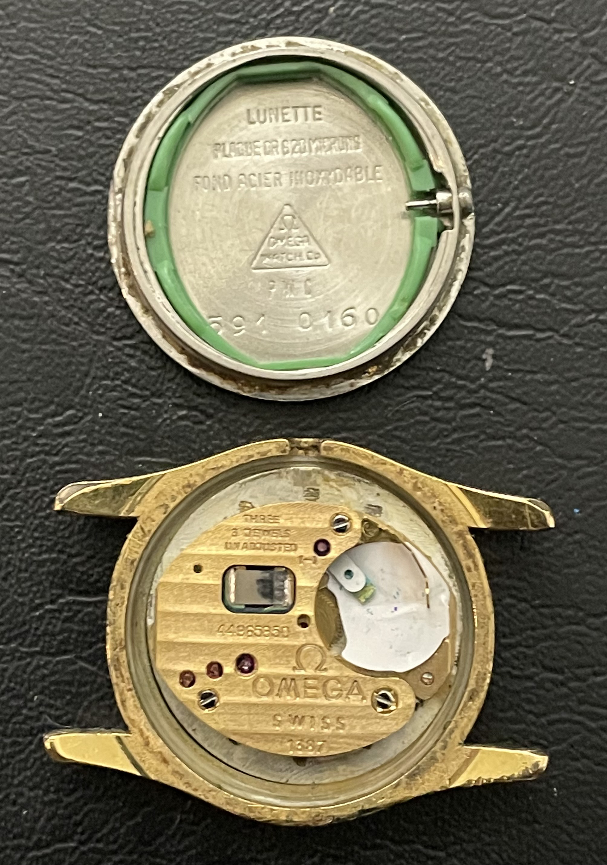

An interesting thing about the Bulova the original battery was mercury and the silver oxide replacement needs a little rubber ring to help position the smaller battery..you can see it in the photo..
