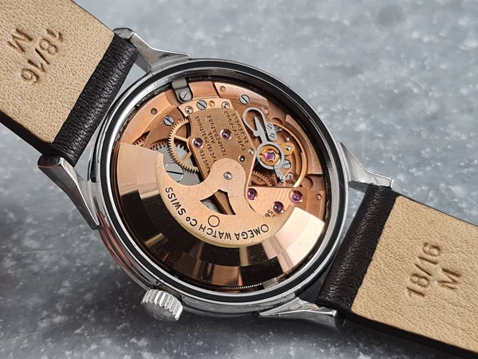

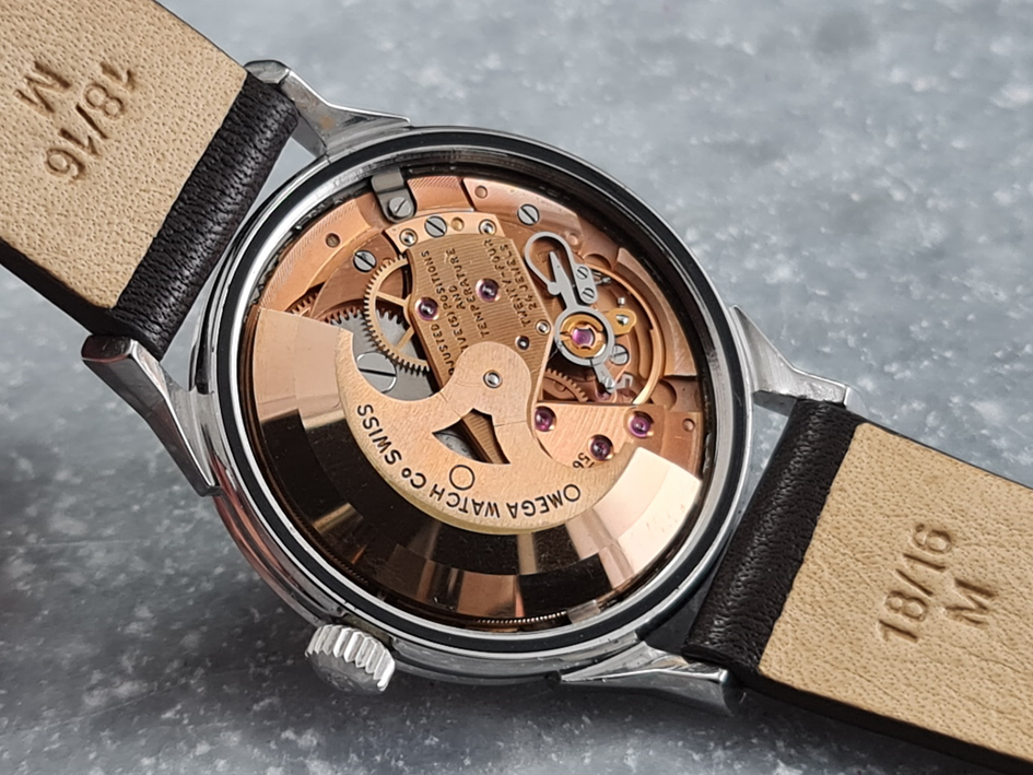

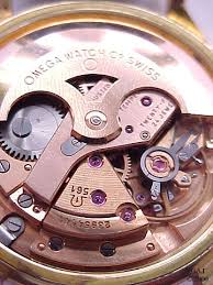

Any idea what this "O" means on the rotor ?
322
163
I'm offered a nice looking SS 168.005 dating 1969 with a 564 Cal. inside : and I recently realized that the rotors bears an "0" or "O" just underneath "Watch" : then I went on searching, and I found quite a few, but it seems only Cal. 564 have it : any idea what this can mean ? additional proof for a 564 ?
Certainly several OF Members will have the answer : many thanks in anticipation !

It signifies a replacement part.
Can we see other pics of the watch?

I have also read that the "O" indicates a replacement rotor, and I tend to believe it. But it's also interesting that almost all 564 movements do seem to have a replacement rotor.

Well this is exactly the point ! I first suspected it to be a replacement rotor, but it took me 10 minutes to check on C24, and find more than 10 Connies with Cal 564 which all exhibit this "O" on the rotor, hence my question; and so far, I cannot recall having seeing any other movement than 564 housing this mark on their rotor... but again, I'm a newbie on Connies, so I thought I'd rather ask the experts.

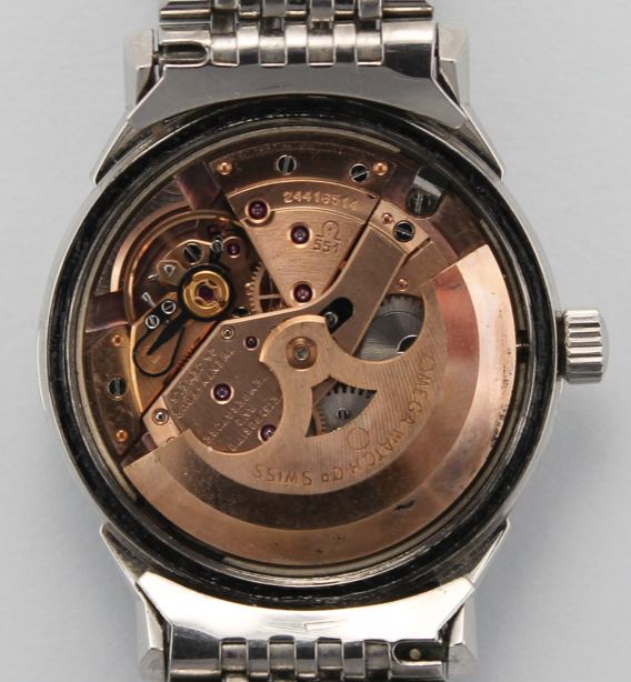

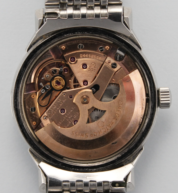

I'm pretty sure that it was @Archer who suggested that the 'O' denoted a replacement rotor.

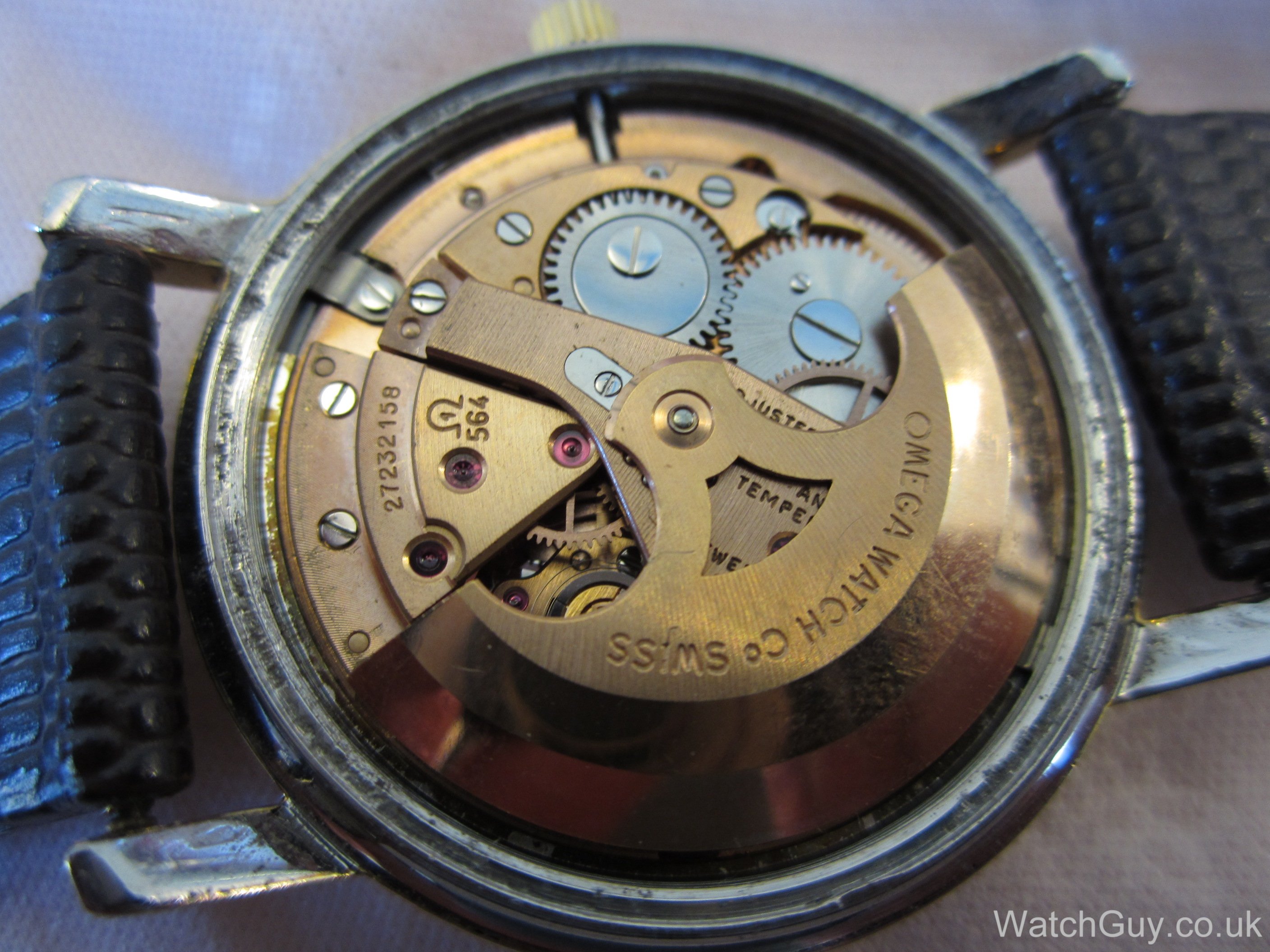

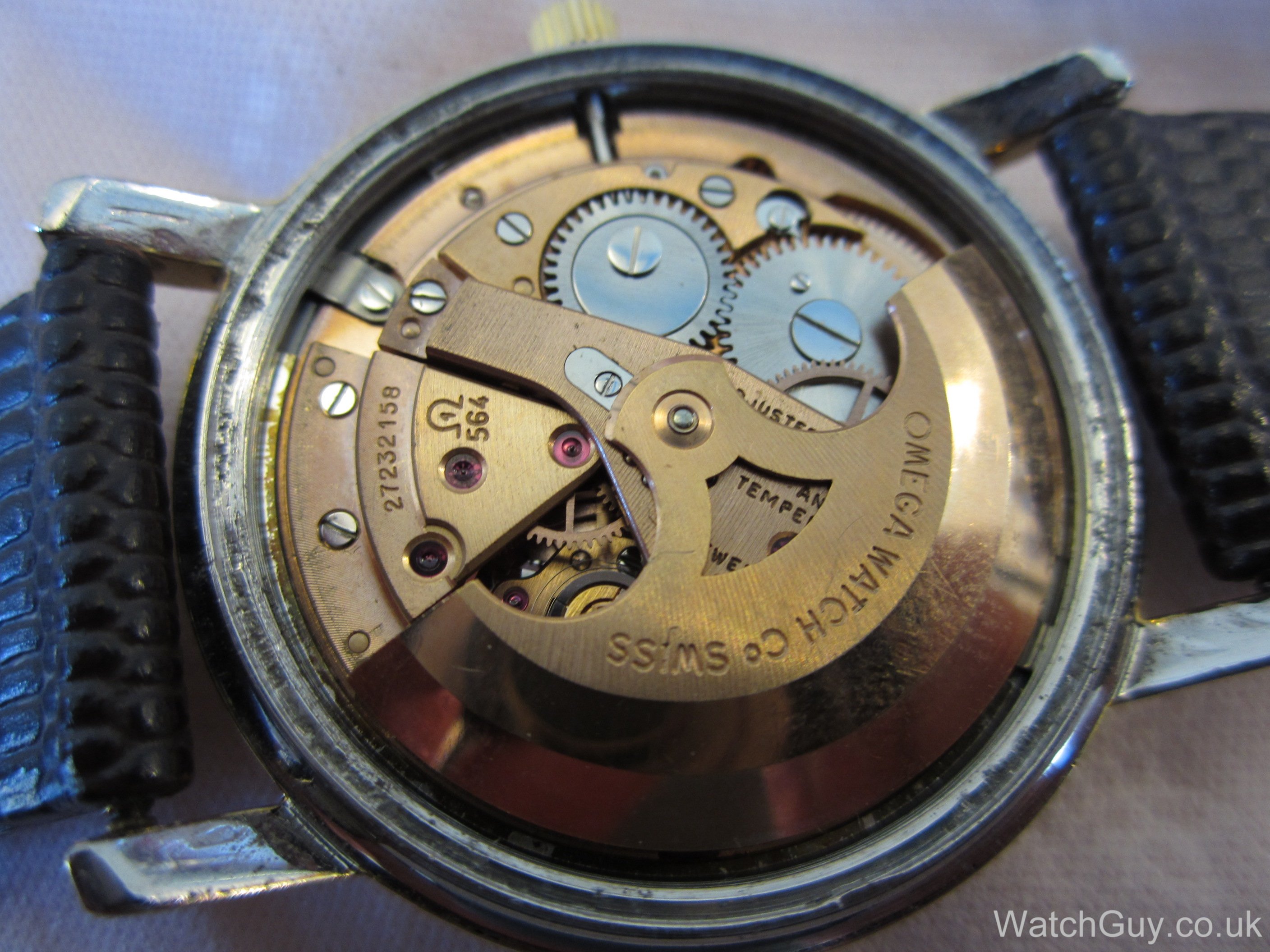

I've just checked and of the handful of 564s, that I have pictures of, they all have the 'O' on the rotor but the 551 and 561 don't.
However, they all have historical service marks so no smoking gun there.
If it is conclusively a sign of a replacement rotor, then it could be that replacing the rotor was a standard service action for a cal564
It also may be a factor that the O only appeared on the replacement rotors post mid-60s, so it would make sense that more 564s would show Os
A quick google reveals just one non-O rotor, which whilst it looks like it belongs to the watch may itself be a replacement.
But another quick google of 561s and 551s also reveals o-marked rotors

I’ve seen several ‘O’ rotors on non 564’s. They also seem more basic and utilitarian that the normal rotors, which given the direction Omega went with the cal 10xx series, adds weight to them being replacements.

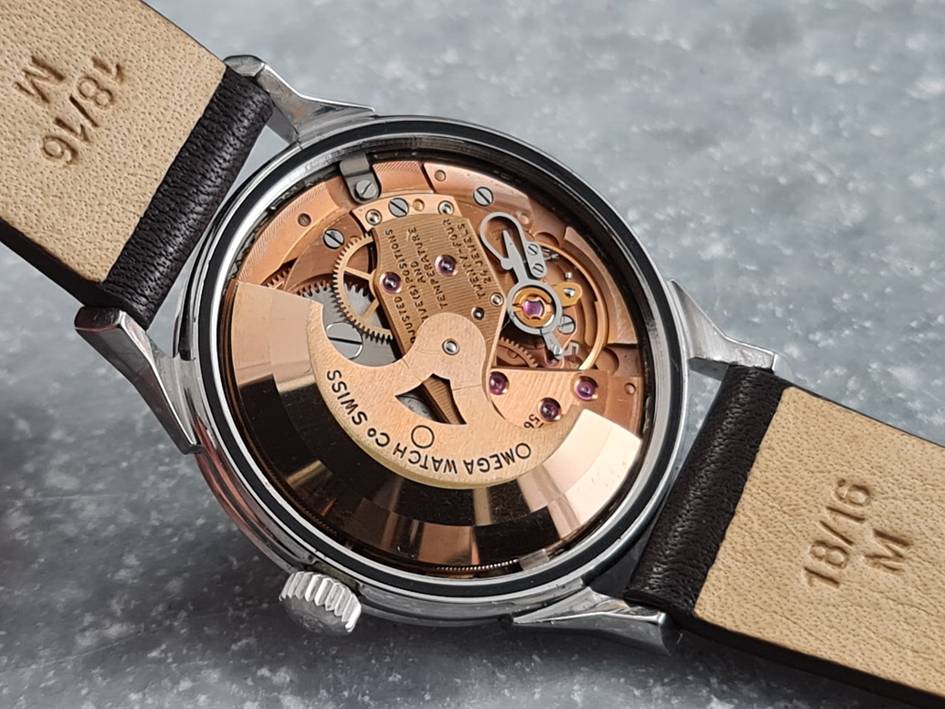

I will add I have always seen that O on 564s, specially on C-Shape Connies.
To be fair, the style of the rotors on late 60s Constellations were pretty basic -like the one on the OPs pic

Comparing them visually, some have a rounded edged circumference around the pinion, and some show 2 somewhat sharp corners, whether with or without "O" : so it seems there are at least 4 different shapes, not knowing whether this has an effect on the dynamics of the rotor. Has anybody ever compared weight and thickness of these various rotors ?
