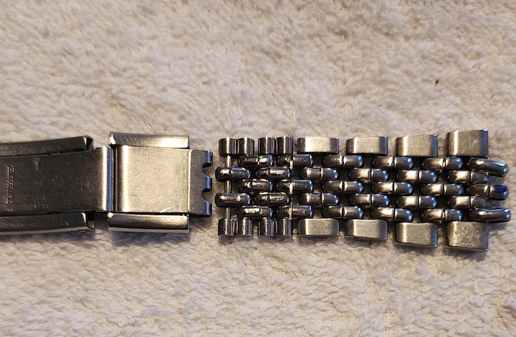

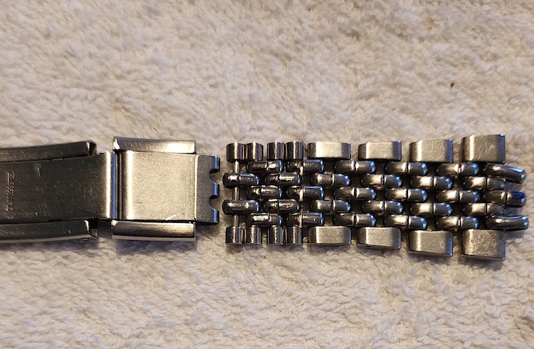

Any idea how to remove the pin from this BoR link?

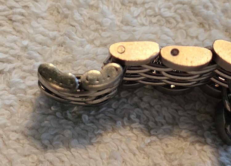

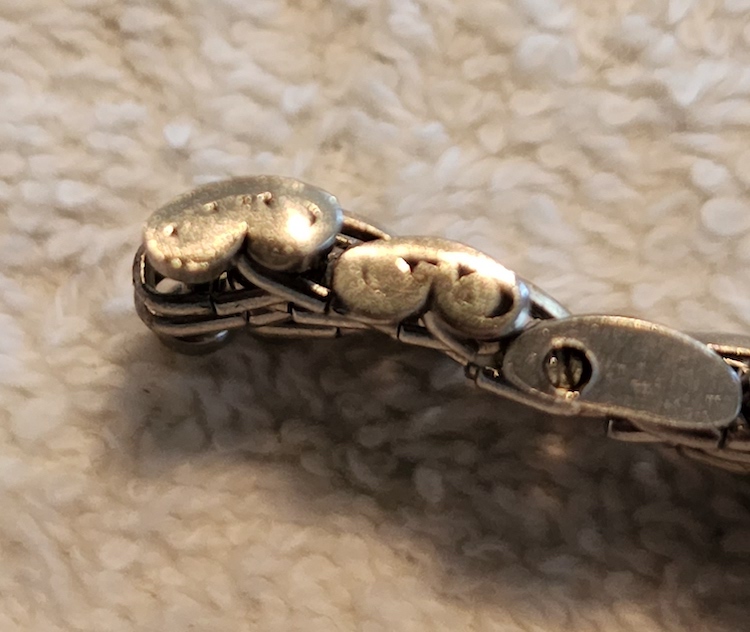

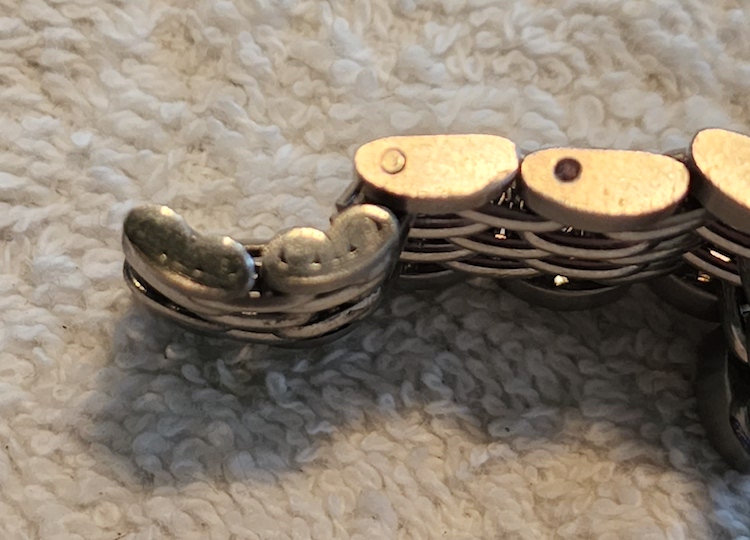

As you can see, the pin needs to be removed so I can get the links into the clasp ends. They look like push pins to me, but they also look as if they are fused to the link? Before I begin tapping away with a fine bit hard punch I thought I had better ask the more knowledgeable here.

I think it's a normal pin, but that the whole edge has been polished.
18,851
39,204
They're straight pins which are swaged into the links and aren't meant to be removable, unlike the other pins/screws in the removable links.
You could try a pin punch, but I fear that would break before the pin gave way unless you use a quality item.
There's only one way to find out.
Support the bottom of the link in a bracelet block, apply oil to both ends of the link and use a pin punch and a hammer.

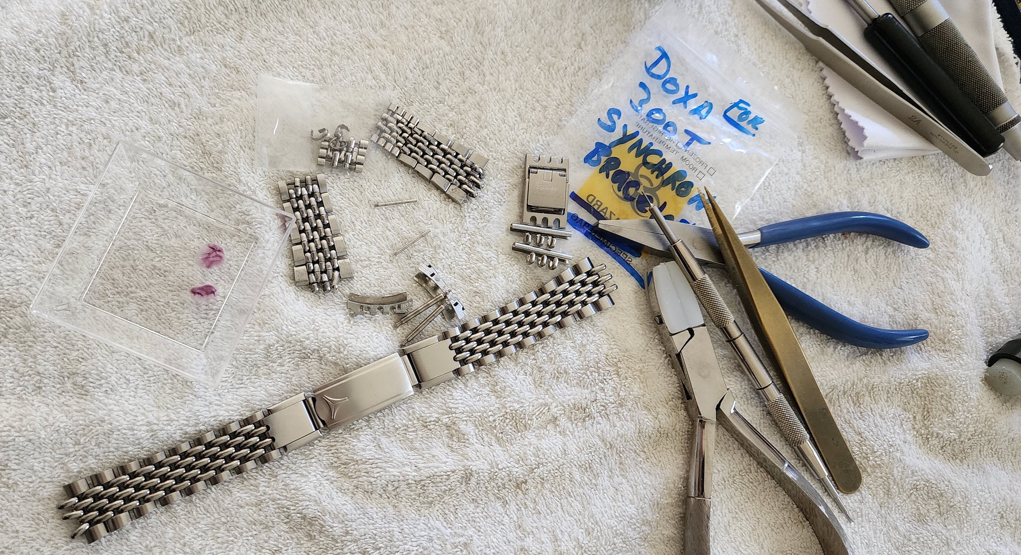

Thanks guys, luckily I found an another set of BoR links in the bottom of my Felix bag of tricks that were better suited as it turned out. Turned out ok with a light polish.
Never thought about the swaging process - but yes, I can see that now. And as Dan says, polished up as well.
